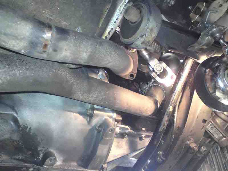

Well tonight I have bolted the prop, fitted the terminals to the reversing light switch (but they still don't work) - not an MOT failure is it?
Fitted the 320 gear selector rod I picked up from the stealers, gearstick sits bang in the middle and all gears can be obtained. Fitted the fan switch to the side of the rad.

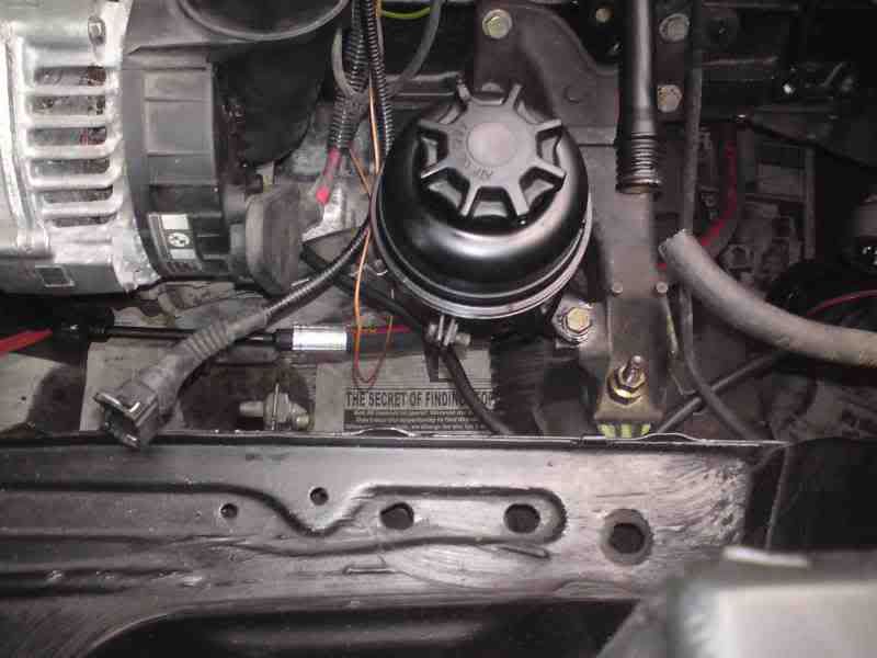

My only final snag is the PAS pipes coming from the E30 rack do not want to connect to the M52 power steering pump, the bolt that goes through the union and into the pump is much bigger on the M52 pump
So I can't connect the E30 pipe to the pump as the bolt is too big to fit through the union.
They fitted no bother with the pump that was on the M50, so my solution here is to either get a M50 pump or get a custom hose made up, which must be a right fanny on of having to take the rack back off and the hard pipes etc and I really don't fancy that.

I did give it another quick start up tonight now the exhaust system is all connected up, sounds sweet as a nut.

M50 pump wont fit on your M52. You will have to have a pipe made unless you can bodge the E36 hose on, rad can go on though, plenty of room to get at the PAS pump
- Posts: 16806
- Location: Norfolk
I thought I was being a smart arse and instead of removing the complete pipe assembly off the E36 rack, I thought I could get away with cutting the E36 rubber pipe off with the intention of joining E30 pipe to E36 pipe by sleeving some copper pipe down the middle and using some jubilee clips but that ain't going to work.
Damn it! I wonder where I need to go locally to get a pipe sorted out. What do I do Dan? Take the complete pipe off the E30 rack and then ask them to fit the E36 union to the end?

If you have somewhere like pirtek nearby they will have the unions in stock, all you need to do is give them measurements between bends, hard line, flexi, unions etc
I had mine made up by pirtek and it cost £40, mine is routed behind the crossmember to the passenger side and then a straight bit to the pump

So do I need them to make up the complete setup from the rack all the way to the pump, hard pipes, unions at each end etc or do I take my crusty hard pipe off and take that to them and get them to add a fresh rubber pipe with correct union?
Do they do this stuff while you wait normally?

Just have a whole new pipe made, its worth it as it will be a long time before it starts leaking, give them a ring and if they are not too busy they will do it while you wait
- Posts: 16806
- Location: Norfolk
Well I may aswell take my hard pipe down to them so they have a good template to work from, it's going to be coming off anyway. So I guess I'll be removing the rack once more, grrrr.

Got the steering rack off and removed the complete pipe, took this down to the local Pirtek and the lazy cnooots are closed, even though it said they are open on saturdays until 12.30.
So I have bought a super drill bit and am going to try and take the extra mm of meat out of the union on the E30 hose, put some new copper washers on either side and see how it works. Worst case scenario is it won' work and I'll be back to Pirtek on Tuesday, but if not, my god this mo-fo will actually be finished and ready for an MOT. Shock horror!! I didn't think I'd see the day, well not as a married man anyway

I drilled out the union on the pas pipe and it's fitted upto the M52 pump and ain't leaking yet. The cooling system took an age of adding more water bit by bit before there was any heat at the vents. No leaks there either and no oil leaks, so all good so far.

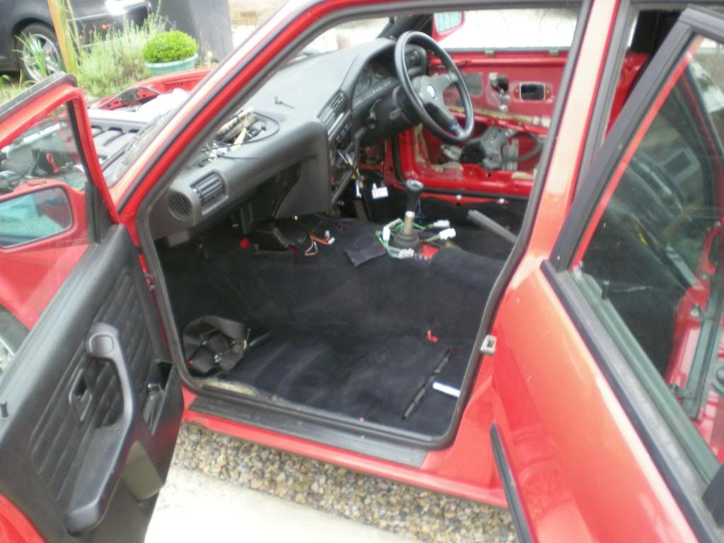

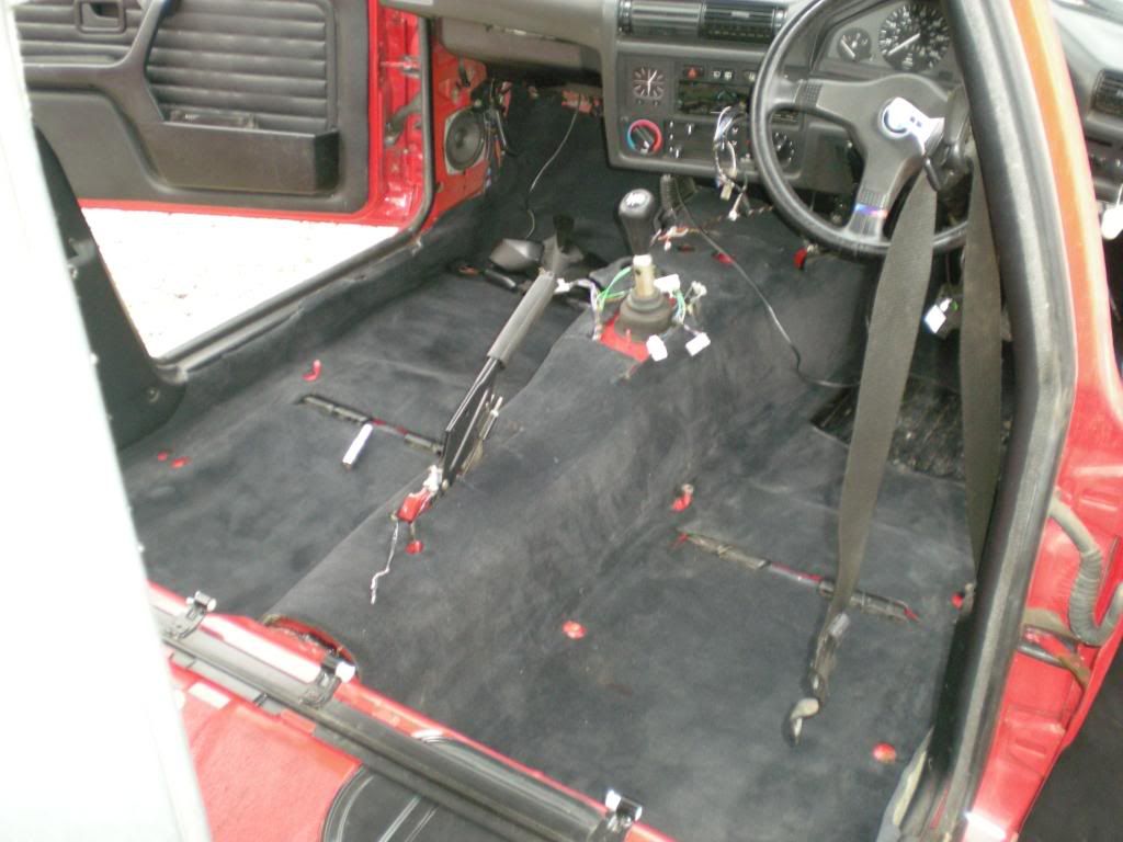

Well today involved sorting the interior out a bit, now I have the luxury of 4 opening doors. It's starting to resemble more of a car now.
Also the excitement of the car being parked in a different part of the driveway warranted a pic. Anyway, here's the engine room dept at the moment
Then I set about the interior, first of all fitting the 6 pot coding plud to the instrument cluster so the rev counter now tells me what is actually going on. Also fitted a tech1 steering wheel I've had laying around, replaced the SE style 3 spoke wheel. Also took the bucket seats out and gave the carpet a quick hoover

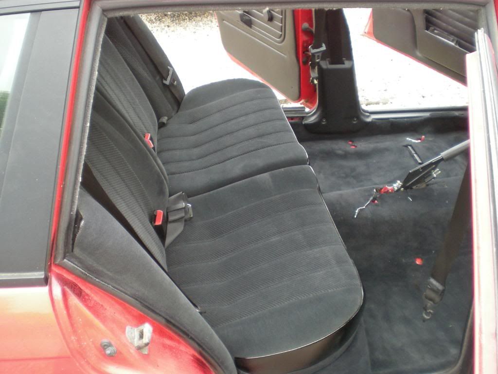

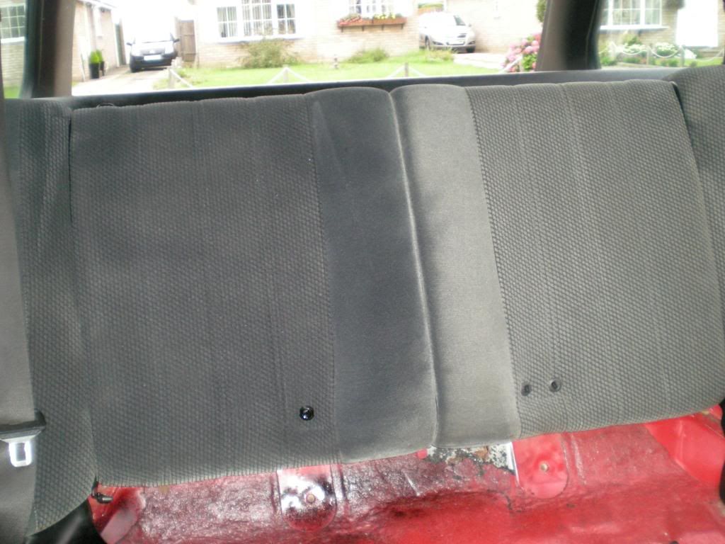

I then dyed the rear seats and bit of carpet that goes underneath them, so the black theme continues
