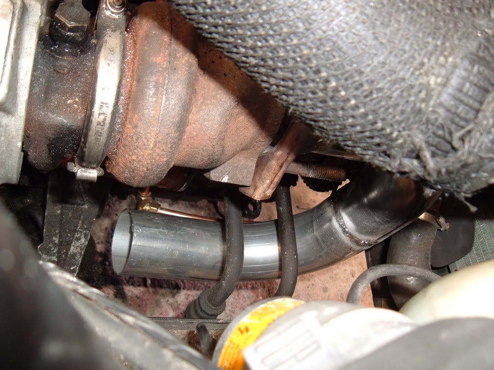

ant wrote: One method I considered is to fit the turbo so the intake faced the rear, that allows the discharge pipe to run back under the manifold itself and exit through the stock routing, I thhink thats how deano has run his.
Yeah that is how i'm planning on doing it, well not planning in the middle of doing. I got two 90' bends welded them up that then goes just underneath the pipes that run to the oil filter housing, pointing in the right direction. And well thats as far as i've got on the downpipe so far. Just got to come up slightly to miss the engine mount and UJ iirc, then join to thhe existing frontpipe.
Heres a little piccy, not a very good one mind you. sorry its a bit large
