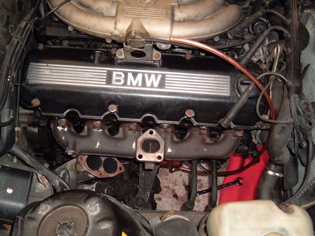

I did the "round the back of the block into the vent tube" and the car smoked like hell .. not much fall on it at all ..
it may work with a large enough pipe(i used 15mm copper)or a pump to draw it out..but straight down into the sump seems to be best bet..

With reference to can you use a 325 diesel manifold, then the answer is yes, have a look at the below photo.
Now to get that to fit it took about 5-7 hours solid with a file on a drill and lots of sweat. Basically enlarging the top holes and creating notches for the bottom studs. I also burnt out 3 drill bits, that cast iron is strong 8O .
I have fitted 535 injectors already, and am using a vortech fmu to try and sort out the fueling,i have a nasty feeling its going to overfuel like a basturd though.
As regards to the turbo you have to take it apart into its three sections, and put them ack in the desired angles to 1)make it so the compressor housing isn't pointing at the suspension housing and 2) so that the oil feed is at 12 o clock and the return at 6 o clock. Once you've done this the wastegate then won't fit in the right place so a custom adapter plate is required, yet to do.
A nasty exhaust downpipe has yet to be created.
