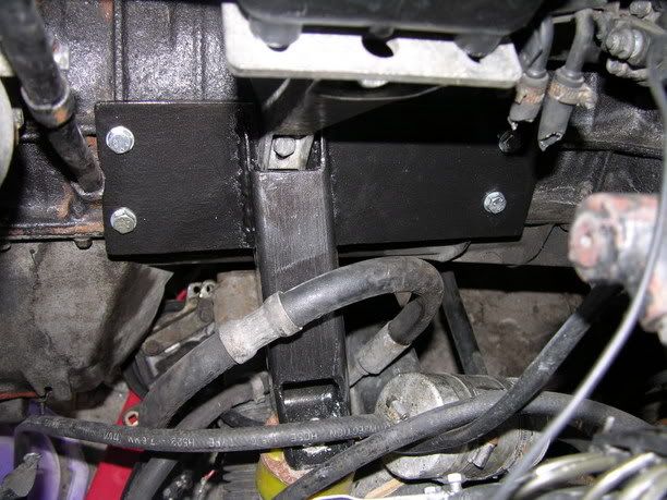

hey alex,i'm about the same stage as you in the conversion,i made my own mounts as well,a little tip i found worked out well,i mounted the box first,then,set the engine on a 10mm peice of wood on the crossmember ,line the crankshaft pulley to the middle off the two chassis legs,i had plates made for the engine and the rubber mountings(5mm plate),bolted them in place,then i cut pieces of cardboard the size and shape i needed to go between the two plates ,i found it easier to shape the card board first then use thet as a template on the steel,i used lenghts of steel 10mmx40mm.three lenghts on eash mount,similar to these.

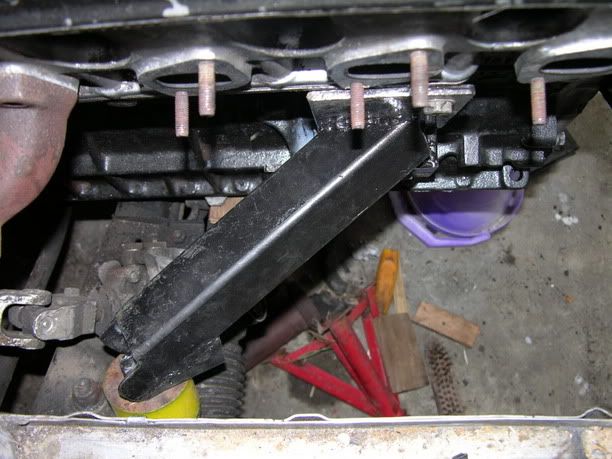

heres the inlet side mount, should finish the exhaust side later.Alex Imagehttp://i151.photobucket.com/albums/s121 ... mount2.jpg[/IMG] Image

that welding would worry me to be honest... it looks like the you need to use thicker wire and turn the power up for more penetation (ooer!). or if your welder is maxed out, tack weld the other one to get the shape and then get a local engineering / welding company to run over your welds to beef things up a bit.
Posts: 14033
Sat May 05, 2007 8:50 pm
Does looks a tad 'chicken-shitty' doesn't it! Should be quite strong though as it's a box structure, welded on both sides of the steel plates...

Yeh the welds are crappy, im new to this welding lark, the main stress points, ie the top and bottom have been 'properly' welded, i only welded the brace parts if you get me. Oh well if it brakes whats the worst that can happen.Actually PLEASE dont answer that!Cheers Alex :D

try tinkering with settings and preheating the metal with a blowlamp.

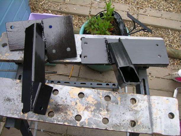

ed325i
Posts: 4146
Sat May 05, 2007 9:42 pm
This is how I made mine.
Posts: 14033
Sun May 06, 2007 11:37 am
Now those look sweet! 8)
