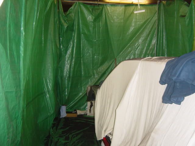

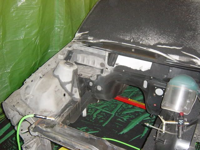

Ok, started to do some blasting on the shell today Whoo Hoo! Got everything prepared, fired up the compressor, plugged all the equipment together - then it started raining :cry:
So, not being one to let the side down I sheeted the unit up and made ready for the mess 8O Yes I know I said I wouldn't.
Does anyone remember M*A*S*H, the 4077th? Remember all those green surgical tents?
Yup, a mere five 20' tarpaulins, a bundle of rope, some 20mm steel conduit, duct tape and zip ties. Amazing. Good job I was a Blue Peter watcher.
By the time I went to the shops and picked up what I needed, then erected it all, it got pretty late so didn't have time to do a lot. Bear in mind that I don't have anyone helping me.

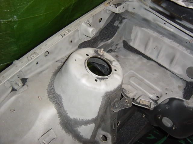

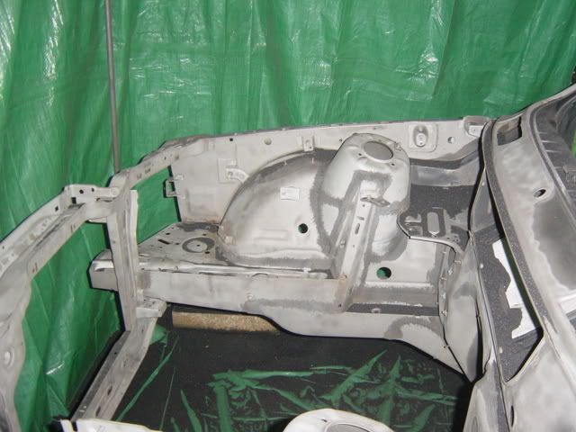

A few random naked E30 shots winkeye , will take some better ones of the body when I get further tomorrow night:
Worst evidence of rust I have found so far is behind the drivers side headlight where the flat metalwork meets the inner arch, the seam sealer has failed, only in a tiny spot but the water obviously gets into it and the rot spreads out without you knowing. Moral of story, check your body seams :?
More progress and pics tomorrow, whatever the weather.

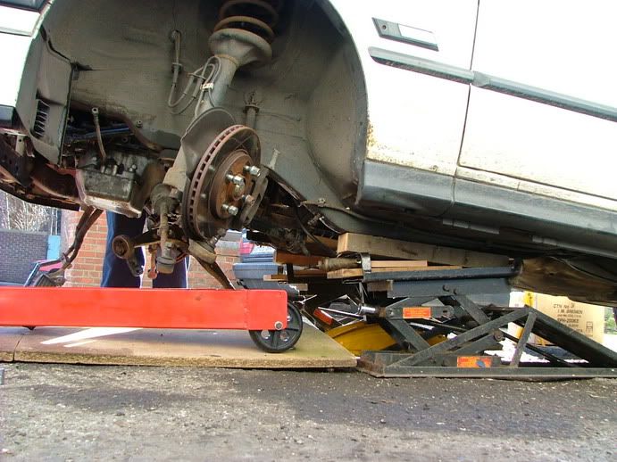

i have the perfect tool for this, a set of drive on ramps that have built in scissor lifts! they can raise about 24" gave me enough lift to slide the fully dressed M30 with gearbox, subframe, steering rack and wishbones in from underneath!!! :D also useful as jacks!
this is NOT at full lift :D

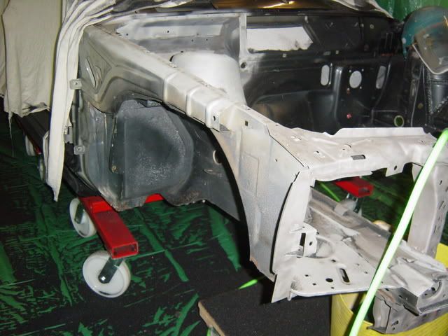

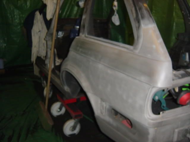

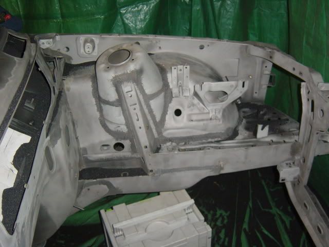

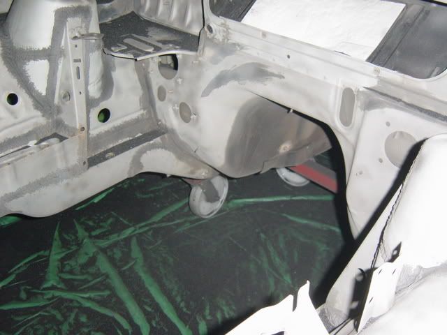

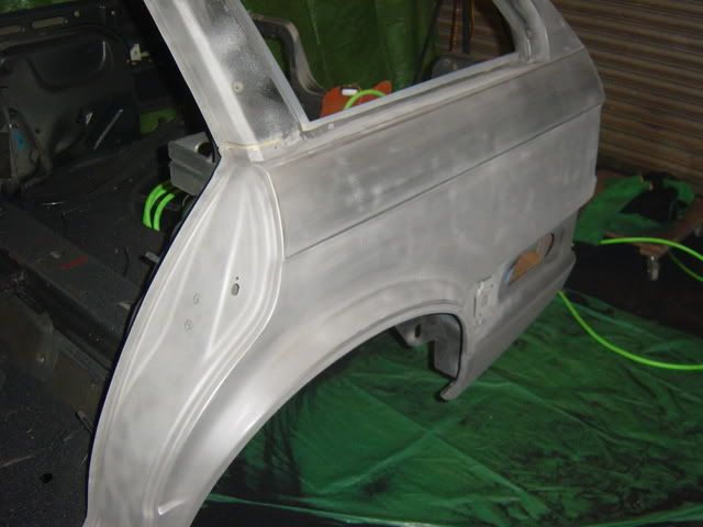

Finished the last of the sandblasting of the shell tonight. It is now fully bare metal. I took some pics last night when I finished but didn't get chance to post them.
Today I blasted the underside and cleaned up the small rust spots back to clean metal ready for brush on sealer and repainting. The floorpan/underside is now cleaner than new.
Another small change of plan, I have come to the conclusion that moving the shell to a bodyshop is going to be far too much aggro and finding a decent bodyshop is no laughing matter either, hence I'm going to paint it myself :eek:
I've spent enough time in bodyshops to know which way round the gun plugs in, don't panic!! I can sort some filtration and heat so shouldn't be a big issue.
Tomorrow and Friday I hope to get the shell degreased, etch primed and filler primed and then paint next week. All I need to do is decide what colour to paint it.
