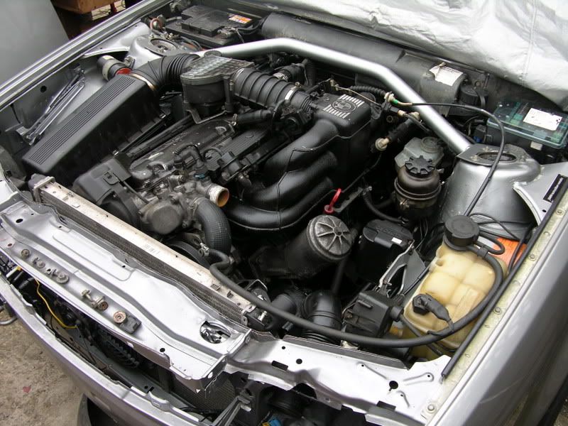

my manifold was hitting the steering linkage
I used the mk1 golf servo so I could move the engine over a bit to give me 1/2" clearance between the manifold and steering. This is where the e30.de mounts are not good because they where designed for left hand drive, Thats why I made my own.

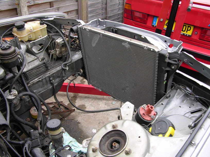

Another question (you lot must be fed up with me already) but what mounts are used to attach the E28 rad? The thing is massive compared to the early 325i rad 8O
It fits in the standard bottom mounts and then I fixed it at the top with the to mounts on the side of the rad.
See lots of room. there is more then it looks.

Is that a facelift car? If so I think that they have different rad mounts to the early cars. But either way I have the other bits from a later 325i breaker so can just use those and mount in the same ways as you have done in the picture.
No it was a pre face cab.

mine is a facelift and i jsut got some of those clip in captive nut thingies from halfords and screwed the rad down. job done! my E28 rad didn't fit the bottom mounts so it's held firm with two heavy duty tie wraps (must sort it one day) but it's as solid as it needs to be! my rad is an auto one though so could be a bit different...
