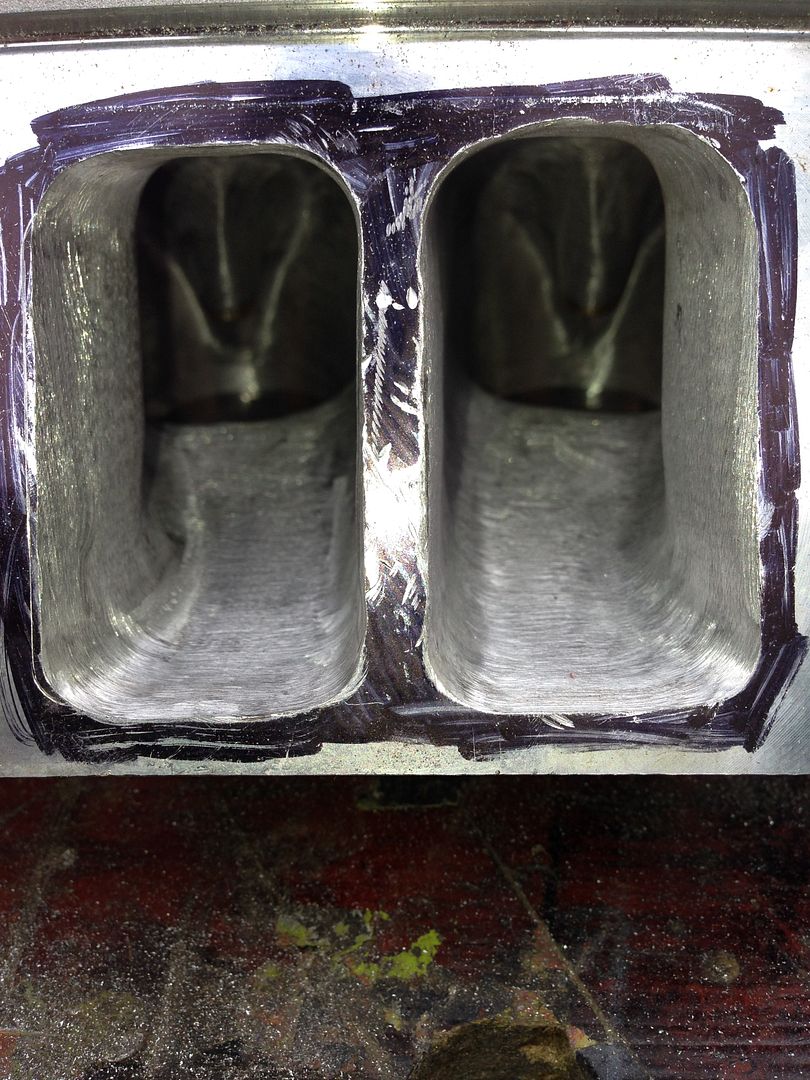

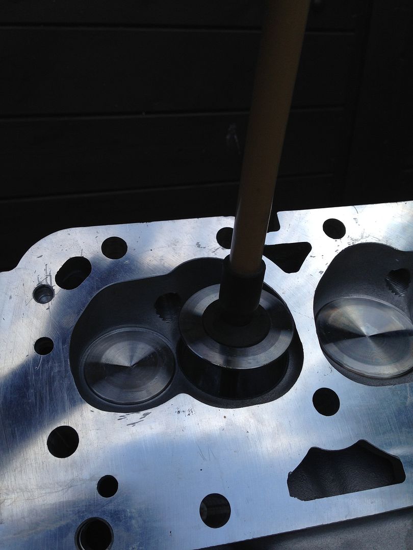

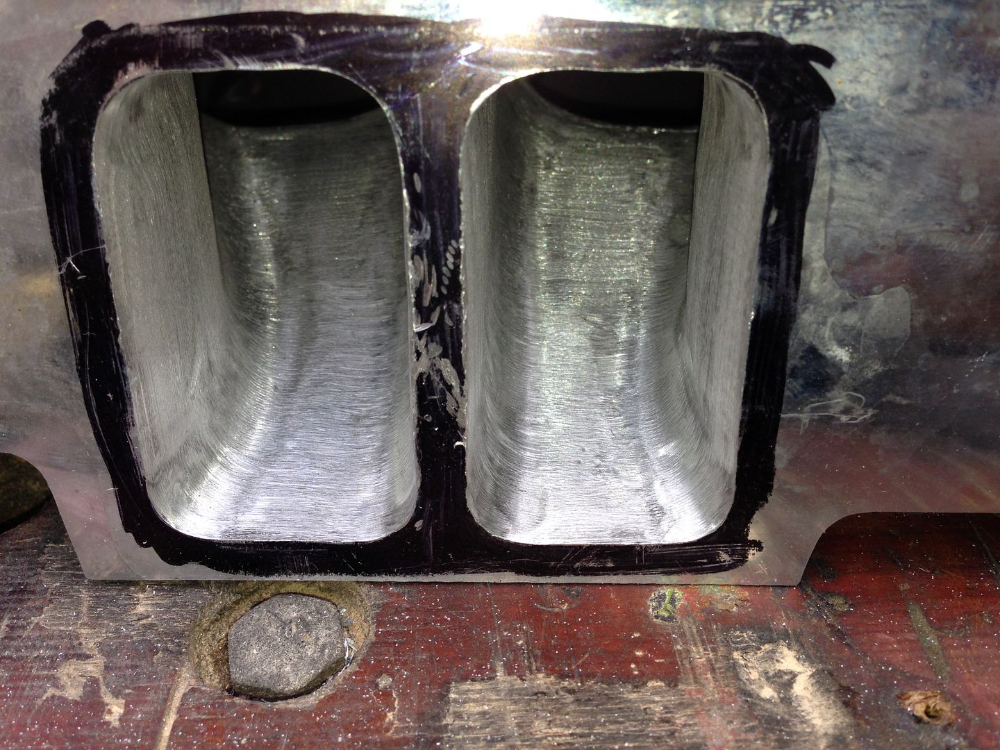

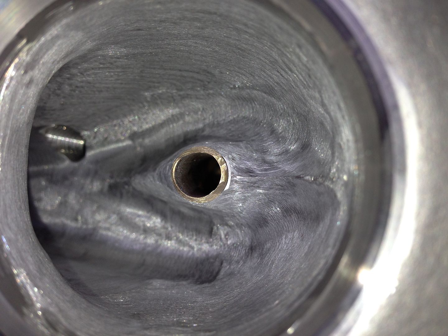

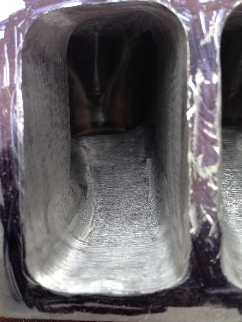

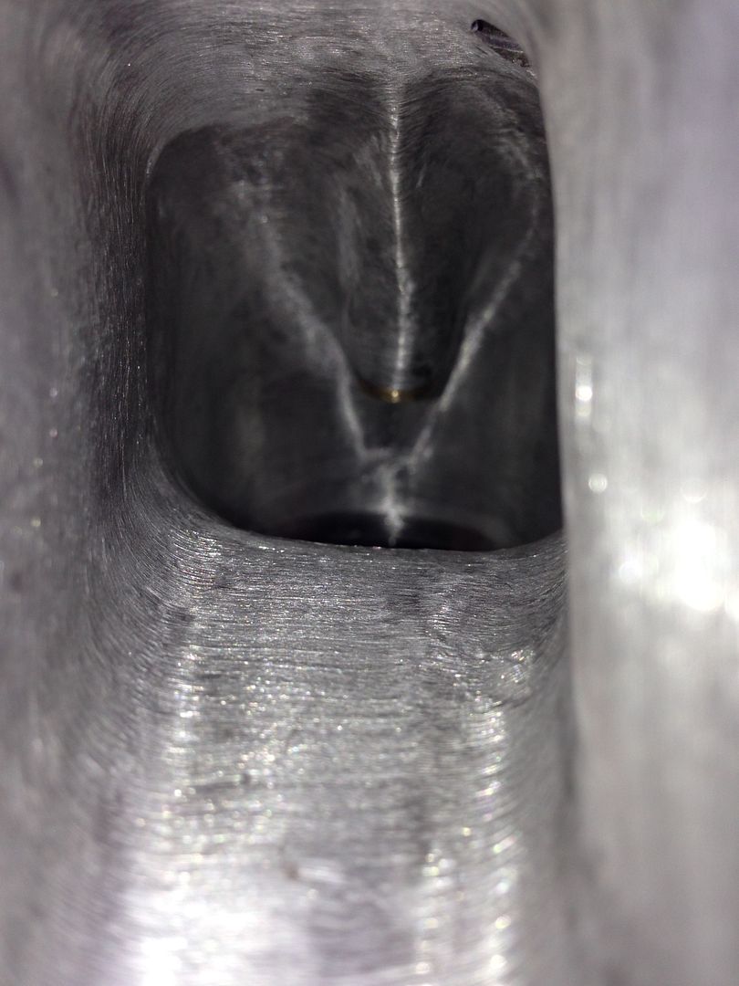

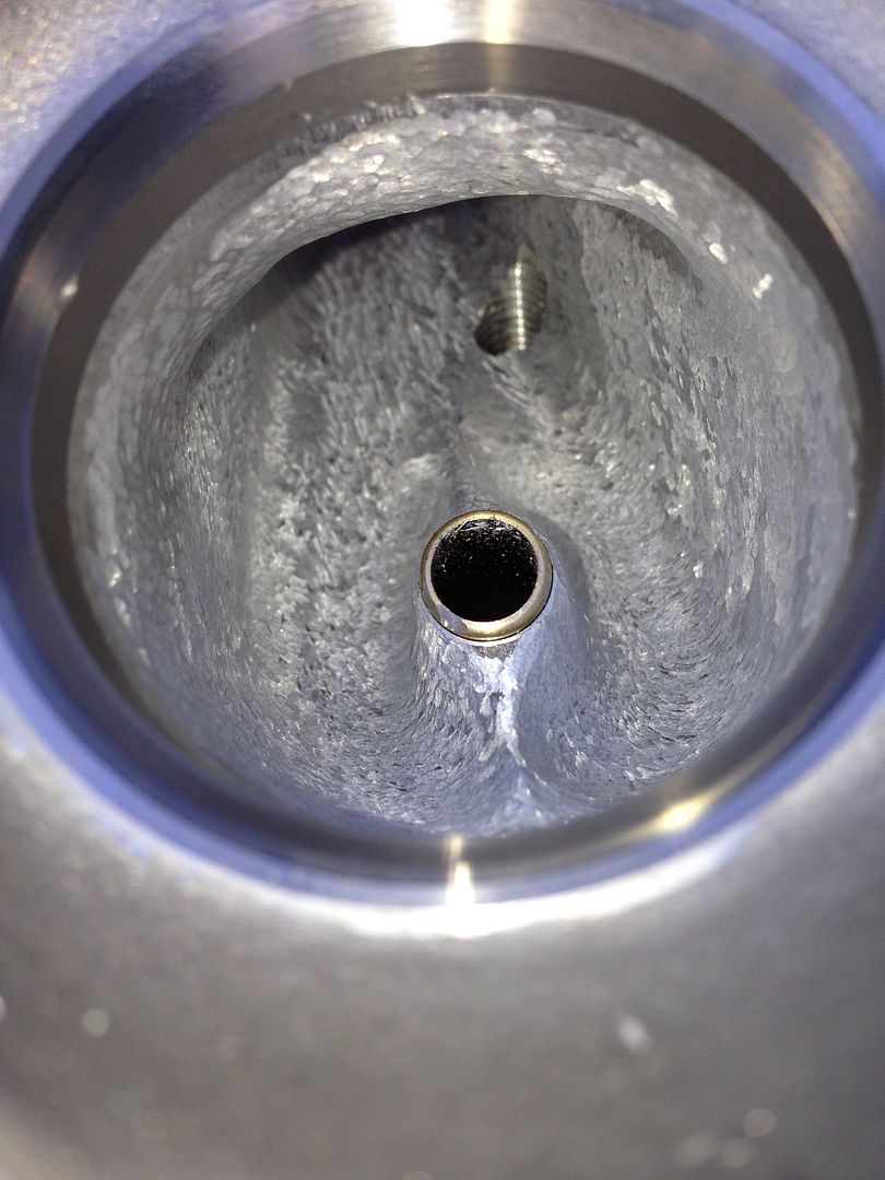

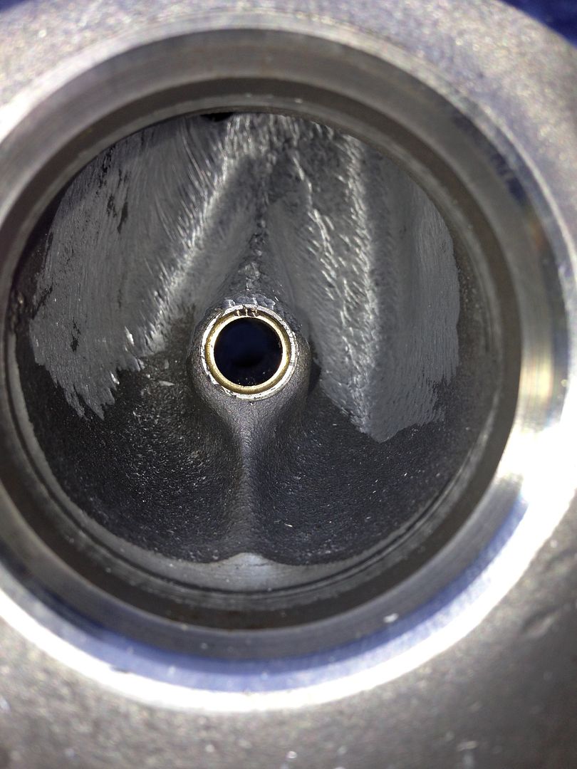

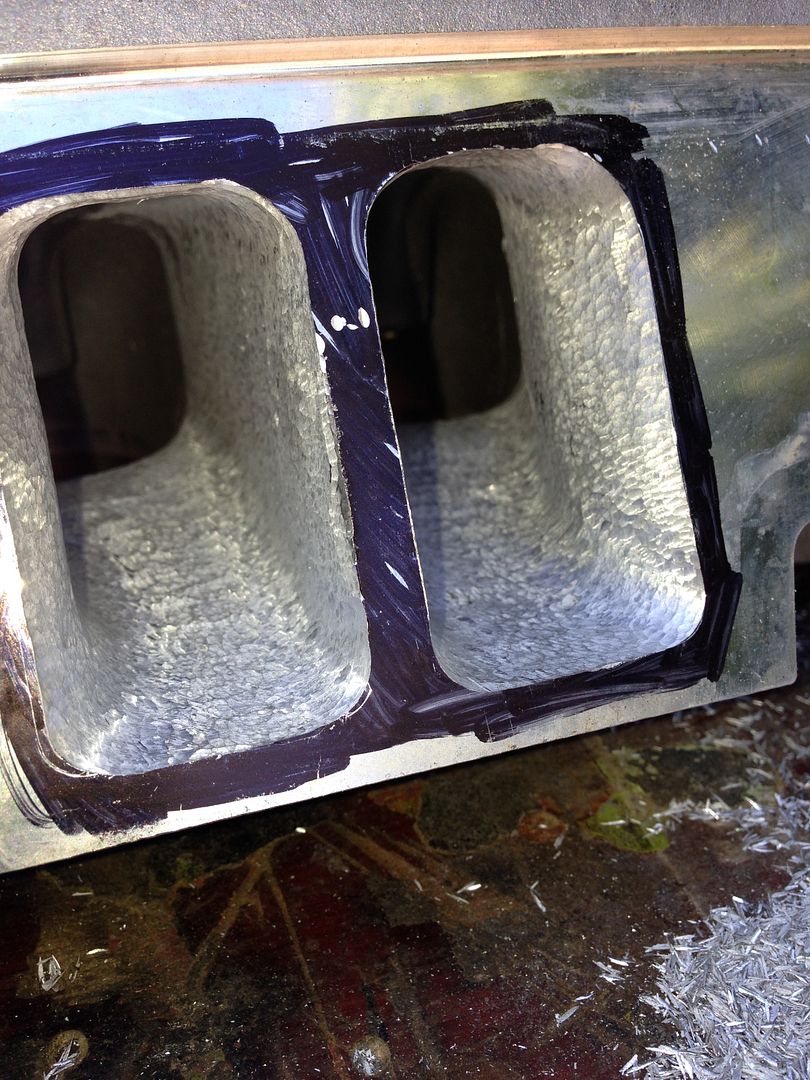

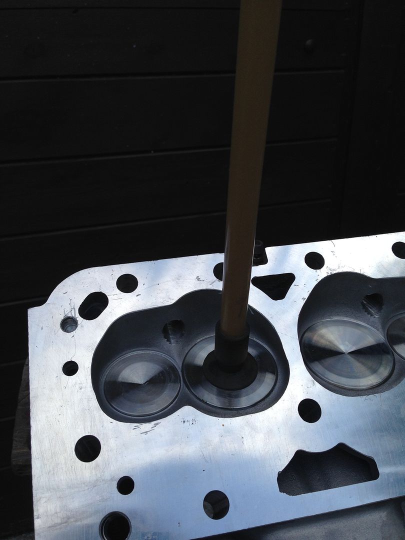

today i done alot of head work took me hours
roughting it out
then getting it all sort of smooth but still rough enough for fuel atomisation
then finished off lapping the valves in, valve springs will be here this week hopefully so i will have one complete head
just one more to go
Turbo M20
v8 project 6.0 twin turbo
Posts: 14030
Sun Jun 22, 2014 10:11 pm
Nice work. 8) Quite surprising that brand new alloy heads should need such work though. :?
ross_jsy
Posts: 7307
Location: Jersey, C.I.
Sun Jun 22, 2014 10:17 pm
Not really, there is always performance to be had from a head.
Can't get over how big your valves are!
ross2009
Posts: 2762
Mon Jun 23, 2014 6:21 am
Speedtouch wrote:Nice work. 8) Quite surprising that brand new alloy heads should need such work though. :?
well tbh I could have put them straight on but the casting Was pretty rough in some places so I thought I might as well work them
with these big v8s the more air you get in the more power you get out, yeah it's abit of work but I think it's worth the effort
and ross I know what your saying my exhaust valves are bigger than most peoples inlet valves lol
the inlets in these are 2.02" and there the small ones you can get you can put 2.30" in these :)

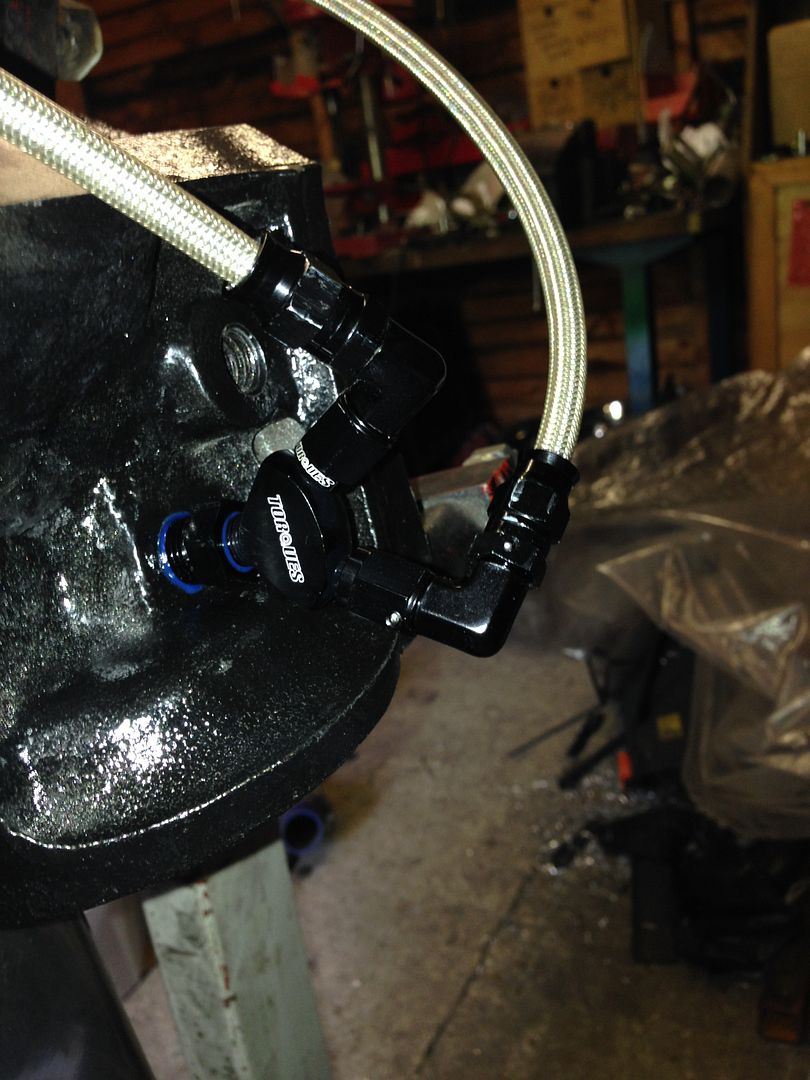

all my oil feed to the turbo parts turned up today and already fitted :)

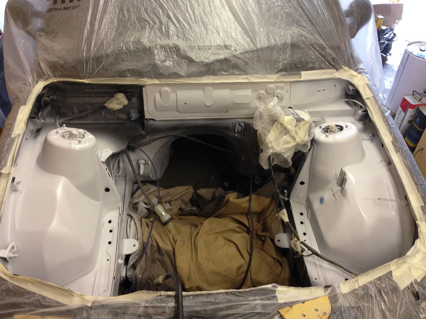

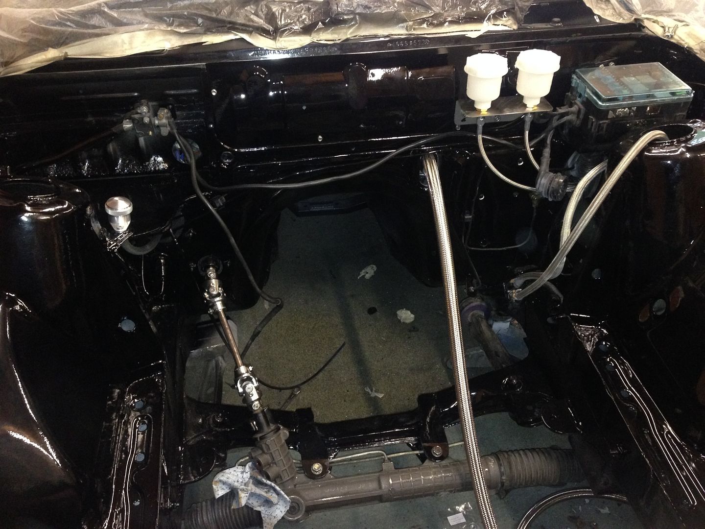

Wed Jul 02, 2014 10:15 pm

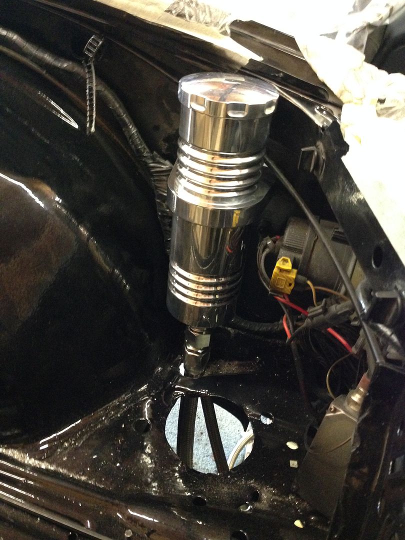

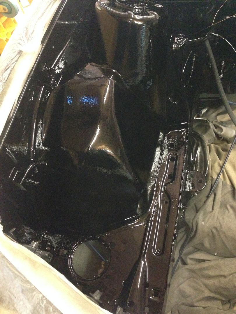

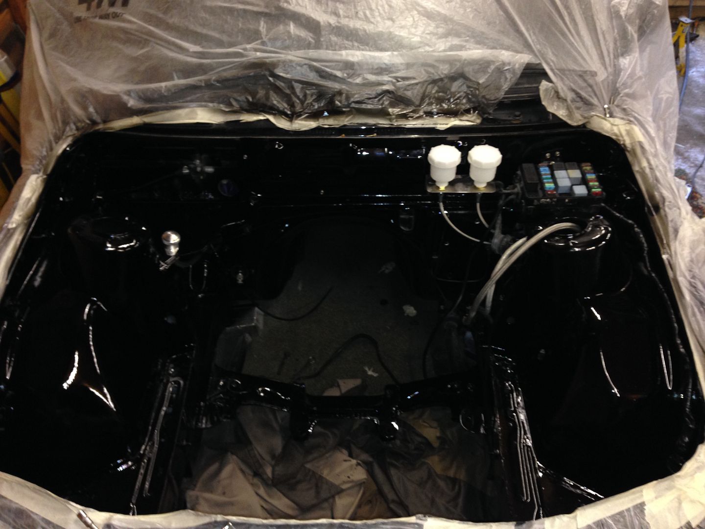

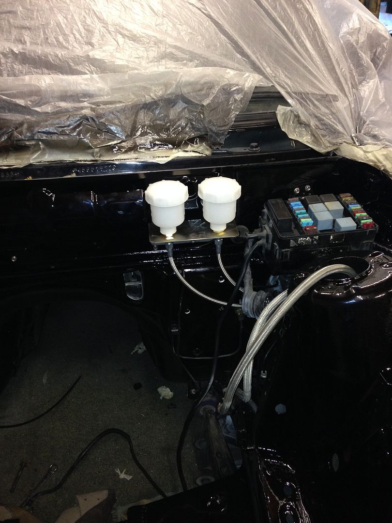

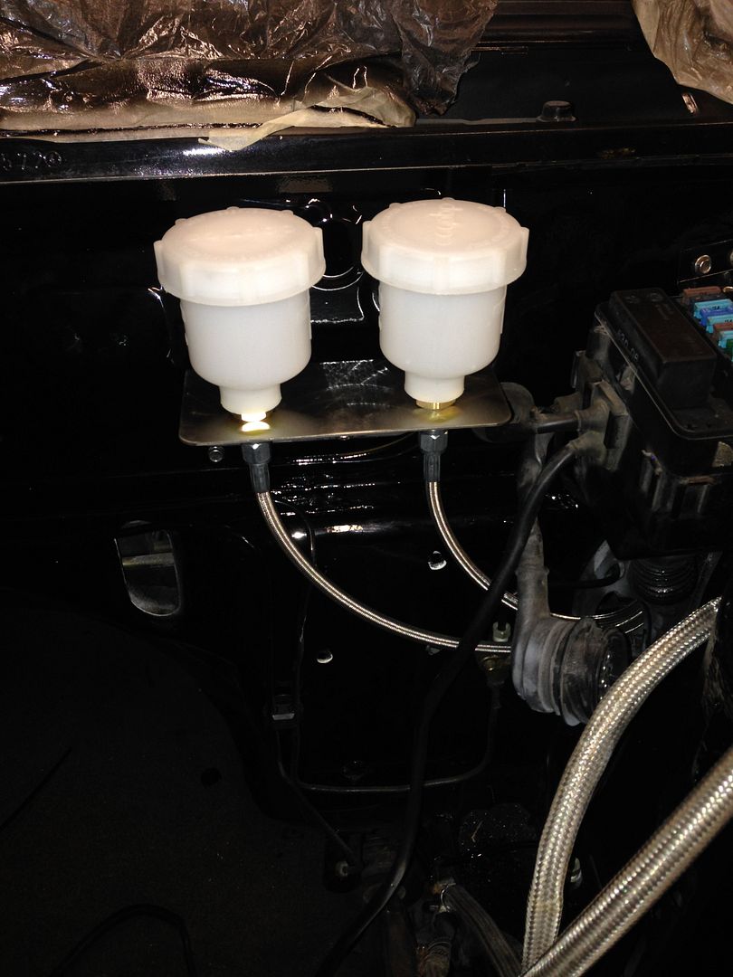

just a few pics of what I've done over the last week or so
Turbo M20
Posts: 14030
Wed Jul 02, 2014 10:22 pm

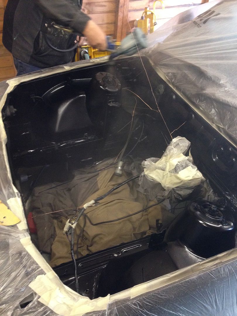

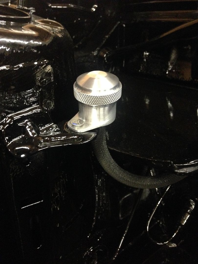

Looking good. What did you spray the engine bay with? Like the alloy clutch reservoir. 8)
ross2009
Posts: 2762
Wed Jul 02, 2014 10:24 pm
Speedtouch wrote:Looking good. What did you spray the engine bay with? Like the alloy clutch reservoir. 8)
just base coat and clear mate done it last weekend
reservoir looks good don't it it's actually from a Harley Davison lol
Turbo M20
Posts: 14030
Wed Jul 02, 2014 10:26 pm
Yes, a nice touch.

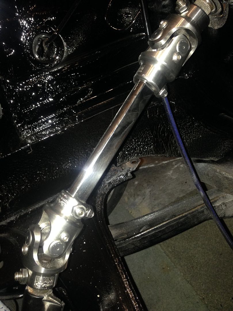

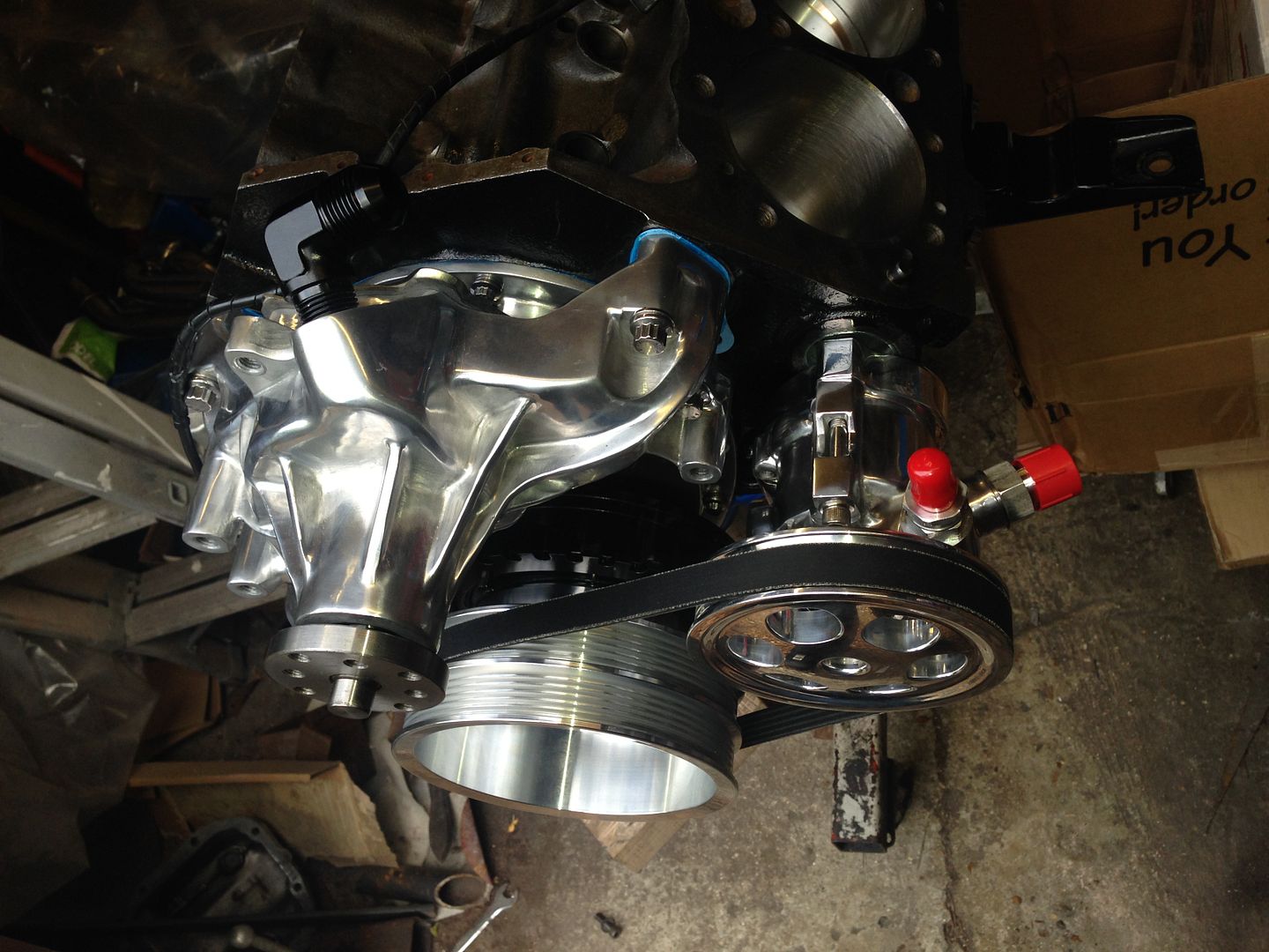

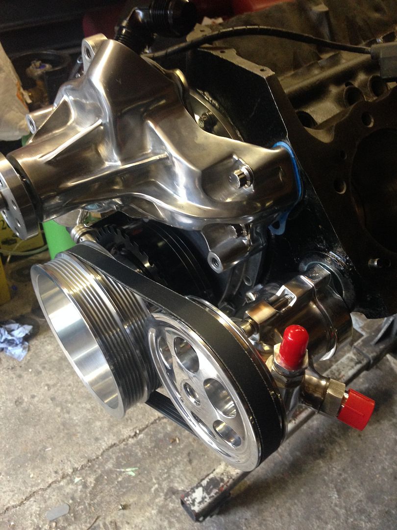

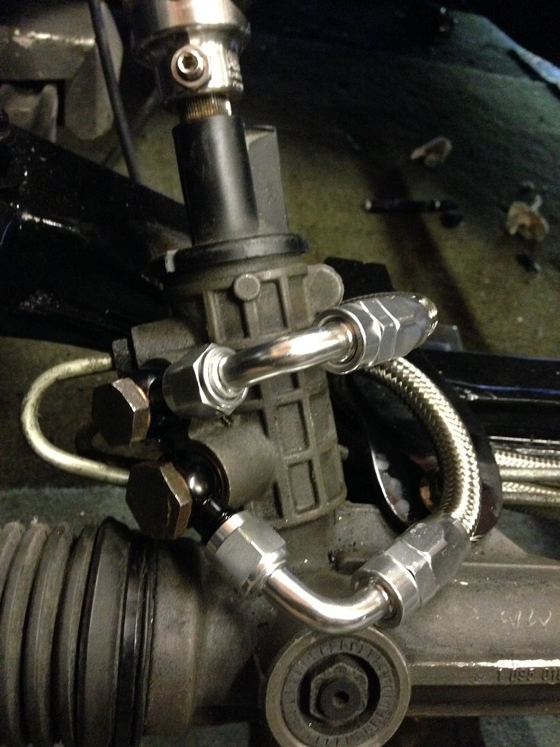

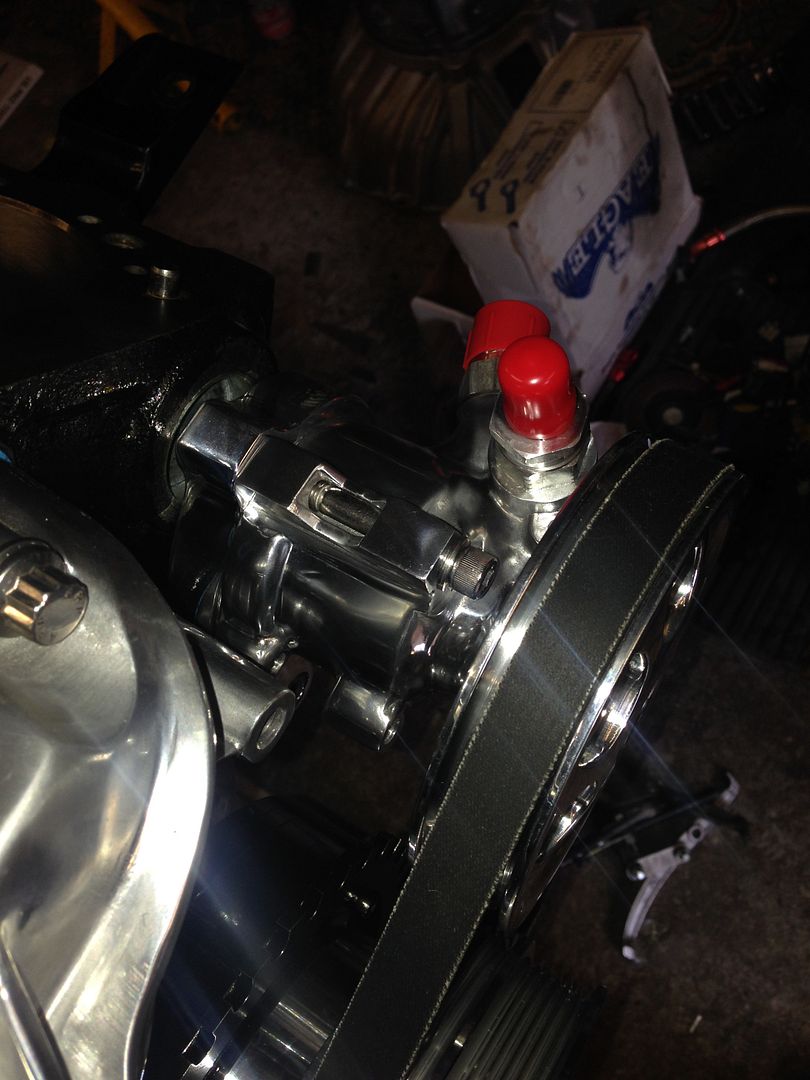

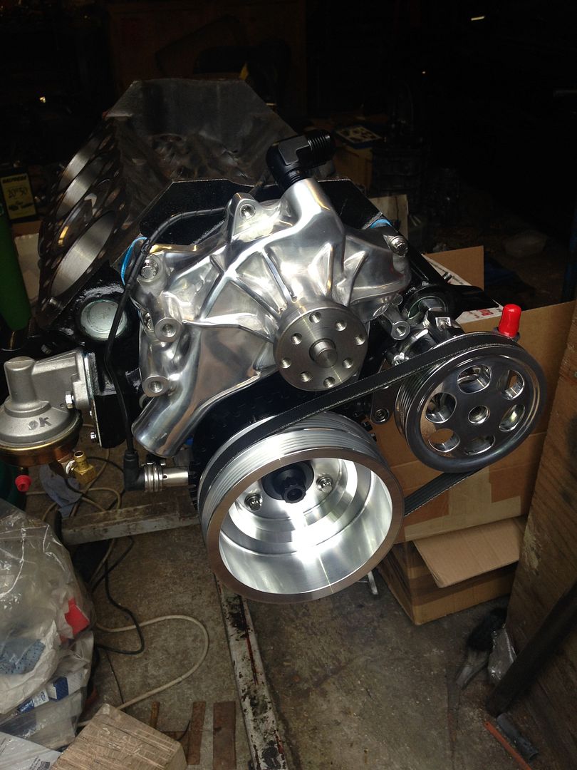

Mon Jul 07, 2014 2:54 pm
power steering bits going in

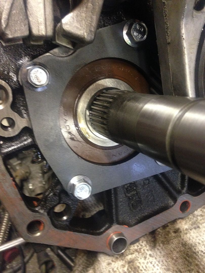

Sat Jul 12, 2014 9:17 pm

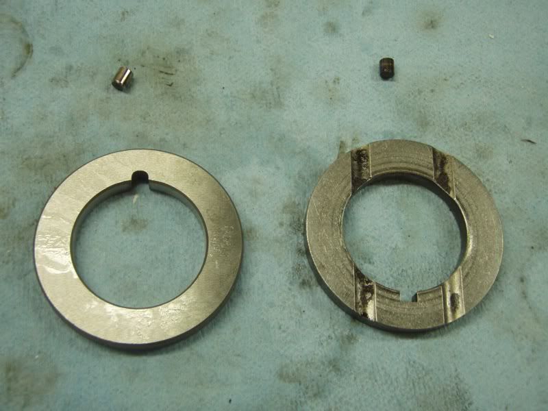

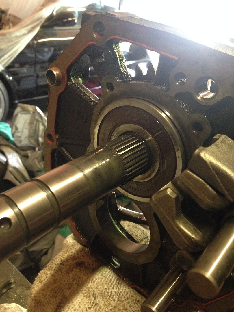

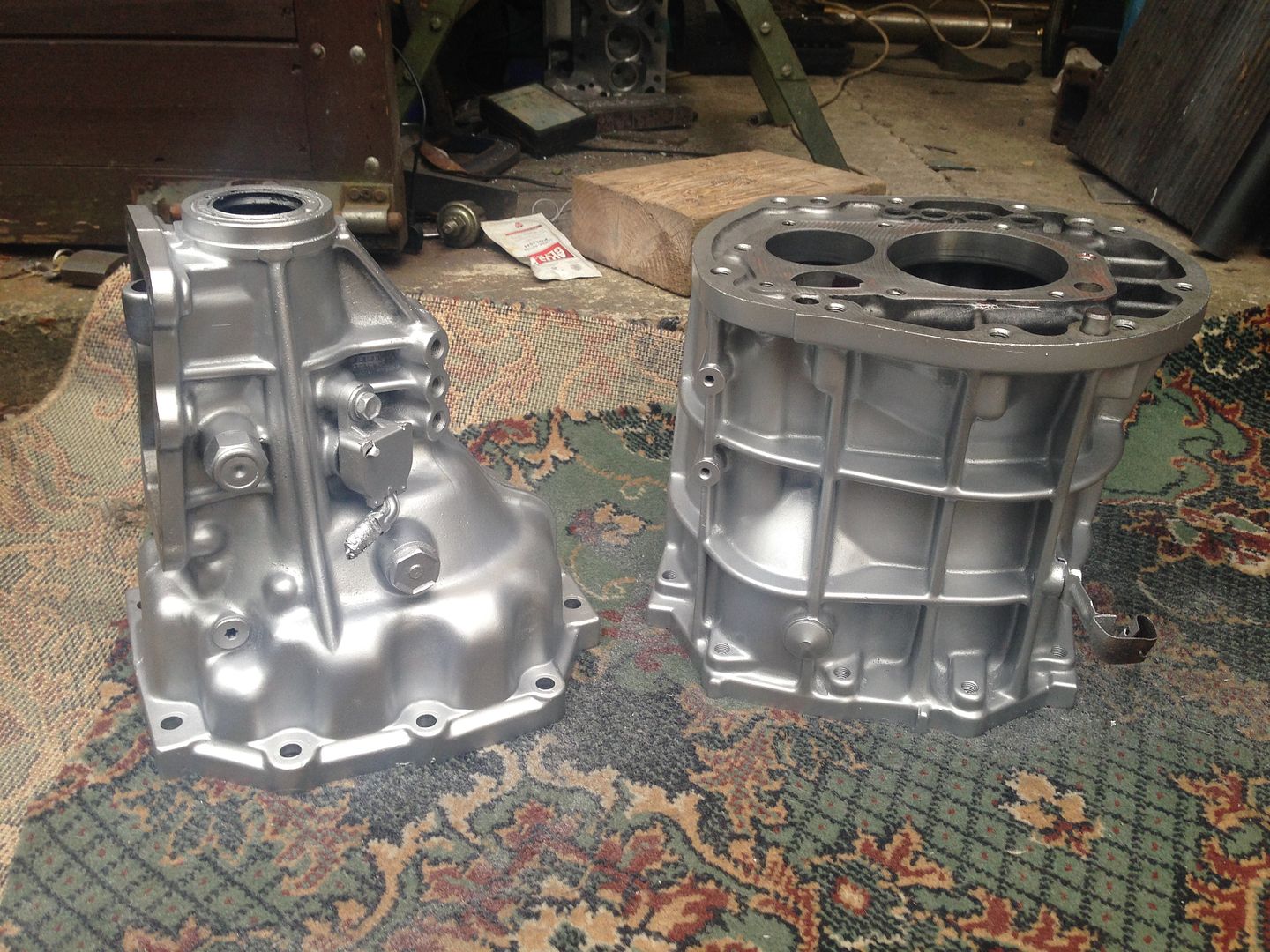

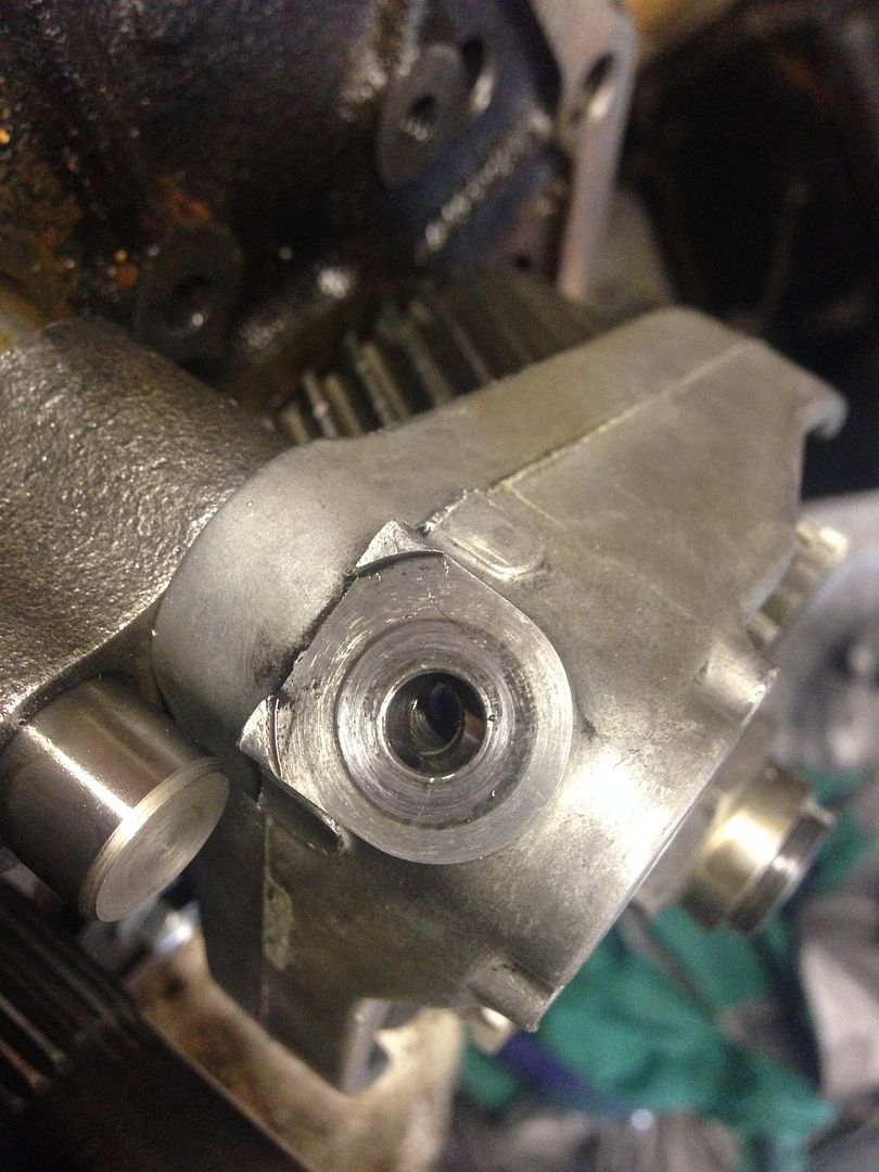

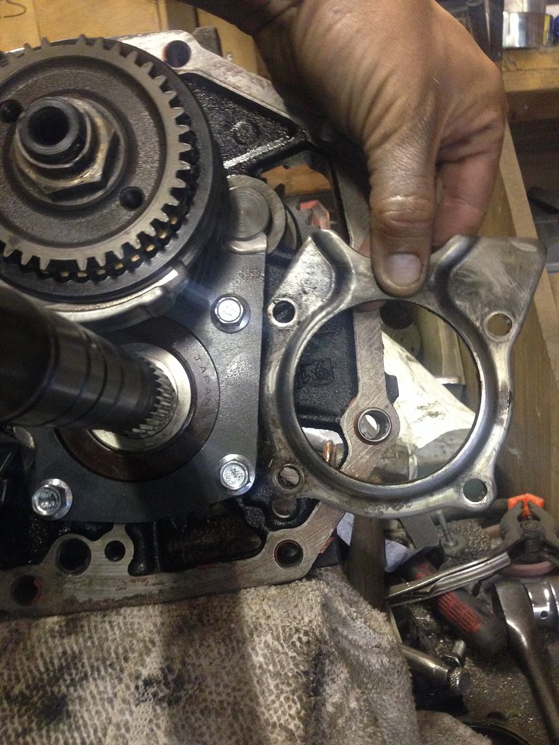

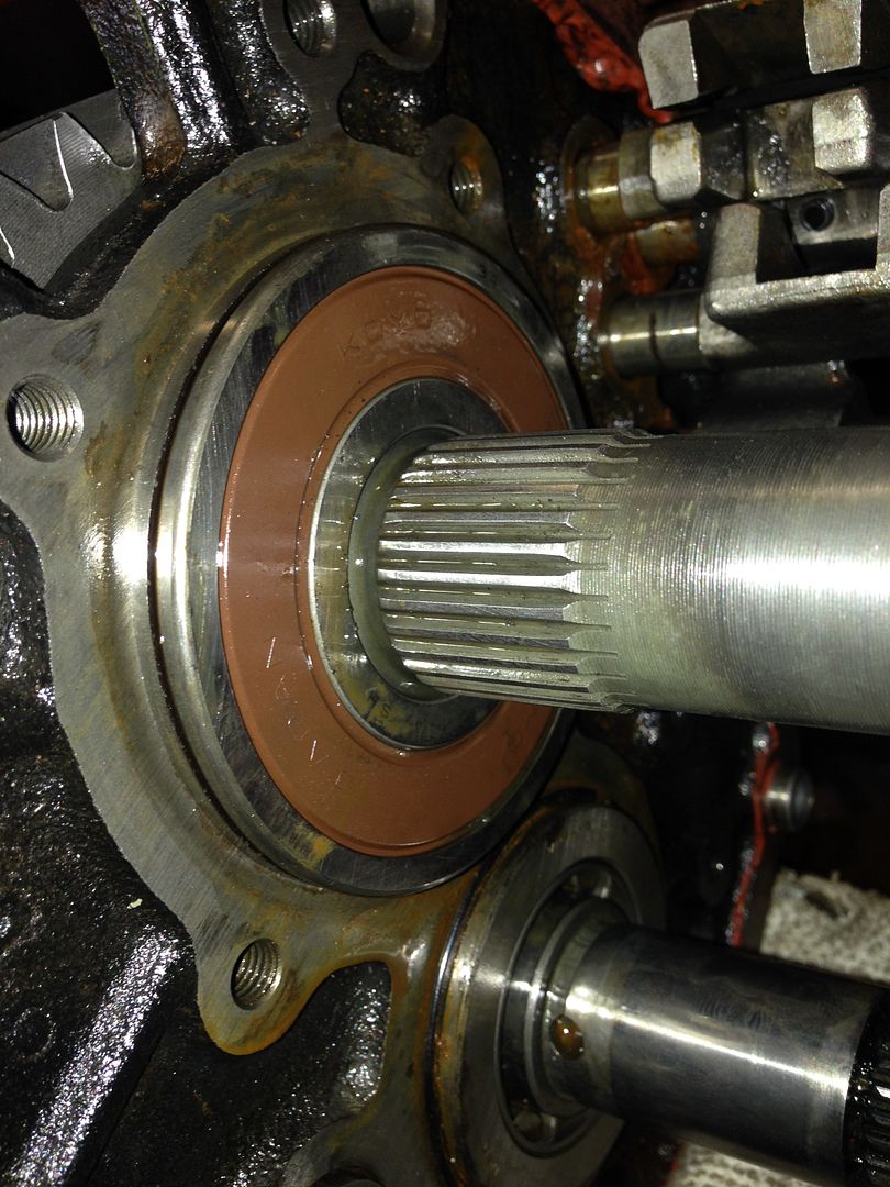

well not done much but have been messing about with the gearbox adding the uprated parts to
it, the bits I've done have seen this gearbox take upwards of 5-600 bhp I have seen in the states this box taking over 800bhp :eek:
the uprated parts I've put in are a chrome moly first gear thrust washer which takes most of the load from the whole gearbox
and billet steel rear bearing retaining cover the original is just pressed which flexes under power which In turn ruins the bearing and the original thrust washer
so here's just a few pics if what I've done
not everything tho
front and rear casing off
started taking 5th gear and synchros of to get the thrust washer
this is the old and new thrust washer (new one is on the left)
and with it fitted
this is what can happen to the original ones
I replaced the rear main output shaft bearing as it had to be destroyed to reach the 1st gear thrust washer
new and old retainers
and then the new bearing retainer on top
and with it all bk together

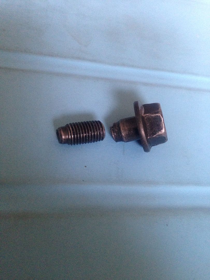

this happened
just great so now I've gotta wait for some more bolts to turn up

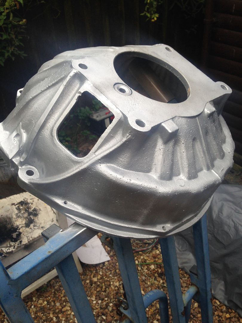

soooooooo in the mean time I done some painting
that's about it for now till I get these bolts
when I do and it's bk together it's finally going all in the car for the last time I hope :)
Turbo M20
Posts: 14030
Sat Jul 12, 2014 11:13 pm
Good work - certainly looks like a pretty beefy gearbox...
ross2009
Posts: 2762
Sat Jul 12, 2014 11:18 pm
Speedtouch wrote:Good work - certainly looks like a pretty beefy gearbox...
thanks mate
yeah it certainly is with out spending thousands on a yank gbox it's prob one of the best and strongest for the price

so much shiny!! look good though, contrasts well with the black

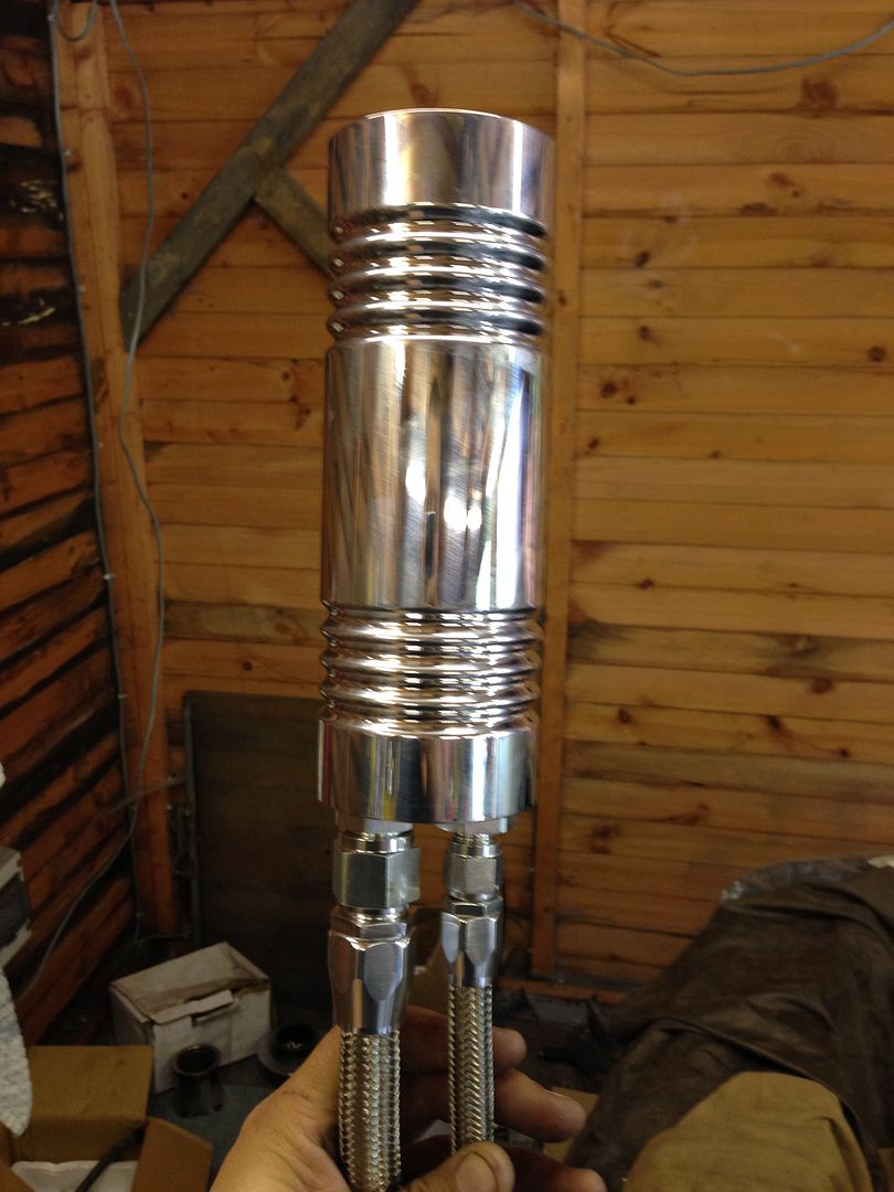

saw you made your own steering rack hoses did you use the torques fittings for the rack banjos ? if so what size are they and is the quality good (torques in general )
ross2009
Posts: 2762
Mon Jul 14, 2014 5:40 pm
yeah there is gonna be a little more black in there too
erm yeah I've bought quite abit of them now they look good to me
banjos are 14mm inside dia and 16 mm inside dia both 6an quite expensive tho
Turbo M20
jimmyspeed
Posts: 848
Joined: Sat Sep 08, 2007 11:00 pm
Location: riding a wagon wheel west
Mon Jul 14, 2014 6:23 pm
thanks , might give them a try
ross2009
Posts: 2762
Mon Jul 14, 2014 6:29 pm
the only reason I've gone that was is that the American p/s pump and the reservoir I've got are both an's so I just followed what they were

on the oil fees lines to the turbos ??
Turbo M20
jimmyspeed
Posts: 848
Mon Jul 14, 2014 7:03 pm
yeah the turbo ones
ross2009
Posts: 2762
Mon Jul 14, 2014 7:06 pm
o right yeah your right it's just loctite mate
