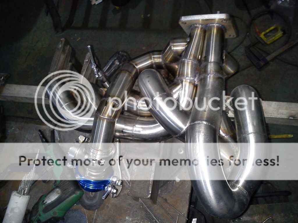

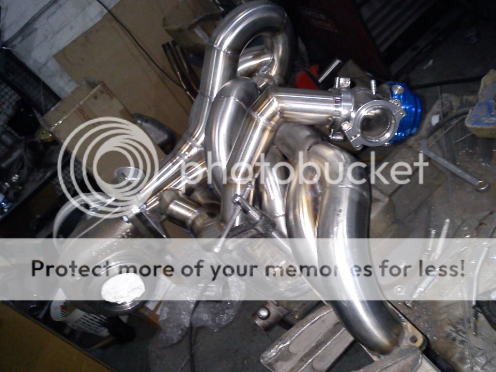

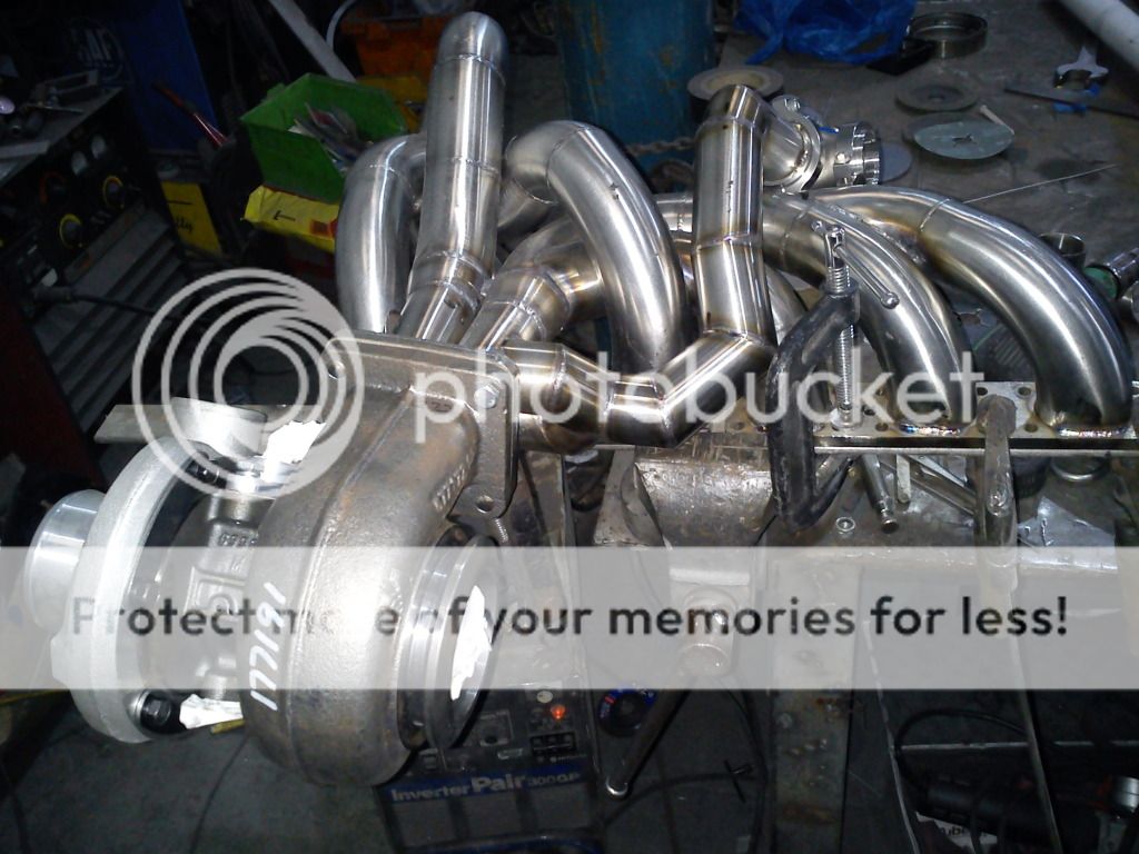

I know your saying Tial's are expensive, but....
when you factor in the 2 wastegates you buy, then change the diaphragm in say 10-15 miles,
then they start sticking,
by the 4th time you've taken them off you'll be thinking..
hmmm I wish i bought a Tial
I gather that you turbo is a "twin scroll"
that doesnt mean you have to have 2 wastegates,
you can simply run a branch off pipe from each bank of the 3 pipes,
then join them down the line into 1 wastegate.
Like so...

good evening sir. yes it is twin scroll. I was thinking of what you are suggesting before but decided against it as I wasn't sure if whether I would loose the pulse where the banks come together in the wastegate. Is twin scroll/single wastegate a common setup.
