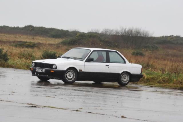

Thought I'd slam this on here.. mainly because I'm bored and enjoy winding up purists :D
Bought one E30 316 that's about bollocksed...

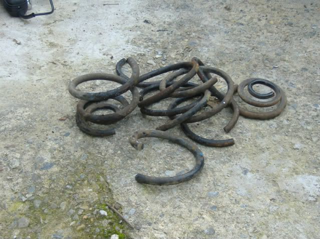

Removed this....
To get this.....

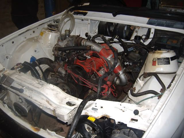

Then took one of these....
And removed this bit.....
And jammed it in here (mucho gracias to Rob for the mechanical fiting and Clive for the electrickery, I'd have been knackered without you).
Took it out for a spin and scared myself shitless (because unknown to me, Rob had wound the bleed valve out by something like 5 turns) and declared myself in love.
Hauled ass to TDW 3 and pimped around like a real cool dude making "Bwaaaaaaaaaaaaaaaaaaaap... Tish!" noises.

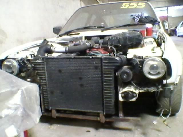

Then I wanted a 'cooler, so....
FMIC is on!
(not quite finished in the pic, but you get the idea).
Time for uber booooosts!
Although it looks bad with the front off, we've been at the car again.
Bad pics, from phone.
Ooooh, she is sexy.
HARDCORE with the front back on. Leaving the bumper off methinks ;)

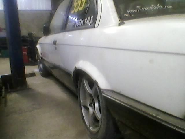

Wheelz bought cheepz from Trig. I likes a lot.
Oh, I so do love this car long time.
Went up to the farm to get the ol' shitter running again after chomping the front out for the FMIC.

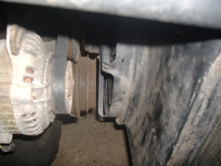

Got the fan all fitted up. We haz clearances!

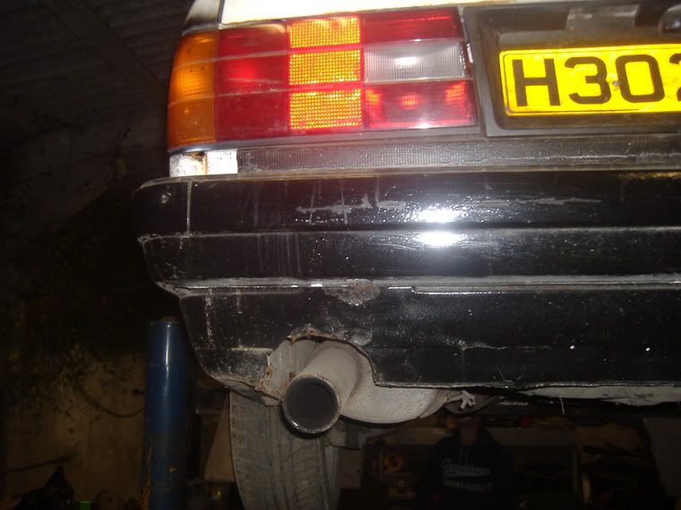

My biggest complaint about the car has always been he exhaust note. When I got it, it was fitted with a Scorpion backbox. Wehn we fitted the engine, we removed all but the very quiet Scorpion...
Obviously not good enough... so... GTFO!

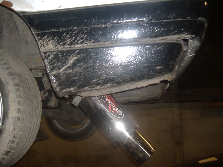

Check out ma SAVAGE exhaust y0! Got it for cheap y0! TAIIIGHT!
ZzzzzZZzzzzap! (thanks Clive).
I haz tha JDM goodnesses. Sounds the bollocks too. YouTube of tha noises y0!

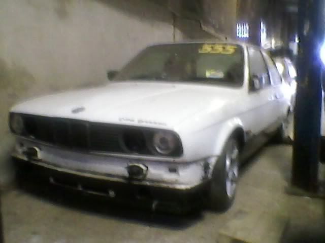

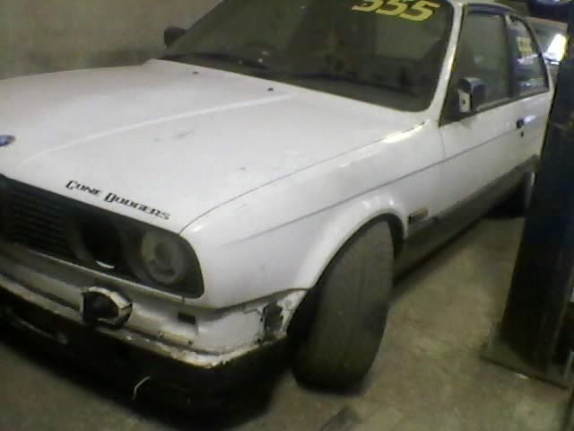

After the Horatio debate I thought I'd trial fit it. Waddya reckon? I'm undecided.
Decided on without in the end :D

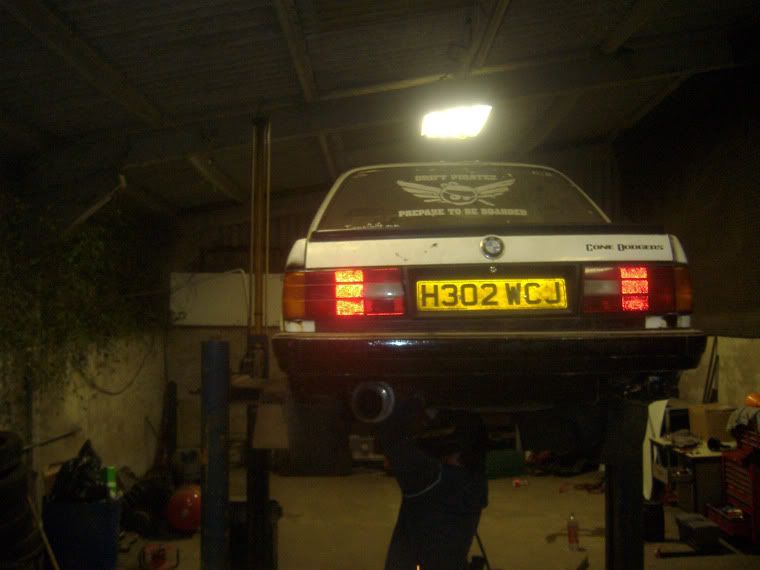

And here's how it stands... getting ready for TDW5.
Let the shitstorm begin!

Scuze my ignorance, but what was the donor car, I don't recognise it? What engine, turbo etc. Any specs you'd like to share?

GeoffBob wrote:Scuze my ignorance, but what was the donor car, I don't recognise it?
Just guessing here, but I think it may be an Isuzu Piazza Turbo

isn't it an S13?????? god all these buddy jap cars look the same!

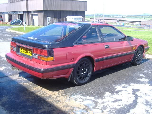

gareth
Posts: 11009
Sun Oct 18, 2009 12:00 pm
S12 nissan silvia :D
here's a 'similar' car with a rather different approach to the build / finish :D
it does look like a hoot though :)

Sun Oct 18, 2009 12:19 pm
Gareth gets extra nerd points.
It is indeed a nissan Silvia S12.
Engine is a CA18ET 1.8 Turrrrbo with a T2.
Running without an airbox for extra aeroplane noises, a bleed valve for extra powerz, a dump valve for extra tishyness, a dirty great intercooler off of a Volvo 740 Turbo for more intake cooling and a Savage chavomatic exhaust for extra Brapppyness.
Now on the lookout for free or cheap spare parts to make more powerz. Anyone got a T25 from an S13 or a T28 from an S14?
Got dibs on a set of SR20 injectors to glue on (might have to take the fuel rail too mind...) and if I find an Apexi SF thing for extra mappyness in a skip somewhere I'll have a crack with that too.
All totaly unrelated turbo fed car parts that can make this go faster for very, very little money gratefully recieved.
Apart from the seats... car still owes me under £200.... :D
