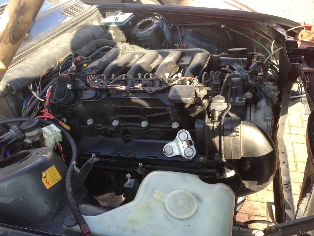

jasso
Posts: 531
Joined: Tue Mar 28, 2006 11:00 pm
Fri Mar 28, 2014 8:04 am
M57 in mines starts up fine
dirtee-herbert
Posts: 327
Joined: Sat Apr 23, 2011 11:00 pm
Location: Keighley, West Yorkshire.
Fri Mar 28, 2014 8:08 am
jasso wrote:M57 in mines starts up fine
:cool: any pictures or a build thread?
