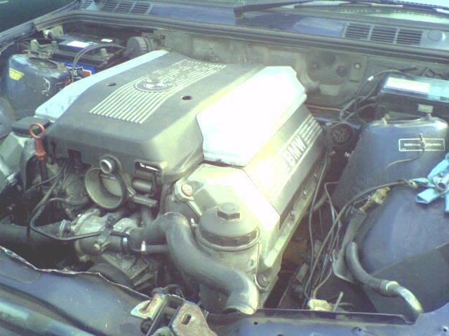

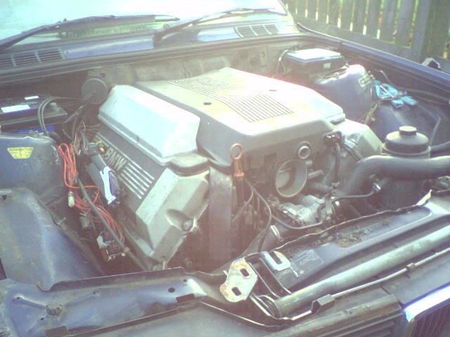

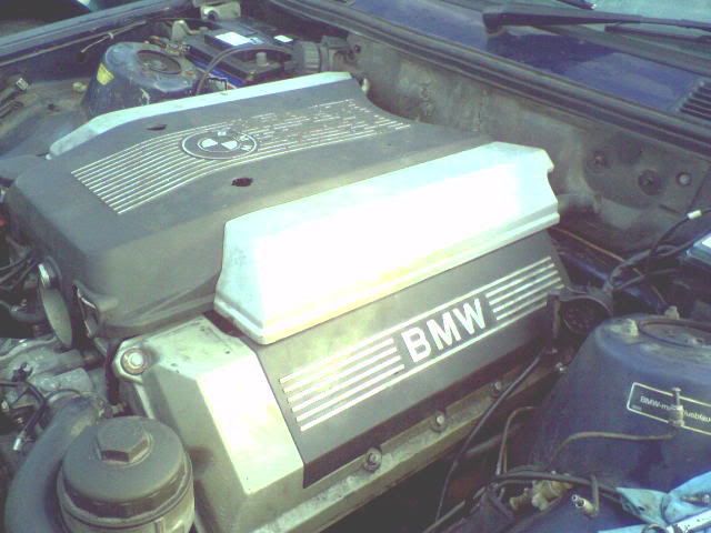

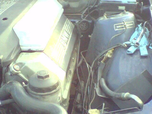

bigdek
Posts: 1115
Joined: Thu Feb 10, 2005 11:00 pm
Location: Fife Scotland
Sat Nov 25, 2006 1:01 pm
you can use v8 alpina mounts although they cost a fair few dollars.
i will have my own mounts finished today .
5speeed manual from an e34 3.0 v8 used with 325 crossmemer and gear linkage bolts into place without issue.
unmodded m3 prop can be used or a custom jobbie
engine is very wide so the servo will need relocating.
Not even room for a hydraulic set up.
Exhausts manifolds are a big issue but i reckon i can mod the originals without too much trouble.
this is mine so far
