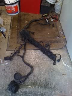

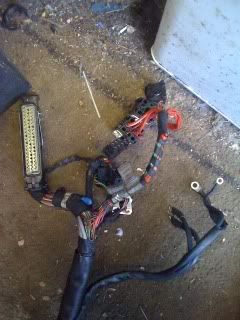

Hi all
i have a question about the loom i have...
iv taken a picture on what i have taken from a E34. do i need anything else taken from the E34?
can the round plug connect to the E30
Imageexisting socket?
6pot wilwoods front
4pot Porsche rear
89 E30 stripped running a 6speed V8
Twin Turbo M60 in progress
Tue Nov 10, 2009 11:04 pm
Yes it can but you have to swap 3 wires round for the heater fan and the eco guage to work.
Its all in the engine thread

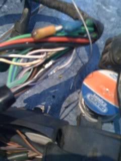

i have sorted the loom and installed that. i only saw 2 wires that had to be swaped on that thread rav?
Black with purple stripe and white with black stripe...... god i hope they are the right ones

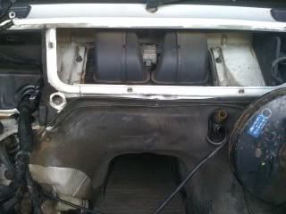

also a little question.
how far back roughly should i beat back the firewall for engine pos 3? and where abouts should i beat it?
and a little teaser on whats to come... 6 Pot porsche calipers front and 4 Pot Rear calipers.... challange or what.
6pot wilwoods front
4pot Porsche rear
Sun Nov 15, 2009 5:36 pm
You wont really have to, some of the guys haven't done this for Pos 3, all they've done is take off the Soundproofing from that area, and from the transmisiion area too.I beat mine, but didn't really need to.
But also some have beacause they have had too.
Only sure way is to put the engine in and see.

I bashed mine where the head sits but as Rav said its not really necessary just a precaution and its easier to do with the engine out
Ive coloured in where it needs knocking back

Oh right i see. So really I should just take the soundproofing off for now and see how it sits?
I still have to get some M20 engine mount bushes and a steering rack and the lump will be heading straight on in there.
Then charger bolted on then off for a remap. Yay it's getting there.

looks good, i would just remove the sound deadening first, you can always bash it later if needed.
