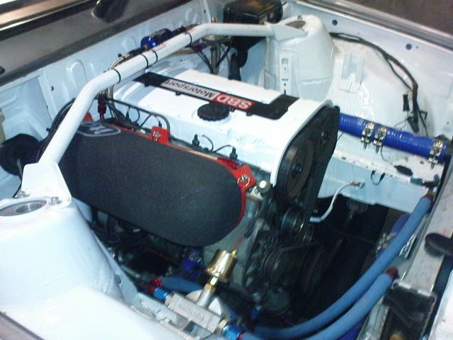

I have done it, its fairly straight forward, i used sbd engine to chassis mounts that are meant for escorts.
I also hillclimbed it but to be honest i was dissapointed. the engine will have to be reasonably well tuned, i had a standard motor with sbd tapered itb's and it was not really powerfull enough. (slower than when i had the m20b25) But after a rr session it turned out i was only pushing out 150bhp 8O because the engine was down on compression. after looking into the prices of 200+bhp engines and a tran-x box to suite i decided to just part it off and buy an m3
I still have a few parts left over if you are thinking of going ahead.
This is how she looked....

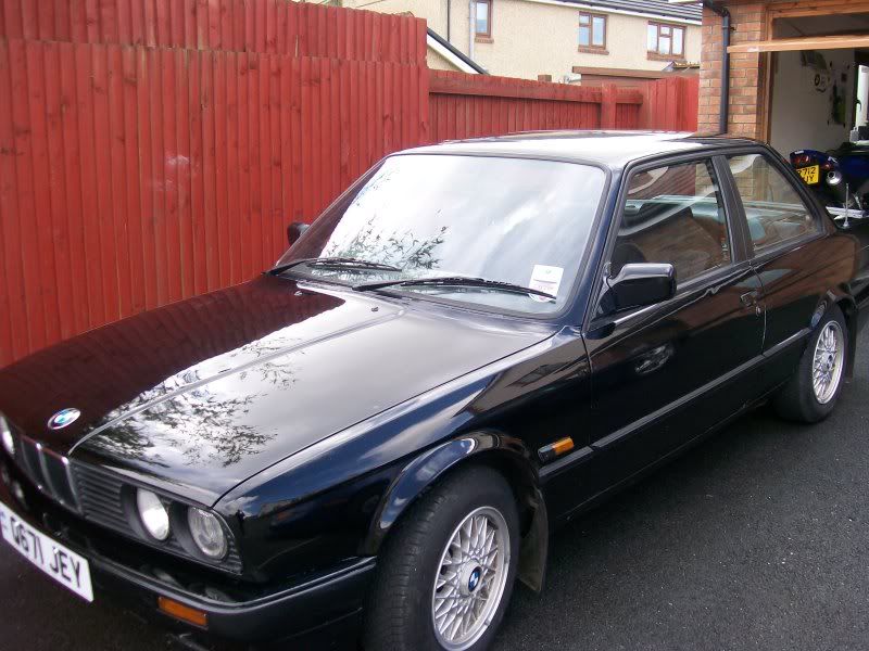

£500 quid eBay impluse buy - 318is

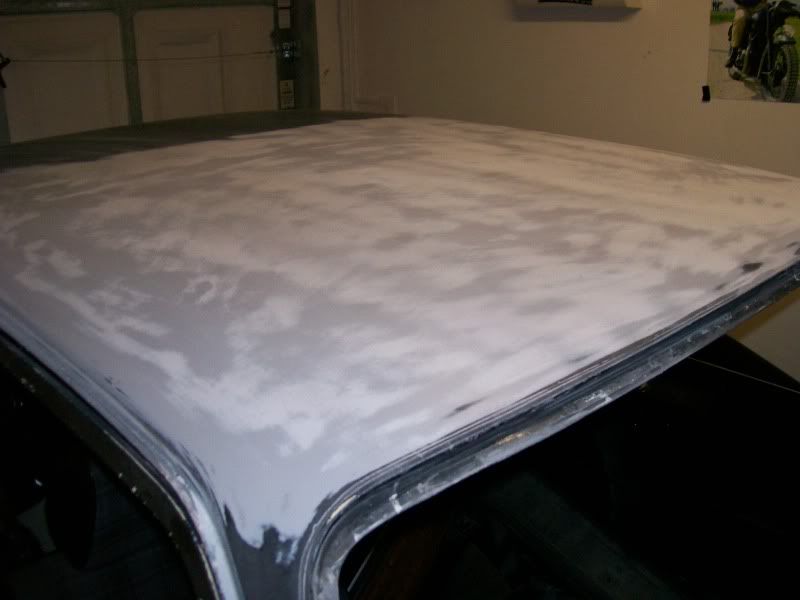

Sunroof removed and sheet of mild steel cut, formed and welded in to to fill the gap - skimmed with filler and primed

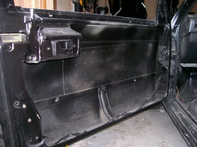

Door skins cut out and door catches relocated to upper rear quarter

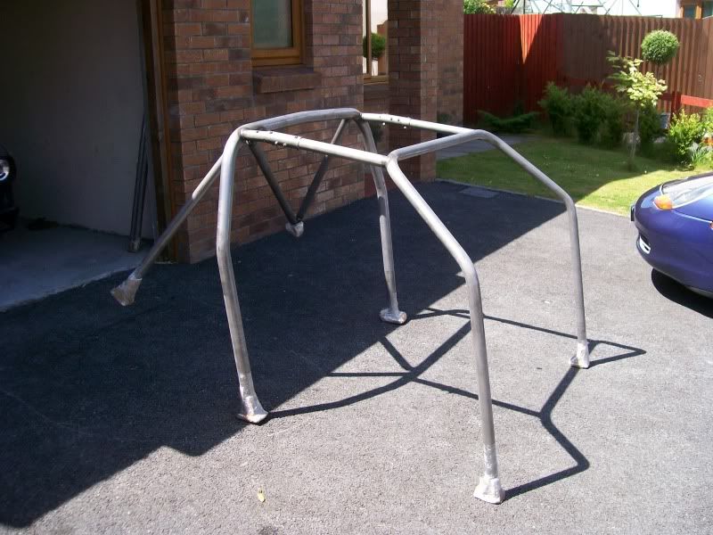

Rollcage purchased and sitting in the garage ready to go in

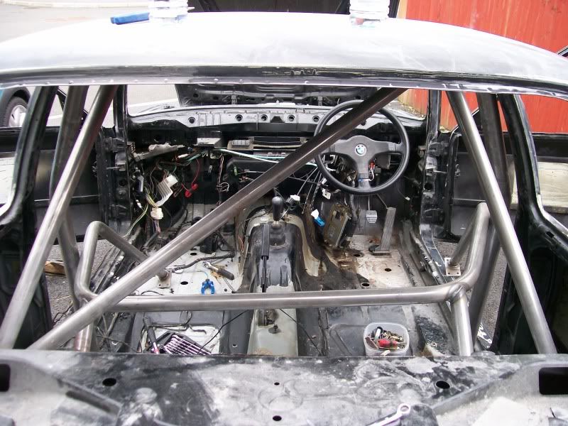

Rollcage partially in - dashboard out!

That's a nice job done on removing the sunroof.

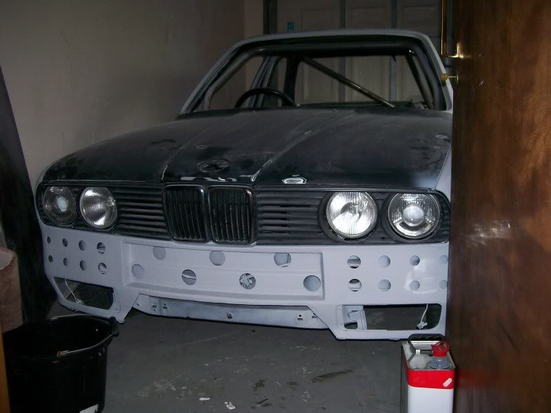

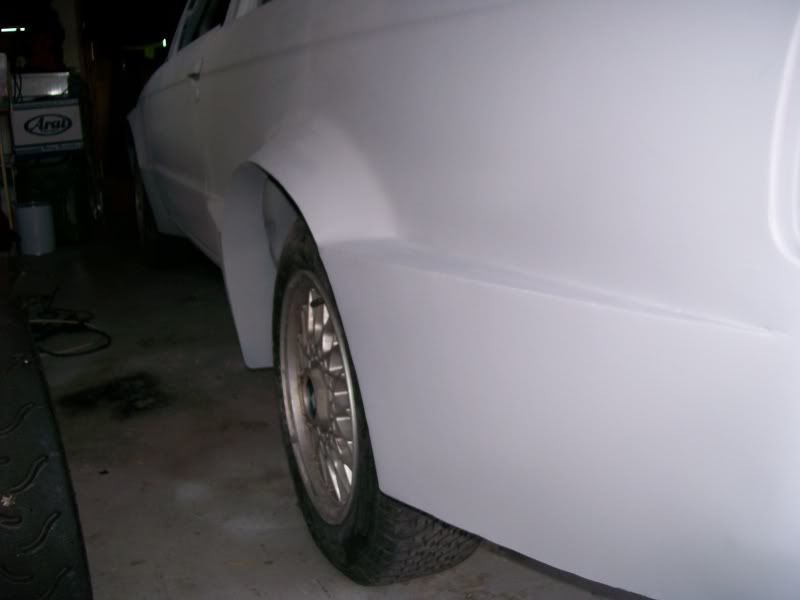

Yes there has been some progress, but to the car's bodywork, not the motor. She's now a wide-bodied E30 with everything fabricated from steel.

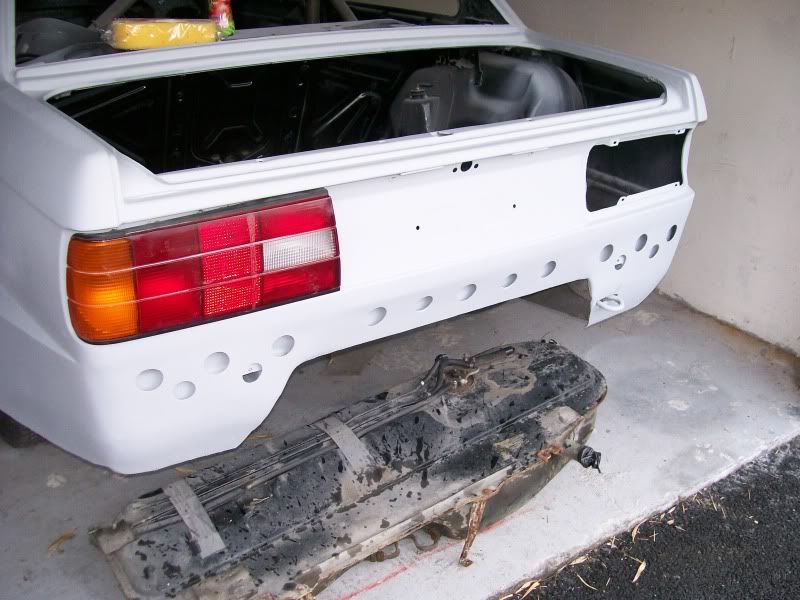

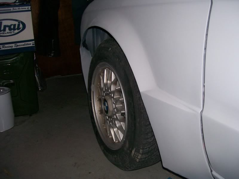

Everything is in metal not fibreglass:
Looks a bit funny with the original skinny wheels - pls try to imagine sitting lower with wide wheels

Progressing nicely, that rear end looks proper :wales:
