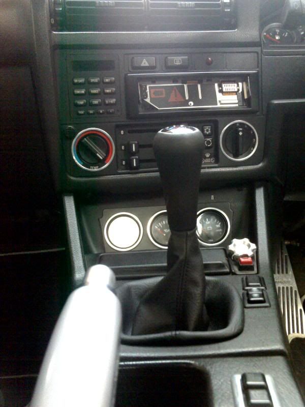

what gear box set up have you guys used i.e cross memeber, selector rod etc.
ive gone with e36 crossmember, e36 shifting arm, e30 selector. and e36 shift lever. it all fits well but the shift lever sits slightly to the right in the
car rather than central just wondered befor i have a tinker?

Hmm.strange actually as mine sits slightly to the right ( 6 speed ) .
It sat more to the right with the e30 gear lever but when i used the original evo one it put it more to centre,but like i said, still slightly to the right.
Do you want a picture ?

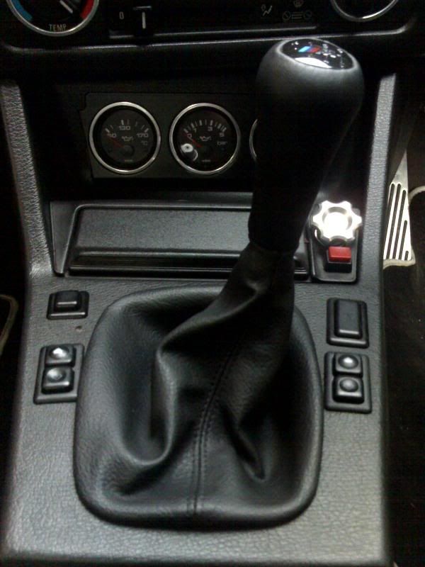

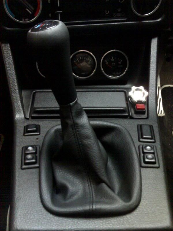

5th gear is ok on mine,not close to console.Infact in the extremes ,reverse and 5/6 th it seems centred.
Pics speak a 1000 words.
Natural/relaxed not in gear :
Reverse :
5th gear :
There you go,
cheers,
andy
Reverse :
5th gear :
There you go,
cheers,
andy
cheers mate, im going to have to play around with the linkage mine seems a bit more over than that, any sugestions any one?

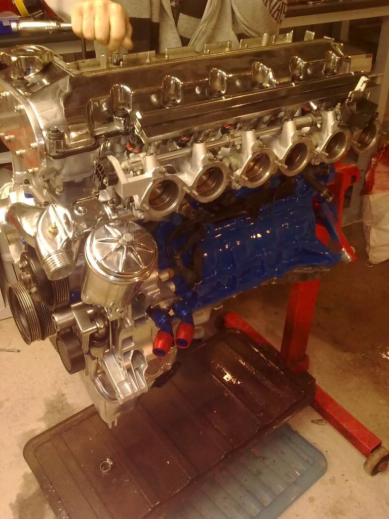

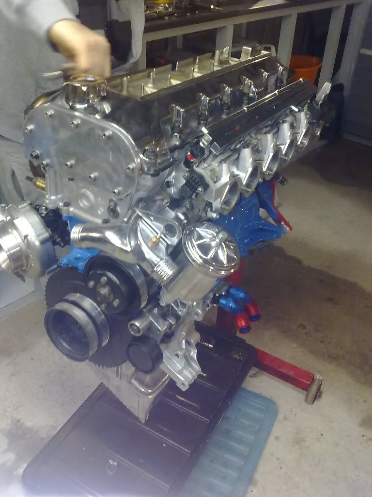

little upp date if any one is interested, ran the car as a turbo for a while on standard comp ratio, cracked a ring land in the end so went for the whole hog rebuild. spec-
s50b30
je forged pistons 8.5.1 ratio slight oversize
forged con rods
crank polished and balanced
nearly all internal parts renewed
gt30 turbo
vanos removed
kms stand alonew with map sensor and wideband
rc injetors
steel headgasket
light weight flywheel and padle clutch
apexi avcr boost controller
mocal catch tank
sard fuel regulator
ally rad with spal fan
mocal oil cooler
fk coil overs
k sport 8 pot 330 disk kit front
k sport 6 pot 330 kit rear
h and r anti roll bars all round
polly bushed
tilton pedal assembly with bias adjustment
arp head, main and rod kits
and more i have forgot, hoping to get it running this week and then mapped
does anyone know of any other RHD e30 s50b30 turbos????
