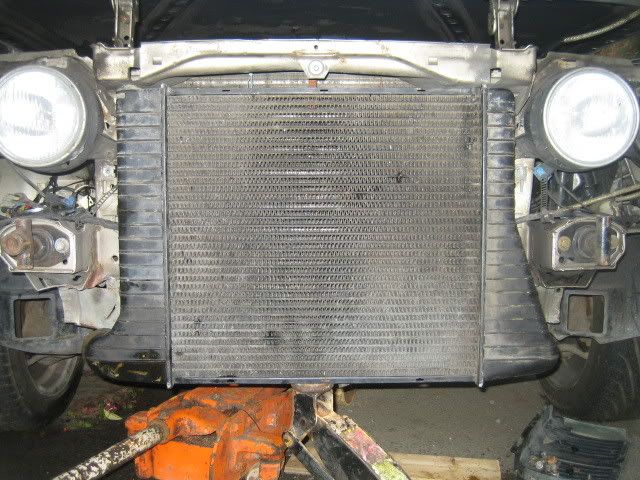

spent most of this afternoon sorted the postion of the intercooler, much happier with where it is sat now! although its not tucked right up to the radiator at least it will sit inline/behind the front bumper!
anyway, here we are, what do you think
some photos didnt work to well as theres so much smoke in the garage from the anglegrinder!
thoughts???
thoughts???

Looking brilliant!!!
Love the list down the side lol!
Those coolers are certainly popular no doubt I'll end up getting one. Can you share with me where you got it from?
Whats your plan for the suspension and brakes side of things?
Here you go rix!
http://stores.ebay.co.uk/MaximumPowered ... idZ2QQtZkm
The ones me, phil and fozzy have are all the same, me and fozzy got ours from the above link and are the "large" model guess phil got his from the same place
yep mines a good ol egay ic....aswell as some other bay treats too
picked mine up off a guy who tunes skyline for a pint more then £50. when you can buy them new from the price they are there and get justify why people will spend fortunes on blitz/bla bla ones

the intercoolers from that link.... they are very cheap...whats the quality like? im after a larger cooler but not as large as yours but im not really wanting to pay £400 for an rs500 cooler.

thats what i was looking at, to fit in the space infront of the rad and between the headlights but i do have plenty space between the rad and engine though so i could move the rad back and fit the mid size 660 x 300 in front. ill definately be calling him as they do look good and the price is very good compared to the usual cosworth scene coolers
Sorry its abit off topic phil
i spoke to some one abit back who was local to me and would nock a copy of a volvo one which fits with no mods for £440 all in ally which i though was ok but then the ebay cheap ness becond and the fact that i didnt mind modding the front of my car, have you seen these.
very simular to the above i think!
