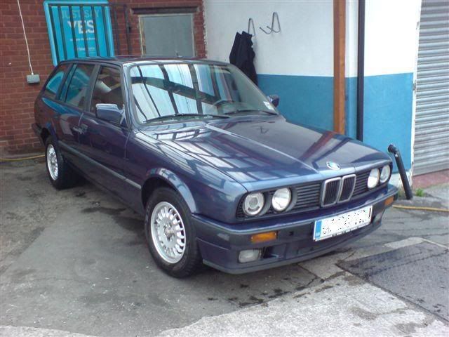

i've just noticed a few more m40 > m20 threads but i'll stick with this one:
here our new m40 tourer shell:

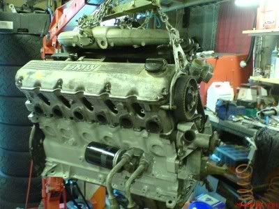

heres the engine its a 6k, alot cleaner than when we removed it 8)
had sump off + main/thrust cap off and its in good nick, rocker assembly clean too. Replaced the cambelt too and checked the clutch its ok. Someones snapped 3 manifold studs off in the head but they'll come out.
Now i'm gonna order some new engine mounts up and get a shift seal for the back of the box. Read the oil grade sticky, but bearing in mind this things gone round the clock do i want type do i want mineral or semi-synthetic?
some bad news though....the 3.73 diff feels sick?? when i rotate a driveshaft flange (its not a limo) the other flange rotates the opposite way and in doing so feels very rough. When i turn both flanges forward it feels better :?
