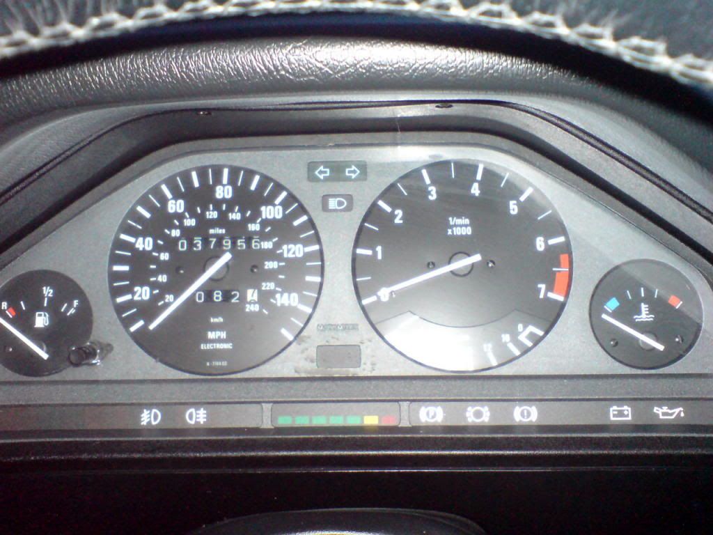

This is how it all started, a totally standard car which only had covered a paltry 32000 miles when i bought it in july 2006.
A few pics from the early days before any major work was carried out.
