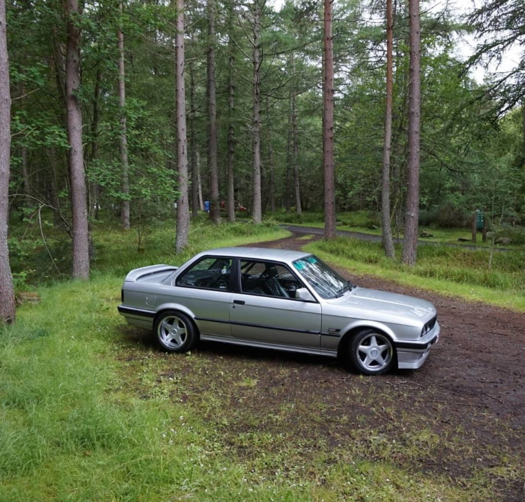

I have been meaning to write this thread for a number of years. I picked up a fairly low miles 316i auto, sun roof facelift with electric windows back in 2014
The first thing i set about doing was to ditch the hub capped wheels and fit a fine set of BBS reps.. as you do.
I managed to pick up a really clean set of sport seats for £250 and 4 hours of driving. If only we could still find bargains like this now.

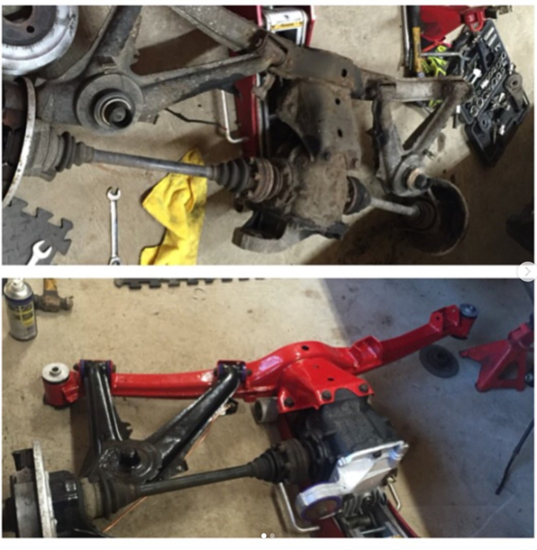

i had to keep with the powder coating theme, so i pulled the rear subframe and set about it. I really regret not changing to rear disks at this point in time. Spring was coming and i got impatient

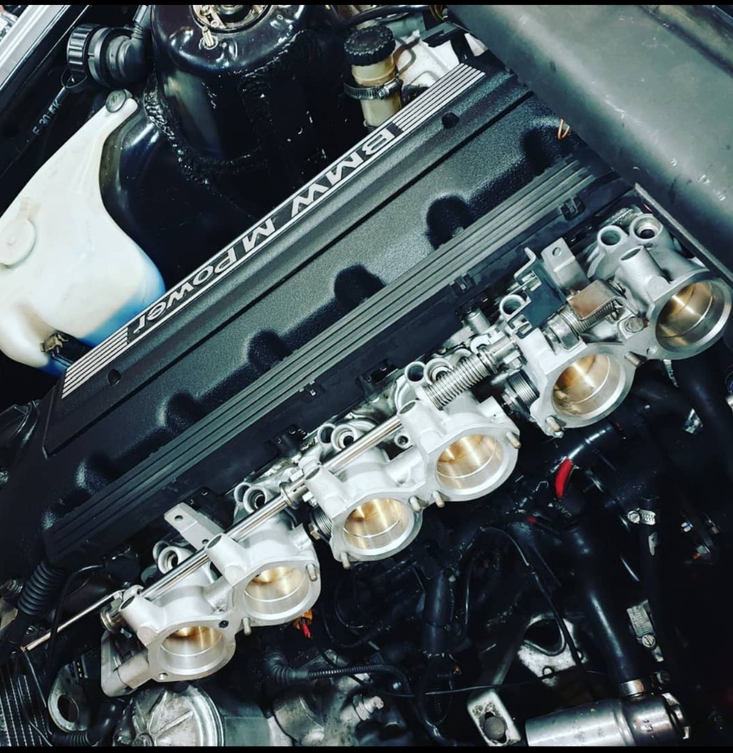

i vapour blasted the ITBs and got the rocket cover and airbox powder coated with a crinkle black to freshen it up a bit.

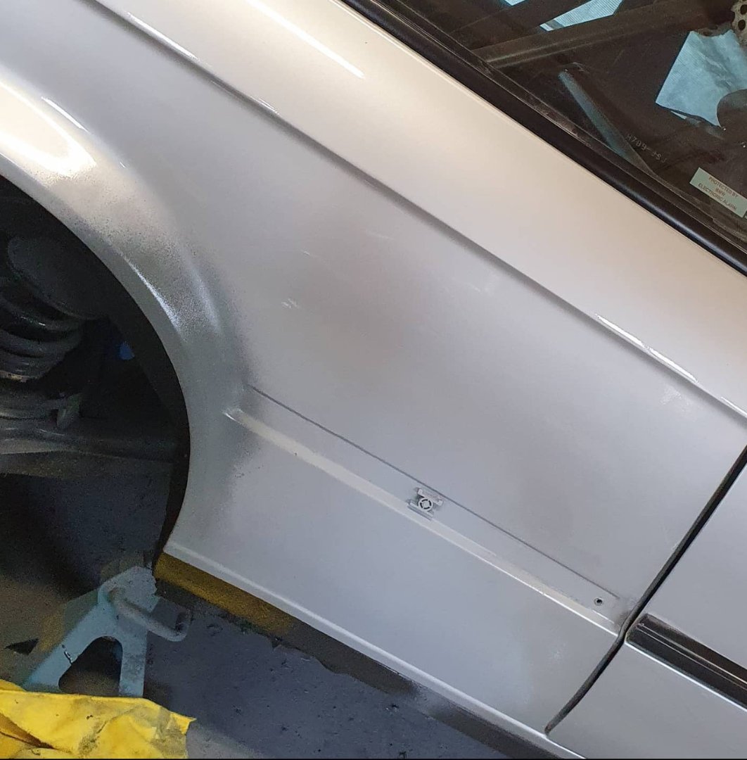

the car always had a blister on one of the quarter panels but upon a proper inspection it had gone into the inner arch. Up until now i had never welded on a car but had played about with a mig welder. I decided just to get stuck in.
It was time for some new shoes as well

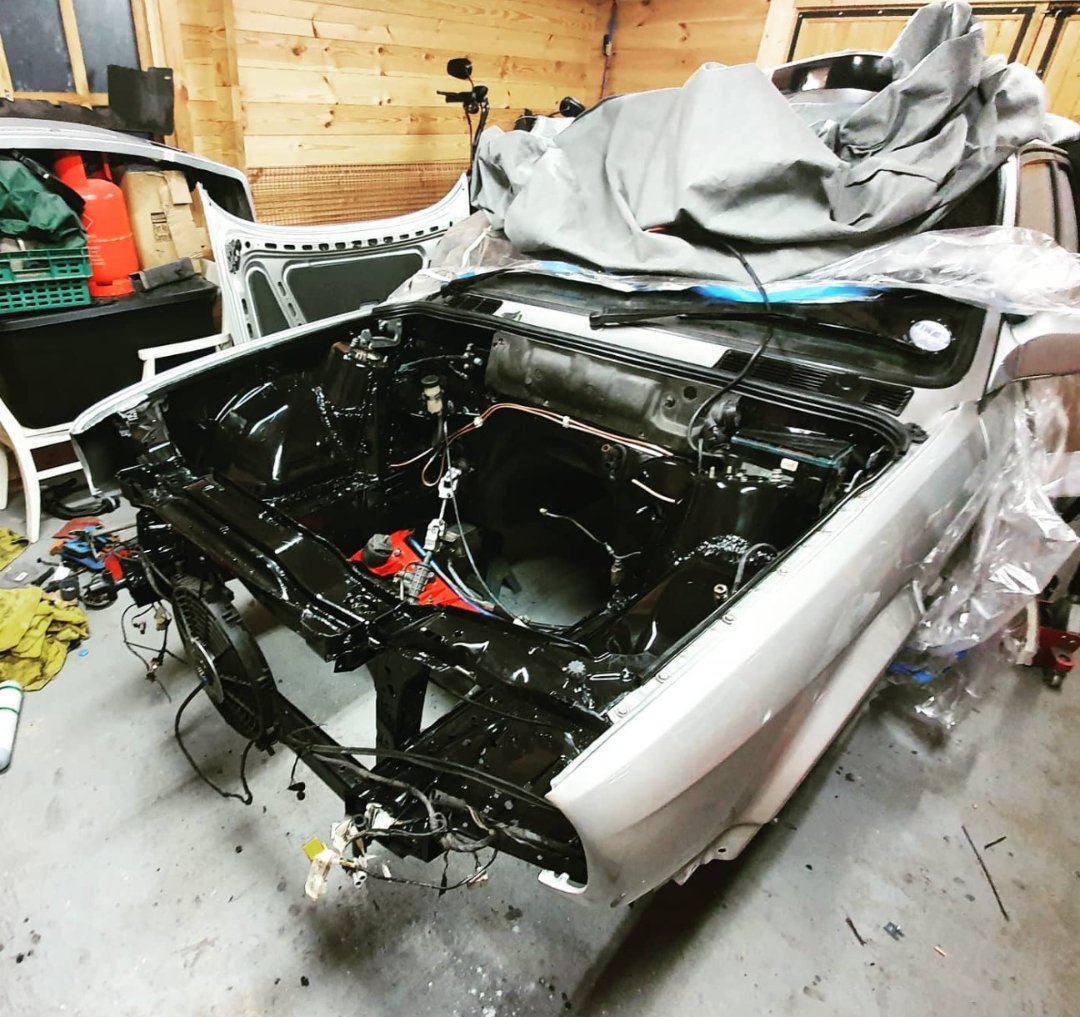

The following winter i had some more rust to take care of. This being easier with taking the engine out... again.

i replaced the brake pipes again and resprayed the bay. The block got treated to a clean up as the last time i put it in, i was in a rush to make the sprint it never made.

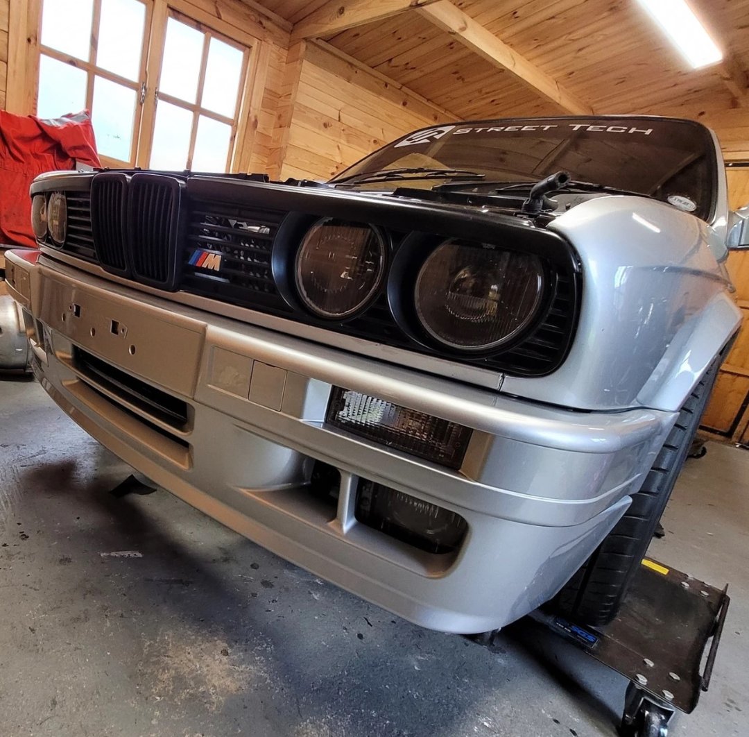

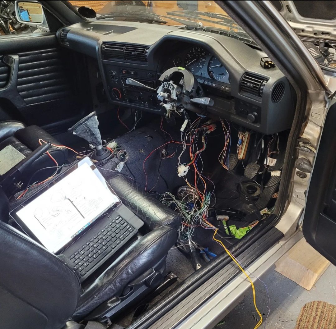

Next up was a trial fit of the aftermarket tech 2 kit before paint.
after paint
