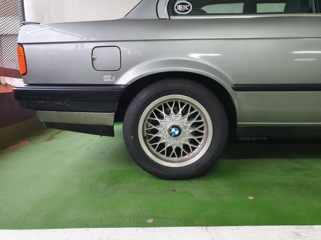

Wed Mar 02, 2022 9:22 am
Just a small update - put the BMW emblems on my Ronal LS and I think they finish the wheels of perfectly...
Tzantushka
Posts: 464
Wed Mar 02, 2022 10:08 am
Very nice.
If you are not an aficionado - you'd think they are OE.

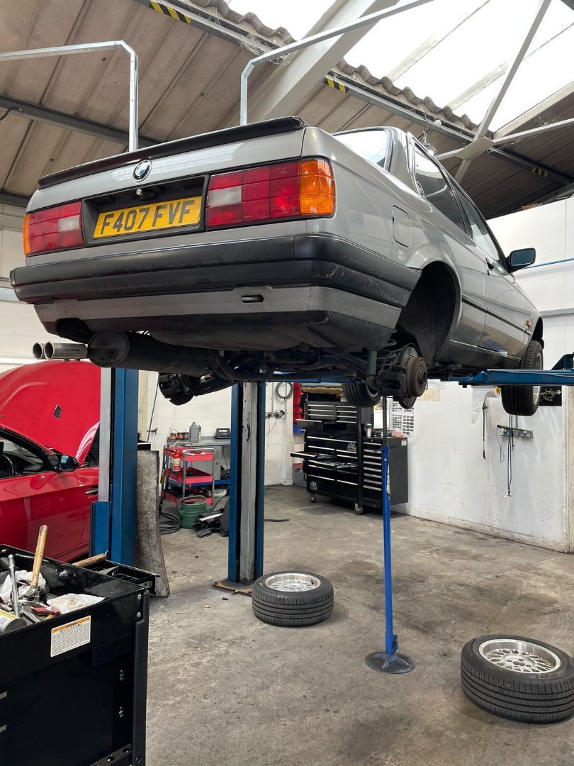

Update on the car - I had it in a Crago's BMW & Mini Specialists in Dartford for subframe and control arm bushing replacement as I was getting an annoying clunking noise from the rear of the car when it changed gear. I can't tell you what a difference it has made! It feels so much more solid and stable now, and silent gear changes which is nice :D
The guys at Crago's are fantastic, can't recommend them enough if you're local... or if you're not... definitely worth the drive! Here are some photos they sent me of the car up on the ramp in the garage:

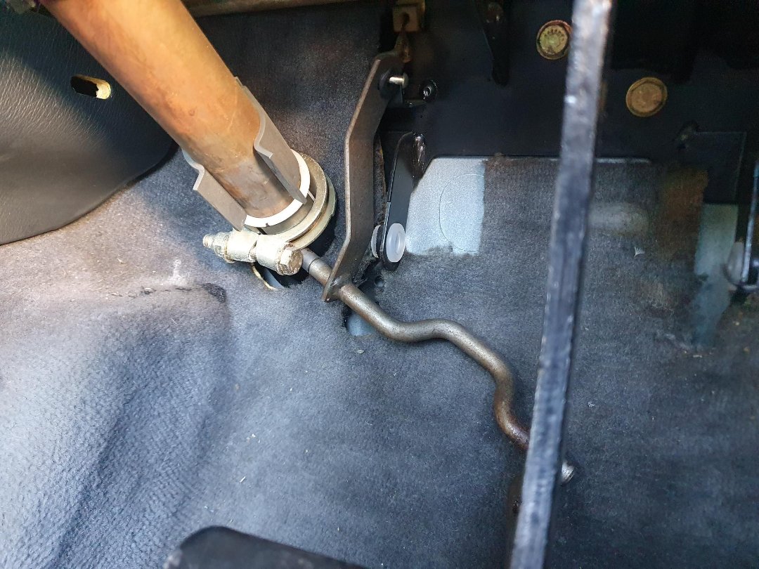

Two small but VERY satisfying improvements made today... when I really should have been working :P
The first is replacing my accelerator pedal bushings... which weren't just old, they were totally non-existent which meant my pedal was loose and rattly. A very simple job, made even easier by the great write up on this thread (which is real treasure trove of useful info): viewtopic.php?f=25&t=278775
The pedal already feels way more secure and responsive, can't wait to try it out properly on the drive home.

So happy to have the car back on the road... thought I'd celebrate by fitting a nice condition 3 spoke sport steering wheel that I picked up on FB marketplace - also realised I've never posted an interior pic so here you go:
I also did a clean up of the ICV, throttle body and surrounding area which raised a few questions - will post these in the technical help thread a little later on today...
