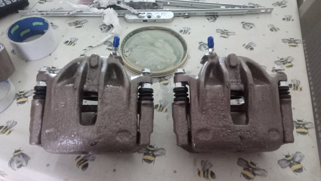

Post Sun Nov 12, 2023 12:35 pm
Just finished rebuilding the front calipers, little bit of paint touching up before they go on the car
