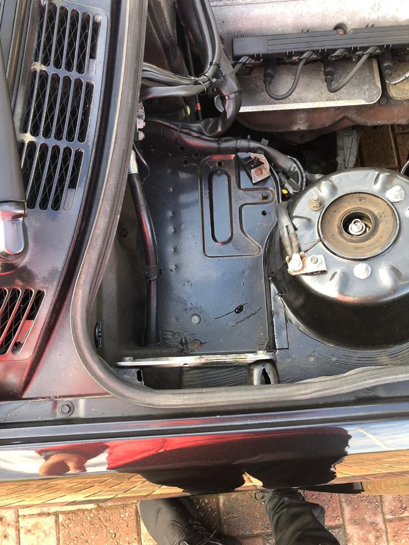

Got a bit carried away today. Started doing the cambelt then next thing I knew had the head off. Now I'm thinking of changing the piston rings and con rod bearings so I will have no engine worries for a few years!
Sat Apr 20, 2019 8:15 am
Nice unmolsted example
A complete refurb of the head will be a good job done on its own
Brianmoooore
Posts: 49358
Sat Apr 20, 2019 10:00 am
I'm with DanThe on this one. After a quick look through the thread, I didn't see what mileage it has on it, but as long as it hasn't be seriously abused, I'd expect everything in that bottom end to still be within factory tolerances. It was on a 200,000+ mile example I stripped down once. Can't see in the pic., but I'd expect the cross hatch honing marks still to be visible on the bores.
Take the head to a good machine shop and they'll probably recommend new exhaust valve guides, refacing of the inlet and exhaust valve seats, plus a light recut of the valve seats in the head and a light skim of the deck.
Take the exhaust manifold along as well, have them check that for flatness, and have them skim it if needed. Fit new exhaust studs, plus copper coated nuts, and you're good to go.
Put it all back together with new stretch head bolts, new cam belt and idler, new water pump, new thermostat, check that the coolant bleed screw works, check the hoses are all good (especially the small one from the back of the head to the heater (it lives a hard life)), remove the large hex drain plug on the exhaust side of the block, at the front, (just hidden by the towel), fill the cooling system with water, and flush out the lock cooling jacket.
Replace the plug, fill the system carefully with coolant, then fire it up, having first read up on the possibility of an air lock and what to do about it.

After having a sleep on it I decided against the bottom end refurb. Bores looked fine and doesn't burn any oil or make funny noises. Mileage is 168000 but seems to have been well looked after. I will do as you suggest and get the head and manifold looked at. I got carried away because as I stripped away for cambelt removal I found various hoses that needed replacing and things like the plastic cover on the camshaft sprocket cracked, couple of snapped bolts etc so I kept going. Plus my missus was out for the day so thought I'd spend as much time on the car as possible. Thanks for the advice. Is there an easy way to remove the big bolt on the crankshaft pulley? Can I get away with a big crowbar in the fly wheel teeth or is it too tight for that? I'm sure I found a thread somewhere on here an someone used the starter motor with a breaker bar on the bolt but not sure I fancy that.
