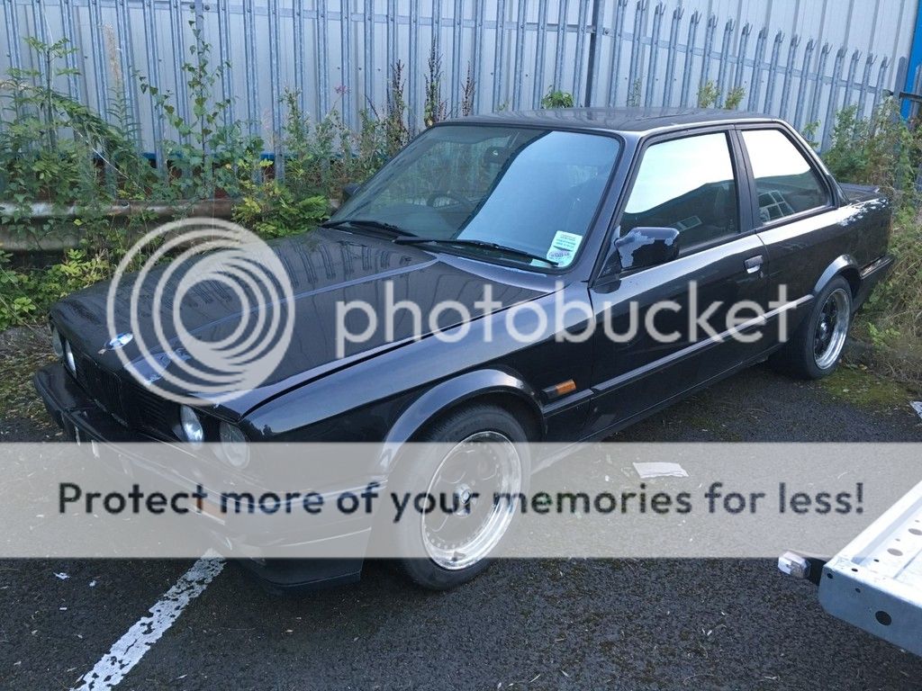

An indeterminable amount of time ago, I sold a 318iS Powerflow exhaust system to a chap called James who lived up near Derby. He had a black 318iS he drive daily and bought my old exhaust for his car. One piece was missing and I vowed to find it and send it up to him (although to be fair he wasn't too worried about it). Cut to... 18months or so later, I found said part and got in touch only to find the car was of the road due to a minor non fault accident not long after we first met. A deal was made and I ended up with my exhaust back...
...attached to the rest of the car...
:banana: :banana:
Because I needed a third iS of course :roll:
I must admit, at the time I needed an engine for my racing car, the interior was in good shape and I could break the car up get my money back and some nice spare parts. The car proceeded to sit in the compound by my workshop for the best part of a further 12 months under a cover until I could make space to do what ever I was going to do with it.
Now, I was home one day going through the paper work for my cars and realised that in actual fact, the car had a lot of money spent on it over the years to keep it maintained and running and there was a tonne of paper work and documents. Despite its rough exterior, this was a car that mechanically had been cared for. Being a sado I took pitty on it and brought it in to start work repairing it.

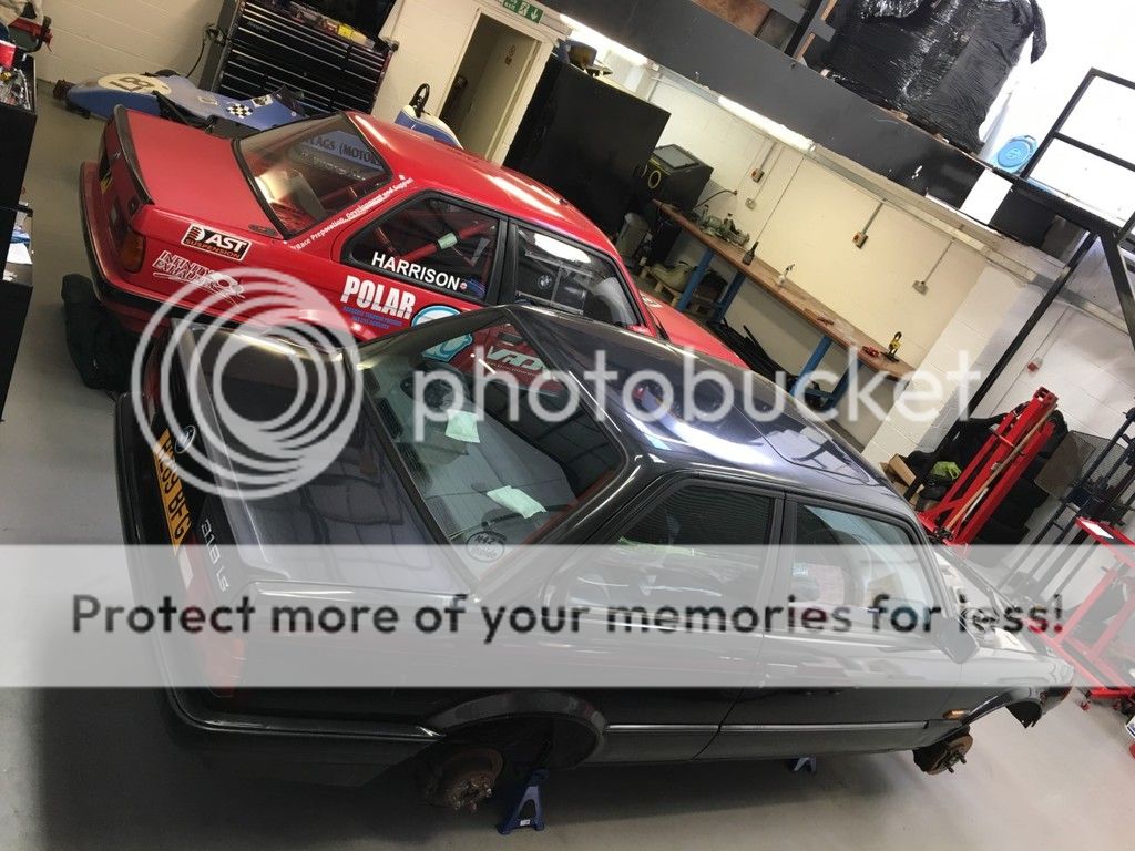

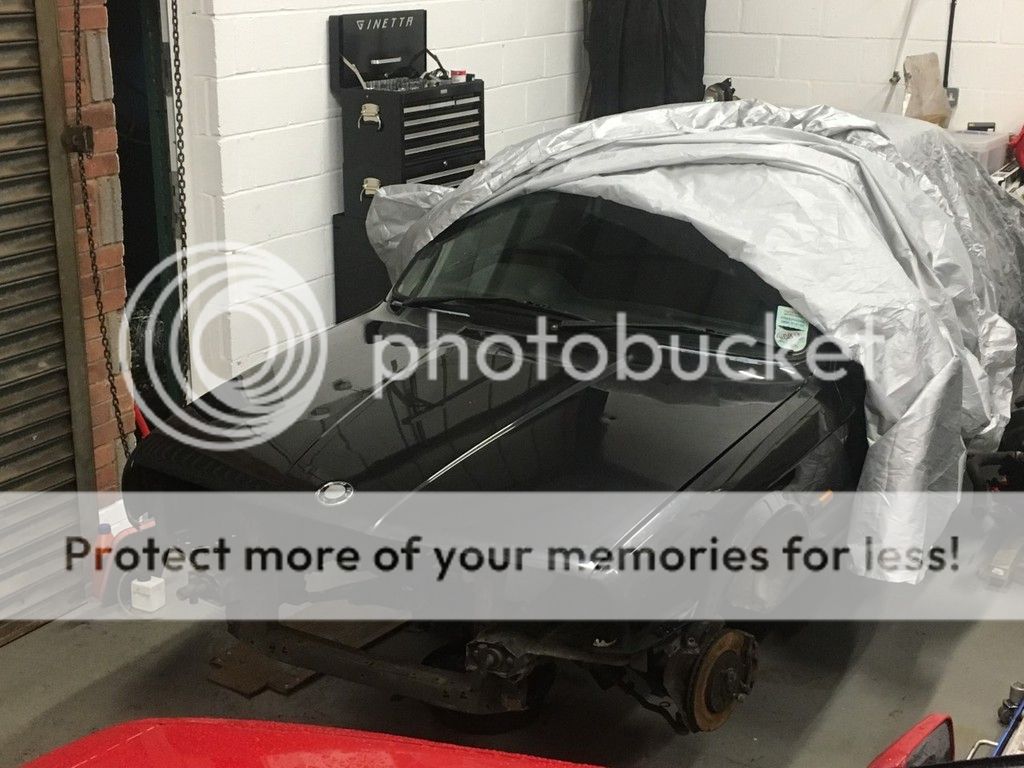

I moved one of my beloved 'Poppy' to a garage near my house and 'Emily' now had a place to live.
First was I removed the engine and gearbox as the rubber mounts were shot and the front sub frame was corroded.
A replacement subframe and steering rack (the other one was leaking) were assembled and the wishbones and ARB were painted and reassembled with all new nuts and fixings.
The bonnet, valance and bumper were the most damaged parts. A very long drawn out search ensued and eventually I found the correct parts.
Work did/has stalled slightly when I moved all the cars to a new workshop closer to home. And this is the point I am at. Next plan of action is to refit the engine and gearbox to get the car back to a driver again. Then refit all the body work. Or vise versa :mrgreen: :mrgreen:
