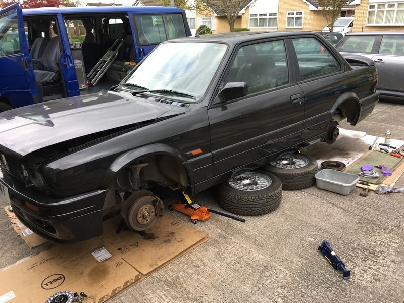

I got chance for some tinkering over the weekend, finally...
I dismantled, and cleaned up all the brake friction components, checked the pipework etc. and deduced as expected it at least needs handbrake shoes and preferably some replacement front pads (still got YellowStuff in, which I never got on with and take too long to warm up for road use).
I last changed these shoes around 11 or 12 years ago when my mate owned the car, not surprised to see they need doing again.
Although the discs and rear pads look reasonable, and cleaned up ok from lack of use, I thought I might as well go the whole hog and replace the lot so have ordered:
- New discs and pads all round
- New wear sensors & clips
- New handbrake shoes & fitting kit (thanks to advice in general area)
- New fluid
- New rear ARB drop links (noticed these looked perished too)
If that lot arrives in time and weather permits, I will fit it all at the weekend, flush and bleed the fluid and we might be close to an MOT worthy vehicle, hopefully... depending on what the tester makes of the rusty bits I suppose. :?

Brake and MOT update:
I had a lovely weekend just gone, in good weather too, tinkering on the driveway doing a pretty thorough brake job on the E30. It was a good job I did as the MOT is booked for today actually...
Bits required:
Wheels off:
Handbrake parts removed for reference how to re-fit:
New bits fitted and adjusted:
Discs, pads, wear sensors (pad wear warning light off for the first time in ages), retaining clips etc. all fitted.
I had a go at the rear ARB links but struggled so left those for now and will ask MOT man for advice on how to get the new ones onto the ARB, old ones come off relatively easy, new ones very tight of course, so I re-fitted the old ones for now.
That was Saturday. On Sunday I continued and changed all the brake fluid, clutch fluid, bled both and then fixed a wiring issue with the window washer pump by soldering a small new section into the loom near the pump.
Checked all lights, wipers etc. and ran it up and down a bit with the handbrake half on to test and bed the handbrake shoes in a bit.
Then this lunchtime, it was off to the MOT station. I'd forgotten how much I love driving this car, after 4 years or so of not doing so. It felt very old fashioned heading to the MOT test centre today, even compared to my daily car which is a 22 year old Volvo so not exactly modern!
After a few miles I started to get used to it again and remember that the combination of a tuneful, torquey straight six, open sunroof, narrow relatively lightweight car, manual 'box and RWD is just lovely :D
Stuck in lots of traffic jams on the way home, but the temp gauge stayed rock solid at half way and everything was fine. Brakes feel better than I ever remember to be honest.
Next stops, improving the gearshift, sorting the exhaust tailpipes to be correct, fit those ARB drop links, and tracking down someone to fix the rusty bits.
Any recommendations for the bodywork much appreciated, now it's roadworthy I'm happy to travel for the right place to do a good job.

Yikes - where does the time go?!? It's spring again, and time to start tinkering again and hopefully get the E30 through another MOT (last one, I'm embarrassed to say was spring 2017!). I put the battery on charge, checked the fluids and she fired straight up as usual and ran quite smoothly.
I ordered the bits for an oil and coolant change, as despite it having only done a few hundred miles on the oil and filter fitted, it has been a good few years! Also, I have this oil extraction device (big sucker!) I use on other cars to try on it...
It happily sucked just over 4L of still rather clean oil from the dipstick tube, then I changed the filter and found the remaining few hundred ml of oil, and re-filled it.
Onto the coolant change. I last did this around 2009/10 according to my records so definitely time for a change. The coolant drained out and looked pretty decent, but the top radiator hose connection was brittle and appeared already cracked off when I removed the top hose to flush the radiator.
Although it hadn't leaked or had any issues, I'd rather find out now and just replace the radiator and any other bits that look suspect. Old radiator came out easily so I could measure it to make sure I was ordering the correct size.
New radiator is on order so I reassembled the car with the old radiator and re-filled with water for now so I could drive the car back into the garage rather than push it!
I'm now back on with researching all the other bits and pieces I was looking at previously, as mentioned on the thread above to jog my memory about what I was up to! Here we go again...
Great to see everyone else still working on their E30s :D
Stu

Good news: I changed the timing belt this weekend, the old one was as expected in good condition but glad I swapped it for peace of mind. Took a bit of remembering how to do it and referencing the guide on here!
Bad news: I unpacked the new radiator to fit that and found it damaged! Contacted supplier to arrange a replacement.
Getting there... :-)

Here's a few pics. New radiator, turned out not to be damaged but had expansion slots cut into the top and bottom of the frame. I queried it with the supplier and it's correct.
Old timing belt, which by the time you get to it you're bound to just change anyway like I did!
New belt fitted and tensioned.
New radiator fitted this eve after work along with new OEM top hose, correct coolant mix added and system bled. All fine.
My other new parts arrived from Cotswold for the gear linkage refurbishment so I'll get on with that next, maybe go for MOT first before I take the car to bits again though...? :D
