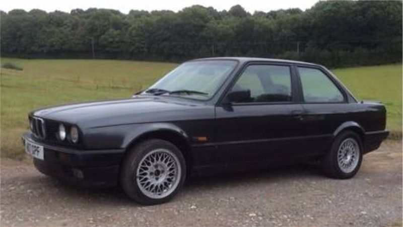

second is a 318is I bought yesterday off of a friend.
Bought it to replace my Impreza WRX as a daily run around as I was getting fed up with 24mpg on super unleaded.
The 318is was pretty reasonable price but does need a few bits doing to bring it back up to scratch as it's not been used much recently. Seams to drive reasonably well.
List so far appears to be:
Get Stereo working
Electric mirrors don't work
Central locking doesn't work
it needs a pair of correct size front tyres.
a pair of orange front indicators
refit the centre caps
New Arial
sort out a couple of small marks on the bodywork.
annoyingly I seam to have somehow buggered the drivers side lock today and can't get it to unlock with the key
Fingers crossed I don't find too much more!

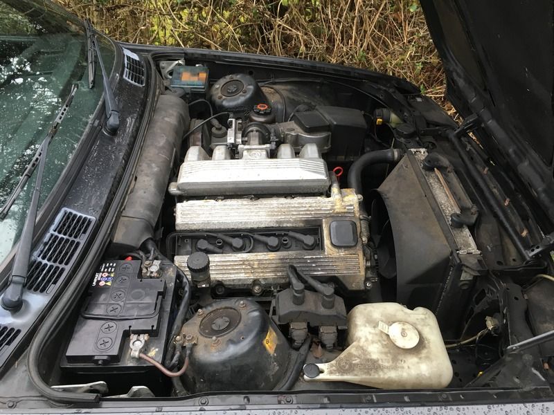

Managed to sort a few bits on it today.
Found some orange front indicators to replace the smoked grey ones
Found some reasonable body coloured wing mirrors in the box of race car spares to replace the slightly ruff black ones that were on the car (luckily had a pair in Diamond Schwartz).
Managed to get some signs of live from the central locking, it locks / unlocks from the boot. need to check if the spare doors I have have central locking motors in them, fingers crossed.
Fitted the centre caps to the wheels (well 3, one is different and doesn't fit so another thing to buy)

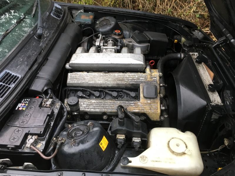

Also had a go at degreasing the engine pay
starting to look a little better, might have to keep my eye open for a replacement rocker cover, does anyone know if its the same as a E36 318is rocker cover?

Sounds like a familiar list of fixes! Currently about to replace my 318is rocker cover too, it's come from an e36, so I assume it fits. Post the confirmation here ASAP when it arrives.

Oh dear, just checked on the m42 club and one poster says the e36 cover won't fit the e30. My stuff will be on it's way now, so I may as well see for myself out of interest. I'll let you know.
Sounds like you're pretty handy, from what they say a tensioner change is never going to hurt for the 'is (especially if you don't know when it was last done I guess).

cheers, I've had a look at a picture of one on eBay and it does look slightly different.
No idea when the tensioner was last done and for £26 on eurocarparts it seams silly not to just chuck one on.
Post Sat Jan 14, 2017 8:25 pm
the breather pipe hole is in the wrong place on an e36 cover

andye30m3 wrote: starting to look a little better, might have to keep my eye open for a replacement rocker cover, does anyone know if its the same as a E36 318is rocker cover?
Earlier E36 rock covers will fit. All you need to check is that the breather port is on the front not the back.
