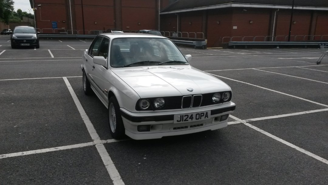

Thought i'd start a thread on my 325i which i bought in March. Some of you may remember my last e30, a brilliant red 320i
I owned this car for 6 years, used it daily, and the only real fault in that time was a knackered starter motor. I did tell myself i would never part with it but in reality i was sick of looking after the red paint and it needed some bodywork
So for quite a while i was keeping my eyes out for a clean e36 or e46 sport. However this 325i SE came up and i thought it was worth a look
The bodywork actually suprised me, it was very straight and tidy. The downside immediately was the electric sunroof, it works fine but i could see some rust in the channels and wasnt sure the extent of it. The handbrake wasn't working. Only other issue was the engine was a bit tappy but noticed a snapped exhaust stud. It turns out both studs on cylinder 6 have snapped off
So got a few quid knocked off and set about getting it home to swap some parts over and make a to do list

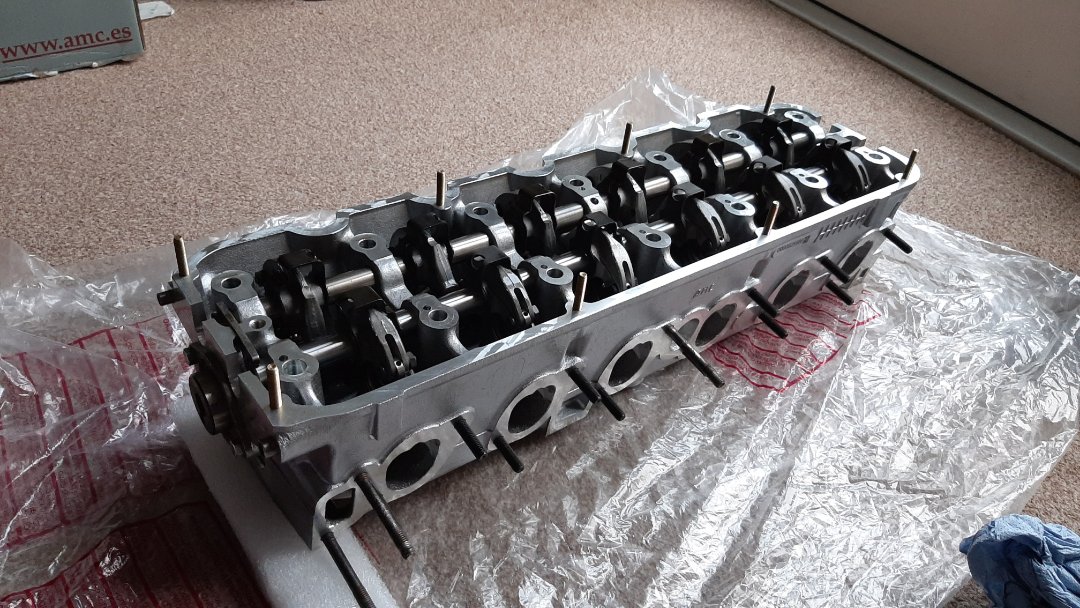

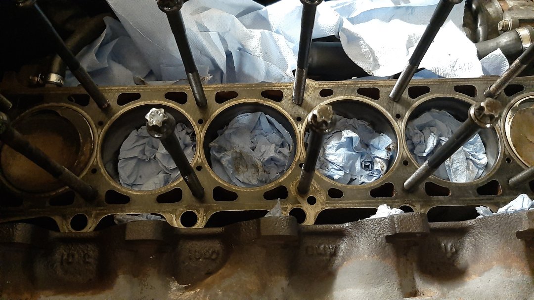

Snapped exhaust stud on cylinder 6. It turns out both the studs on this cylinder have snapped and will involve dropping the engine to repair it. In fact there were 4 studs missing in total..
Ordered new gaskets, studs and nuts. Around £35 from c3bmw for the lot (excluding downpipe gasket)
I also bought another good used manifold as a backup which was used in the end. I would have liked a 6 branch but time wasn't on my side to find a reasonable option
As the engine was being dropped it made sense to tackle a lot more jobs while it was out. Here's a list of what was done

Studs removed and replaced
Also discovered someone had been here before but didn't take note of the dots...
Suprisingly it didn't vibrate at all, although it did have a vibration damper fitted. It's all been put back together correctly
So the car is back and driving very well. The annoying tapping from the snapped studs has gone. The eibach springs are exactly what the car was missing. The original springs were standard so very soft, also it emerged that the rear springs had been cut by a previous owner to lower the back end...

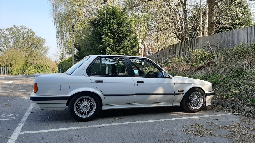

Ive been using the car daily over the summer (except for the wettest days) and slowly ticking off jobs. The steering rack seals went so replaced the whole unit with the purple tag e46 rack. This has transformed the car. I've been on a few days out to the south coast without any problems at all. Its been a pleasure to get it on some decent roads and with all the suspension and steering work complete its a blast to drive

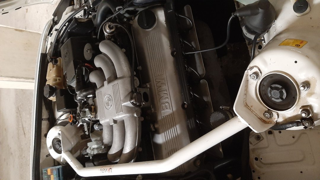

Ive also had the injectors refurbed and given it a full service. A front strut brace has been fitted aswell which makes it seriously planted in high speed motorway corners. Just making the most of it now until the weather gets shitty!

The new release bearing also means no more nasty rattle when I leave it in neutral.
More recently I decided to tackle the intake manifold gaskets due to a visible leak from cylinder 4 inlet.
And looking much cleaner

I was anticipating a head rebuild on the car for a while, but it got thrust on me a bit sooner than I had hoped as I snapped a rocker.... on the motorway near le mans. Certainly not ideal, luckily this was on the way back home. The car was faultless the whole trip up until then, but I think I pushed on it a bit hard straight after letting the car cool for 30 mins at one of the service stops
The head had suffered a broken rocker in the past so the cam was showing signs of wear, but the previous owner obviously decided a replacement rocker was cheaper than doing the job properly. At least this gave me the chance to do it to my own standard
I decided to tackle a lot of the work myself, and set about removing the head and gathering parts
The worst part removed was the dizzy and rotor, still on the originals stamped 1990
After getting a few quotes I decided on Corry Motor Services to do the head rebuild. I took my original 885 head but it was evident the cam journals were scored. Luckily he stocks brand new AMC heads and it was cheaper to buy this and have him build it up than what most other engineering firms wanted just for the labour on the old head
So I supplied a brand new cam and rockers and a few days later it arrived
The main job for me was cleaning the old gasket off of the block, an extremely tedious process that must have taken at least 6 hours in total
I cant recall whether I took that photo once it was fully cleaned but you get the idea. I made sure the bolt holes were clear of any moisture before reassembly

A pair of new Yokohama Advan Fleva in 205 55 15
Got those fitted and a wheel alignment, the choice in 205 55 15 rubber seems to be getting smaller year on year, but I'm more than happy with these so far
I've recently fitted this little oil temperature sensor kit from JR parts. They produce a lovely Alpina replica gauge that was a bit out of my price range, but this was good enough for me

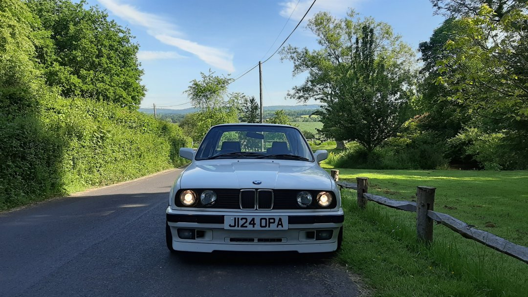

And just a couple of pics how its sitting at the moment
