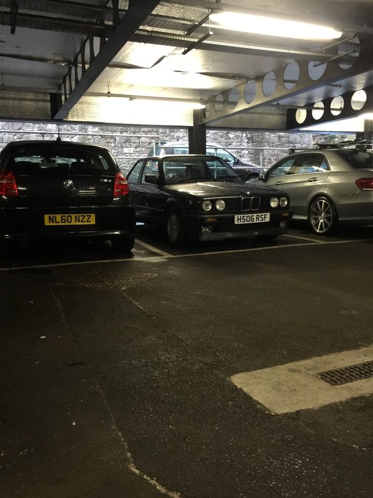

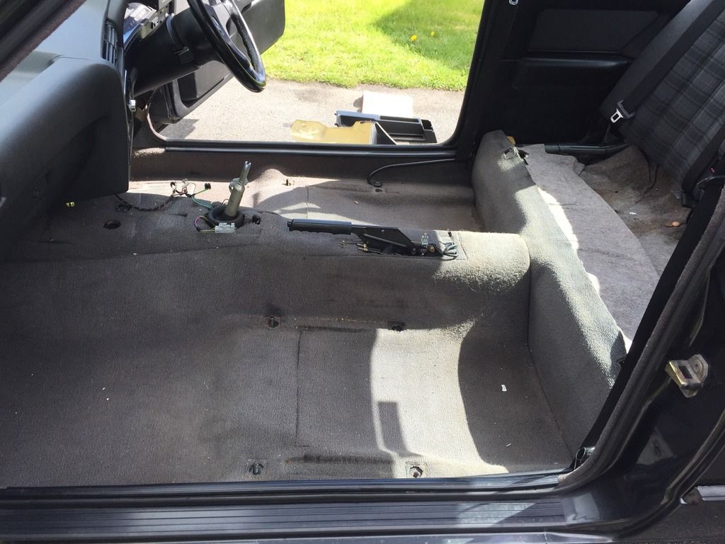

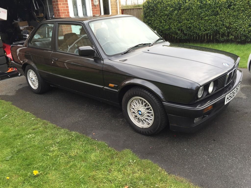

So roughly a year ago I bought my BMW E30 318is with 110k miles from Liverpool, with a MOT and no advisories :roll:
It made it home to Newcastle fine, but the clutch seemed to be slipping quite a bit, but I was over the moon, I finally had an E30!

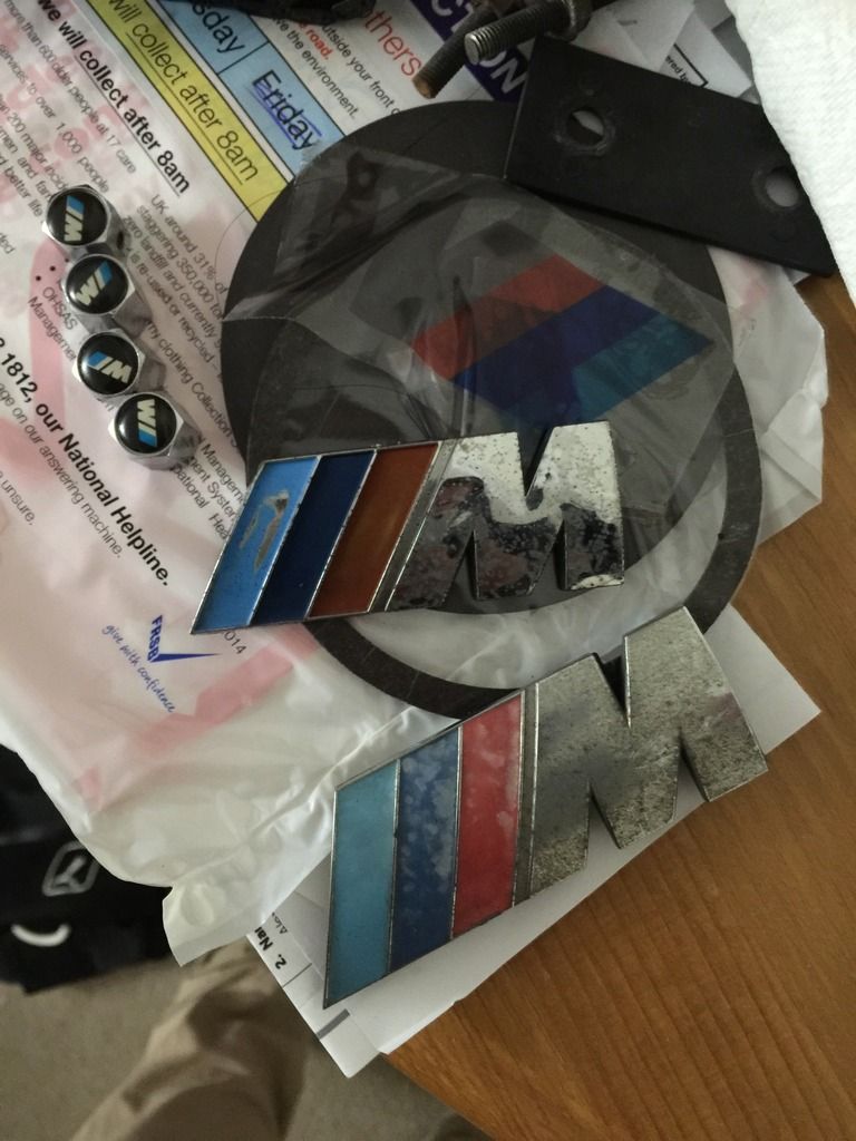

The removal of tat didn't take long, half of this came off in the services and the rest when I got home!

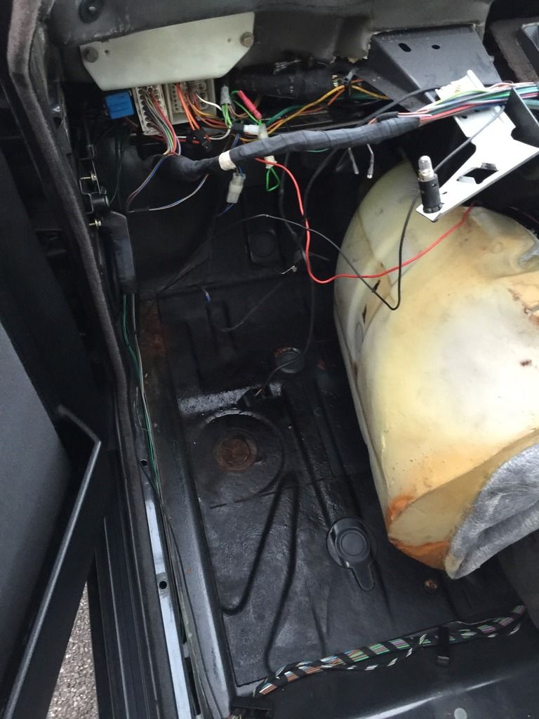

The next day I gave it a wash and started inspecting issues with the car

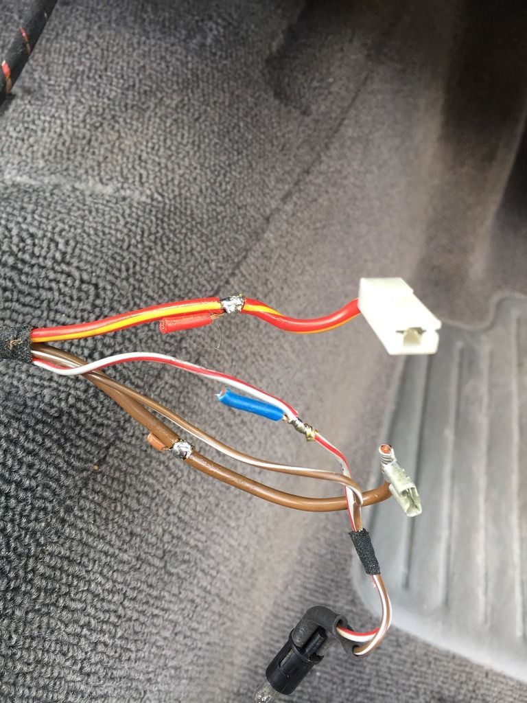

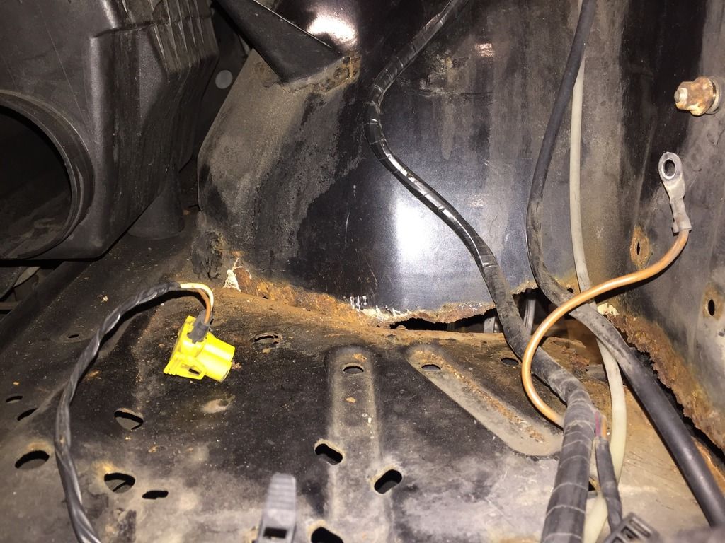

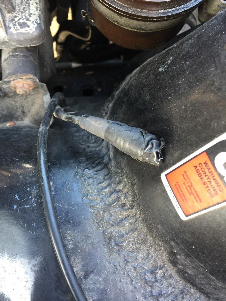

Evidently I had an oil leak (or several) and some dodgy wires taped up everywhere!
So I started a strip down to inspect things more

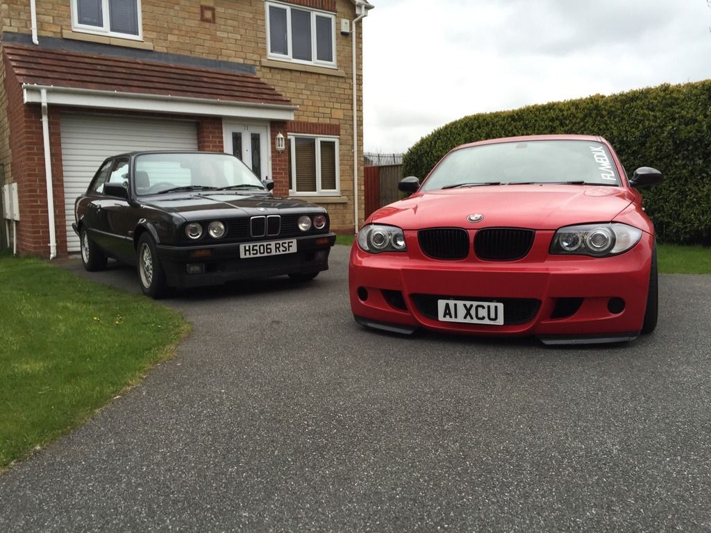

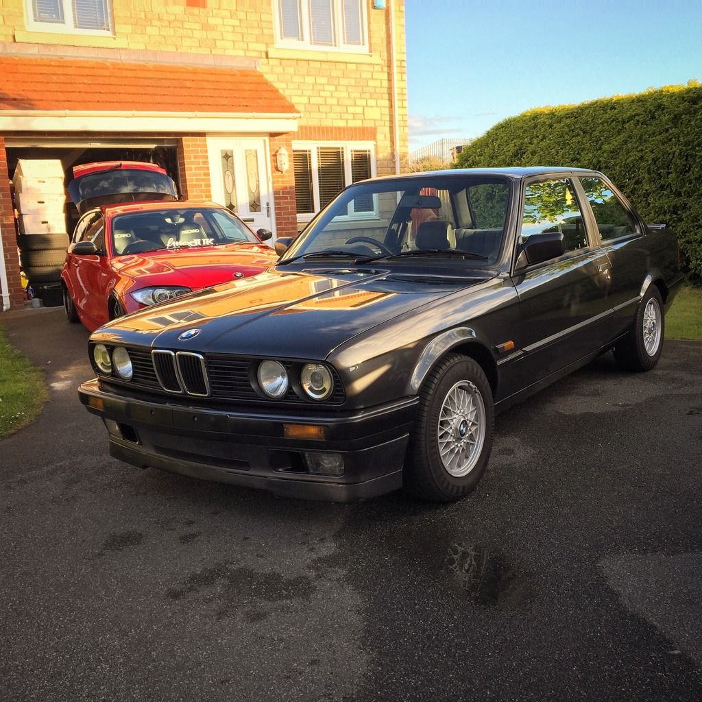

Even with these initial issues I found, I was still happy!

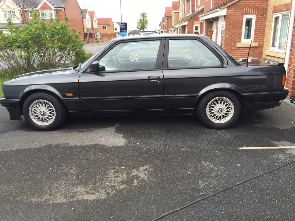

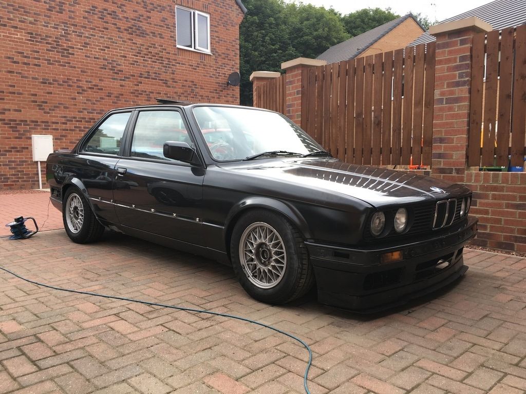

And even with a slipping clutch, or what I thought was just a slipping clutch, I used it for a few days as my daily and took it to work
Another pic in the sun...

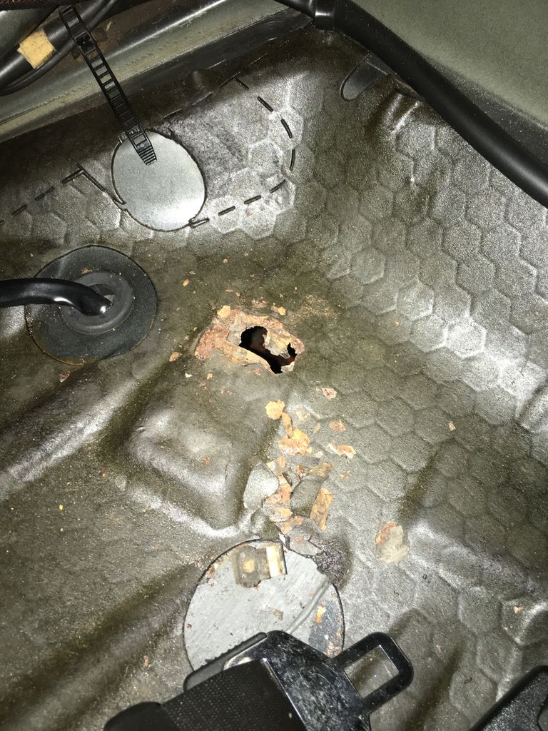

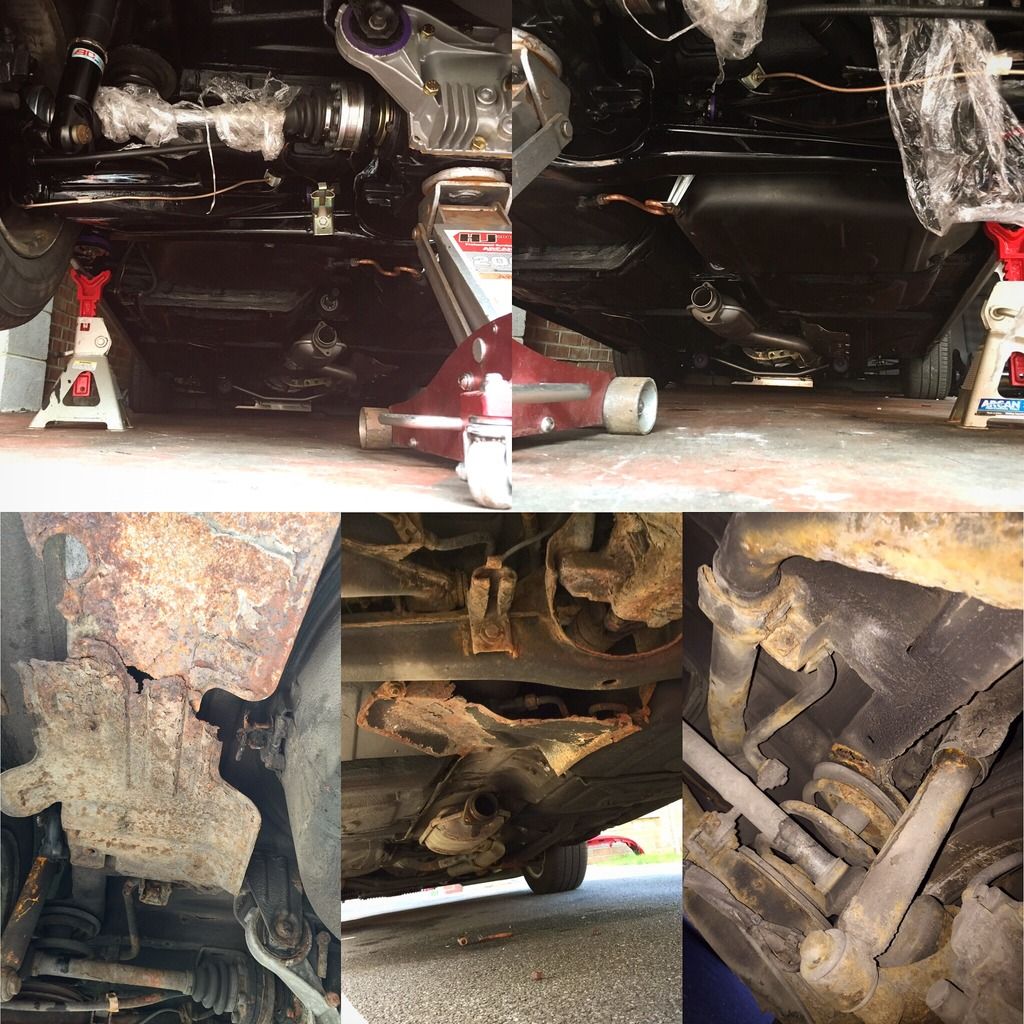

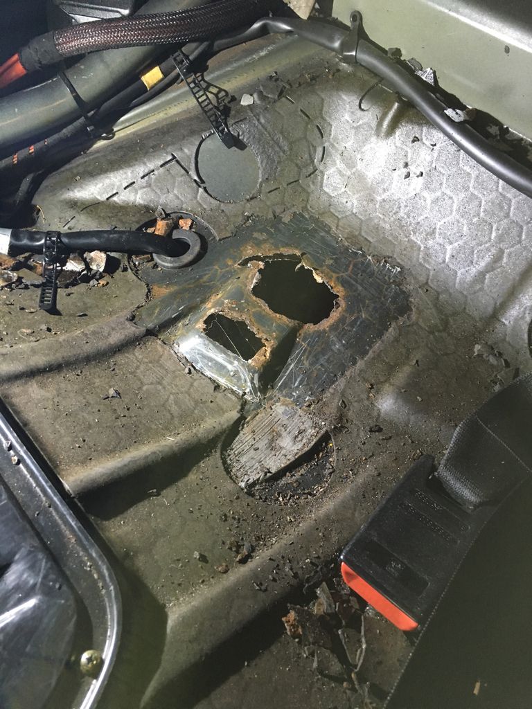

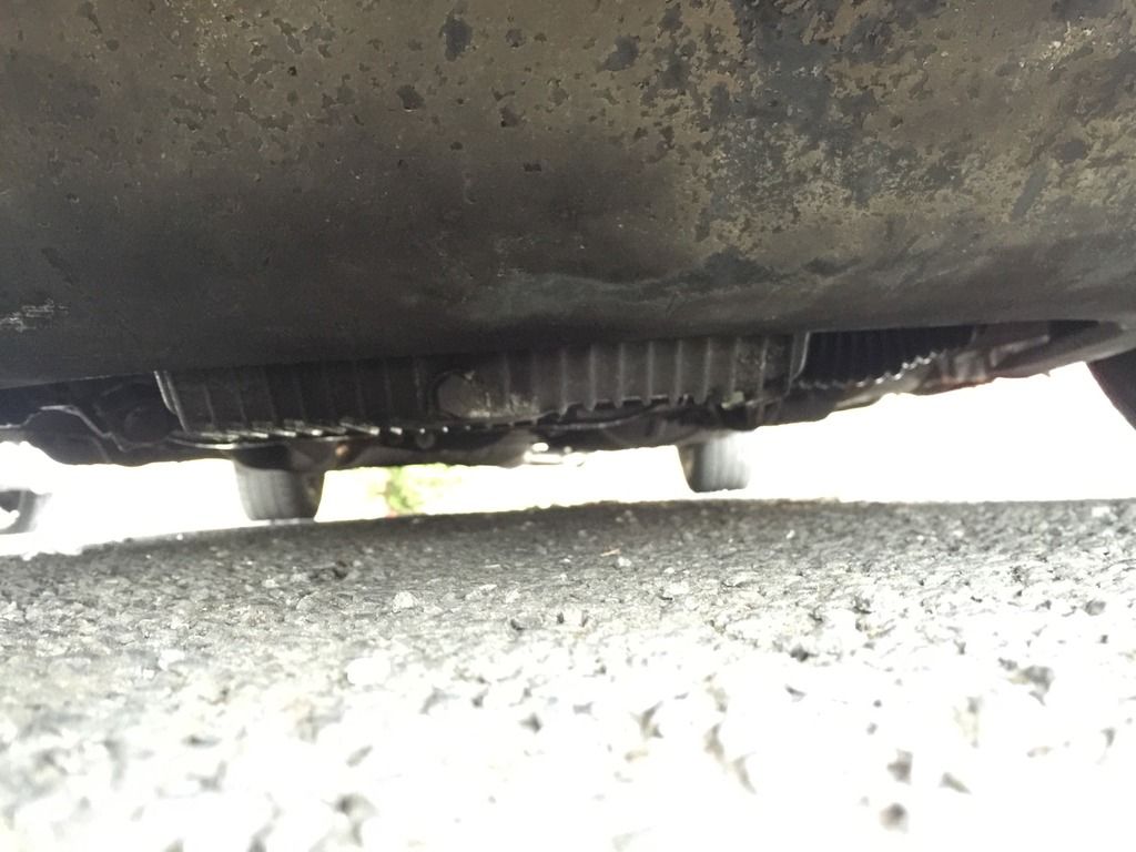

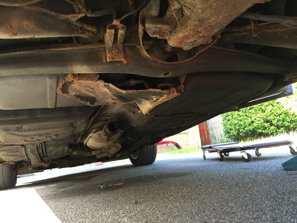

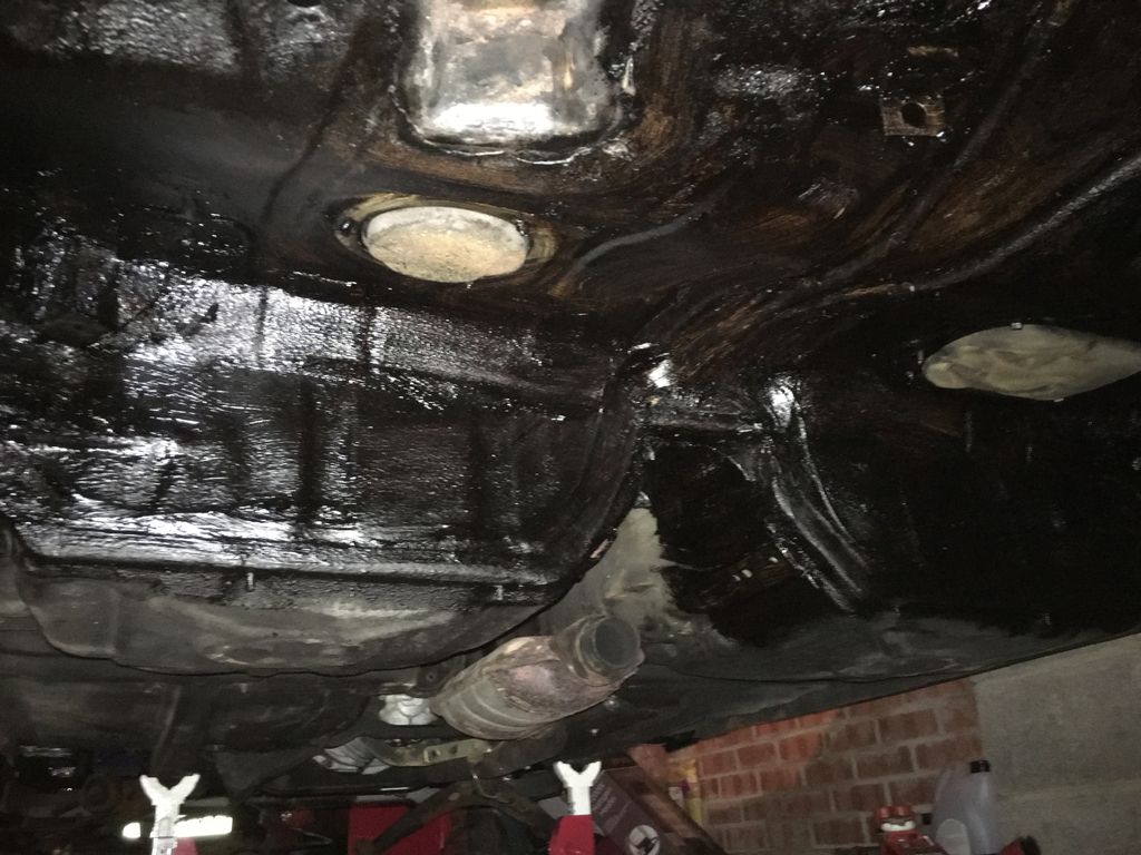

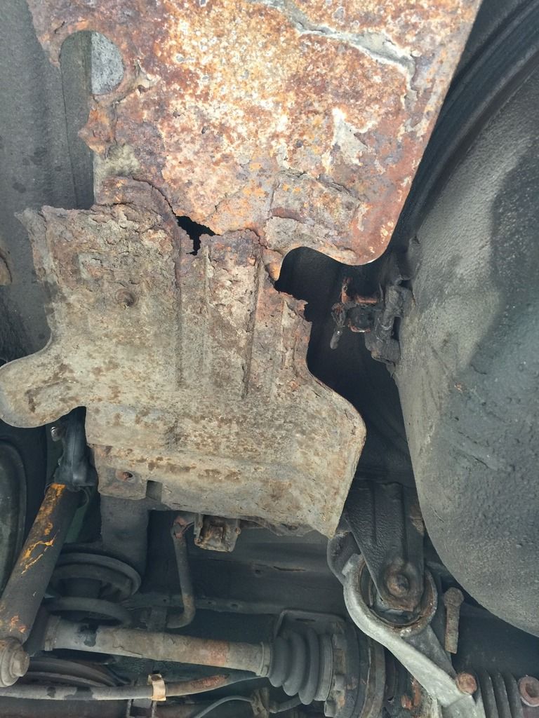

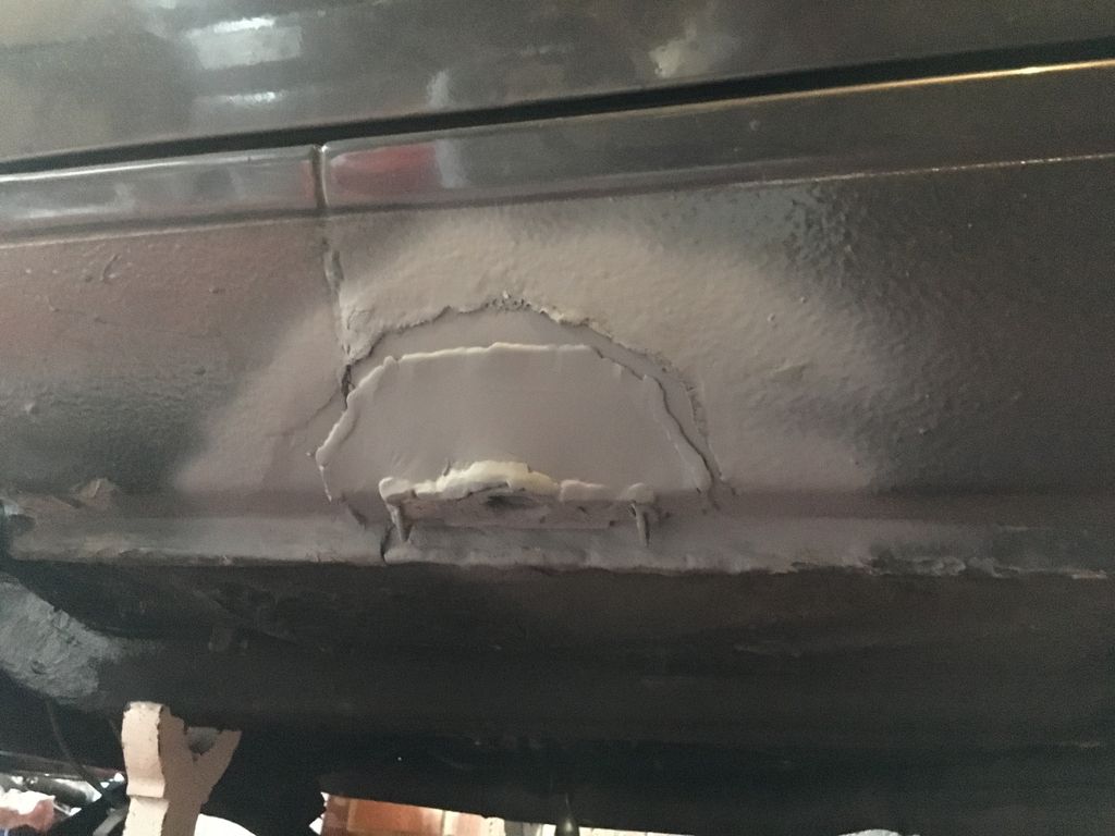

Then I looked underneath :(
And that passed an MOT!? somehow I don't think its a genuine one any more!

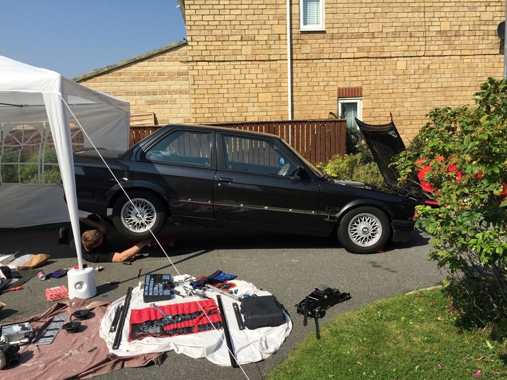

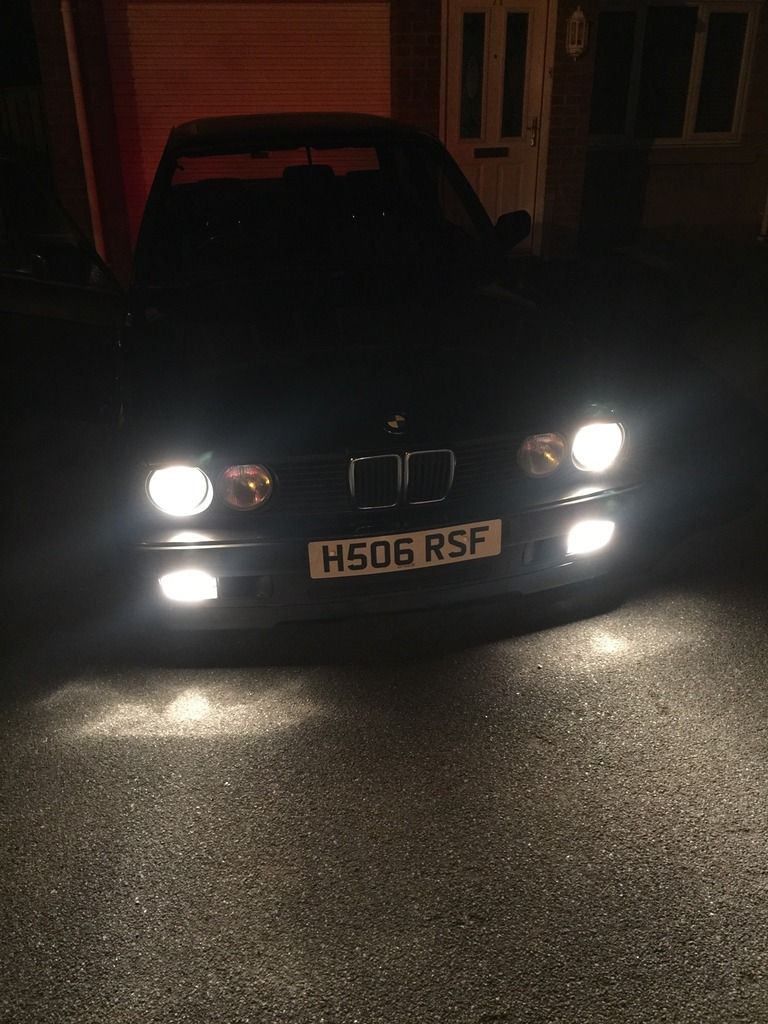

Fitted some fresh Osram headlight bulbs and foglight bulbs

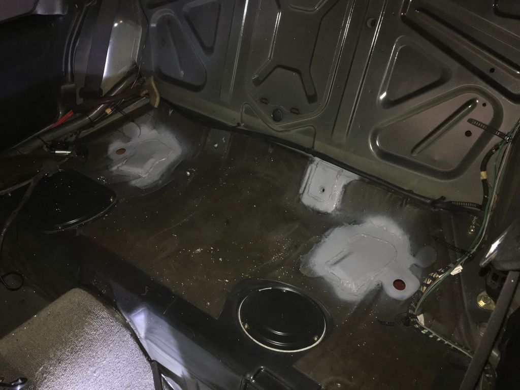

Did a bigger strip down
Cleaned under the arches and this is just the start of the crap coming off the underside!

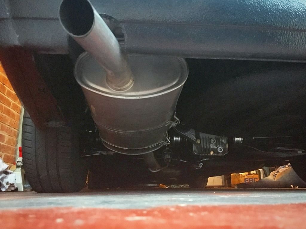

Started ordering more parts, one was my new rear section of exhaust

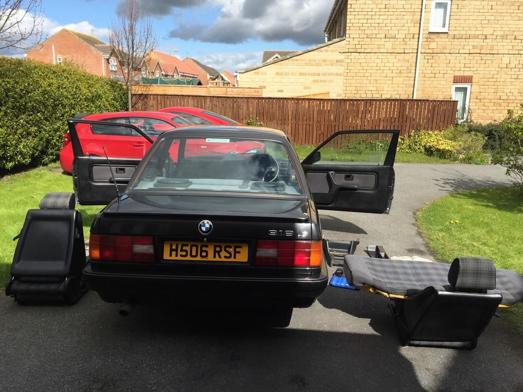

Disadvantage of rear seats not folding! It was very difficult making it fit in!

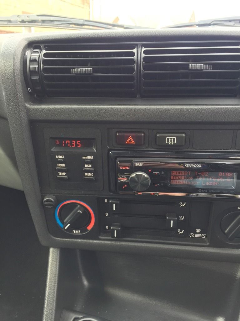

Got a working clock from Germany and changed over the face plate for my english one

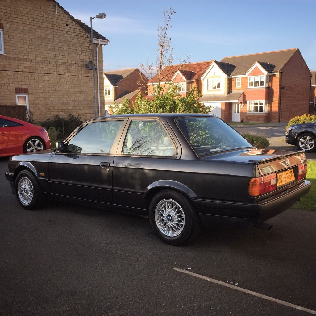

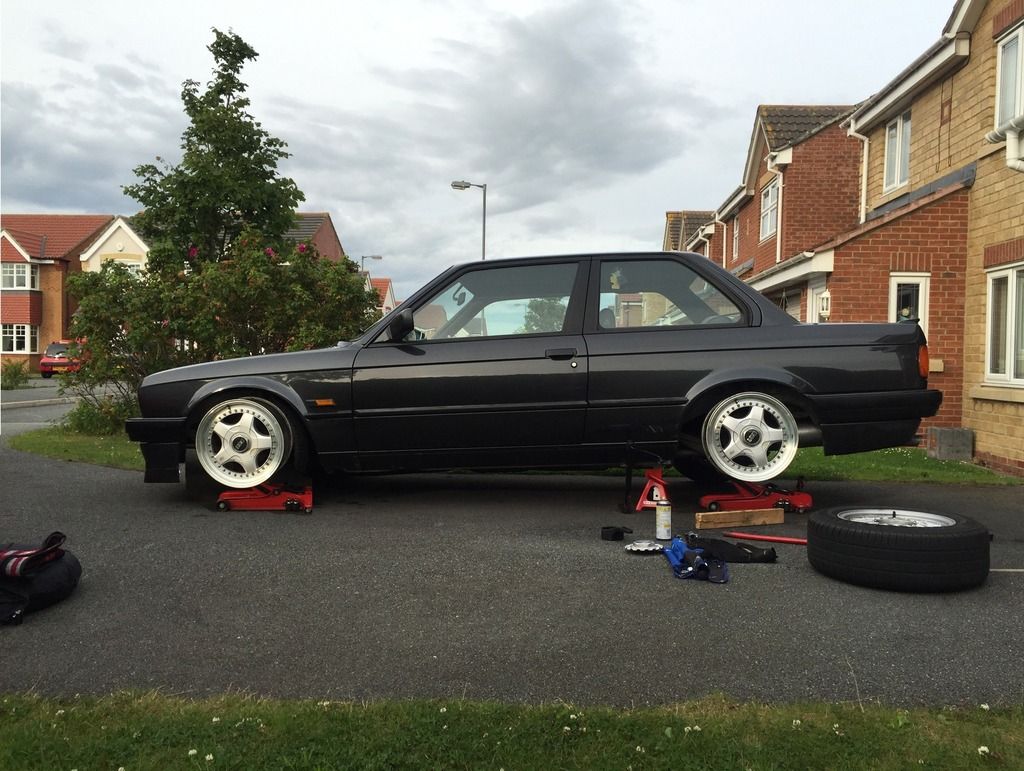

Did a little experimenting to see how my old wheels off my 1series would look, initially I was impressed, but they never went on
And another sunny pic ha

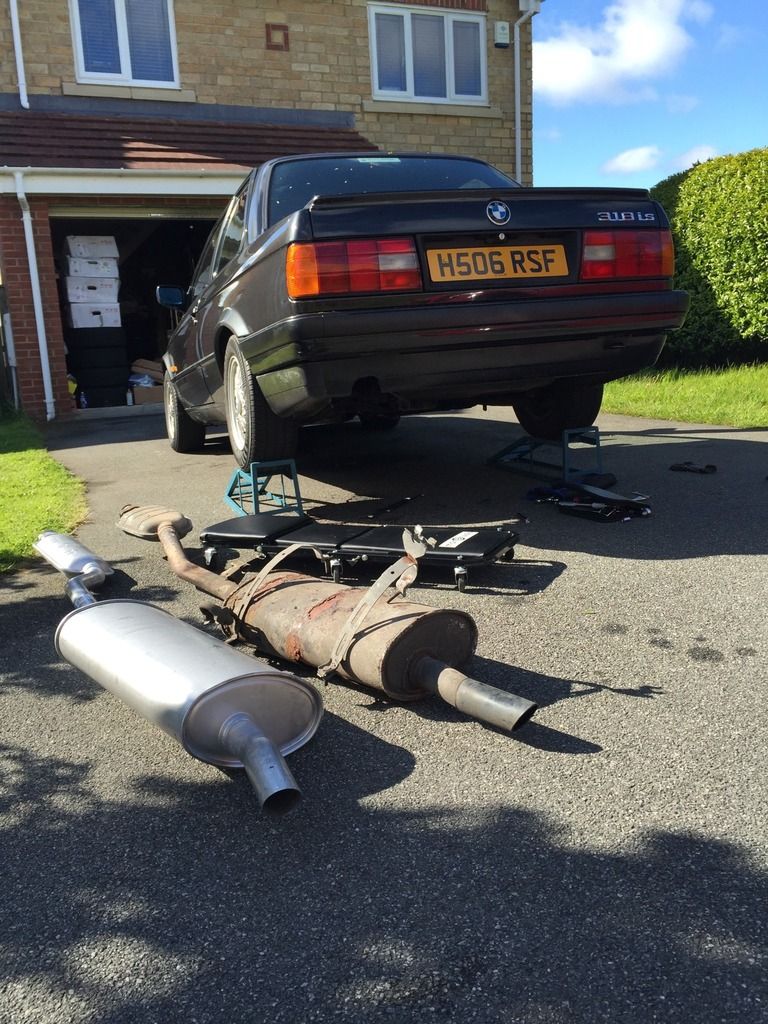

Then my birthday came and I spent the morning changing my exhaust
You'd of thought the car had been in the sea or something by all that corrosion

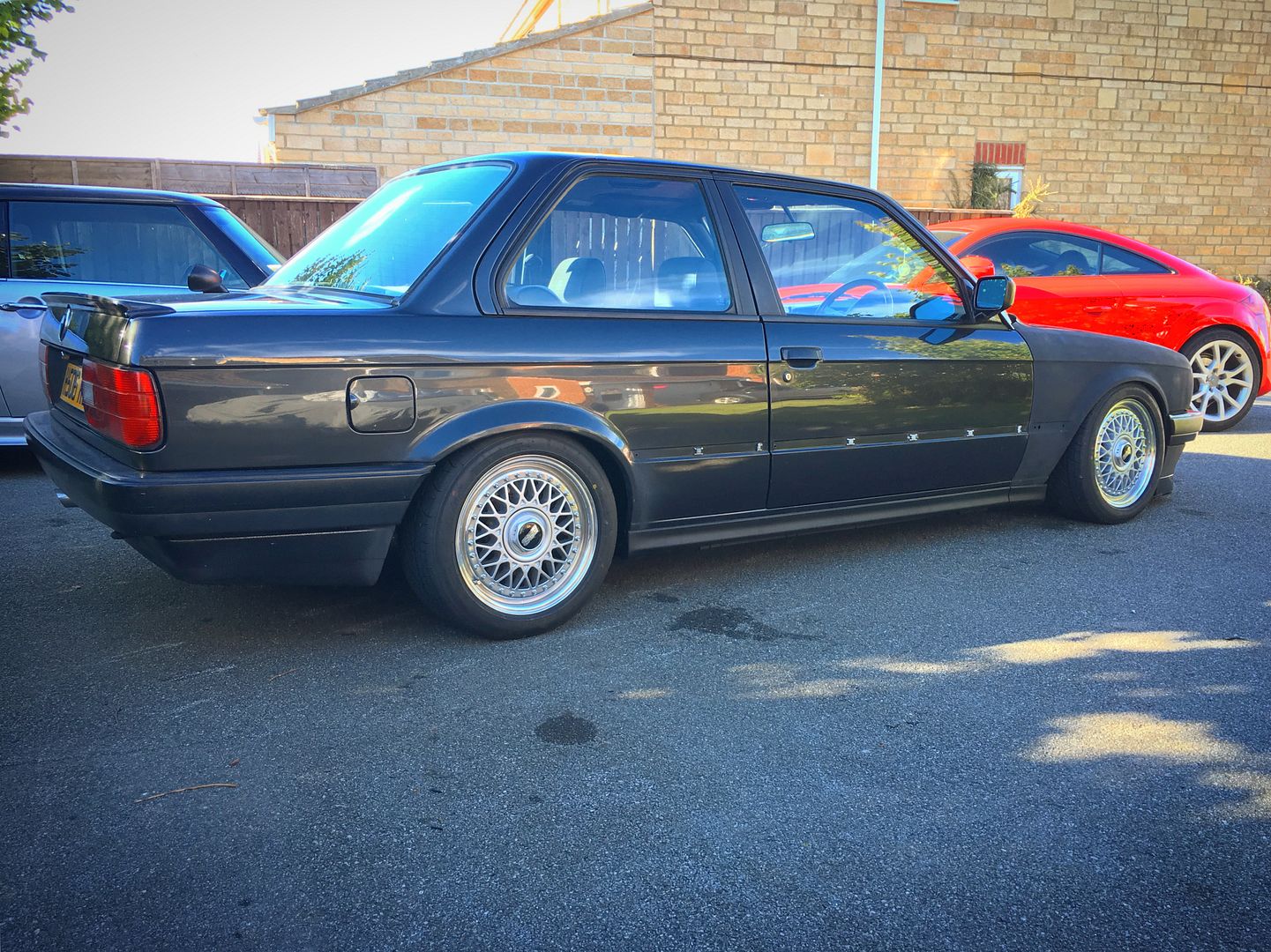

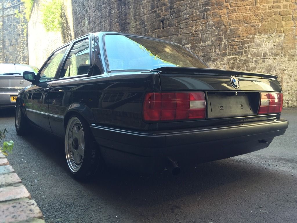

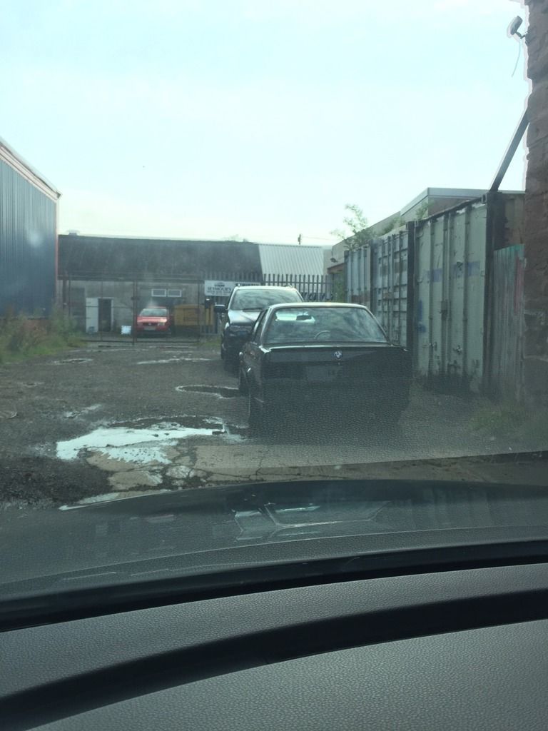

I drove the car down to ripon and met up with some friends, one of them also had an E30 so we took them into the barn for some pics

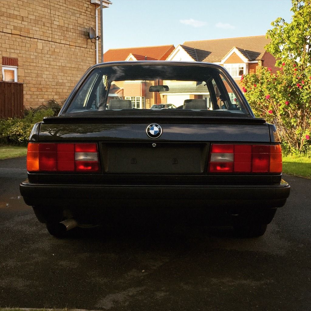

Then I decided to debadge the rear and then also another sunny pic

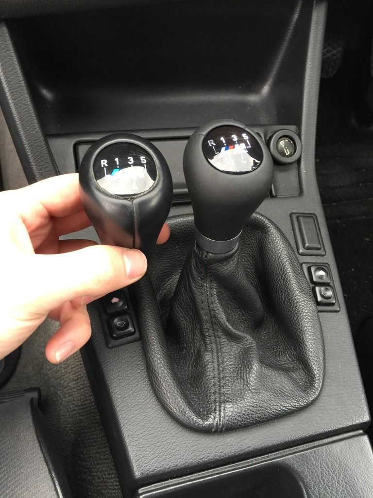

Changed my knob

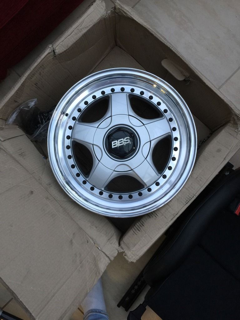

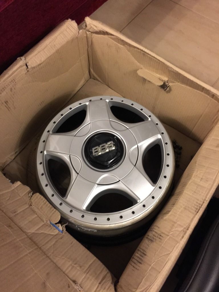

Imported some BBS RF's from germany

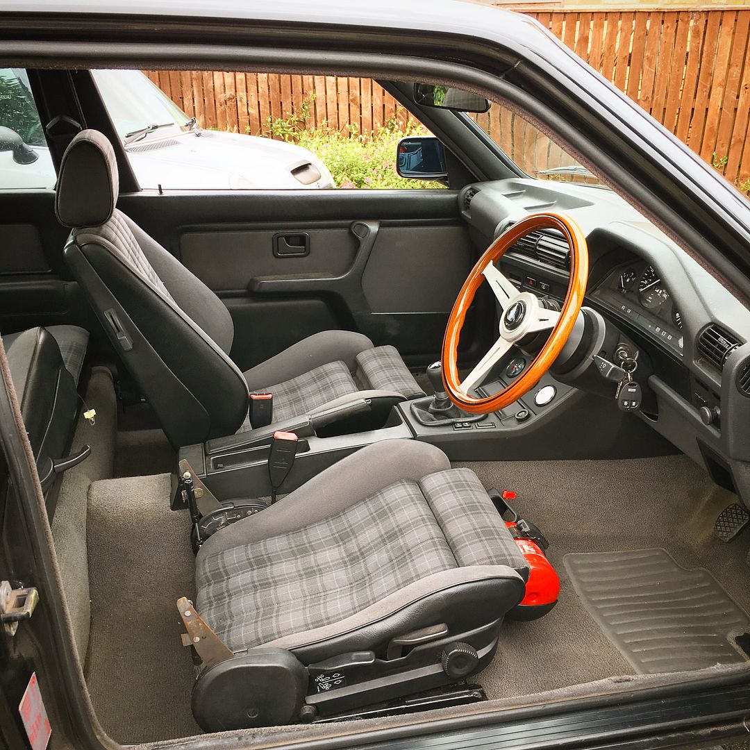

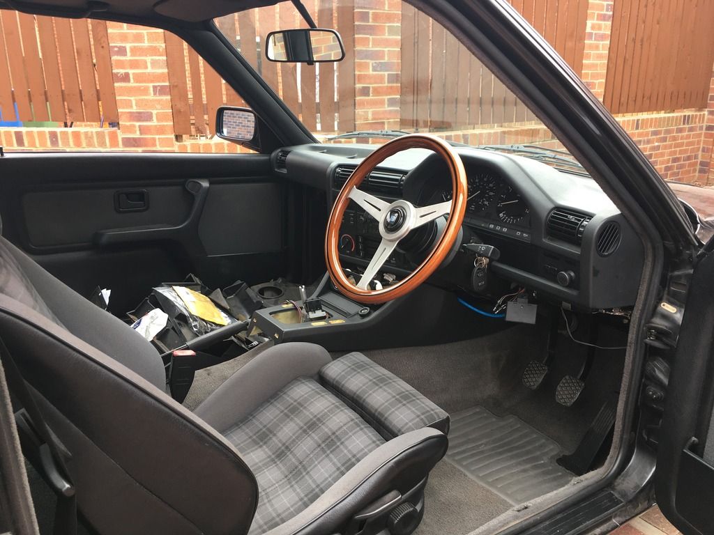

Got myself a nardi

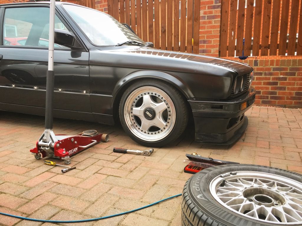

Test fitted the wheels
Got snapped at a car show dissembling my wheels to be refurbed

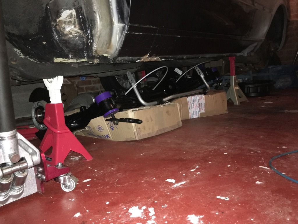

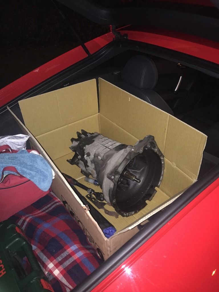

Gearbox came out for new clutch pack to be fitted, rear coilovers fitted and shortshift started to be assembled to fit... then the end of the night ended like this...
Gearbox needed to be send for a rebuild as there was play in the shaft, and a leak from the selector seal, the pressure plate wasn't flat, the thrust bearing was in bits, and the bush the fork pushes on was warn down to the metal!

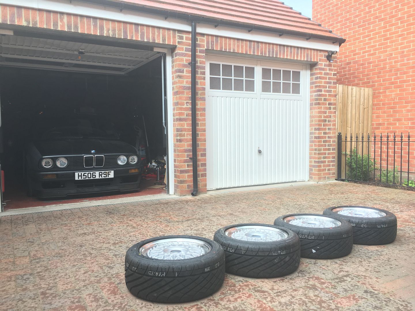

Got wheels back from being refurbed and rebuilt them
Got tyres put on, but two have leaks :( still need to sort those leaks...

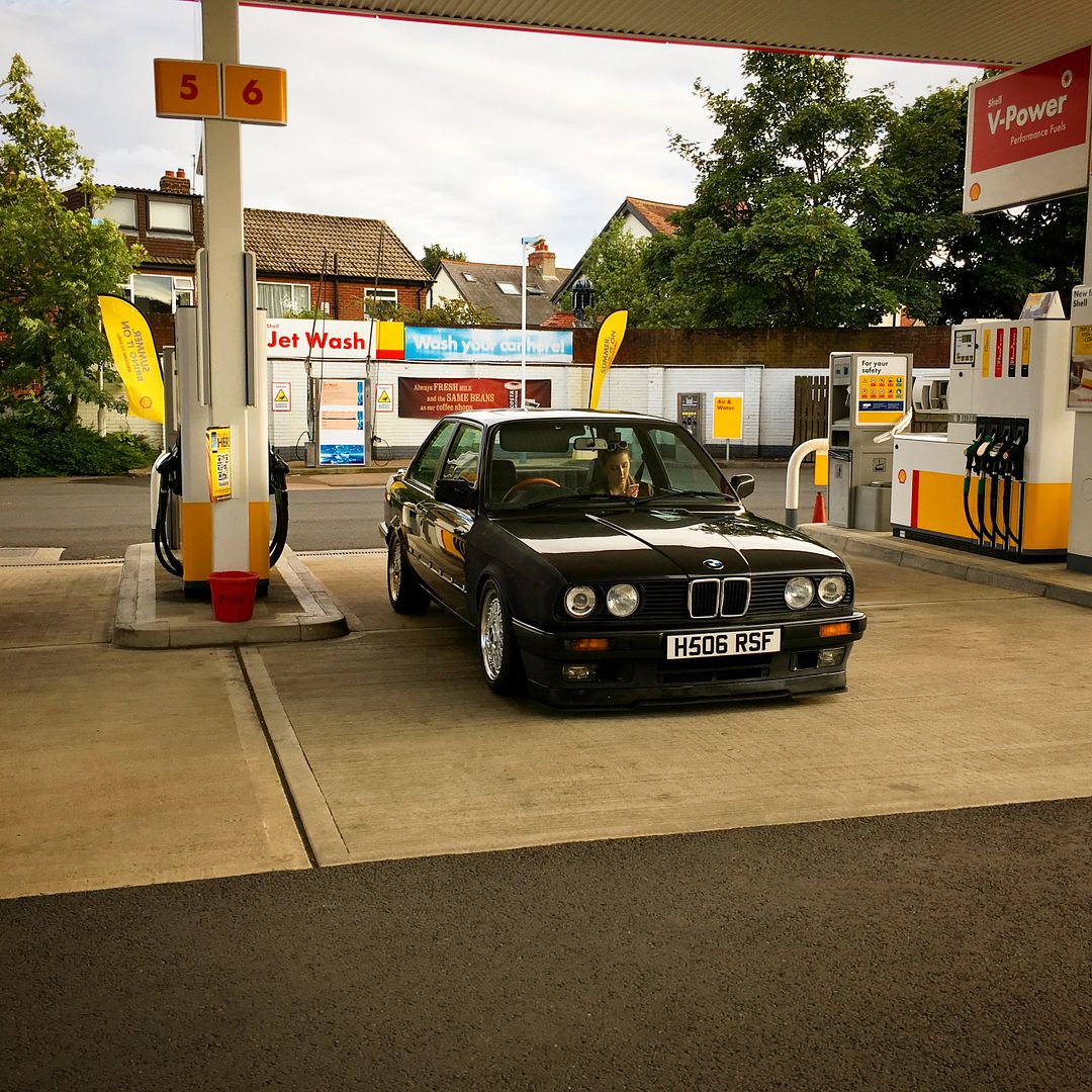

Went out for a meal, embarrassingly got stuck at the entrance, had to get out and remove the splitter and hold on to it out the window! (When I looked a few months later, looks like a scraped the subframe too given there was some fresh yellow paint on it
Clearance isn't great for the m42 engine!

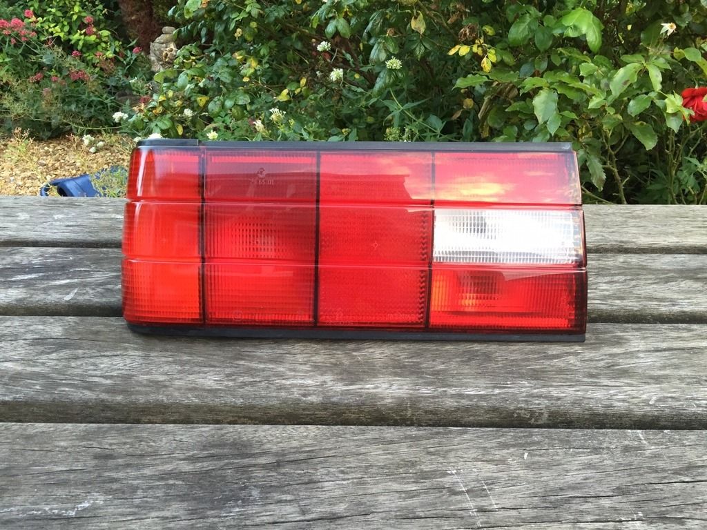

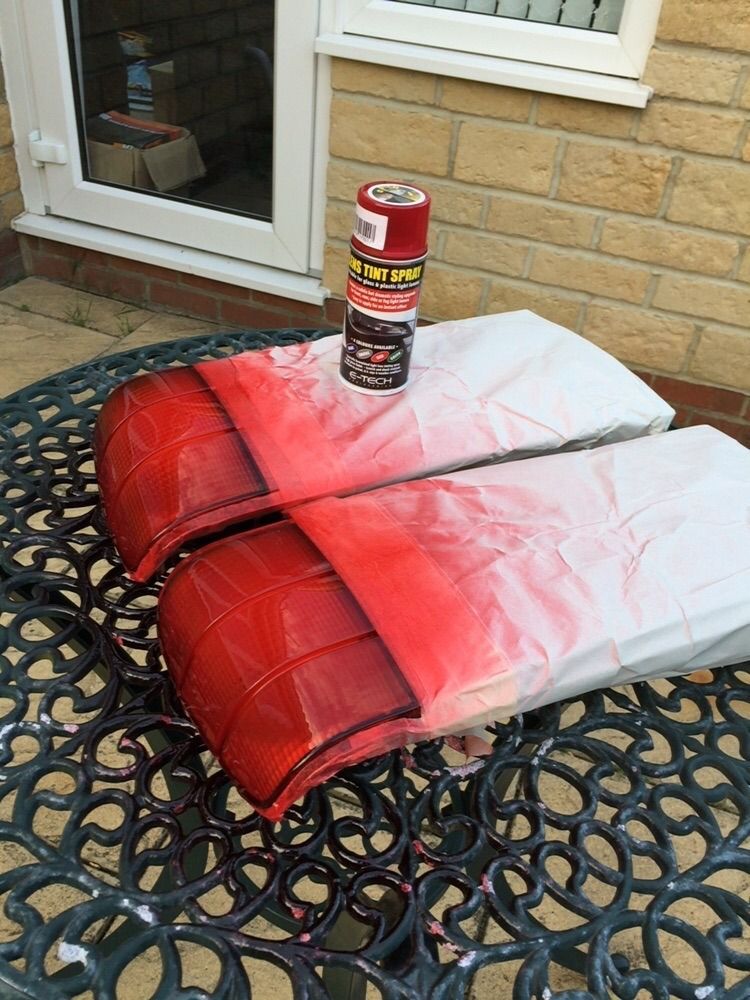

My mate came over and helped, he sprayed some rear lights for me, mine with cracked had water in etc and I wanted a subtle change to the rear

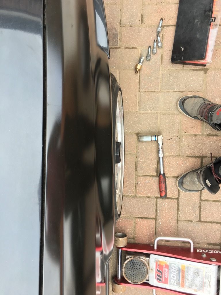

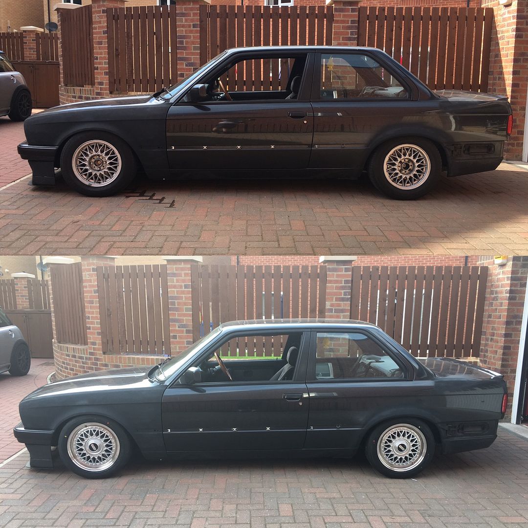

I also started to put the RF's on and realised I had cocked up with the adapters! I wont go into that though...
Then even though I cocked up, left the rear RF's on and took the car to work the next day on odd wheels

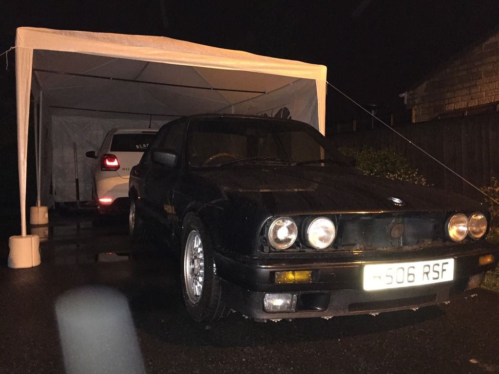

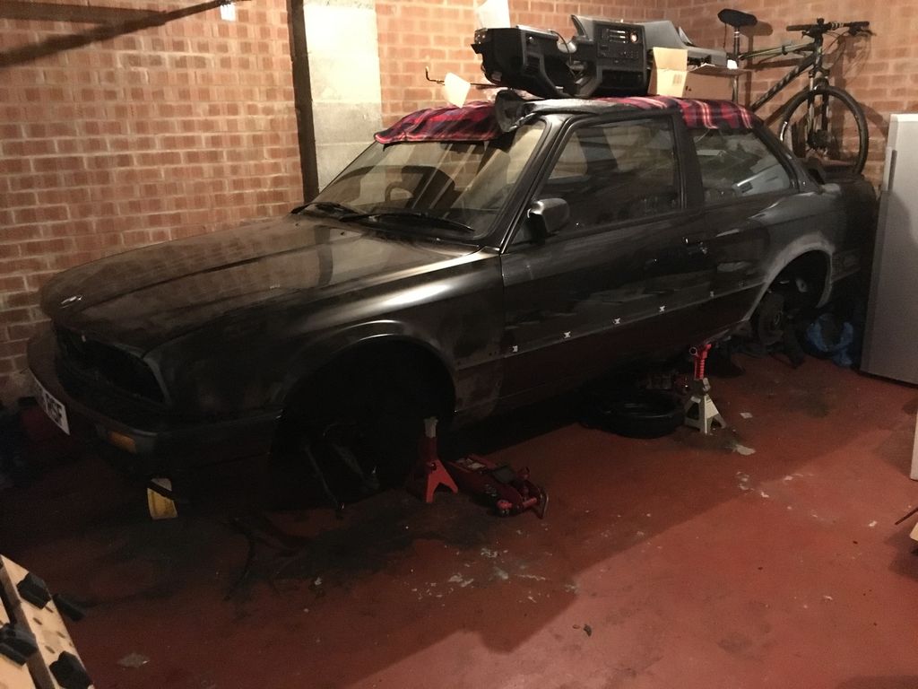

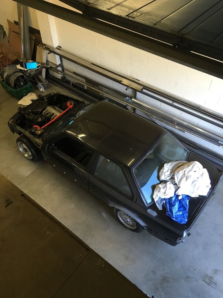

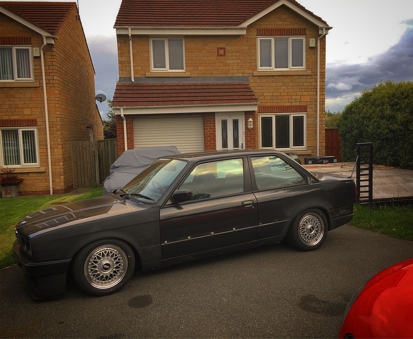

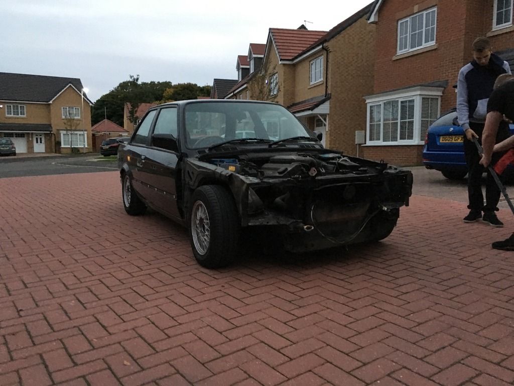

So the E30 started to get stripped down for some welding it required despite what the MOT said...

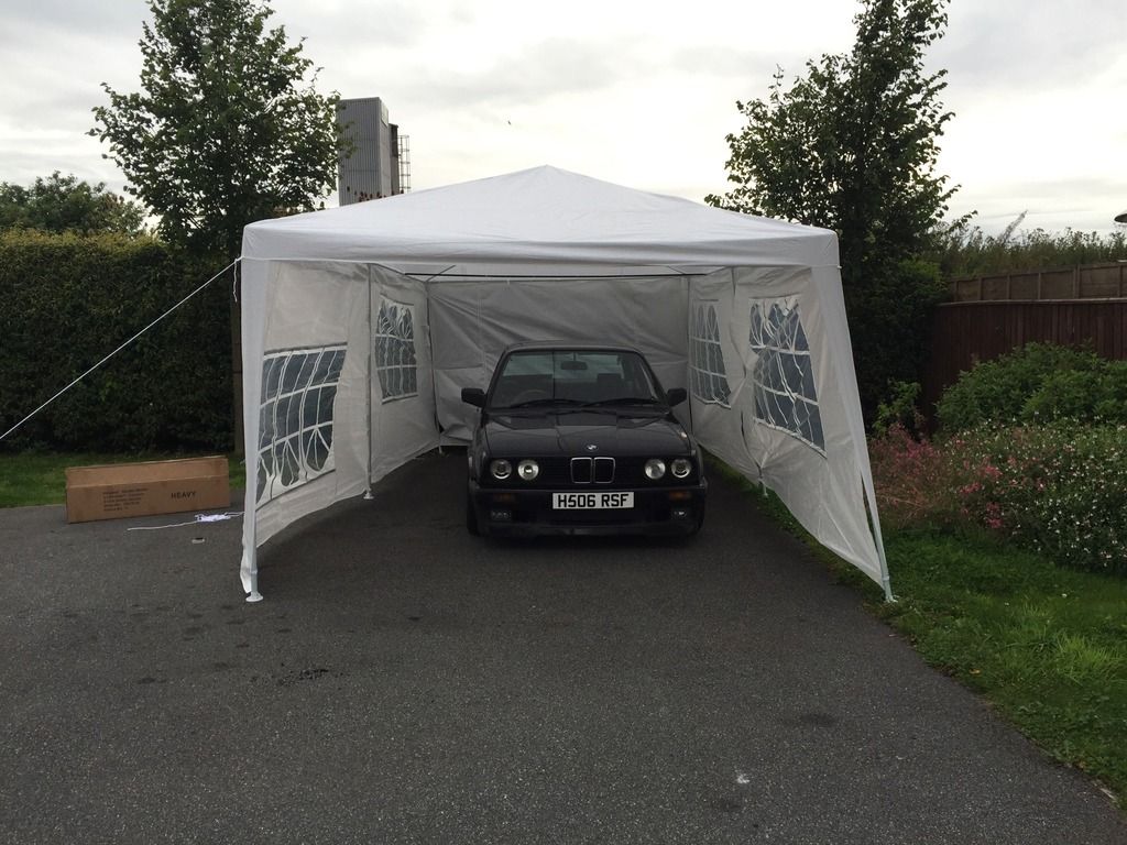

Bought a gazebo to help with cover, once we finished the stripping it was sent back as it pretty much fell apart - but it was still good given it decided to rain for a full week!
Whilst it was being stripped, we also fixed my overheating issue, turns out the fan clutch was knackered so a new febi one was fitted!
At the same time my 1er was being split to be sold

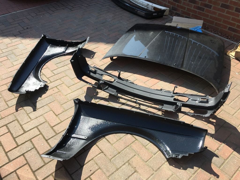

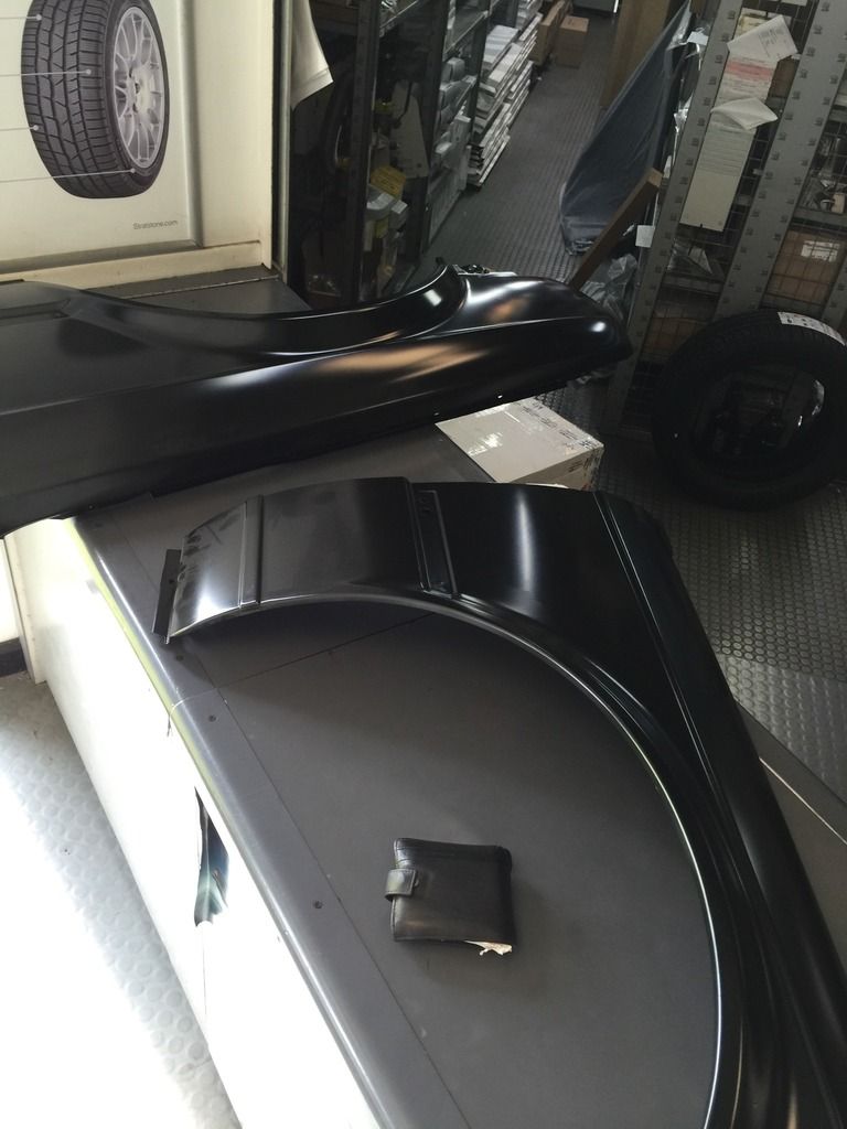

When the car was away took my daily trip to BMW and picked up some fresh wings! US spec 8)
And then I went to go and take a look at my E30 when it was stripped down for its surgery
6weeks later I got the car back and took it to its new home at my mums since she had a double garage

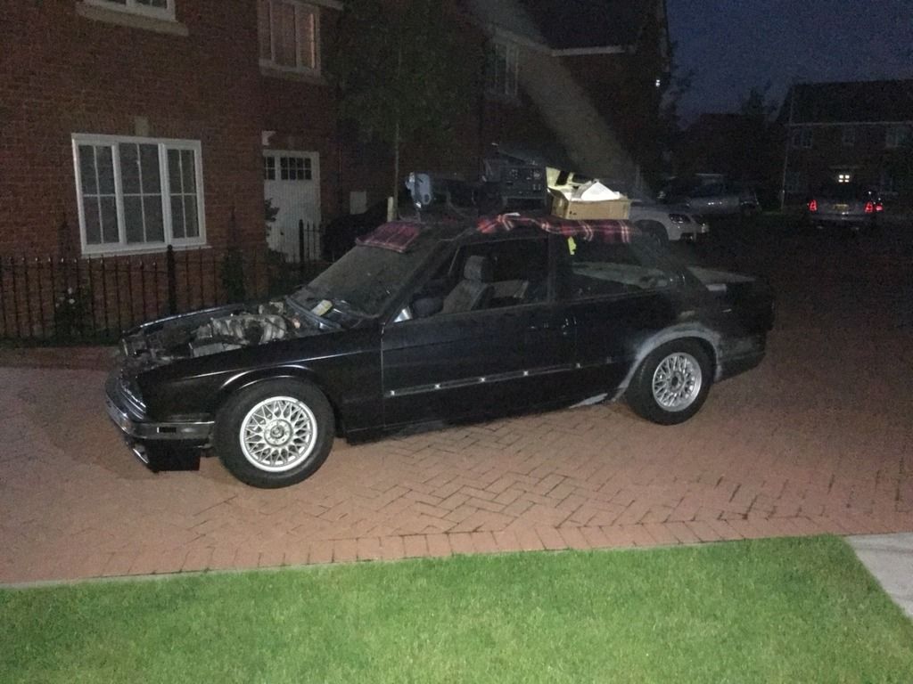

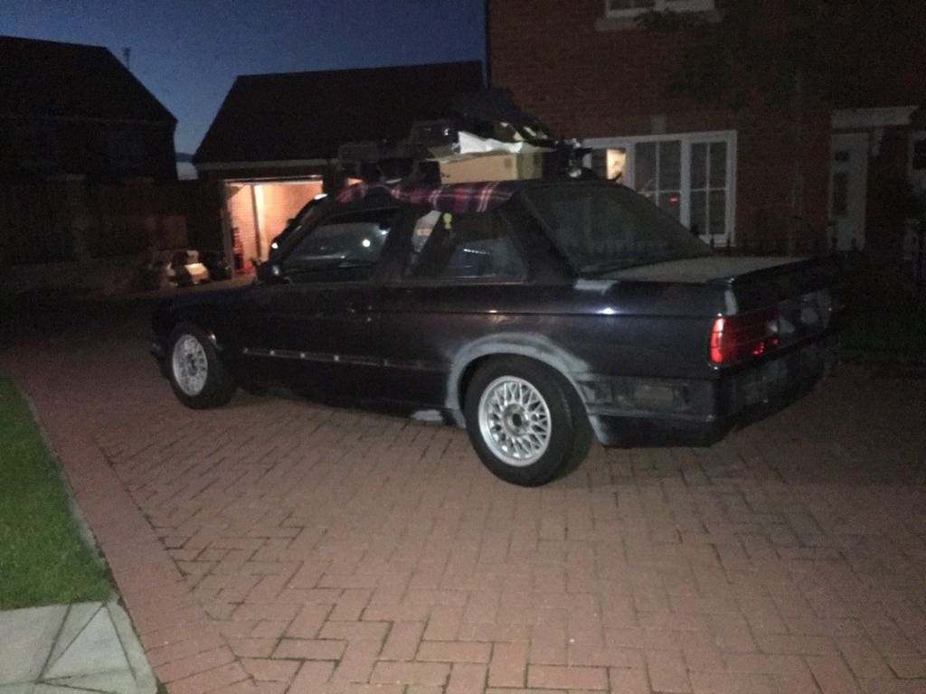

Then I went away to Holland to go to 100% Tuning (car show) with mates and on our way back home stopped off at BMW to collect my next batch of parts
Mainly bumper plastics, AC spec front valance and new sunroof!

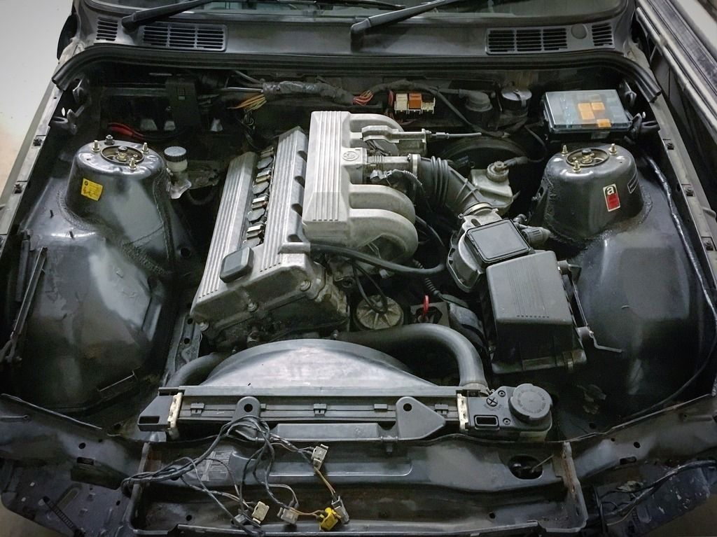

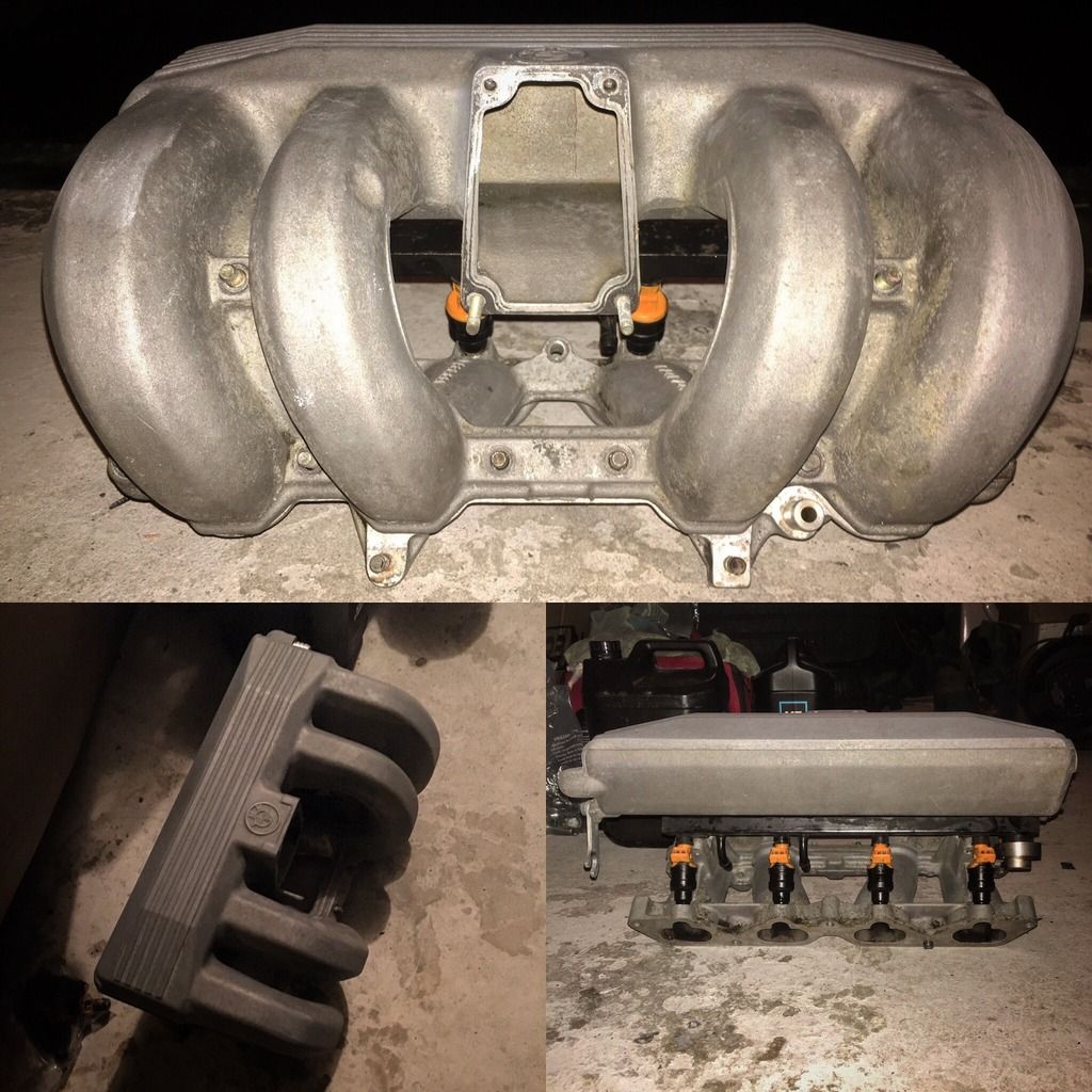

Stripped down the inlet to check coolant pipes, delete the throttle body heater, and install mustang injectors
All rebuilt back up, but the valve cover hose is too big so a smaller one was ordered

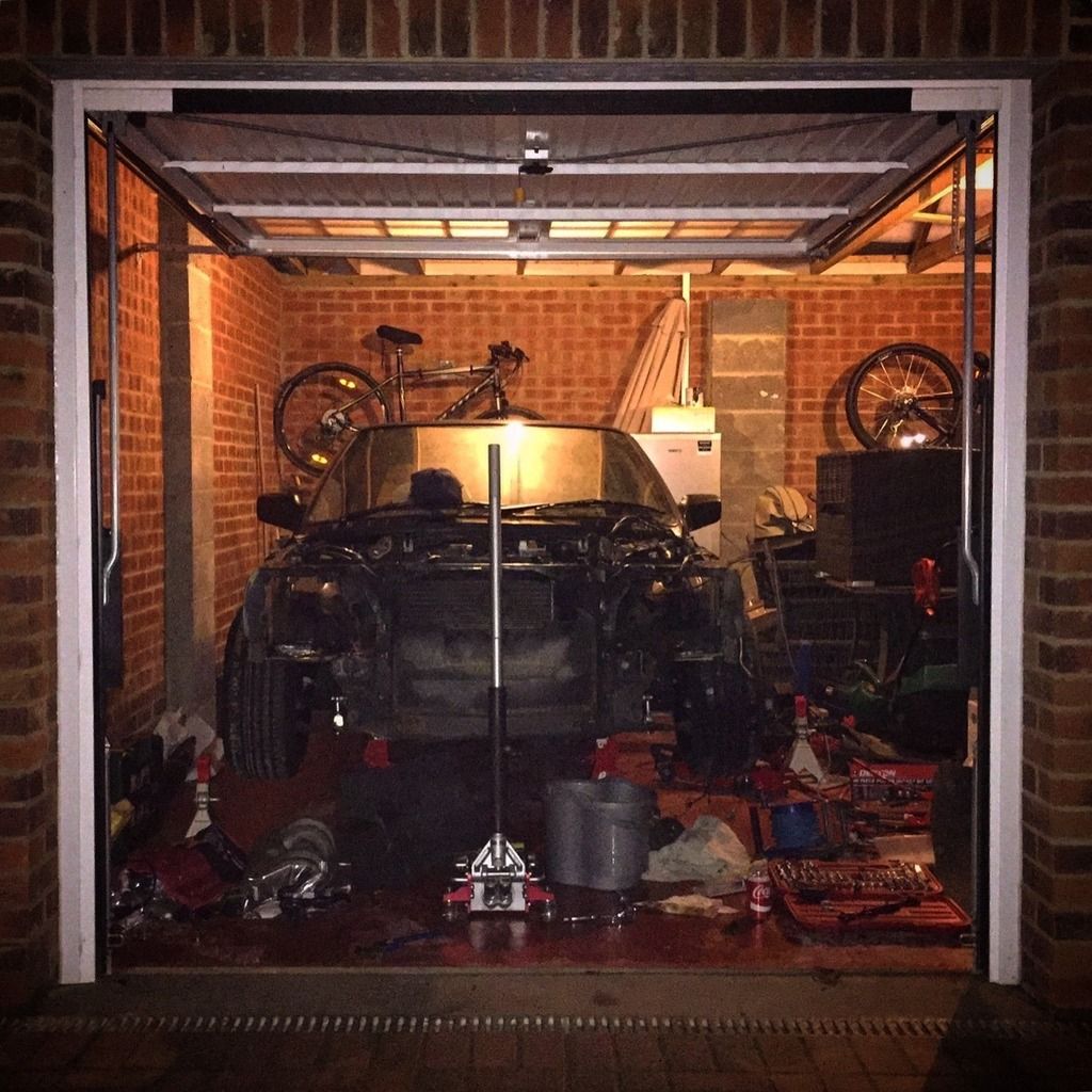

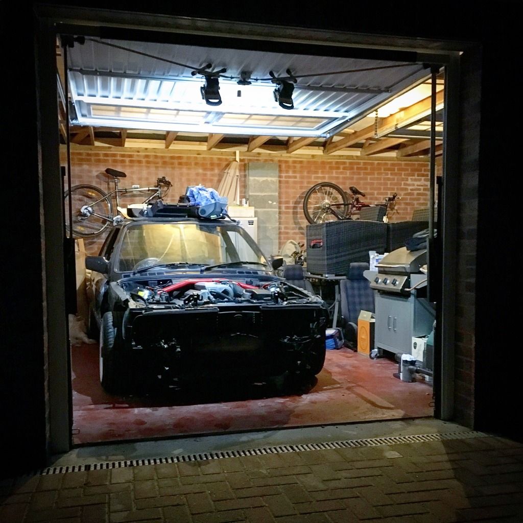

A night shot after a long night working

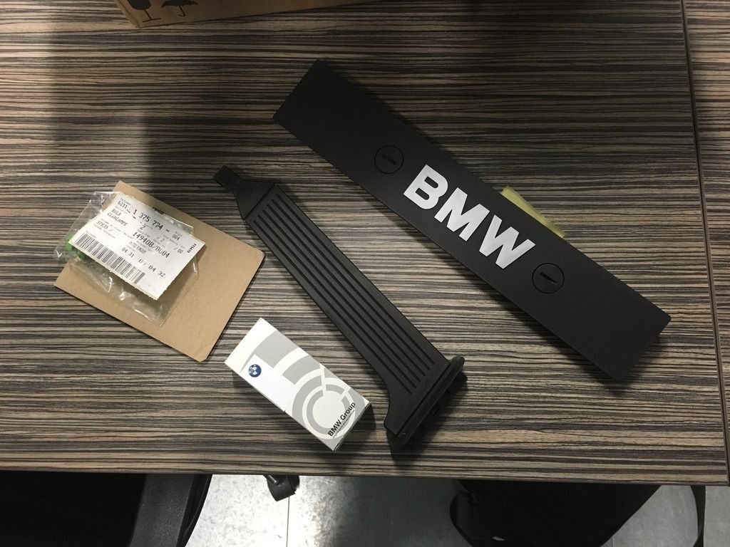

Some fresh parts bought from BMW in germany as the accelerator pedal wasn't available to buy in the UK!

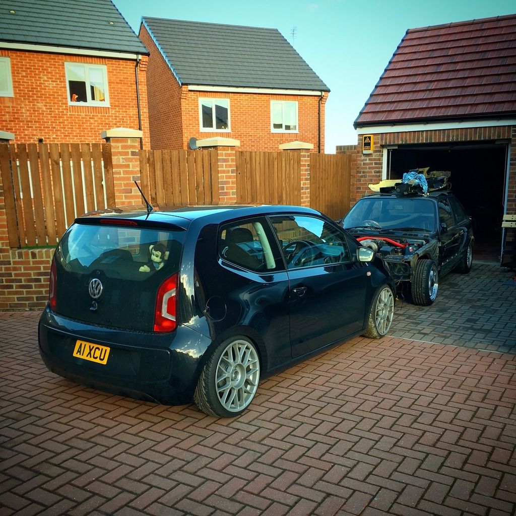

The new daily, massive change compared to the 1er, and not in a good way - major cheaper running costs, but everything else is crap.

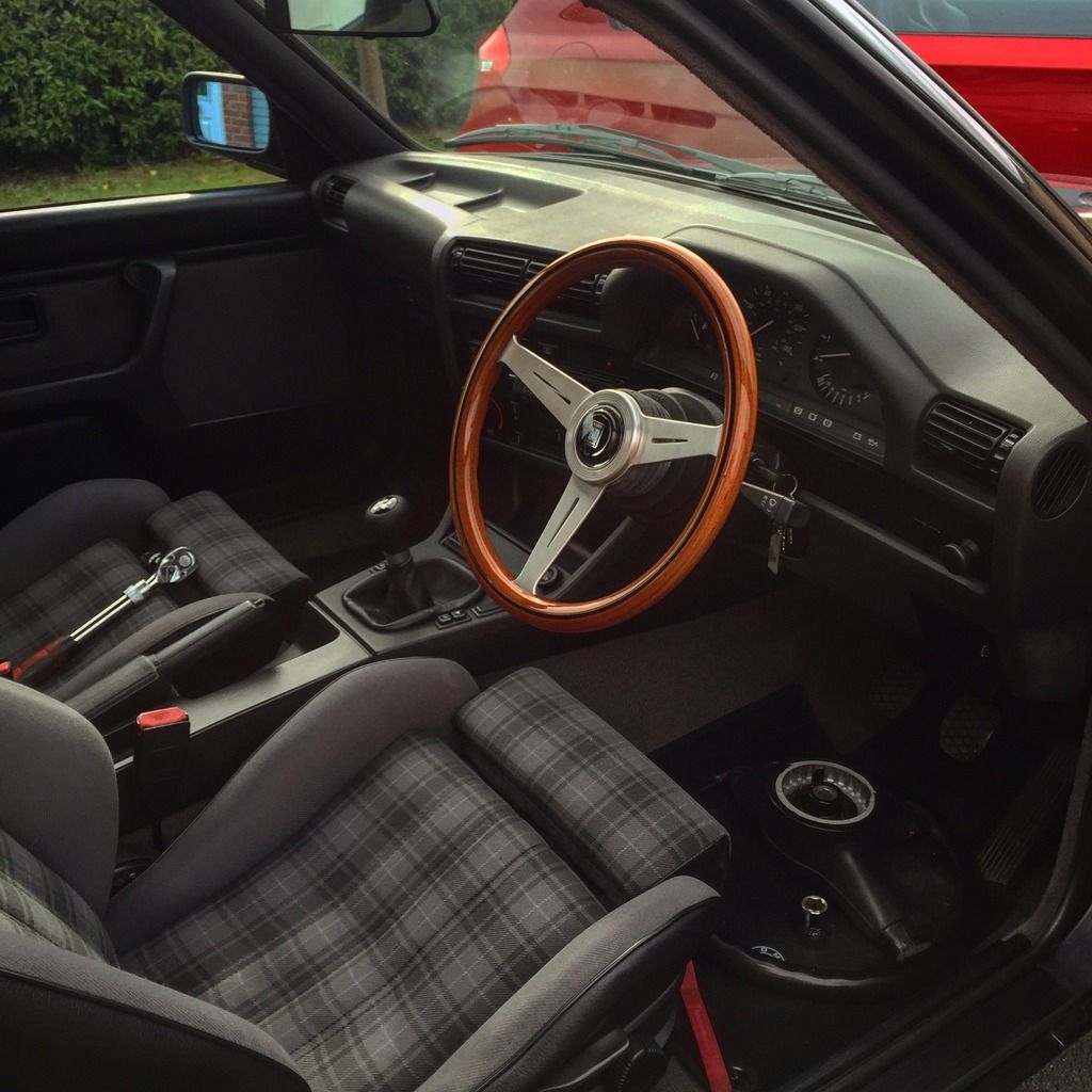

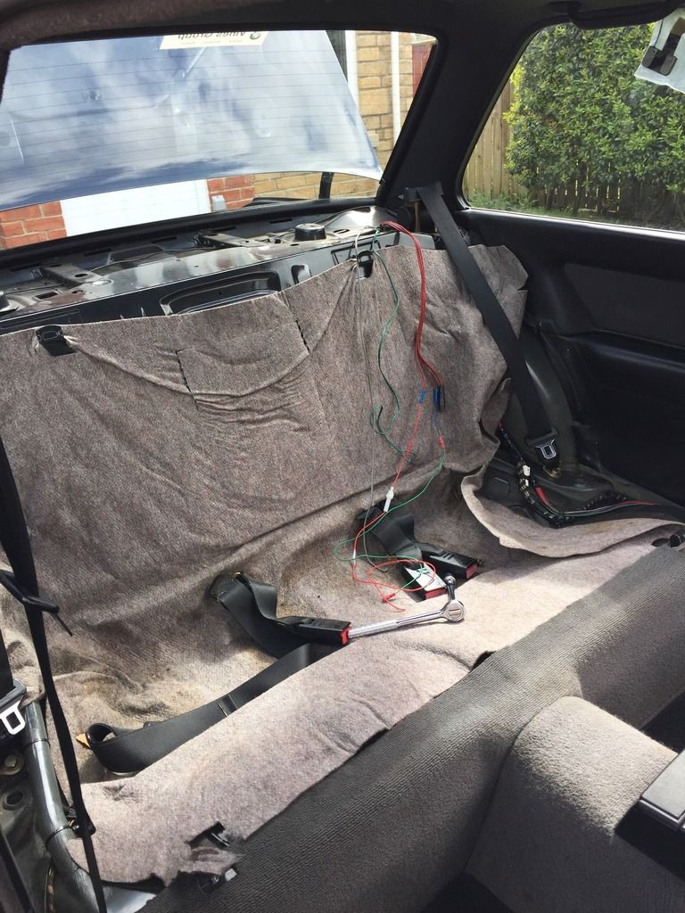

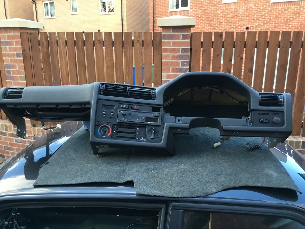

Started rebuilding my crack free dash I got, moving over the wiring loom, fitting an OEM radio I picked up in Bradford
I decided I wanted a quick release for my nardi, so I imported an NRG boss and quick release from the US

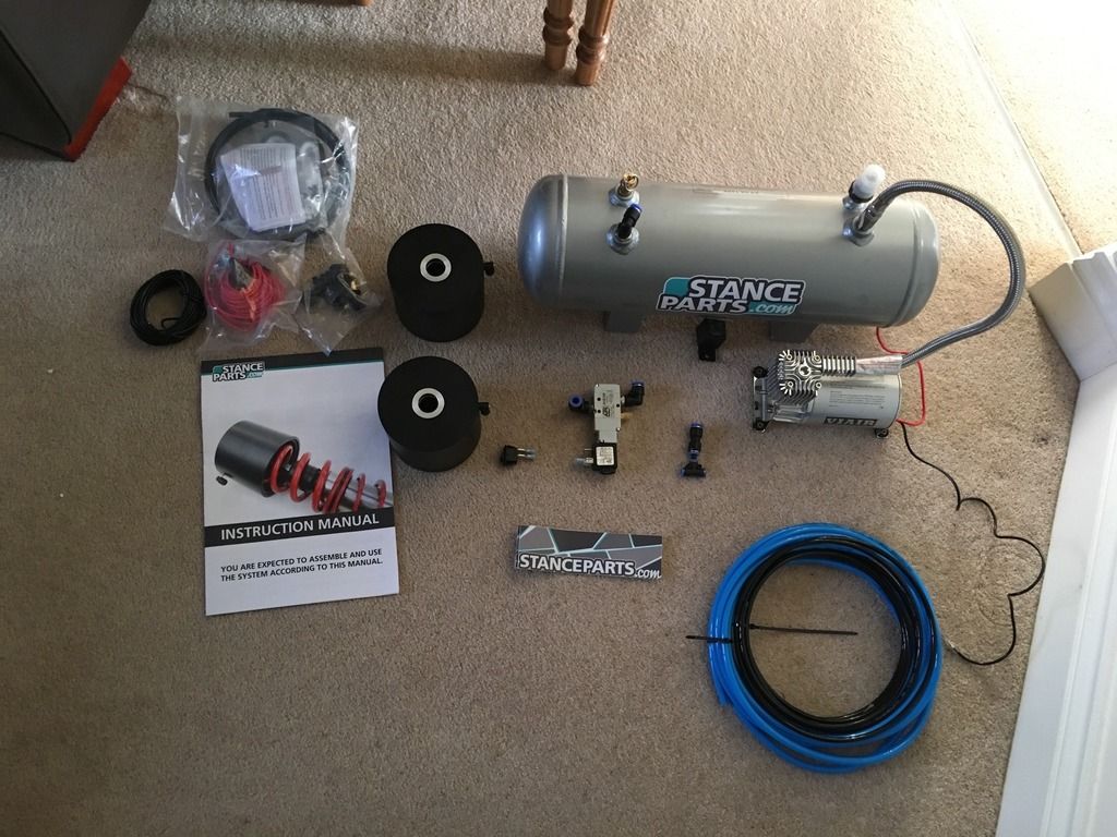

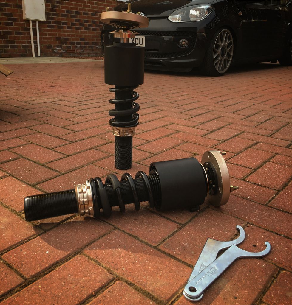

And then also decided I wanted aircups to fit to my coilovers to give me better clearance at the front over speedbumps etc

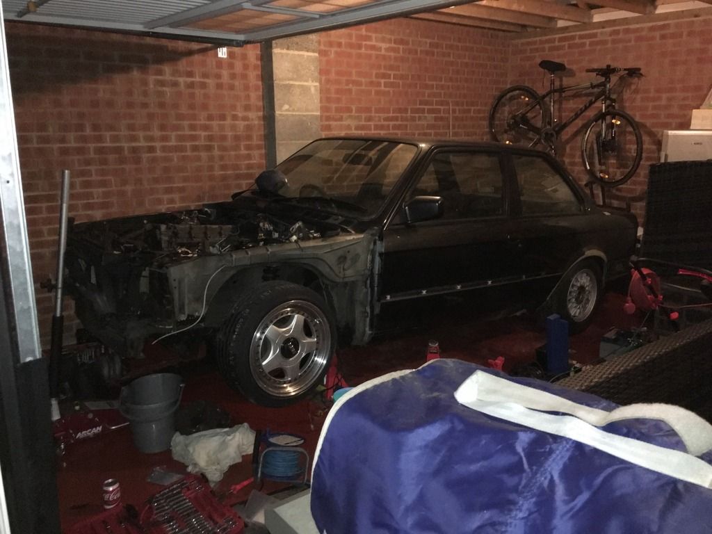

The E30 then made a trip to my brothers unit for my dad to do some welding for me, when I started dissembling the car more I found a few areas where rust had been missed!

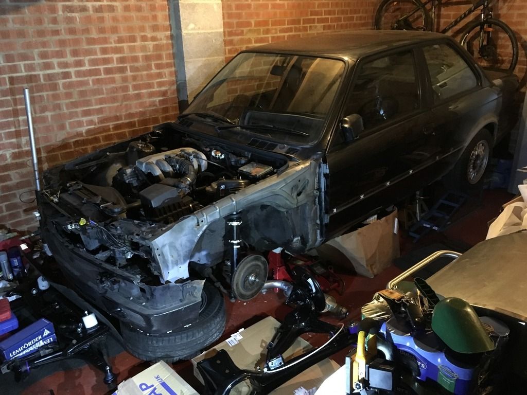

Then when the car was away I ended up buying many many parts and using the garage space to start building parts of the car

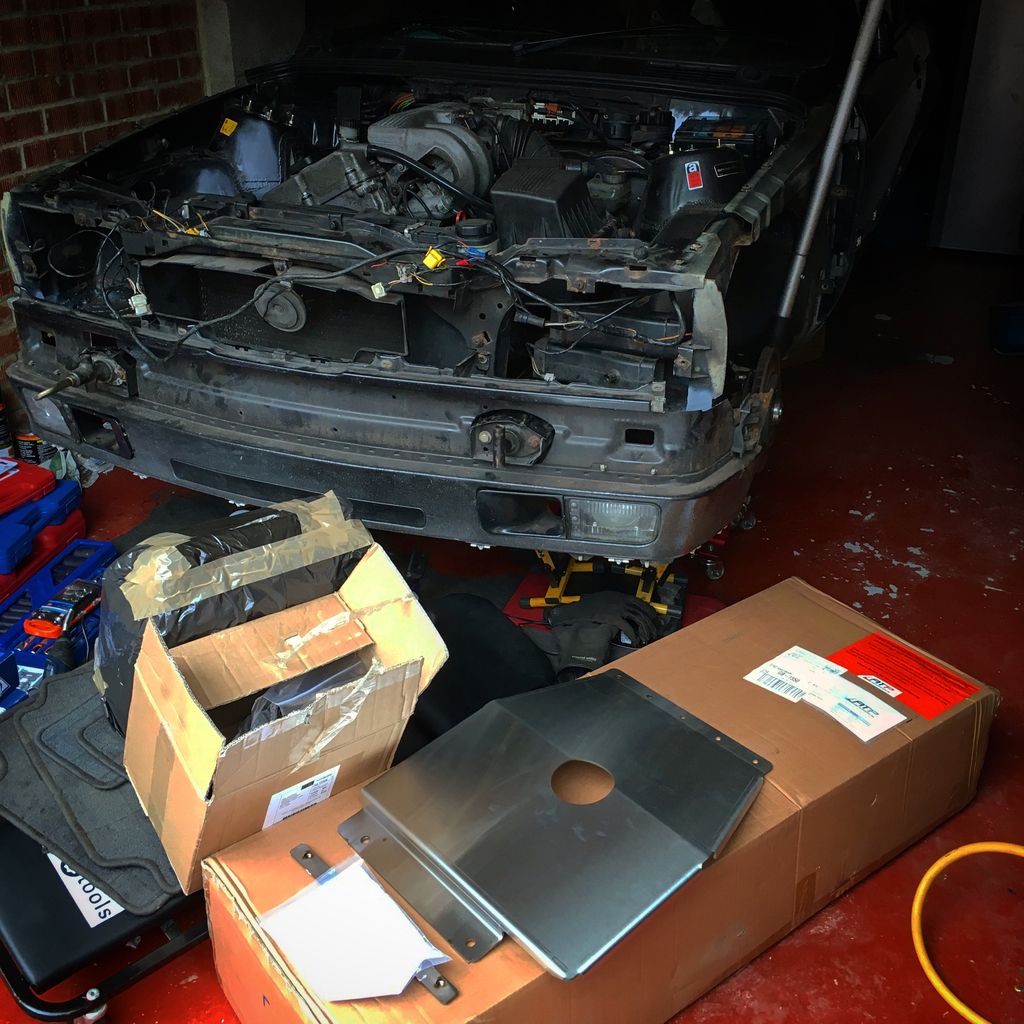

I went over to go and see my E30 and finally got round to fitting my cop conversion plate and got my dad to chop off the old brackets
Can also see the E36 battery relocation to the boot too, I forget how much I've changed!

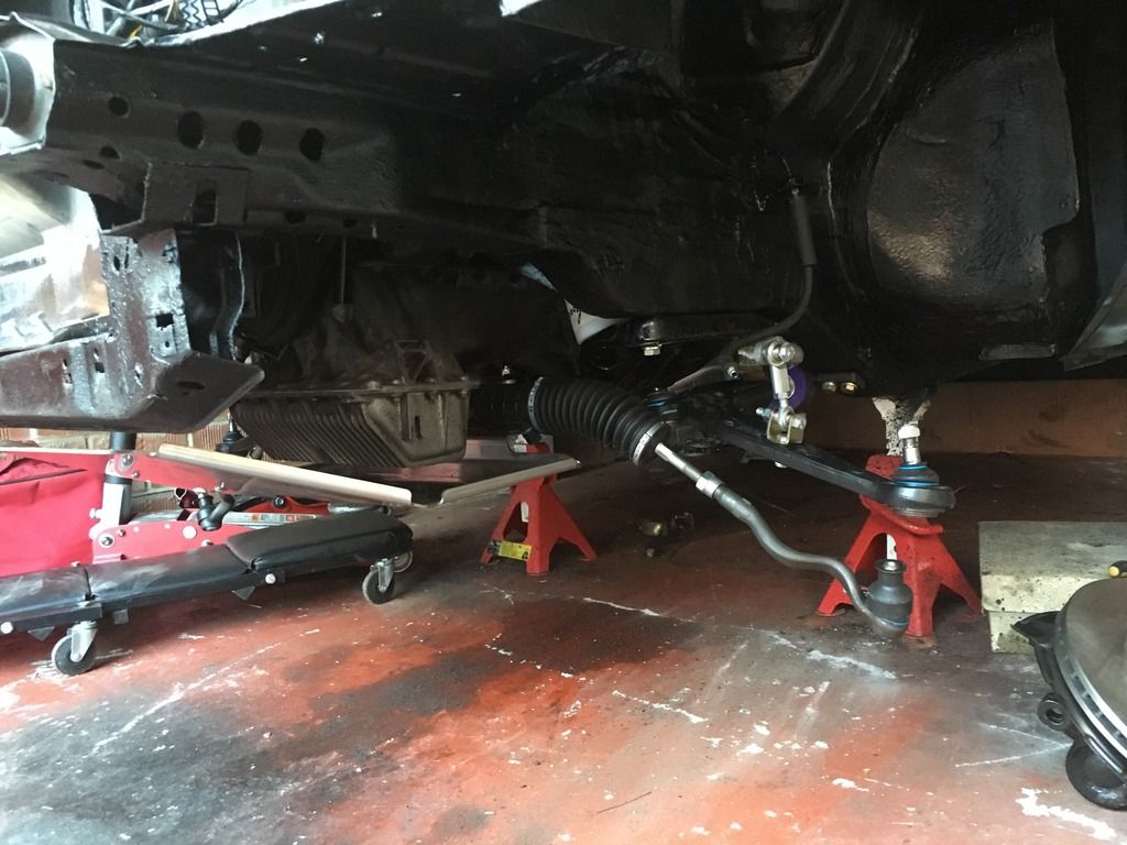

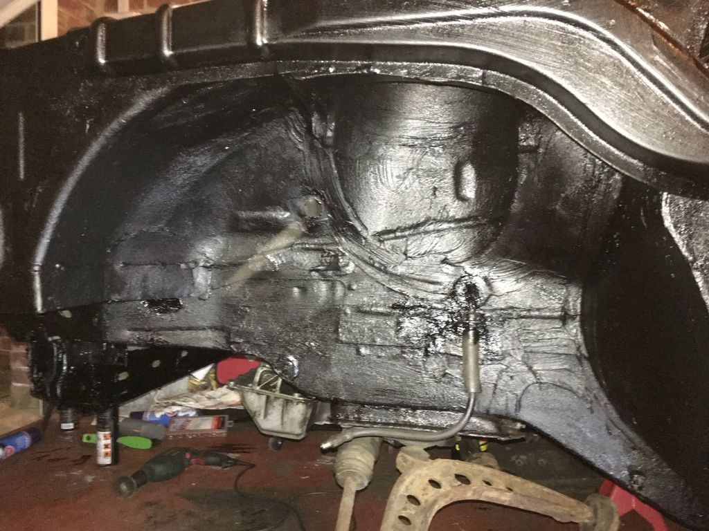

The E30 then went back to my mums to start the underside complete strip down to paint the whole underside and fit new/power coated components

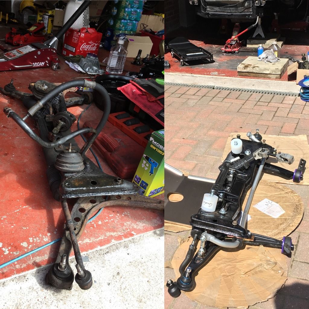

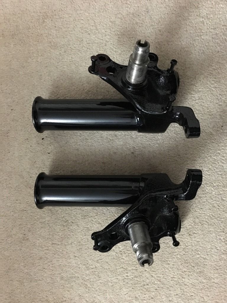

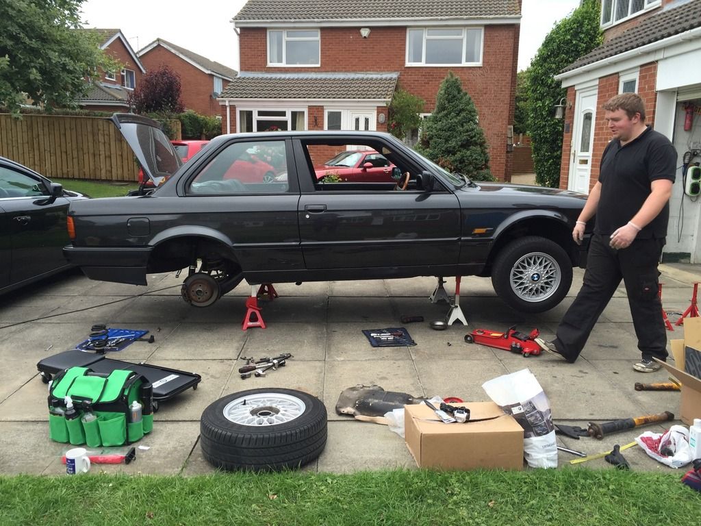

First to be removed was the front hubs/struts so they could be powder coated

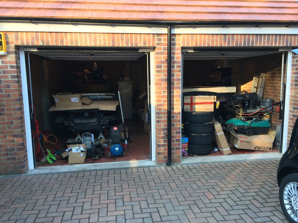

Had to use any space I could find, as space started to become very limited!
I then went to New York for just under a week for my girlfriends 21st Birthday, and the day before her birthday I proposed and she said yes! But anyway, the important part of the trip, I got a Red46 Sump armour delivered to my hotel!
And got it home safe and sound, and undetected in my suitcase!!

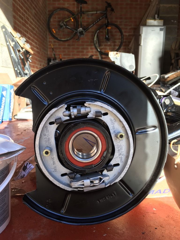

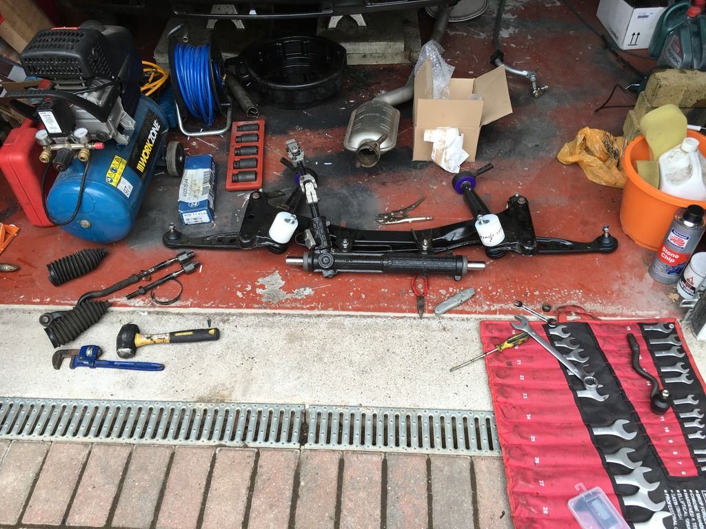

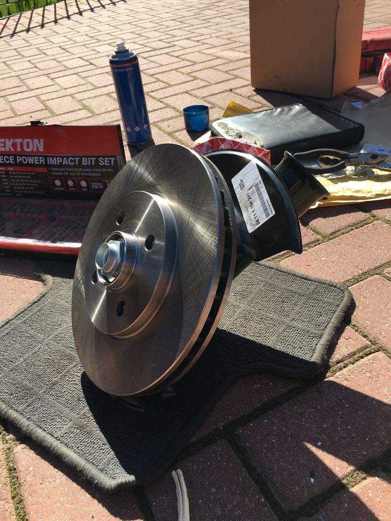

I then started building up my front hubs with all brand new parts, either Febi or genuine BMW with EBC brake discs
Fitted the air cups to the coilover struts

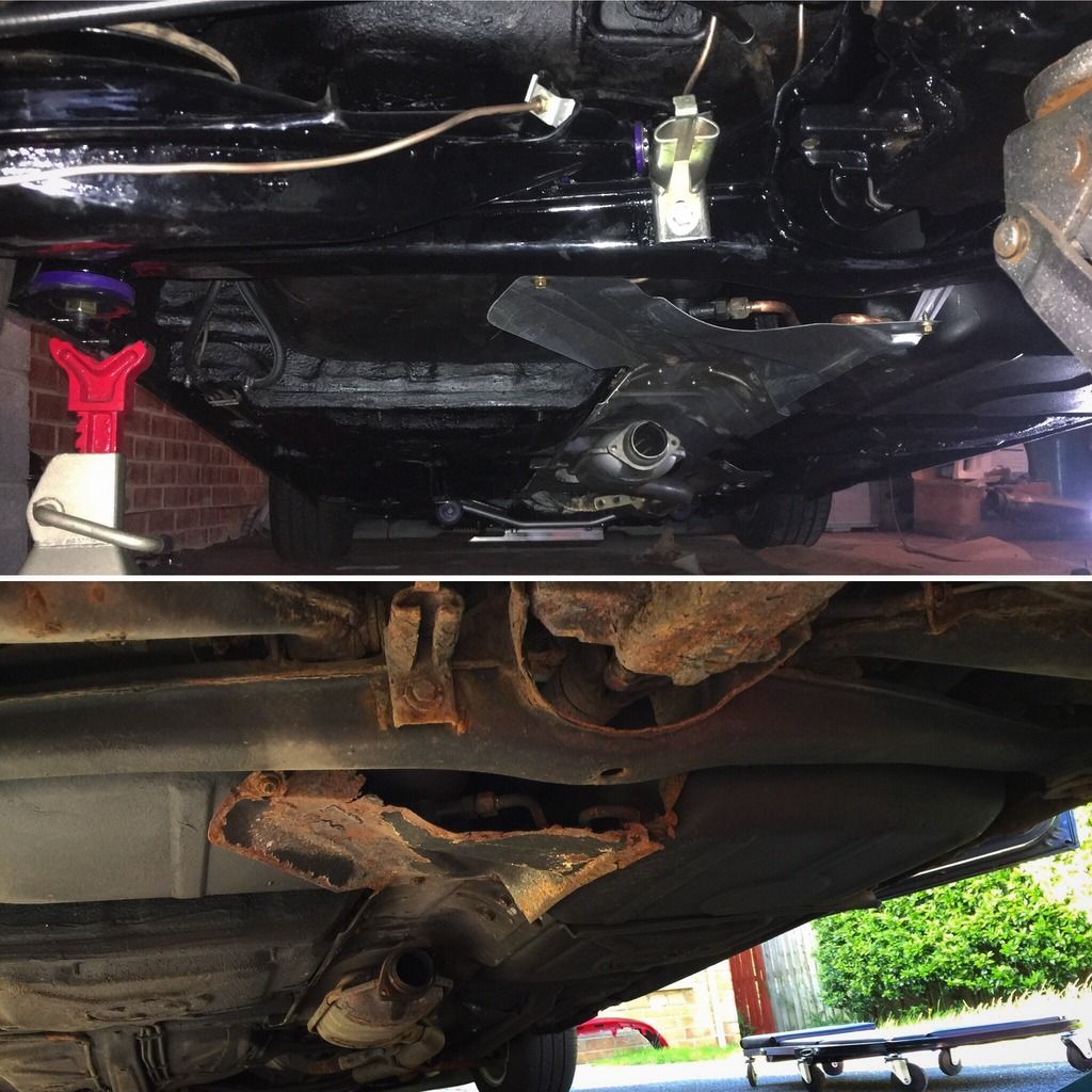

Started to paint the underside
I wasn't happy with the condition of the driveshafts and I wasn't paying BMW prices for a pair, so I imported some from the US

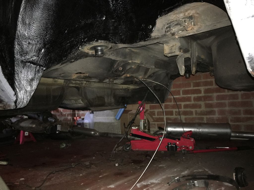

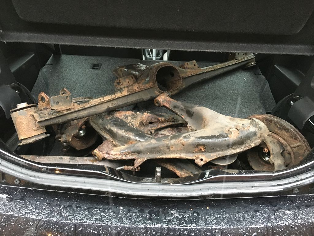

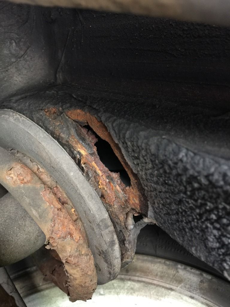

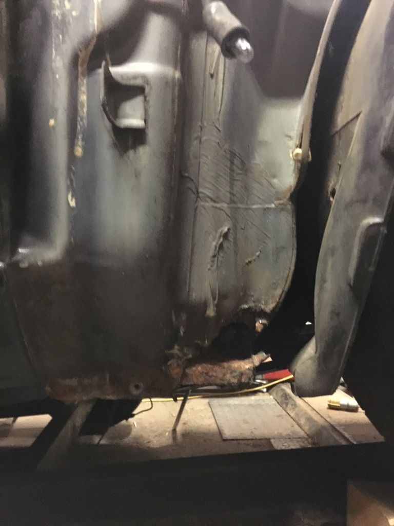

When frustrated that the rear axle was corroded to the body and i couldn't get it removed that night, I start poking at an area of my rear seats, it didn't sound solid... then this happened
I brought all my panels to my mums and slapped them on the car to make me feel better about the rust I had just found

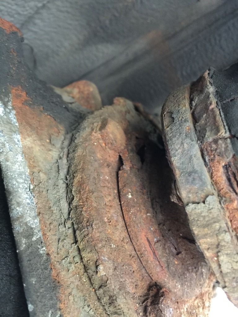

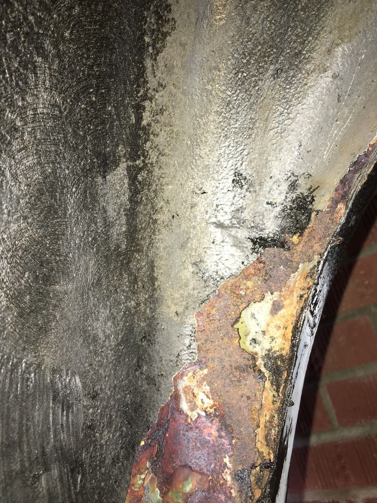

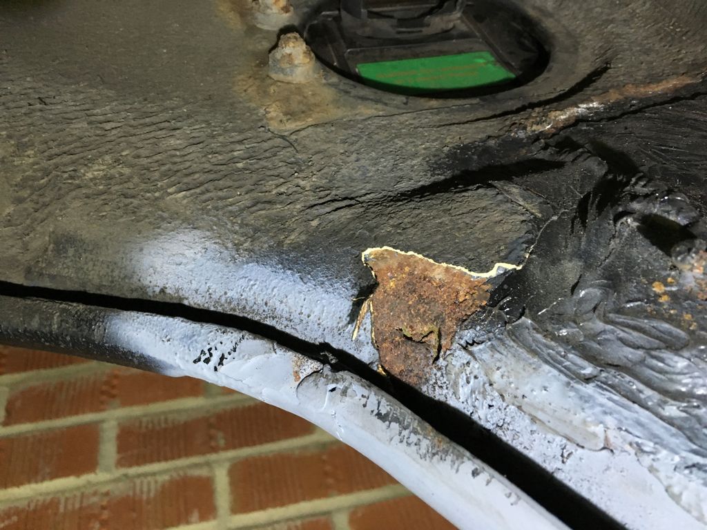

Then there was more rust

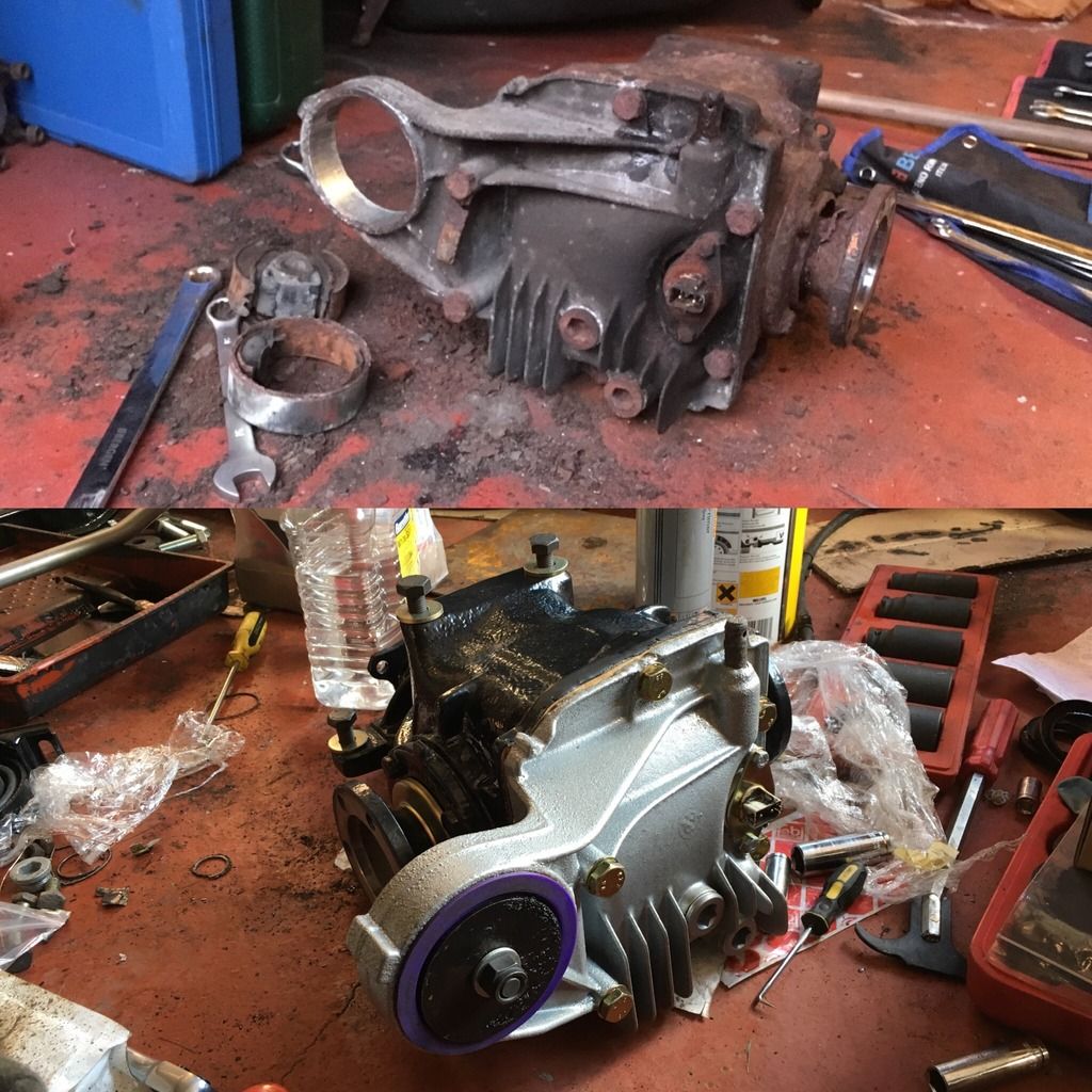

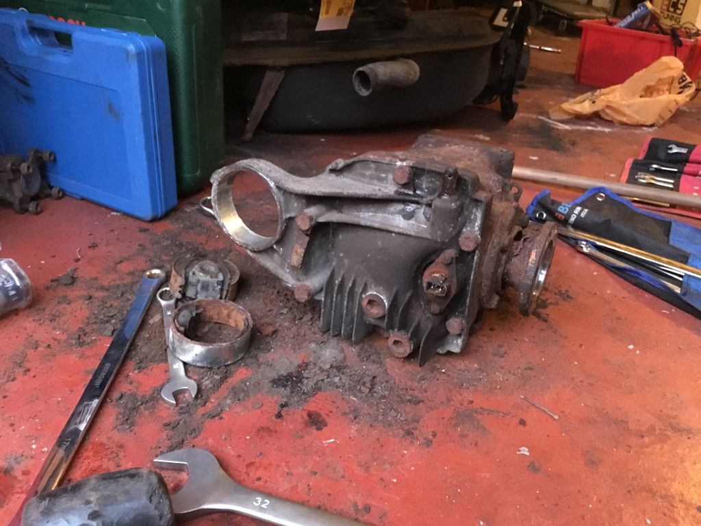

Finally we got the rear axle off and then I started by cleaining up the diff a bit and removing the old bush
And this passed an MOT, how? :roll:

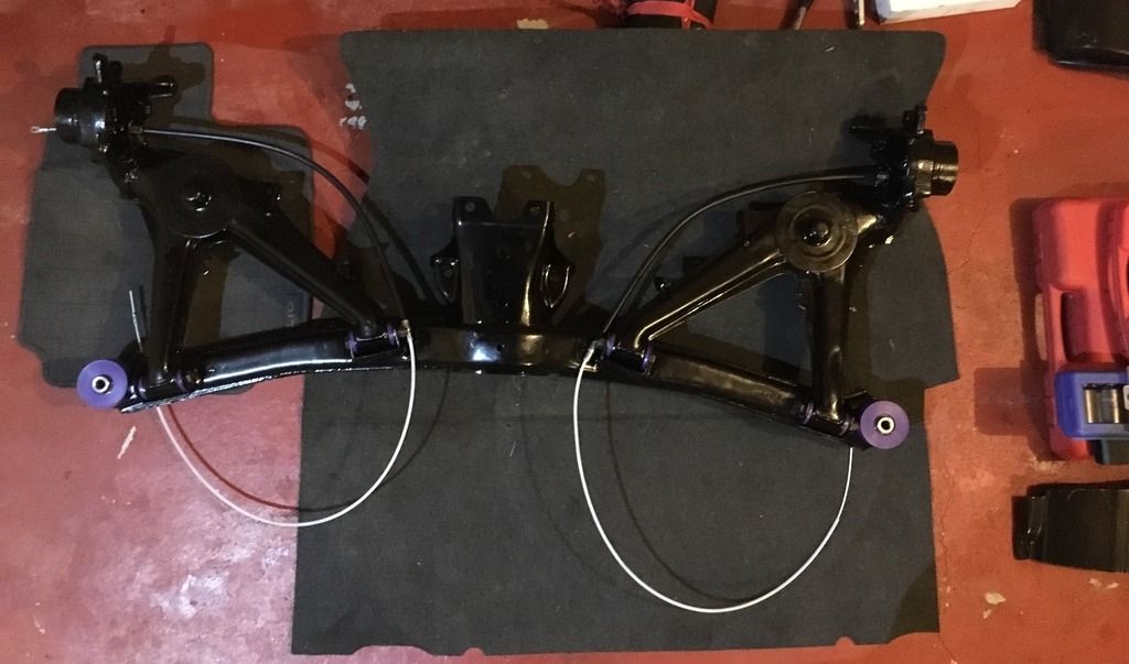

Front subframe and rear axle we starting to come together pretty well
Got the tank out and the car was looking pretty bare, and got another arch painted up

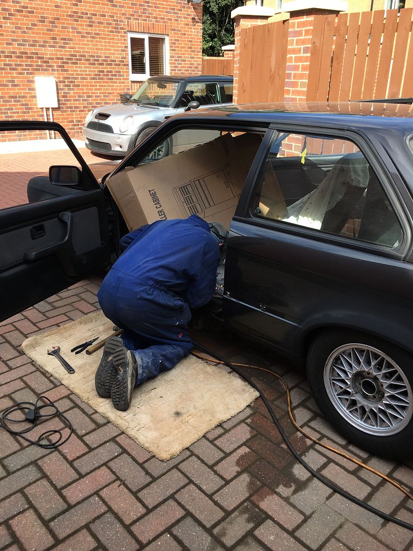

My dad came over with a welder and made a start on sorting my petrol tank brackets, what is really annoying is that these two brackets which both went you cant buy new from BMW, but the other two brackets that dont end up rusting you can buy new?

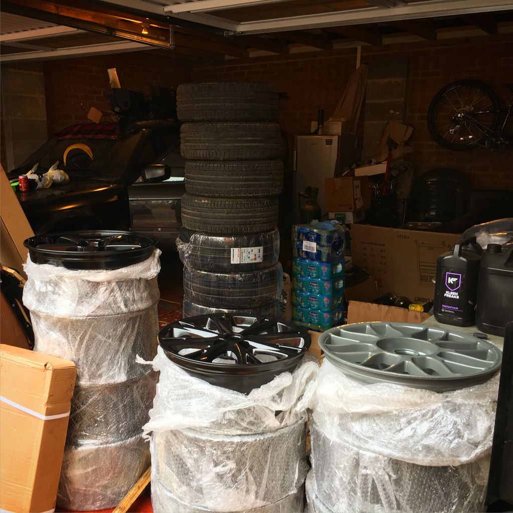

I also got many many wheels and half of my car delivered all freshly been powder coated!
My dad finished welding the top half of the brackets in
Then we found a jacking point that was just full of filler instead of being repaired properly!
Found more rust for my dad to sort out

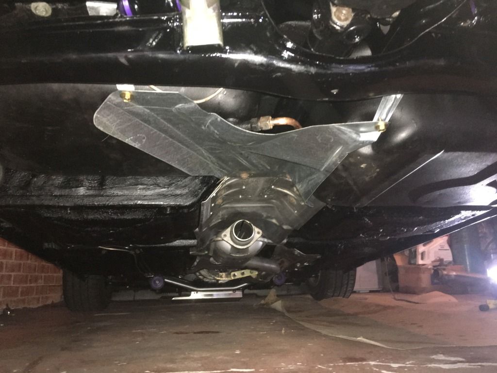

Gave half the underside its first coating of underseal

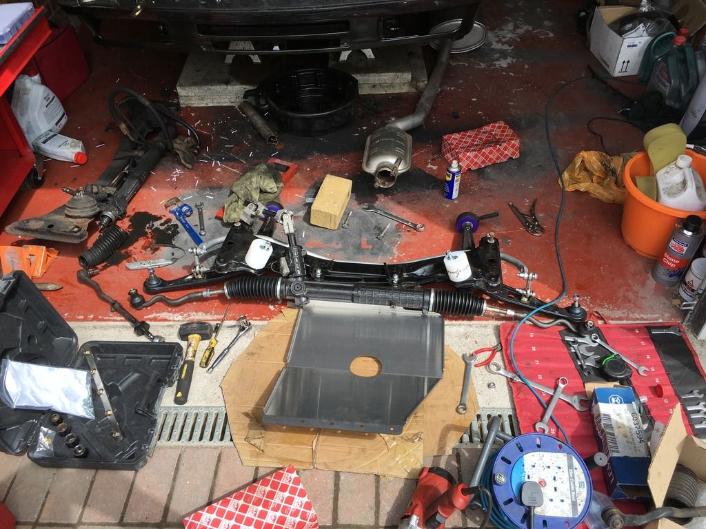

Finally got the front subframe off

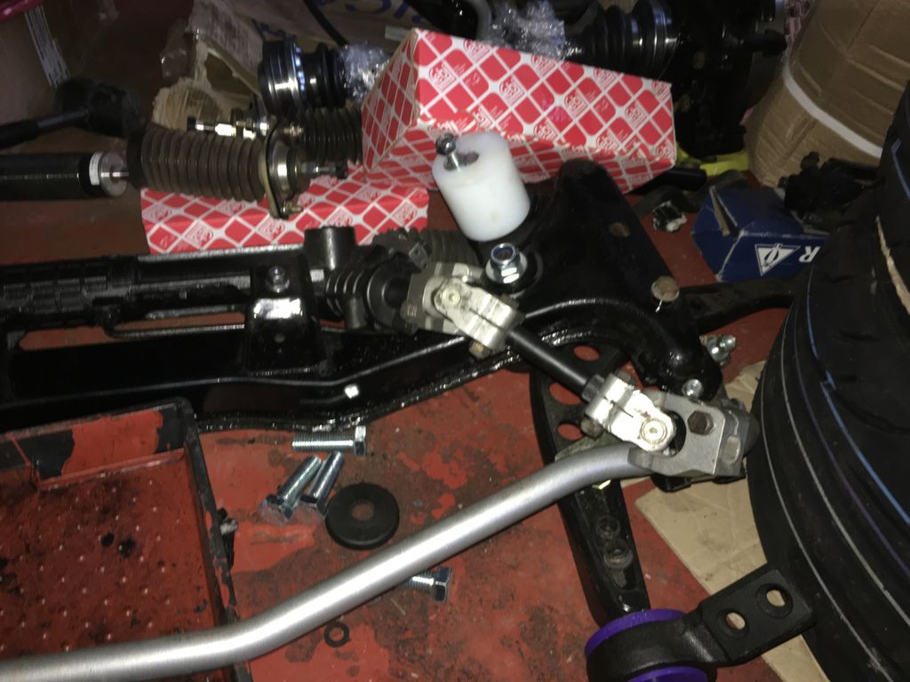

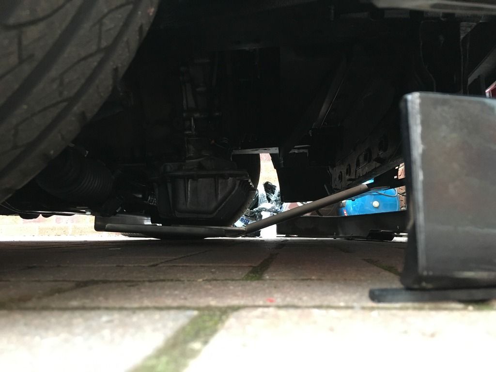

Decided to tackle the hybrid steering linkage that i'd need for the E46 quick rack I have and the DanThe shaft, after an hour or two I had it built up

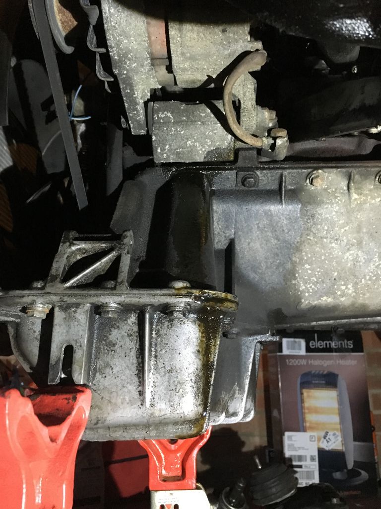

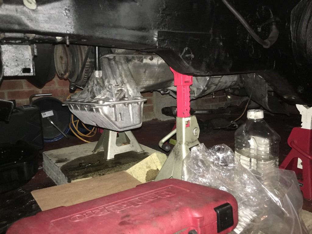

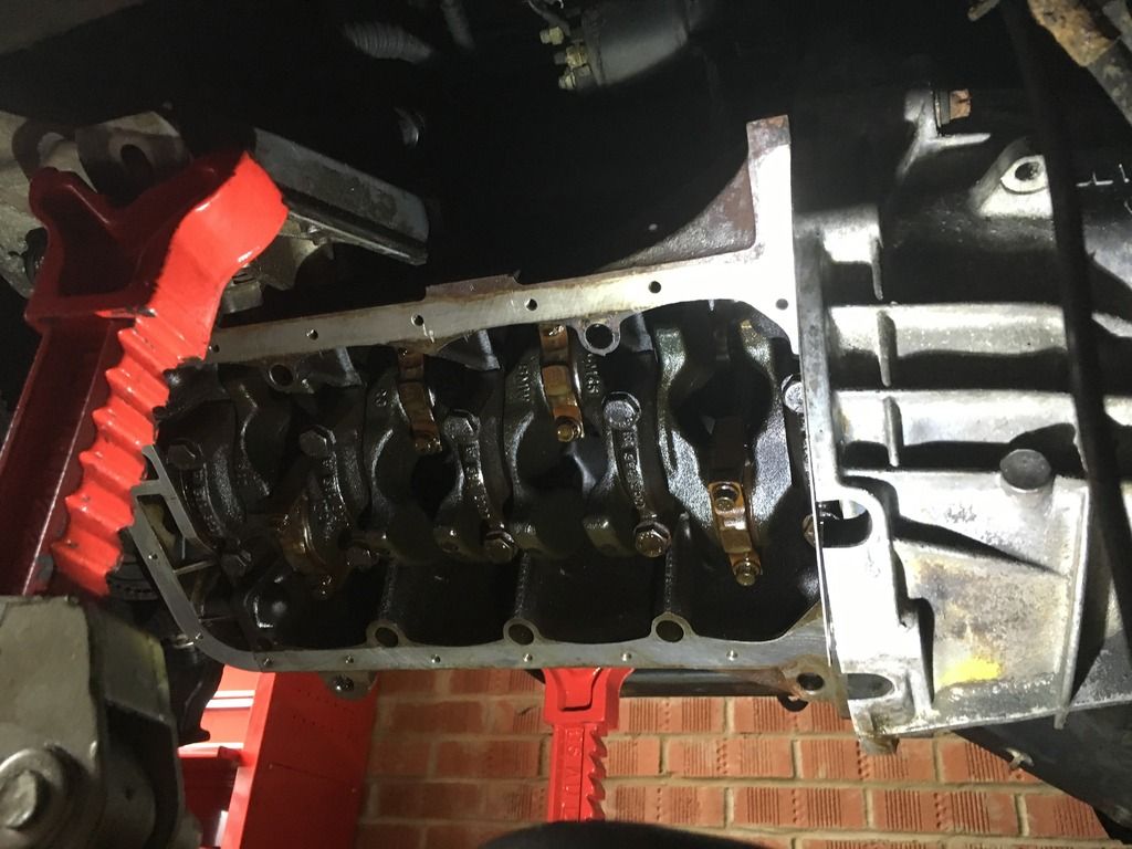

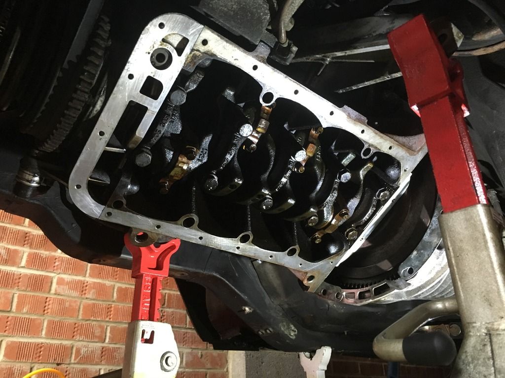

I then turned my attention to the engine, I finally gave it an oil change, it had been sitting waiting for one for ages, but turns out I ended up just wasting 4.5L of oil, as turns out I have an oil leak, the car must of been running low on oil too as I decanted the oil that came out into a 4L container and it didnt even come up to the 4L mark!!

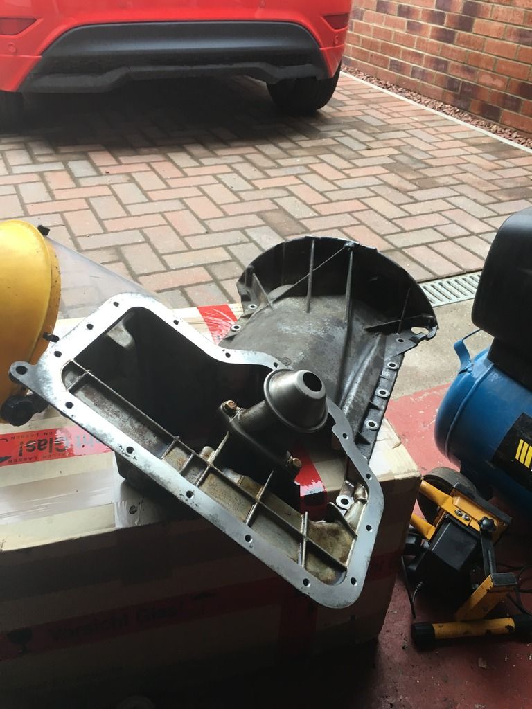

So new gaskets were ordered from BMW and I set about taking off the sump, unfortunately I couldn't get the upper sump off due to a 8mm bolt that was in too tight, and is still stopping me removing the sump now! so i think I need something welded on to get it out, I tried extractor sockets but its too small to grab on to it

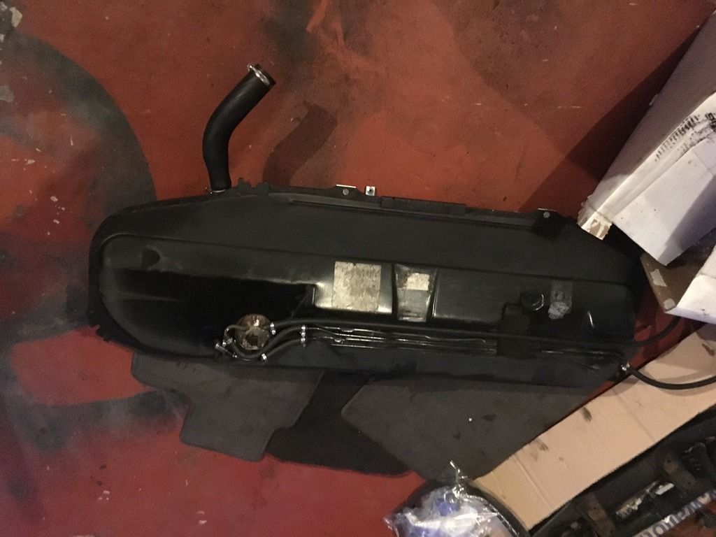

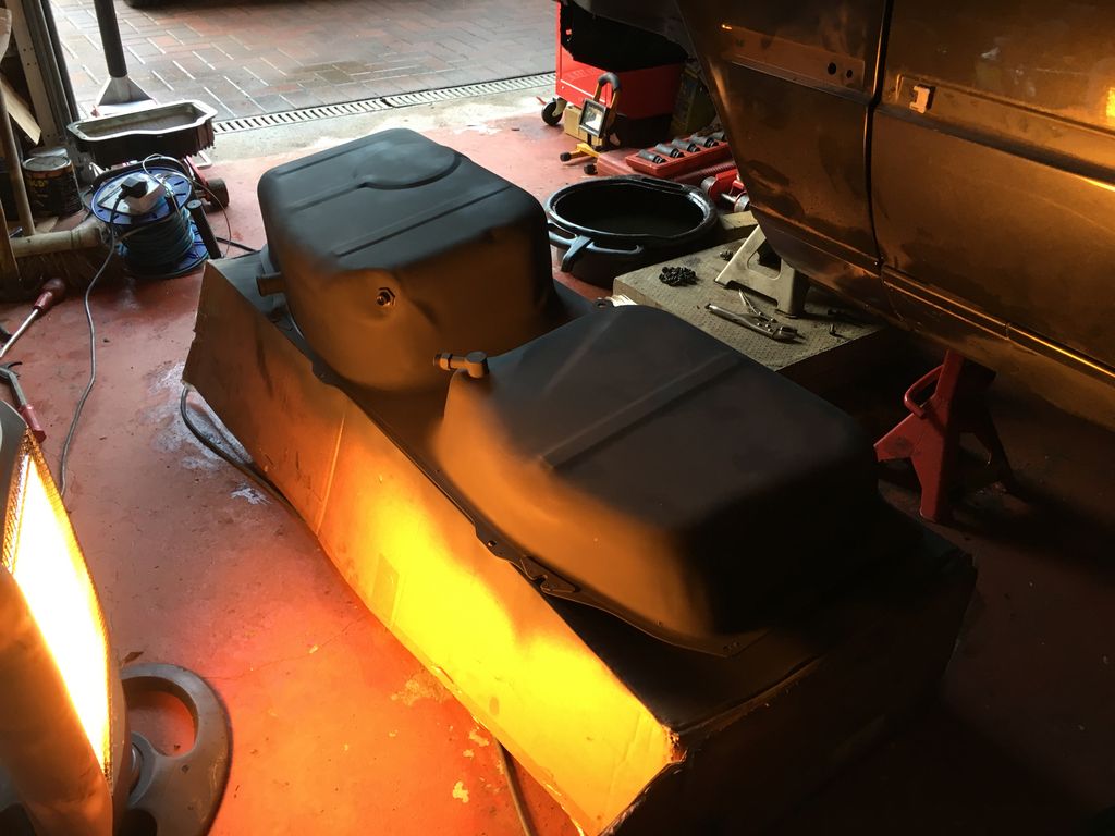

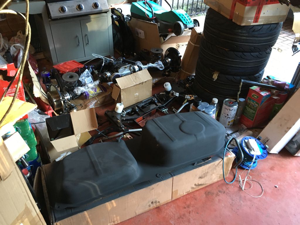

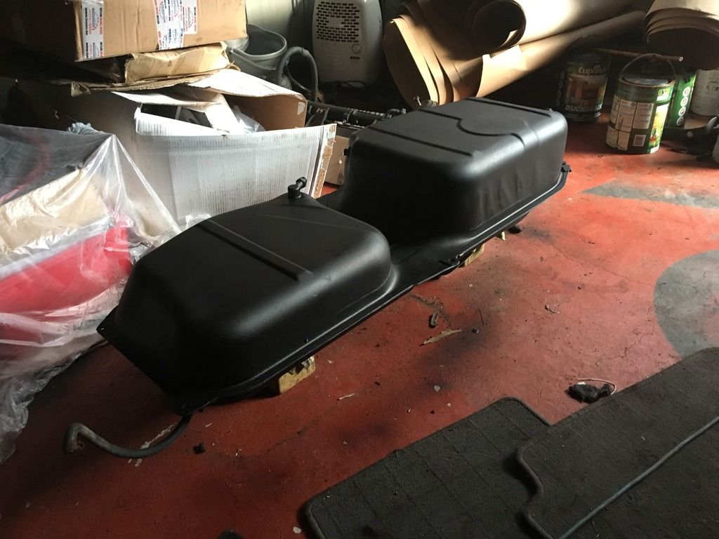

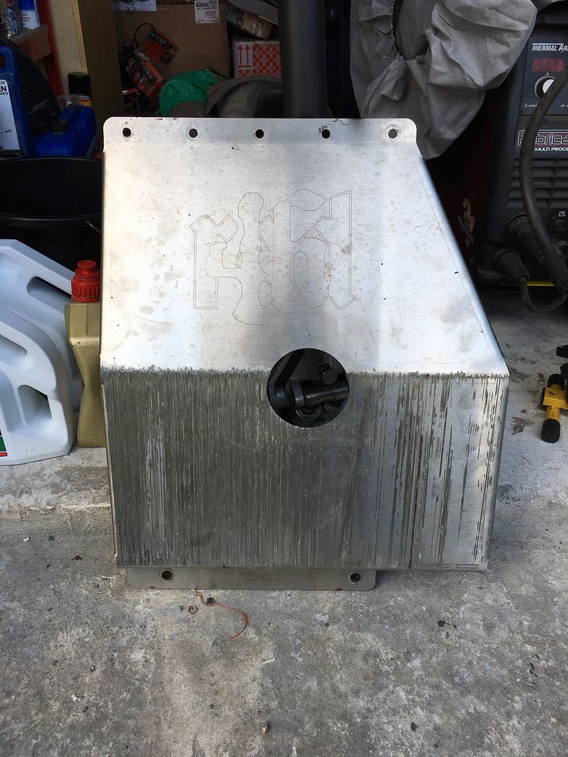

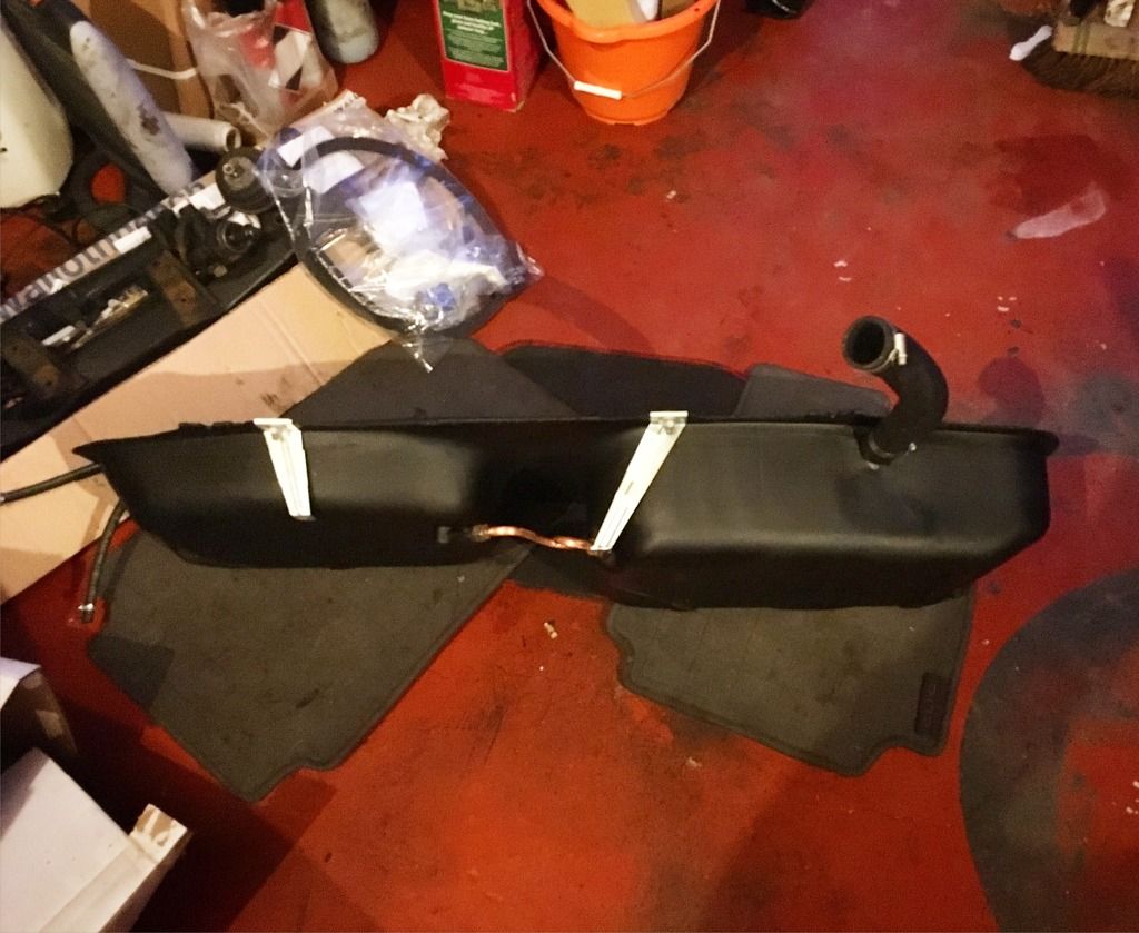

Started on with my new tank, my original (second tank, replaced in 2001) was too rusty for my liking so I've got another, and its getting several coatings of underseal/stonechip the lot to make sure it stands the test of time!
I decided to clean up the connecting pipe for the two halfs of the tank

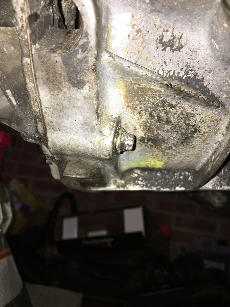

1 bolt holding the whole upper sump on, not happy

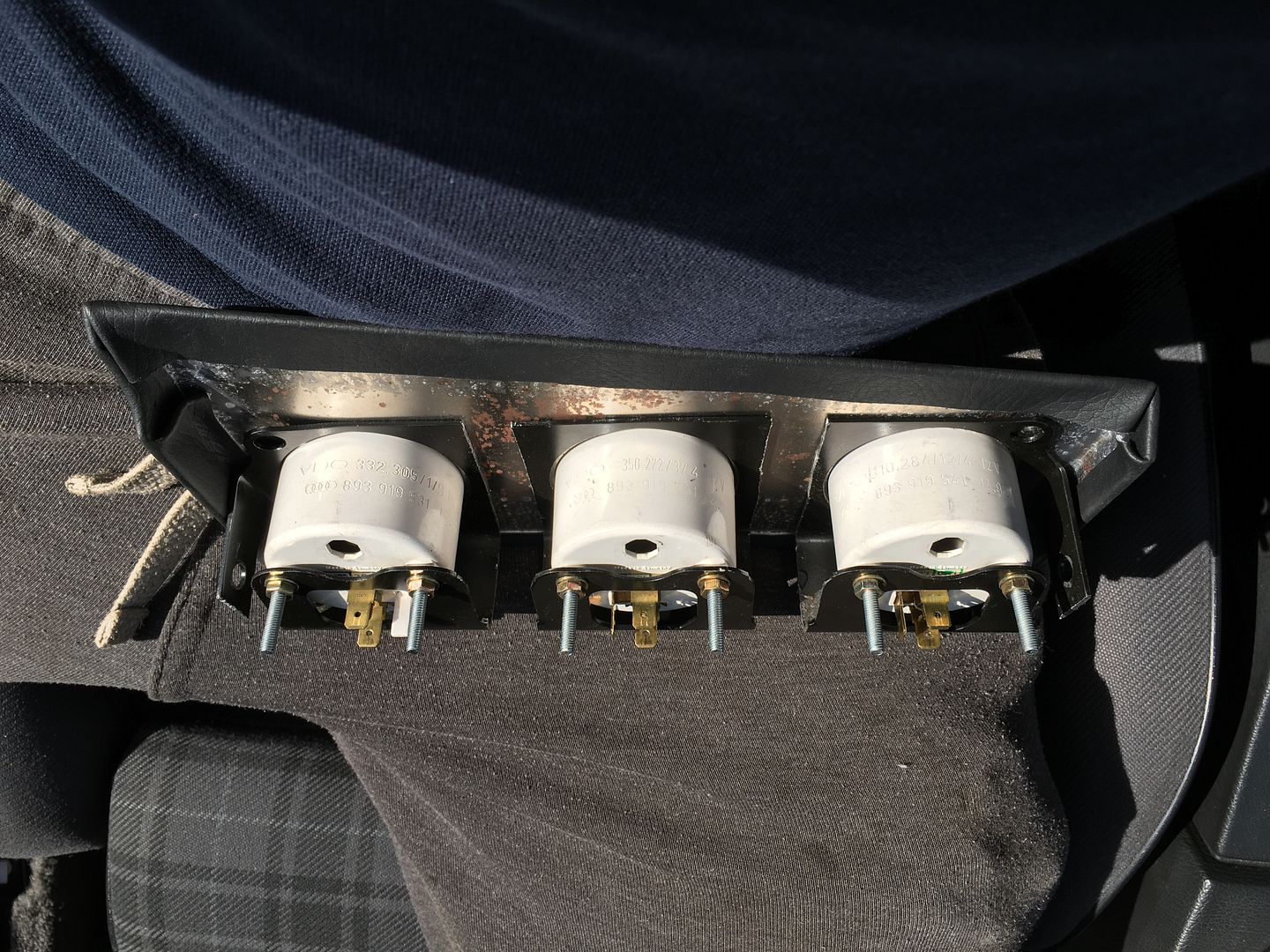

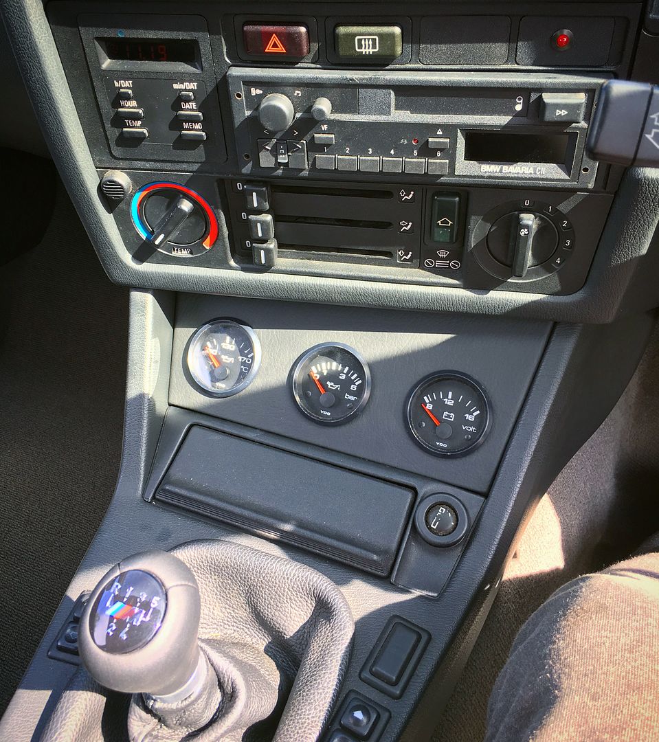

One thing I haven't pictured is that when I had the oil drained, I fitted my VDO senders for my oil temp and pressure gauges I got ages ago, and then wired them all in, at least theres been some positive progress with the engine!

I started the day by starting to tidy up the garage as I haven't thrown anything away, its all just been sat in piles around the garage
(I don't have a problem, honest)

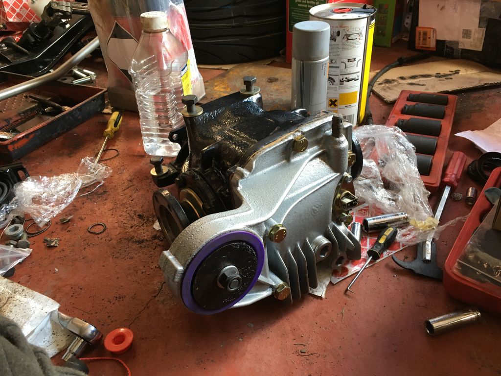

Diff got all rebuilt today and fresh oil added, I seem to of miss placed my pulse generator cover though, probably in one of my many piles!
And got it mounted to the rear axle, and attached to the driveshafts

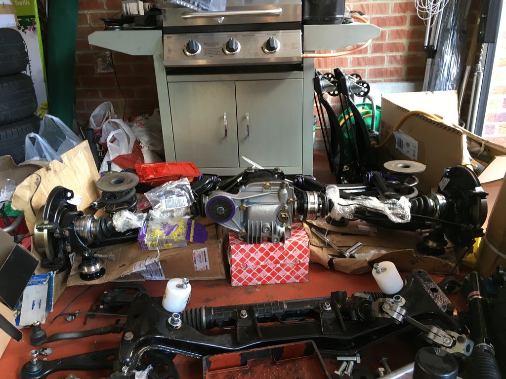

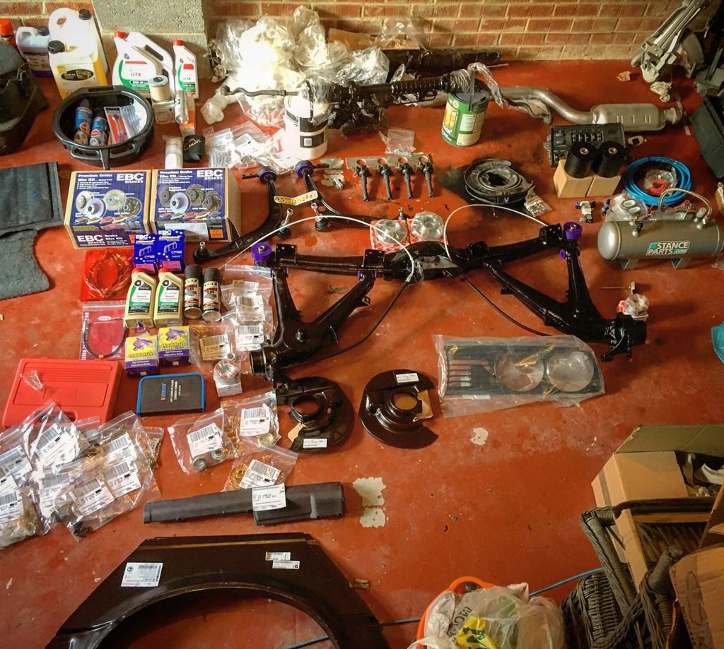

My pile of new parts nearly finished to be re-attached to the E30 once the underside has finished being painted and welding has finally finished
A much tidier garage than what it use to be

Top work! The pulse generator cover is available from bmw for about £4

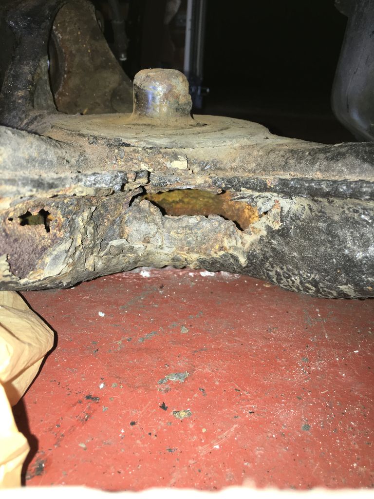

very impressive work. lovely car but my god that is the most rotten trilaing arms I have ever seen.

So after I did my oil service I found out that I had an oil leak coming from my upper sump, so dropped the oil again, and dropped the sump and cleaned it all up and back together with new gaskets
stonechipped my new wings and front valance
Found more rust :(
Finished undersealing the car

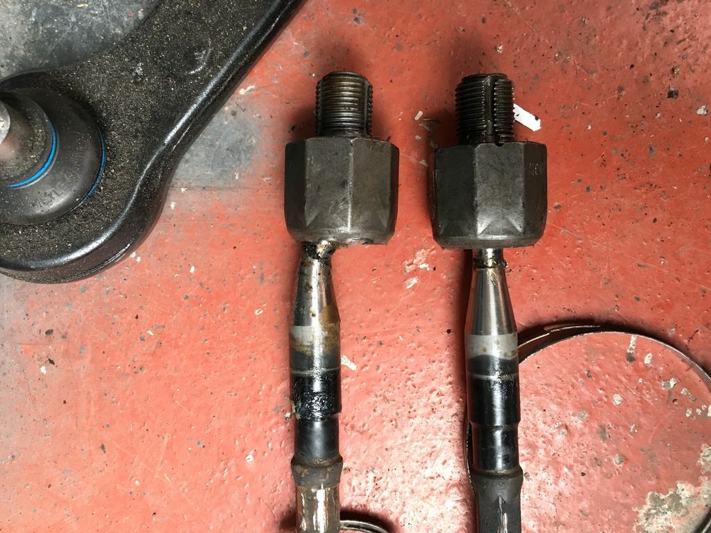

On my E46 purple tag quick rack there was play in one of the track rod inners, guess which one
Rack stripped down
Rebuilt with new track rod inners, outers and sump guard
Attached the front subframe all by myself, god that was difficult!

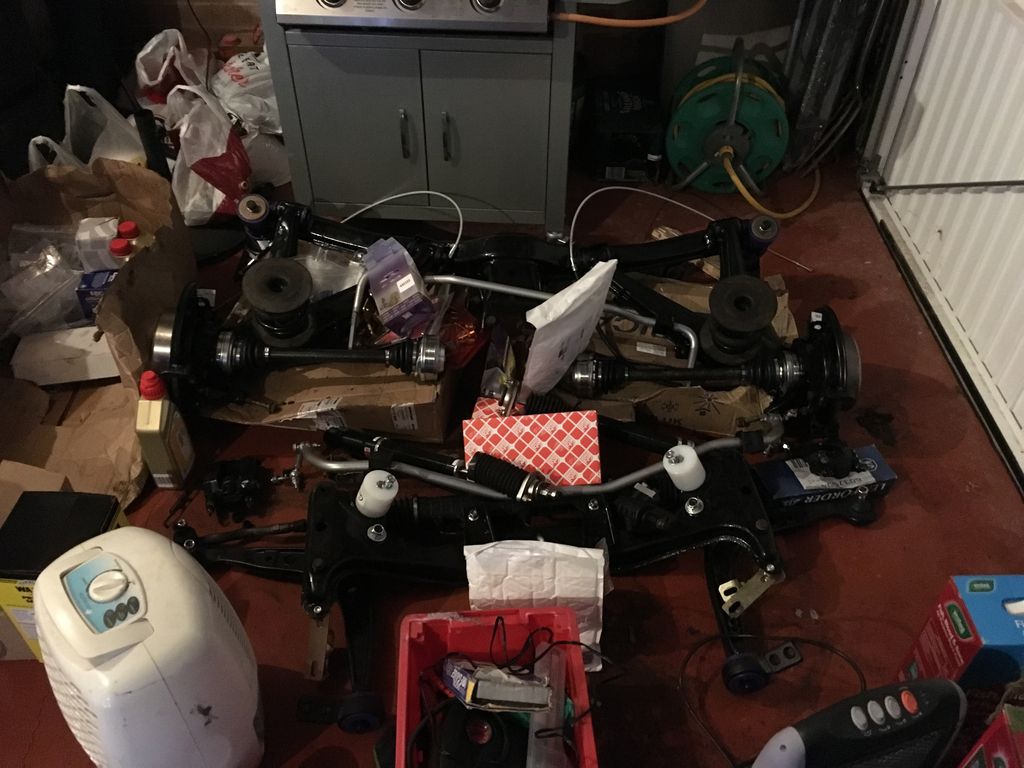

Lovely freshly painted half propshaft and new centre bearing, dust cover and circlip assembled
Got the rear axle on, had help for this axle though, given it was completely built up including diff
Saw a wheel I haven't seen in a long time!
Went to Santa Pod in the Mini when I should of been in the E30 :(
Then as of last night!
Rolled the car out of the garage, it doesnt drive as theres no petrol tank or the other half of the propshaft so its not going anywhere fast soon ha.
Even with attaching the steering rack to the furthest holes it still catches the manifold so i'll need to offer it some persuasion!
The end is in site to get it driving again, then a couple other things to tweak then it needs paint and interior fitted!!!

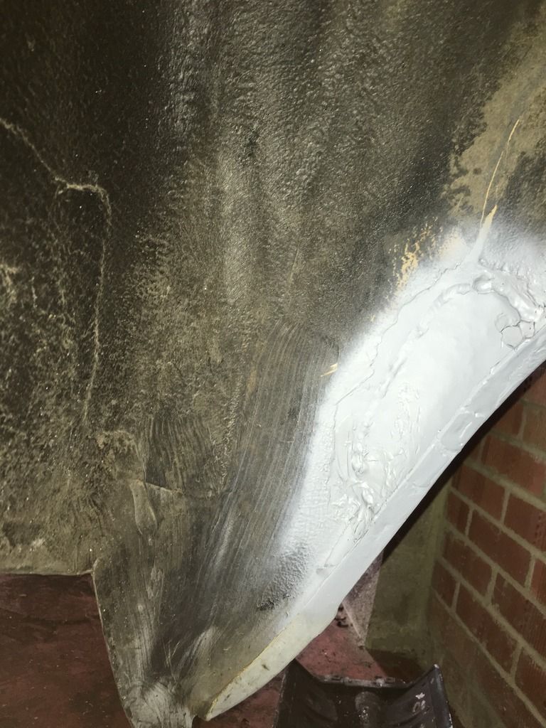

Great read thanks! Bloody rust! Interested to see inner arch? repair as mines alot worse!
smiths0n
Posts: 64
Joined: Thu Mar 27, 2014 11:00 pm
Location: Newcastle-Upon-Tyne
Thu Jun 23, 2016 12:30 pm

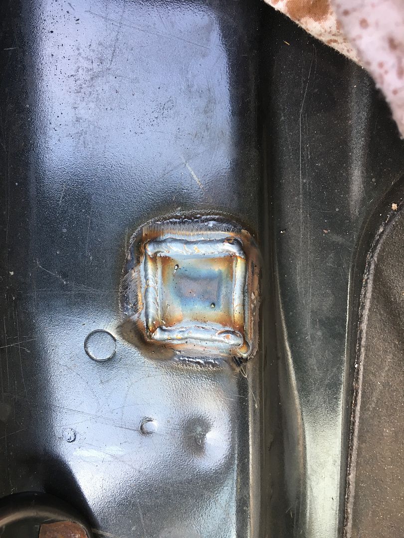

AndyE30 wrote:Great read thanks! Bloody rust! Interested to see inner arch? repair as mines alot worse!
Plate welded in, and seam sealer over the welds

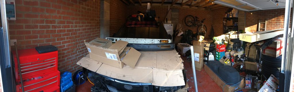

Now that its back on 4 wheels, I've been able to wheel it in and out the garage which has been fun! ha and I've done some little fun jobs
I finally got my quick release fitted, when I initially fitted it, when tightened down the horn was constantly on which wasn't good! All it needed was a washer and now its on with my Nardi

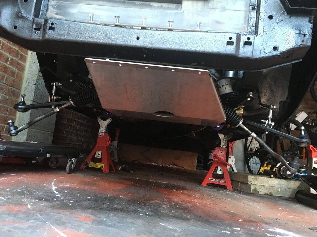

Bearing in mind the sump guard isn't actually attached to the front of the car yet, but yeah - not a lot of clearance
A little bit of context, my car is being stored at my mums as she has a double garage and I only have a small single garage. We've already had the police around, and a letter from the council regarding noise and vehicle maintenance, she just got this letter today and its hilarious!!!
And a couple pics of today in the sun, got the aircups wired up and working and also got areas that were welded inside all seam sealed up and a lick of paint to protect it all, now plans for tomorrow are petrol tank and fit dashboard!!

So the frontend is virtually built up now, I need to get the car MOT'd so I can move it around before it goes for paint, probably in September
I've finally test fitted an RF with a front arch to see what fitment is like, unfortunately with the adapters the wheel is still sat on the strut! so I'm going to rebuild them with smaller barrels, bigger lips (radinox winkeye ) and redrilled to 4x100!
And thats the clearance with an RF fitted hahaha, luckily it will be a little more when I eventually get the front bolted onto the car! (not much though)
And I've also got my original tank painted up, the replacement tank didnt fit! :( another layer to protect areas I sanded back to bare metal then its getting fitted, then prop shaft in then it'll drive!
smiths0n
Posts: 64
Tue Jul 19, 2016 10:25 am

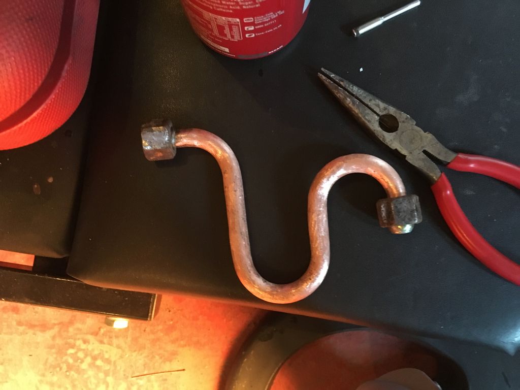

So the tank got painted and then rebuilt with all new fuel lines, and the connecting pipe was cleaned up and new heatshield brackets.
Got the tank fitted and the car fired up after the fuel got through the brand new fuel lines! :D It also only had the front half of the exhaust fitted, so got a letter from the council from a noise complaint! So thats letter 4!

And then my attention was returned to the interior, it now has a dash! just needs passenger seat and rear seats :D
Because of the noise complaint I finally fitted the exhaust, firstly cleaned up the 25 year old heatshield and got rid of majority of the dirt.
Then this weekend just gone I got my sump guard attached at the front of the car, 80% secured the fuel lines (found a little more rust, one of the studs holding the fuel lines on) so thats being sorted on Friday coming. I also ran the car for a bit and my radiator seems to be leaking quite a bit too, so need to sort that out :(
Finally secured my front valance and wings then took it for a drive around the estate and realised I cant turn my wheels due to the bulgy sidewalls and how low it is! So because the BBS RF's need to be redrilled to 4x100 as I hate adapters, and the adapters i bought I'd stripped the threads :mad: I've gone and bought some freshly refurbed BBS RM's to allow me to actually turn the wheels, standard 6.5" and I've gone for a set of Yokohama Parada Spec 2 in 195/50/15 so nice and beefy to allow me to have some fun when not on the showy stretched tyre RF's

So before the RM's came had to get my dad to do some more welding work on a rusty fuel line holder!
Then the RM's turned up 8)
Then got them on once it stopped raining

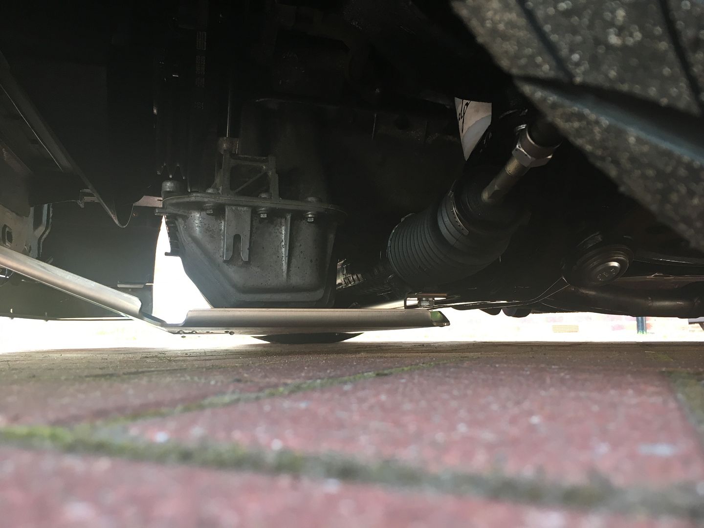

And the underneath clearance to the sump guard wasn't great, I soon realised how bad it was...
We tow poled the E30 back to mine from my mums due to all the complaints we were getting from the council, to help with protection of being outside it went under a cover
Next day I assessed the damage and got it up to finish up the last few things, dropping the exhaust to manifold to weld a new stud in the manifold, fit rear ARB and get the propshaft balanced from my foolishly splitting it without marking it

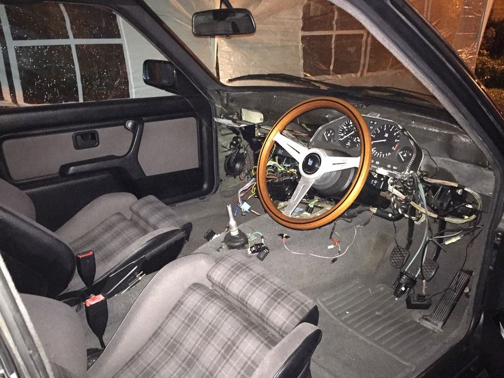

My seat was broke, wouldnt fold forward and the brackets holding the back on both had snapped! So more welding for my dad and I also eventually fitted my fire extinguisher, was a steal winkeye
I had fitted my VDO gauges into the facia, but they weren't fitted properly, so I cut up the bracket I got with them to allow me to secure them all in place
Got my seat back together, propshaft back in, exhaust back on and it was ready to drive

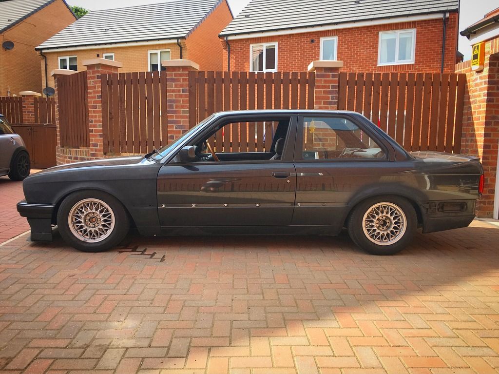

But it was just too damn low with the sump guard on, so the sump guard came off!
This is from 16miles
So much more clearance now!
And now the E30 now has a full tank of shell in her, which made the rear sit even lower ha
The solid engine mounts I had fitted were horrible, caused the whole car to vibrate so bad, so 1 is out, second is available at BMW today so I'll be collecting and fitting tonight
Got my sideskirts fitted over the bank holiday weekend

And now got my RF's split down ready to get them redrilled to 4x100 and rebuilt to fit perfectly

I think your a bit mad to leave the sump guard off with it this low. I would rather hit my sump guard on everything rather than hit my sump on something once. I cracked my sump twice before I got my sump guard, wouldn't go anywhere without it now.

really good thread, great to some one doing it properly instead of the usual "i'll just chuck an M5x in & be done with it,
as said above best to hit the sump guard a few times, better than replacing the sump :D
also, where did you get the fascia for the gauges?? home made or shop bought??

Also the comment on the sump guard, it was hitting every other second and the feeling it gave through the whole car was horrible, I'm going to see if I can get the sump guard altered so it doesnt sit as low then re-attach it
