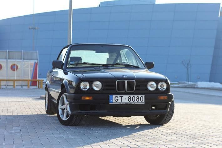

Post Fri Sep 11, 2015 12:44 pm
Timeline
Sellers advertisement
Purchased 2013 late winter
Body was superior condition, good start point
Hard job, painting, bunch of money ”¦
and 2013 late autumn
2014 spring
2014 summer
2014 autumn
suspension upgrade done
2015 may - time for upgrade
2015 august ”“ continues restoration and installing of all extras

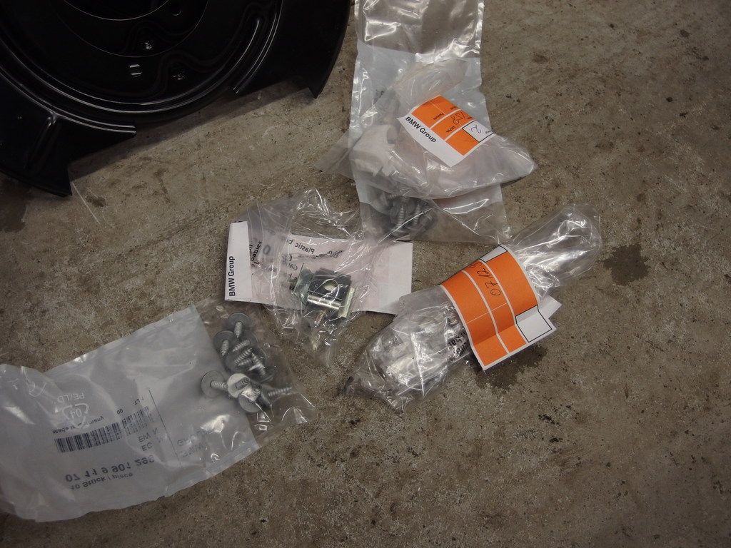

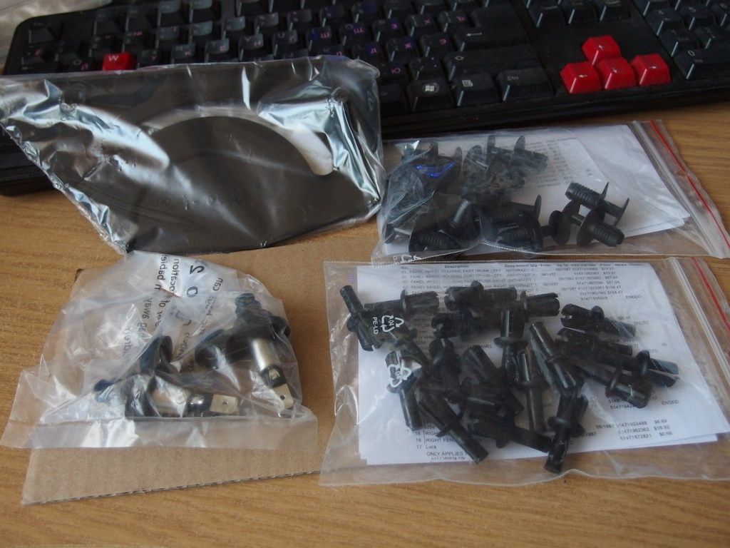

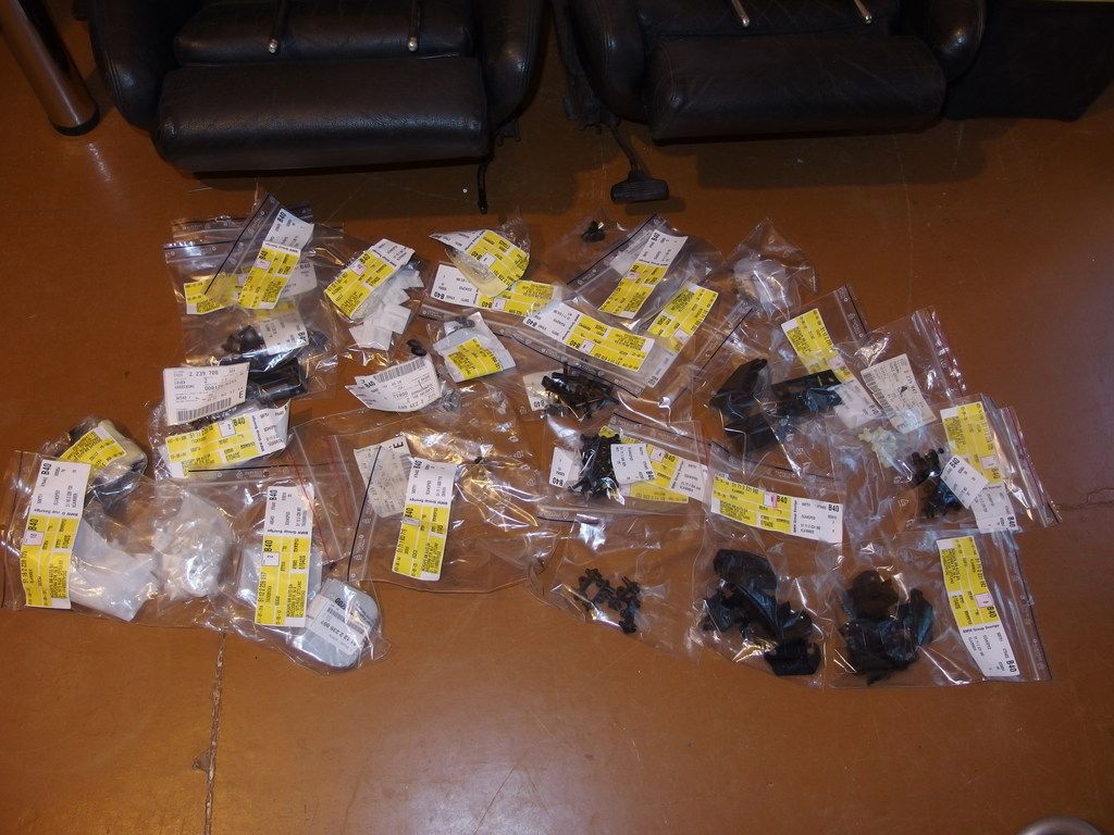

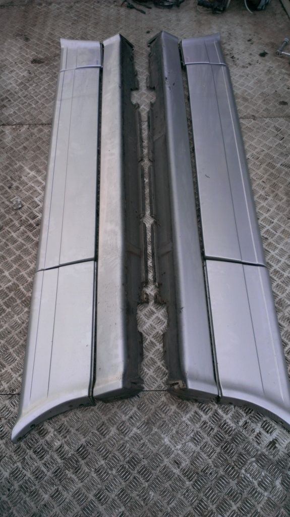

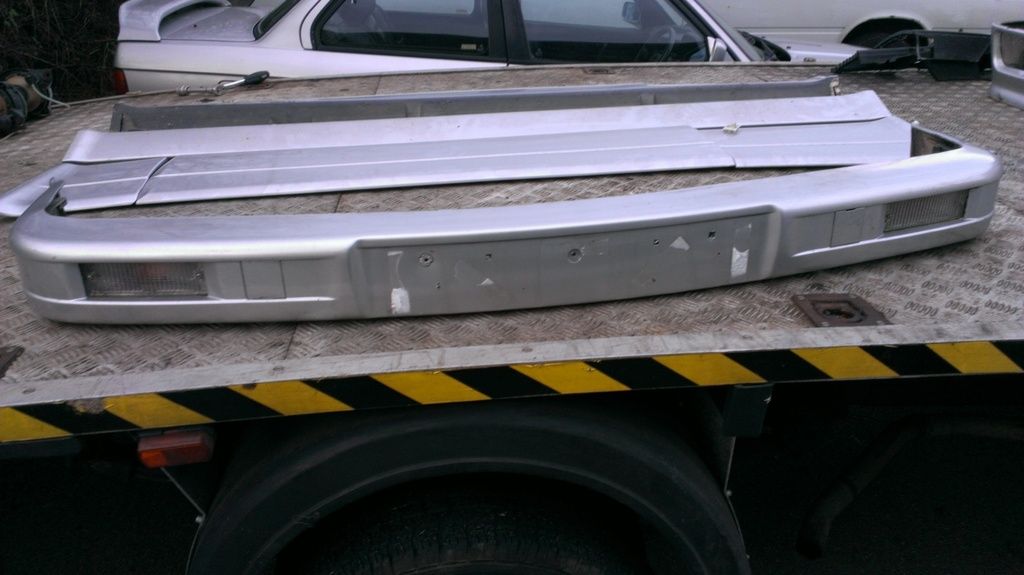

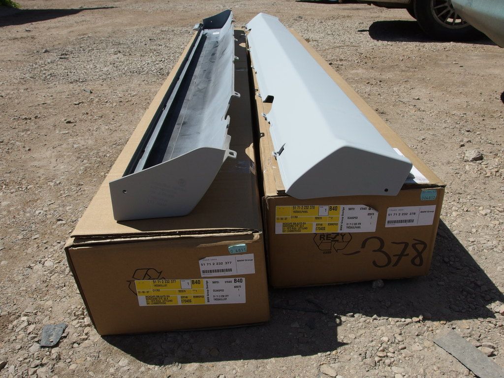

Coupe M Technic 2 body kit bought from UK
But side skirts lowest part is convertible specific. So, ordered new ones.
Bunch of M Technic 2 OEM fitment clamps, screws and other stuff

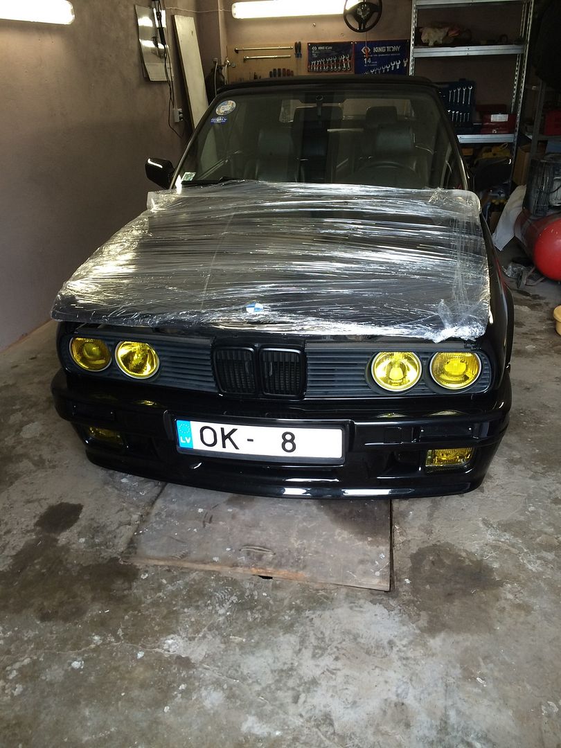

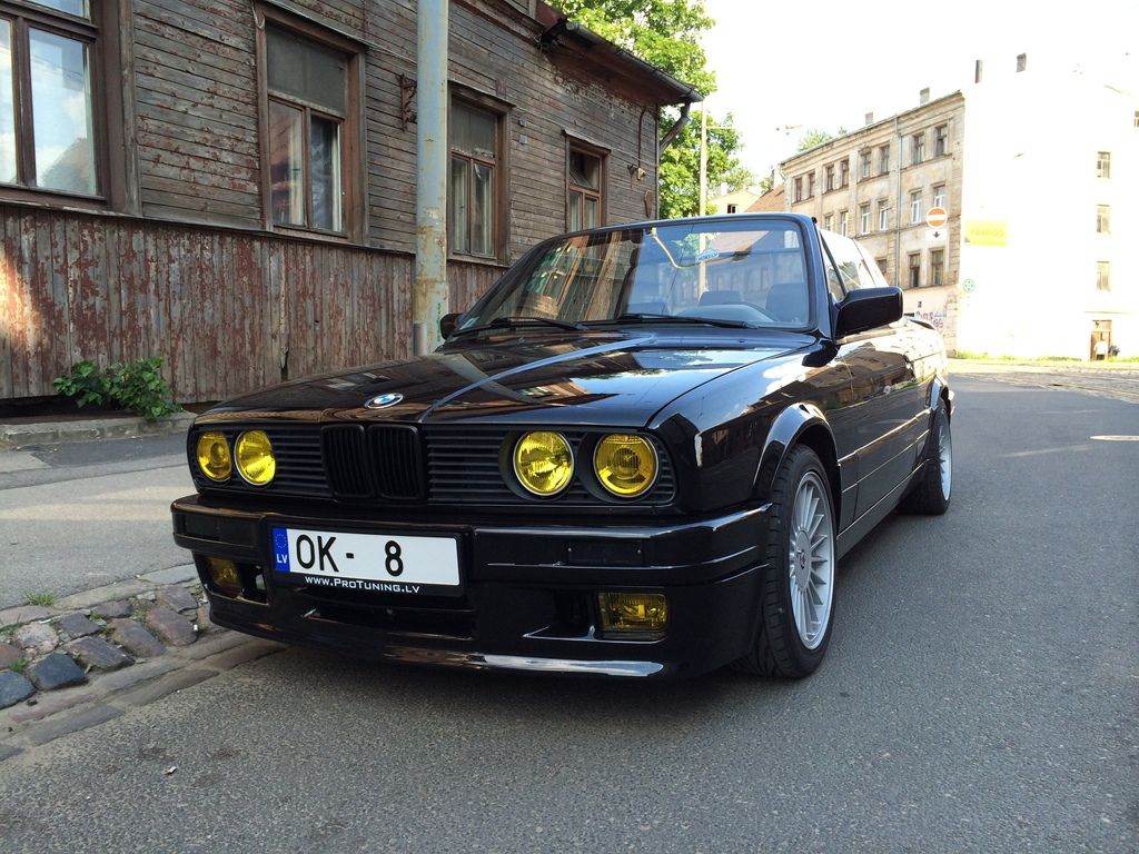

new OEM yellow headlights ”“ manufactured 2010
new OEM fog lights

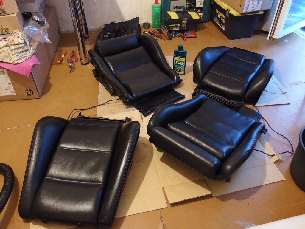

seats repair

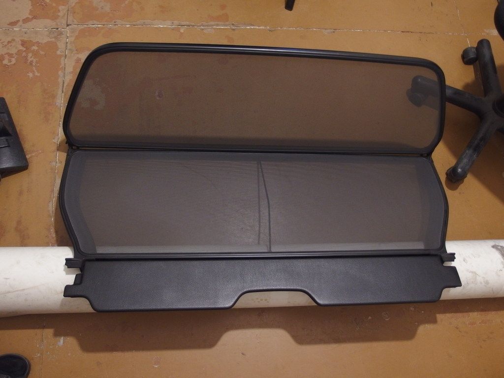

Post Fri Sep 11, 2015 2:30 pm

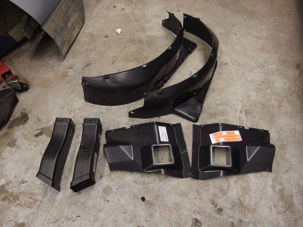

get some nice stuff
again OEM parts
must have for convertible owners

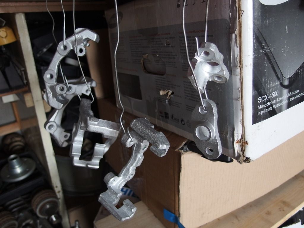

Post Fri Sep 11, 2015 3:46 pm

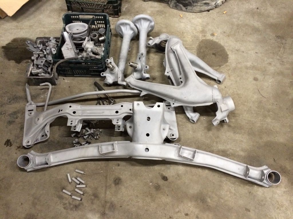

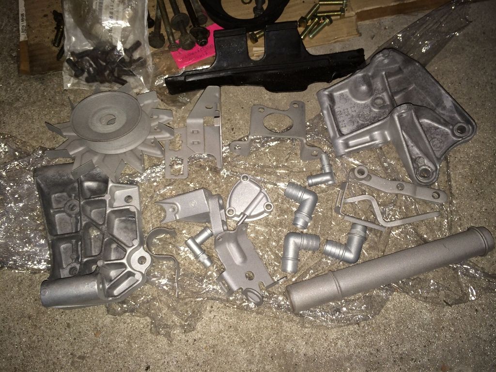

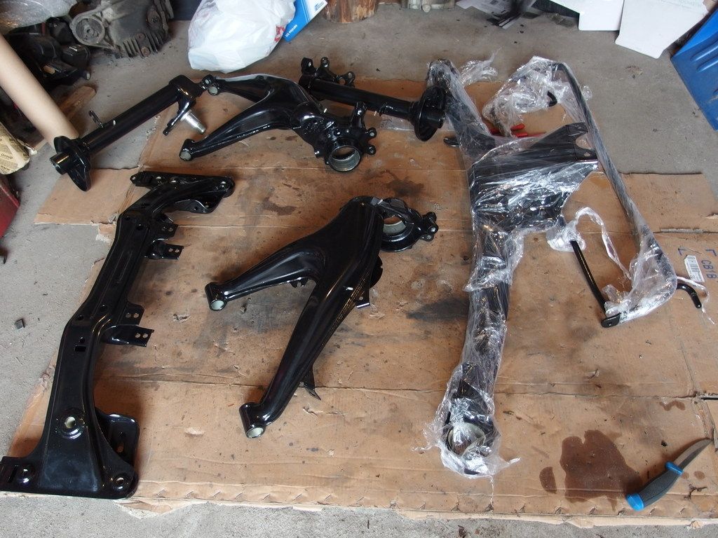

pripearing for sandblast
sandblasted
electrogalvanization with zync
powdercoated

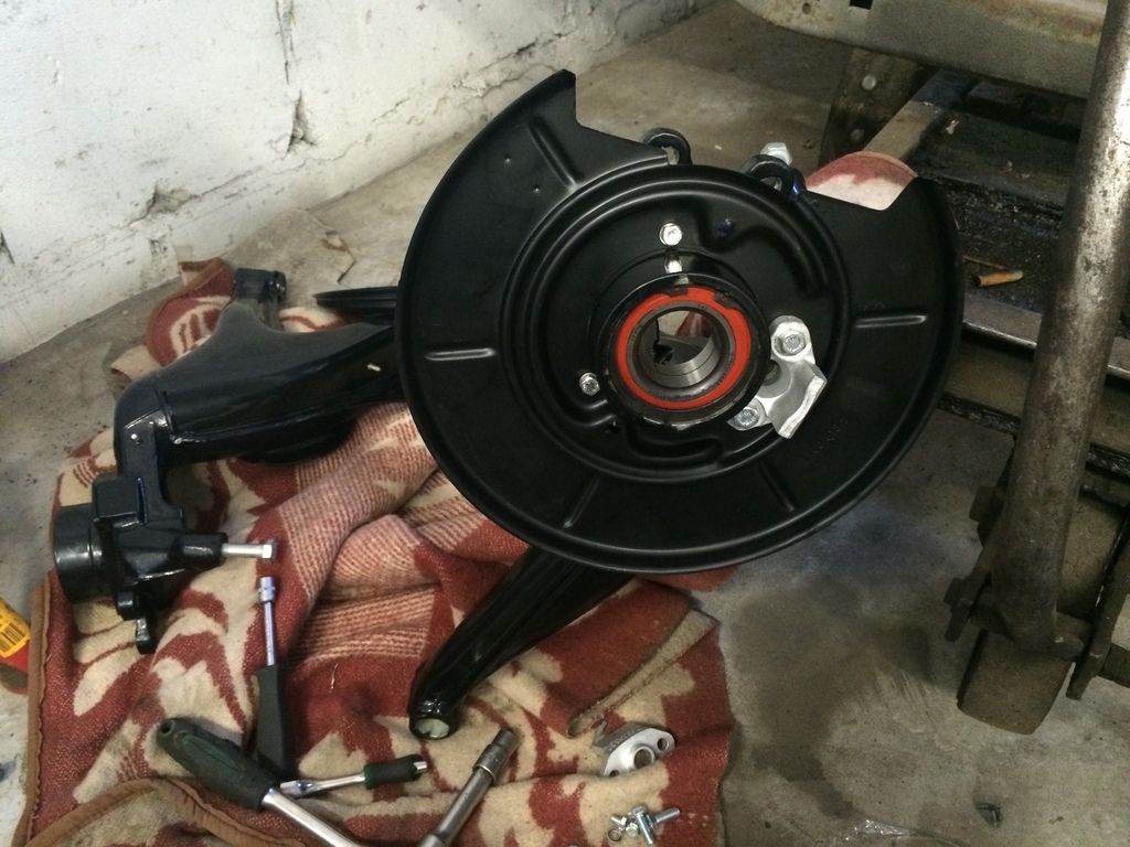

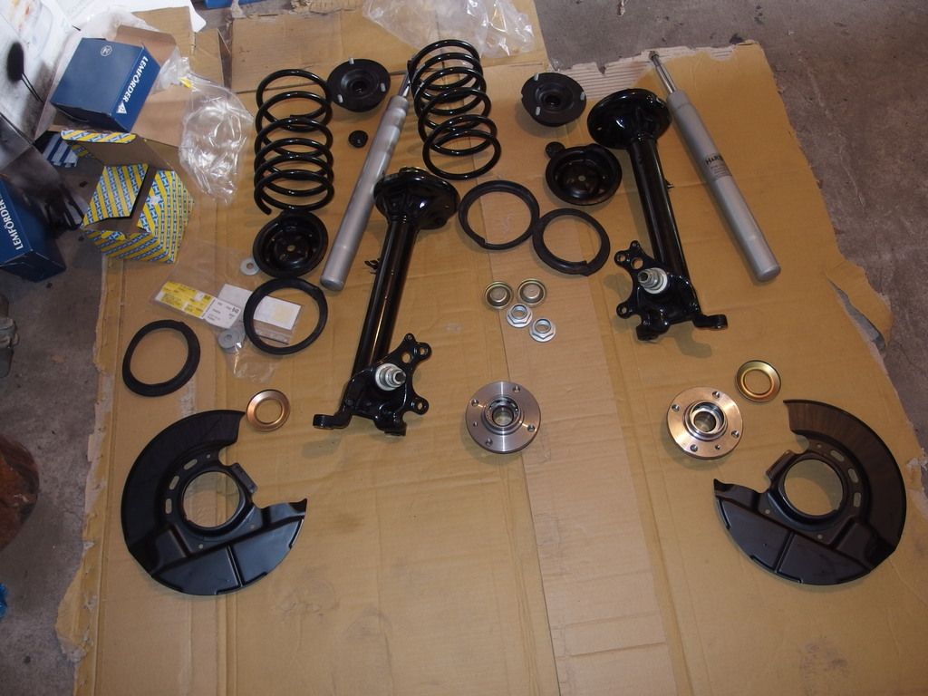

Post Fri Sep 11, 2015 3:54 pm

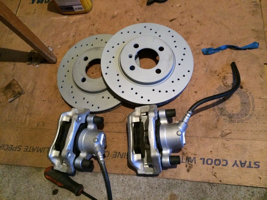

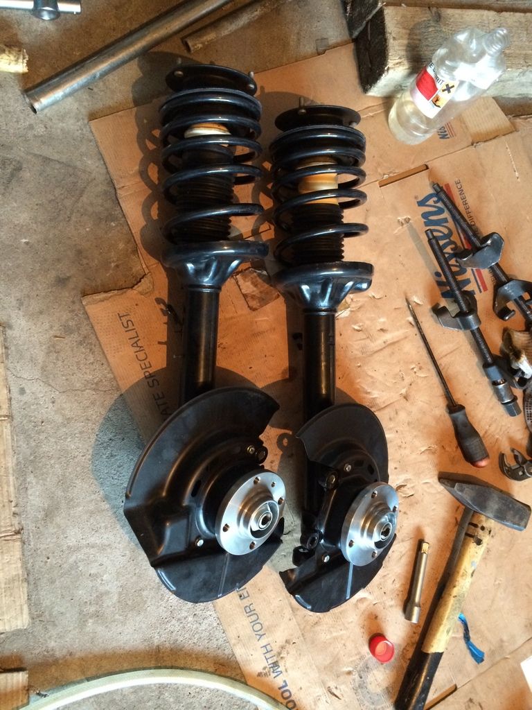

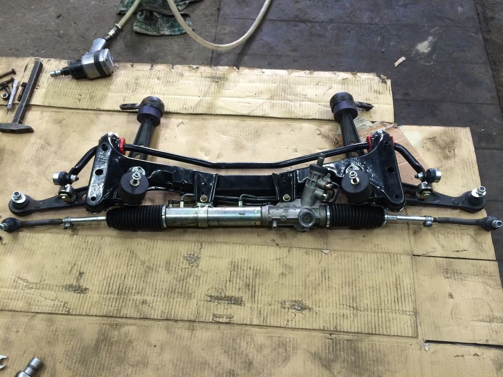

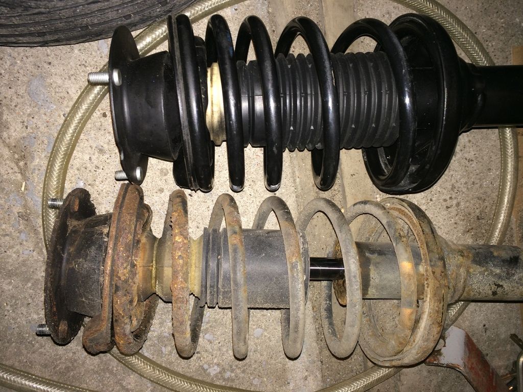

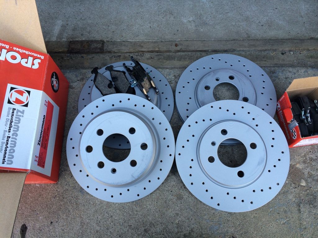

suspension H&R KIT
zimmermann KIT
kro
Posts: 82
Location: Riga. LV
Post Fri Sep 11, 2015 3:58 pm
ready for assembly together
old vs new
nice
rear

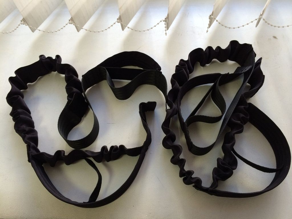

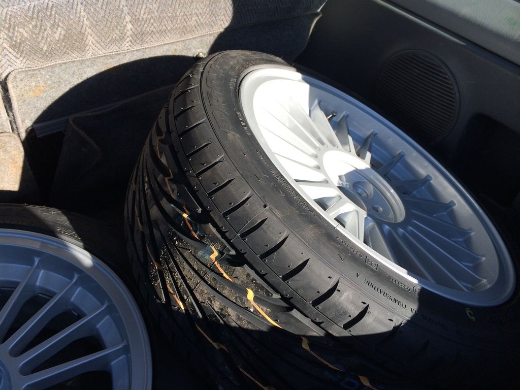

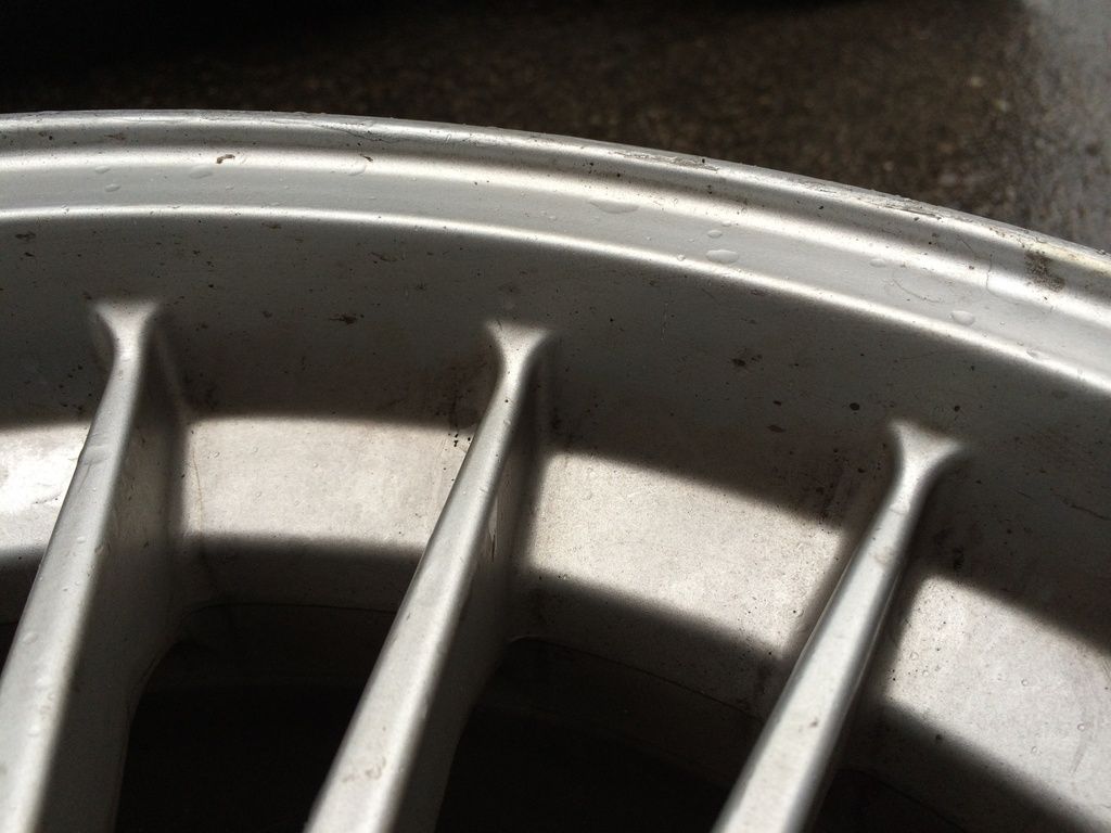

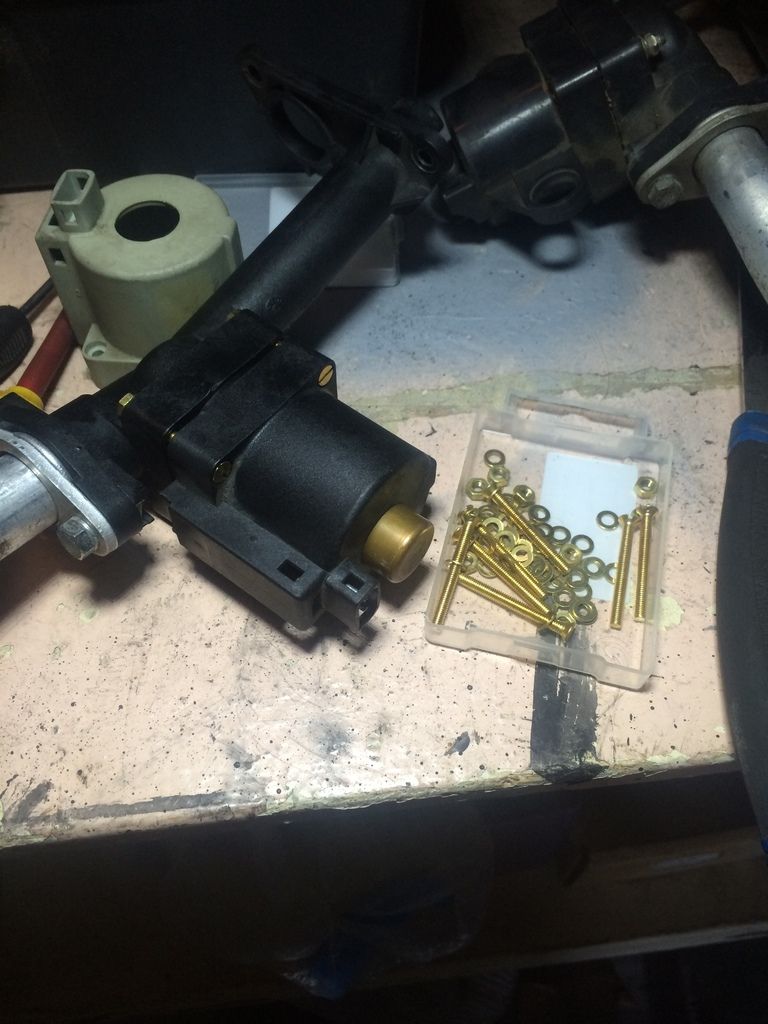

elastic bandages for folding top. when change them top closes so smothlly - no more need take care of folds

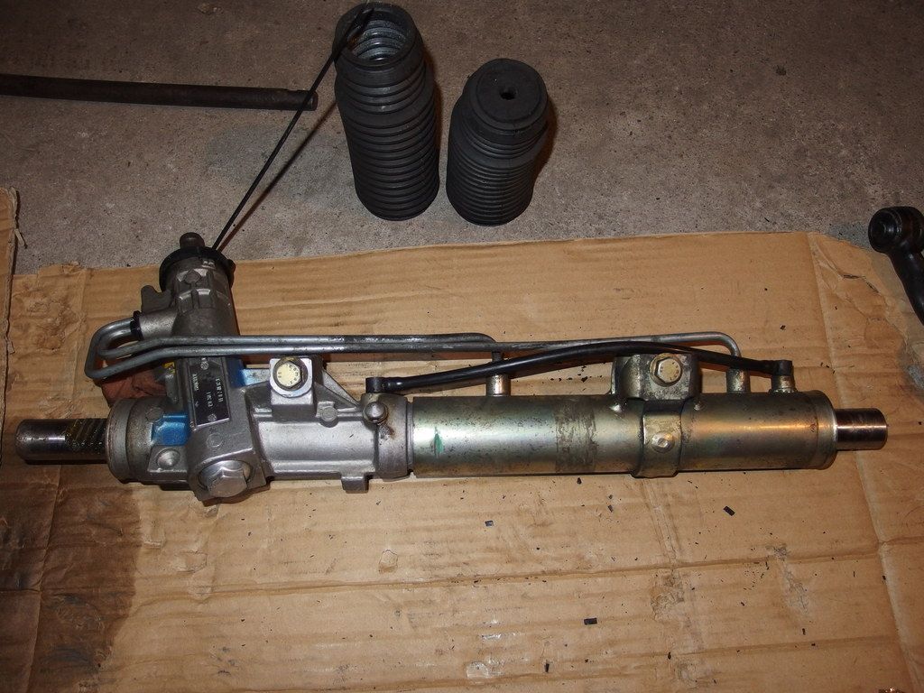

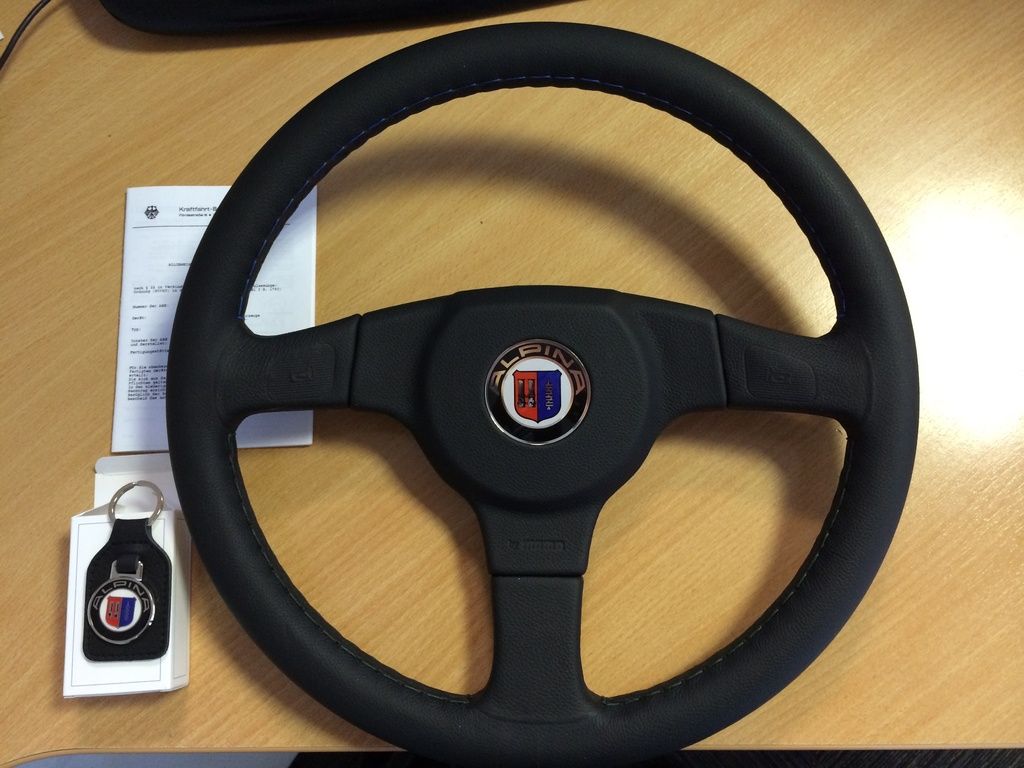

z3 steering rack - 2.7 turns total rack travel

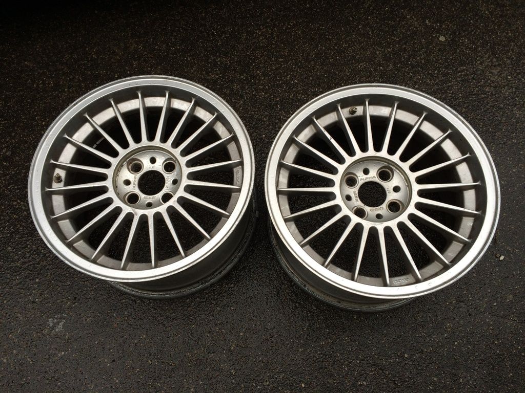

super rare Alpina size 8J
new tyres for refreshed alpinas

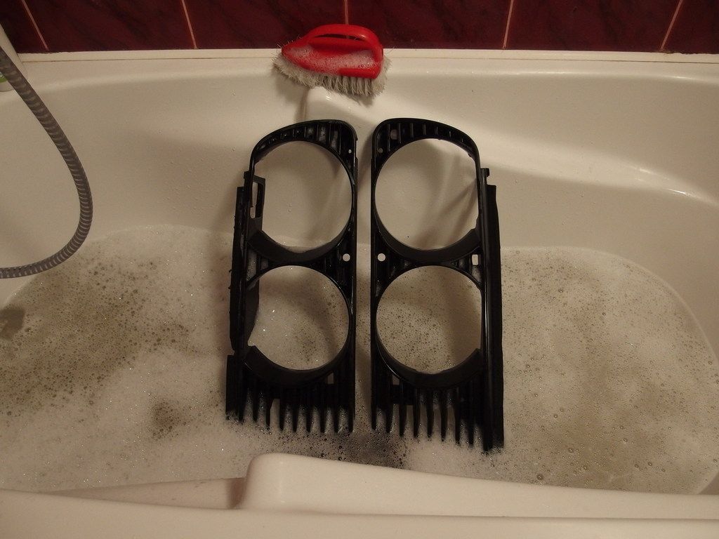

lets clean - wife not happy :D

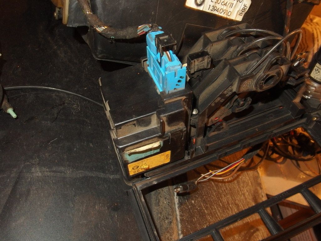

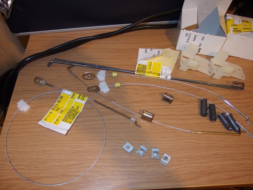

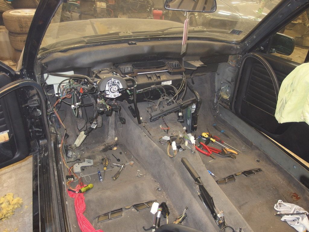

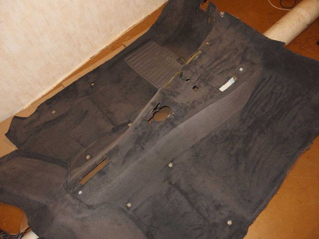

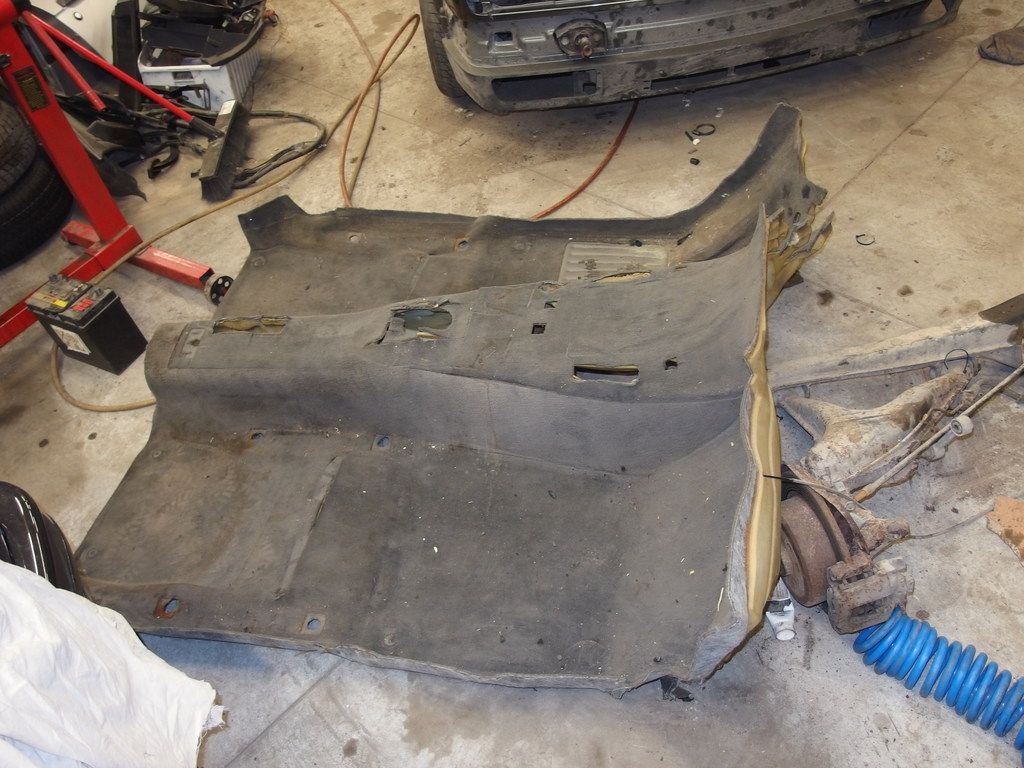

mission - clean carpet and change heater unit to max possible version with AC and electronic temperature regulator (in catalog option S535) :)

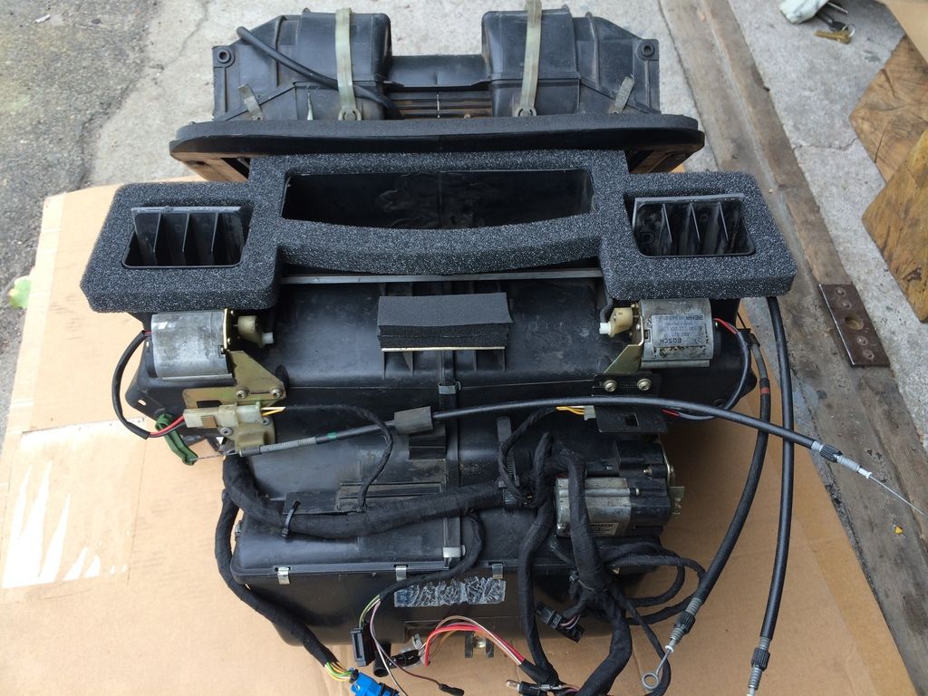

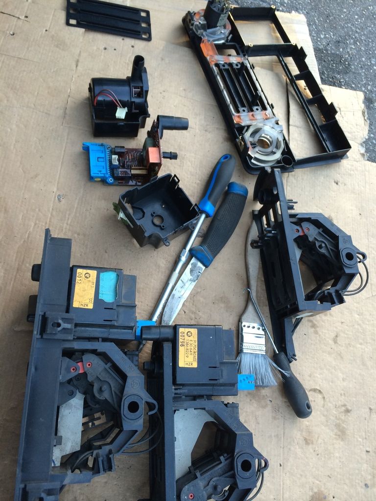

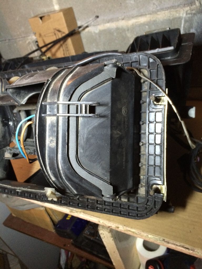

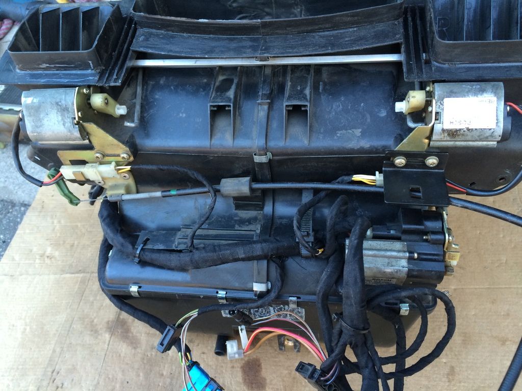

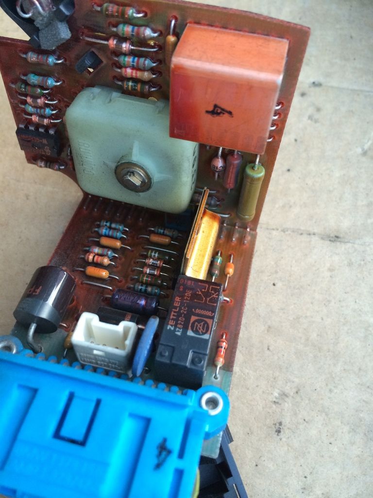

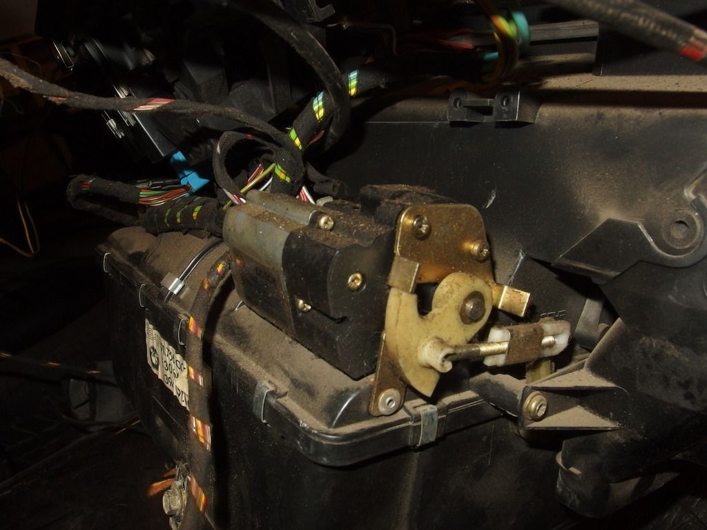

So what means S535 ELEKTRONISCHE TEMPERATURREGELU
This option you can find mostly late e30 from 90-93 especially Executive edition series.
German WIKI https://de.wikipedia.org/wiki/BMW_E30#Edition_Executive
With electronic temperature regulator can be equipped all types of salon heater units
1. standard heater only + electronic temperature regulator
2. heater with micro filter (heater body is nearly similar to AC body) + electronic temperature regulator
3. top version: AC and heater + electronic temperature regulator
To get top version of electronic temperature regulator I bought complete car! 324td 92 year packed full with all extras.
and disassembling
here are heater with micro filter + electronic temperature regulator
kro
Posts: 82
Location: Riga. LV
Post Fri Sep 11, 2015 11:28 pm

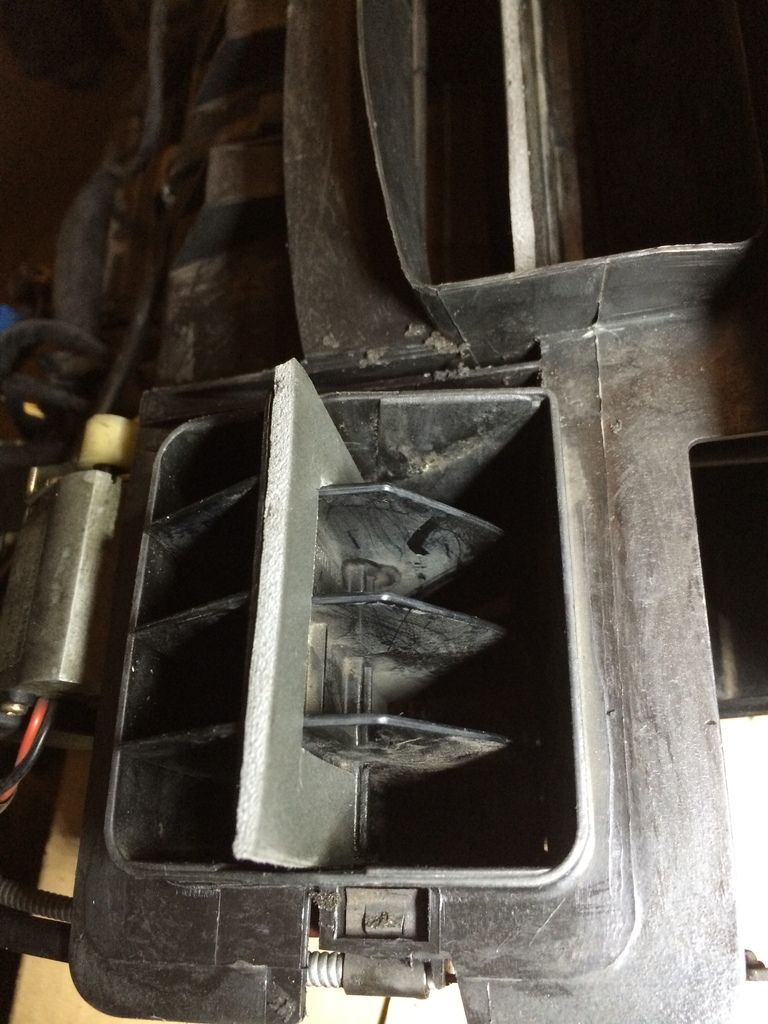

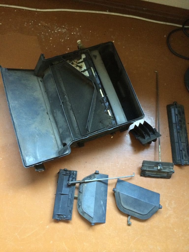

let's refurbish it

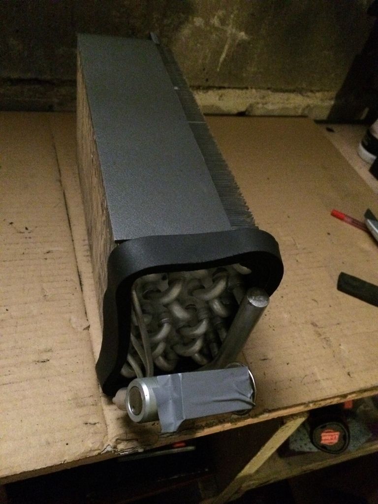

change to new heater, evaporator, thermo/heat isolation, isolation on vents, blower motor
check electronic and connections
compare all versions :)

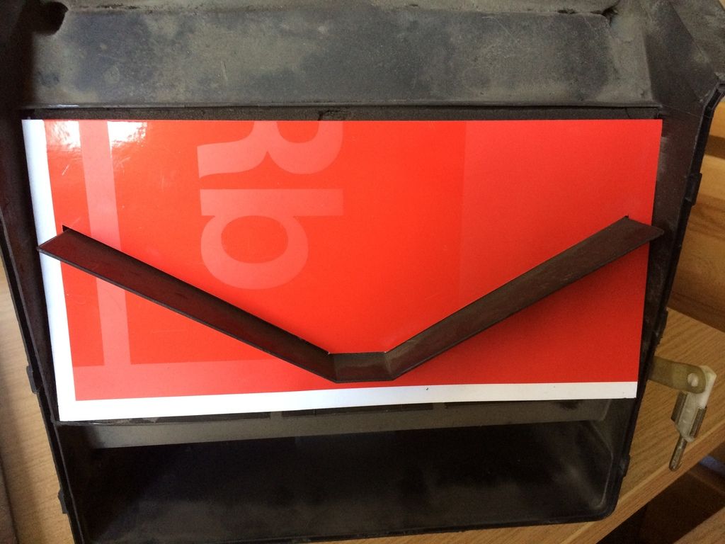

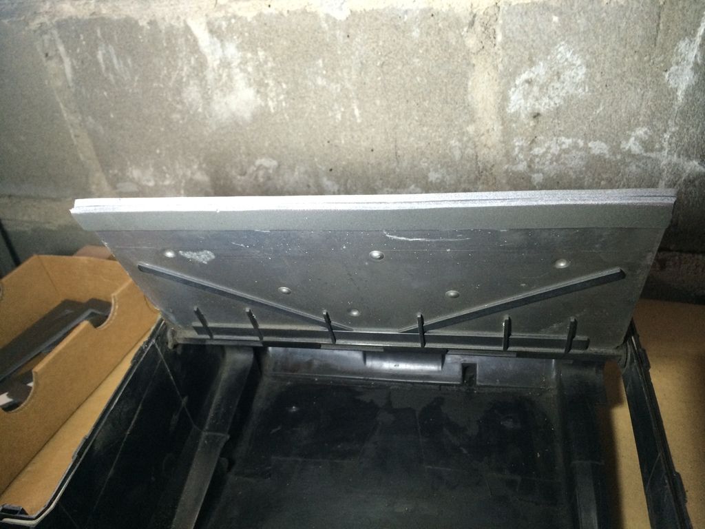

heat isolation
remember childhood and make templates
cut
and hardest part :D
evaporator
almost ready

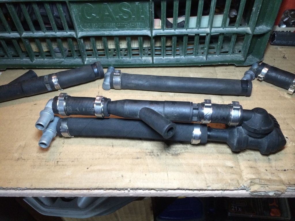

never forget check heater valve... officially it not repairs but technically it quite easy task
so here are examples what are inside after 20-30 year of e30 life :D
finally one of them cleaned, repaired and checked if works. when you check be aware of valve polarity ;)

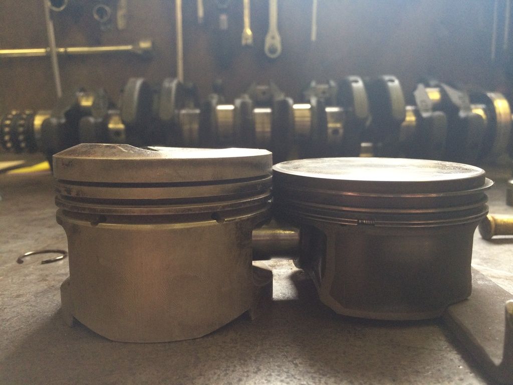

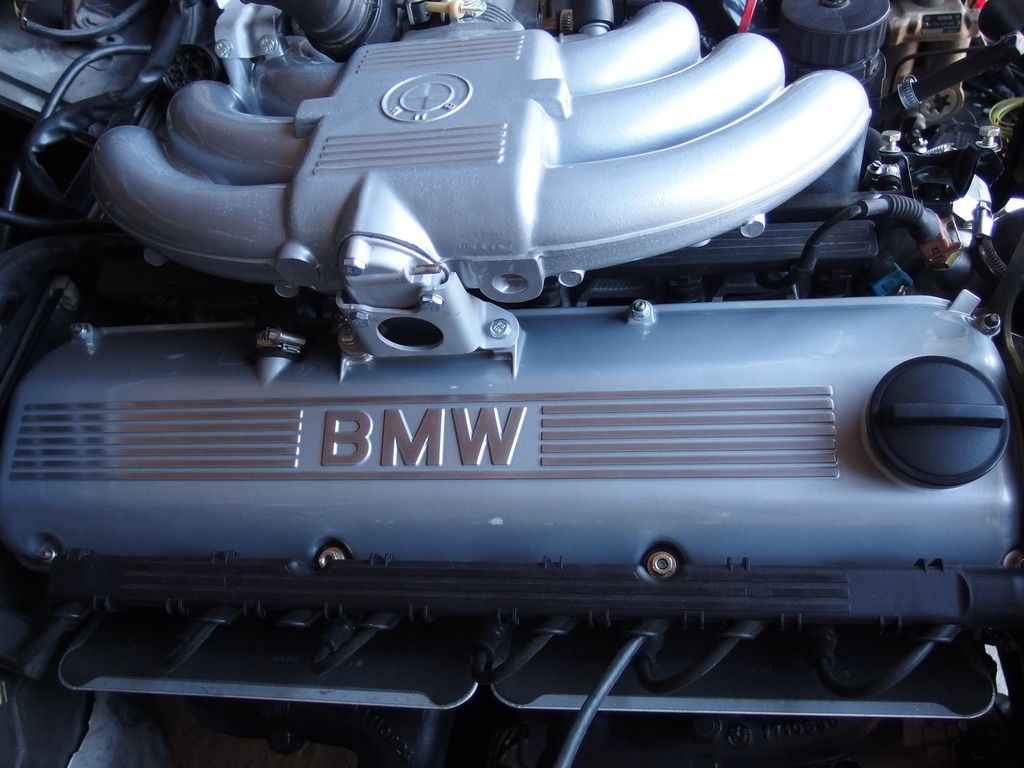

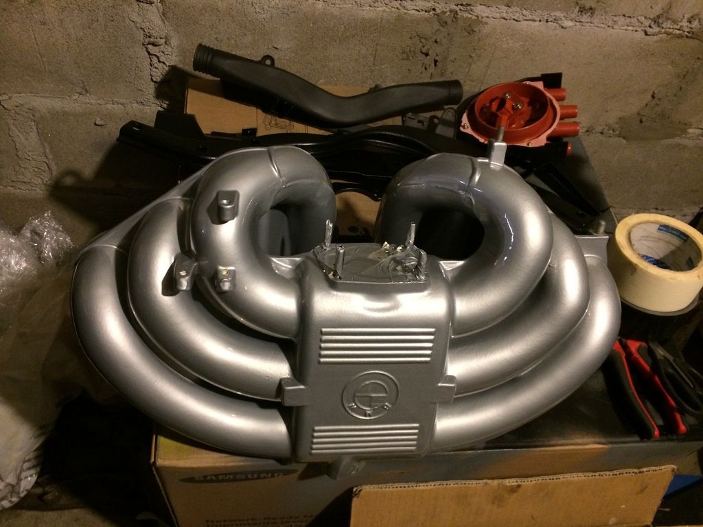

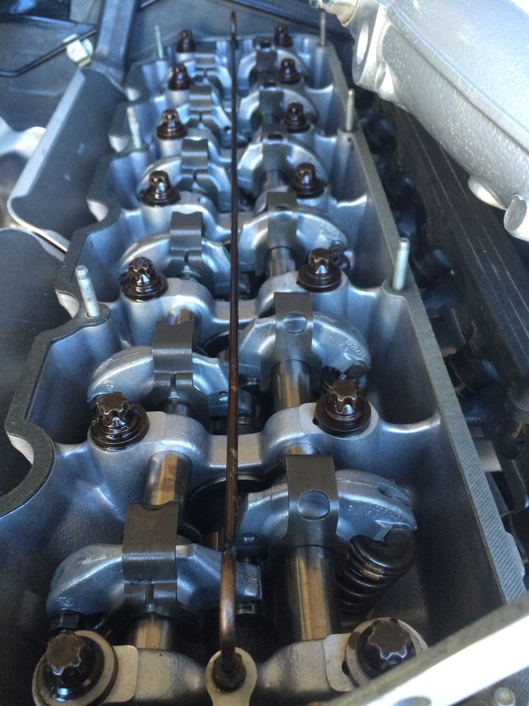

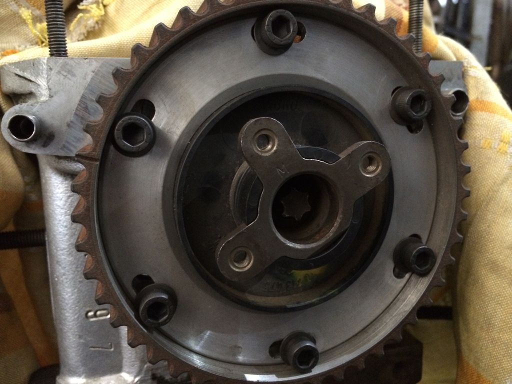

engine
as mostly all things do by myself at free time except serious paint works and welding than engine build process take long time
finally build stroker m20b28 with schrick 274/288 camshaft and other slight modifications but keeping all setup street legal and at comfort zone
some random pic of process
actually most time takes all stuff around engine - about that next posts later :)

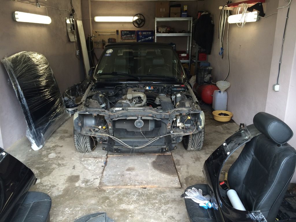

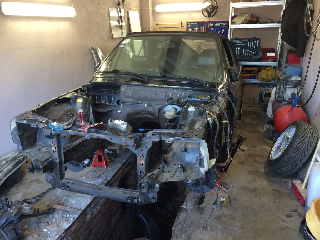

Post Tue Sep 15, 2015 3:29 pm

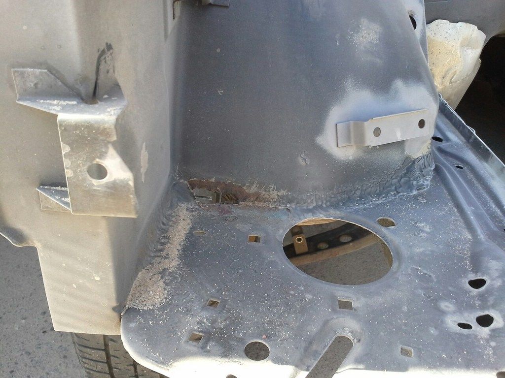

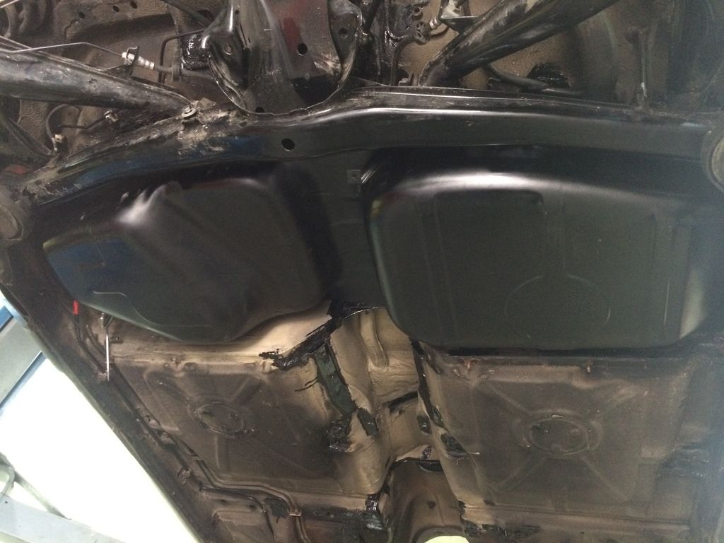

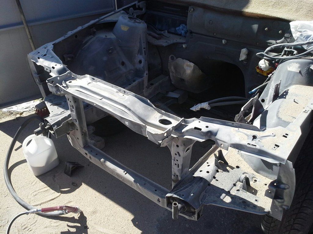

2015 spring ”“ time for engine upgrade from m40 to m20 and change all gathered stuff

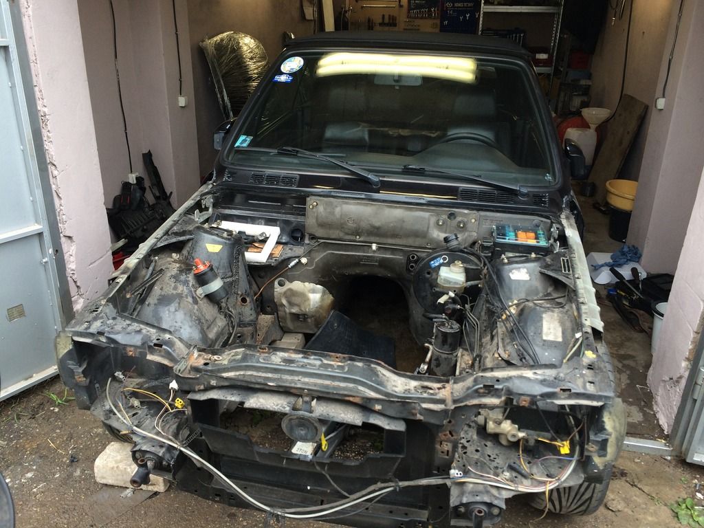

Carefully removed front body parts and wrapped in plastic as they already painted previously
Removed all changeable stuff

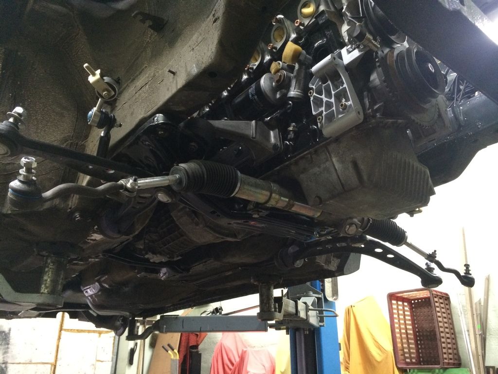

uh, lot of junk.. petrol tank, gearbox, all exhaust stuff, front sub frame elements etc.

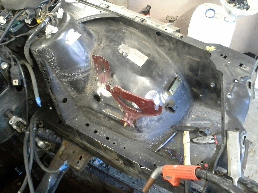

Preparing holding brackets for M20

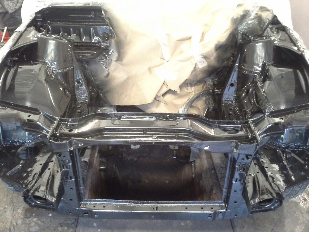

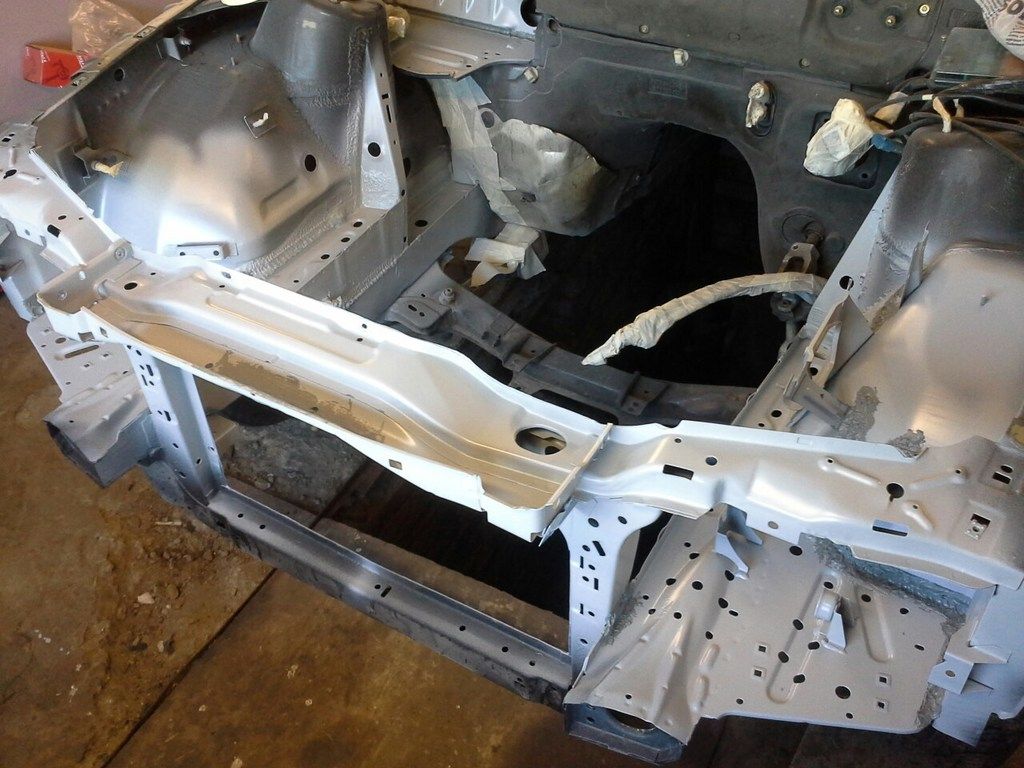

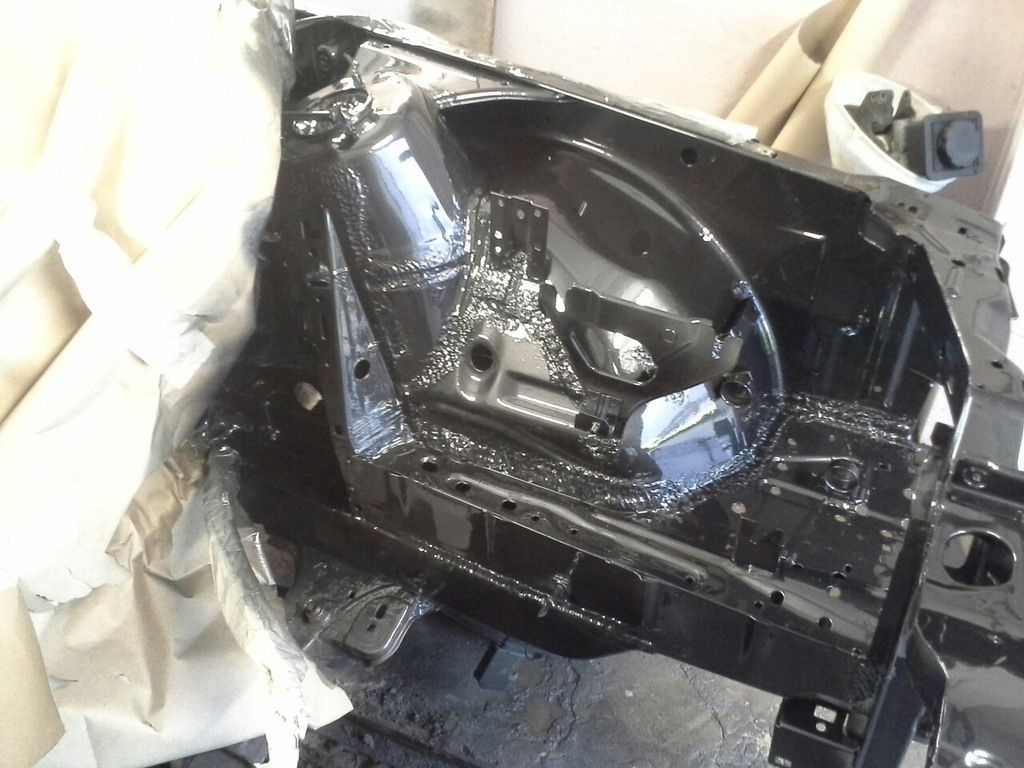

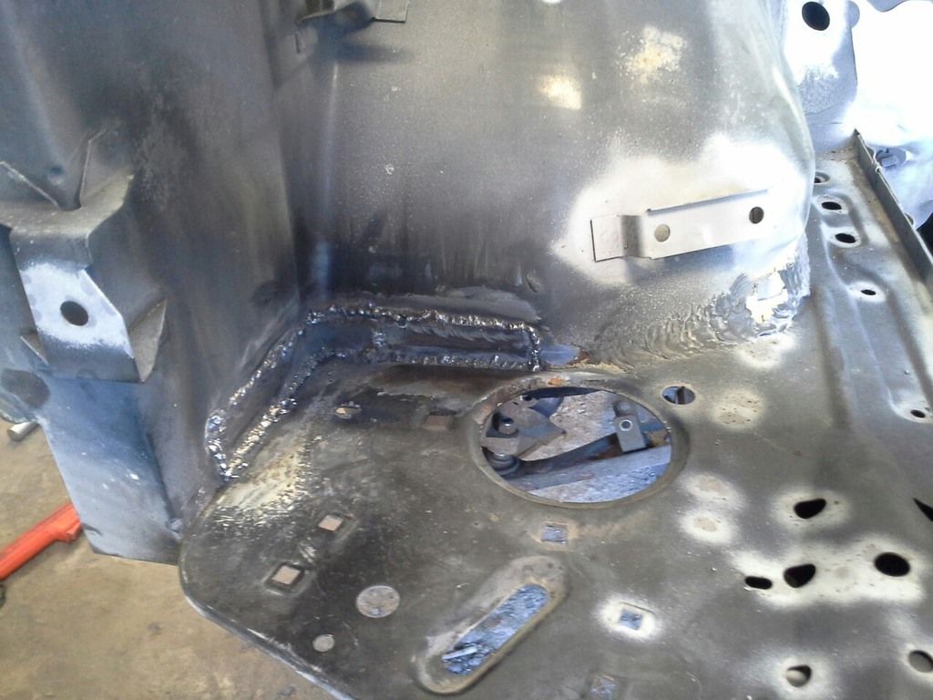

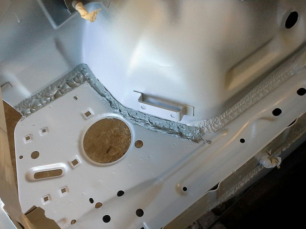

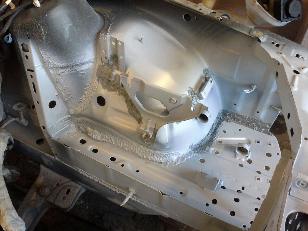

Sandblast, welding and engine bay painting works]
kro
Posts: 82
Location: Riga. LV

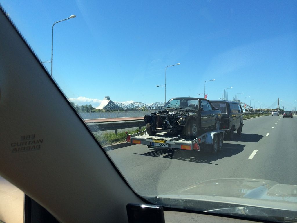

Post Tue Sep 15, 2015 3:51 pm

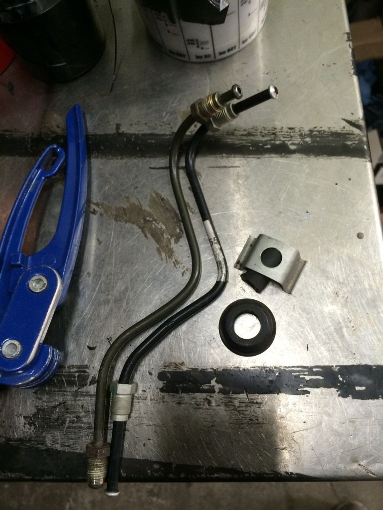

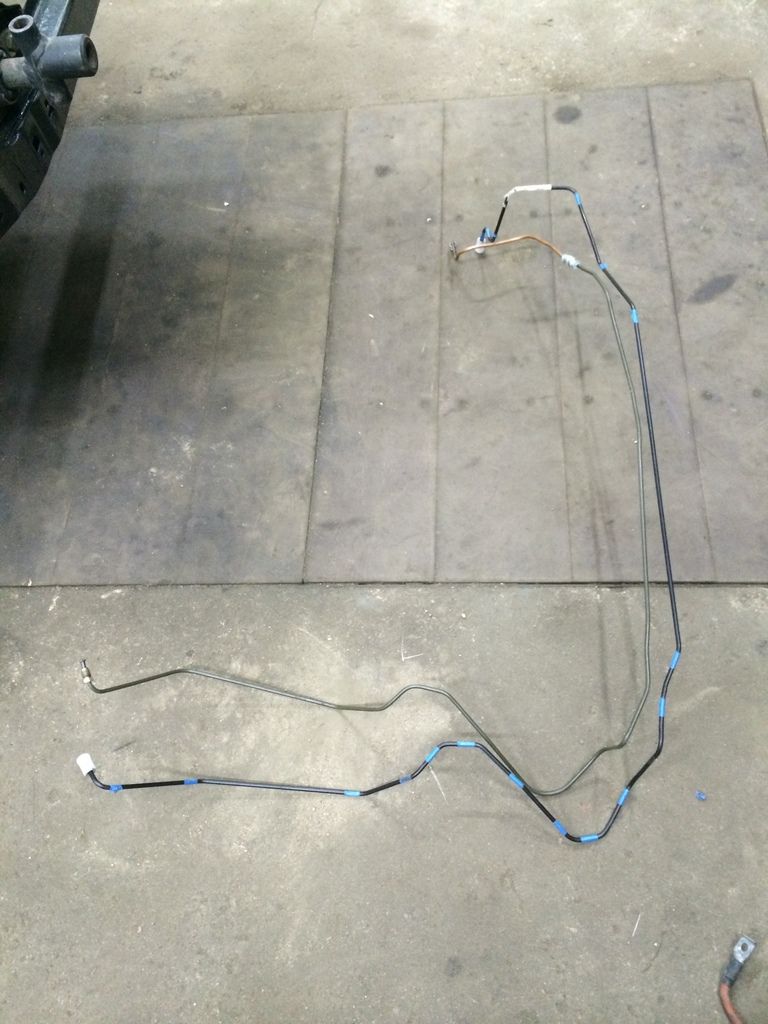

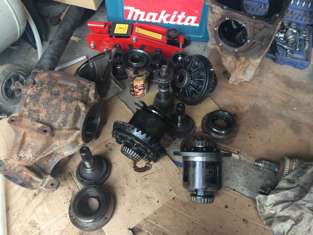

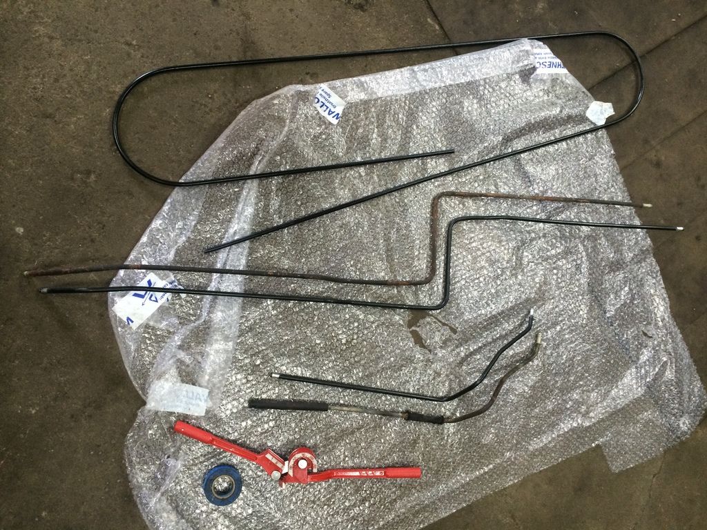

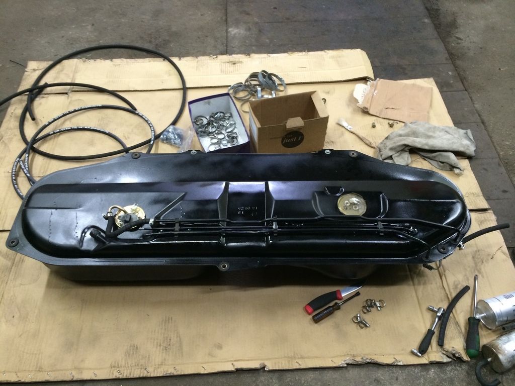

Travel to my friend’s service premises with car-lift and other valuable service equipment. There will happen magic :)

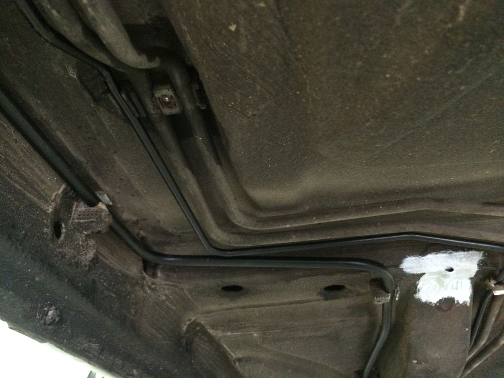

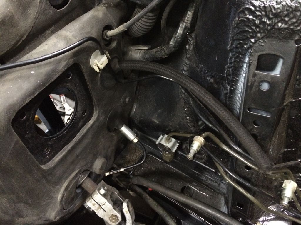

Few days of changing hoses for brakes and fuel. OEM hoses is straight with proper endings and made from iron. Bending need lot of patience and mistakes not forgiven.

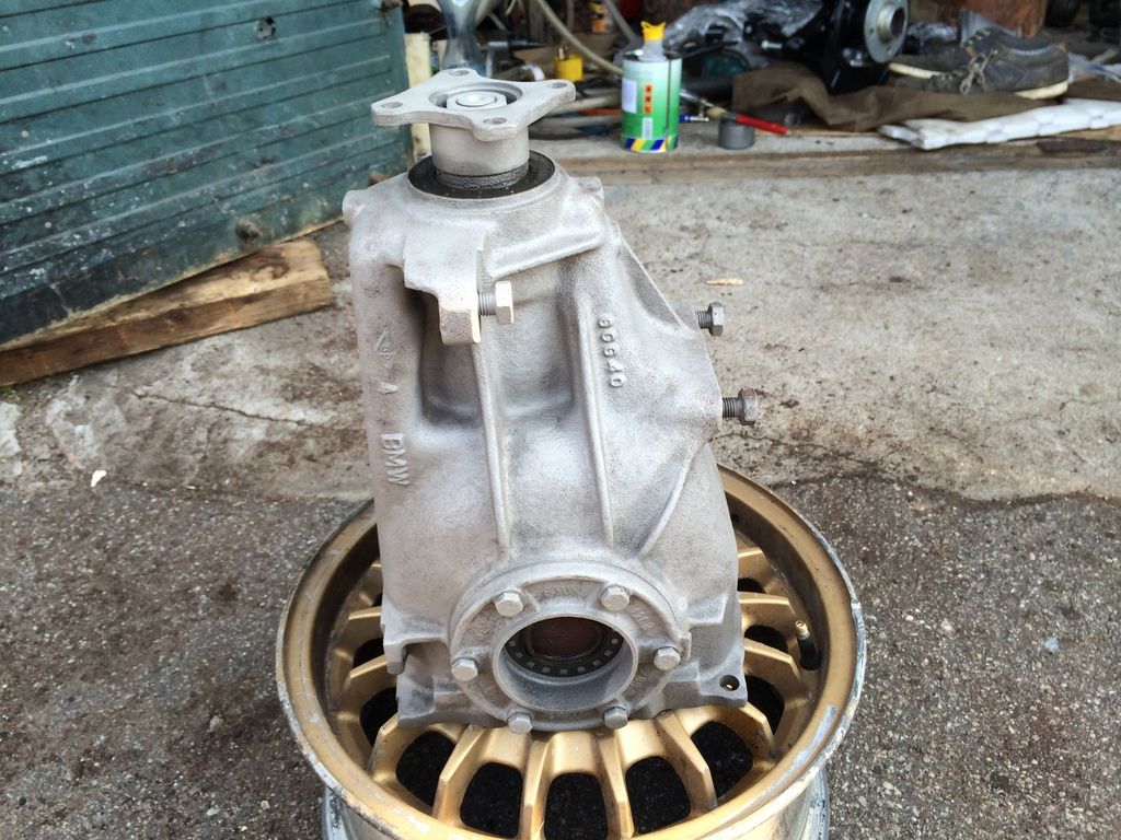

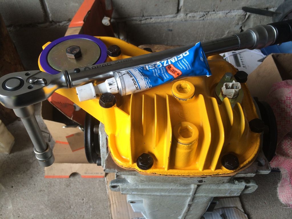

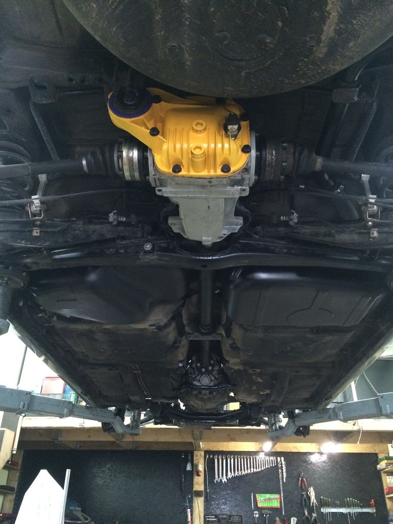

LSD Diff
Changing all bearings, sealing’s, friction plates, make cosmetic, proper measurements of teeth contact etc. Lot of work and quite expensive.

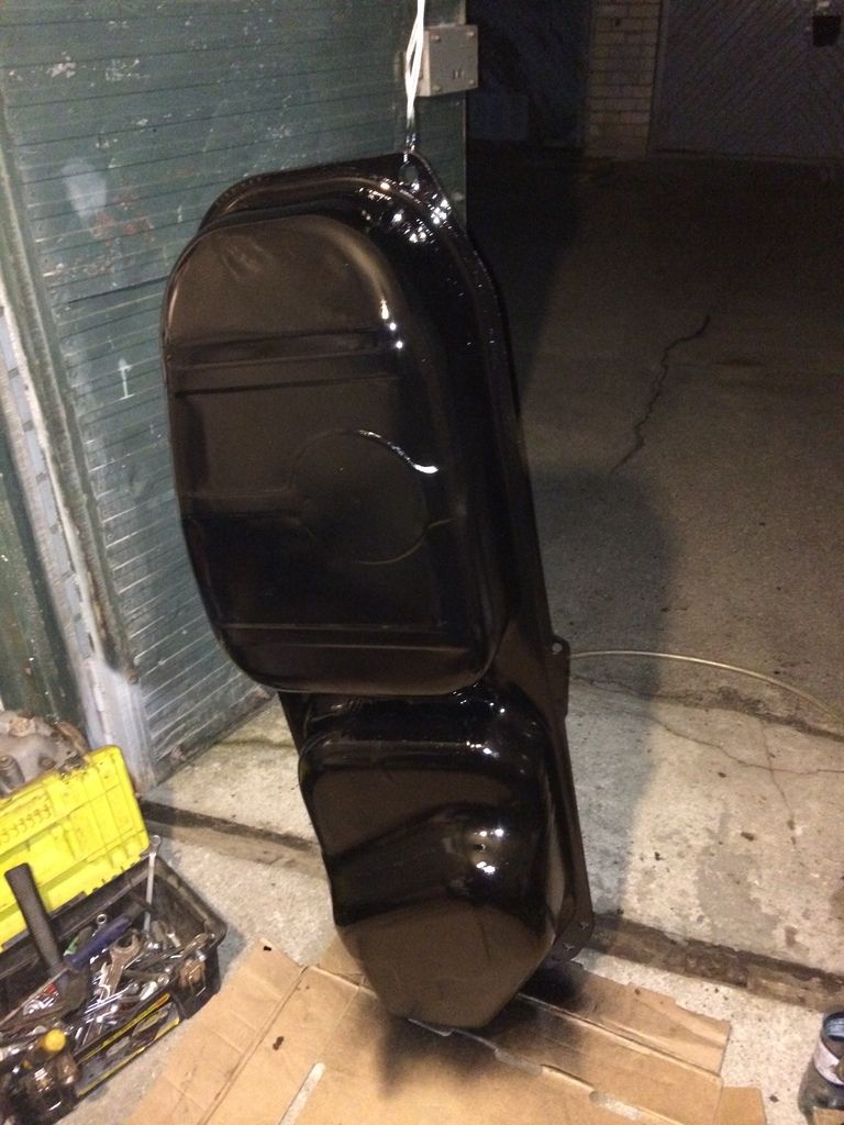

new fuel tank, fuel lines etc.
kro
Posts: 82
Location: Riga. LV

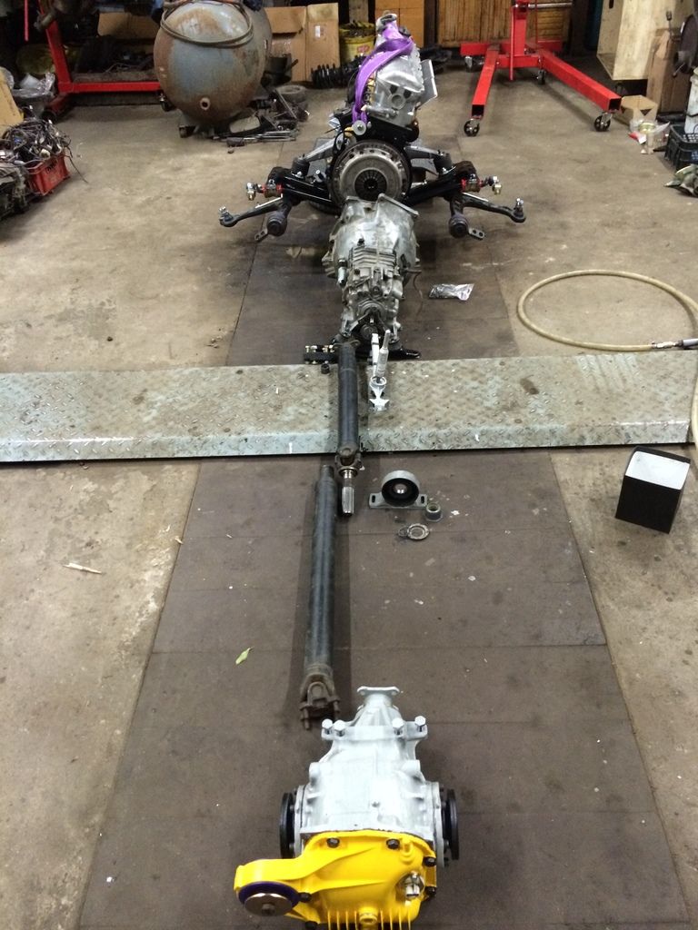

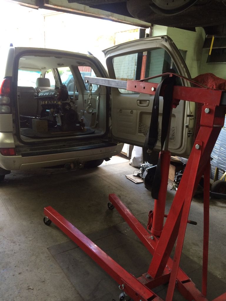

Post Tue Sep 15, 2015 5:38 pm
most important thing ”“ engine loaded in my ”acargo vehicle”a
unloading
front subframe assembled together
install top of subframe engine
all what need install
save your back and use power tools :) gearbox bolted to engine
now car body and engine is ready to marry :) bring down the body”¦
here most difficult is fit the steering rack shaft and after that screw 4 subframe bolts
little help with lifter to get in place subframe
yes ”“ they are promised never divorce and live happy all life

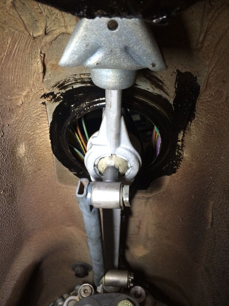

gearbox z3 1.9 shifter instaled
propeller shaft and diff in place
heat insulaton elements
ready for vacuum, new clutch master cylinder installed as well
other minimal stuff for test start ”“ I am impatient

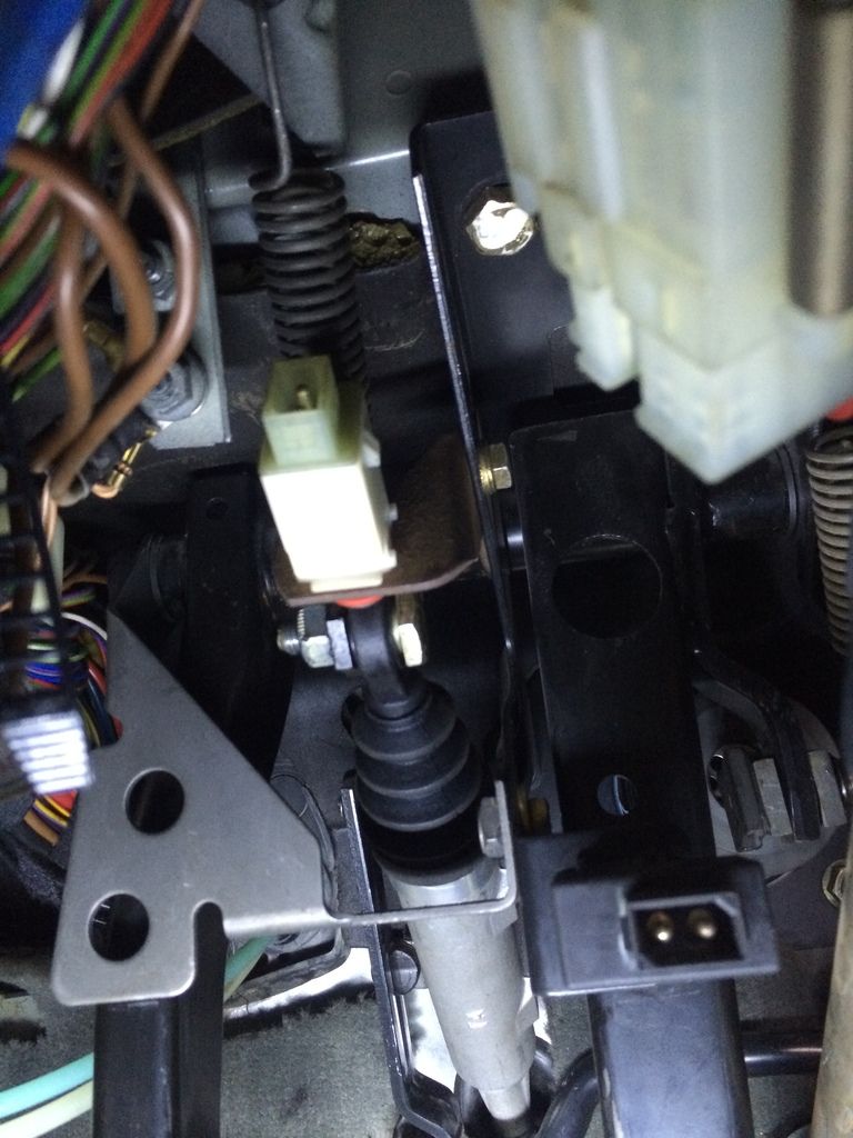

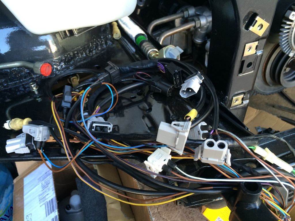

Post Fri Sep 18, 2015 8:30 am

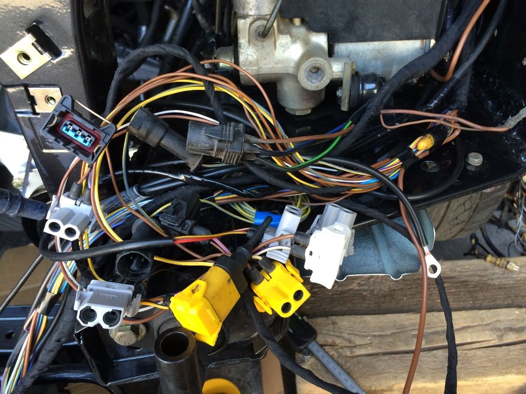

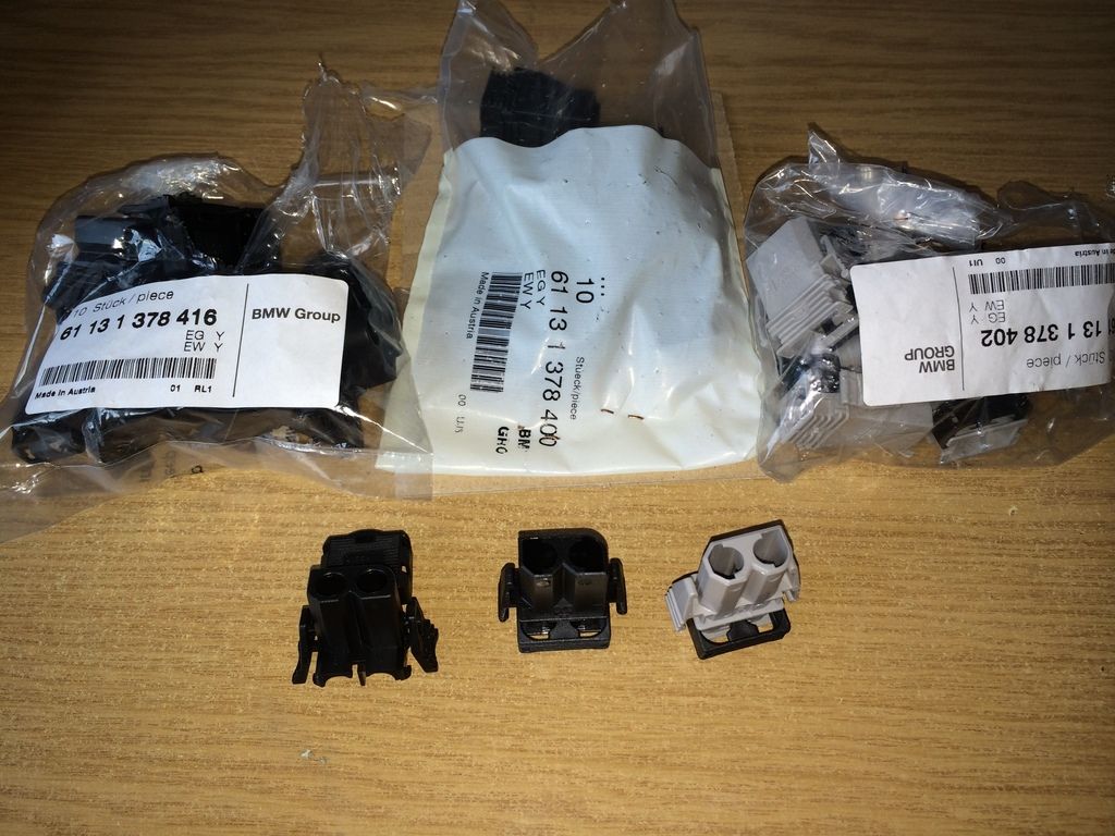

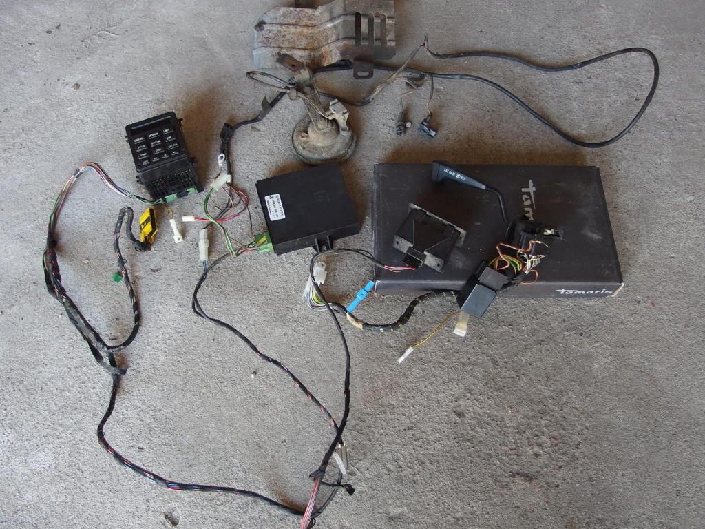

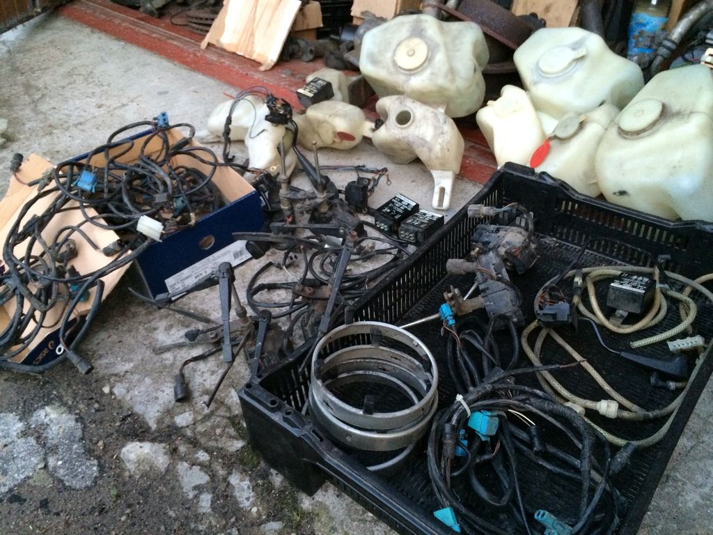

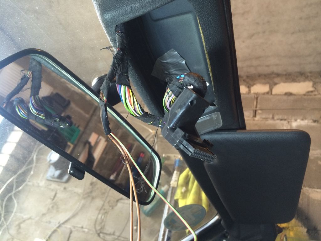

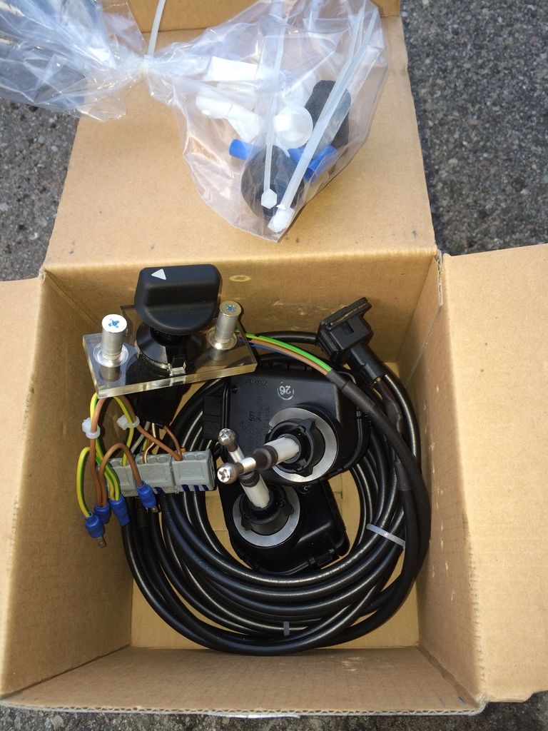

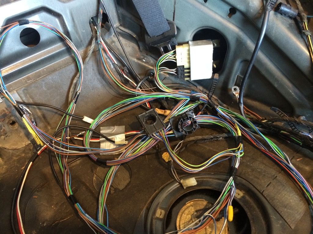

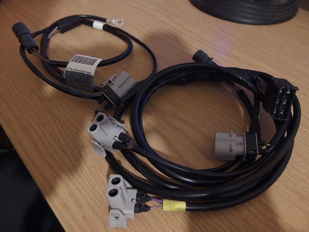

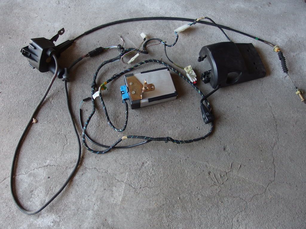

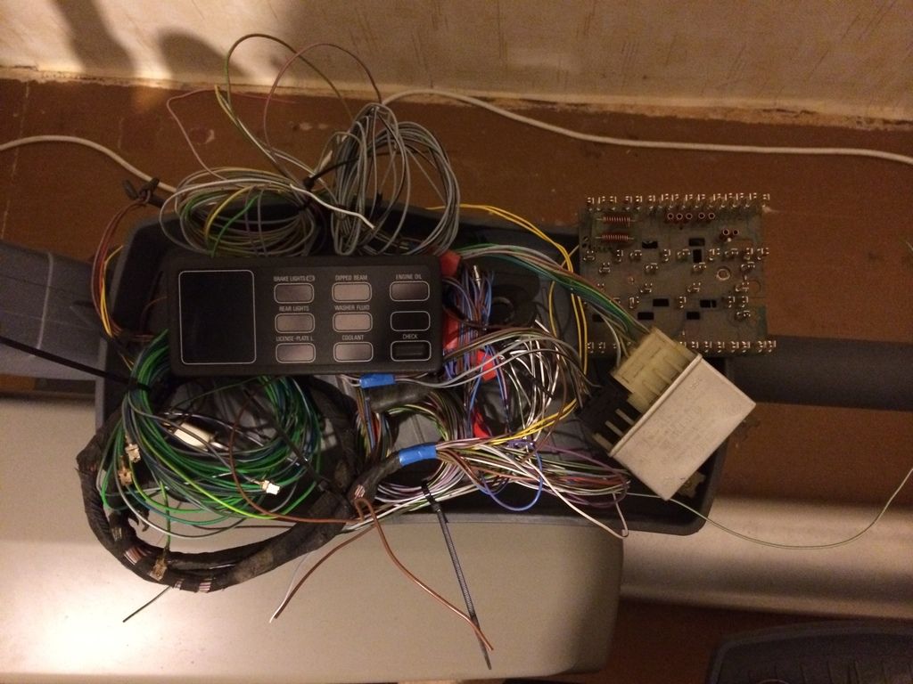

My car originally was 318 it did not equipped with check control
To get this option is only two ways: change complete car wiring loom or solder in necessary components
Possible donor wirings what I get was worst condition therefor decide solder
donor kit
check control atached
new HLWW loom
HLWW set's
new sockets
headlight corrector set
OEM alarm cover
wiring refurbish
ready for all possible extras
helpful tools
treasure box
old vs new

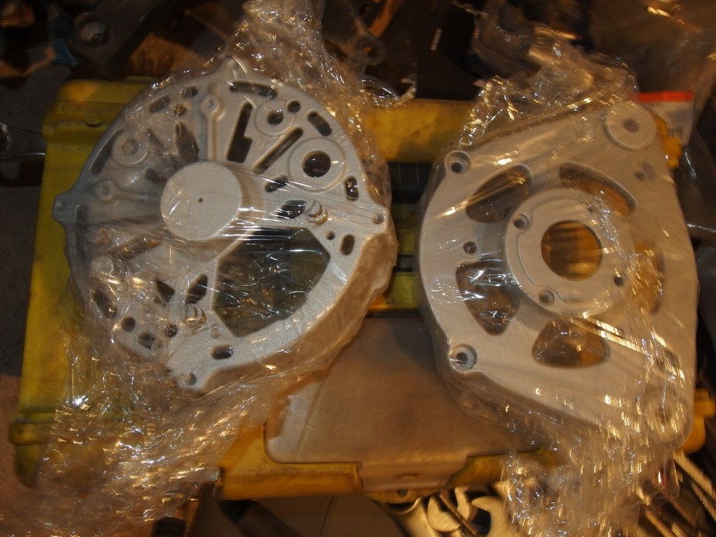

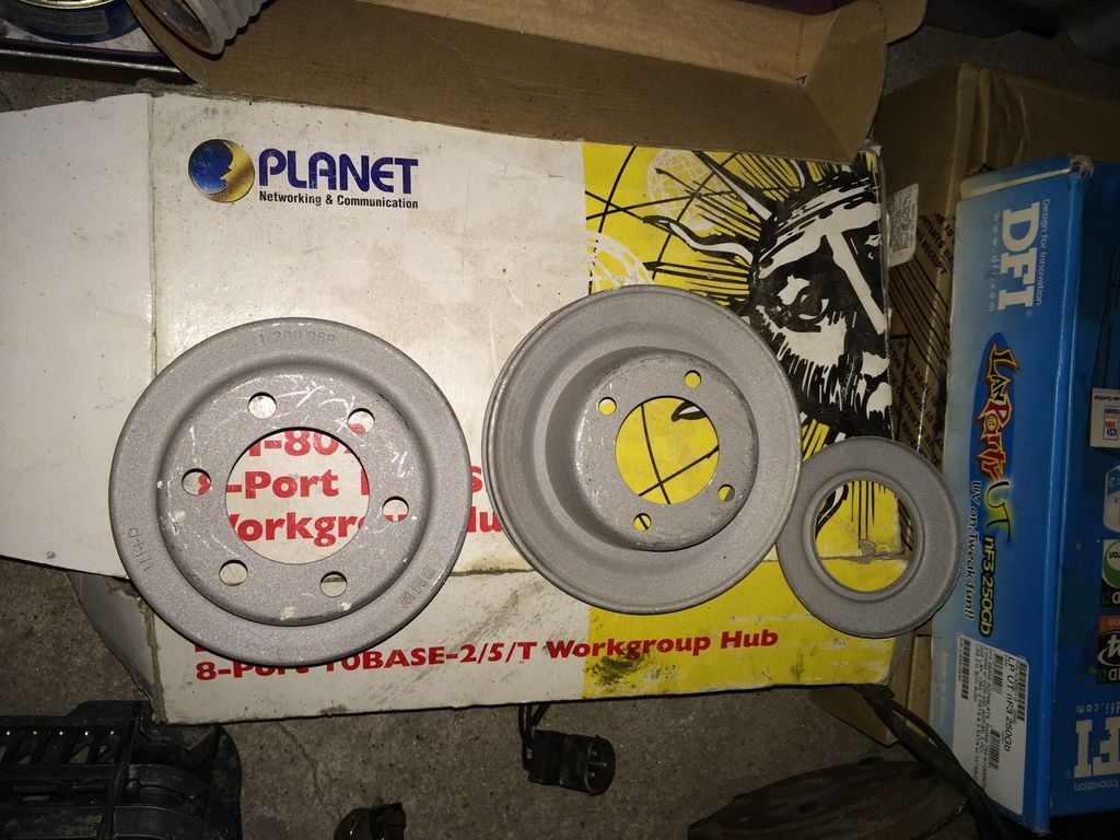

Post Fri Sep 18, 2015 8:31 am

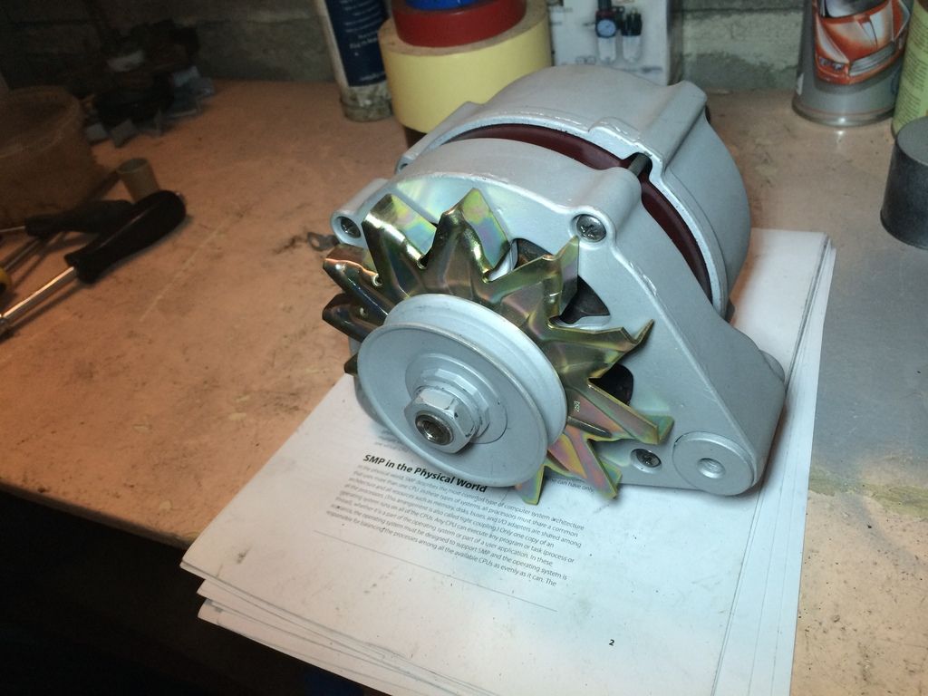

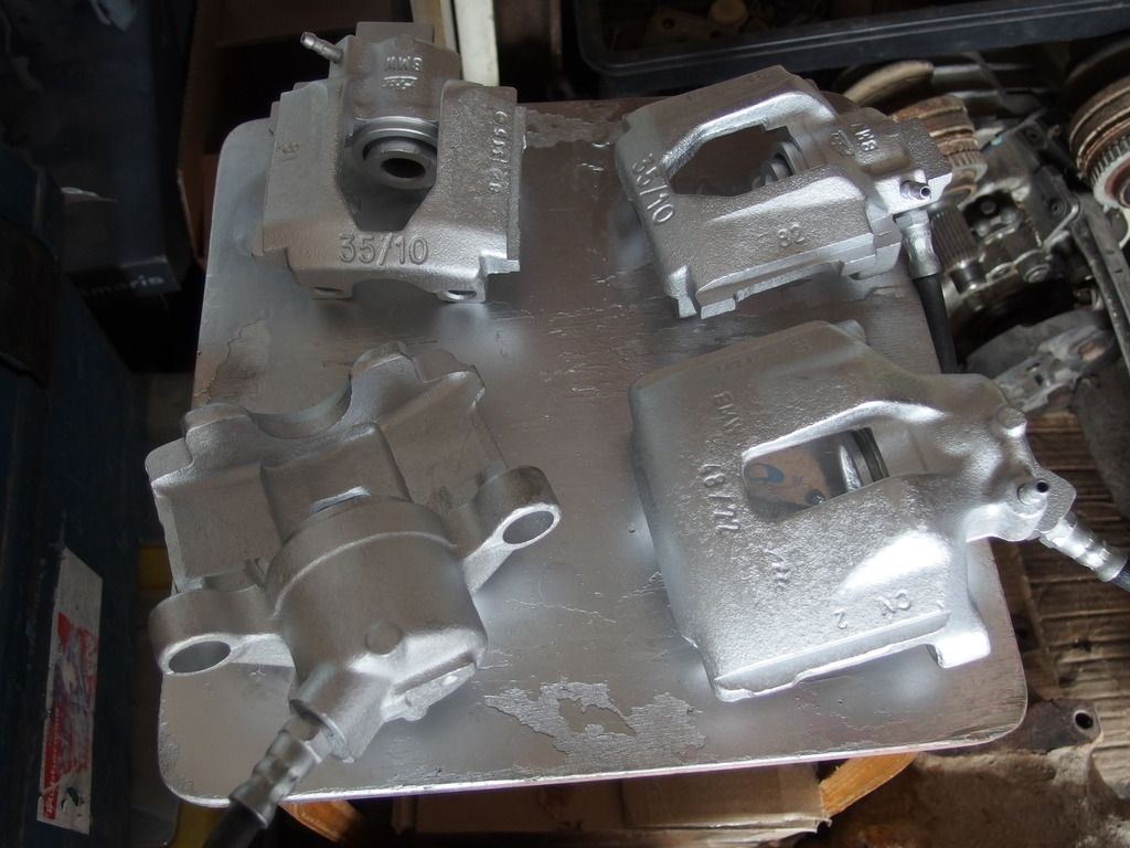

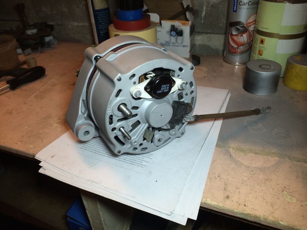

alternator
starter

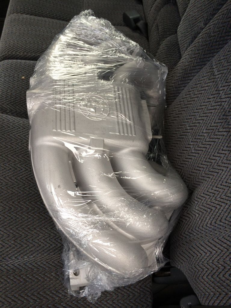

cleaning of engine parts
cleaned, verified and changed sealings
only form 14 nozzles get 6 usable

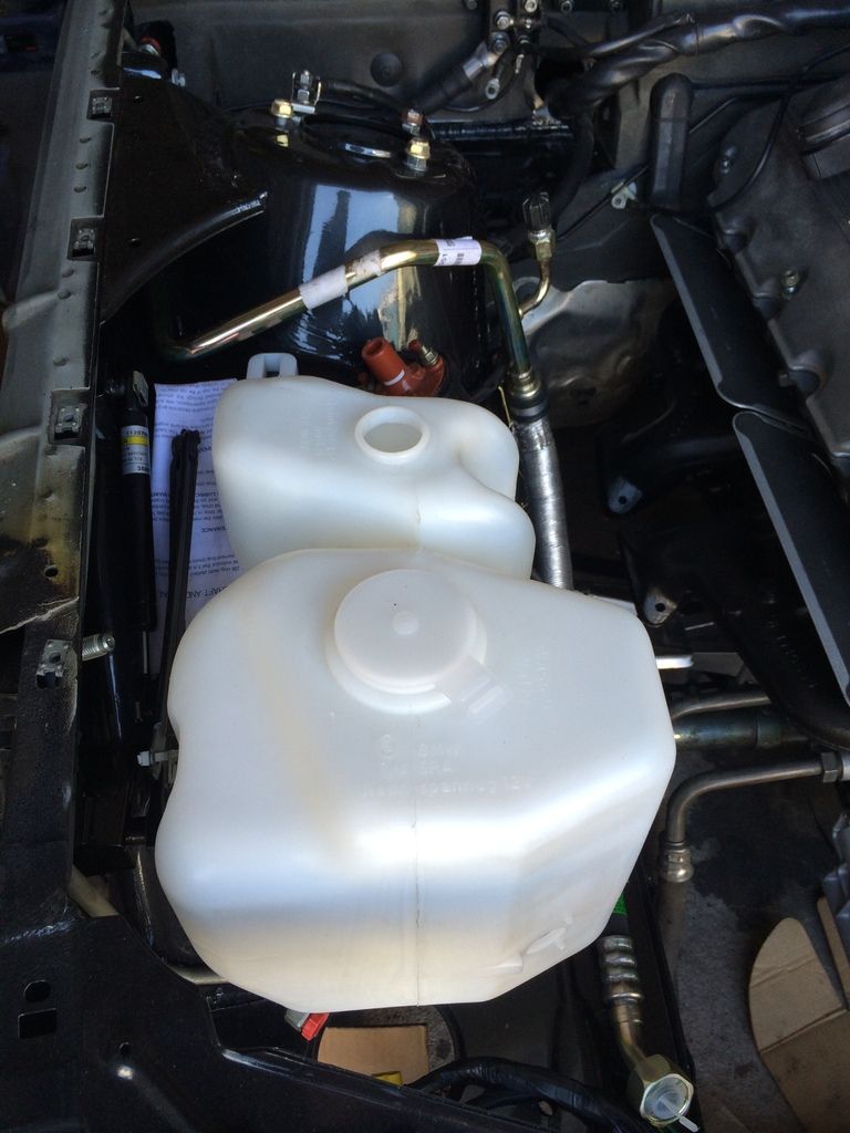

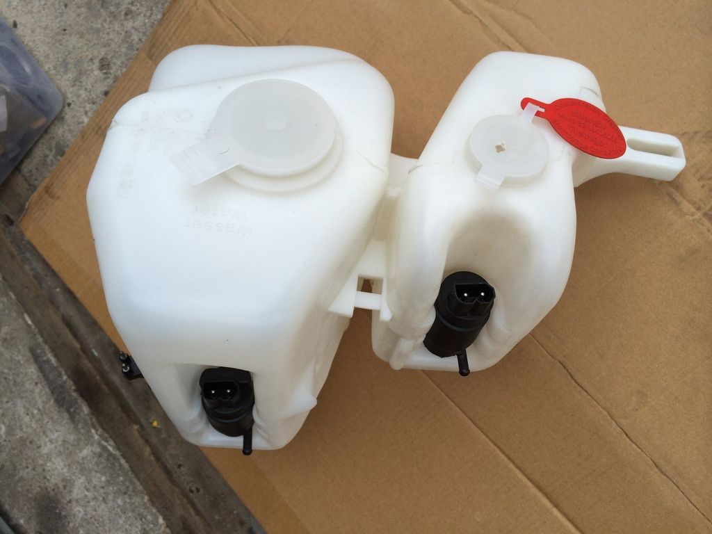

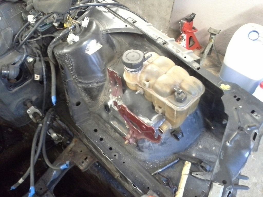

coolant conatainer
washer container

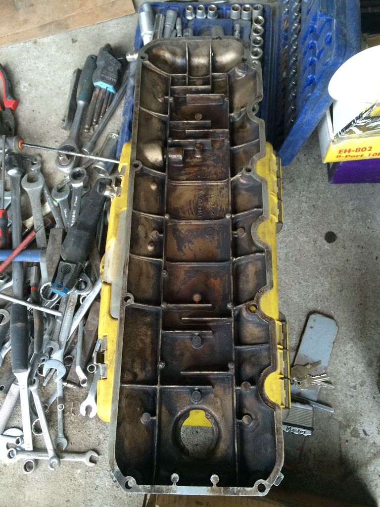

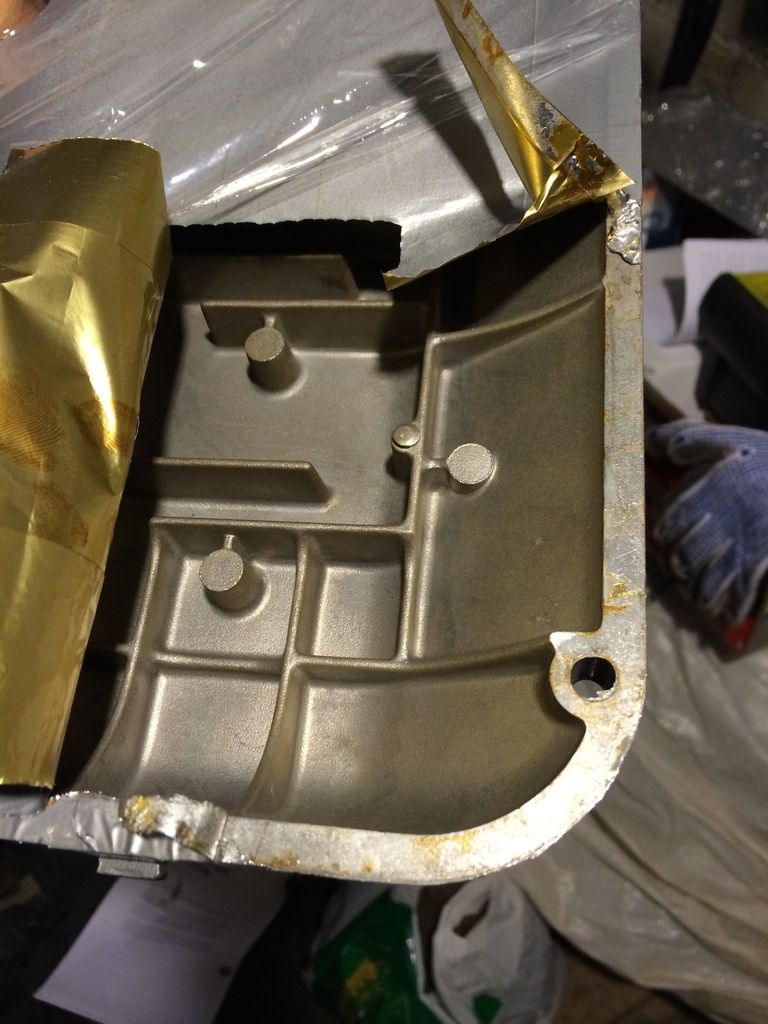

valve cover before and after ultrasonic cleaning and powder coating

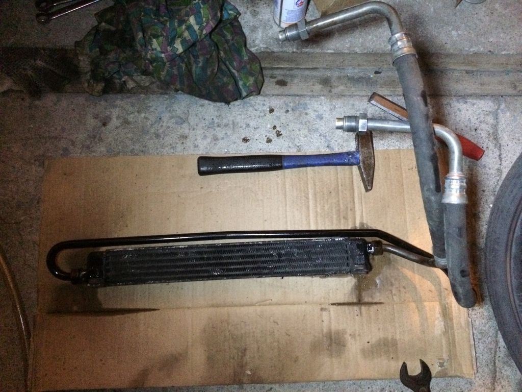

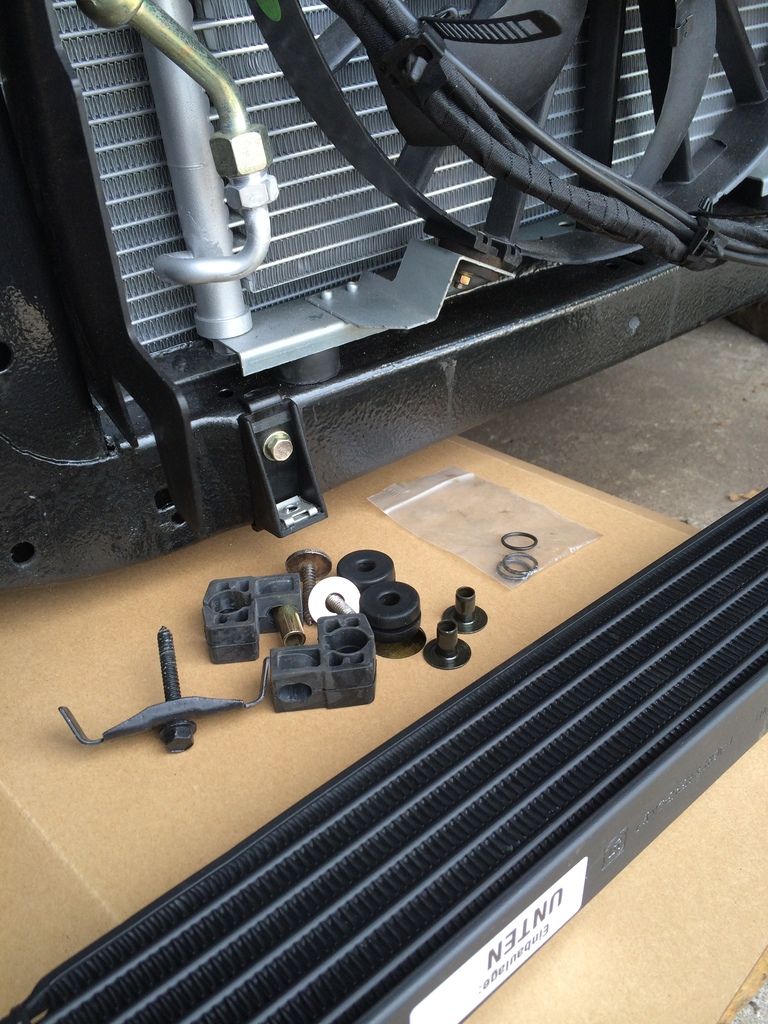

power streering

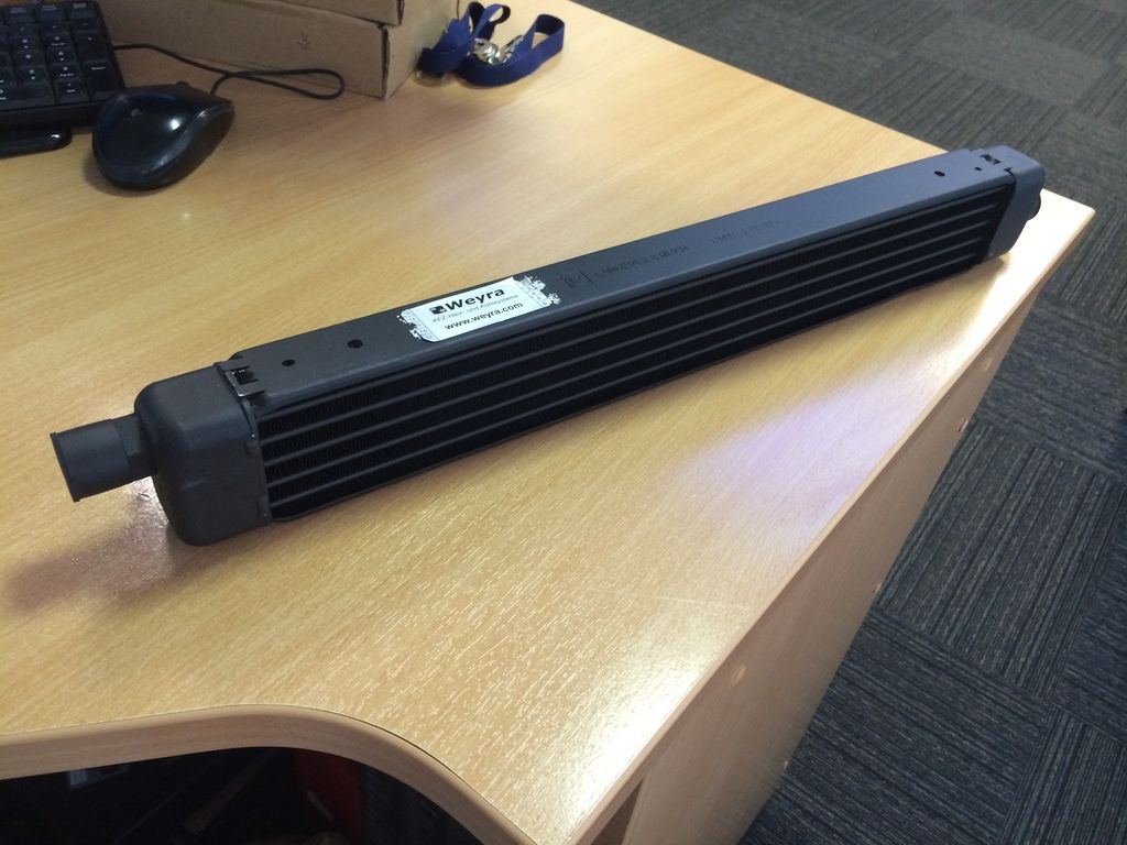

change oil radiator

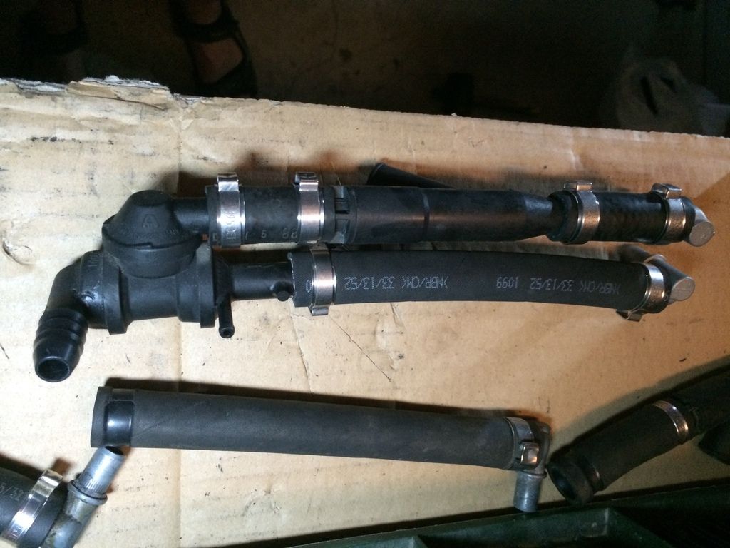

restore vacuum lines

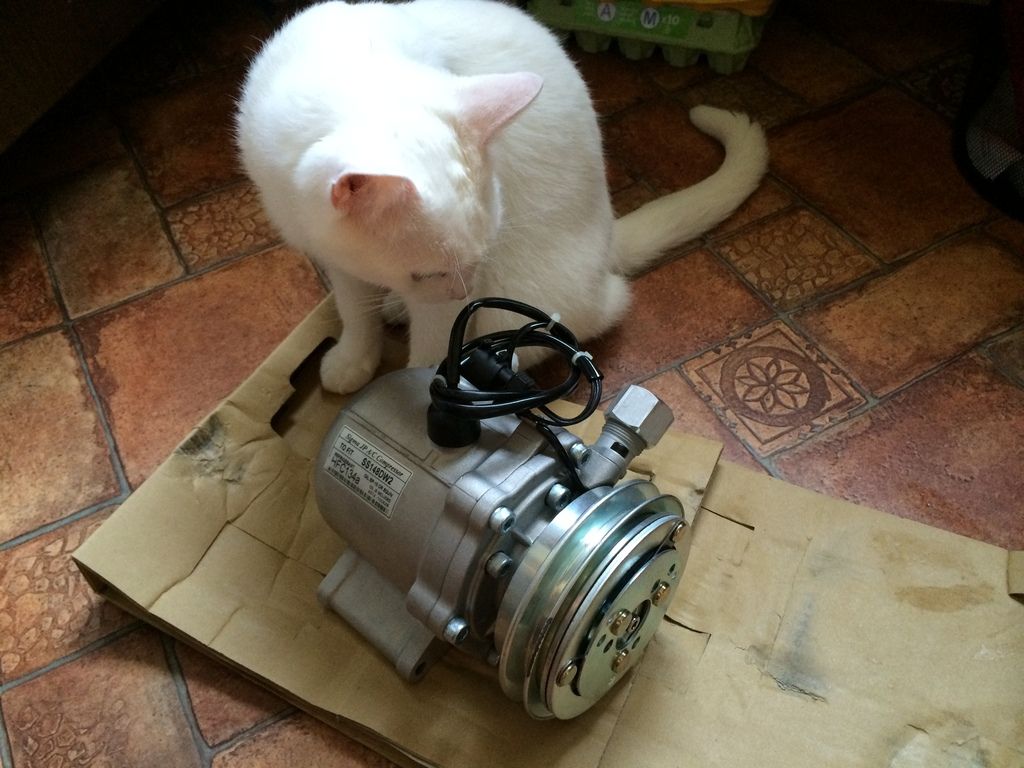

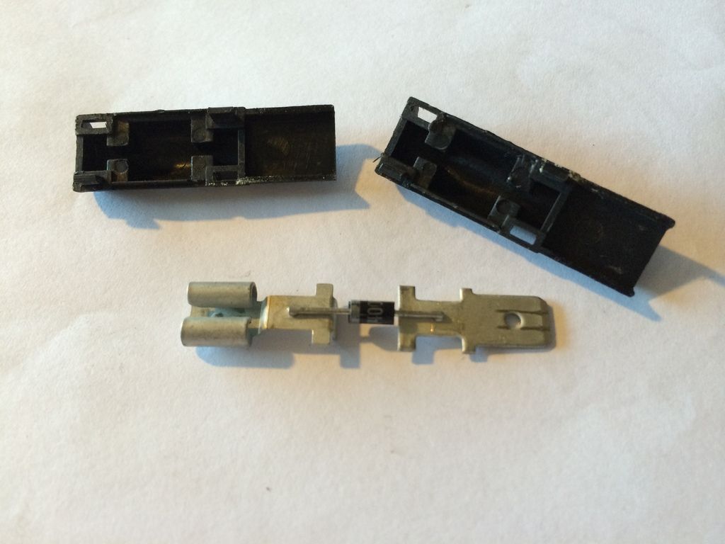

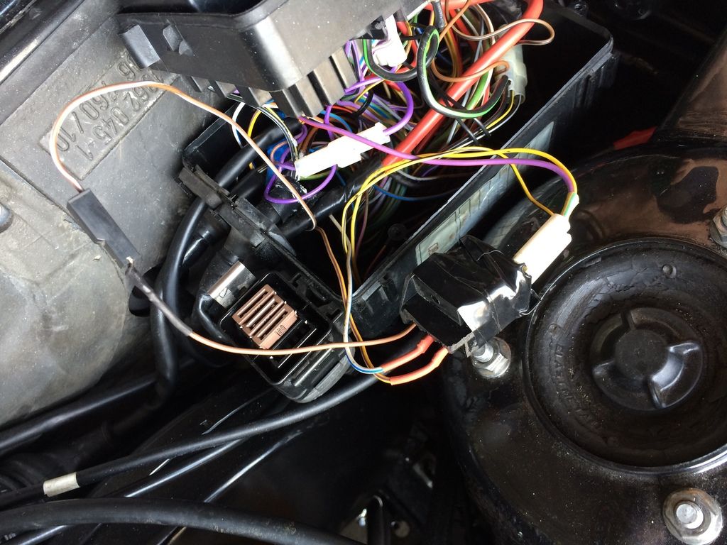

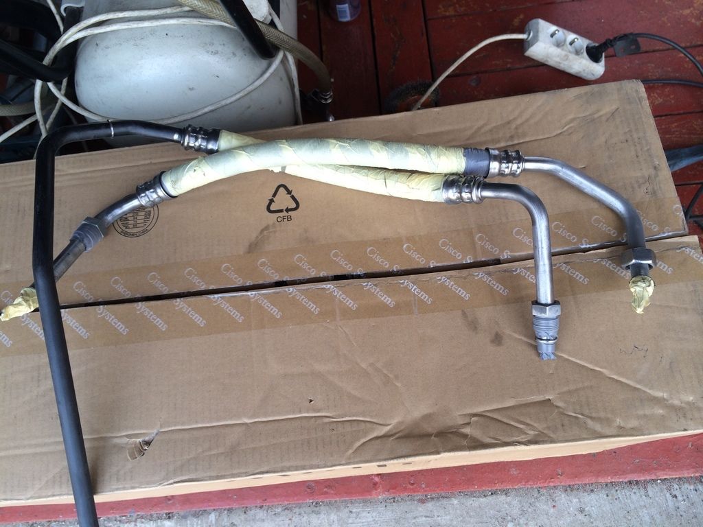

AC Retrofit
new hoses

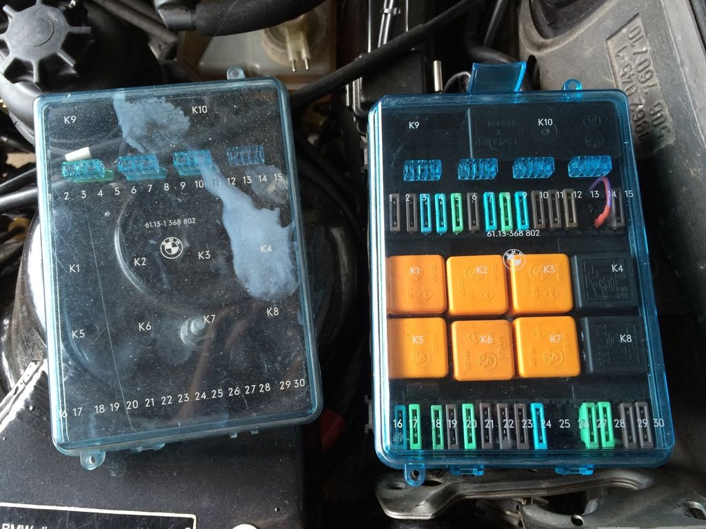

additional electric fan diode located inside fuse box
AC compressor - bad example
rust is everywhere because r12/r134a gas was very aggressive and if system stays long time open/without gas happens this
AC compressor - good example
moral of stroy
buy new one :D :)
my cat accepts it is as good enough
hoses instaled

List of items if you want retrofit AC
1. AC set form donor - heater housing with wiring, engine bay wiring for AC and additional FAN, old evaporator, hoses, old salon heater matrix, mountings, switch etc.
2. AC mounting stuff - plastic plugs, clamps, screws
3. HNBR O-Ring set
4. AC Compressor - if long time not used and lost hermetic not possible reuse due heavy rust (especially R12 compressors) of compressor inside parts!!! New alternatives Seiko-seiki, Bosch - Behr, Frigair etc.
4.1. If AC compressor can reuse ”“ perhaps need repair sealing kit. Problem that is difficult find correct kit and vendor. If need new bearing for magnetic clutch.
5. New front condenser
6. Electric fan with resistor and mountings. Old style fan is pure efficiency and loud. Better change to new style like e36 or aftermarket like Frigiair etc.
7. Engine bay wiring set for el. fan, dryer and compressor - if don't get from donor is still possible order new OEM from dealer. Often eBay sellers forget or do not know about engine bay AC/fan wires. All e30 have connectors in place at fuse box for AC/fan wires.
8. Hoses - only part is reusable. Big problem is inside rust! Mostly need get new OEM or made custom. If you have m5x series engine then only custom made hoses will fit to compressor.
9. Mandatory - new dryer
10. New style dryer safety switch (mostly old one not possible reuse due rusty valve)
11. Evaporator expansion valve compatible with r134a
12. If feels that old one evaporator is not good enough or leaking (color evidence) then change to new.
13. Saloon heater matrix - also the same story like evaporator
14. Saloon heater matrix valve - often leaks, need repair if possible or change to new

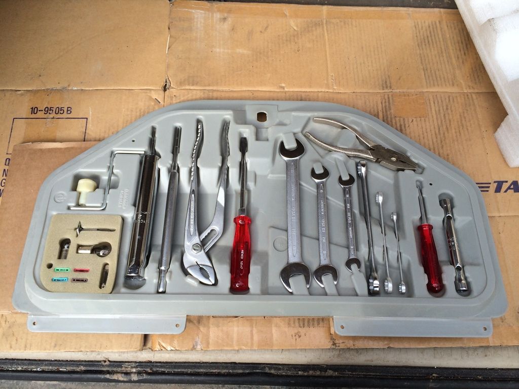

Full set of big tools box

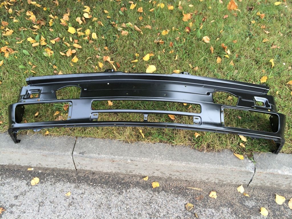

new front valance
