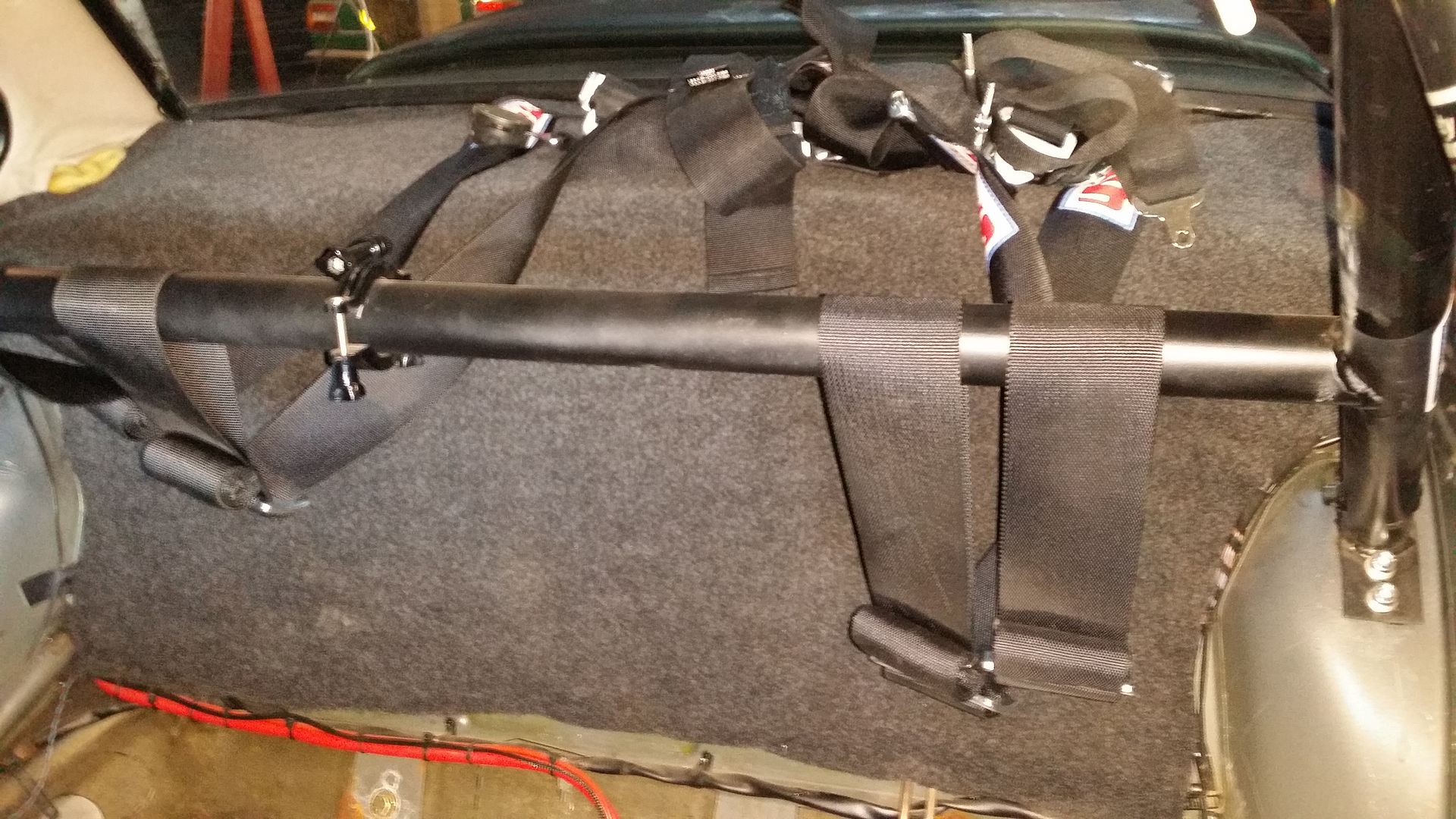

Rear shelf carpet :)
Seats :), originally went for some really nice OMP seats, but i think they where made for 5ft Size 6 ''Drift Cake'', because i couldnt get my ass into them and my head was over the top of the seat! so had to go for the cheaper polish alternative, but still a nice Fia 2020 Fiberglas seat.

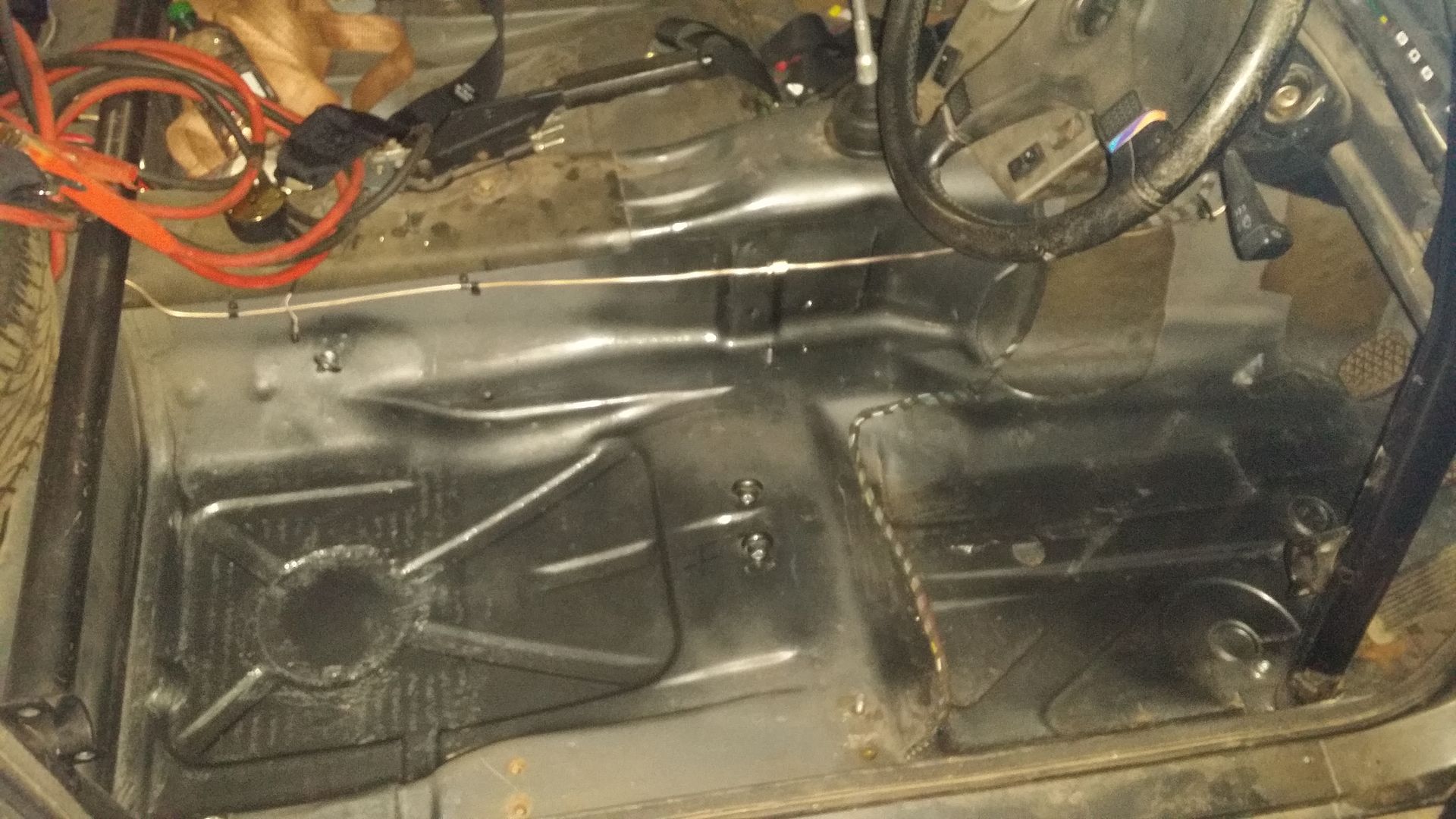

Hydro Delete !

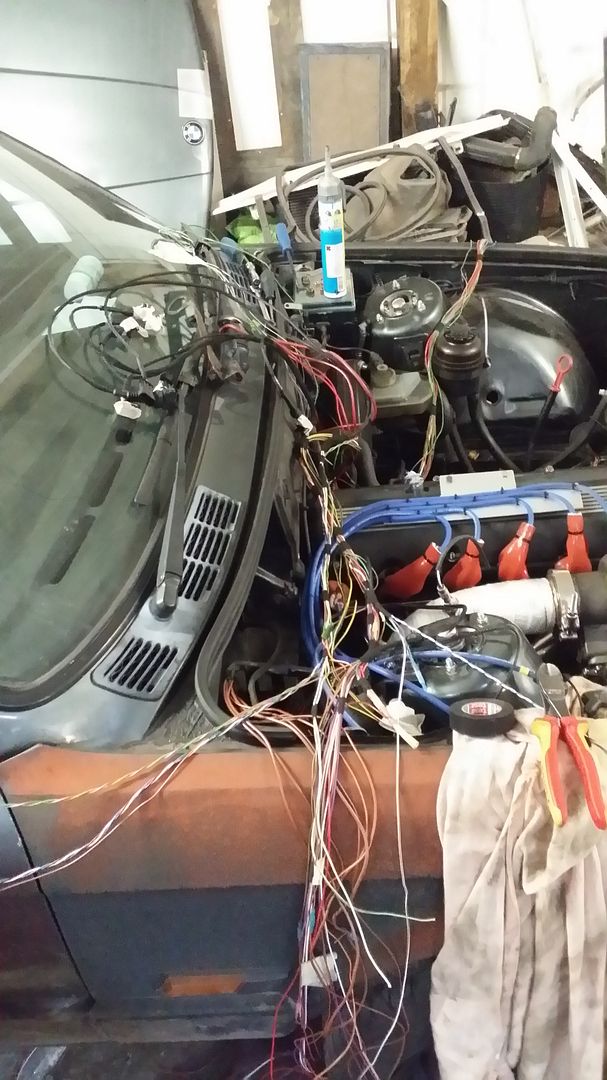

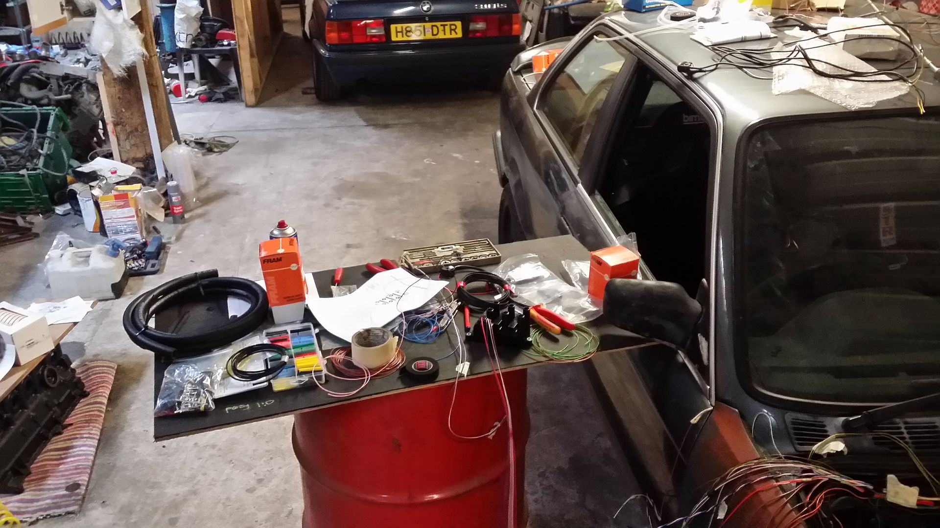

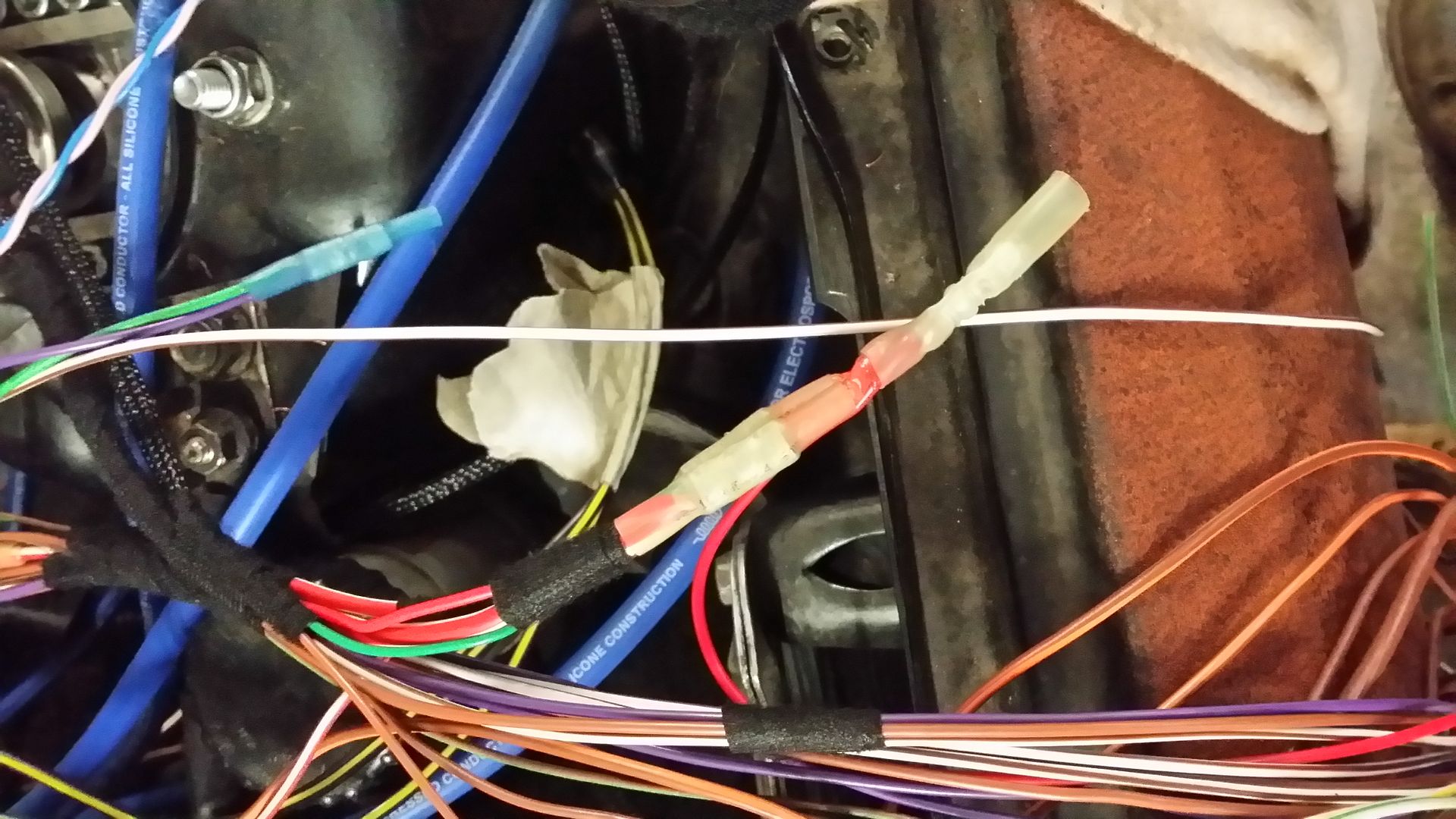

Electrical Gravy

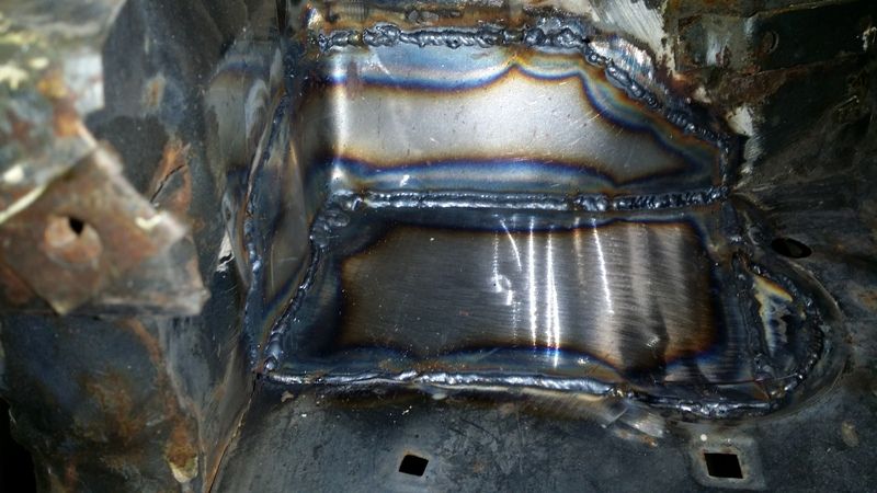

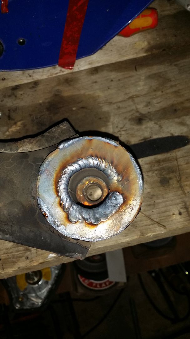

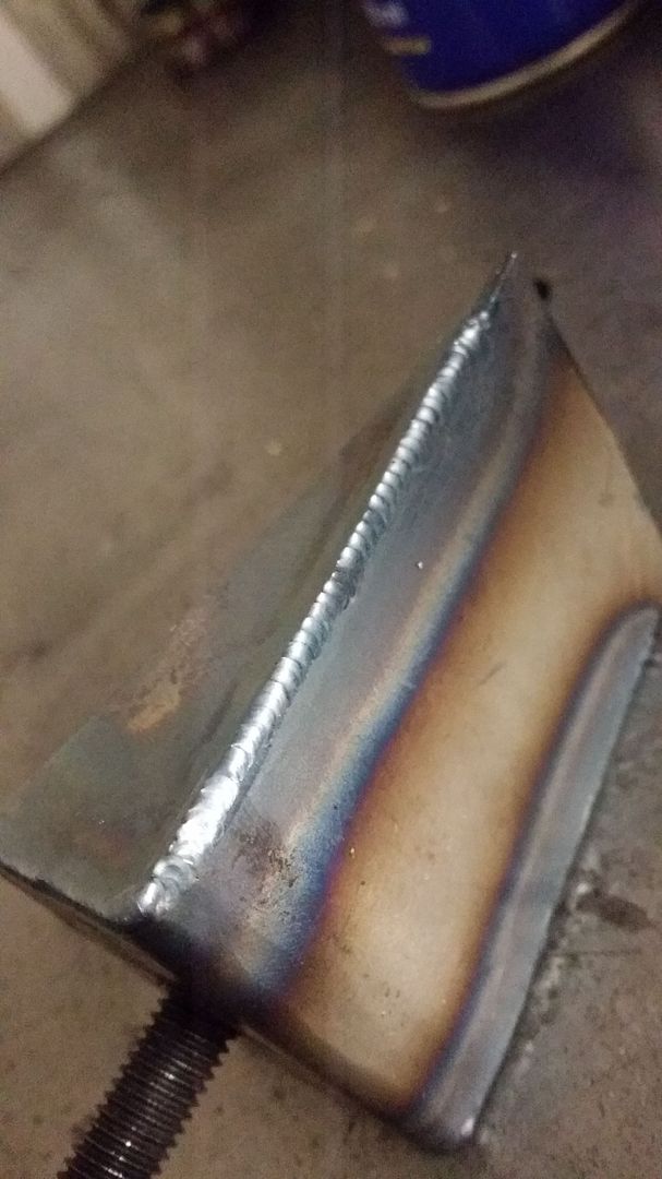

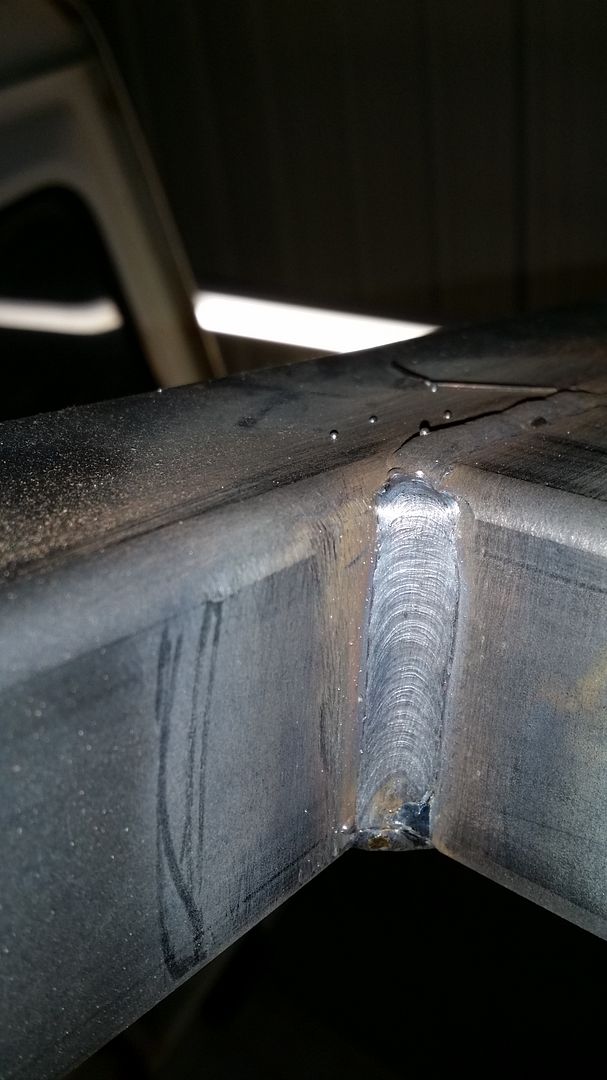

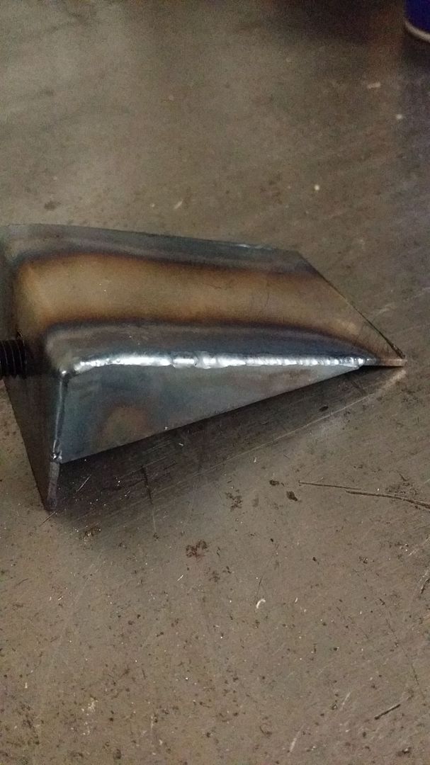

More Welding Porn For the Haters :)

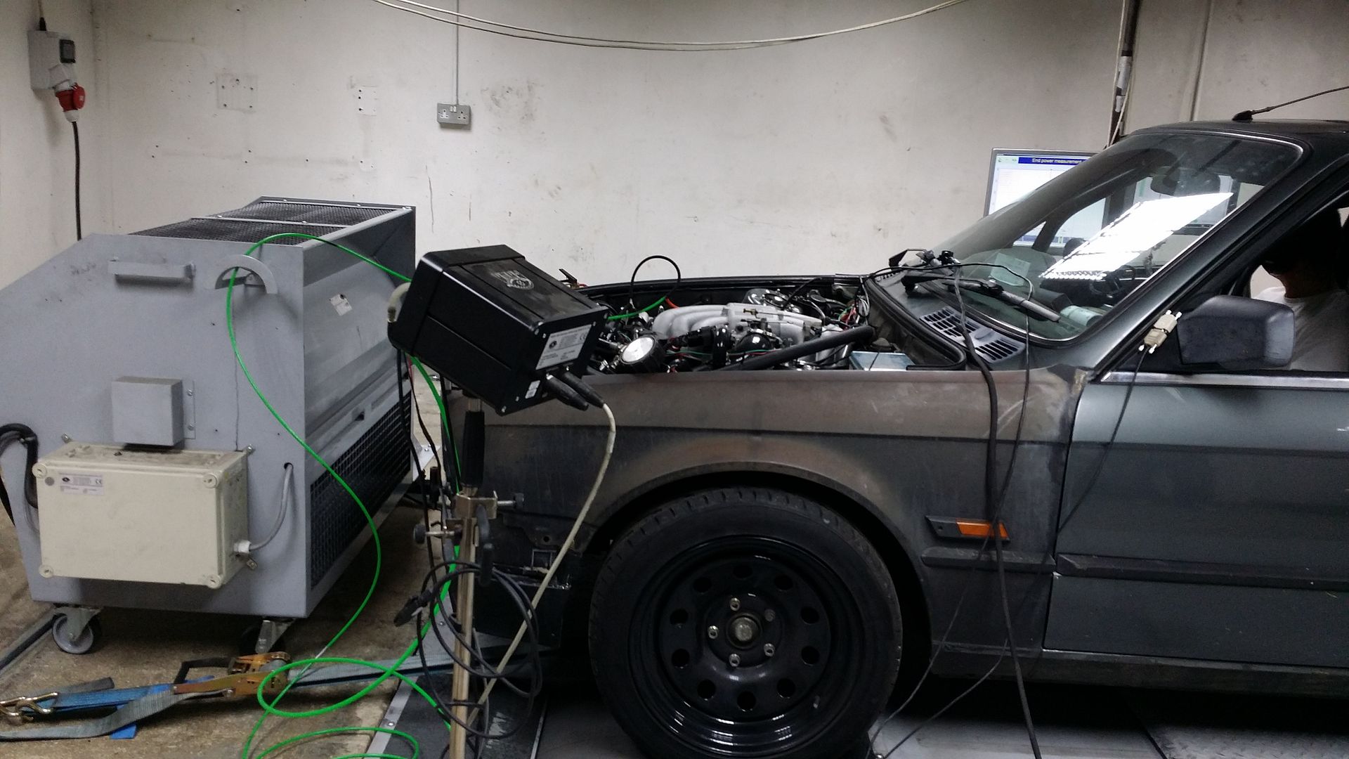

Got the HY35 all fitted and made some good results on the dyno.
Welded on a 3" V band and welded up the internal gate, then bored the inside of the housing out to 3", so the exhaust is 3" all the way to the wheel.
As for oil feed, im running a AN-4 feed, M12x1.5 31mm long banjo, no restriction.
Return is custom shizzle i made from 19mm i.d tube and some 25mm o.d pipe to the sump.
no smoke, no oil loss 1000 miles later.
Took the car down to be mapped by John and dave at emerald, highly recommend the service these guy's provide made for an awesome day out :)
car made 376bhp @1Bar. (havent got a pic of this graph will add soon)
291bhp @ 0.5Bar, as you can see from the graph its not got any lag, turbo spools up from 2krpm.

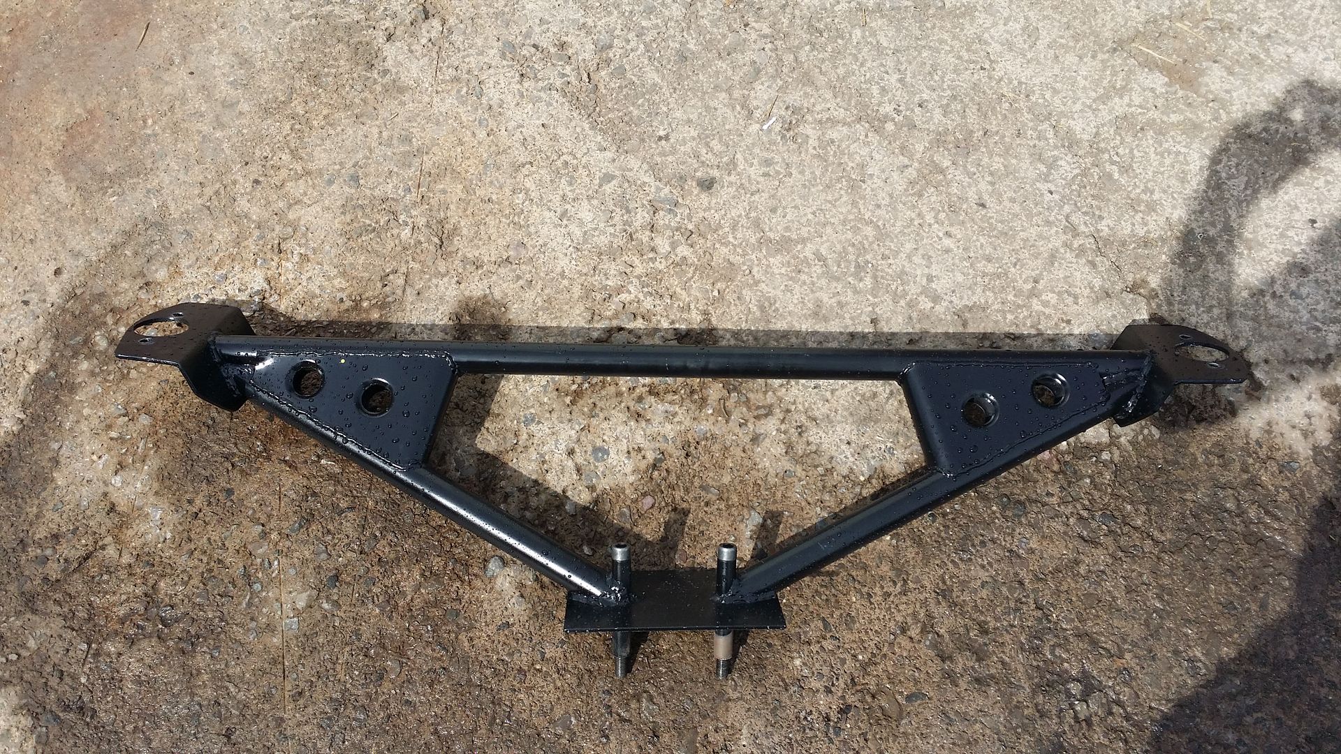

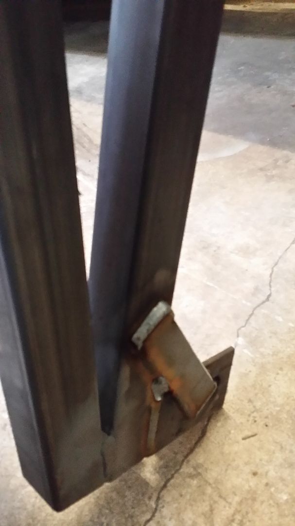

Nice work on the trailing arm bracing.

appletree wrote:Nice work on the trailing arm bracing.
Cheers :)

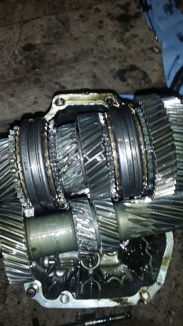

So the Getrag 240 met its match, 3rd gear fully stripped both sides.
Guess it didn't wanna hold onto 460nm any longer haha :D

M3Pete wrote:Just a thread full of win Dan!
And now a bit of fail :D
Epic gear stripping!!

Impressive gearbox fail :D

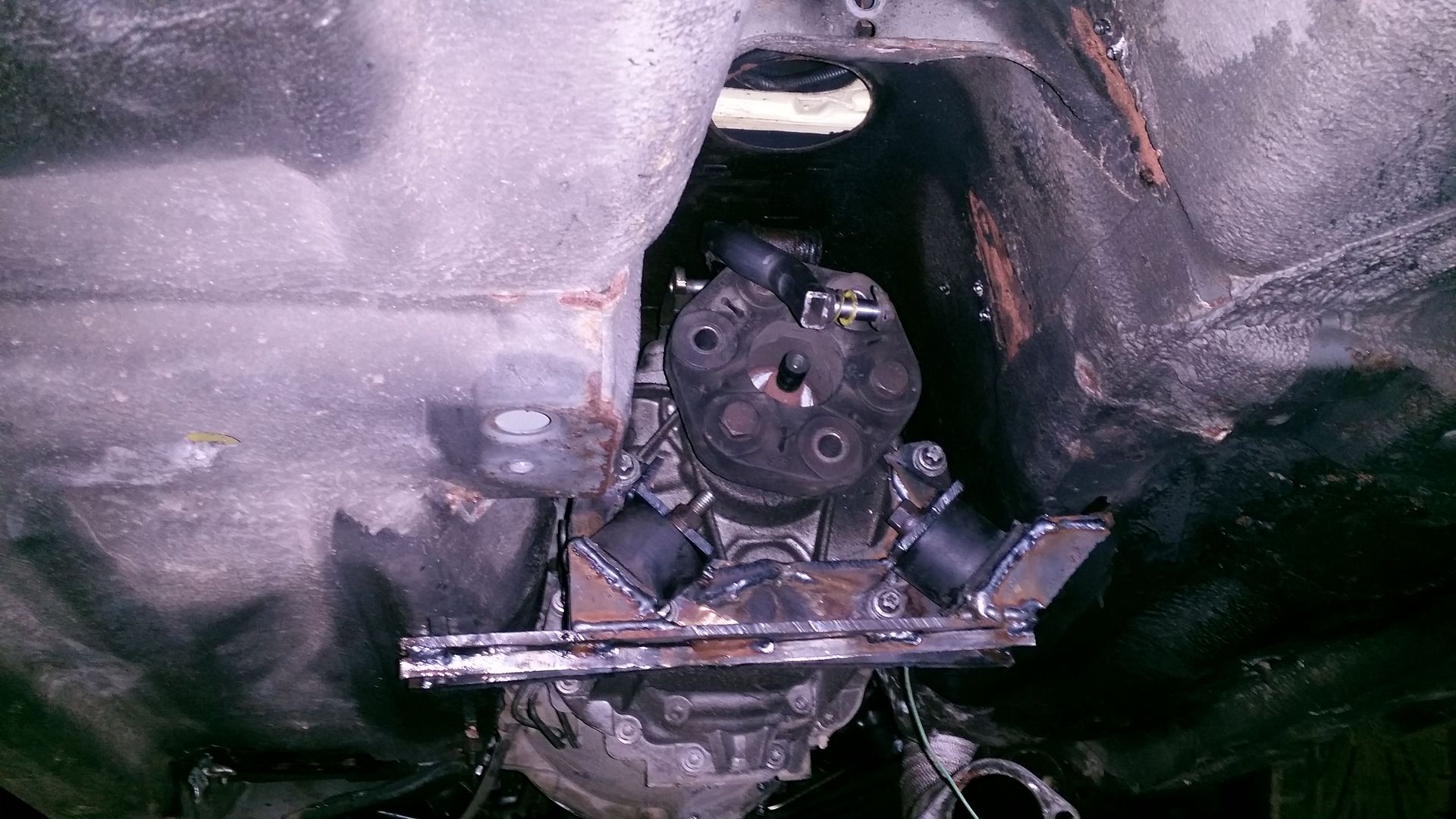

Had Mr Flintstone in today from Ghetto Engineering to make a new gearbox mount.
