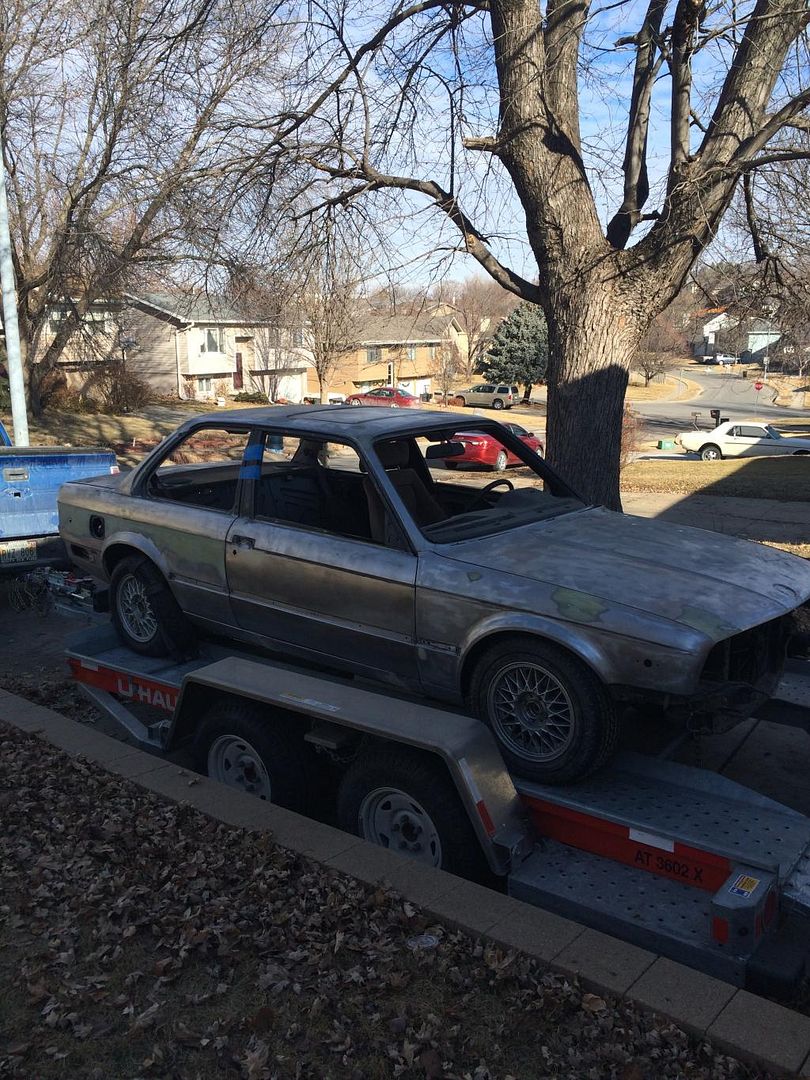

And that' pretty much how it sits after the last year of work. Once I finish the wheel arch repair the car is getting the final once over and prep and then its off to the paint booth. I plan on going back with the original color of Zobelbruan metallic. I plan to have it finish by may 2015. I'm waiting on a few parts like my zender wing to get back and alpina valance. Also picked up a set of hella smileys.

Stopped by the shop to pay the painter for laying the primer and snapped a couple shots. He's trying like hell to get it blocked and reprimed this week so it can cure. He also told me that when this car come back it will look better then when it left BMW so now I gotta get an alpina spoiler so i got matching paint.
