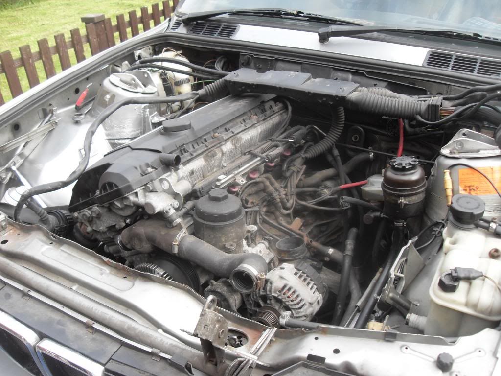

The Alpina B10 engine was an epic piece of German engineering but i fancied a change. initially M50 Turbo was the favorite but with time,fabrication and the summer here its gone on the back burner till winter.
I wanted my E30 back on the road asap.
So ive lobbed a M52 b28 in to get me by.

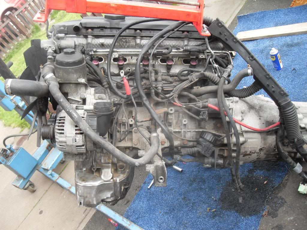

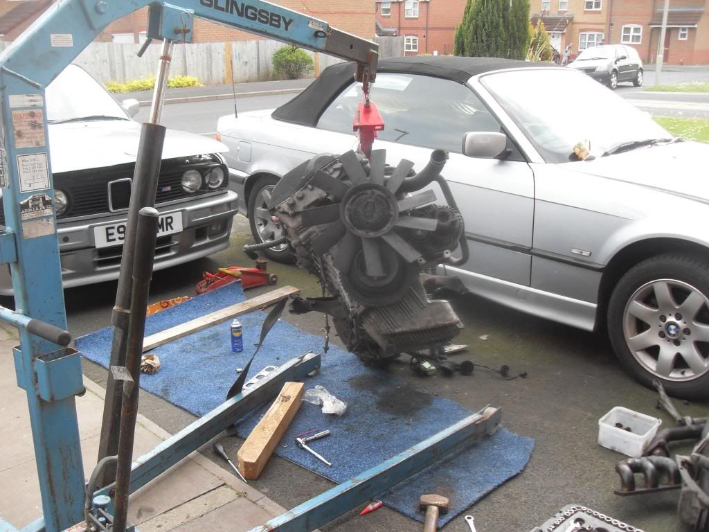

Bought a 98 E36 328i manual cabby with a nice steel liner lump and quite a few M tech morsels to punt on...

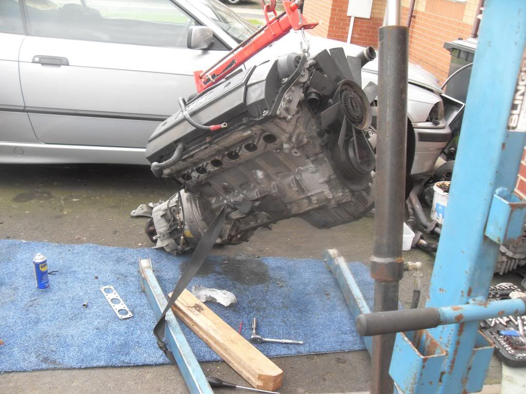

Didnt stay in for long :) On the deck with a E38 728i sump fitted ( cost of sump £60 delivered)

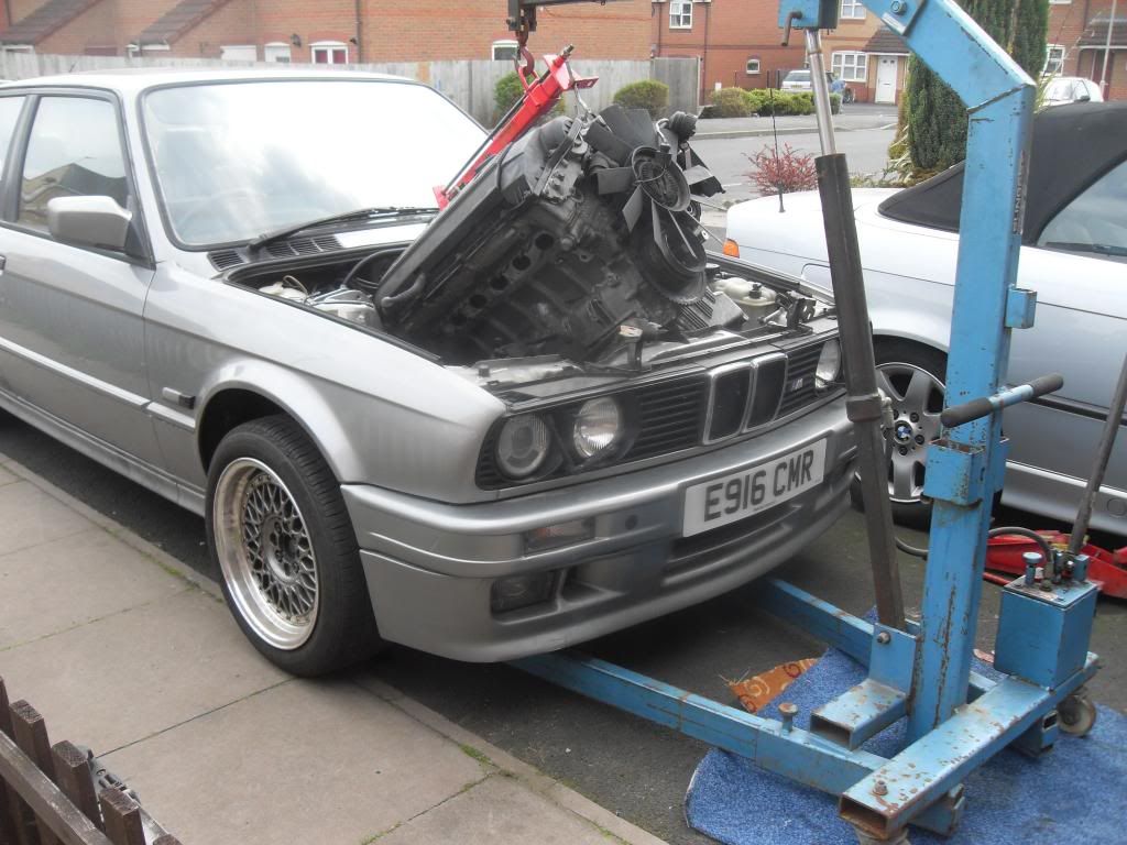

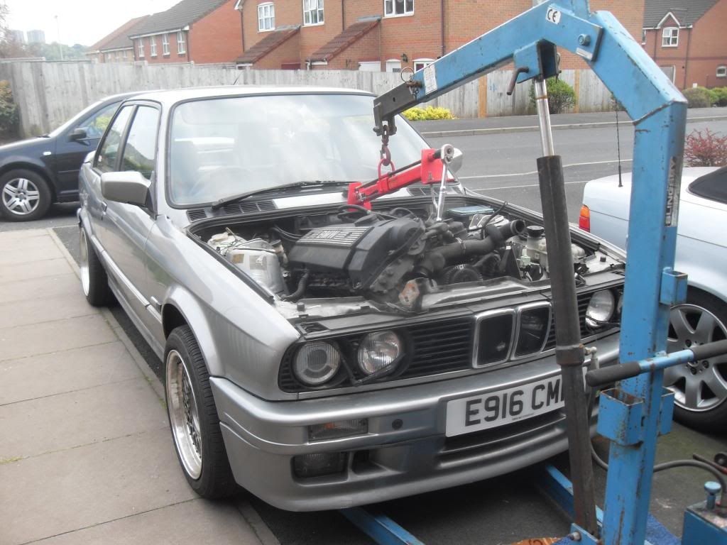

Ready to lift in.
And started to feed in.
And resting on its mounts..

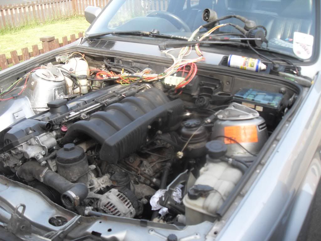

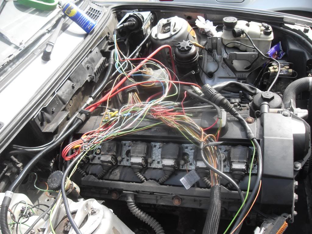

Now....A bit of sound advice...If you are doing this swap, Trust me, Get Danthe to do the loom job!!! sounds easy when you see it on paper but tackling it aint for the faint hearted :( Its not so much cutting one plug off and grafting on another its the ballache of re routing and cutting out all the unused wires so it sits nice against the bulkhead.
Then EWS to flap about with!!
Wiring action 8O

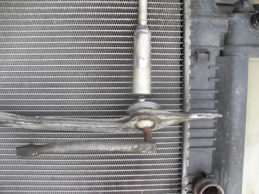

It had this shifter in the E36, below the ball is the same as Z3 1.9 but the stick is about the same length as a standard E30 item.
Was it a different shifter on the E36 328i ?
Here it is...
Either way its gone in the E30 as it felt nice :)

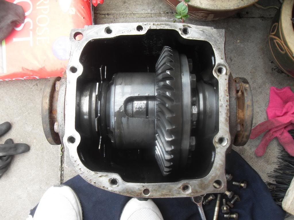

Next up a very nice 3.15:1 Z3 M rebuilt 1.5 way 4 plate slipper :cool:

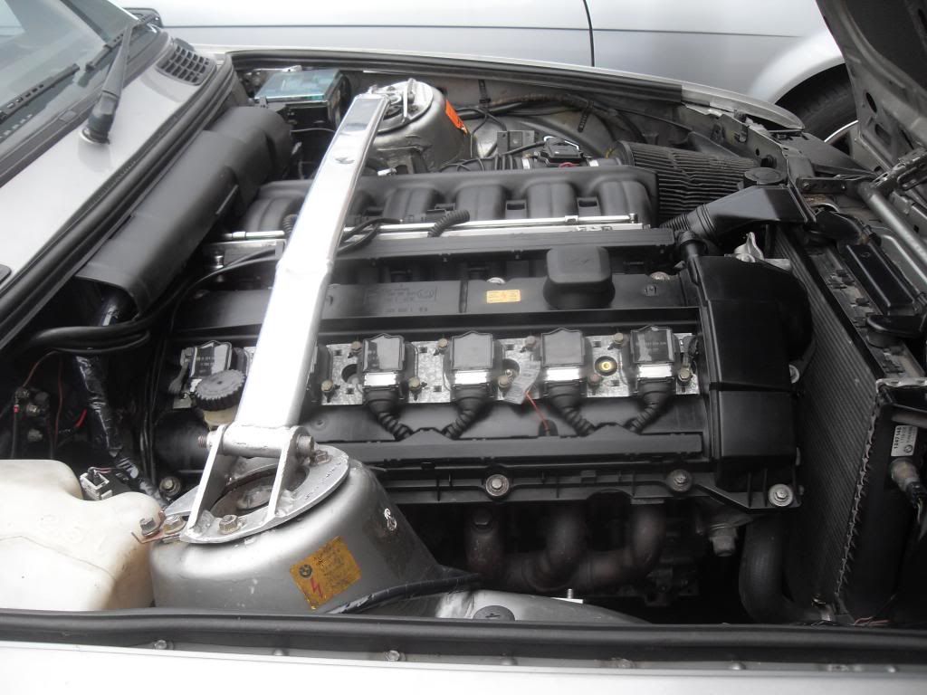

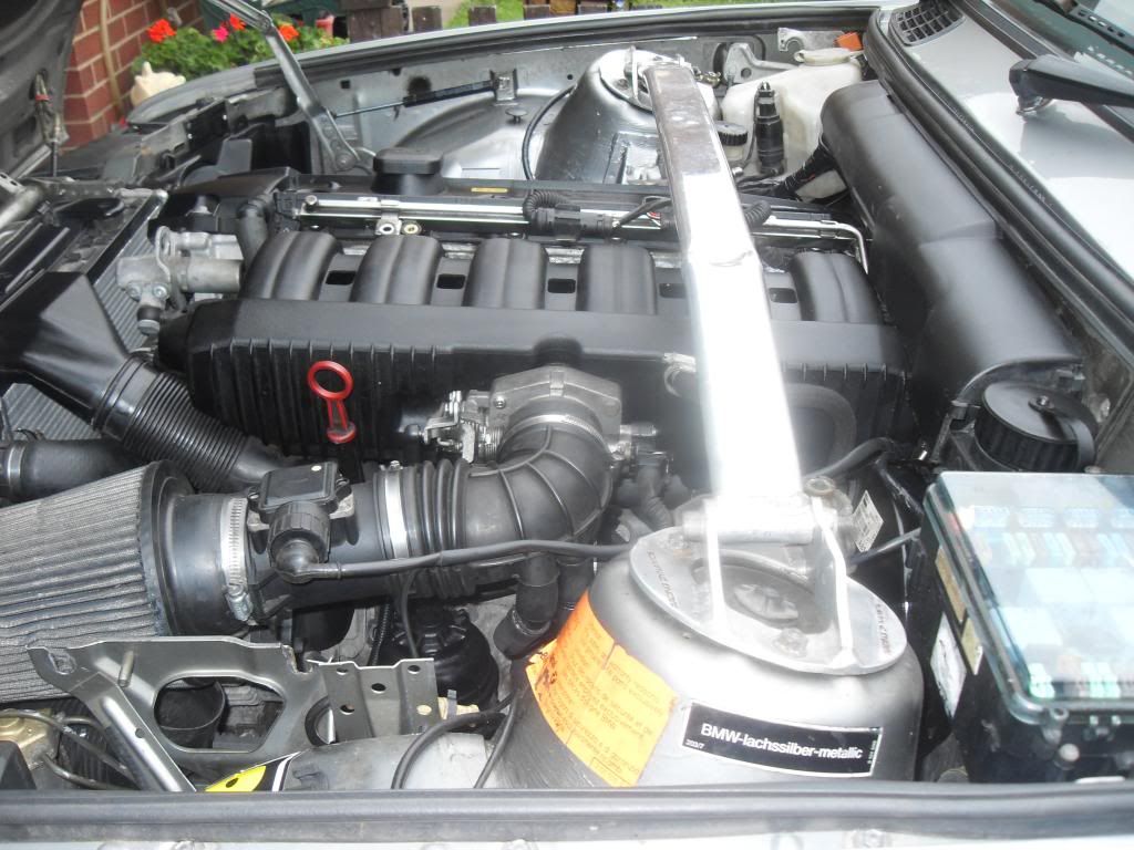

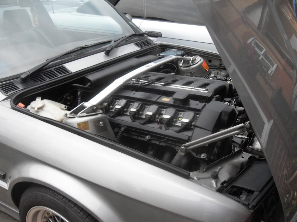

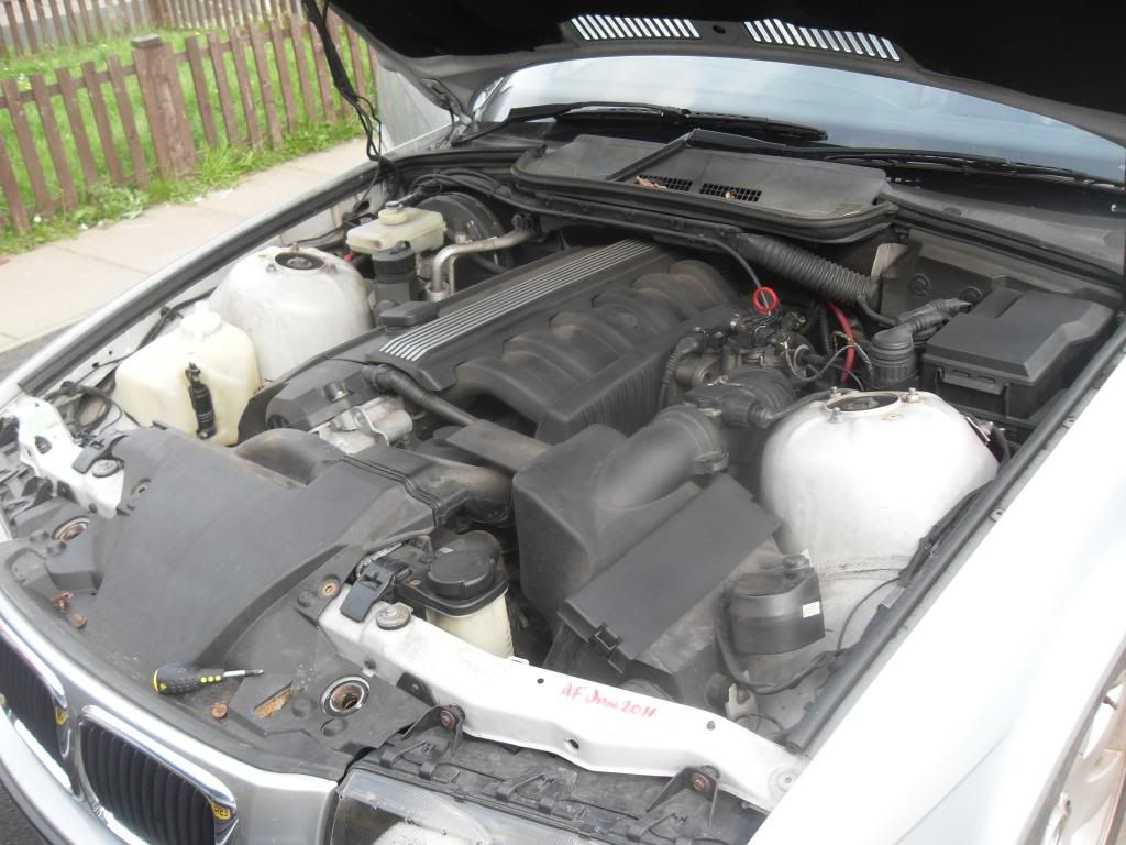

Well with not too much fuss its Fitted and it drives :woohoo:
Ive ditched the engine covers as i prefer the look without :)
