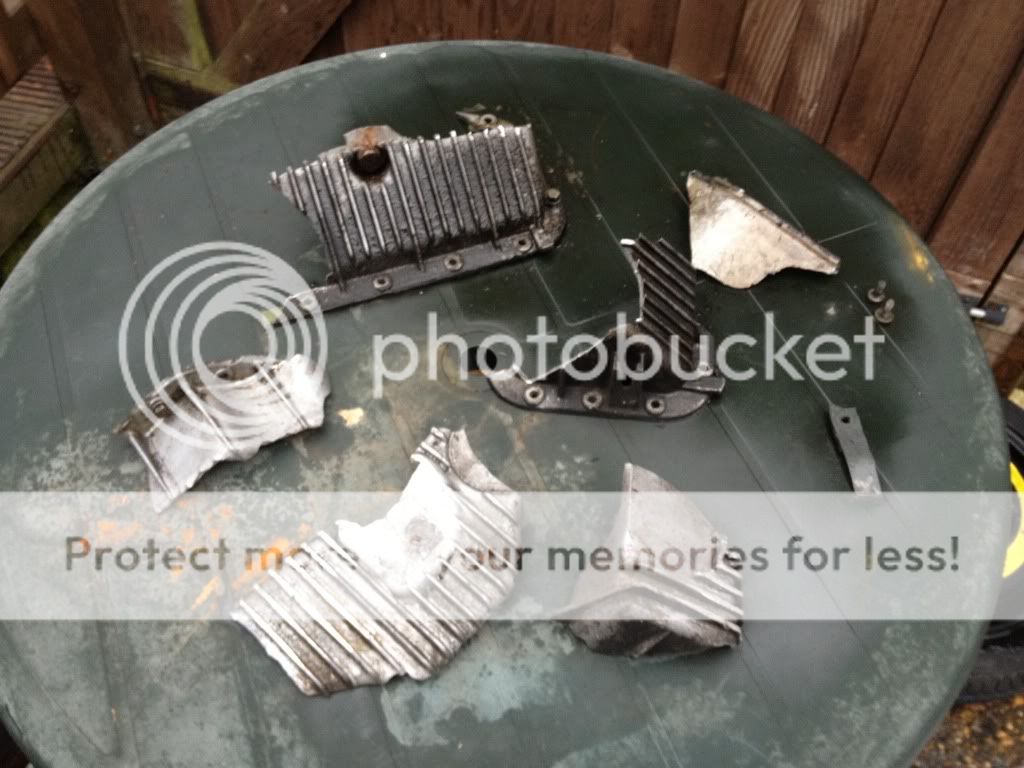

So after a year and a half of driving it as a daily and the M42 sitting to low in the engine bay i had a little accident on the way to an ace cafe meet.

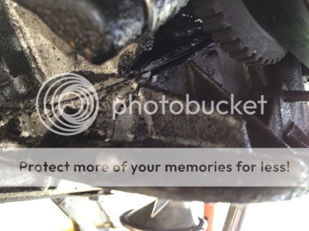

Yep, smashed the lower sump and cracked the upper one. I still had the engine out of the red iS so whipped them off and changed them over. I had problems with the engine not pumping oil and after a quick research (hours and hours of searching forums!) I found that the little part in the sump which picks up oil lets air through. So back off with the sump and re seal the gasket. Job jobbed!
