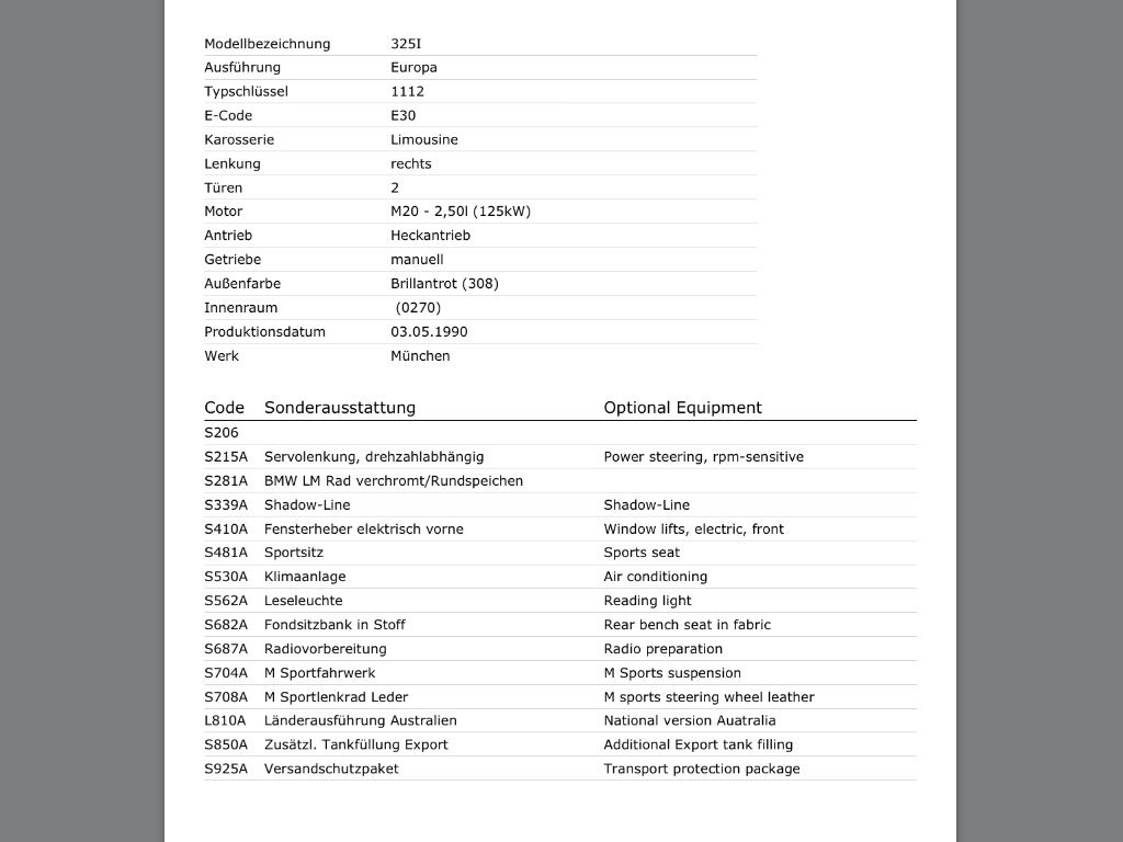

Here is the archive info from the VIN

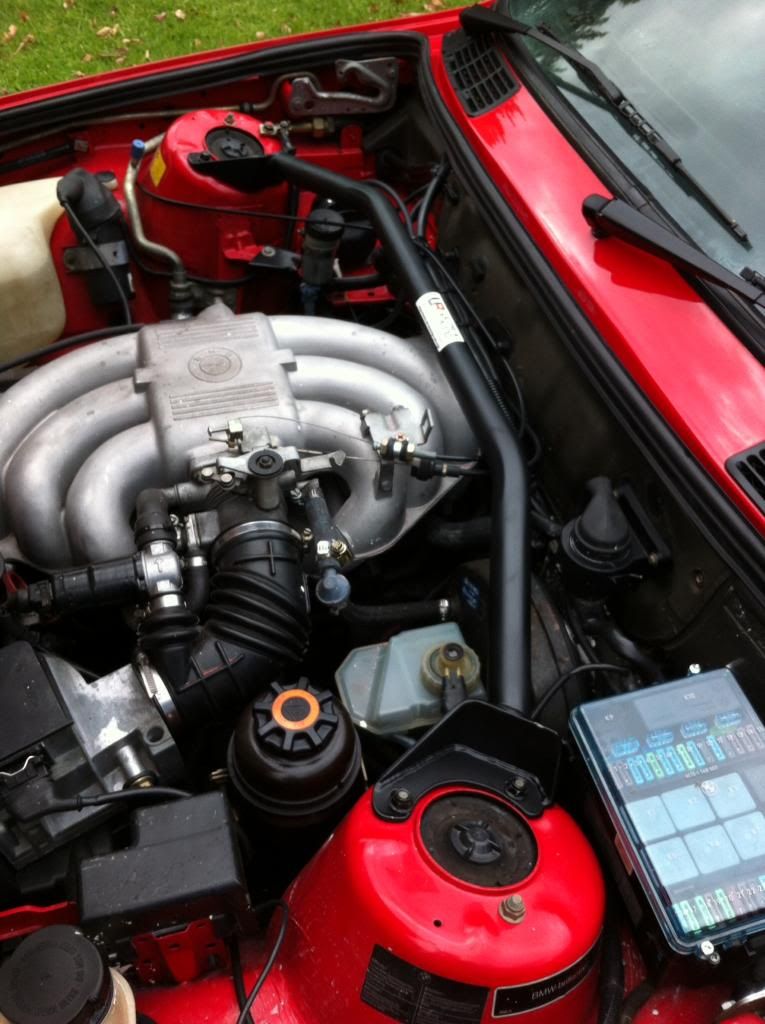

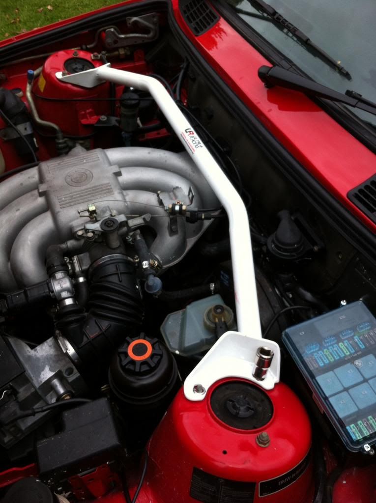

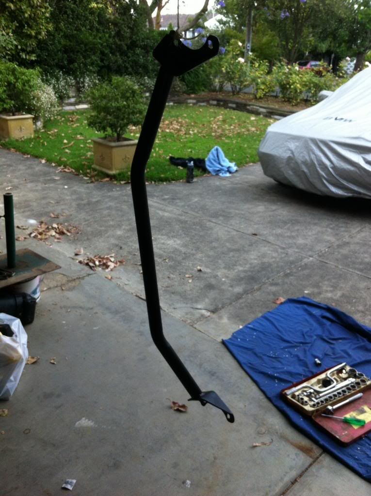

I didn’t like the look of the white strut brace as nothing else on the car is white so I grabbed a spray can of matt black engine paint and gave the bar a few coats. It came up really well and I think it looks much better now.

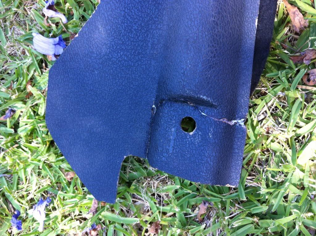

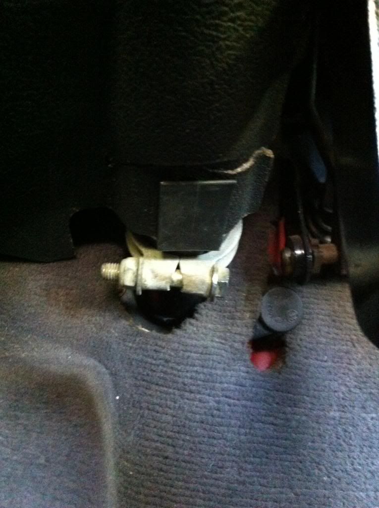

The kick panel under the dash was hanging loose up near the clutch pedal and a PO had attached it with a zip tie. The broken piece was the bit that slides into the bracket, so that was easily fixed with some super glue and then some clear drying wood glue sealed the crack shut and that was coloured in grey with a texta so that came up pretty well and is holding fine.

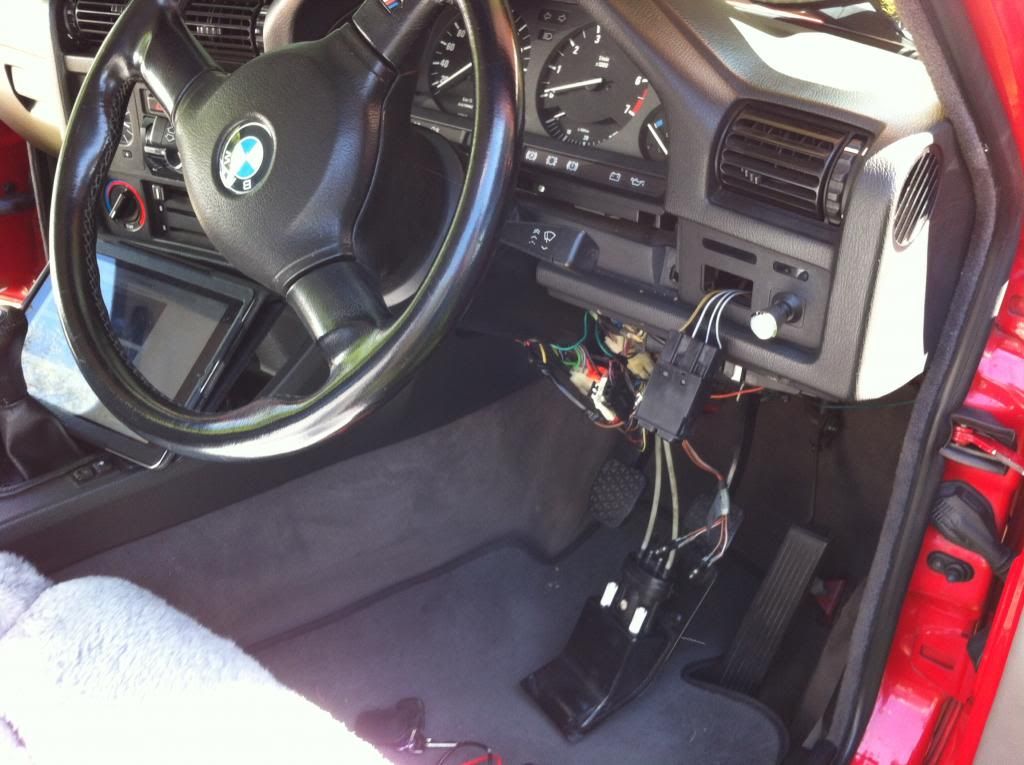

The cigar lighter currently doesn’t work, which is a little annoying as I want to be able to use it to charge my phone in the car. Now this one is puzzling me and any help would be greatly appreciated. After studying the wiring diagrams and reading all the forums submissions I can, I know that the cigar lighter fuse also runs the heater blower and the antenna motor (both of which are working fine). I have full voltage across both sides of the fuse and the ground (G200 I believe) is working fine. So after taking the ashtray out and checking the voltage across the cigar lighter wiring I have no voltage at all. So unless someone can give me any other ideas it looks like I’ll have to rewire the cigar lighter which while not hard is a little bit of PITA.

I take it the heater blower still works ? if not it Might sound daft but just try changing the fuse rather than testing both sides of it. If nothing on that circuit works sometimes a new fuse is really all it needs.
Otherwise for the cigar lighter you might need to trace the wiring back under the dash to check there are no breaks - there is a big wiring block next to the bulkhead under the dash on the passenger side - you might find a previous owner has tapped into the wiring somewhere to wire in something else.
The bulb holder in your photo is indeed for illuminating the ashtray.
IIRC if you look in the ashtray holder which you have removed in the above pic you will see a hole at one end that bulb holder fits into.

Also finally solved my cigar lighter issue, after taking out the the trim surrounding the glove box trim and the centre console I was able to trace the Cigar lighter wiring back into the loom and was able to ascertain at least the PO hadn't cut the power to install the aftermarket stereo or alarm but still couldn't ascertain why I had no power through the Cigar lighter wiring before or after the large white loom connector for the accessories and the steering column.
So after bringing up the wiki and analysing the accessory socket I found through a continuity test that my cigarette lighter had continuity with a wire plugged into plug U on the socket. Now this plug according to BMW is for the Heated seats and leads to fuse 16. I'm pretty sure no e30 in Australia was sold with heated seats for obvious reasons. So long story short the PO had for some reason rewired the cigar lighter onto its own fuse (fuse 16) and that was blown. Moral of the story if you are having any electrical issues CHECK ALL YOUR FUSES :roll: not just the one you think might have issues.
