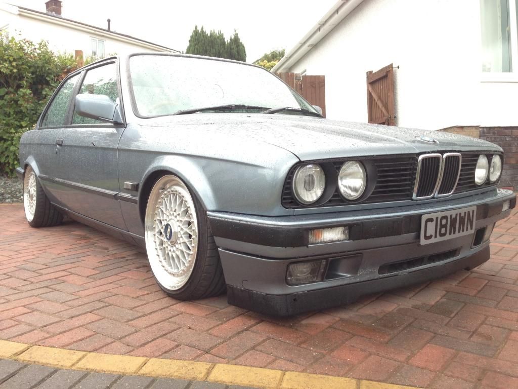

I thought I'd start my build thread from day one as I've own my E30 for 6 months now. I've always wanted one, and make a 90s throw back with an OEM touch, with the hope of going for 24Vs in the near future
I picked this little gem up in the summer '13, a lovely 325i not sport, low mileage (98,000) completely rust free, sport seats, Z3 short shift, grooved discs front and rear with Goodridge braided lines, an LSD (unsure which one) and got it polly bushed before I got it too. Swapped the plate then the fun started
I work abroad a lot so got a few things ordered up for the next time I came home. My wooden Nardi looked out of place so ordered this (a rep sadly) it's a temporary measure until I find something I like
Also got these fitted, with project silver camber adjustable top mounts
Next up was to get the arches rolled, with the newly bought heatgun ready for the BBS RS264s wrapped in 195/40 and 215/35 continental tyres
You can just about make out the beautifully crafted G23Engineering adaptors in this picture
BBS Fitted

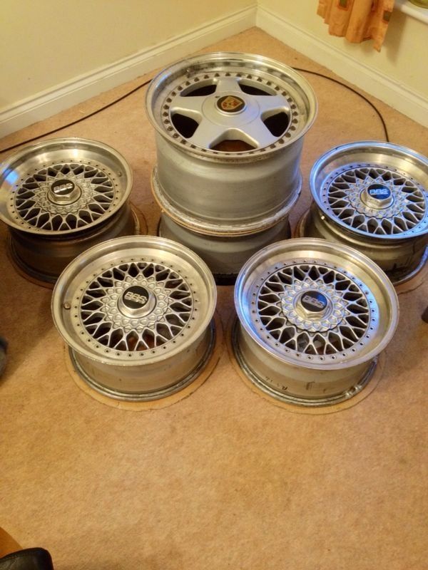

Just bought some more wheels, they seemed to cheap to leave alone whilst drinking Rum & Cokes last night
16x8" and 9" BBS RS, they need building up and tyres, so thinking about the finish I want on them as I really like the oldschool faded gold centers my other friend has for his 924.
Tyres are going to be a hard choice too, I'm getting too old to be running rubber bands.
Anyway, enough of my rambling, here's a picture along with new wheels for the beige bastard

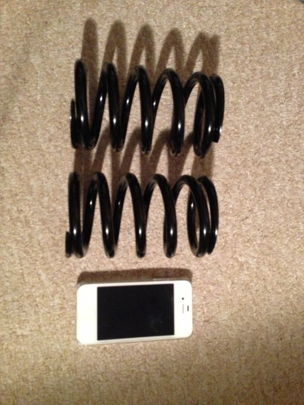

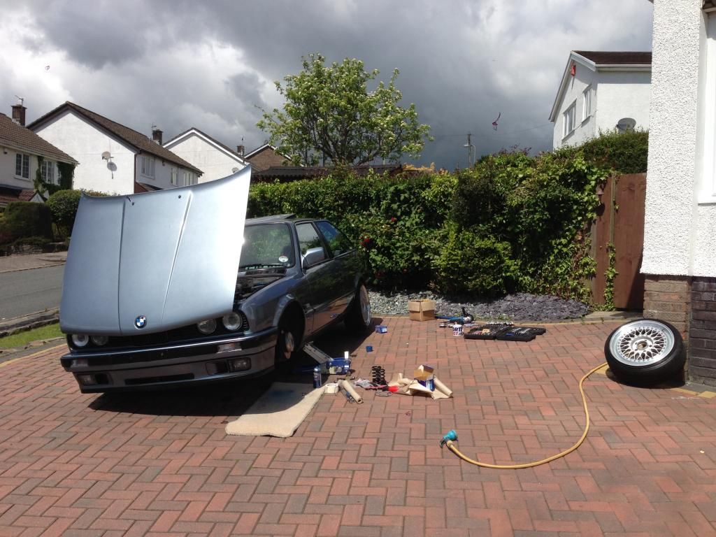

My new 5" AVO springs arrived whilst I was away, should help me raise the adjustable platforms about the tyre but still keep the same amount of suspension travel
I sent the 16" BBS barrels to the guys at Flatout Valeting to be stripped and re-powdercoated in bright silver. With the weather the way it was I decided to spend the whole of Sunday day fettling with the E30
1st job was to start experimenting with this new product evryones be raving about, Plastidip... The brand new IS chin spoiler was sprayed up, and came out quite well, a factory finish and that rubbery feel to touch. Very impressed.
So with that finished I spent the next few hours carefully masking up the window trims, the previous owner had made a right hash of painting the chrome trim black.
Everthing was going well, the finish look great once again. But, and its a big but... The Plastidip had formed such a good, smooth thick layer on the window trims that when i came to remove the masking tape, it ripped all the sprayed black wrap off too, making the trims look even worse, GUTTED!!!
This lead to my downward spiral of enthusiasm, 3 hours wasted re-texturising the window trims needed a pick me up. So I decided to test fit my 16" RSs for a bit of eye candy to brighten up my day, before changing the brake pads all round for EBC Black stuffs and painting the calipers.

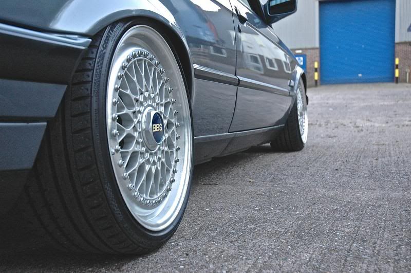

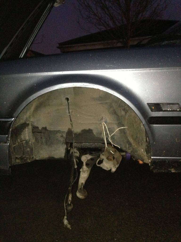

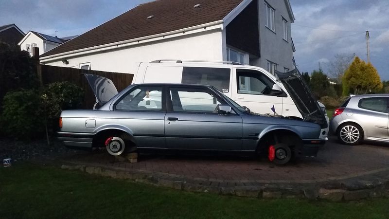

This went a bit down hill too... The offsets are a bit too low on the rears with my current adaptors, so I'm going to have to get the centers filled and redrilled to 4x100. That way the rears should sit absolutely bob on
I also trail fitted my friends 17" OZ Futuras, the ones in the previous pictures. The looked pretty sweet, I'll try and get hold of some of his pictures for the next update.
This is the only picture I have of that fitment (Instagram'd I'm affraid)
All this bad luck drained my oomph for working on it, so decided to leave the pads and other niff naff until another day. Put it all back together, 15" RZs back on and off for a wash and a Sunday evening drive.

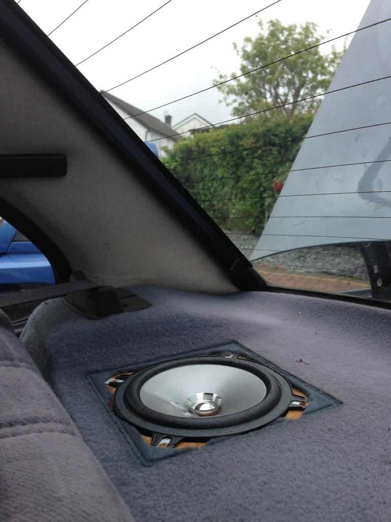

Then to replace the rears, the 25 year old original hanging paper speakers have had their day
Replaced with some well spec'd cheap Kenwood items
Pretty chuffed they fitted under the stock retro covers too...

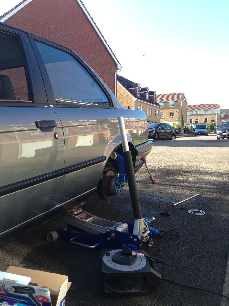

Replaced the front pads for EBC Black stuff, just normal street pads, finally
Painted the calipers blue
Snapped my breaker bar

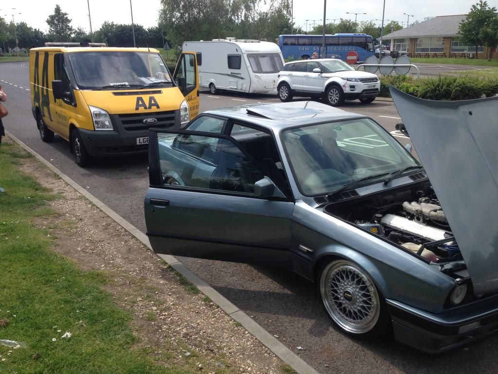

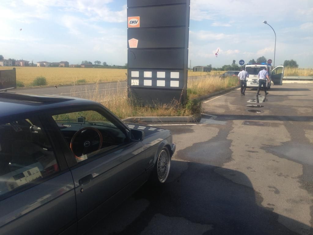

This AA guy was a legend! Followed us from the M4 to the local GSF, to try and get us on our way. We had the back seat off its mountings and used the onboard hammer to shock the pump into performing.

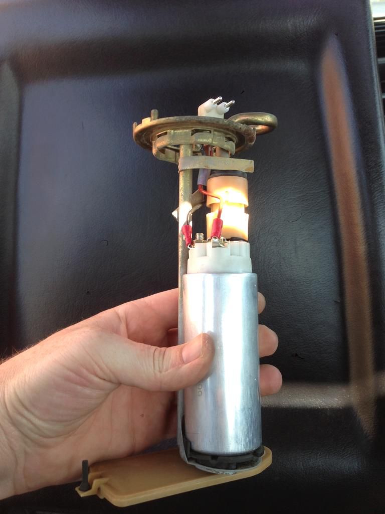

After trying 4 places for an in tank pump at 3pm on a Friday afternoon, we decided to change the filter to maybe give the pump an easier life and get on our way back to South Wales. Baz at DB Autos managed to source us a new pump and was being delivered in the morning.
The pump struggled on until Newport, just before the tunnels... Stopped in the outside lane at first, then wouldn't get going again so had to use the slight incline to get us across to safety. Gutted!!! 20 miles from home!!!!
Nei bother, with spirits still high and laughing and joking about the situation the next day (Saturday) we got the new pump fitted
Took the opportunity to refit the wooden Nardi wheel and the new USB/CD player (which as it happens was a complete God send)
The pump turned out to be a nightmare, first the little seal in the assembly twisted and stopped the pump flowing at its maximum, so anything over 3k and the engine would splutter. So using my engineering skills =-) I used a small Allen key to podge it out and have an all or nothing pump. This in turn made the pump super loud with less than half a tank of gas, but heyho it worked and the car was back on the road

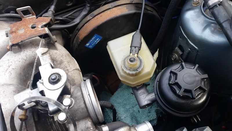

A little issue I should have resolved before the trip bit me in the ass half way through the week, rear brake pads! I spent a day driving around with the flickering warning light and finally gave in, having to return to the local BMW dealership twice as they supplied the wrong pads first time. An €85 expense I could have avoided if I wasn't so lazy before hand as I still had the EBC black stuff items in the shed
Pic of the best out of the four
The last day we spent chilling out, making the most of the scenery and generally having the time of our lives. Cars, climate, company, what more could you want???
A clutch pedal on the floor at 4pm on a Friday? Yes please!!! This car has tested my patience to breaking point. With the help of Flo I nursed the car back to the dealership (again) to get fixed over the weekend. Only to find out the workshops don't open until Monday morning. With no other choice we booked more accommodation in Klagenfurt so we could be within walking distance of the garage and the lake...

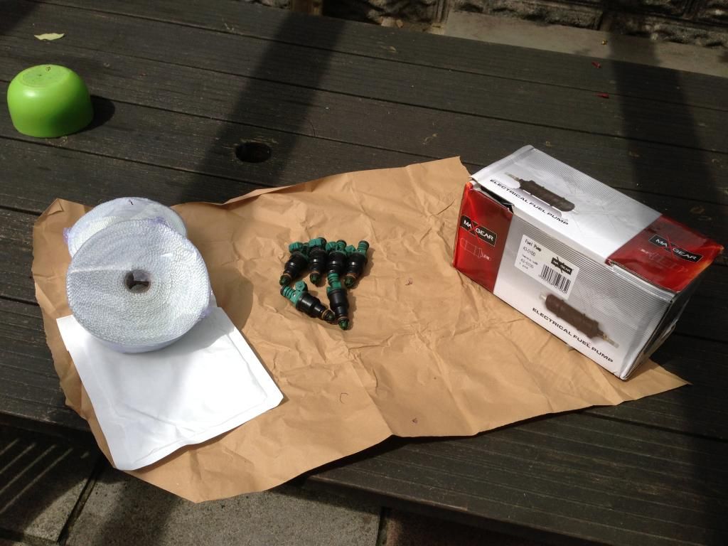

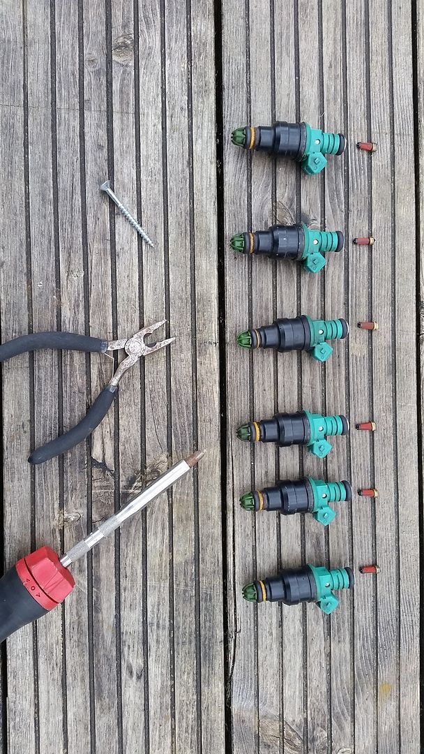

I flew home for a friends wedding and had an hour spare so unwrapped boxes of deliveries
20m of heat wrap, S50 injectors (a straight swap from what I've been told. Run quieter and more efficient) and a whole new pump assy (to replace my noisy one)

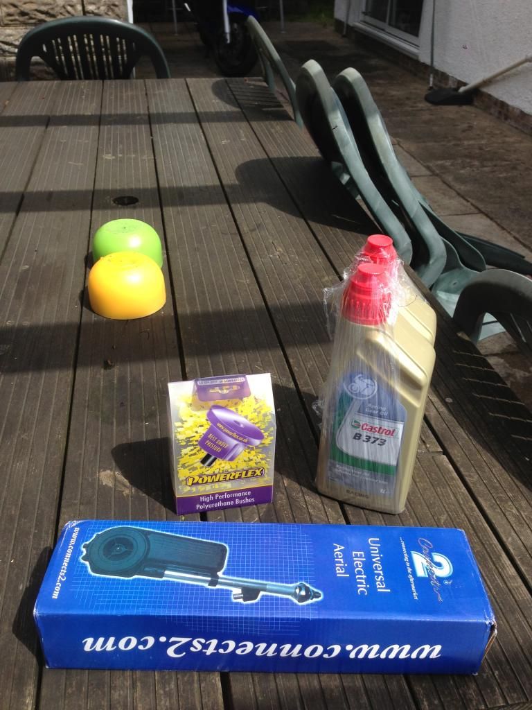

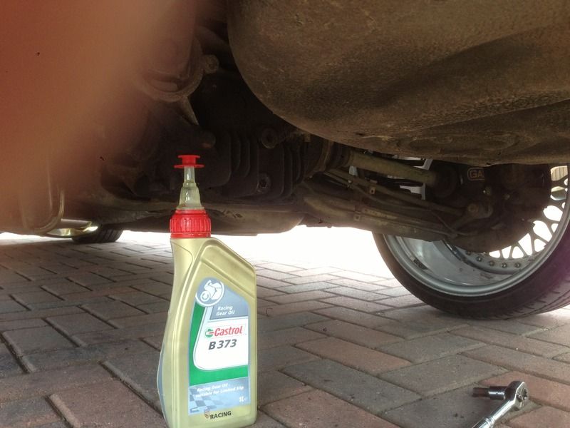

Diff mount, LSD oil and a new power aerial

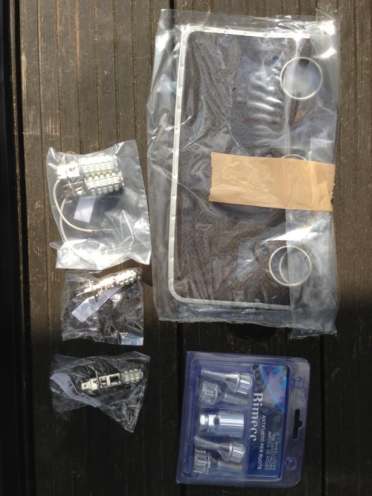

Manifold gaskets, LED replacement bulbs and finally a set of locking wheel nuts

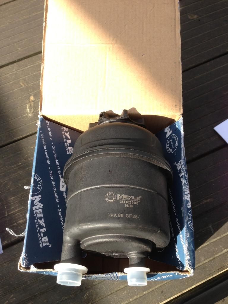

A new PAS reservoir to hopefully cure the weeping

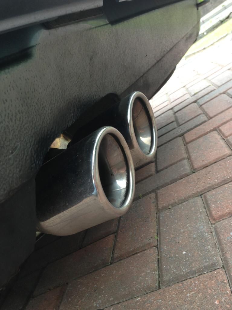

A shiny exhaust fitted all the way from front to back. Decided to go for a standard note, nothing loud and a set of RS4 style tips instead of the usual twin round choice most e30 owners go for

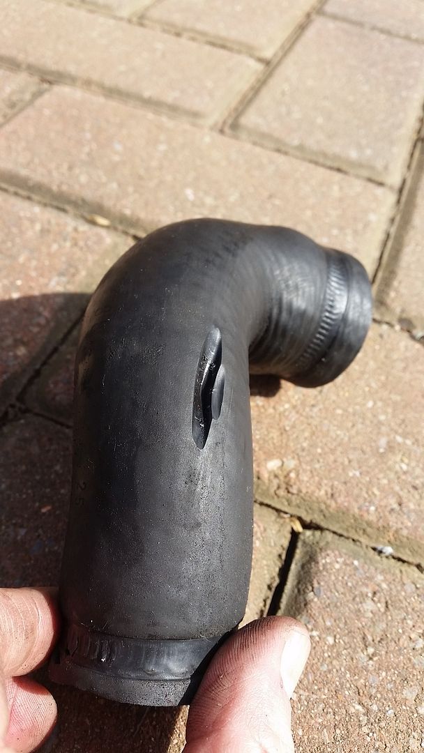

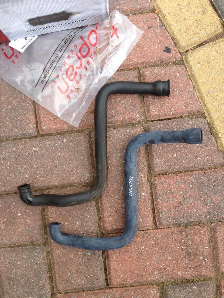

I fitted a new breather hose between the rocker cover and throttle body. This gets clogged with emulsified oil/water, so well worth the £12 to swap

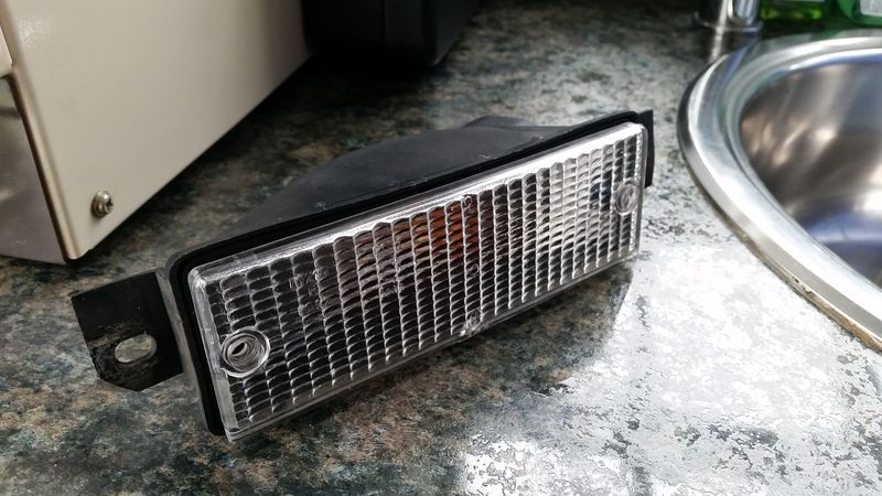

I tried to get the LED filaments in, but unfortunately the heads are too big for both dipped beam and fog lights. GUTTED!

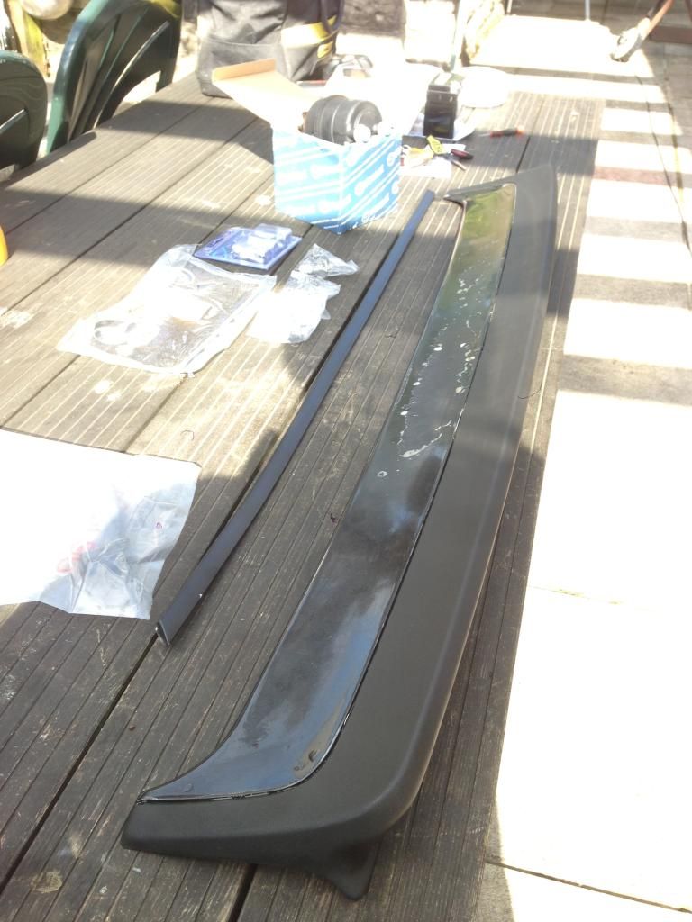

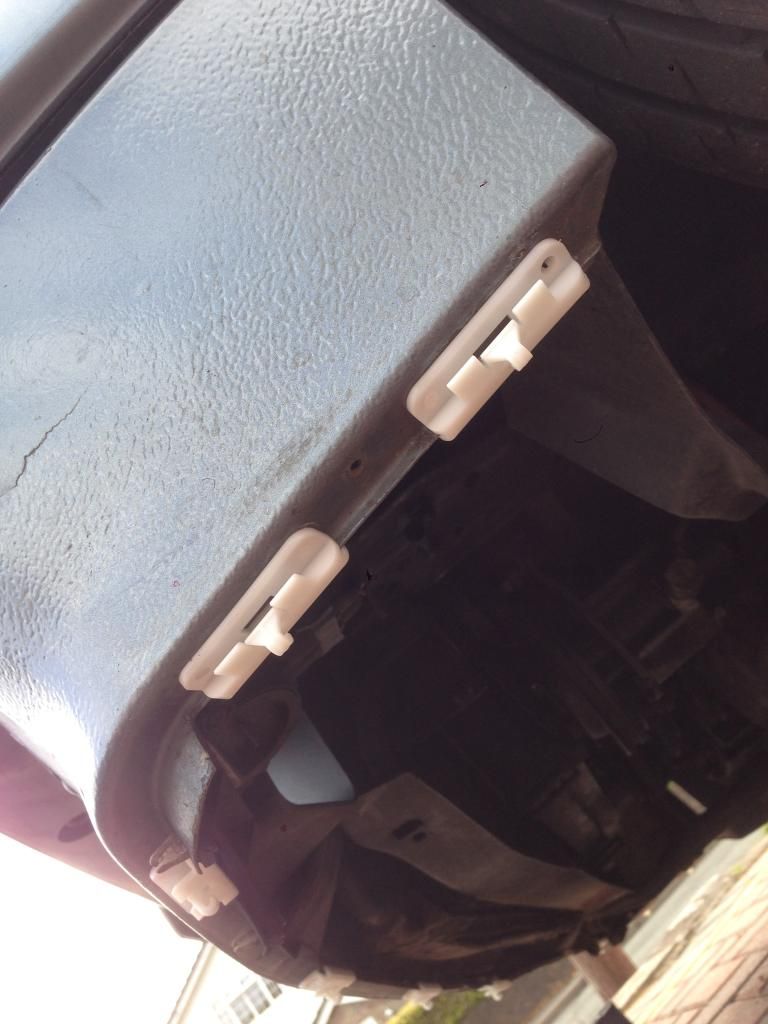

Next on the list was to fit the new trim clips and new genuine IS chin spoiler which have been hanging about for a while

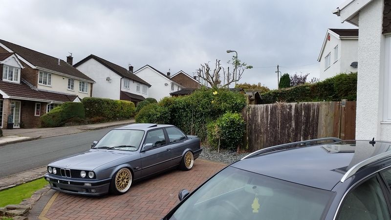

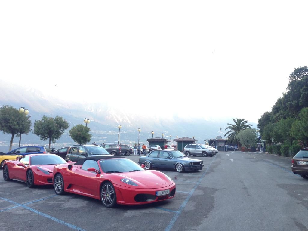

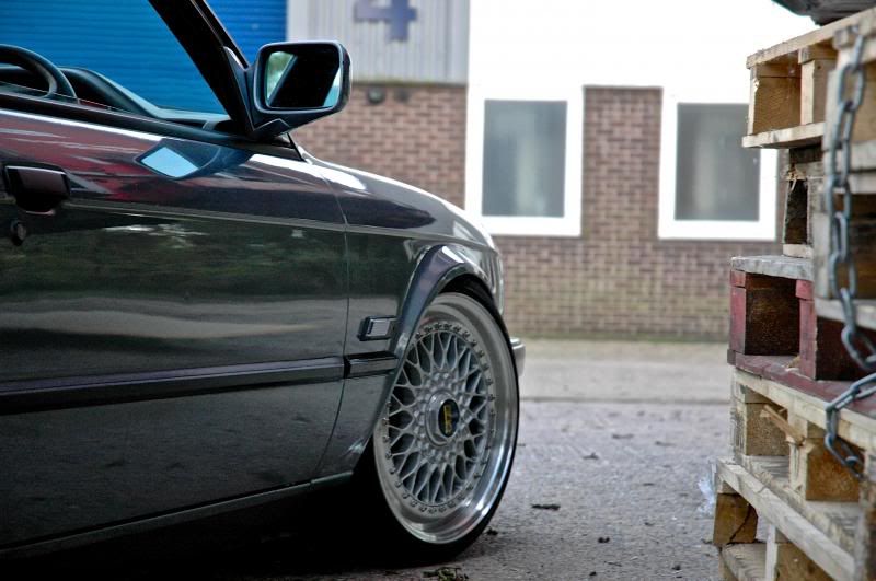

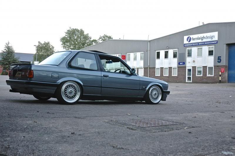

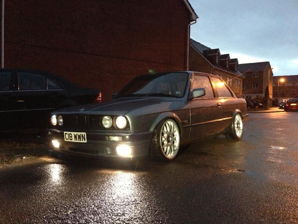

Some Pictures that were taken by Ben (The beige 924 owner) pre-Worthersee trip
as my photography skills are tripe!
and one a friend posted from an Austrian pap

It's that time of year again... Wörthersee!!!!

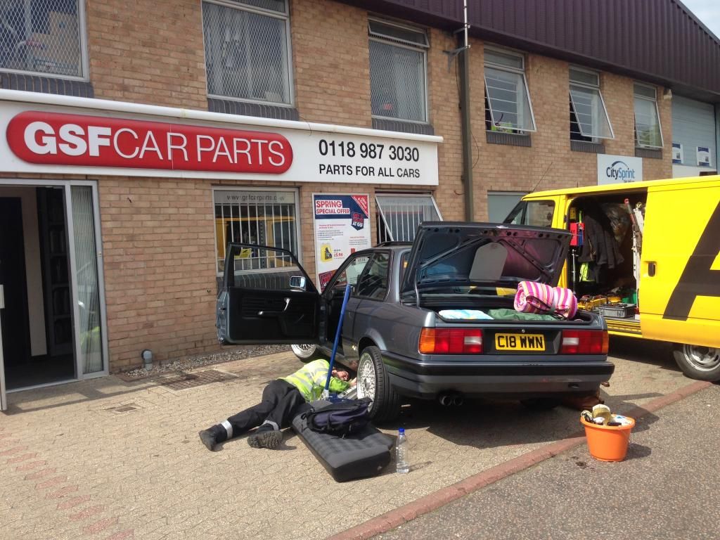

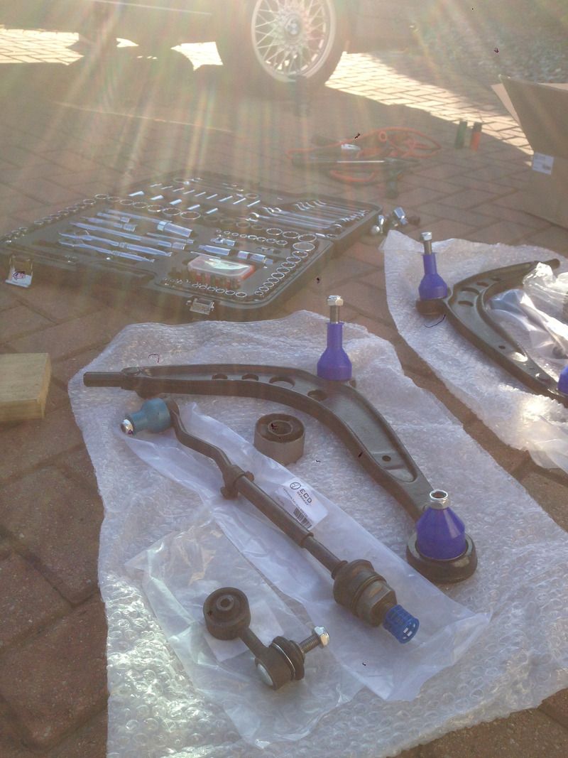

Learning from last years dramas I came home a few days early to give the car a good once over and run it about to find any little problems after being stored over winter.
To my delight there was a few.
Within a few hours of arriving home the car looked like this
So I could replace these in the morning
The wishbone bushes were left out as I have polyflex items going on

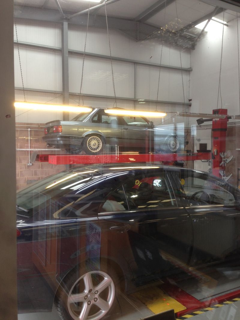

Once it was all fitted and tightened up, off to get the alignment sorted
A new battery was ordered, the cold weather had killed the previous one.
Then onto the fuel pump (again) Where as the last replacement did its job, it was noisy as hell, so I went about fitting a new all in one item.
After a few miles on the new bushes balljoints and tracking I decided it was time to make the old bugger look half about again, so new rear tyres were added to the big BBS's

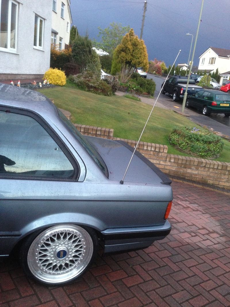

And a new electric aerial was fitted
diff oil changed
With all this work done, the IS spoiler will get clipped on for the journey.
The old 15" BBS basket weaves will be going up for sale.

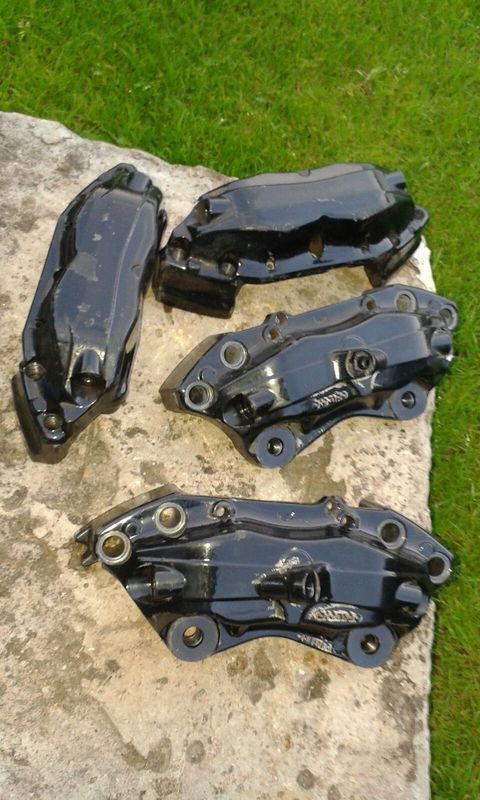

I've got a set of E38 Brembos for up front and E34 ATE calipers for the rear, so I'll need something a little bigger for winters.

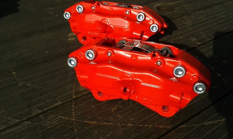

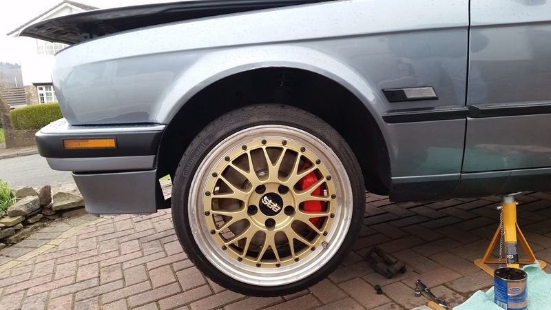

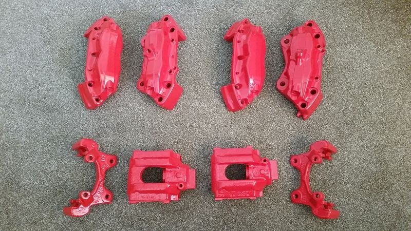

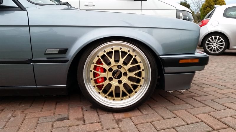

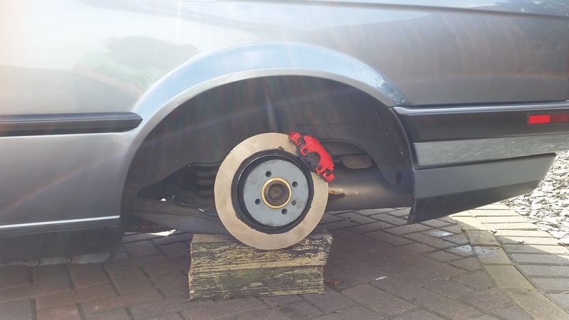

Got a set of E38 730i Brembos and E34 540i rear calipers
Which were stripped powder coated and rebuilt. All this is going to get fitted with the 300mm.de bolt on kit. The clio servo and 750i m/c are tucked away somewhere at the moment, but will be fitted to help move more fluid around the system.
Only have the fronts on so far...

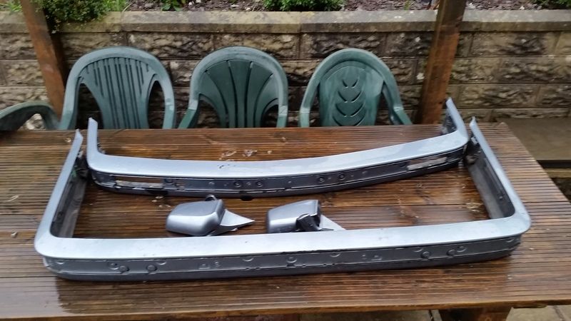

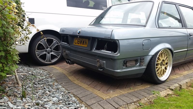

The bumpers and mirrors were sent off to paint as they had seen better days, with various stone chips and general wear and tear.

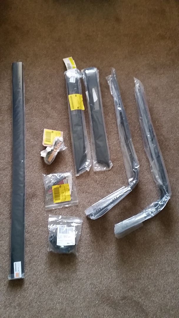

I took advantage of having these stripped down to order up all new rubbing strips and side markers.
Also got the rear lights and indicators off to give them a scrub to get rid of all the crud and condensation from ill fitting seals

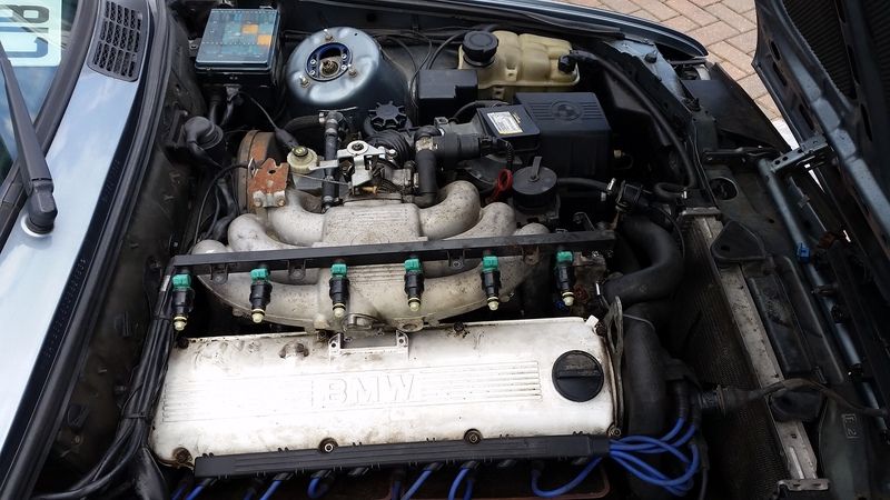

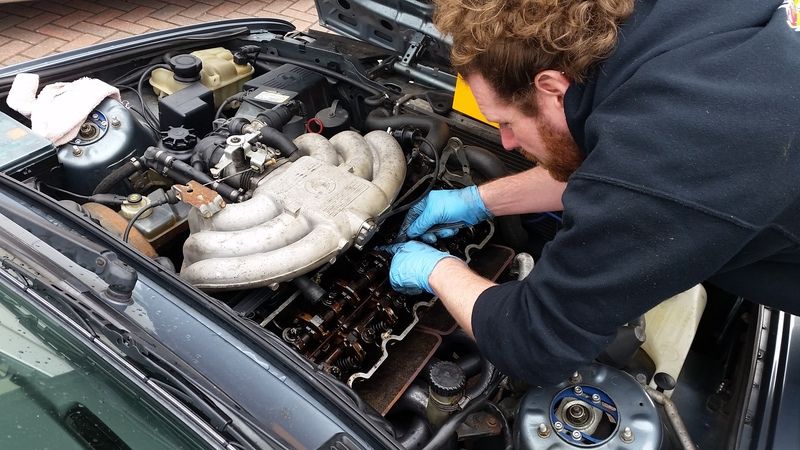

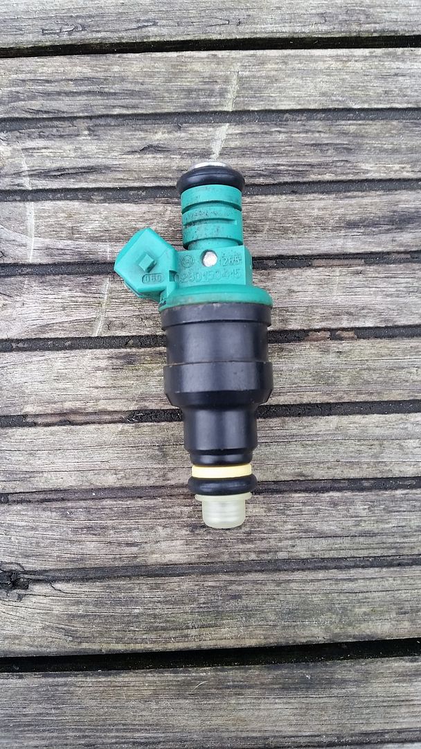

The motor is ticking quite loudly so it was decided to upgrade the injectors to the m50 type, after buying and fitting a rebuild kit.
Once everything was back together to make sure I didn't break anything, we whipped the rocker cover off to check the valve clearances, and to paint it up to get rid of the hideous white.
Much to my dismay they were all within tolerance. So slightly thicker oil and a new filter has been ordered to try and make the engine a smidgen quieter.

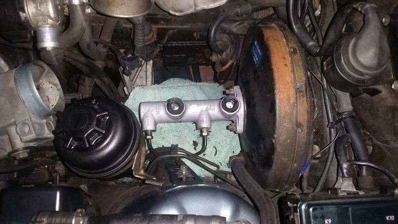

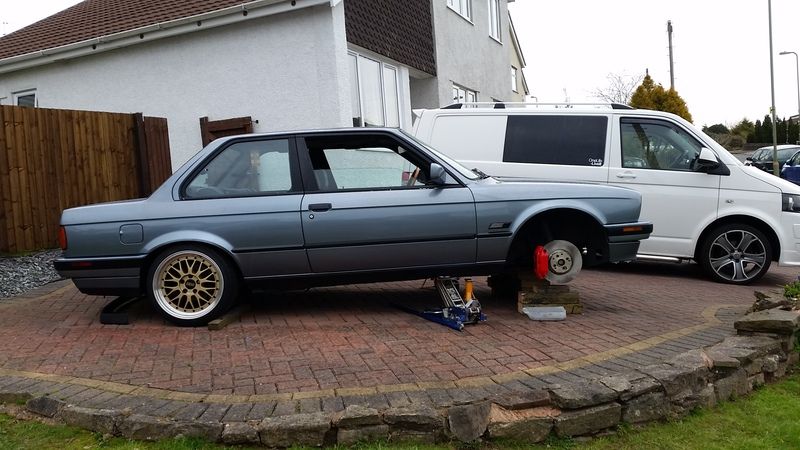

Got the E32 master cylinder on to deal with the extra braking force needed.

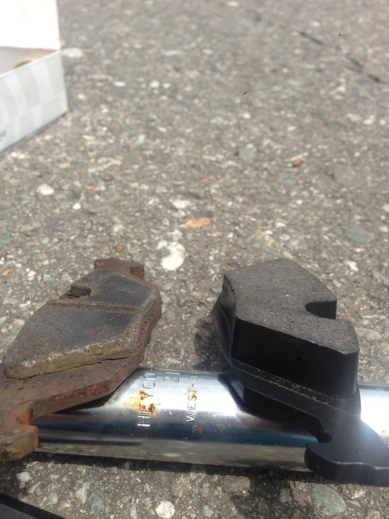

Had to replace this little bugger... weeping over the belts causing a nasty squeal and the obvious loss of coolant.
And after 2 days of hard work the rears are on and bled... Alot of cutting and reshaping of the splash gaurd and hubs, retapping all of the threads the powdercoaters filled and all new brake flexis and fluid.
Whilst being Bled
a few close ups....
