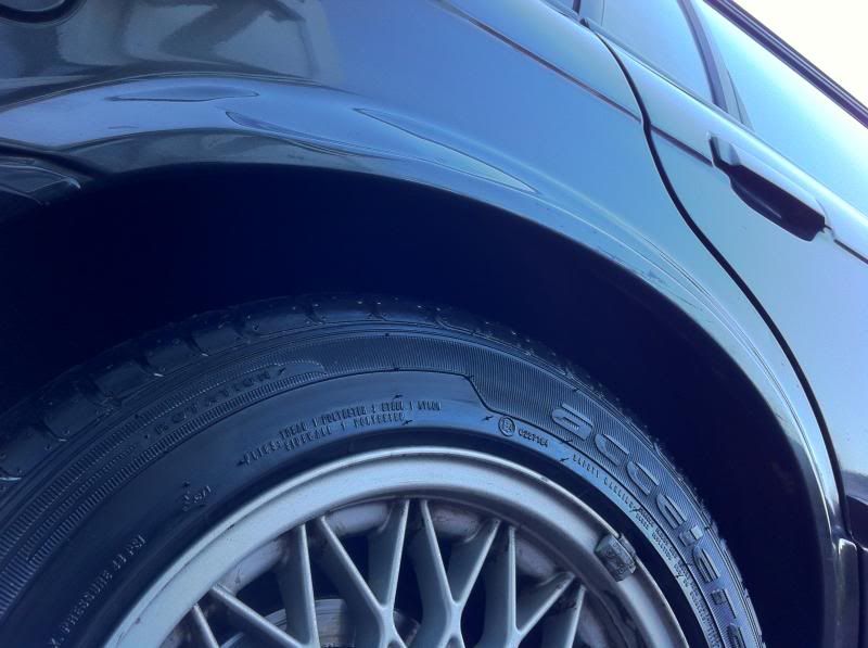

    Clear coat gone funny on the bonnet and one of the front wings

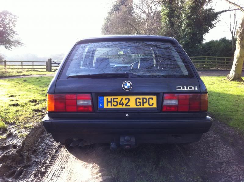

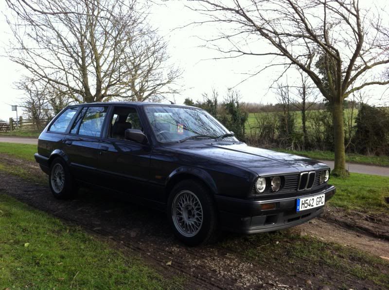

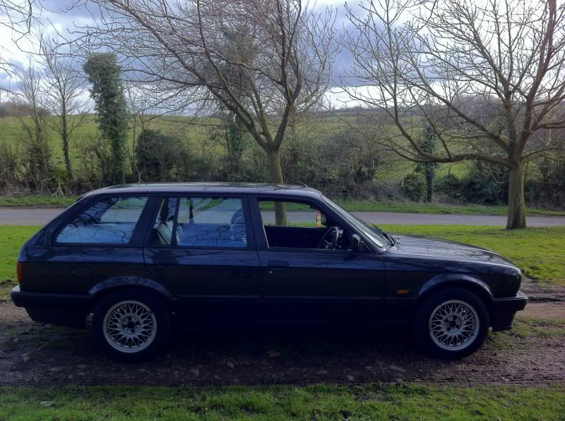

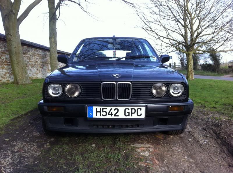

anyway heres some pictures...........

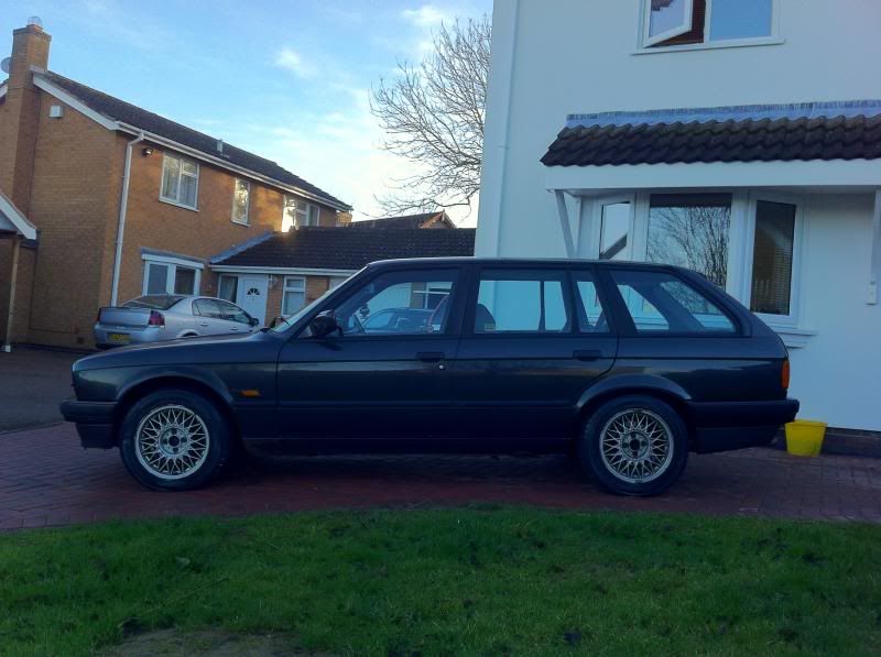

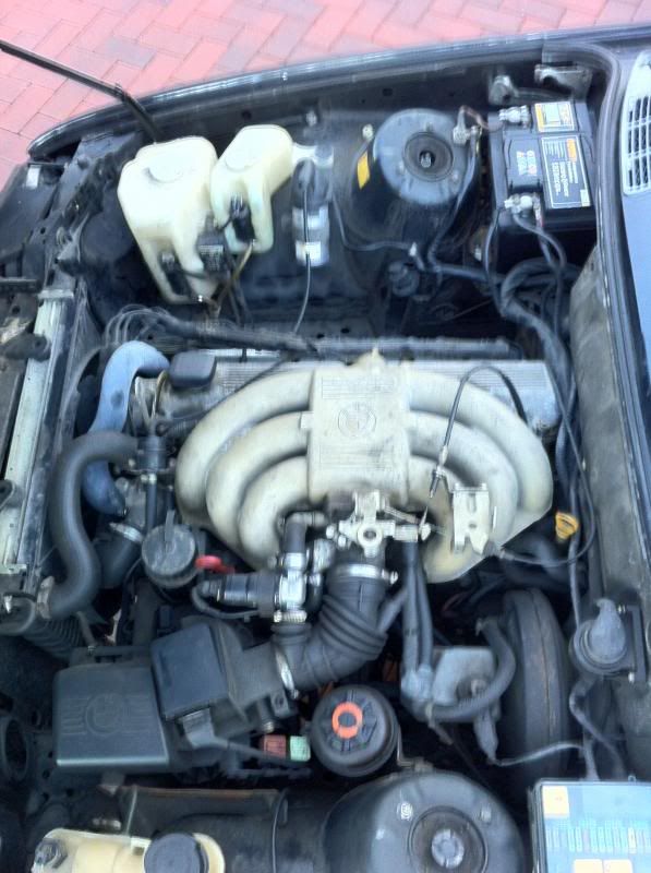

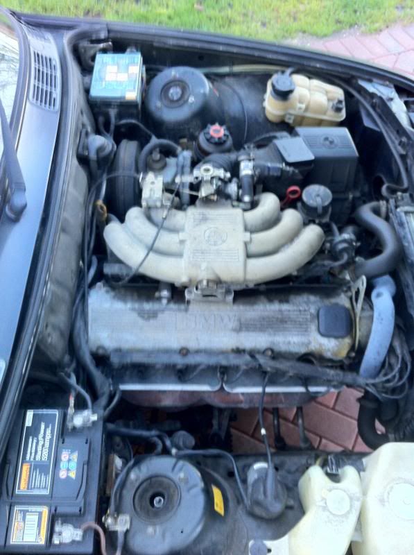

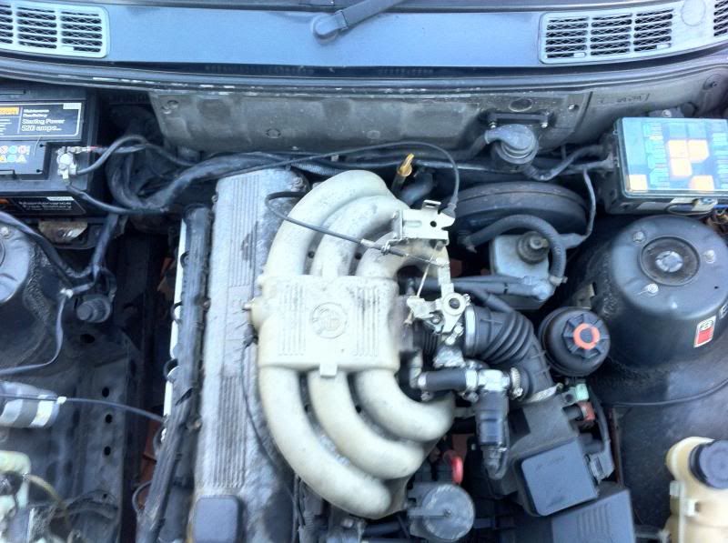

Now being an M20 virgin can anyone tell me if the conversion looks to have been done properly?
engine runs and idles well, seems to pull well, can be a bit scary in the wet when you hit the kick down switch as the back end likes stepping out the only issue I have is that sometimes from cold it won't start first time but always fires up on the second attempt

Post Thu Jan 02, 2014 8:58 pm
Top hose clip missing
Plug lead holder broken
Wiring loom channel missing from bulkhead
Still has M40 AFM bracket, should have M20 one welded on
No bracket for DME/Fuel pump relays
Dizzy cover missing
O2 sensor plug in wrong place, should be under battery tray
Clips for fan shroud missing
Clip for expansion tank hose missing
Expansion tank looks too far forward
That's just from the hazy pics.
I bet there's some moris ital hose clip action as well!

Post Thu Jan 02, 2014 9:03 pm
bss325i wrote:Top hose clip missing
Dizzy cover missing
Thanks for the input
Are any of those a huge concern that I should address asap?
1990 BMW E30 318IS (Sold)
1990 BMW E30 316i (RIP)
Post Thu Jan 02, 2014 9:12 pm
Most of that is general tidying up of the engine bay.
The top hose clip missing could cause the hose to hit the fan.
The missing loom channel might cause the loom to rub on the engine and short out over a long period.
The missing dizzy cover might let a big splash of water allow moisture into the cap.
The missing fan shroud clips might mean it can jump out of its bottom slide mounts then hit the fan.

bss325i wrote:Most of that is general tidying up of the engine bay.
OK good to hear so it is a bodge but not a bodge of massive proportions :D

Without seeing it in front of me i would not say if its a bodge or not but its not a very tidy swap from what i can see.
All easily sortable though.

I'm pretty sure that oil filler cap on the rocker cover isn't a 325i one also - it's probably the 318i M40 one.
The M20 engines had a round cap with a handle moulded in.

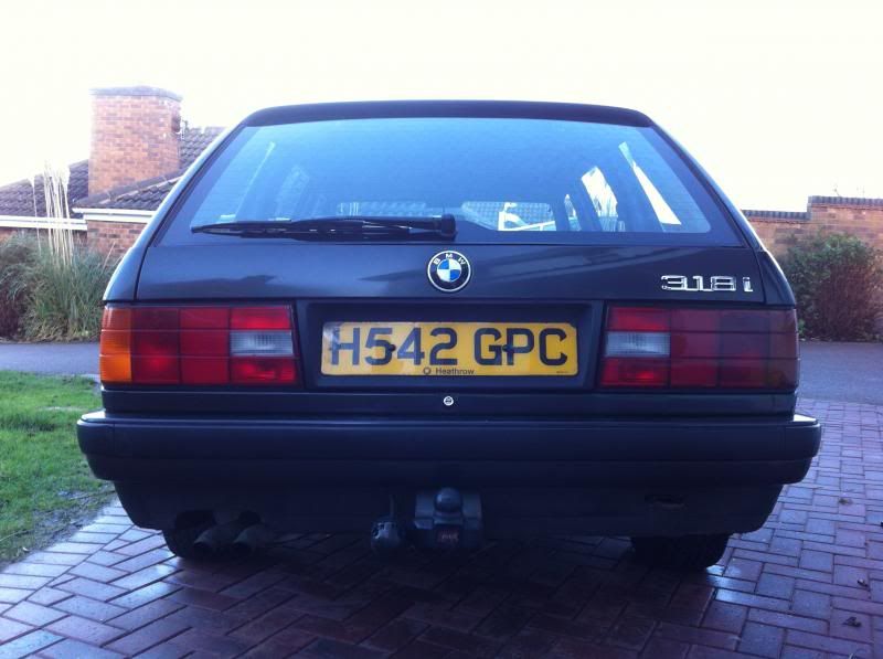

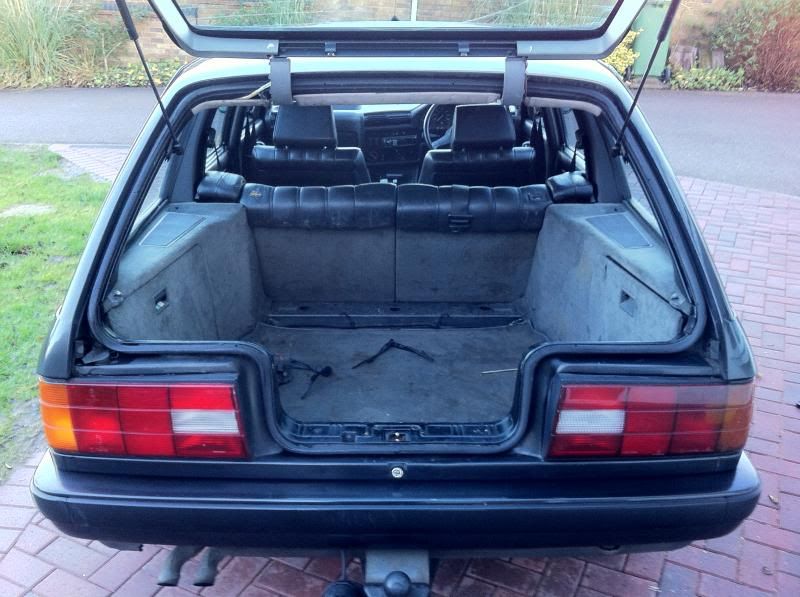

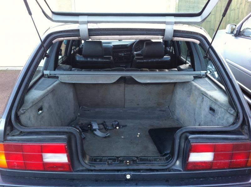

Been doing a few bits and bobs on the car today, when i got it the boot lock was not working on the central locking but just needed the link reconnecting so that's fixed now. The OBC was not lighting up so replaced the bulbs and its working again. O/S rear boot compartment the catch had fell apart just needed putting back together.
and also managed to source all my missing boot trim and a load cover from a guy just down the road from my work.
Before...........
After.........
Just needs a dam good clean now

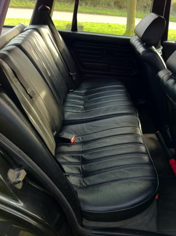

While ypu are paedoing, You need to refit the rear seat outer 'bolsters' Being fitted badly is a sure fire clue to a council trim swap. They should fit flush with the rest of the rear seat. A bit of force is needed to get them to secure correctly and then a 10mm spire bolt (undoubtably MIA) to secure them at the bottom. An even better plan would be to remove the leatherz for serving and retrofit some cloth scrap. Demorseling FTW ! :D
There is something therapeutic (and stupid!) about spending time desnagging a scrapper. I am currently wasting too much time on a £100 318 touring that I bought to frag . I must be getting soft in my old age :)
pac1982
Posts: 5330
Location: isle of wight
Post Mon Jan 06, 2014 3:58 pm
pacerpete wrote:While you are paedoing, You need to refit the rear seat outer 'bolsters' Being fitted badly is a sure fire clue to a council trim swap. They should fit flush with the rest of the rear seat. A bit of force is needed to get them to secure correctly and then a 10mm spire bolt (undoubtedly MIA) to secure them at the bottom.
I did notice that myself but not got around to sorting it yet, I was hoping it was poor fitment and not that the bolsters were bent out of shape

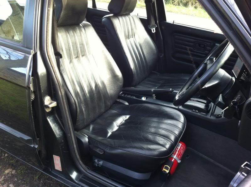

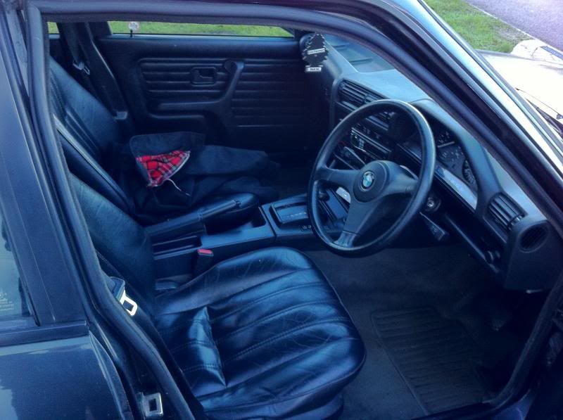

Any idea what comfort touring leather is worth? I know a sports interior can go for anything up to £500 in good condition but have no clue what comfort is worth, I wouldn't imagine alot.
I'm also quite surprised to see how much these are worth especially in non working order
