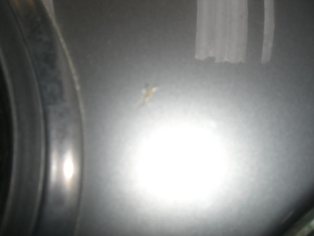

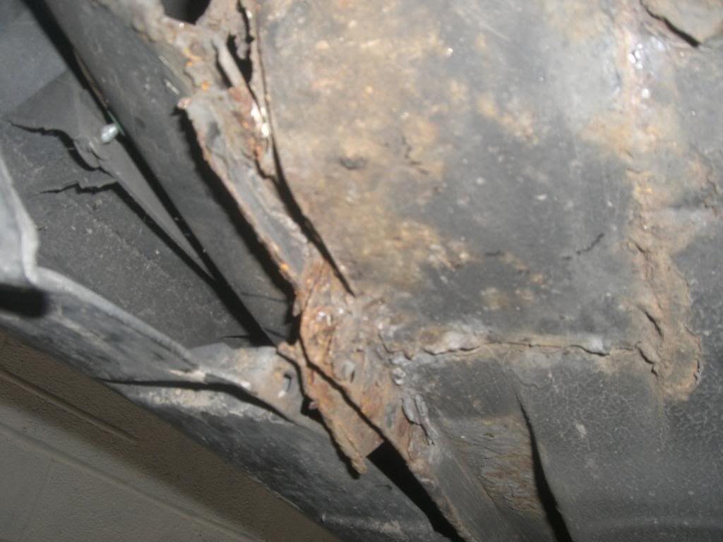

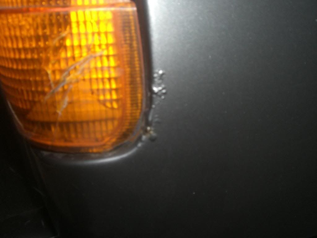

drivers front at end of seal
drivers rear arch

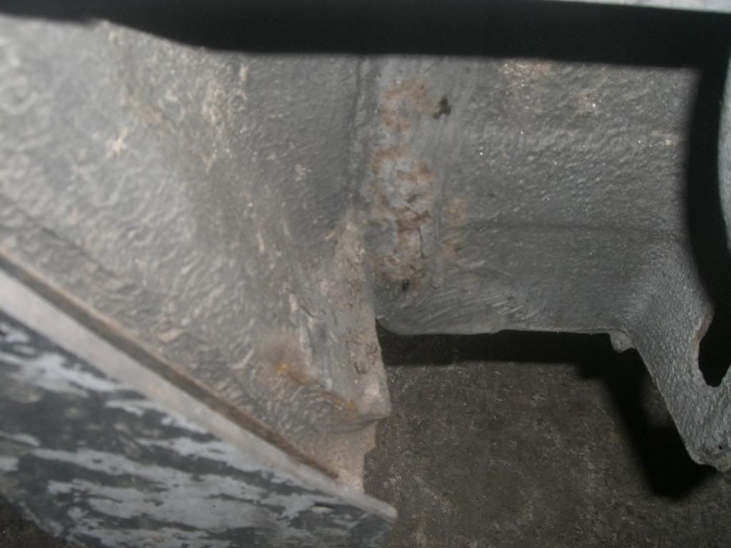

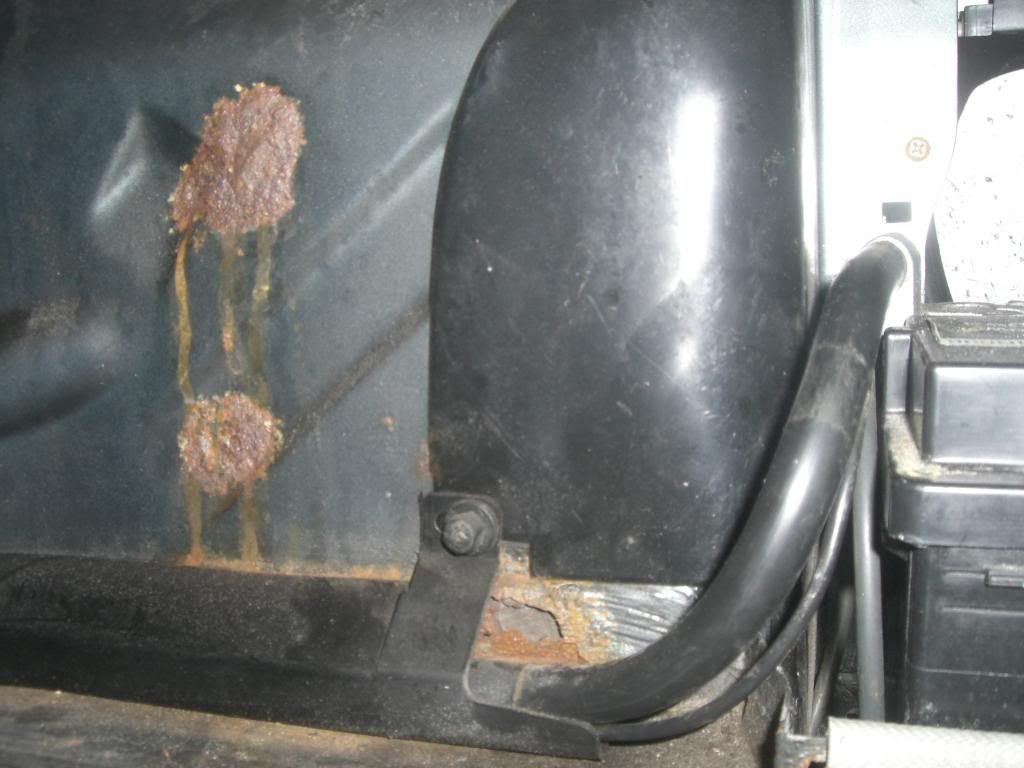

under battery tray
inside boot

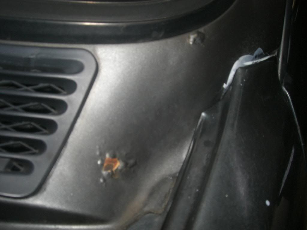

heres a few pictures of the only surface rust on the body work .
and here is the car

there will be some serious rot to chop out of that though, it looks like its gone in all the same places as mine. the area around the fuel breather looks interesting, if its like mine that whole lot will need to be chopped out and fabricated.

the areas on these that tend to go, rear arches looks like yours has gone there.

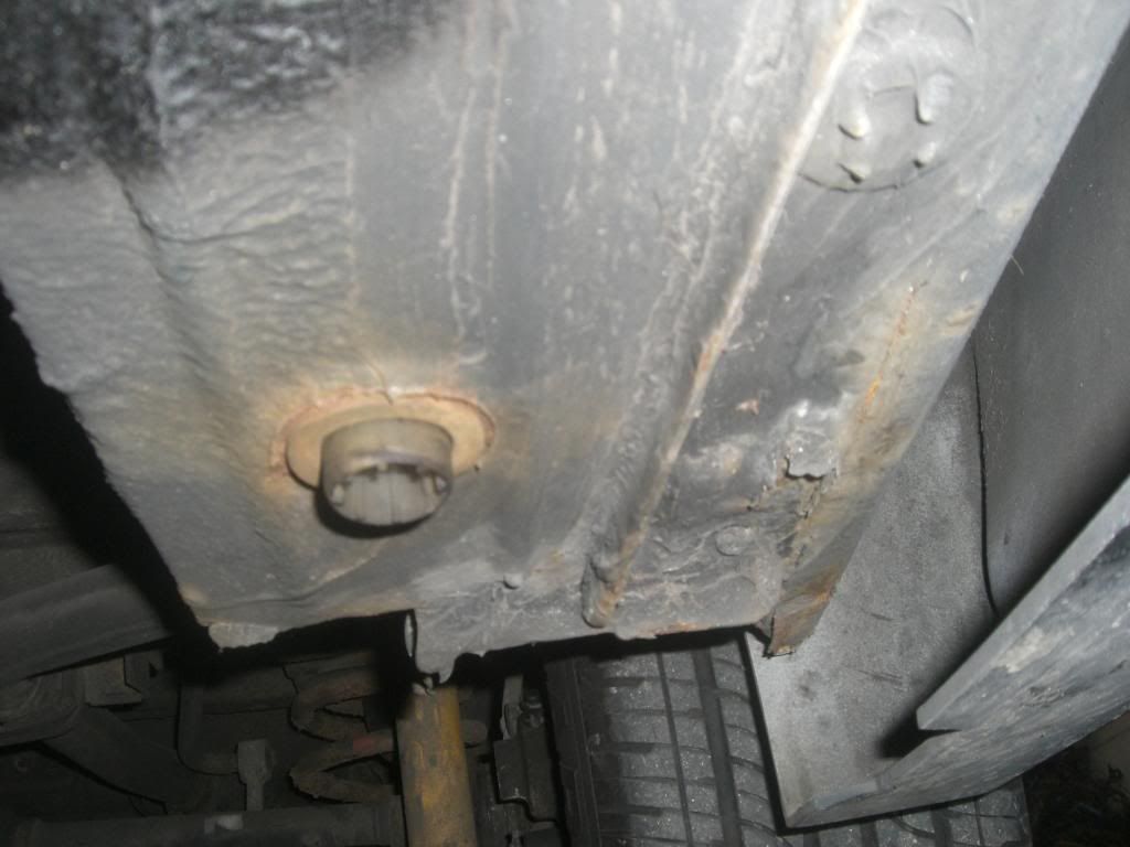

the front jacking points, looking at your sill pictures its gone there aswell.
also the area you photo graphed at the corner of the scuttles, the fact rust is coming through here will mean its most likely going to be windscreen out and fabricate those areas.

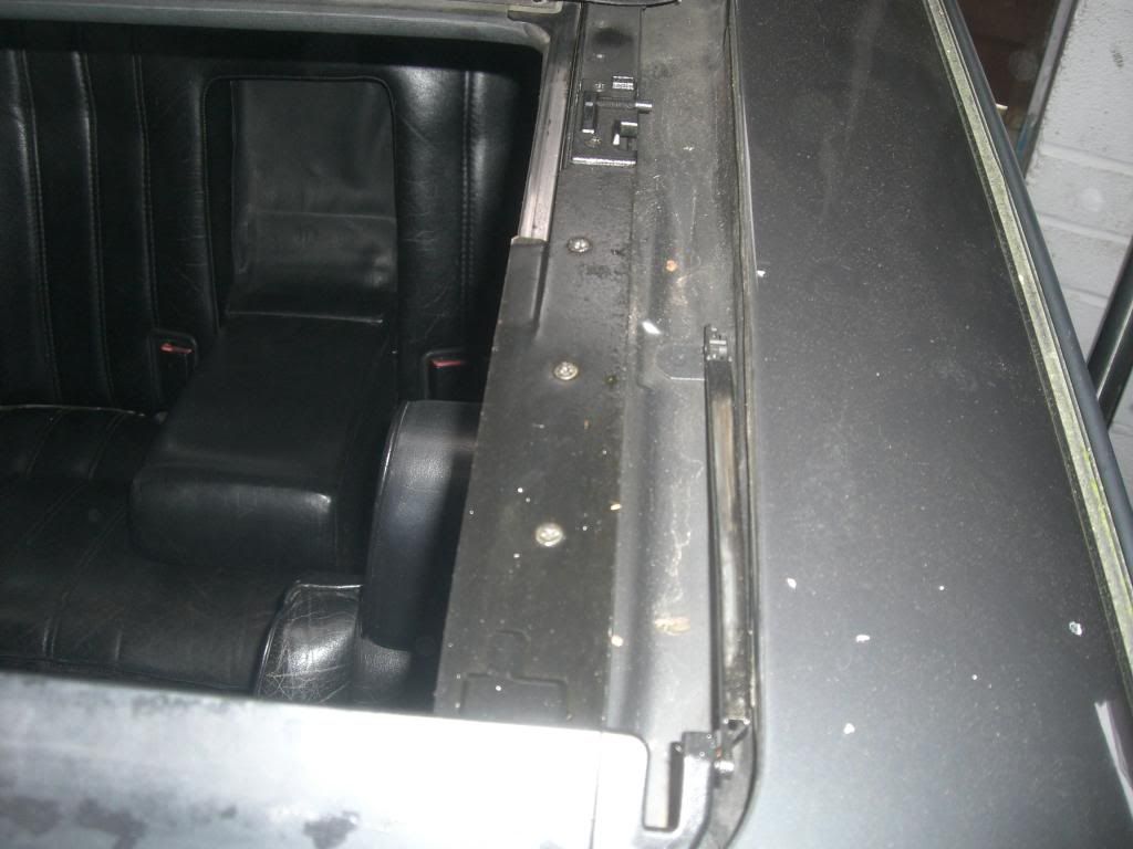

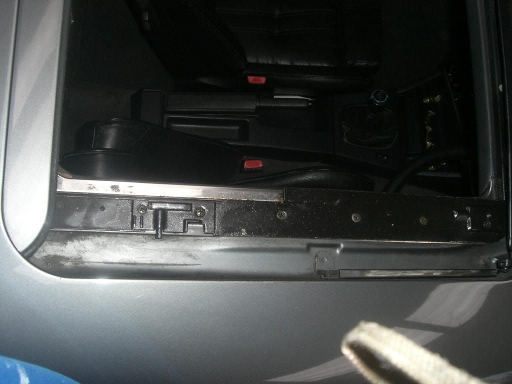

im guessing the buckhead may have some rust or its coming in from front inner arch by seal as driver front carpet is slightly damp . here is sunroof gutters
the passenger front jacking point has already been wleded but looks ok atm, but will still take a grinder n hammer to it to check,
in the pic below its dirt not a rust spot to

ianhayle87 wrote:heres a few pictures of the only surface rust on the body work .
That is not surface rust.
I would be taking the dash and screen out and checking the bulkhead on the passengers side and repairing this at the same time.
This needs stripping to the max to see the whole picture. It'll either confirm what you currently think and you can break out the welder. However, I fear you may be making other decisions once you see the full amount of rust as at the moment, you've only just scatched the surface.
