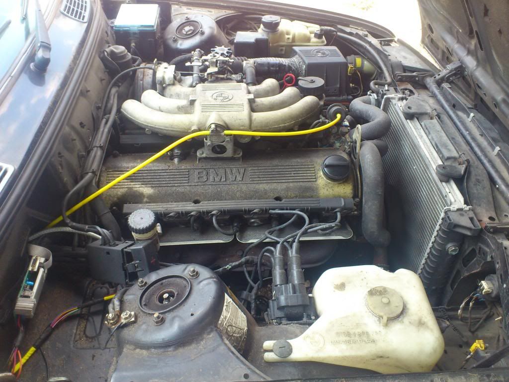

It was all looking suspiciously unmolested until you opened the bonnet ! :eek: What is all that shit about ?

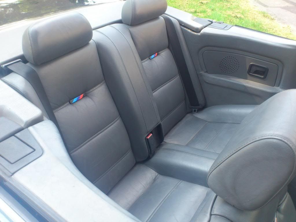

Very nice, are they original rear headrests or from another car?

pacerpete wrote:It was all looking suspiciously unmolested until you opened the bonnet ! :eek: What is all that shit about ?
Imy can't let go of his Ricer addiction. :)

kangman wrote:Very nice, are they original rear headrests or from another car?
Ghetto rear heads FTL . The sort of person that carried out that under bonnet fooookfest will have undoubtably carried out plenty of other interesting modz :(

Is it running MS?
webmaster@e30zone.net
Posts: 22486
Location: Derby Massive!!
Wed Jul 17, 2013 8:36 pm
Chill out guy's, it's running Megasquirt MS1 :)
Previous owner did the conversion, i'll tidy it up when I get round to it, make a cover and that.
Apart from that and the rear Tech 1 (which is going), it's pretty much original.
It's got an upgraded Z3 rack and a brand new roof fitted, bonus !
I'm going OEM with this one :cool:

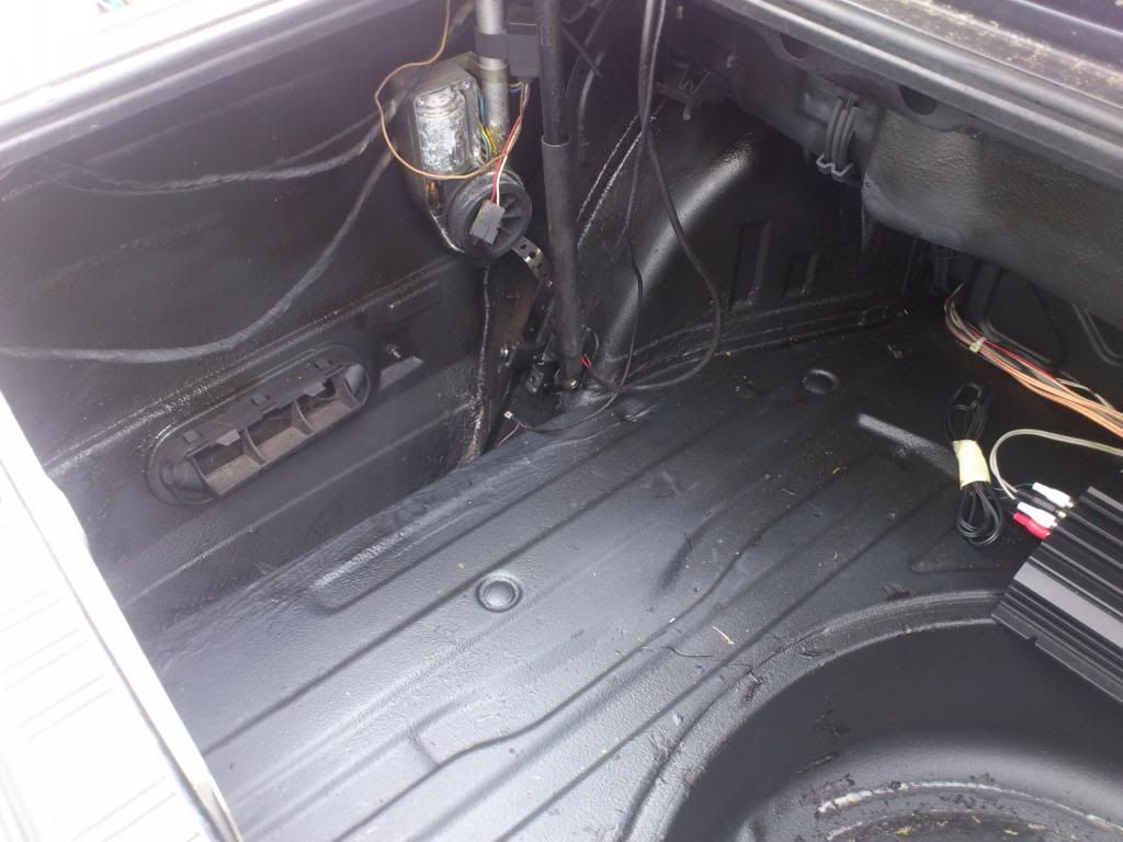

You wanna see inside the boot !! Its totally caked in the Black Death hammerite with added waxoyl, its everywhere , all sticky and horrible under the carpets, a shame , and all around by the glove box hinge brackets etc and bottom front wing area was ropey
I had a good look at the car but walked away , engine leaks galore and iffy shakes/wobble in the drive, bearings maybe
But it was a straight car, but a bit of a dog needs a lot if tlc

The Megashit wants to come off and replacing with proper Motronic.

Are those not E36 headrests?

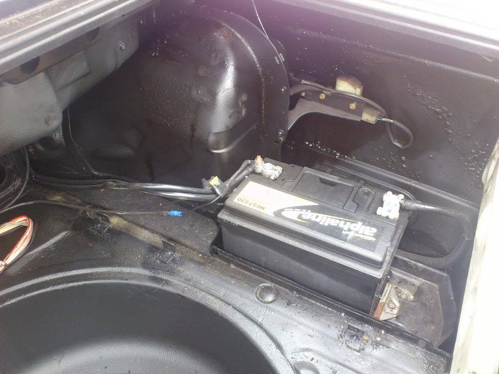

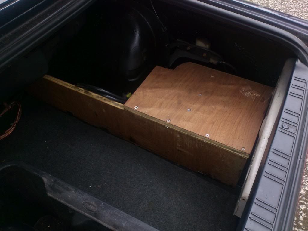

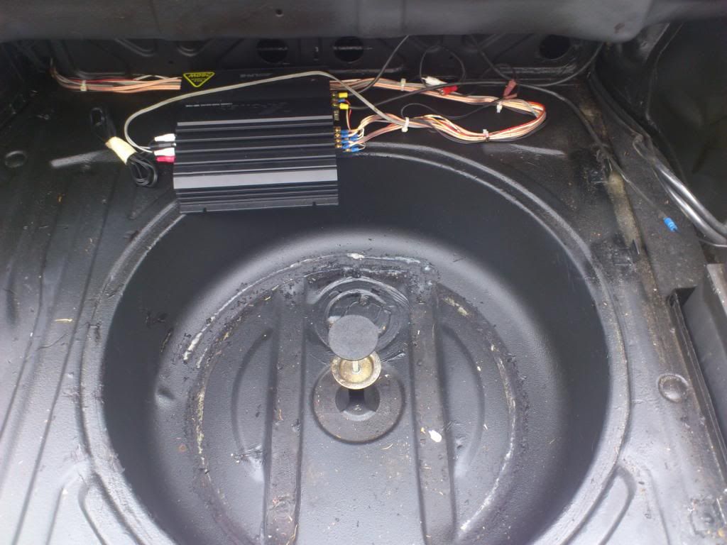

Battery is in the boot, replacing the weight that's normally in there. I will post up a picture of the cover made for it winkeye
Not sure what the rear headrests are off but I have a stash in the garage so will get the right one's put back in.

Bear in mind that the previous owner is a computer fanatic and programmer, so naturally, had to install a fully configurable laptop-controlled ECU on his car! :wink:
Nothing wrong with MS, as long as it's properly built and set up correctly; the problems arise from a lack of understanding of how it operates.
If it were mine, and I decided to keep the MS, I would at least seal up that electronic unit next to the bulkhead, to keep the water out! :eek:

ImysE30 wrote: Battery is in the boot, replacing the weight that's normally in there. I will post up a picture of the cover made for it winkeye
Do it :) one of the highlights for me that was

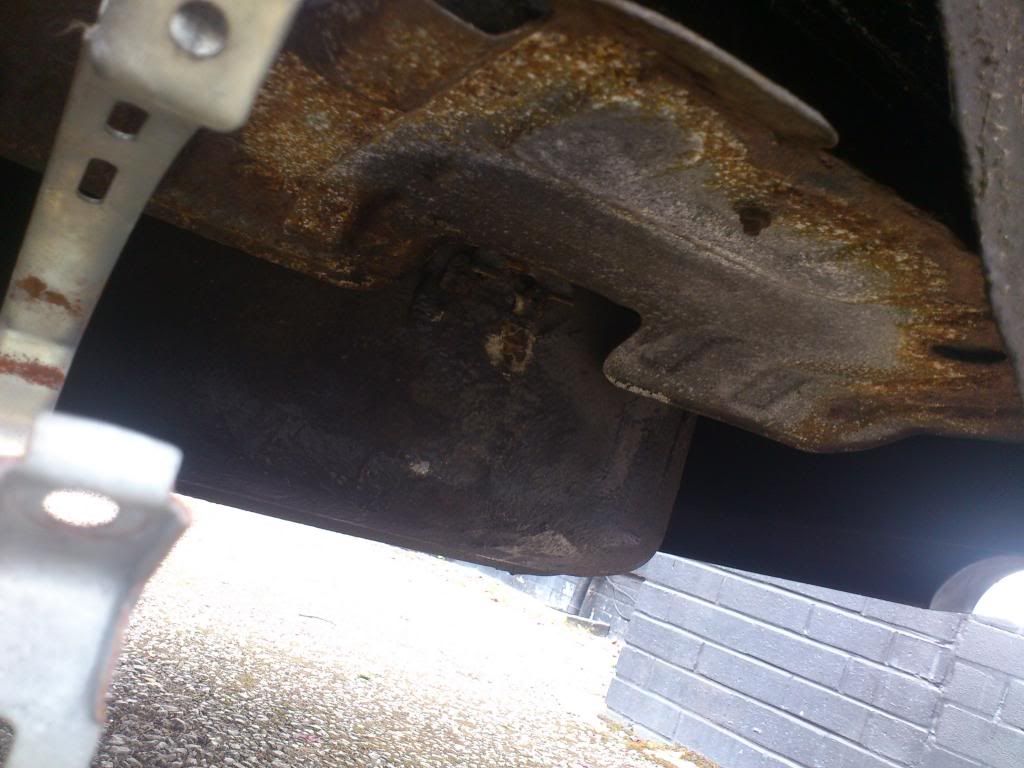

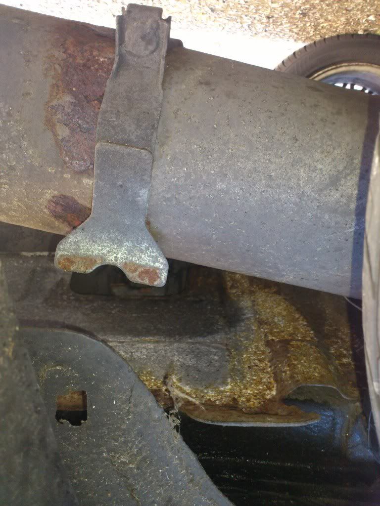

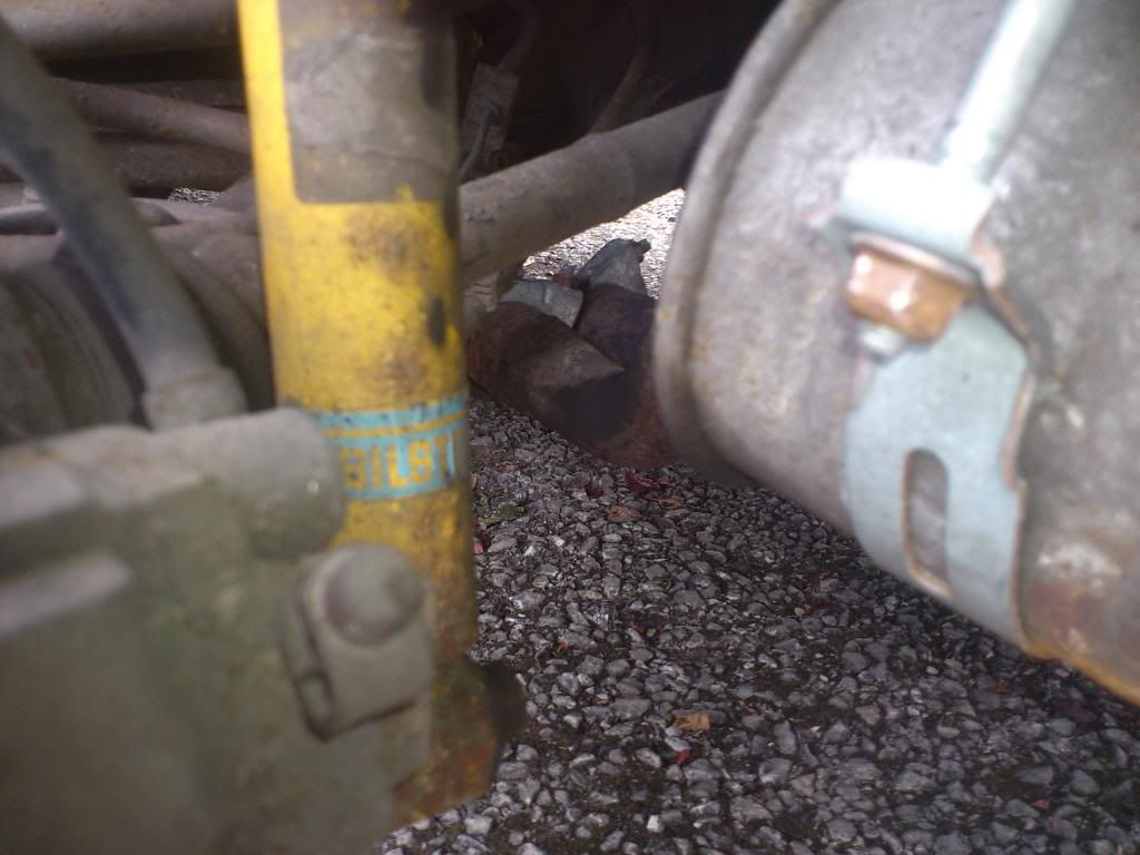

Today's joy was the exhaust rusting off :mad:
Can safely say that's kaput, think it's original so done well to last 25 years. Need to replace it now urgently as the car sounds awful :o:

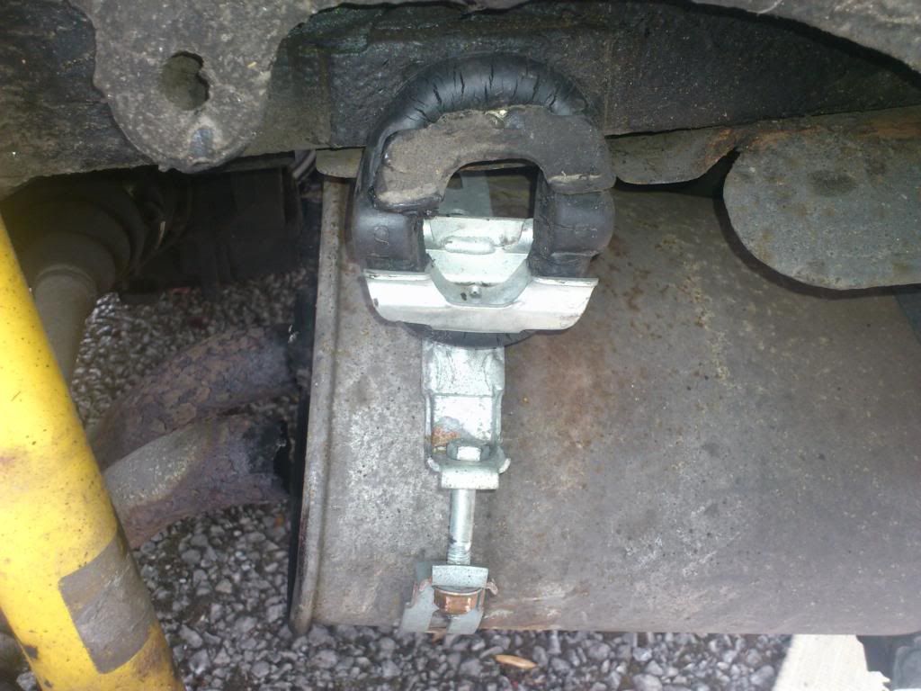

Do I need a 3 piece system or 2 piece system?
Fri Jul 19, 2013 7:48 pm
looks like you just need a rear box from a 3 piece system .looks like the zaust hanger snapped .

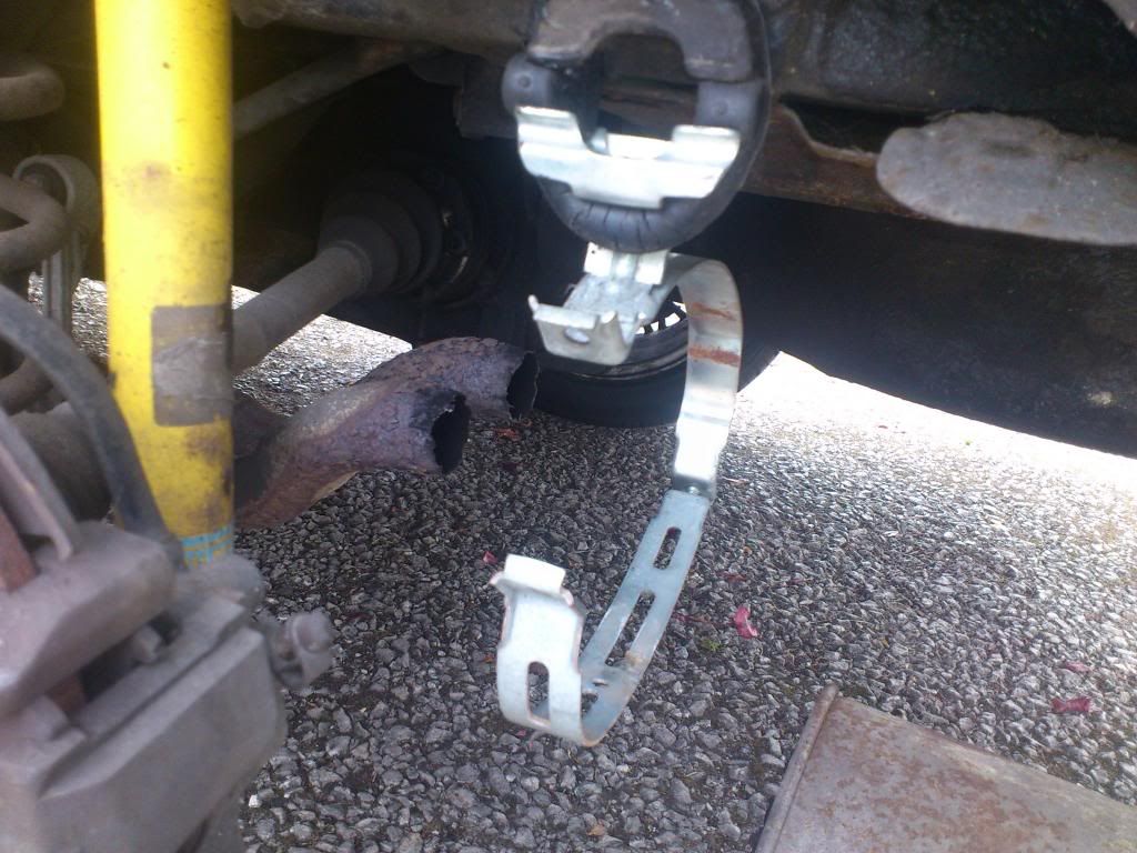

Posts: 22486
Fri Jul 19, 2013 7:49 pm
Cheers Mick. In the last pic, those pipes have rusted away from the backbox 8O

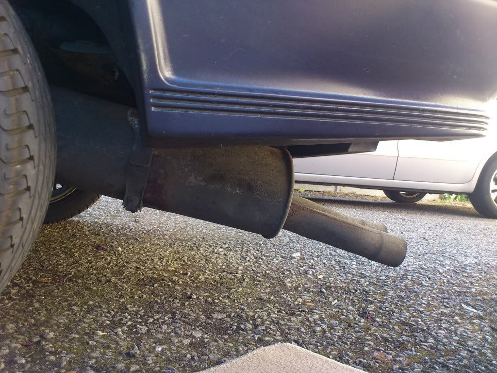

Today's progress was sorting out the knackered old exhaust.

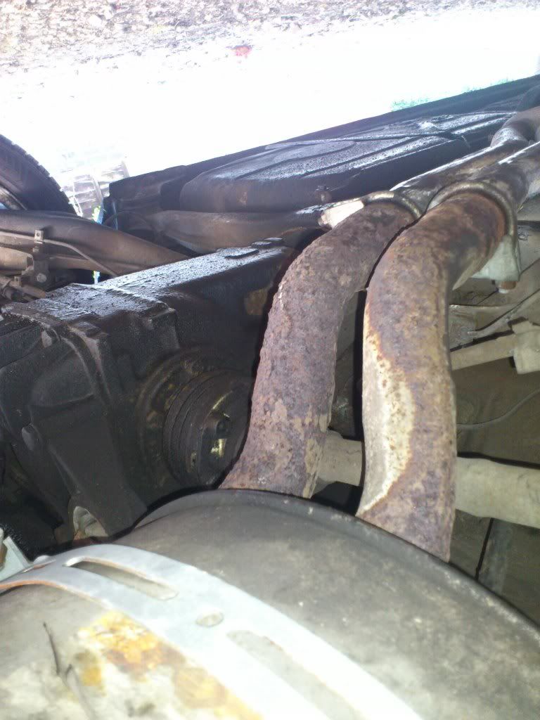

Managed to take it off, proper fooked:
It had WALKER stamped on it.
Hanger rubber's need changing:
Heatshield is rusting so will replace or tidy it up.
Not sure what make the springs are but it's got Bilstien shocks 8)
Boot is pretty tidy, although I think it's been convered in some anti rust seal :?
Here's the battery cover winkeye
Couldn't get the 2 pipes to come off where they join the other part of the system, any ideas? I've tried hammer and chisel with lots of WD40 but no joy.
End of today's play:
More updates tomorrow :D
Sat Jul 20, 2013 6:54 pm
heat them up with a gas blow torch or just keep bashing and wiggling away at the pipes and the should come off .
Posts: 14072
Sat Jul 20, 2013 7:14 pm
I had this issue yesterday, with a length of front exhaust pipe jammed in the rear length. In the end, after trying WD40, various levers, Mole grips, etc., I had to elongate the slots about half an inch using an angle grinder, then it popped right out.
Posts: 22486
Sat Jul 20, 2013 7:19 pm
Hmmm angle grinder :twisted:
