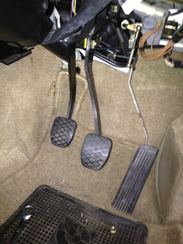

New back plate and paddle clutch not very road friendly

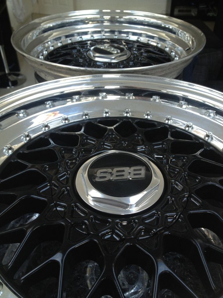

picked up some banded steels cheap 8 and 8.5 x 15 needed some more subtle paint and some sort of bmw centre/hub caps. I had high hopes for them but it turned out they were made by a clown and they wouldnt hold air or balance
