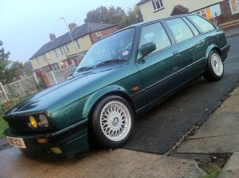

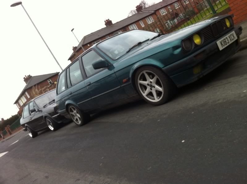

so i got this 316 touring for a steal at £300 in about September last year so that my mk2 polo could be off the road during the winter...
on the way home with it
first decent clean
then this happened thanks to the notoriously low m40 sump...
then it looked perfect when i bought a set of borbet c's!
its getting abit rusty now though so some work is required very soon!

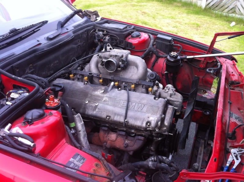

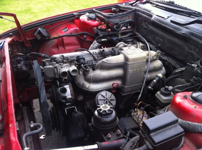

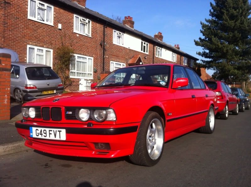

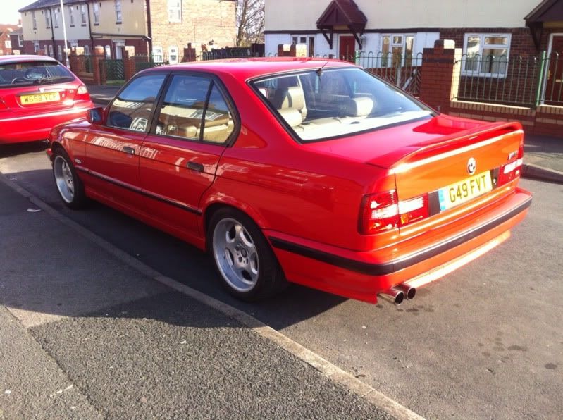

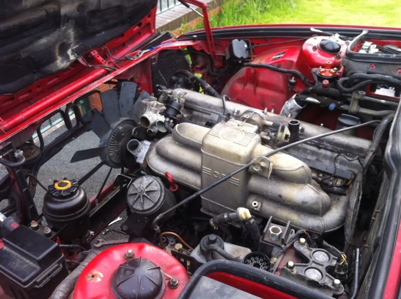

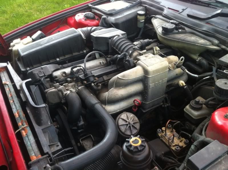

A genuine e34 535i sport, bought for just the engine/loom/gearbox and prop shaft
dont be fooled by the appearence, its foobard underneath, worn steering box and all suspension bushes are shot along with alot of other stuff, driving it back along the motorway wasnt fun with all that power and no way to go in a straight line!
work recently began

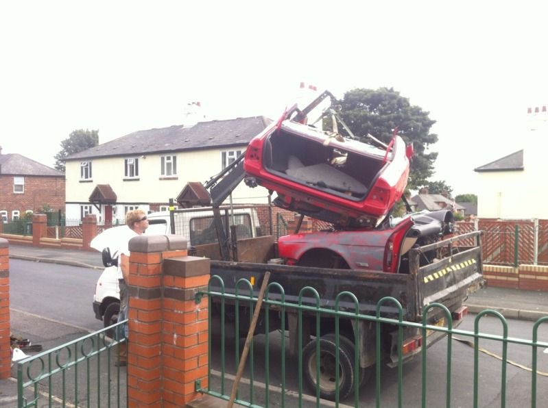

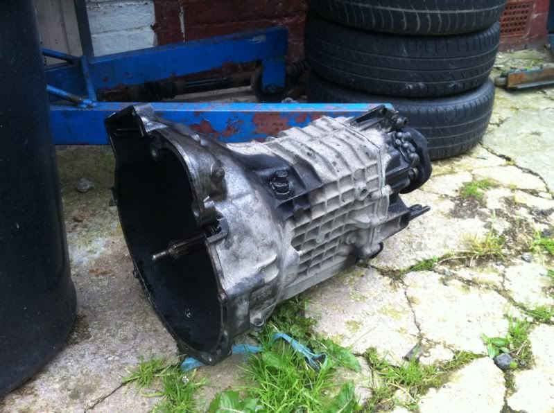

prop shaft still needs to come out and then i have everything i need from it, so i can then remove everything thats worth good money, ie LSD, full leather electric interior, wheels, sport exterior trim etc and whatever else anyone wants, then the shell will be weighed in for some monies to pay for the prop shaft alterations

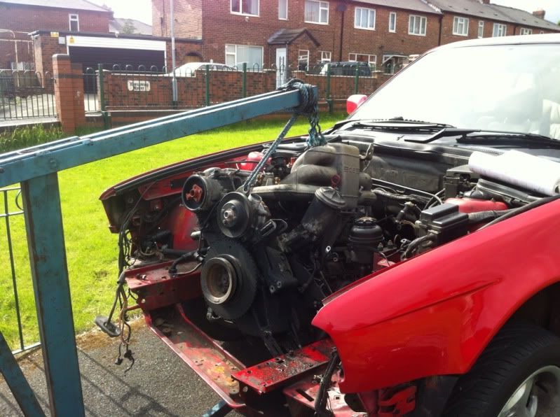

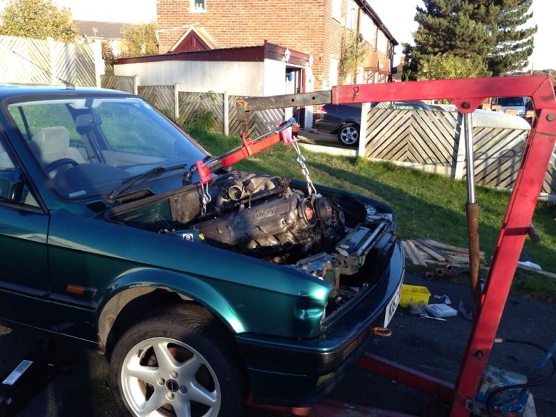

ready to be pulled out when i get my hoist back from a friend :)
dubownerbilco
Posts: 192
Joined: Fri Dec 17, 2010 11:00 pm

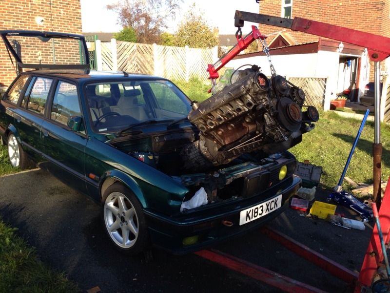

Sun Nov 04, 2012 6:46 pm

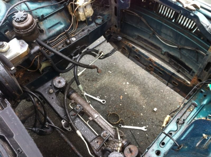

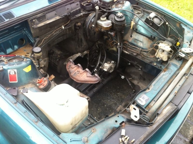

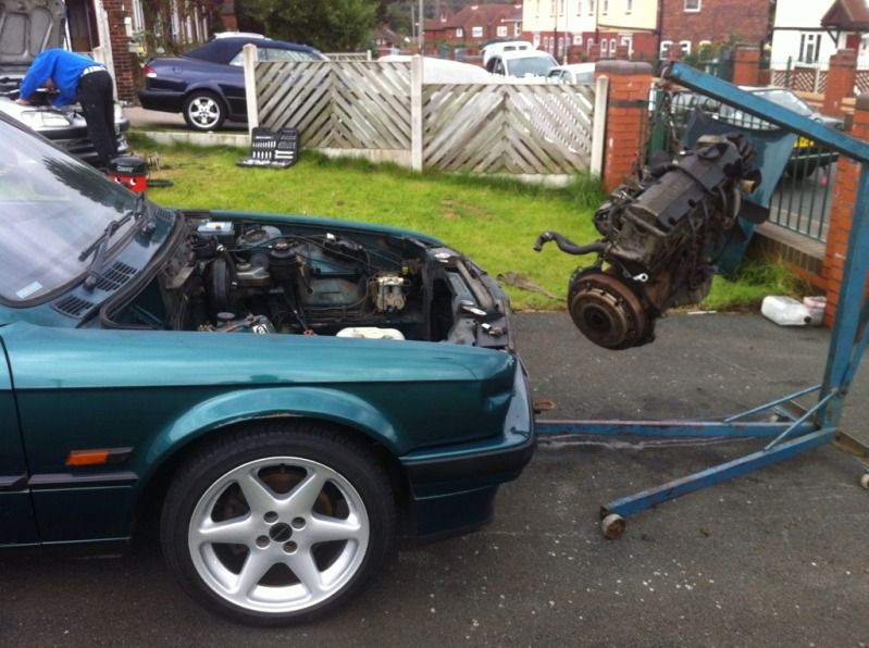

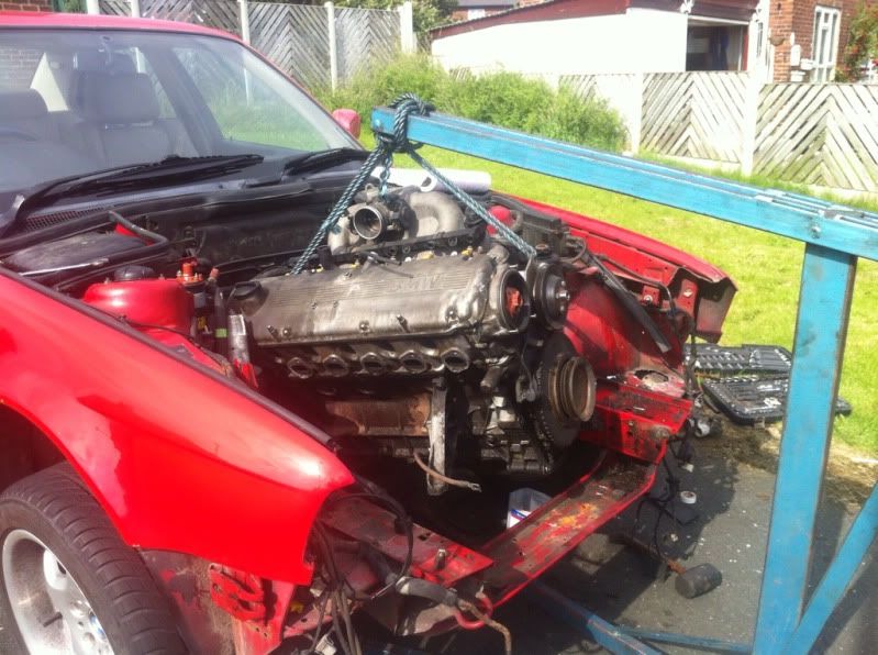

Engine out

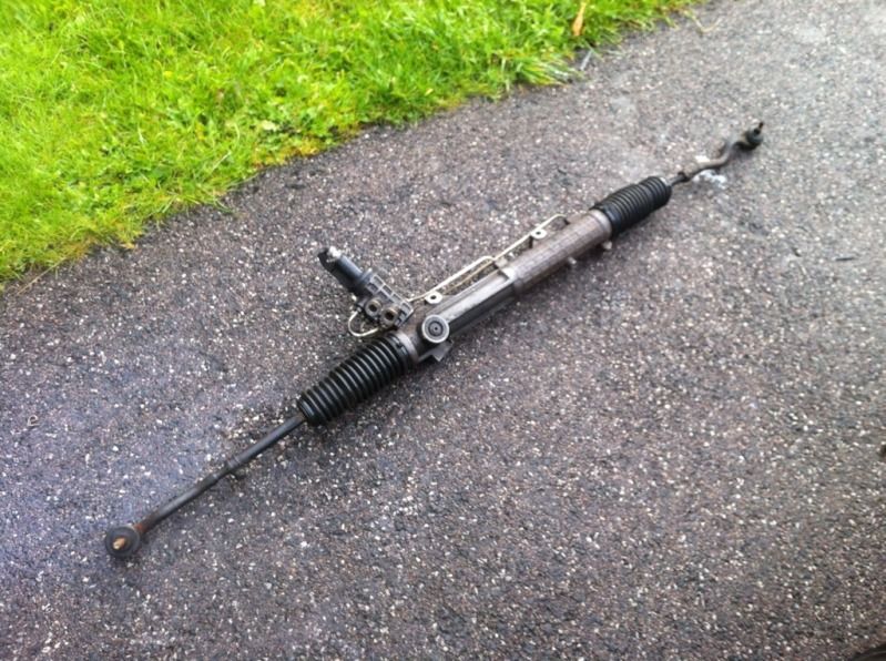

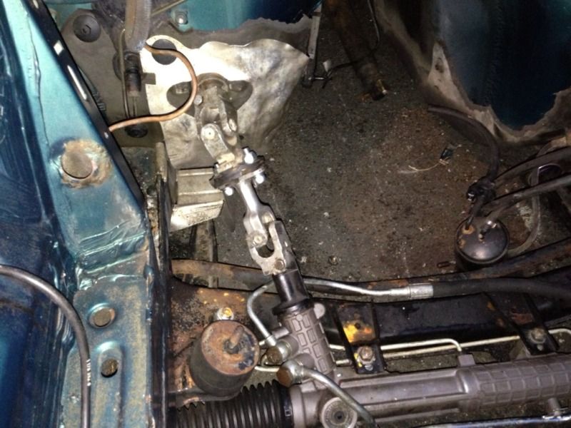

E46 clubsport quick rack
Fitted

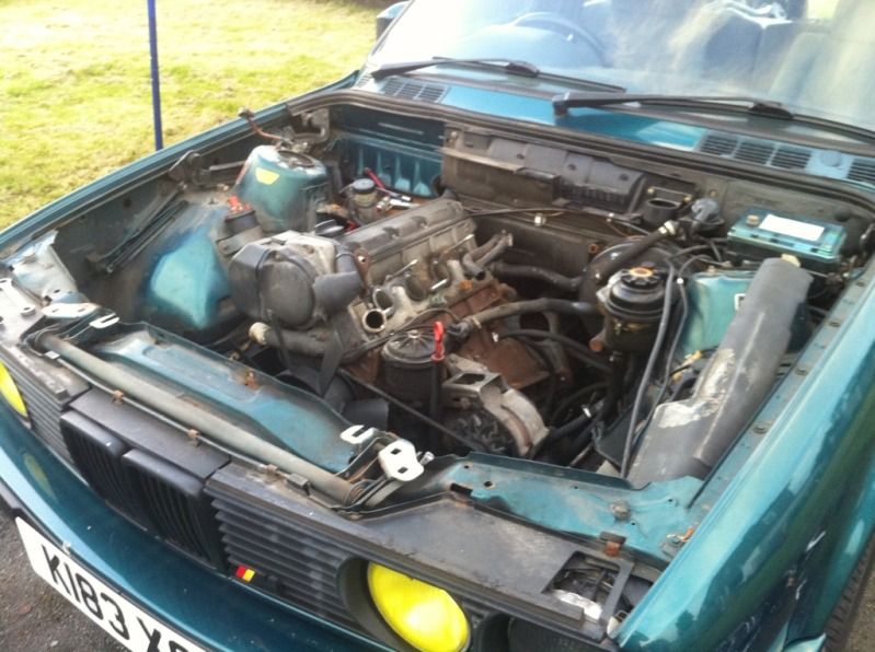

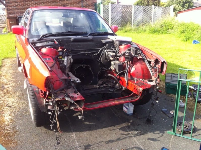

Got some welding to do before the engine goes in!

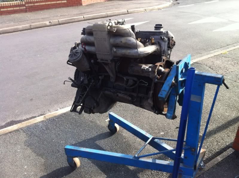

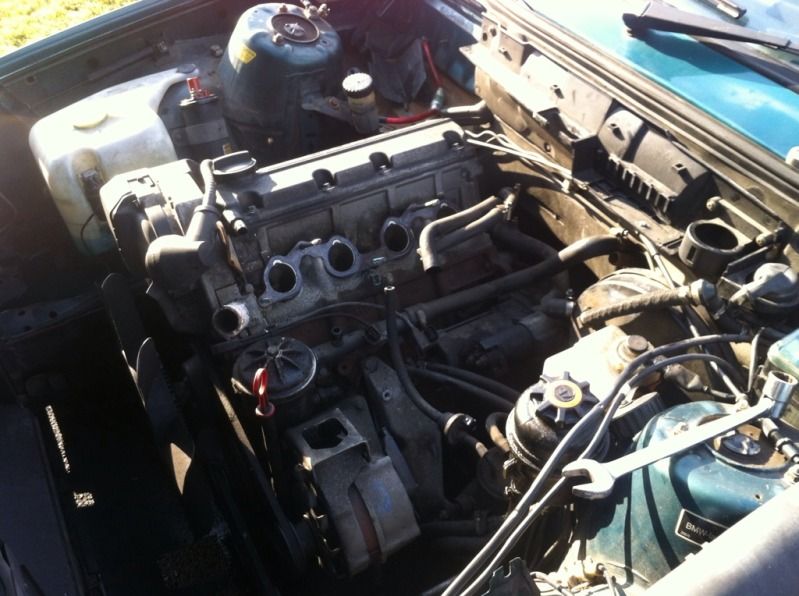

3.5 next to the 1.6!

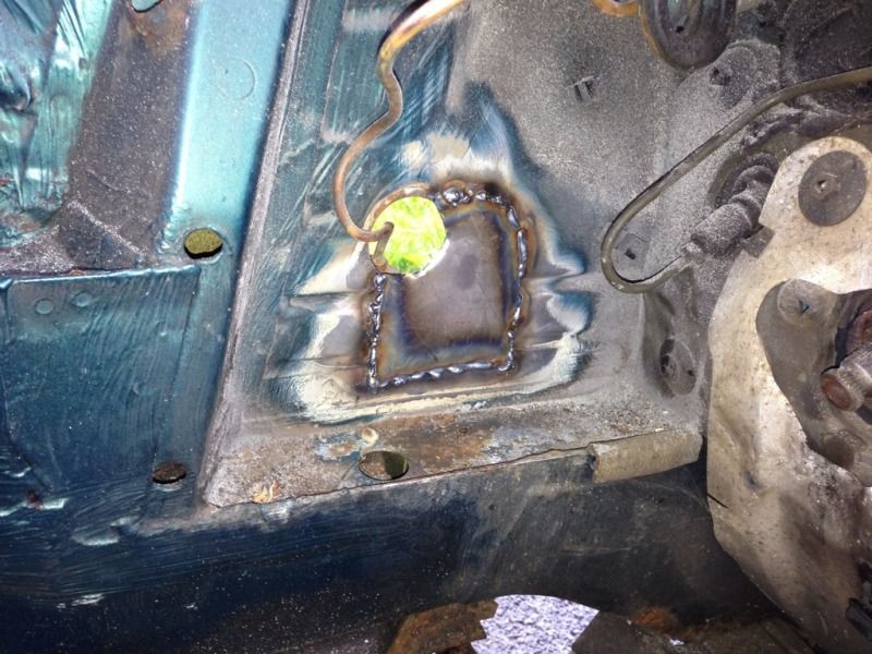

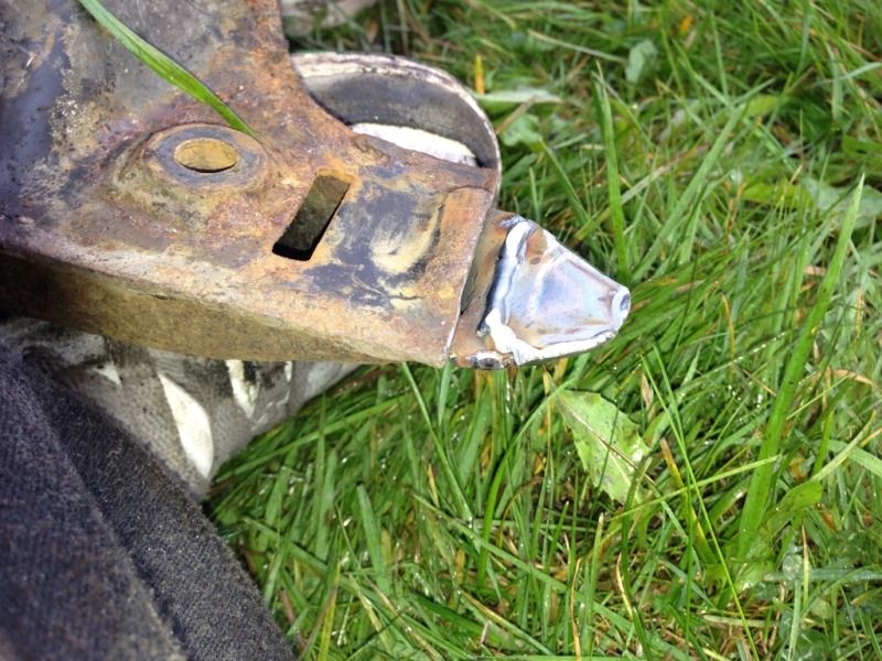

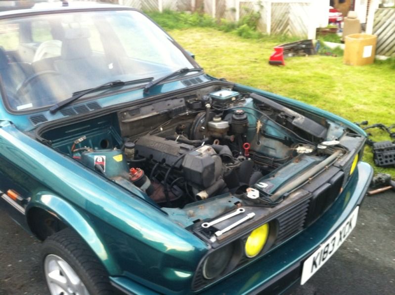

Got on with the welding in the engine bay today, its the first time i have welded properly and i thought it went quite well :)
The best bit of welding I've done so far :) has to removed the subrame to repair the antil roll bar mount as it has rusted and snapped off!

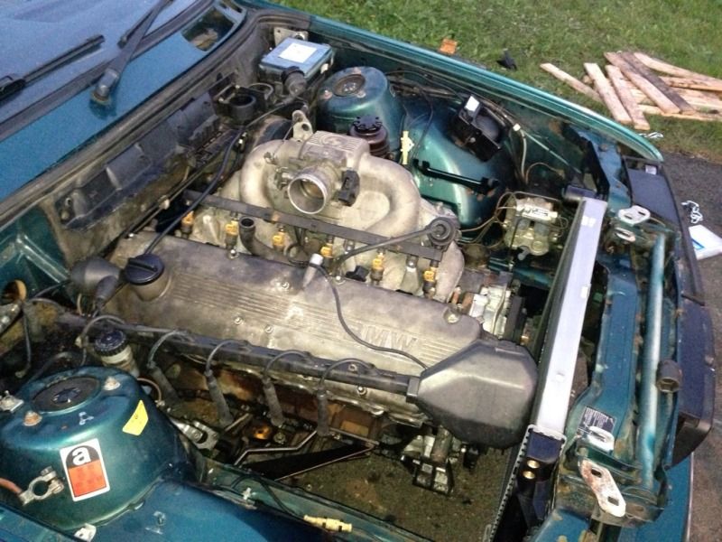

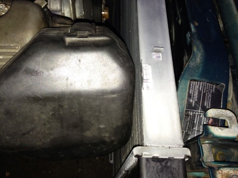

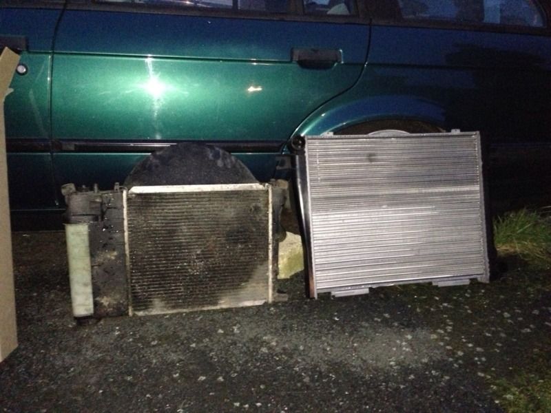

e30 316 rad compared to e28 535 rad, bit of a size difference eh...
fits like a glove though, old rad mounts just needed some 'light' persuasion
had the steering UJ shortened by an inch to fit the e46 clubsport rack, 2.7 turns lock to lock baby!

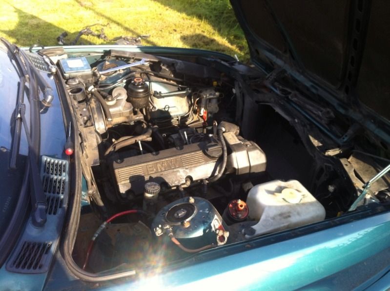

She is alive!!!
The engine roared into life for a few seconds, minus an exhaust manifold and radiator!
So i got on with swapping the diff and fitting the 325 prop this afternoon, tomorow i will be modding the manifold and making the exhaust :)
