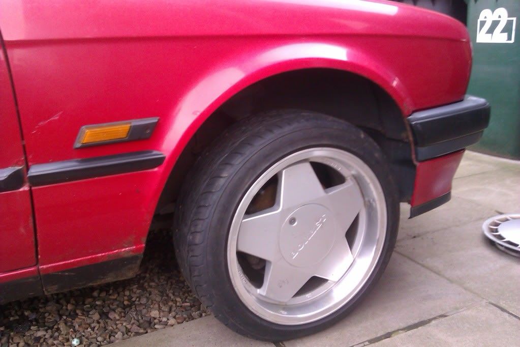

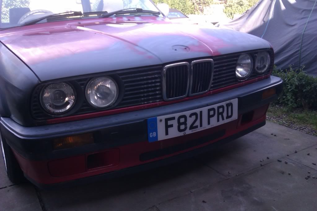

this is the car on its new set of shoes. a set of 15" borbet A's. 9" at the rear and 7.5" at the front
Front of vehicle

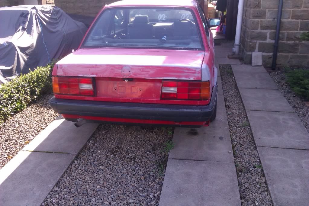

Rear

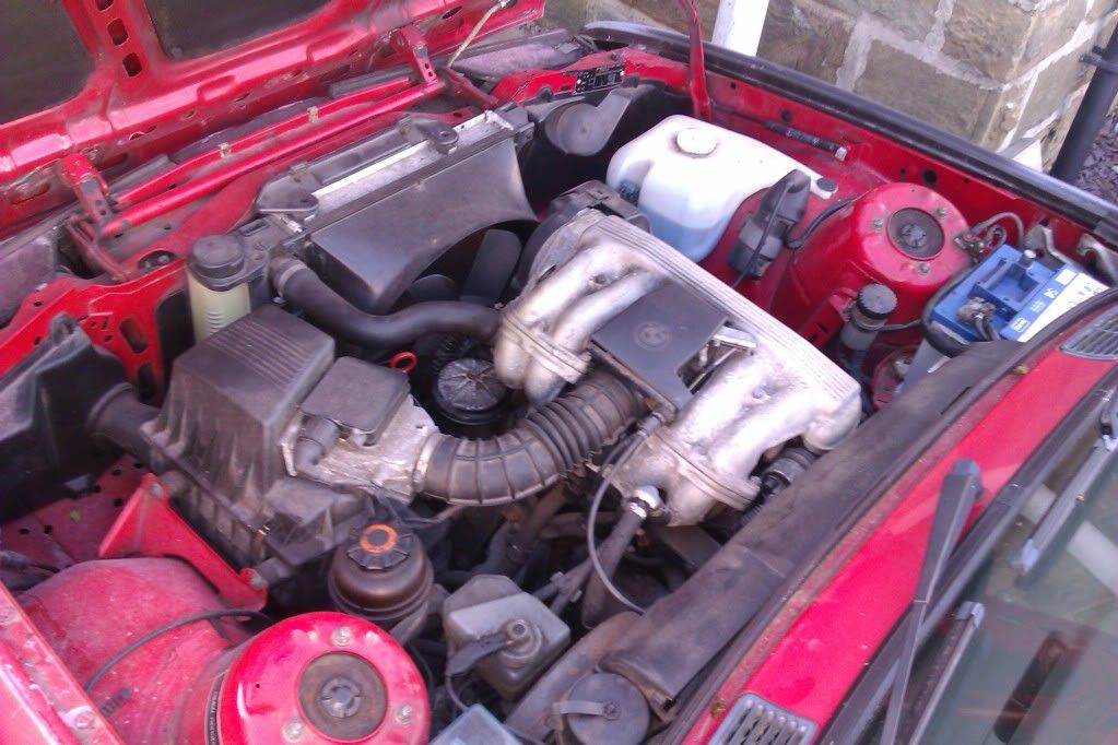

Engine

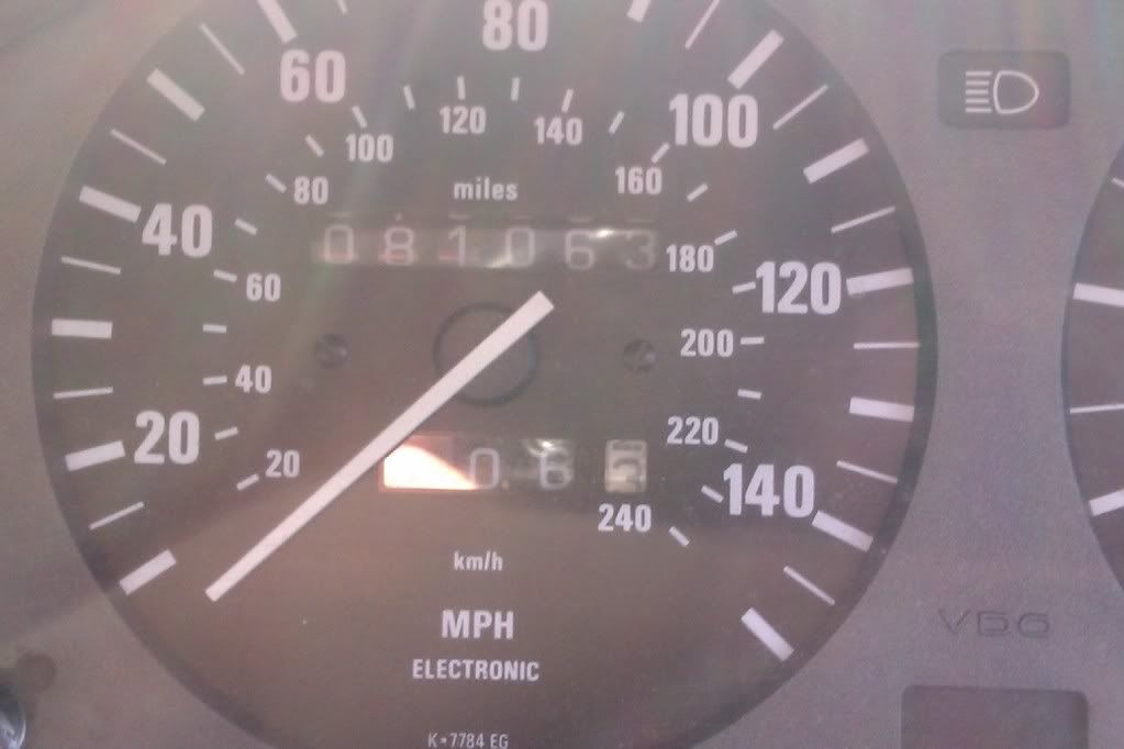

What I consider low mileage

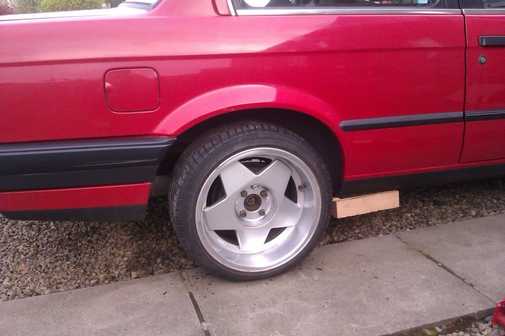

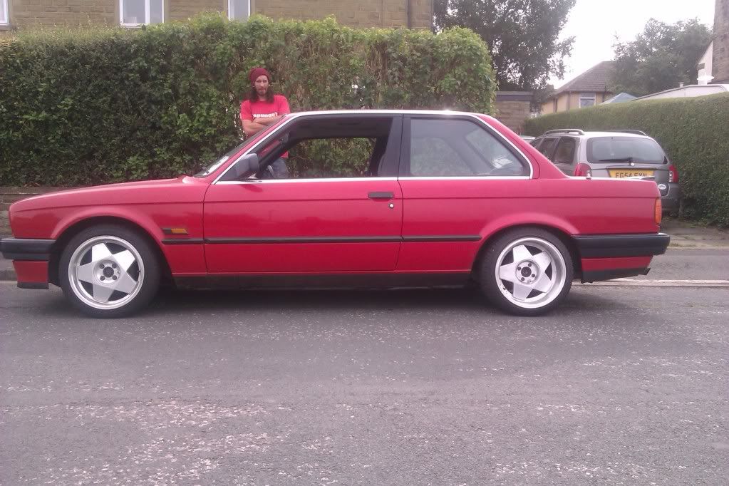

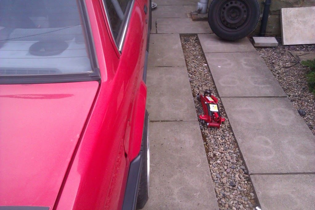

Next job was to get the arch gap smaller so a set of lowering springs that i got for my birthday was put on mad the car in my opinion look a lot coler than it already is.
40mm at the rear and 60 at the front. didn't want to go stupid low because it makes cars, again my opinion un-drivable. This is a perfect hight for me.
slight rubbing from the rear arches on the tire, nothing a old broom handle to roll the arches cant fix!
a few proplem have started to arise, the shacks both front and rear have past the due causing the car to bounce arond on the road, once i have some funds a new set will be bought.

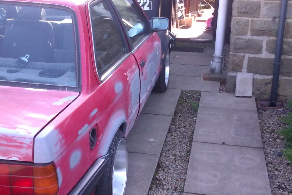

next step is to tackle the dents and scratches that littler the car. my mate has a knowledge for body work, i on the other hand have no patience for it what so ever.
once sanded down and filled there put in to primer ready for paint.

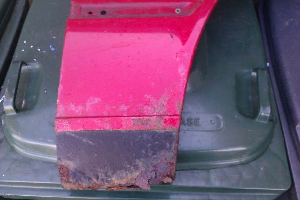

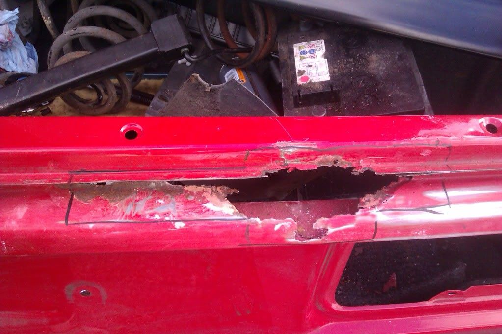

going over the car i found that both front wings are rotten the drivers side not even attached at the sill and i give the passenger side about 2 hours before it does the same.
drivers
passenger

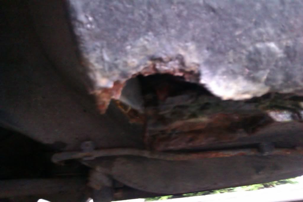

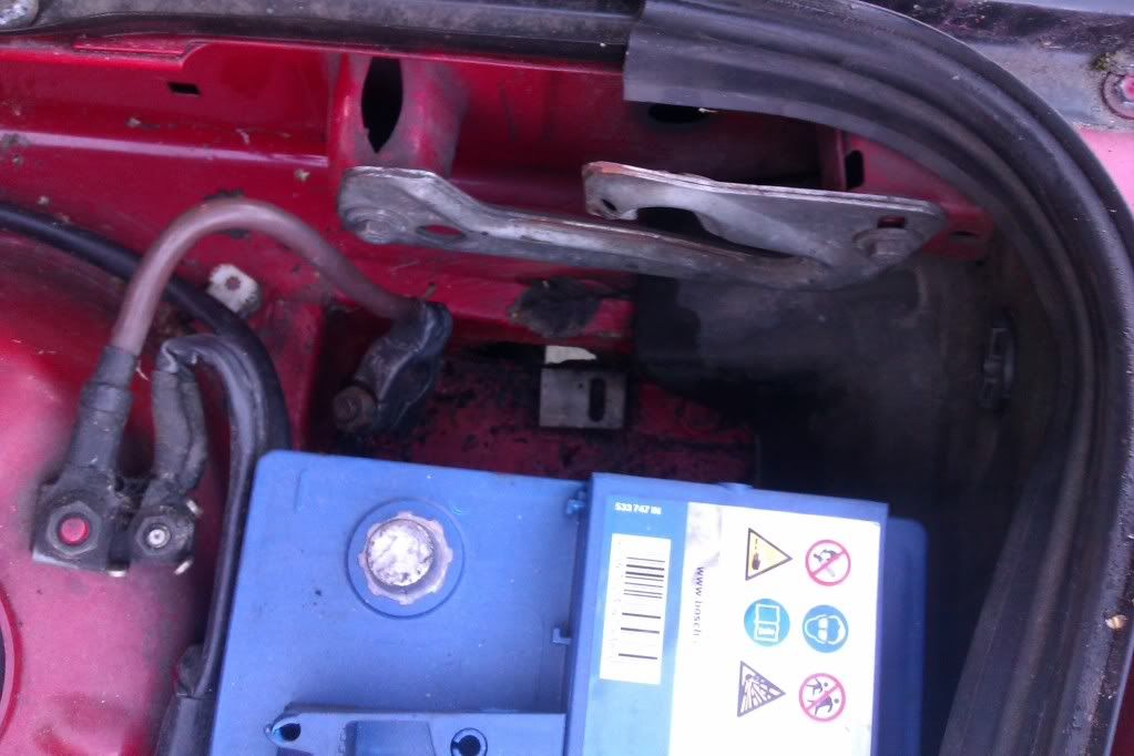

also wandering around i found a dirty hole in the drivers inner wing where the battery sits
(Bad photo, will get better one when the steels go back on)

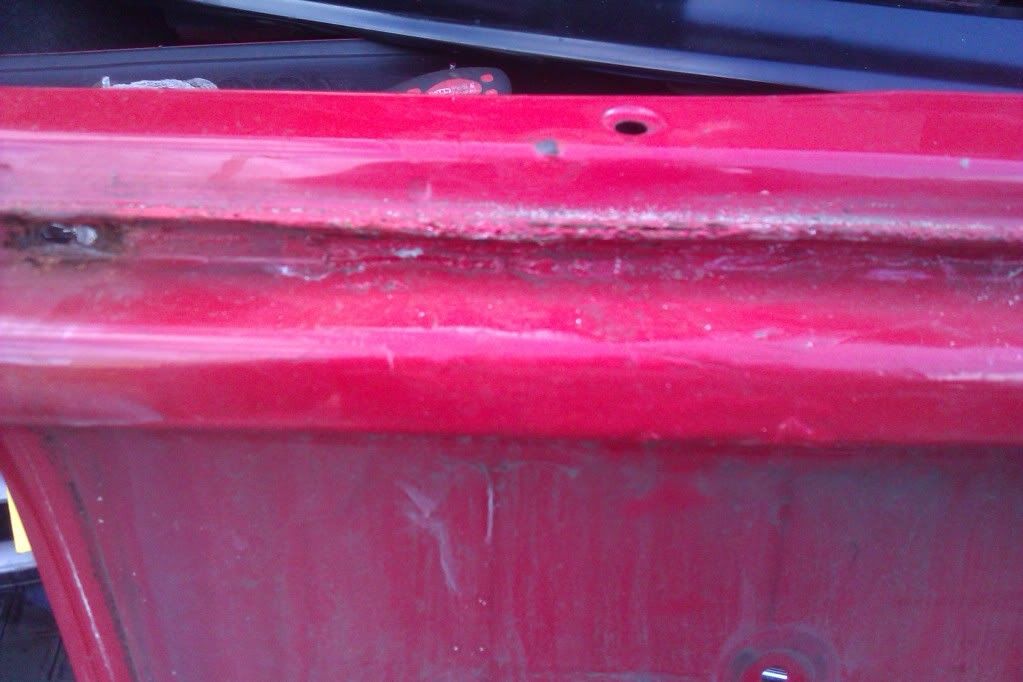

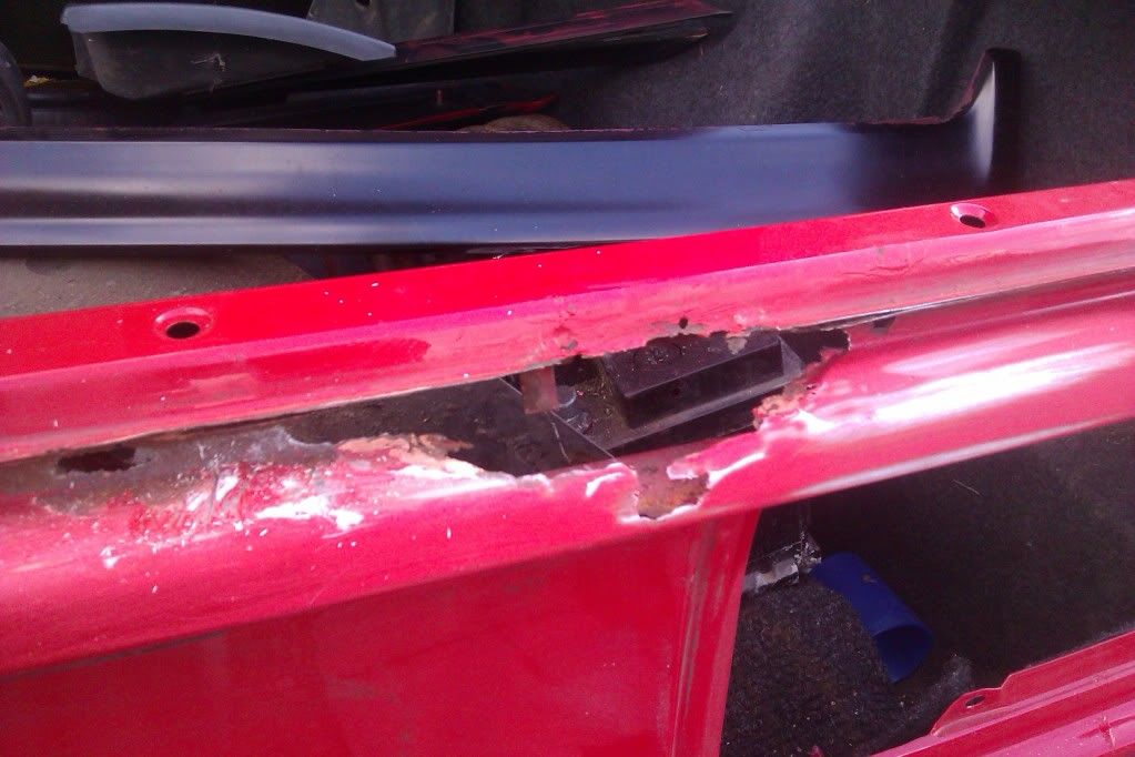

also on the boot shut there are 2 patches where some one has badly mended them.
they mended it with mesh and filler :(
