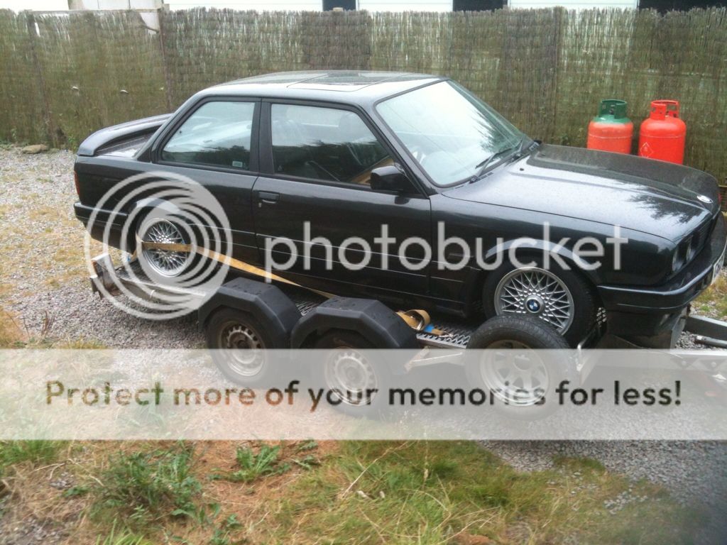

Got back with it last night, was way to late t get it off the trailer so Kedge was up first thing with a poking stick to help find rust and to have a nosey.
Was fun getting it on the trailer too, wouldnt start and no tow eye so have to get it on using the starter... But it was slightly low :cry: not sure how as I was in the car but my dad and luke got the trailer to the right angle and we got it on.

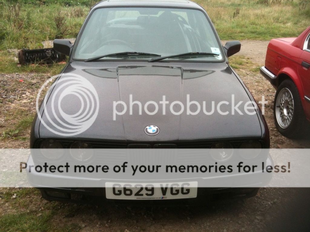

Front

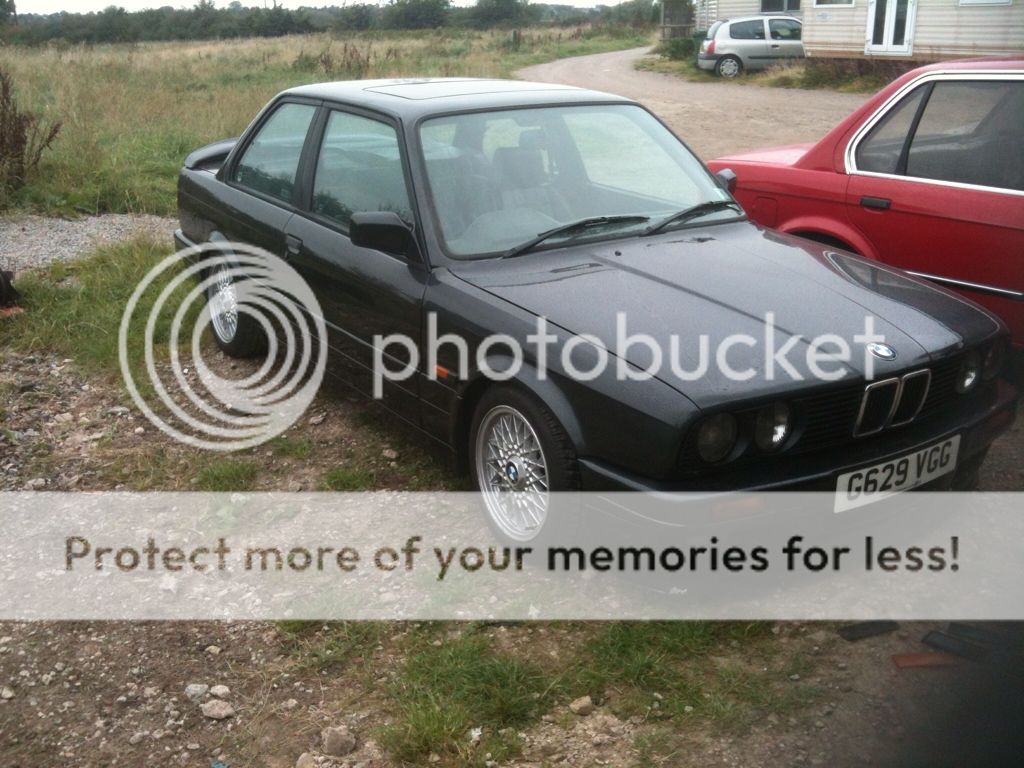

Switched some bits

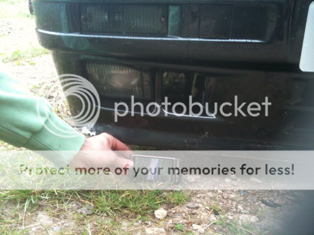

Didnt have any L&B's so Kedge's phone would have to do

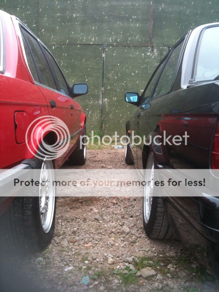

Next to a standard height chromie

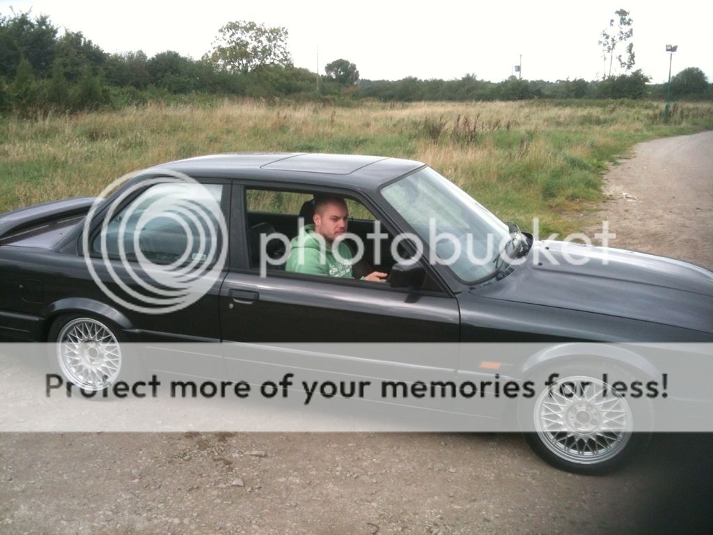

Kedge taking it for some diffing... Couldnt get it off the drive though as the sump is slightly low :cry: So he managed to diff it on the gravel :mad:
I havent had a go in it yet but will do tomorrow
