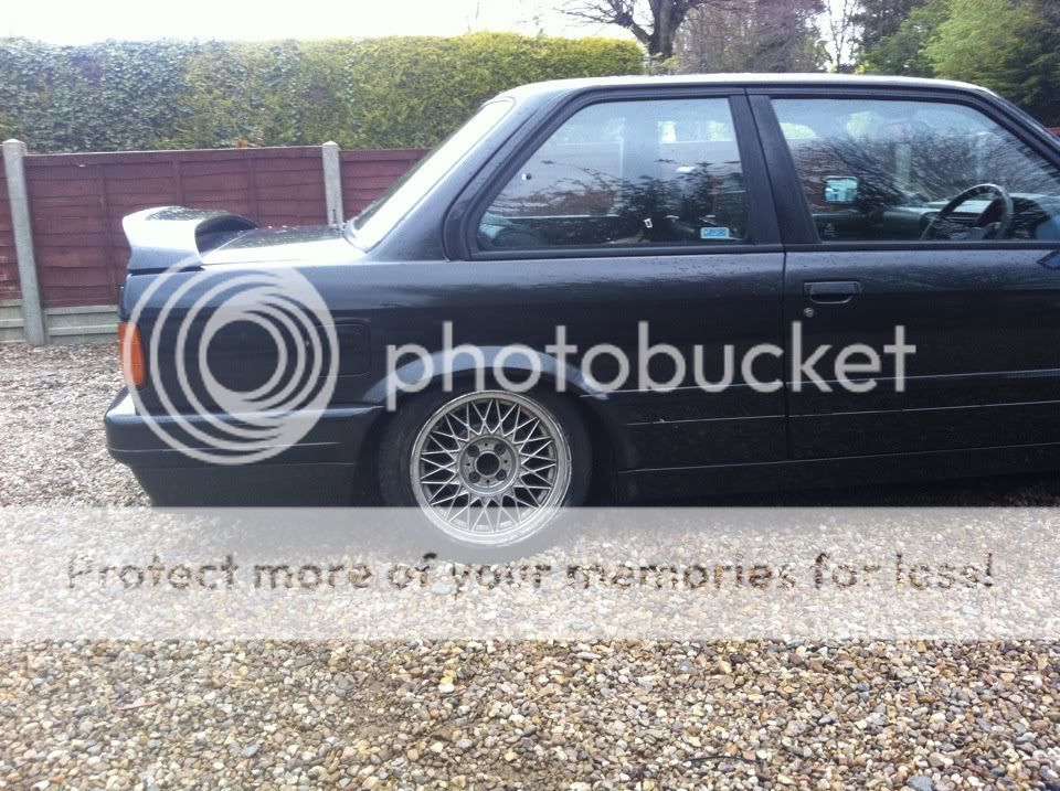

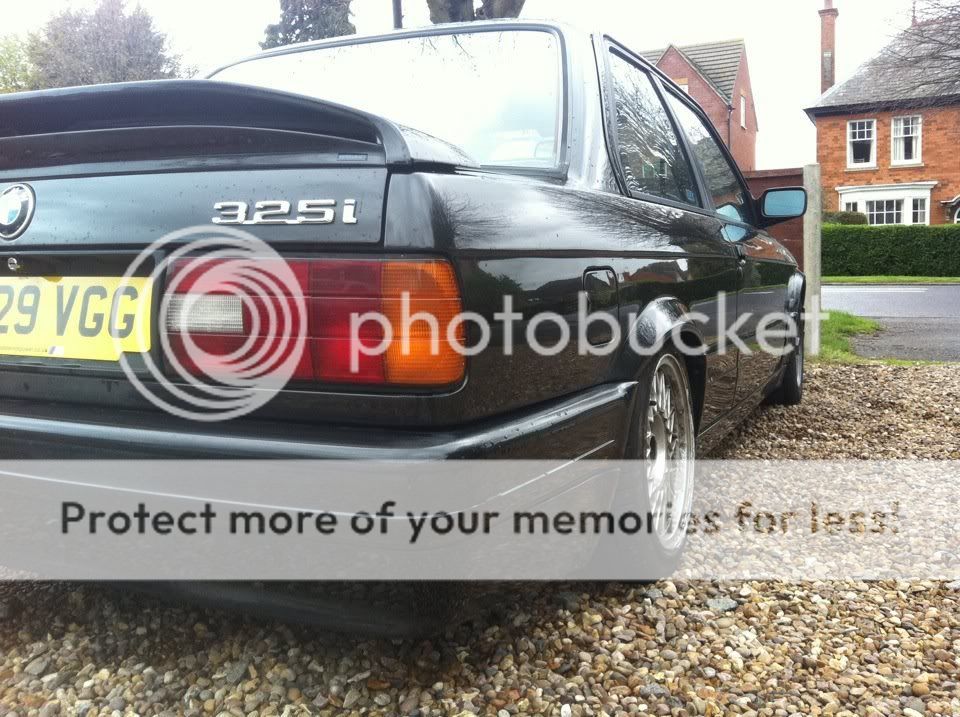

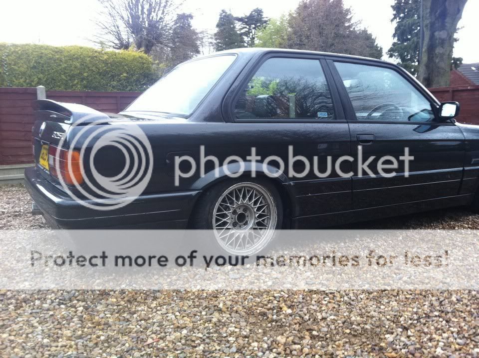

other than this i have got a pair of tyres on my original sport alloys and put them on the rear for now which will please some of you. i forgot how tucked in the arches they sat though compared to the 14s. i am going to be getting them refurbished soon with body colour coded spokes and polished rims.
i have just bought some smoked smilies from rav too so they will be going on, de-wipered headlights and a black kidney grill will be going on too.
anyway heres a couple of pics i took quickly today of the rear wheels back on

Nice car but those tires are waaaaay to small...
Post Sat Apr 28, 2012 9:42 pm
Tyres should be 205/55R15 and should not rub even with a 60mm drop!

the tyres are 195/50/15 and i put them on because they were free. pair of michelins for free whos going to say no? they are just on there for a while until i refurb the wheels and then i will buy 5 new tyres for them but still going to stay the same size because with 205/55/15 it did used to scrub on drivers side with people in the back. might go 195/55/15 so the diameter is the same still but the width could do with being slightly skinnier for some extra clearance

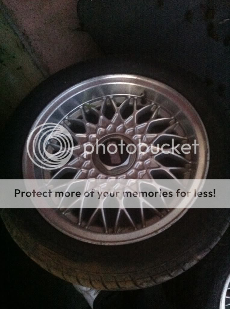

What BBS are they, any pics?

i sold them to Dan320is.

They would of looked nice on your sport. 8)

i put them on and they scrubbed much worse than my sport alloys even though theyre the same size lol.

but yeah with the plans i have to do the spokes body coloured and a polished lip they would have been excellent for that.

Those look to be the Rare Motorsport wheels, i think they were only available in Germany.

Why is everything scrubbing your arches?! Standard bbs 15's with a 205/55 tyre and you should be able to put your car in the floor with no issues! Has it had rear arches repaired in the past?
And why the free stuff? I'm lost as to why you'd fit the wrong tyres whether they were free, cheap or otherwise! Sports are sports, I know you can do what you like but I'd have flogged the 14's for cash and bought new 205/55's for the correct rims :)
Also those 195/50's are going to give you even less clearance with the dreaded cat eyes!
And that looks really, really low for -60mm! Other than that it's nice! And the 2.7 sounds a bargain! Especially leathered up! I'd definitely have kept those wheels though! :cool: 8)

why is it such a problem i have fitted a different tyre size? they look much better than having balloon tyres. and give more arch clearance. im not worried about cats eyes, its not that low. i do wish i kept those other wheels now tbh. and i dont know of any arch repairs being done at any point. but then with a 23 year old car you never know whats gone on behind closed doors do you? :(

FACT! If you car is rubbing with 205/55R15 tyres and E30 fitment 15x7 ET24 BBS wheels there is a problem with your car.
And it doesn't look better with 195/45, it looks ridiculous.
Even 205/50's look shit!

Check your rear beam bushes (suspension)...............
My touring is lowered 60mm, never had rubbing issues, even with a full load.

your springs are just too low hence the scrubbing and smashed sump/engine mounts,
14" BBS on a 60mm drop just won't work properly it must handle really badly with this set up
15" BBS are awesome wheels and very cheap, if you like the lowered look sling some -30-40mm drop H&r springs on there with some 55 profile tyres and you really will transform the car completely,
this has been done to death on this forum I can assure you it will drive/look so much better :D

your car should definitely not scrub with standard wheels and tyres, even -100mm cars don't rub (apart from the diff on the road!) do you know where it's scrubbing? is it on the inside or outside, if it's the arch lip you can get them rolled, but I'd investigate a bit further, it sounds like it may be pointing to another problem which may be the cause of all your woes!

Change ya springs Luke and see what happens.
It does look a tad too low and will be causing all sorts of grief in other areas.
