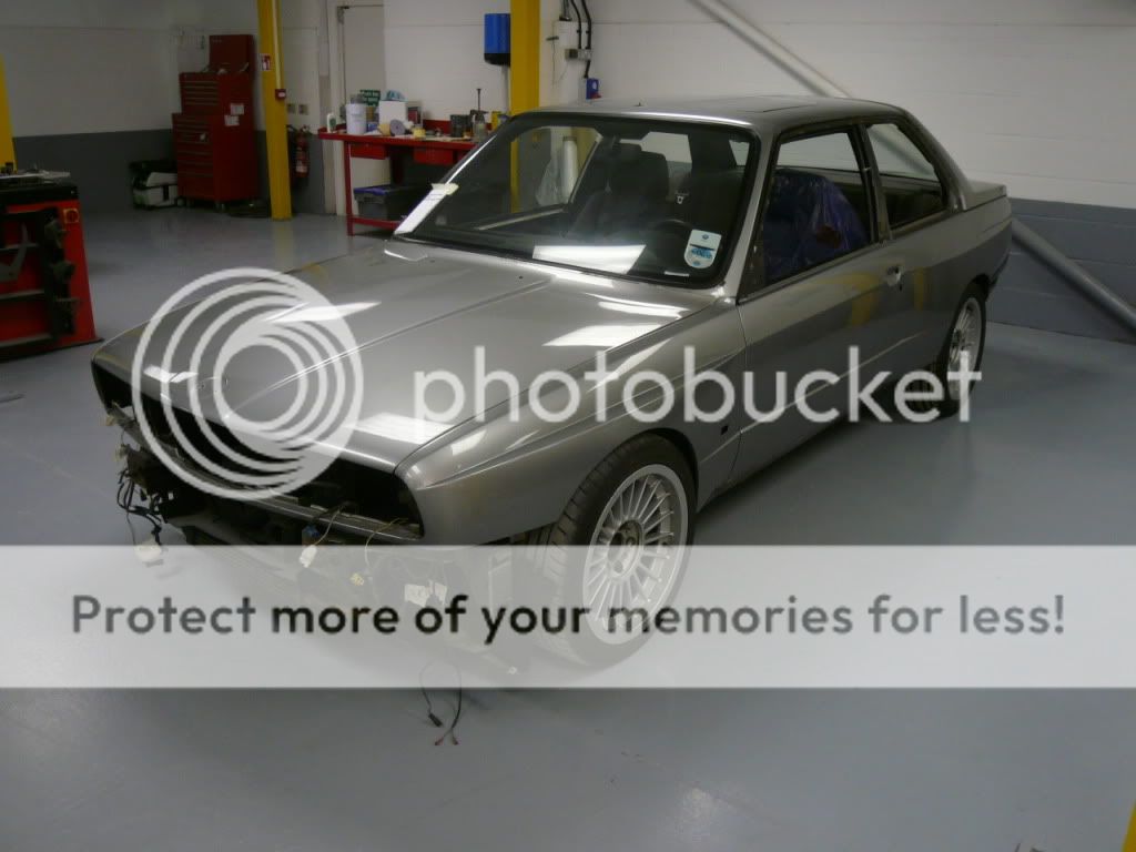

Purchased this about three years ago, in that time it has visited Pacerpete for a rummage and to sort out its rusty underside and other issues.
It was always obvious that a full respray would be required as there were a number of bits that needed attention before matters became too serious. RUST

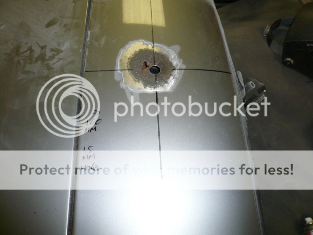

So over to SPR in East Sussex for the bare metal treatment.

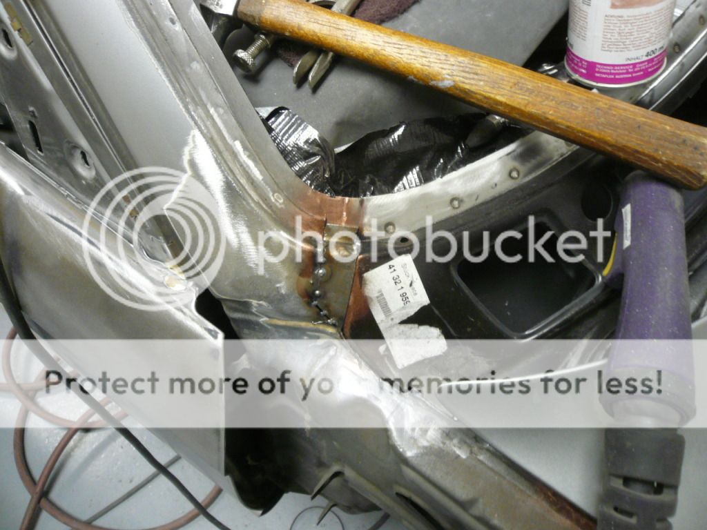

The scuttle had a large rust blister in the corner so it was decided a new panel was required.
Glad that the old one came out as this revealed rust below - fixed.

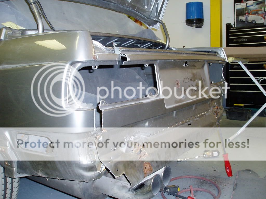

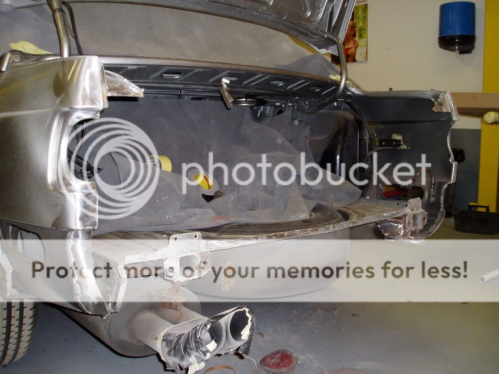

Rear boot panel also needed replacing.
Then the shocker, the rear quarter had a previous repair, which was not properly rust protected. Such a large bodge.
The drivers door was found to be a replacement as it is black behind the door card, so the car must at some stage had a whack to the driver's side. So it was decided a new rear quarter was to be fitted. These are not as expensive from BMW as I expected.

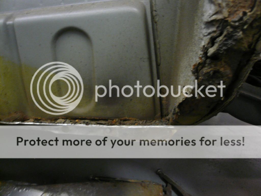

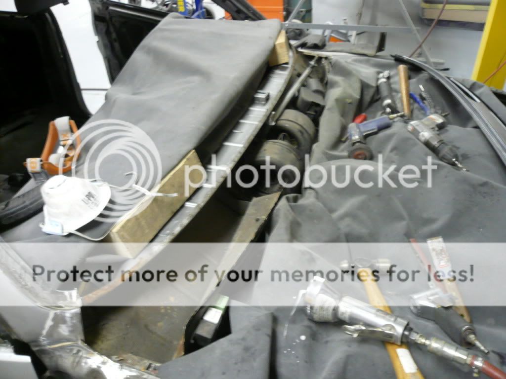

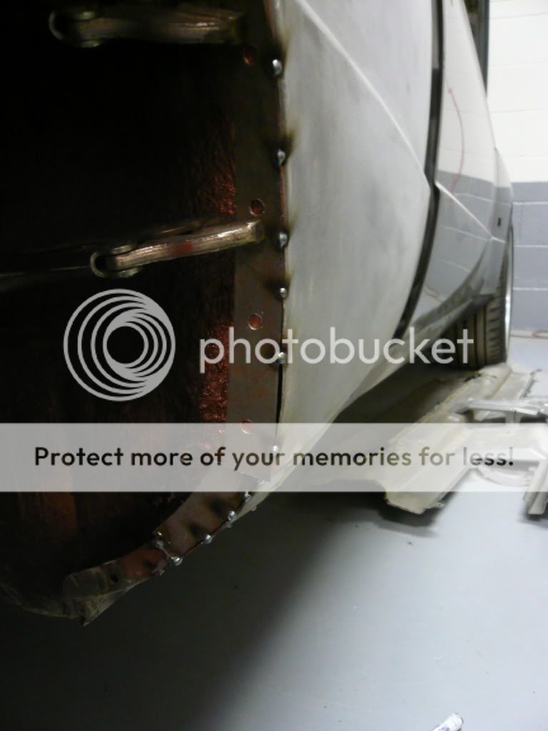

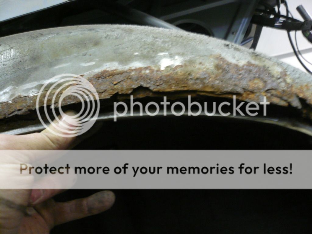

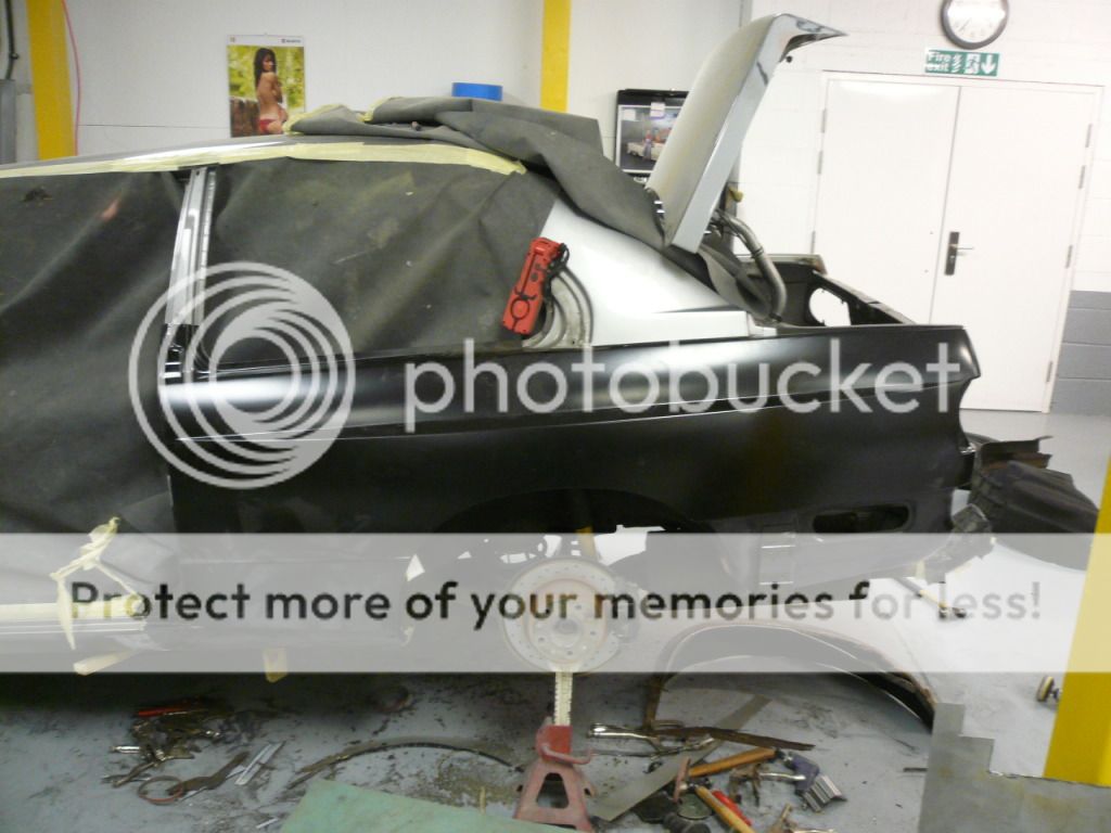

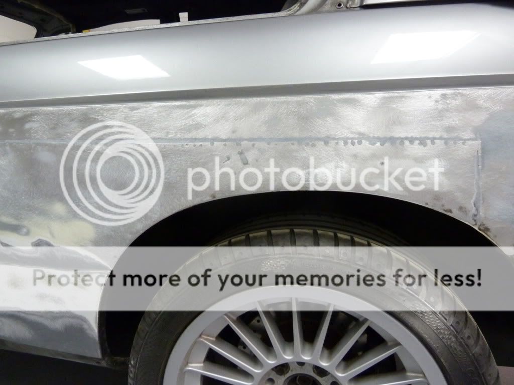

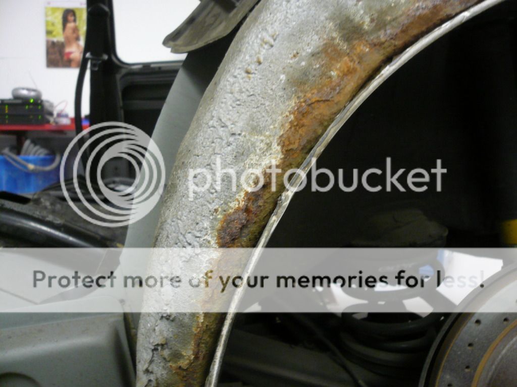

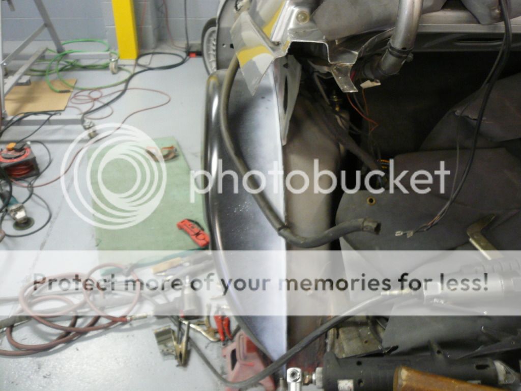

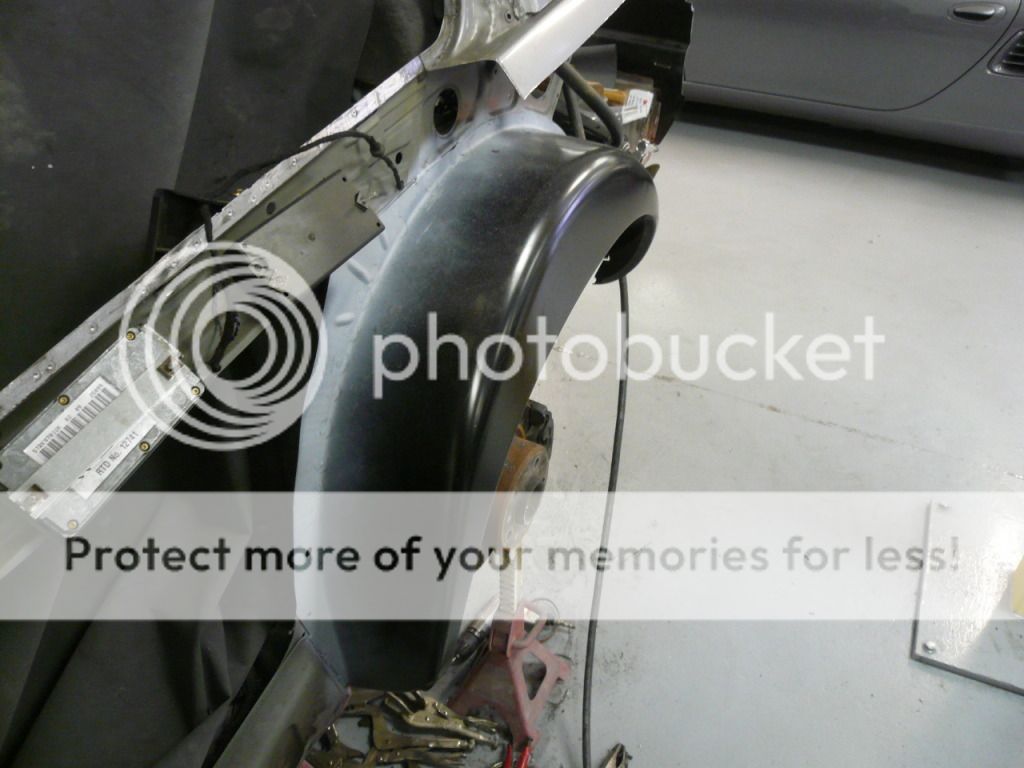

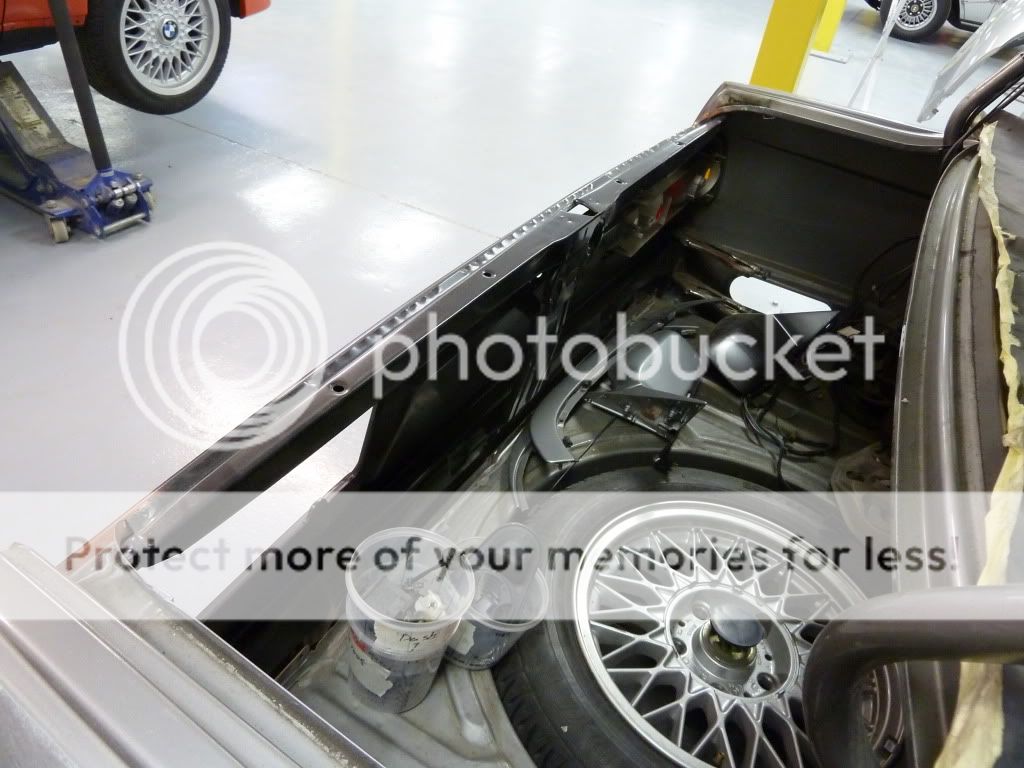

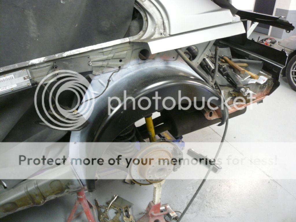

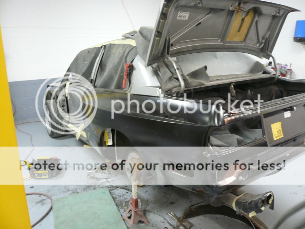

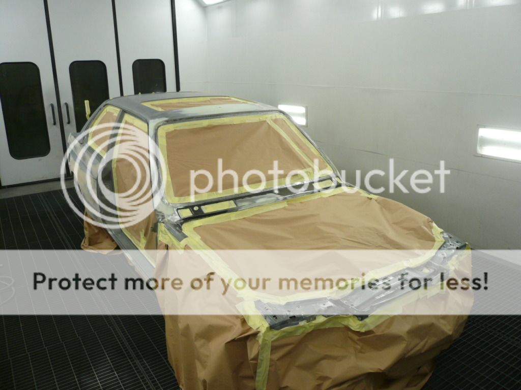

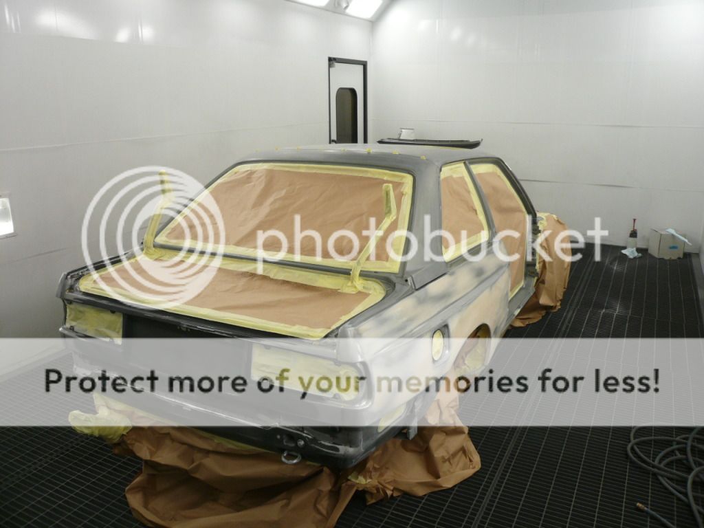

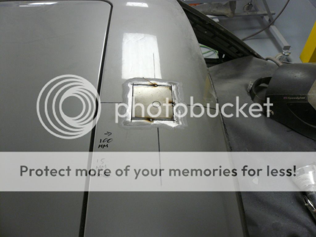

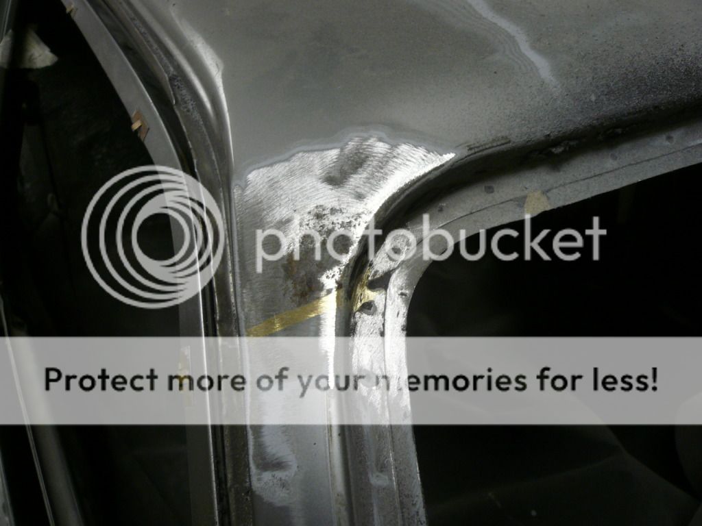

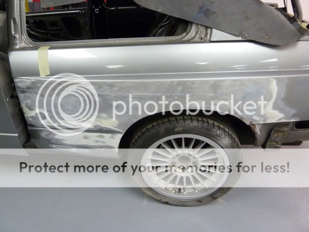

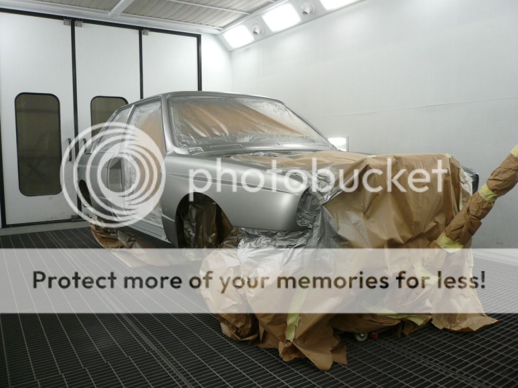

So, time for a long awaited update. Lots of progress has been made, but first some more rust to ponder..
Rear quarter removed due to an earlier repair which was never undersealed and therefore rust could return.
Inner arches ,pretty bad.

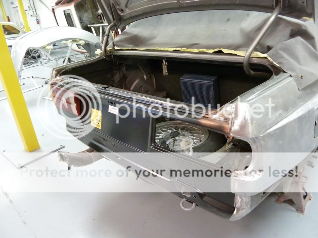

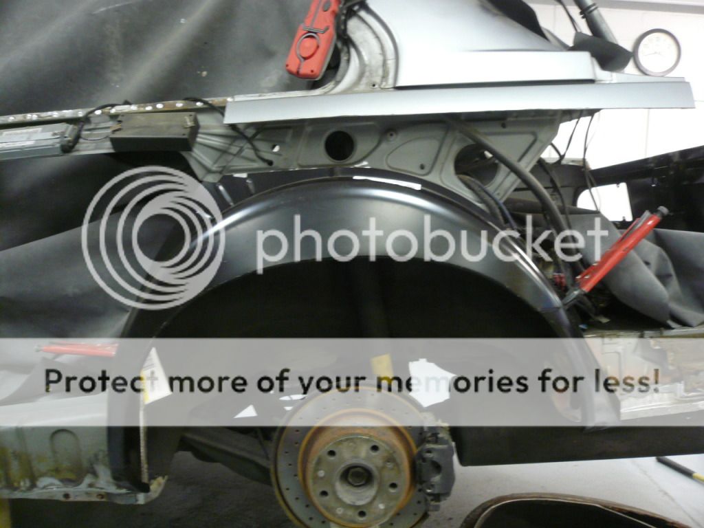

New rear quarter:

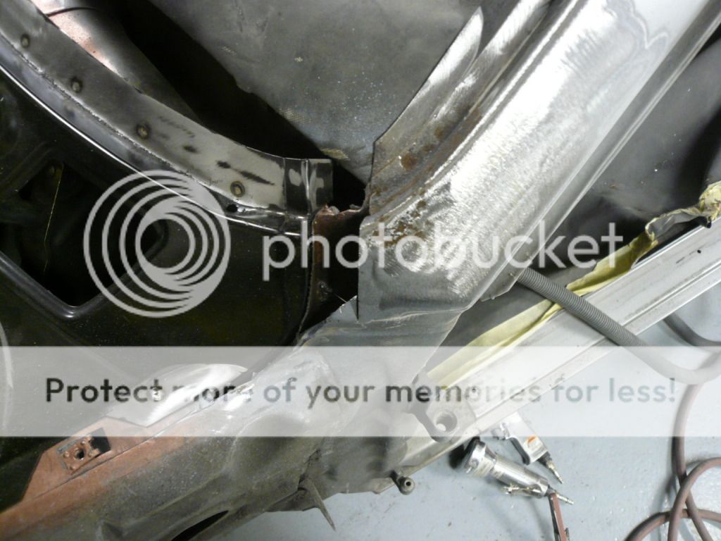

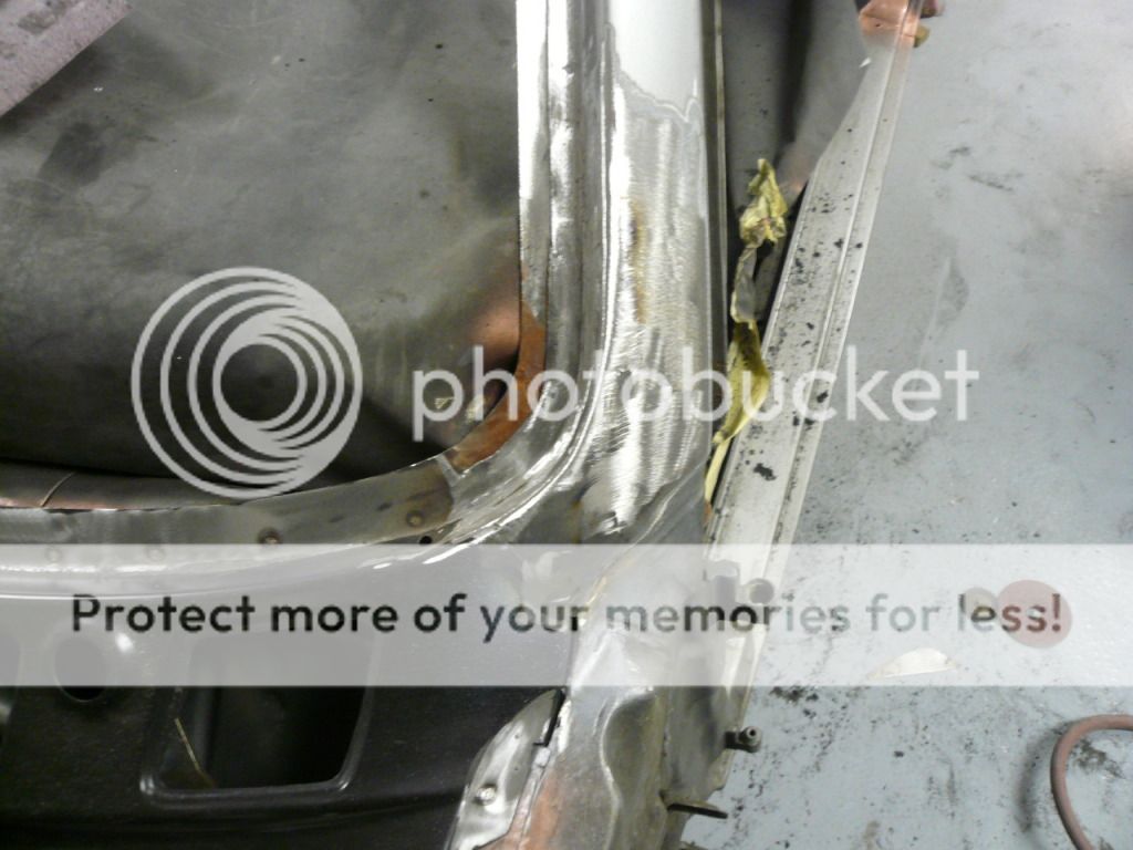

More rusty bits, never ceases to amaze me how much these cars can hide the brown bits.

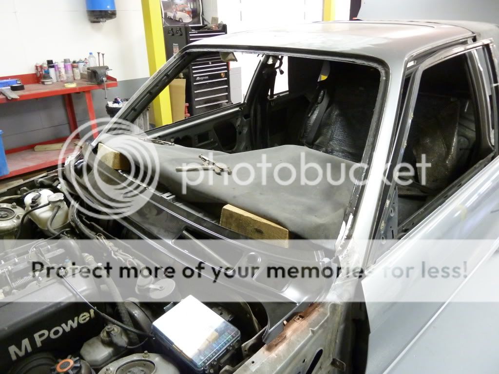

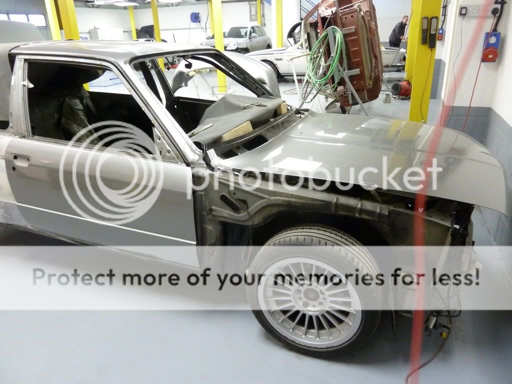

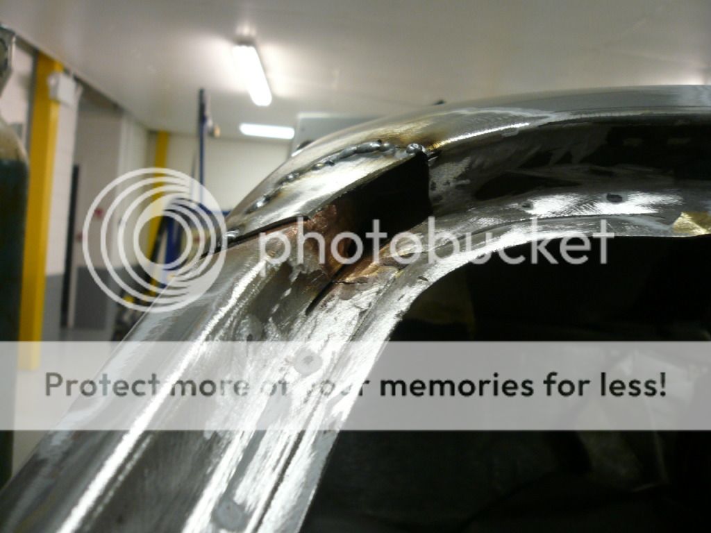

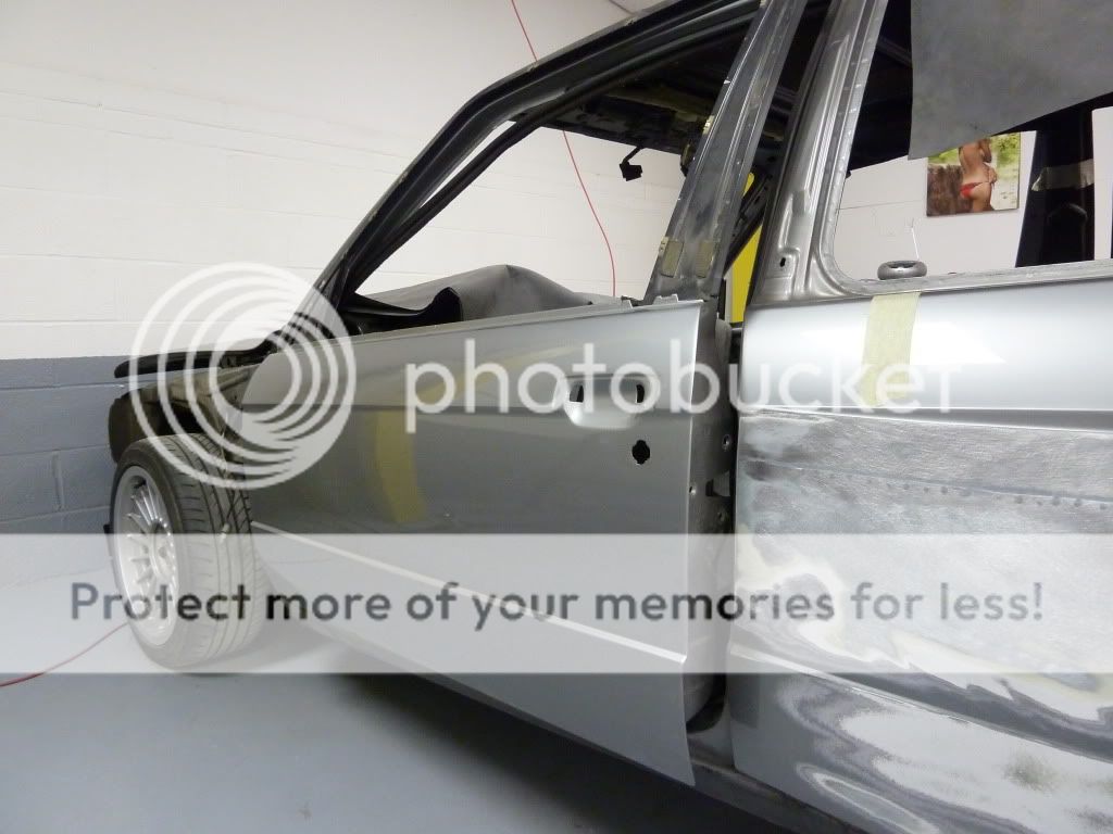

A bit of work to blend in the new scuttle..

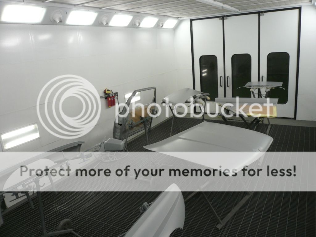

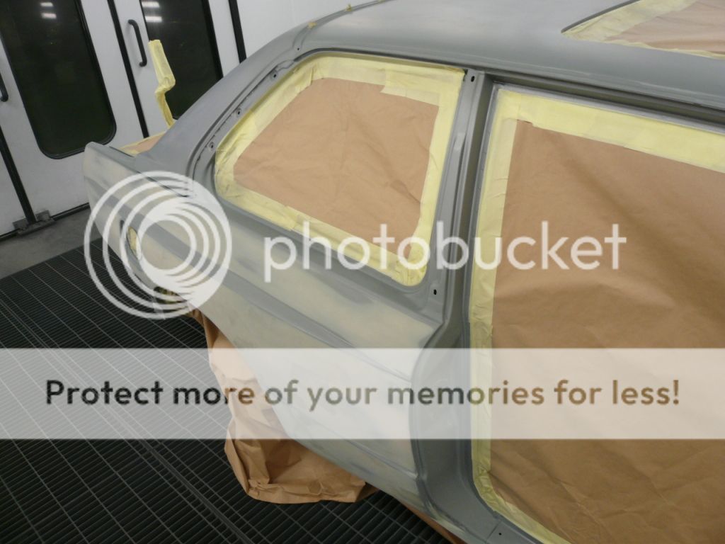

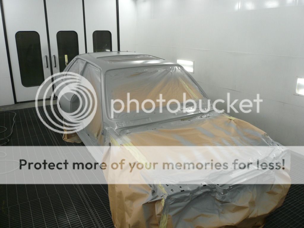

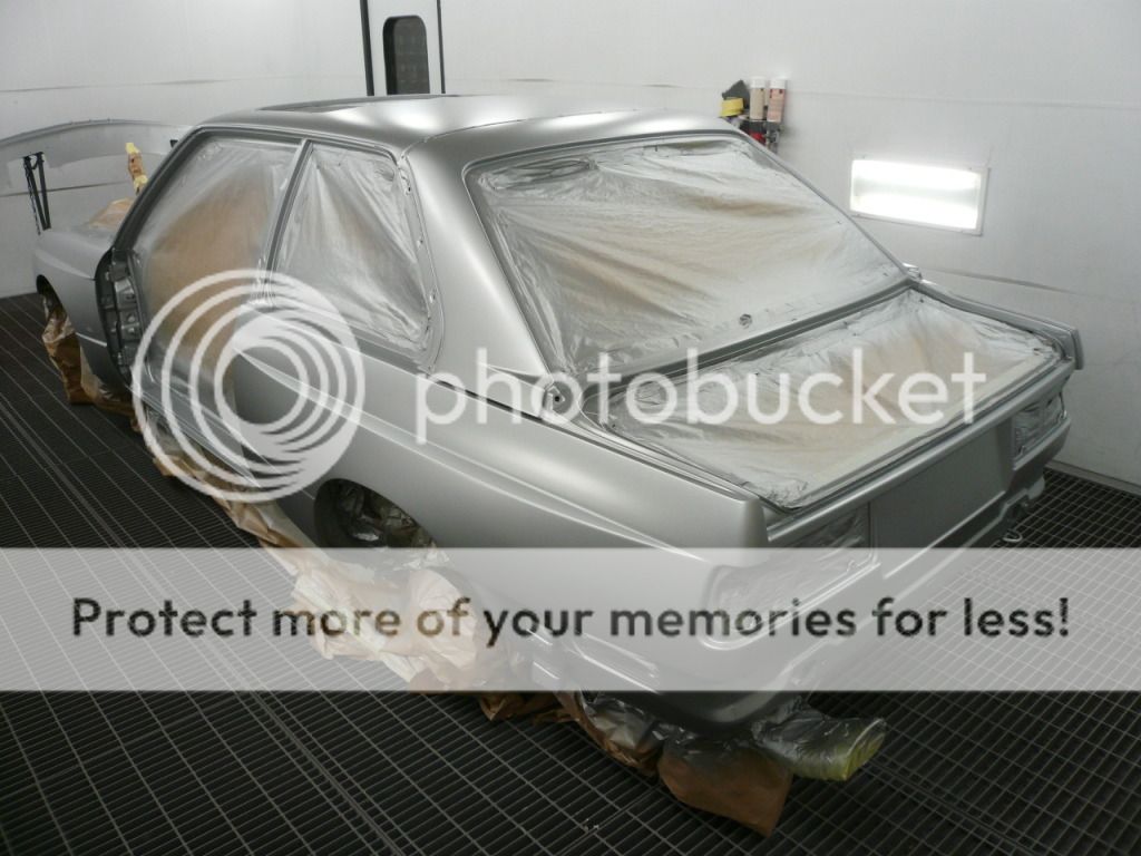

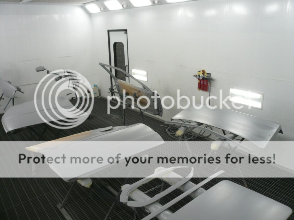

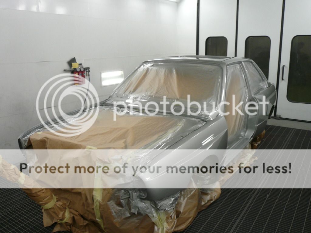

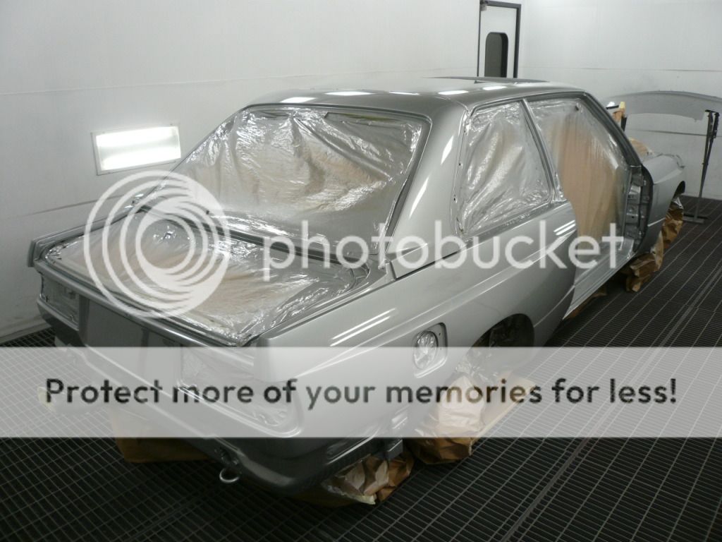

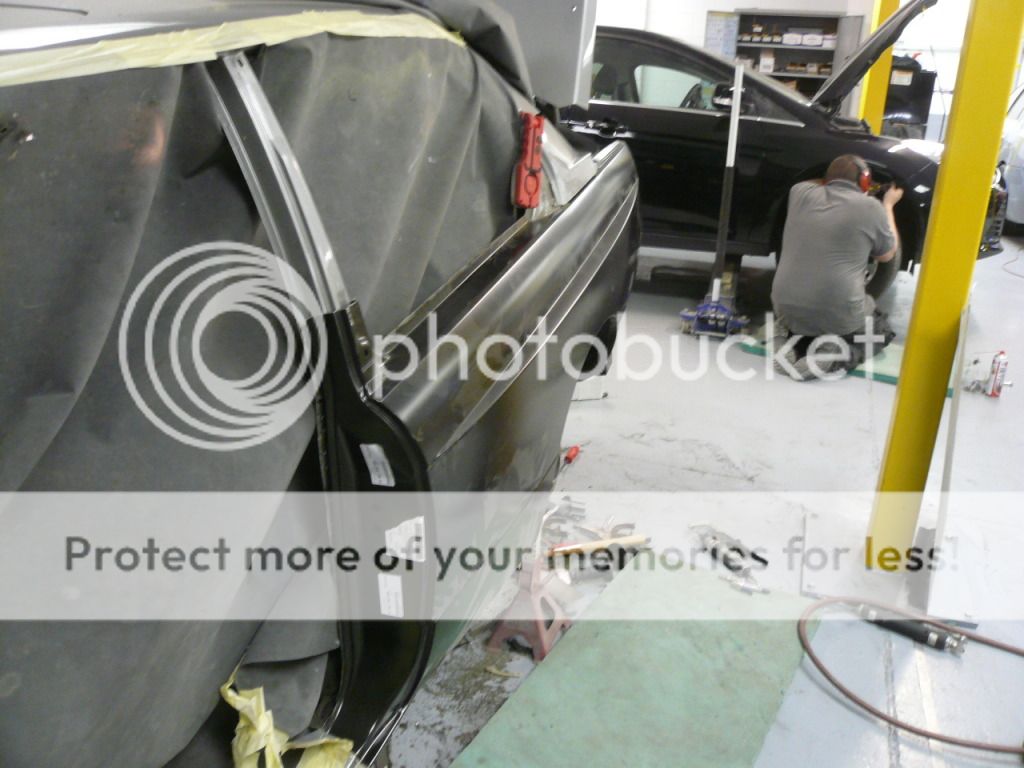

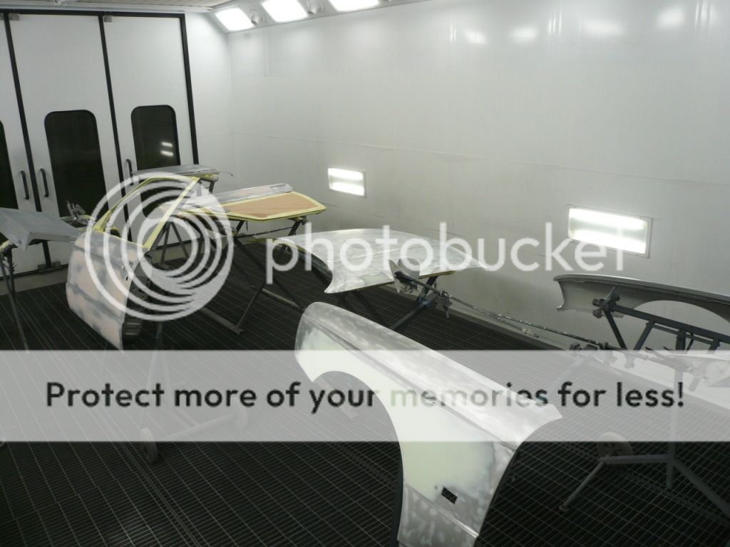

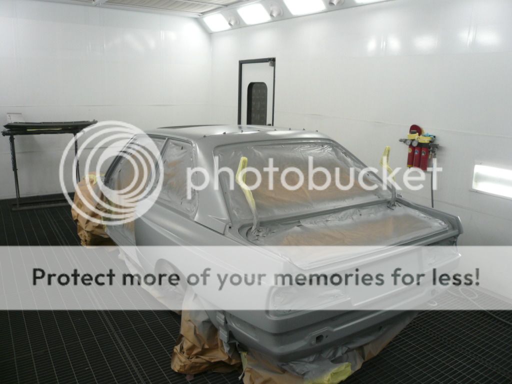

Next onto the spray booth.
pony2
Posts: 805
Sat Apr 07, 2012 1:20 pm
Pictures speak for themselves.

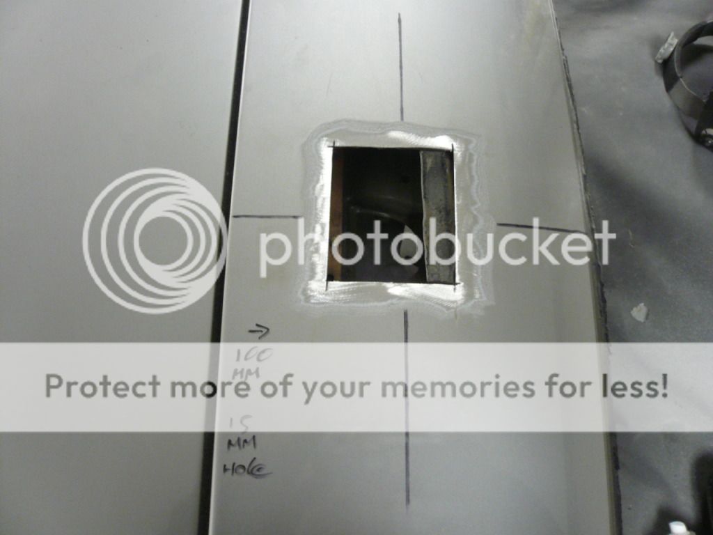

Out of interest, the scuttle looks to have been stamped properly, and in the proper place, have BMW now sorted this problem out?

They were stamping them in the bottom of the scuttle, and the stamping was rubbish too, never straight etc.
I think I had 3 different ones, but they were all coming in the same, and I know I wasn't the only one having problems.
Yours certainly looks ok, but not quite clear, you happy with it? Look original?

I don't think the scuttle has the Vin stamped :eek:
Edit: Yes it is, let me get you a photo Simon...
pony2
Posts: 805
Sat Apr 07, 2012 5:23 pm
On second thoughts I don't think it is a good idea to post a picture.
It is low on the scuttle, hence why I didn't notice it and a little wonky as Simon described, but I'm happy with it.
