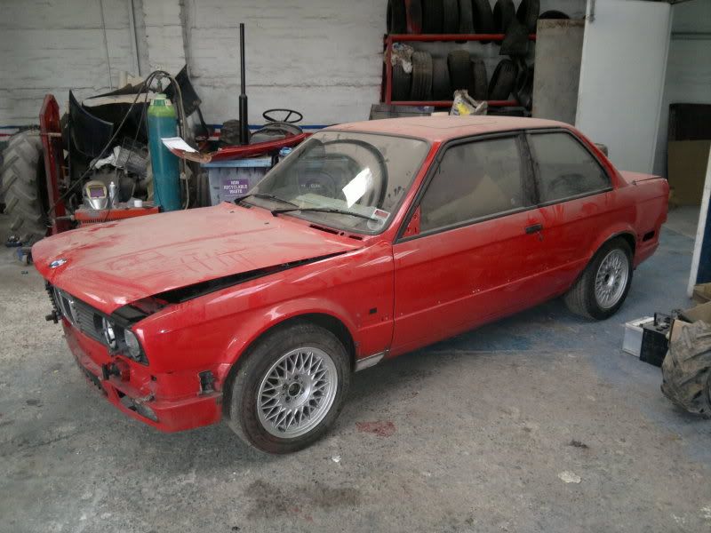

few pics of my car, its getting a overhaul at the moment so i'll get some more up with all ive done to it so far
every tax disc and mot,with bill of sale!!!

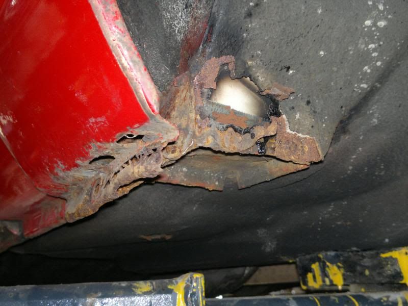

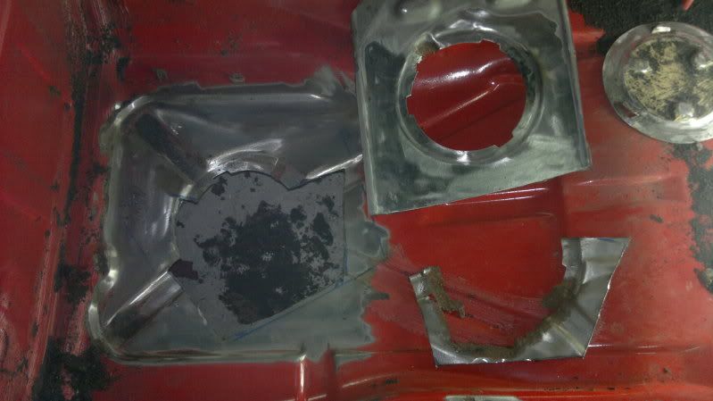

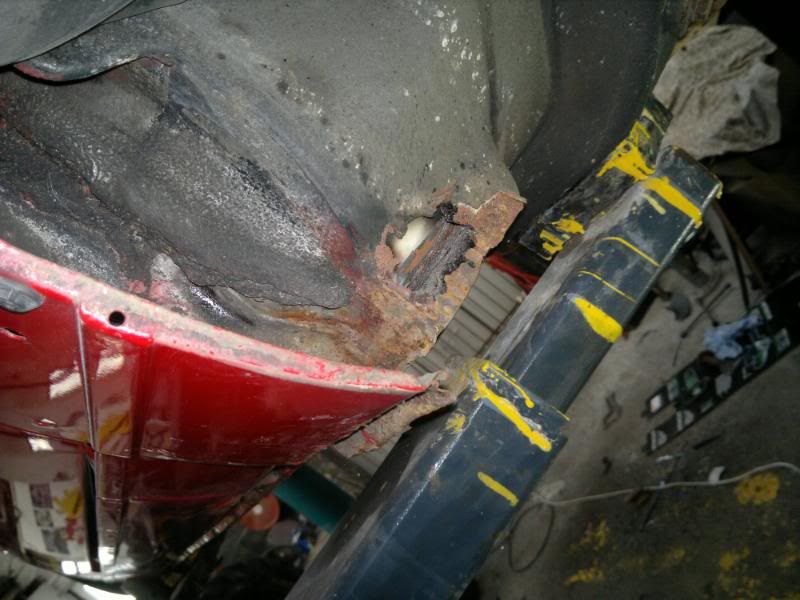

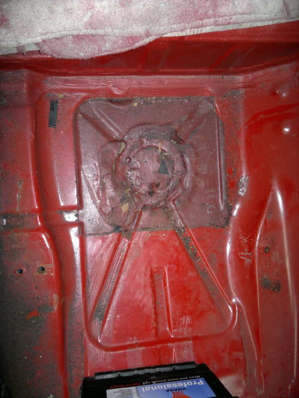

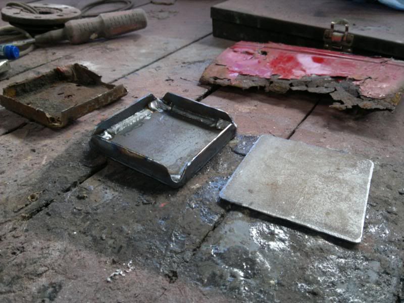

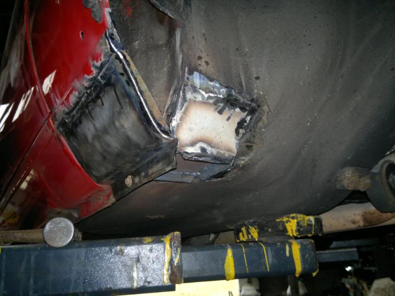

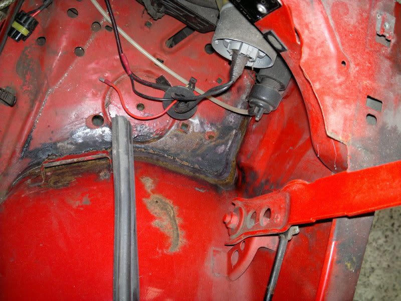

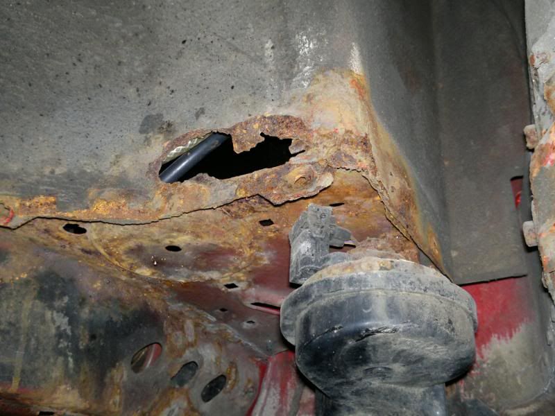

battery area repaired

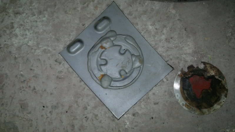

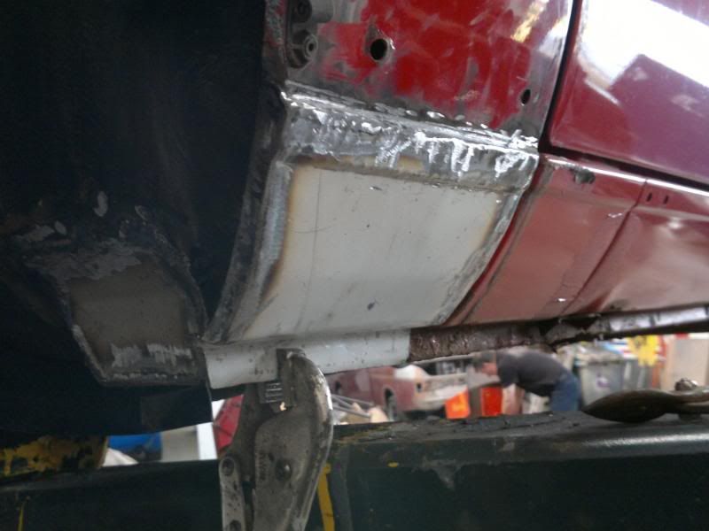

making jacking points

Better just to repair the front corners without replacing the jacking points as its them that cause the issue .
Nice work keep the pictures coming.

Nice work but should have got a new battery tray from the dealers would have been much easier :D

na it will be less noticable than replacing a whole panel

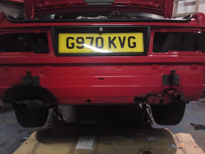

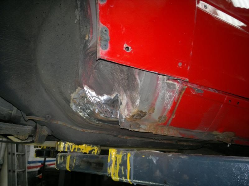

had to put a new lip on the passenger rear arch
thats it in its current state now, put in a new rear inner arch aswell but cant find pics at the mo, just need to sort out filler and prep work

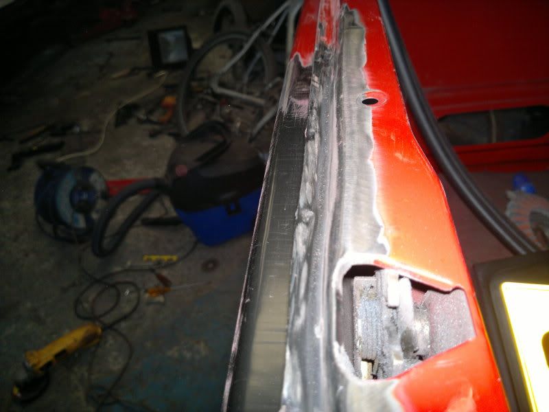

some nice metal work there
was that a full back panel you cut down or can you just get the lower half?

yep had to buy a full back panel just for that lower section....its just a heck of alot easier and neater than making one, had to fab in a section for the number plate lights too, didnt change the panel cause i want it to look as origional as possible (body wise anyway)

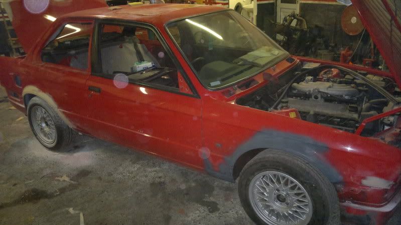

Post Sat Feb 04, 2012 8:57 pm

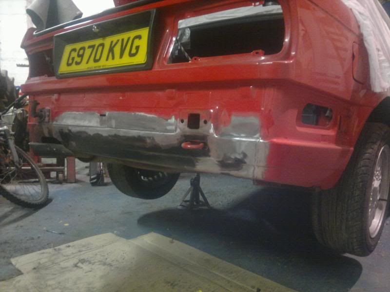

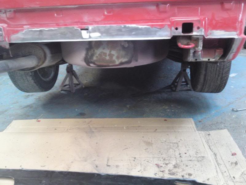

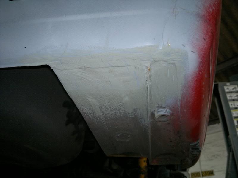

plodding away with the bm ever so slowly

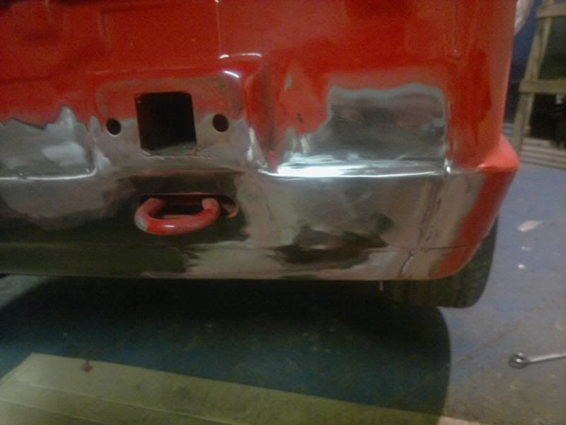

got all the filler work done, had to filler the rear arches as i distorted them doing the inners...origional outers anyway
scuttle is solid
arches got a good few coats around the edges
welded a section in for the rear number plate lights...its actually joint along that edge.. i dont mean the lip!

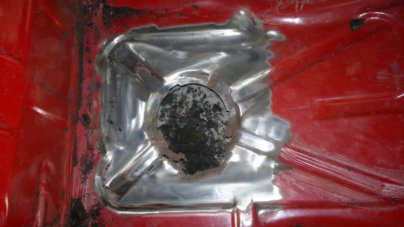

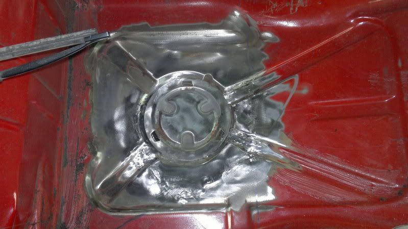

floor needed doing although it looked ok
my mate had a e34 so i nabbed this off it

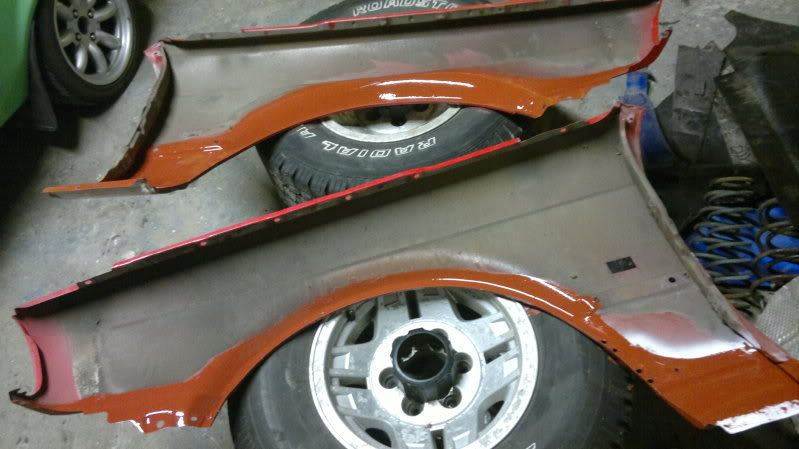

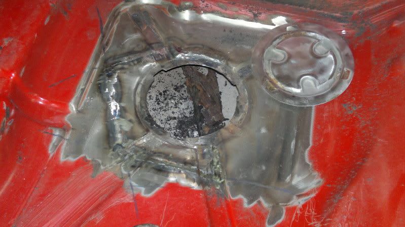

flat surround on these ones so i had to get the hammers out
cut out the bad bit
then got this
so next hit is to clear out the car and paint inside the floor and the boot for starters...getting there

Post Sat Feb 04, 2012 10:13 pm
That racing Puma looks sick!!! Is it RWD with the Yamaha engine?

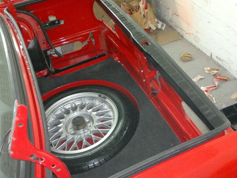

Post Sun Jun 17, 2012 3:09 pm
the rs2000 is a 340 horse cosworth my brother built from a rot box

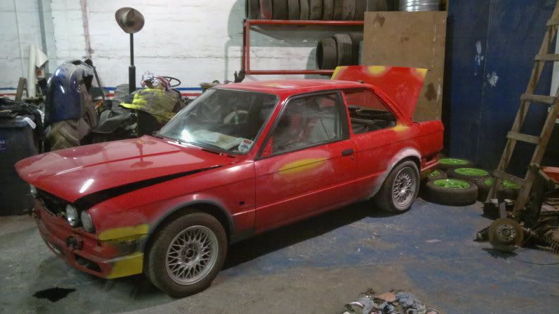

got a bit quieter so started again last week...

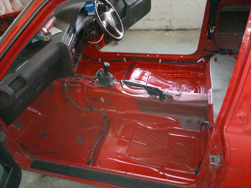

prep'd boot and inside so ended up with this once i painted it
put back what belongs there
and inside
started wet n drying outside so hopefully have it undercoated and painted soon!!
