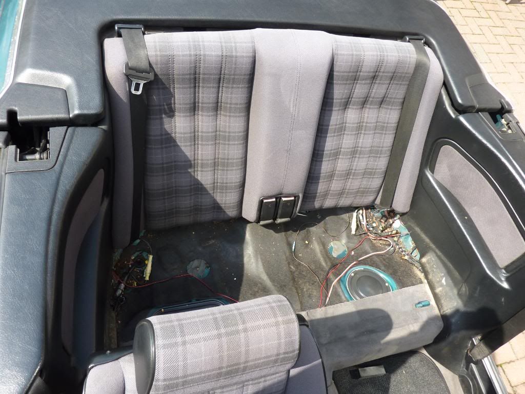

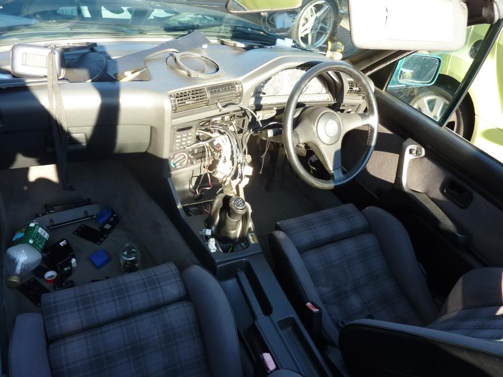

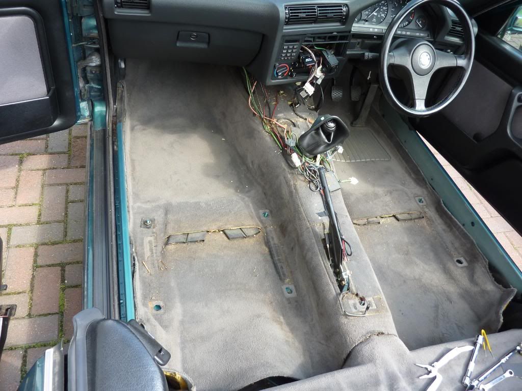

So started off with lifting the rear seat up and took both front seats out pretty straight forward and the side kick panels (A real pain with the clips):

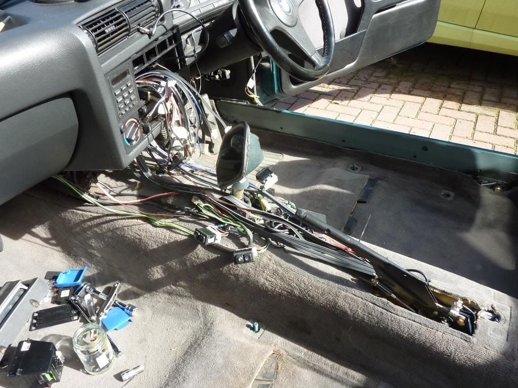

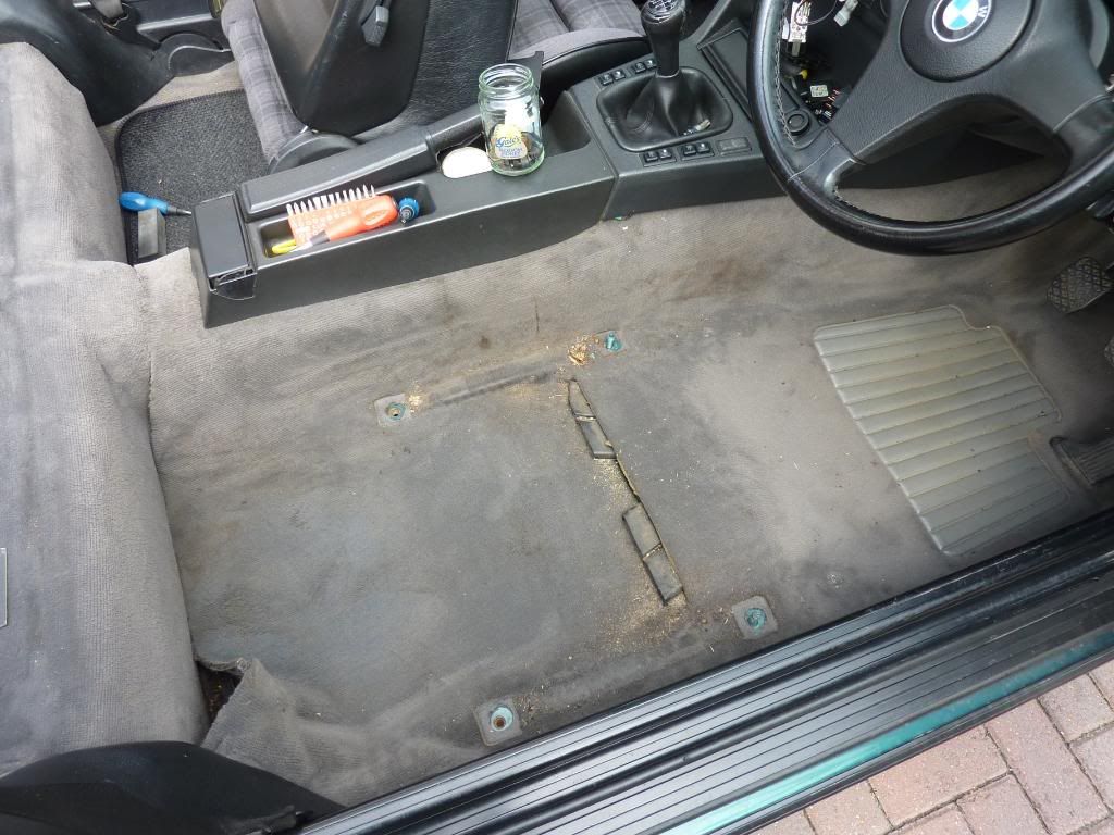

Ripped the centre console out! Gave it all a hoover as well while it was all out.

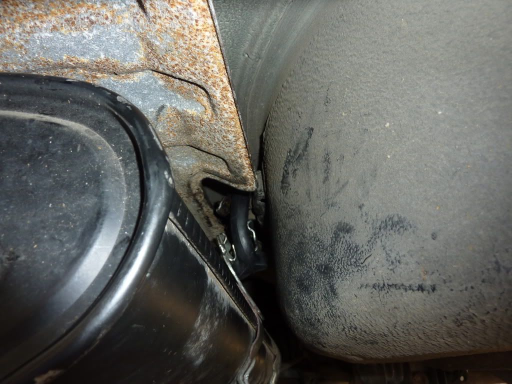

Found some more rust!

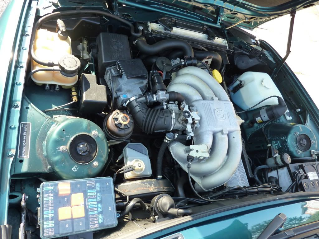

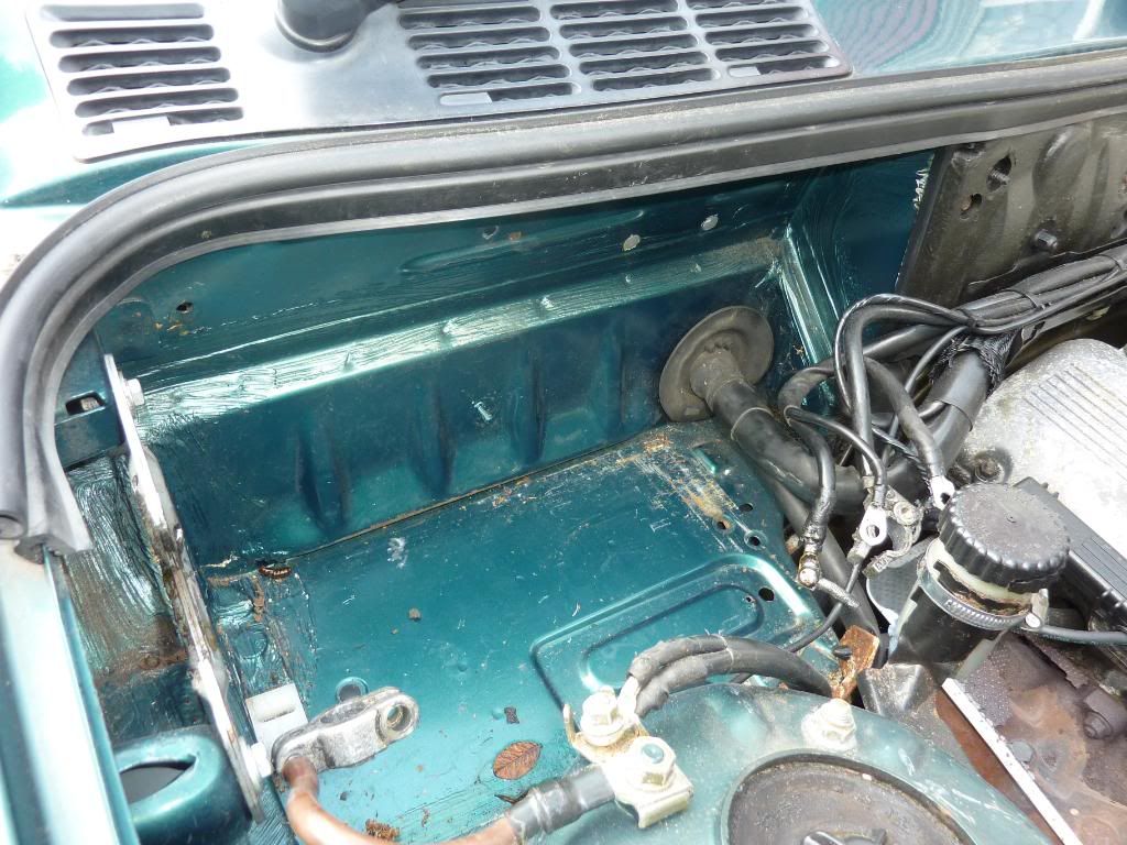

Removed the battery and all the trim:

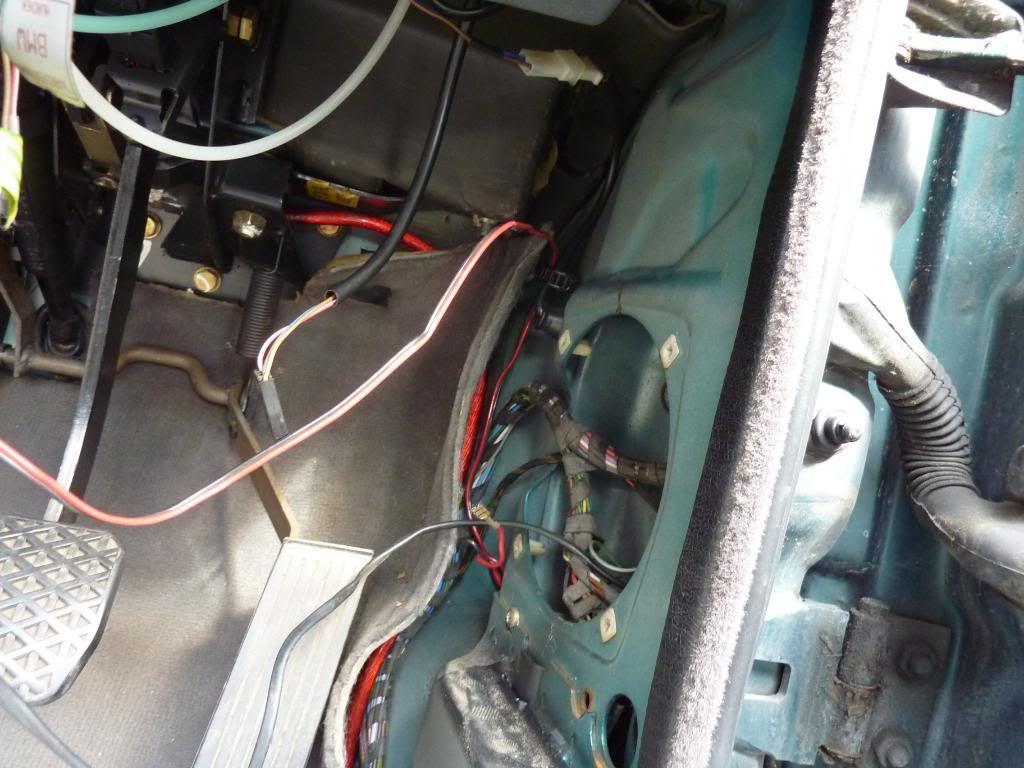

Then made an incision to feed my power cable through the bulkhead and wire fed through into the car:

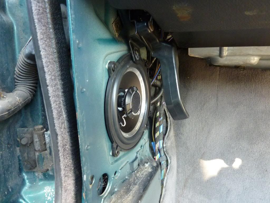

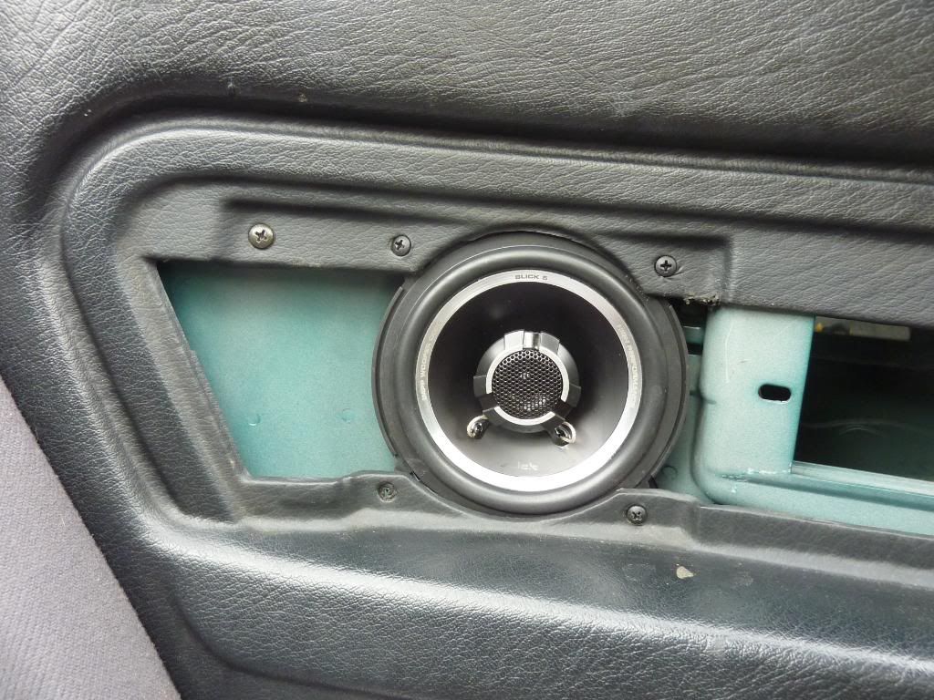

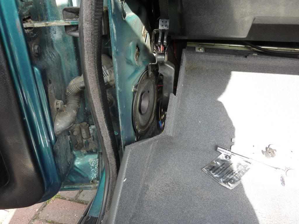

Got the kick panels off and nice crusty old speaker was living there but not for long!
Ripped out the old speaker cables and installed brand new ones. Then started to fit speakers fronts and rear. I was very lucky with the rear as there is hardly much room to accomodate the speaker and was lucky enough to position it so that 3 screws can hold it on.

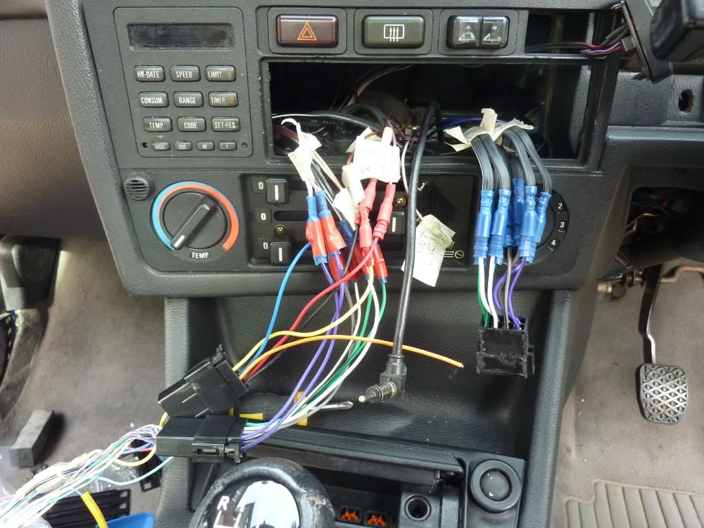

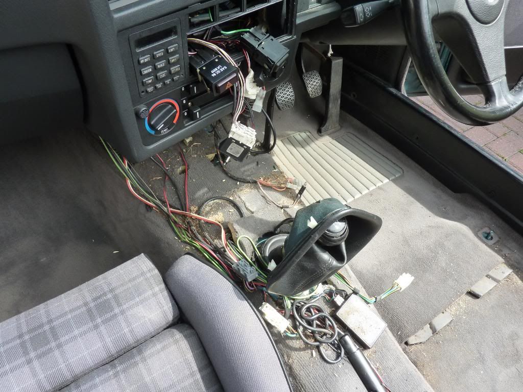

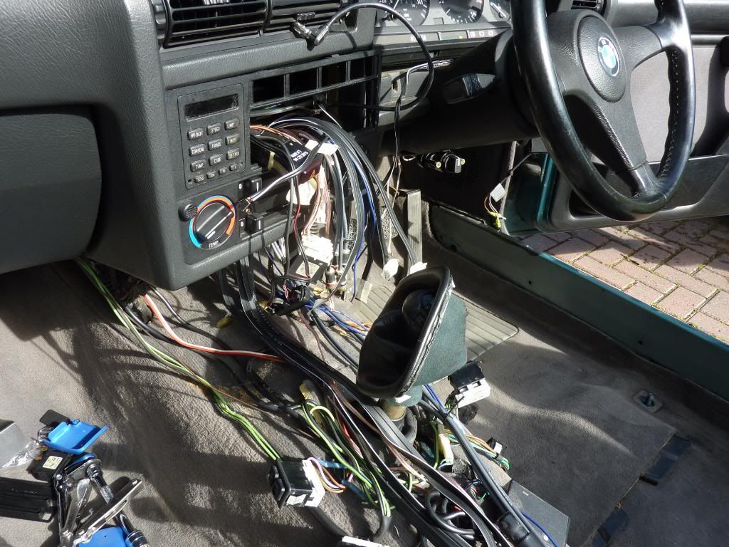

Next it was sorting out spaghetti junction with all the wires, 2 RCA's 2 Remotes, and a bunch of speaker cables! Laid them out through the centre.
Now to put everything back together!
As there was no ISO block connectors to start with I made my own:
Everything all connected, tested to make sure it all works! As you may have noticed there is a ISO connector on the right, this basically is my speaker cable from the boot to the front. What this means is when I do get the amps all I have to do is unplug the ISO speaker connector thats plugged into the HU and plug it into this. It saves me having to run two sets of cable from each speaker, and also if the amp ever blows or malfunctions all I have to do is plug it into the HU iso block again to get sounds to the speakers.
