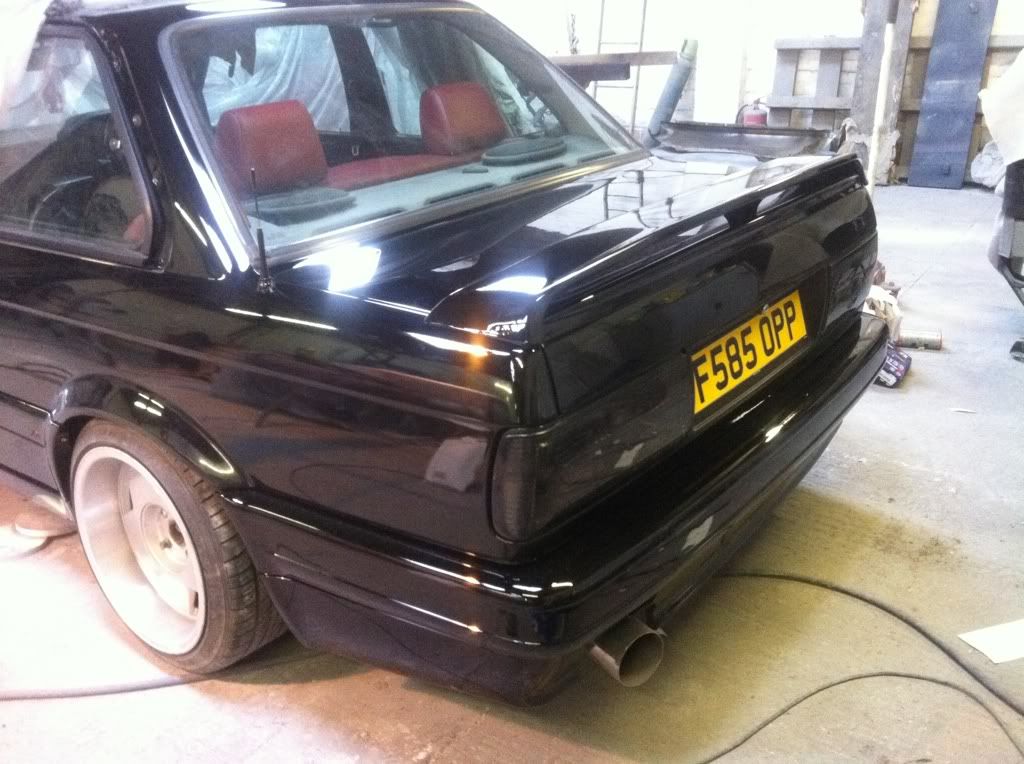

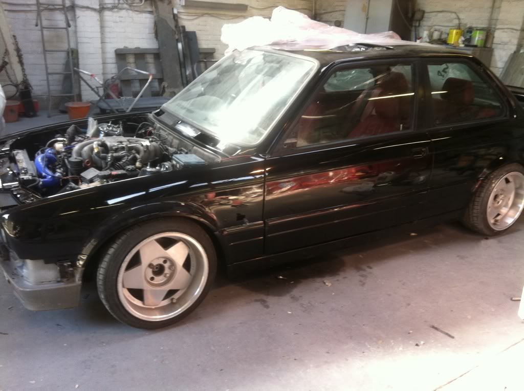

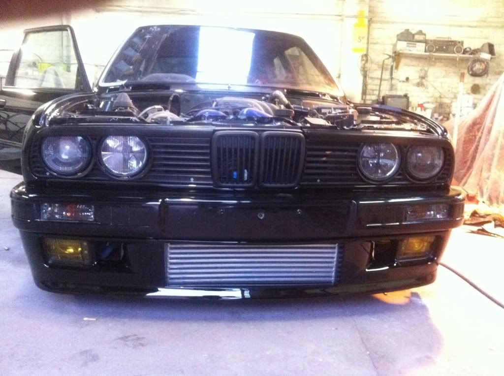

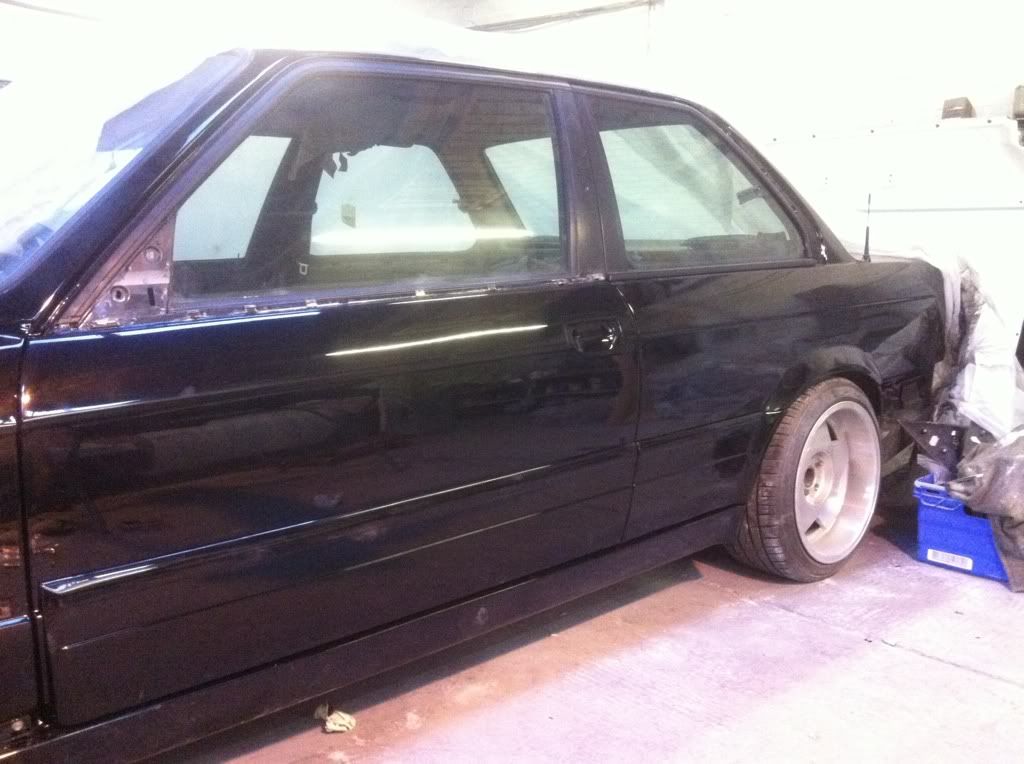

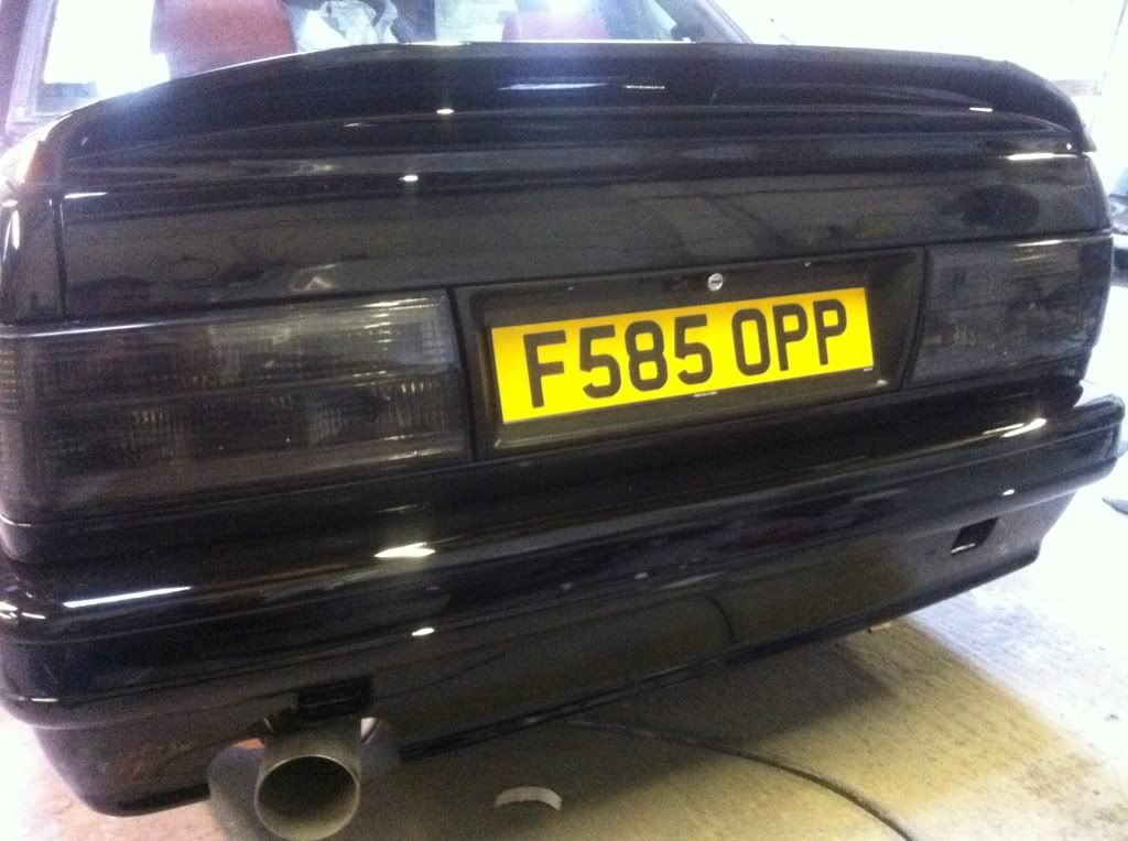

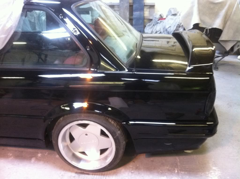

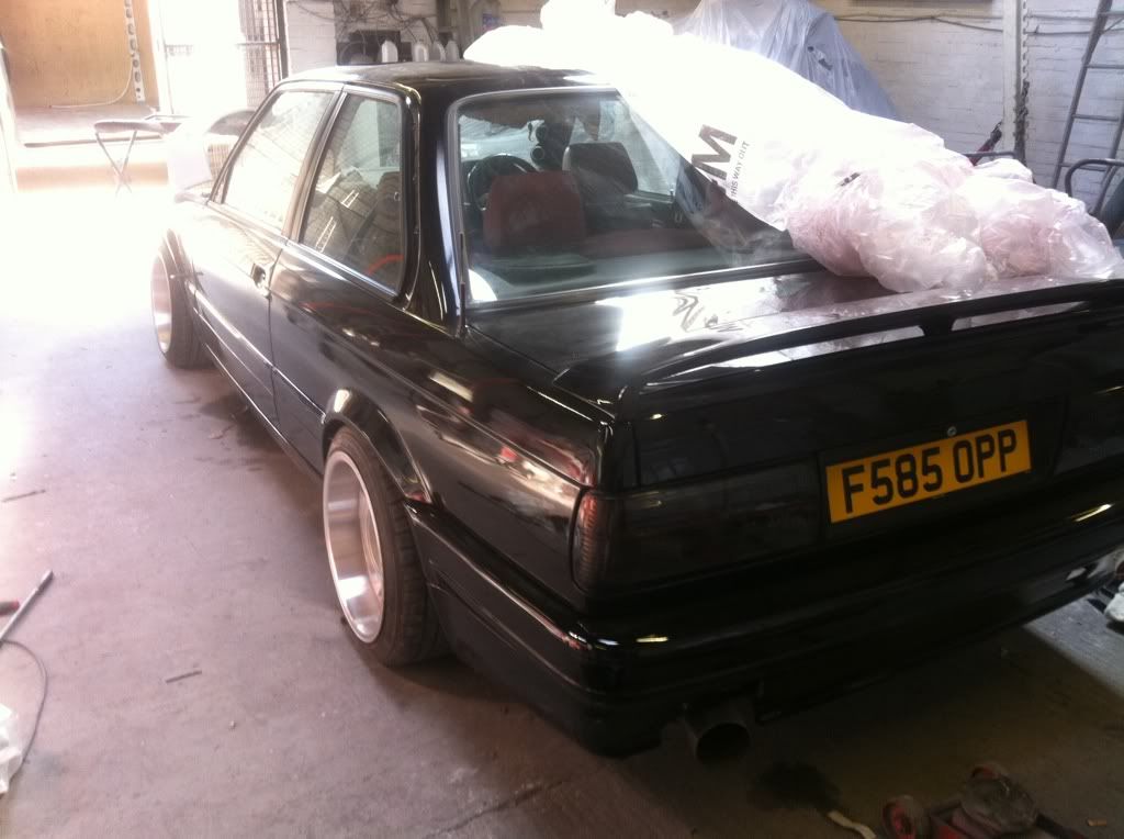

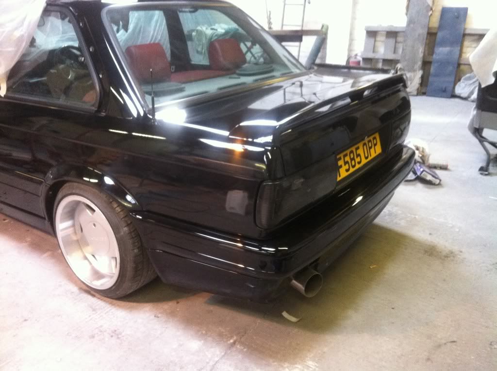

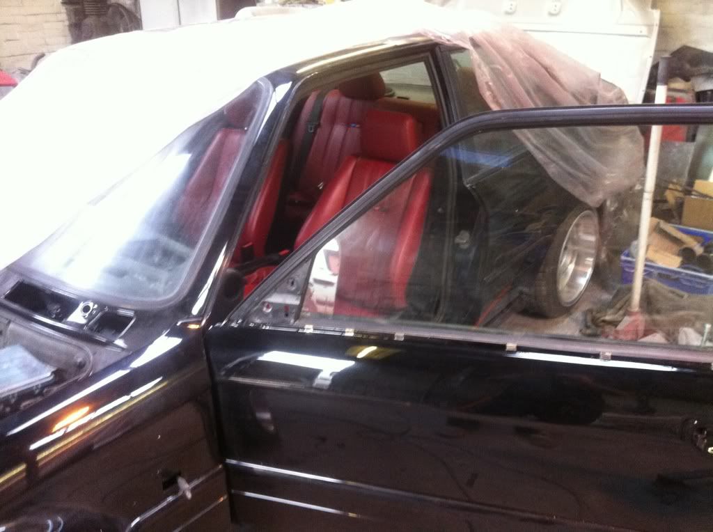

just a few pics of my project took me since march 2010 and spent about 6 or 7 k so far with the turbo conversion brand new built engine new bushes bearing ball joints brakes you name it its been done finally putting the finishing bits on her, rears near enough all done now just gotta put the front together then ill post pics

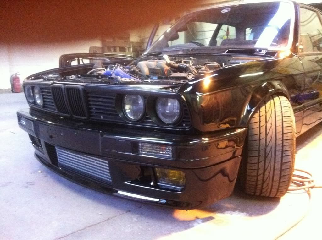

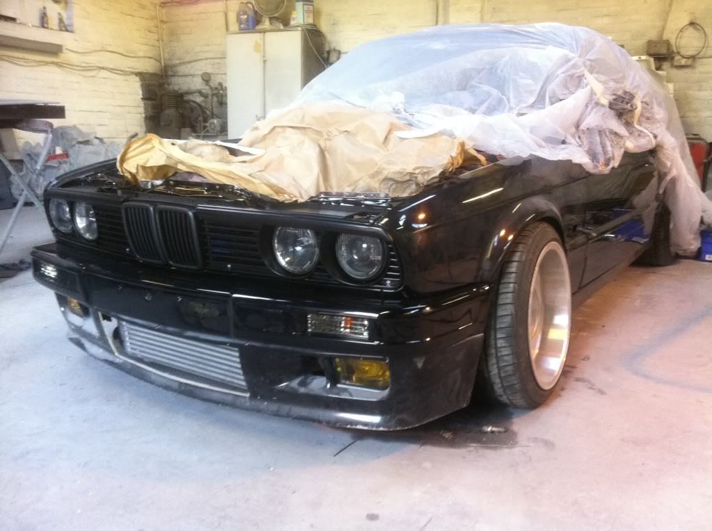

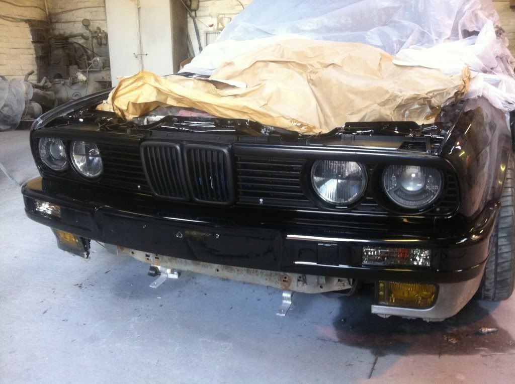

some of the front not finished yet bottom valance has to be sorted yet but you get the idea :)

lol does dont it im well pleased at how she looks concidering me and my dad done the paint work i built the whole thing all my self including the engine no one else had touched which means ive got alot of pride and pleasure in what ive done mate

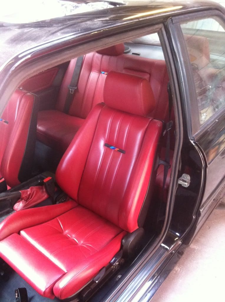

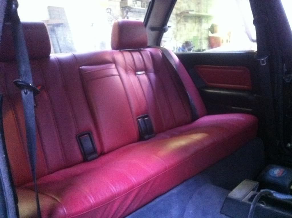

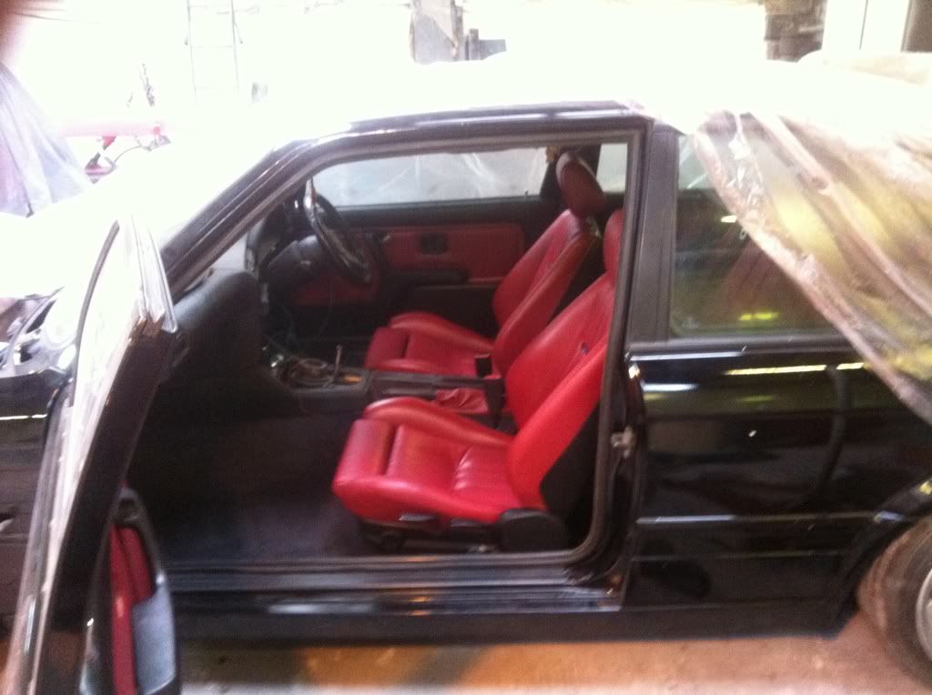

what about your old seats mate :)

Well I didn't wanna say but it wouldn't be the same without them winkeye
'90 325i Sport
ross2009
Posts: 2762
Wed Jul 06, 2011 3:04 pm
f4stjay wrote:Well I didn't wanna say but it wouldn't be the same without them winkeye
your right i dont think it would look half as good with black leather winkeye

Don't like the rear lights, but I like the rest of it! Looks great.. Self built is always a bit more special also. :cool:
ross2009
Posts: 2762
Wed Jul 06, 2011 3:49 pm
Jhonno wrote:Don't like the rear lights, but I like the rest of it! Looks great.. Self built is always a bit more special also. :cool:
each to there own mate they were cheap lol
cheers :)

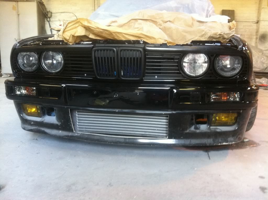

No pics of the front?? winkeye
ross2009
Posts: 2762
Wed Jul 06, 2011 3:55 pm
Rav335uk wrote:No pics of the front?? winkeye

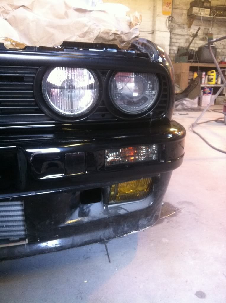

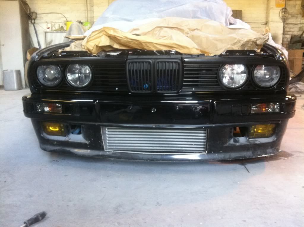

there not in yet rav lol but will be by the end of the week them bloody adjusters cost me 50 quid from bmw lol but at least i know there new just gotta paint that metal strip below the grill then i can start fitting the front up lol dont worry your lights will get shown lol winkeye

Looking good Ross :cool: nice to see it nearly done
get that front end put together and get some piccies up :D
Its a kick in the balls getting the adjusters from Bmw aint it :mad: my bill came to £131 for adjusters and gromits. nice and fresh now tho

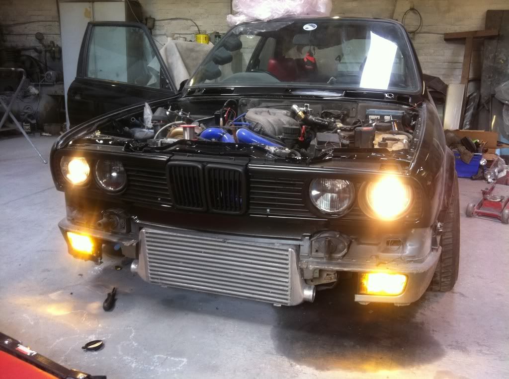

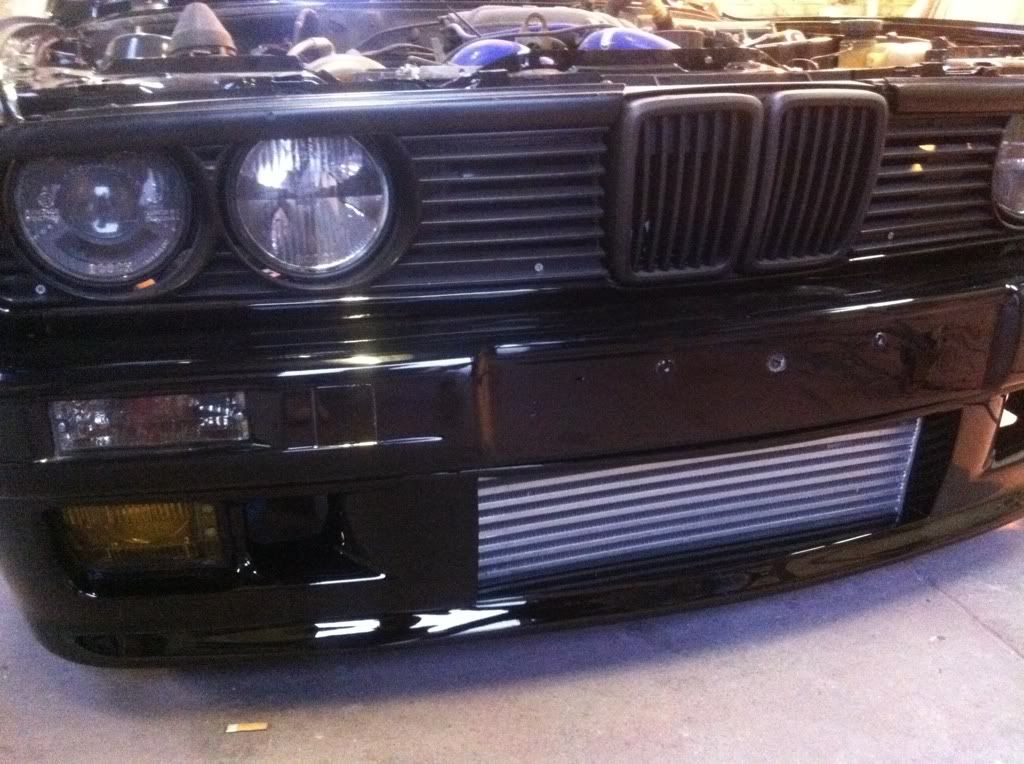

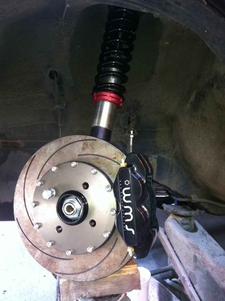

pics for you keri

Fri Jul 08, 2011 12:20 pm
Awesome stuff mate keep up the good work
Brakes looking good :D

they fit a treat mate.

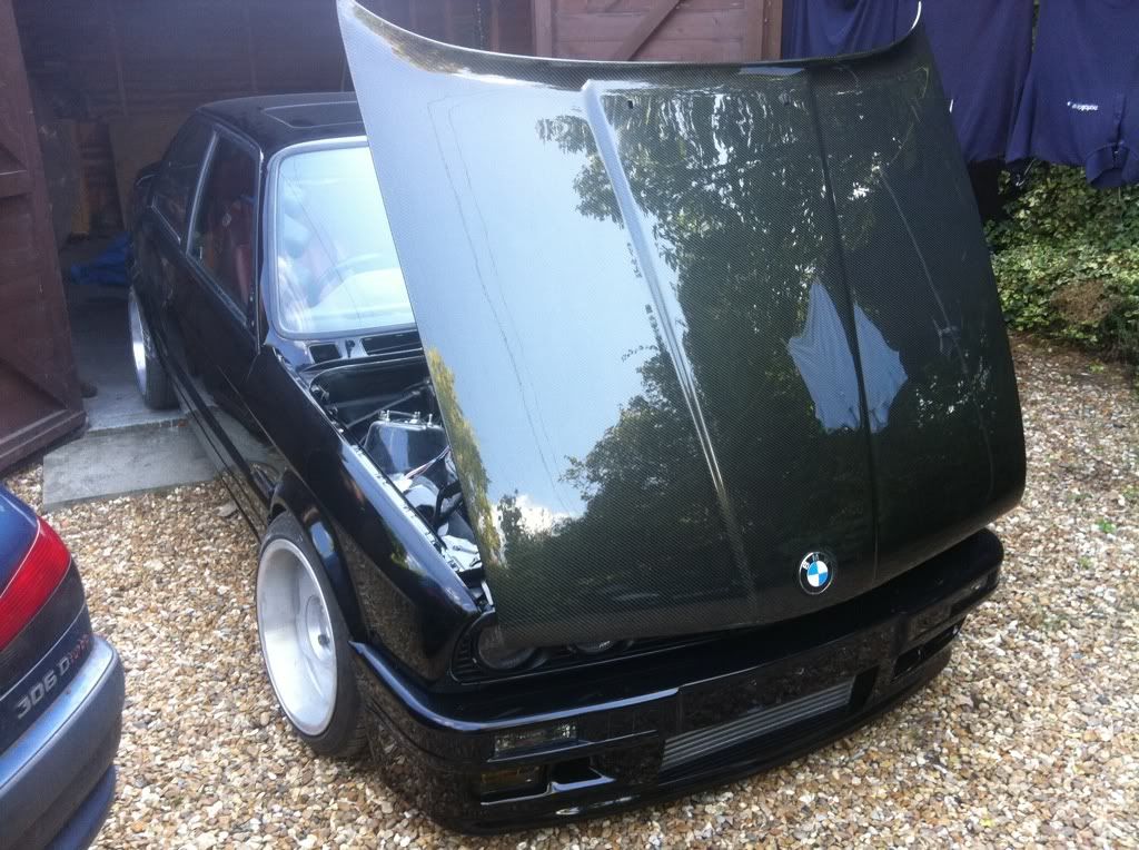

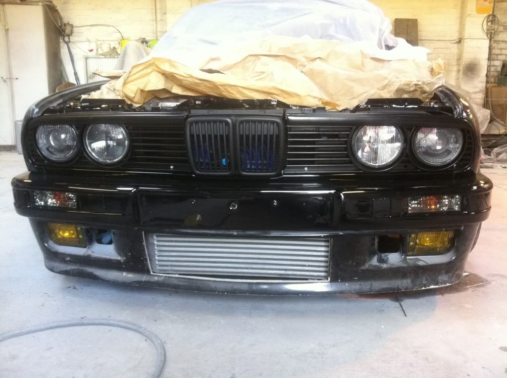

more pics added after a good mopping and got the front valance on

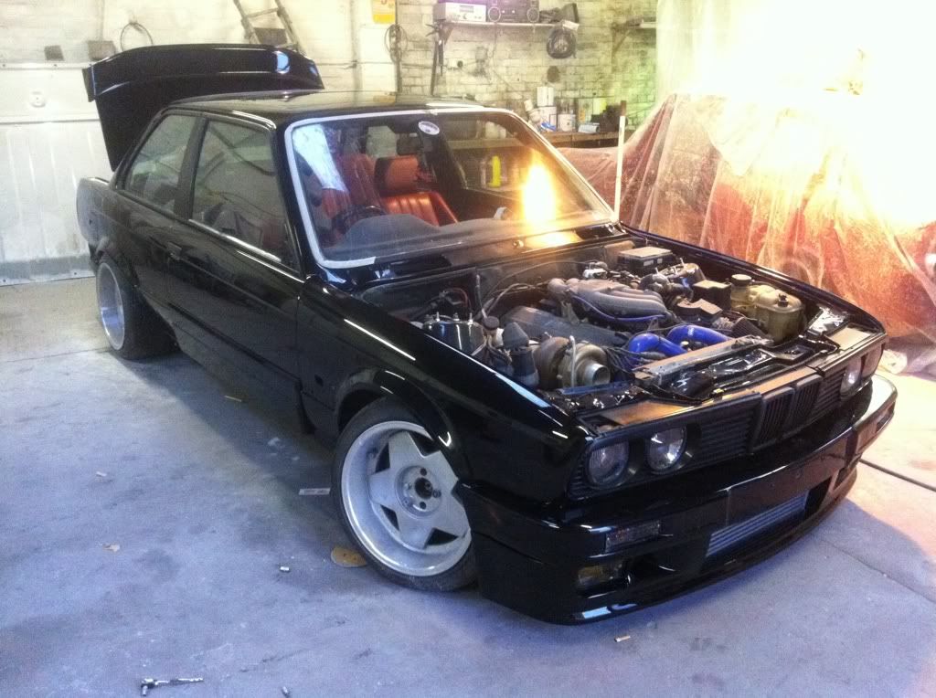

ross2009
Posts: 2762

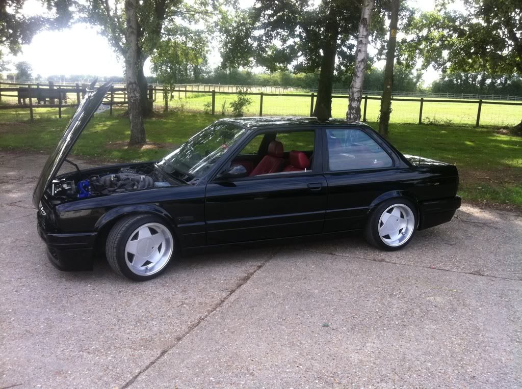

Mon Jan 23, 2012 3:59 pm

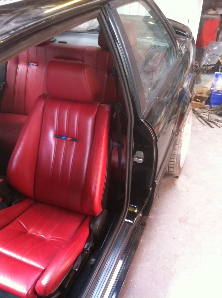

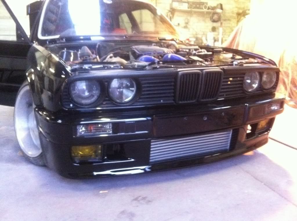

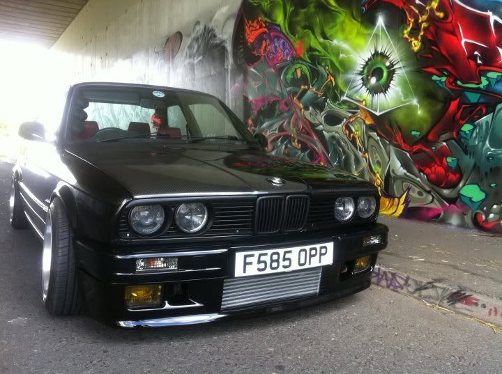

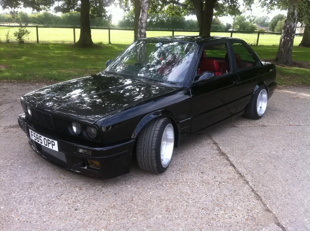

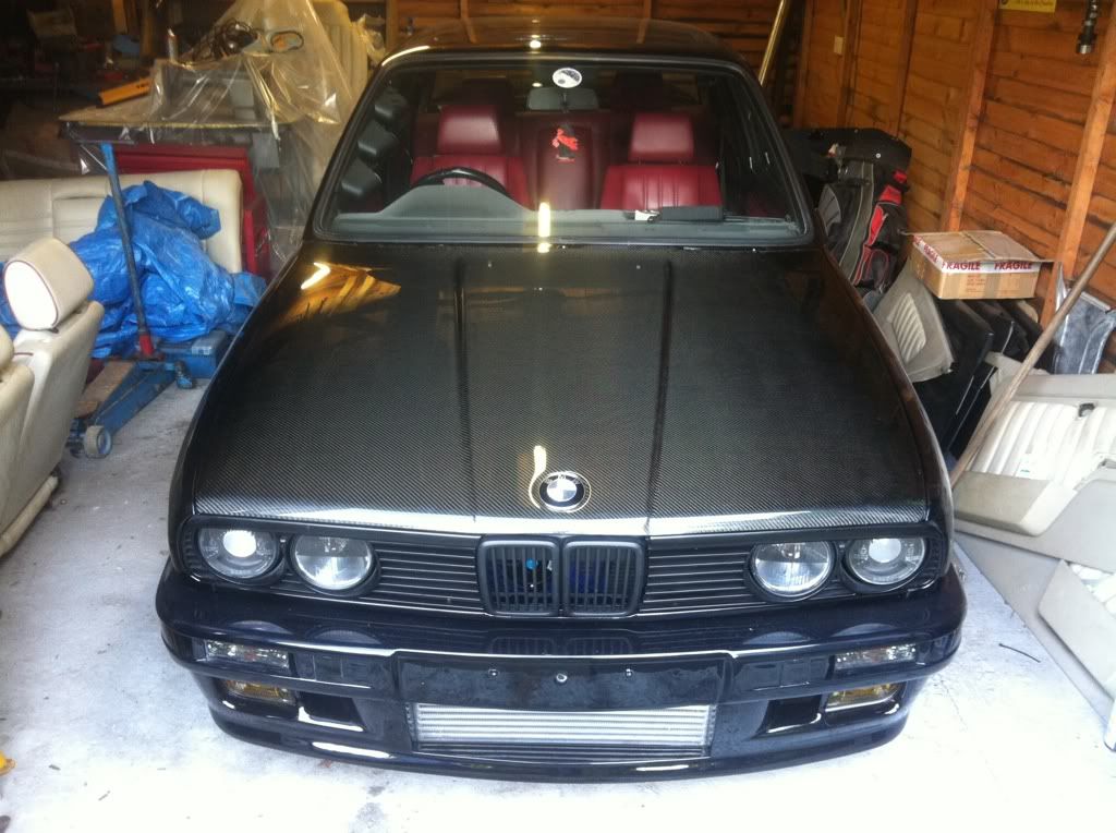

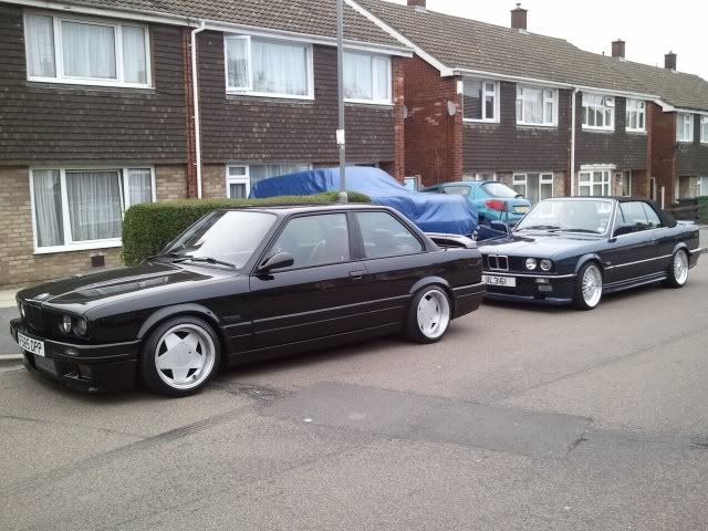

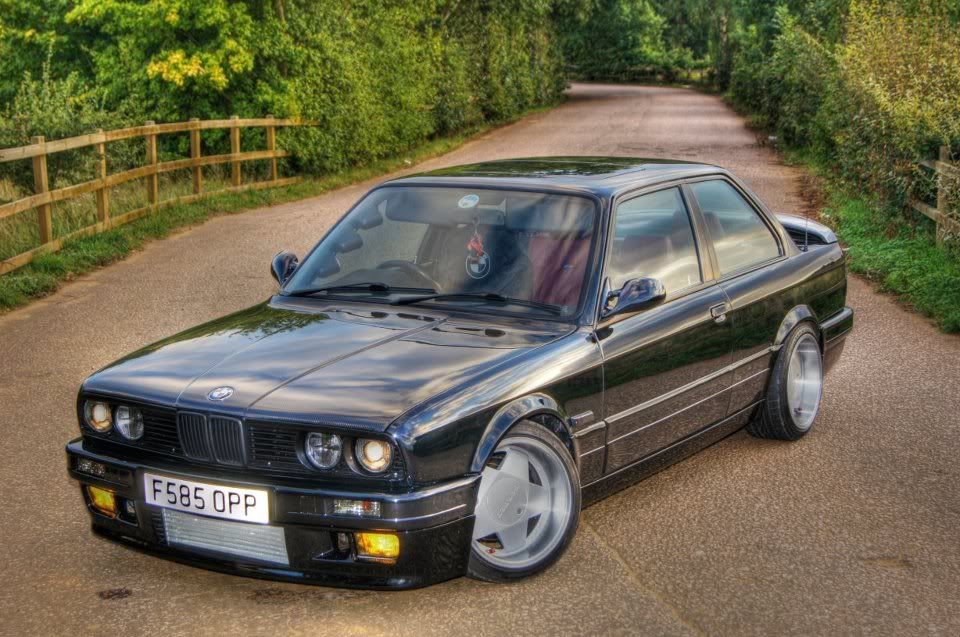

just thought id add a few more recent pics just before it came off the rd for winter :)
ImageImage mine and aliferrari

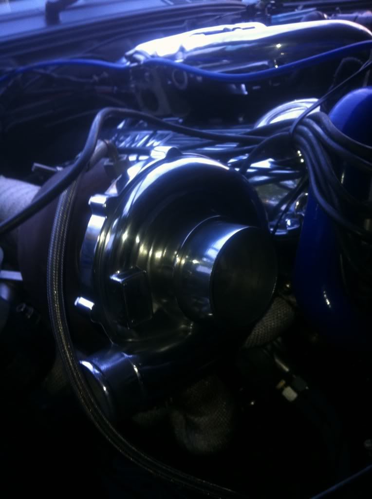

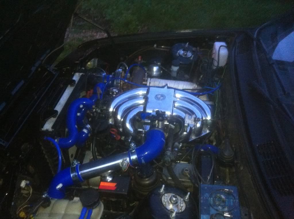

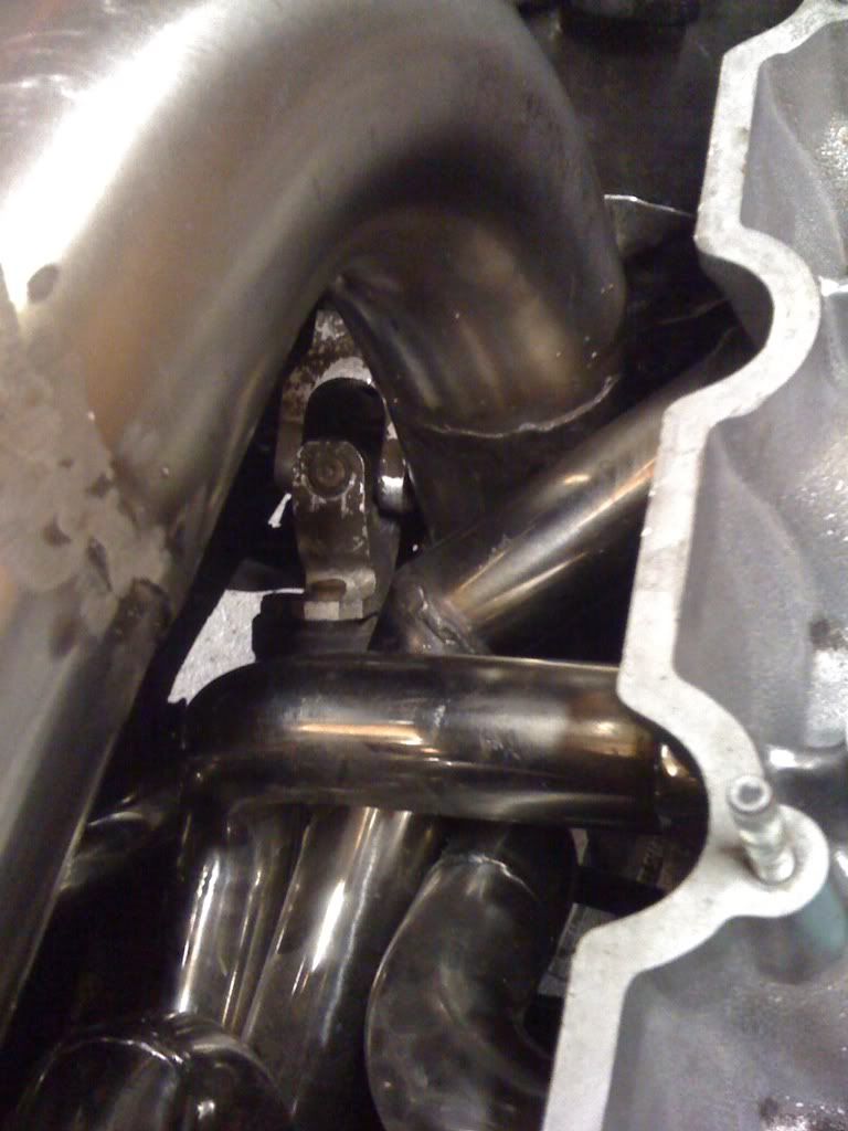

i would be interested in a few details of your build especially how you ran the large exhaust 3'' ? down past the steering uj ?
also it looks like you have removed the idle valve ? how well is it running without it?
and finally did you modify the vacuum for the brake booster
cheers J
ross2009
Posts: 2762
Mon Jan 23, 2012 5:14 pm
yeah no worrys well basically i cheated a little with the exhaust i chopped the no 6 runner and angled it slightly more so it gave me more room plus i also modified the steering joint with 2 ujs and a bar i didnt use the standard joint
and a little fettling with a hammer on the tunnel :)
with out an icv it starts first time but hunts really badly when cold but only need a little bit of throttle and runs fine when its warm you dont even know its not on there
no vacuum is still coming off the same place as standard but have blocked the breather and the water lines to the throttle body :)
