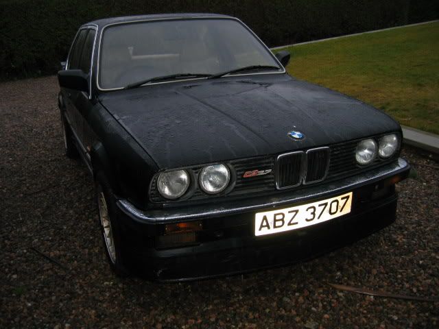

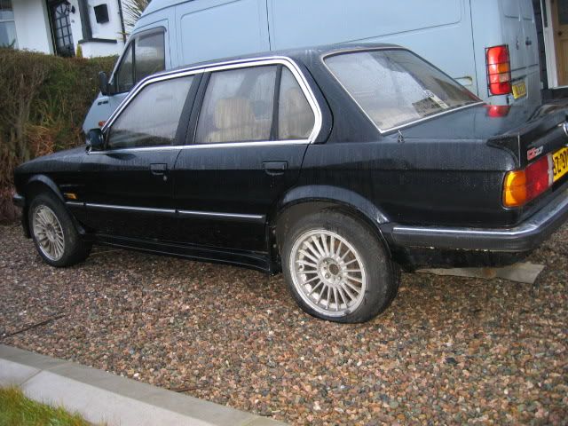

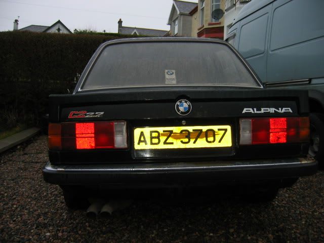

Ive been lurking here every day for the past few years and have recently bought this as a project:
The car is well known to me, as its original owner lived round the corner from where i grew up, and i went to primary school with his daughters. I can clearly remember them beign picked up in it! They kept the car for a very long time, approx 17years and then it was sold into the trade.
I was offered the car a few years after this, however i declined as i felt the asking price was too steep.
So when it became available at a more realistic price last month i felt i should step in and save it!
My plans are to refurb the wheels, get it Mot'd and Taxed then as funds allow do a full refresh on suspension/chrome/interior etc...
Posts: 14101
Post Thu Dec 30, 2010 4:21 pm
Nice find - how much was it? The suspension ride height looks strangely high though :?

the ride height is defo a tad tall lol whats going on there?

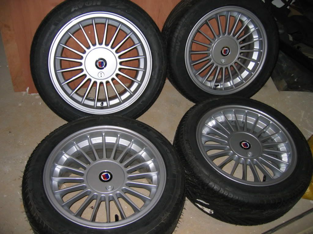

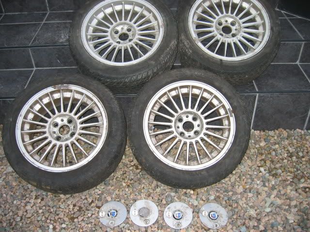

Wheels went from this:
To this:
Very pleased with the results of the refurb, and the new Badges help set it all off.

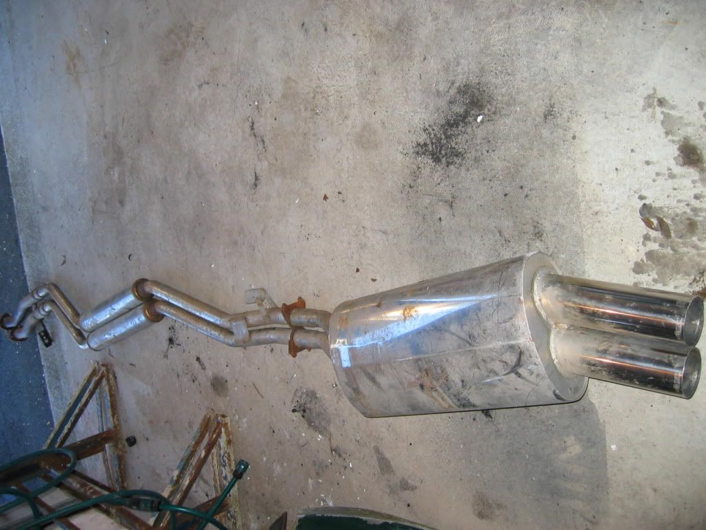

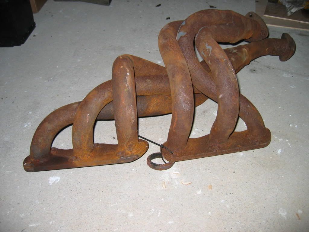

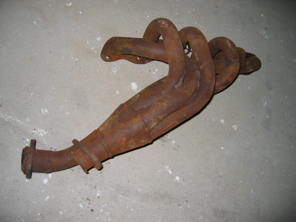

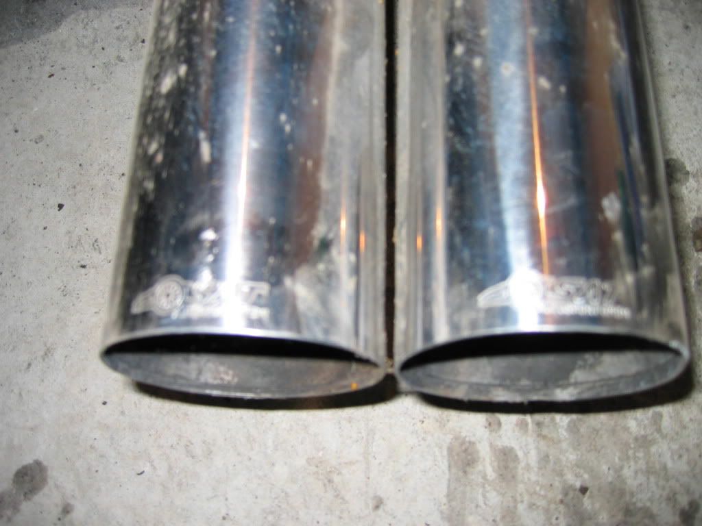

I picked up this exhaust and 6 branch manifold recently:
I am not too sure if i should fit it, is it a bit 'council'? The car at the moment is running the log manifold with a standard system.
Do any of you guys recognise it? It says made in germany, but with the tiny middle boxes i am guessing it may bit a bit too boomy and loud, what do you rekon?

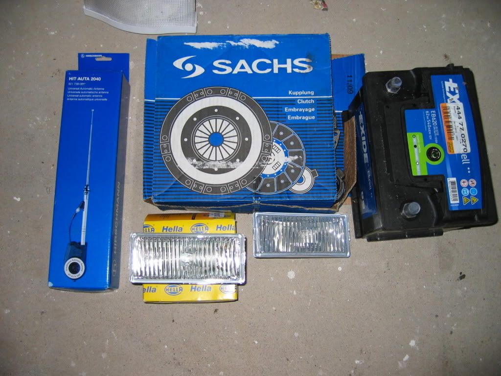

Starting to gather some shiny new parts up:

wheels look great after refurb

The manifold is a genuine RHD Alpina item which were made by Janspeed.

i just typed that out, but someones beaten me to it. Sell it to me! lol not sure on the exhaust don't recognise it myself

That must be one of the first C2 2.7 going by the build number. Pretty near the build number on mine.
Also the manifold is really nice , I was very close to getting one but the seller sold it to someone else for £50 more when we already shook hands on a price. Good luck with your restro.

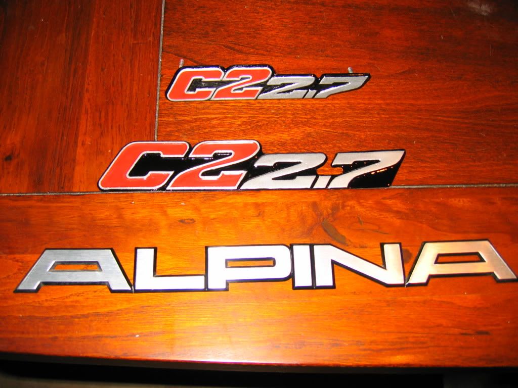

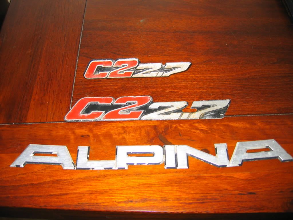

Today i managed a bit of a DIY refurb on the badges......
Went from this:
To this:

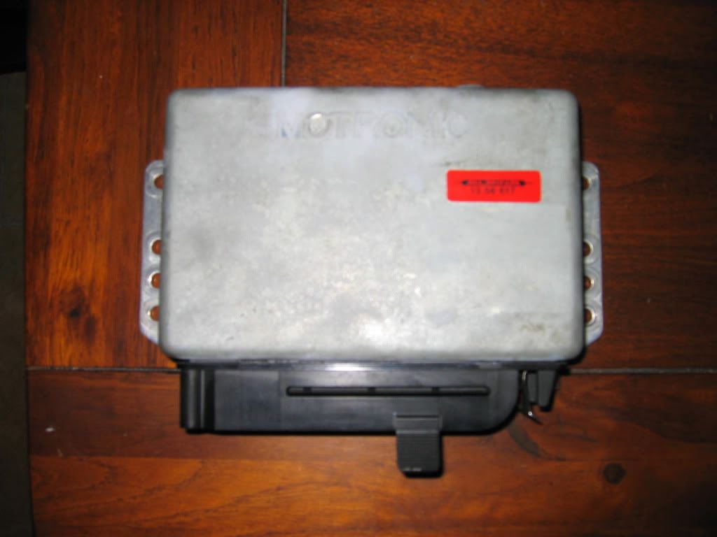

The other issue i have is with the ecu on the car - its been repaired back in 2006 by someone called NWR, Nigel William Rodgers, and the invoice states "remanufactured ecu".
The case still has the alpina sticker, but i havent yet taken it apart to check the EEPROM chip. How will i know an Alpina chip is still in there?
Posts: 14101
Post Sat Feb 05, 2011 10:15 pm
Yes, the later Motronic 1.3 is better, having more load sites for better resolution, and they do away with the failure-prone flywheel sensor (the pins tend to drop off!). Also, they are easier to chip, having only one PCB instead of two.
I can supply a C2 2.5 EPROM which can be fitted into any Motronic 1.3 six-pot ECU to give the 2.5 a useful boost, or even a B3 2.7 one should you later require one. winkeye
If your Alpina ECU has an Alpina chip, it will probably have a label on it to say so, or none at all. (BMW EPROMs have a silver label on, with a part number, e.g., 1 267 356 378).

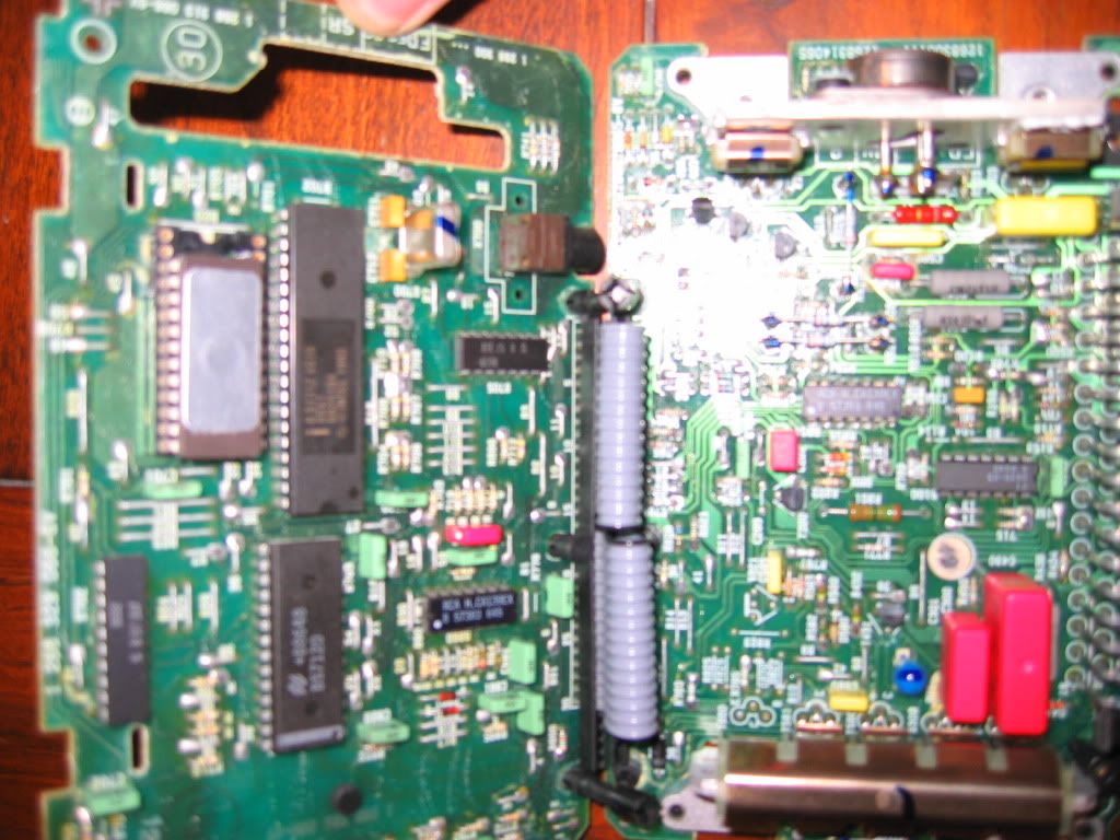

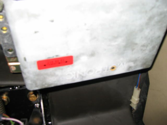

Had a quick look inside the ECU:
The EPROM has a silver sticker with a short 5 digit number written on it.
Its also sitting on a jumper board, so i think its an Alpina original......
Any else know better?
Posts: 14101
Post Sun Feb 06, 2011 10:11 pm
It would help, perhaps, to provide the number.
It looks from the photo as if a 24-pin EPROM has been inserted into a 28-pin socket. I wouldn't expect the likes of Alpina to bodge things like that!

Post Mon Feb 07, 2011 6:12 pm
Speedtouch wrote:It would help, perhaps, to provide the number.
It written by hand, and its very small.
It says 677.2
or 6 > 7.2
