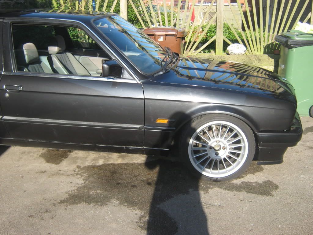

Ive been a e30 owner about 2 years now and a member of this forum for not far off that and never actually shared any photos of my e30 on here so here is how i got it and whats happenin with it now! Ive always liked e30's and when my brothers and friends started getting into the drifting scene i decided to have done with the fwd cars and sold my mk2 golf g60 and bought this 1988 325.
This is pretty much how i bought it but it sat too high in my opinoin so some second hand coilovers later and this is how it looked

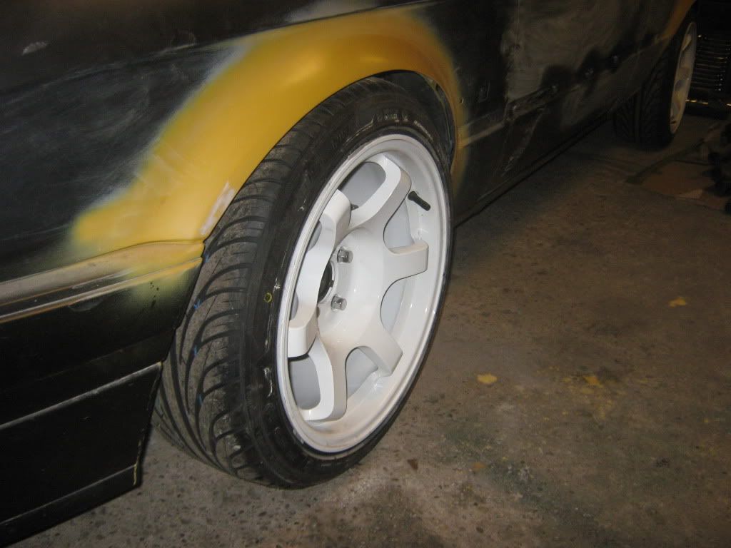

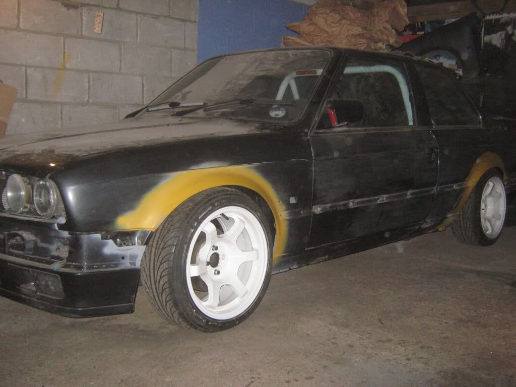

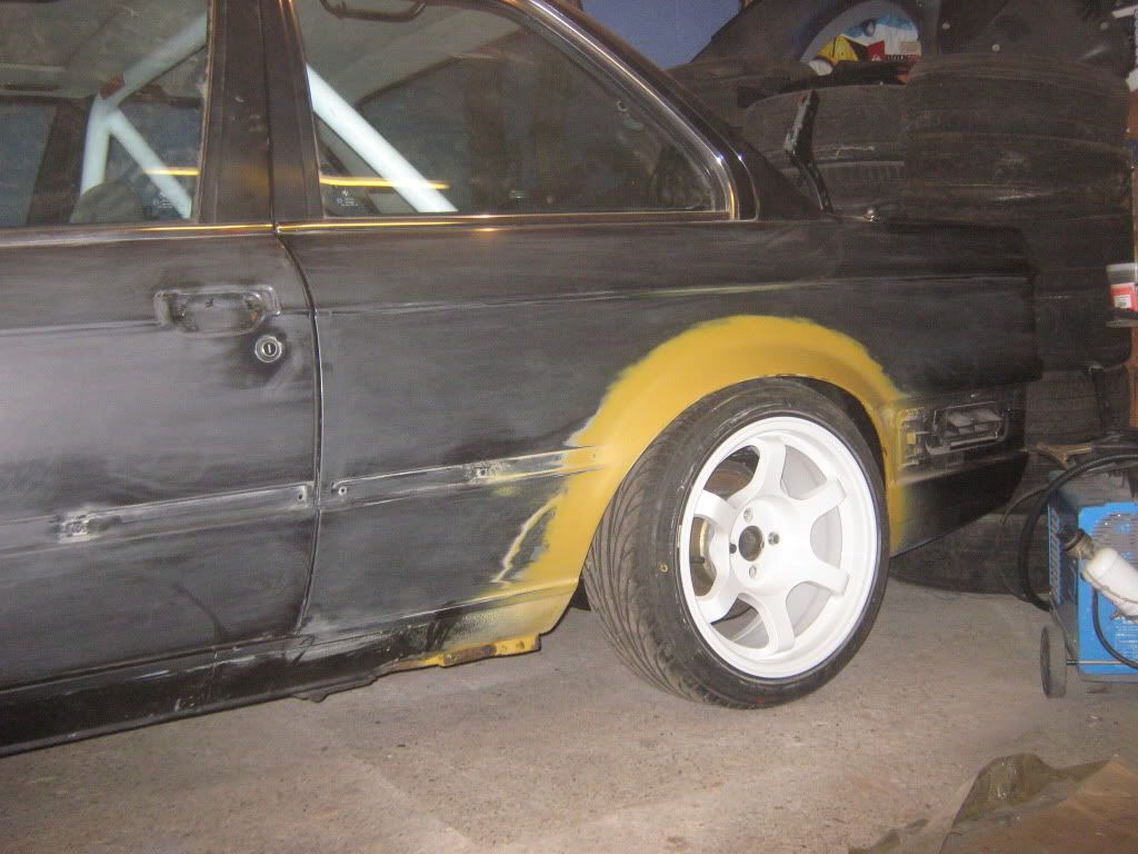

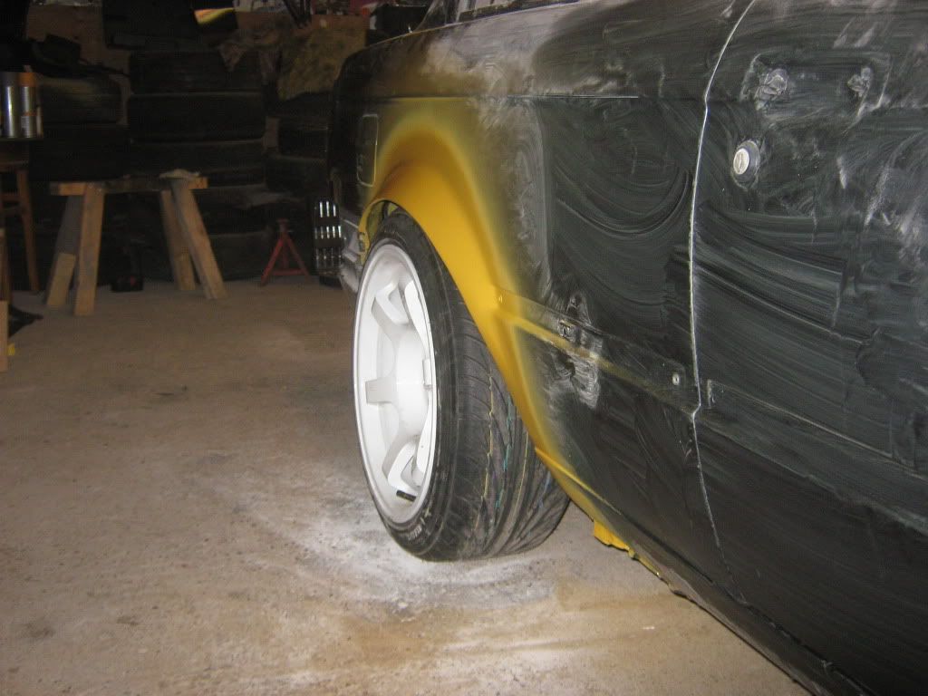

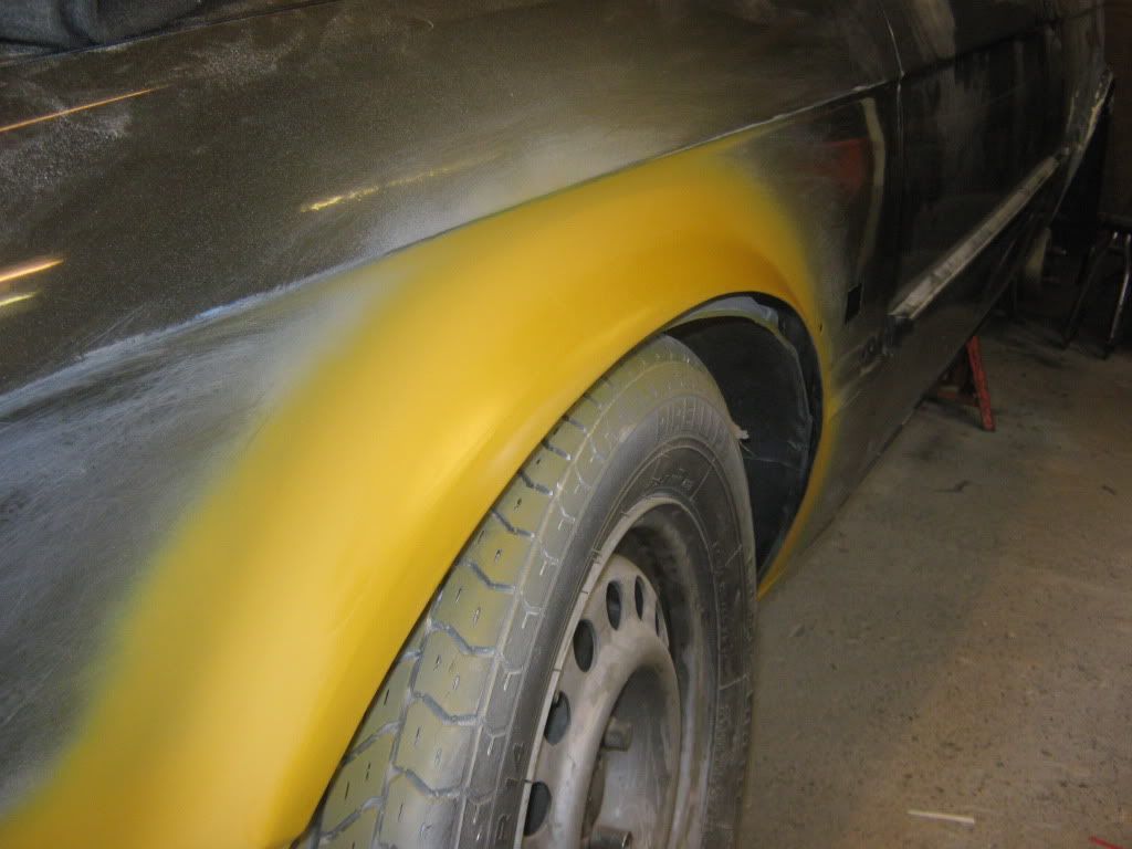

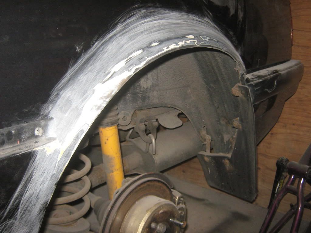

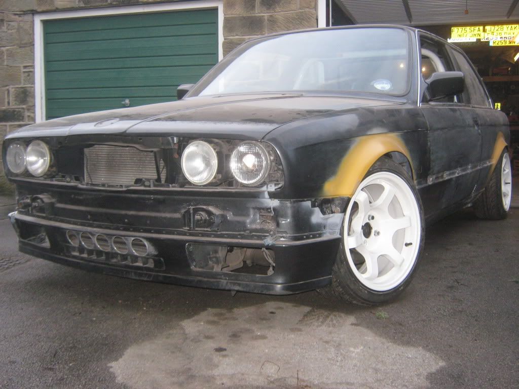

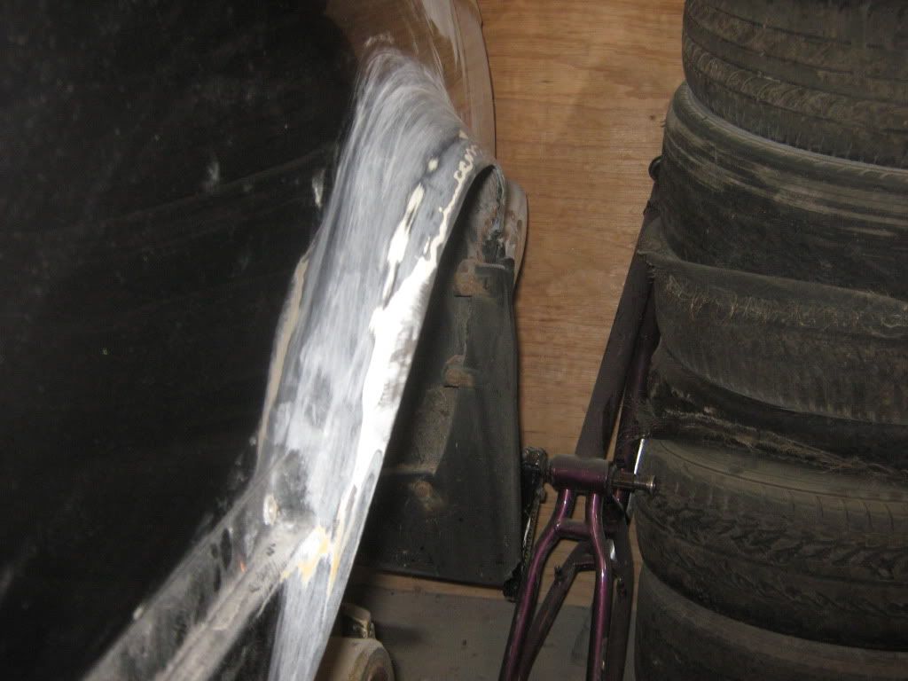

I wanted a much more aggresive look and wanted rid of the alpina reps.I also wanted to give her a much wider stance so started on the arches when i got back and started hunting for rust :cry: i also poly bushed the rear subframe and trailing arms!
This is how she looks now hoping to have her sprayed before christmas so i can build it back together whilst im off work. will keep puttin photos up of my progress.

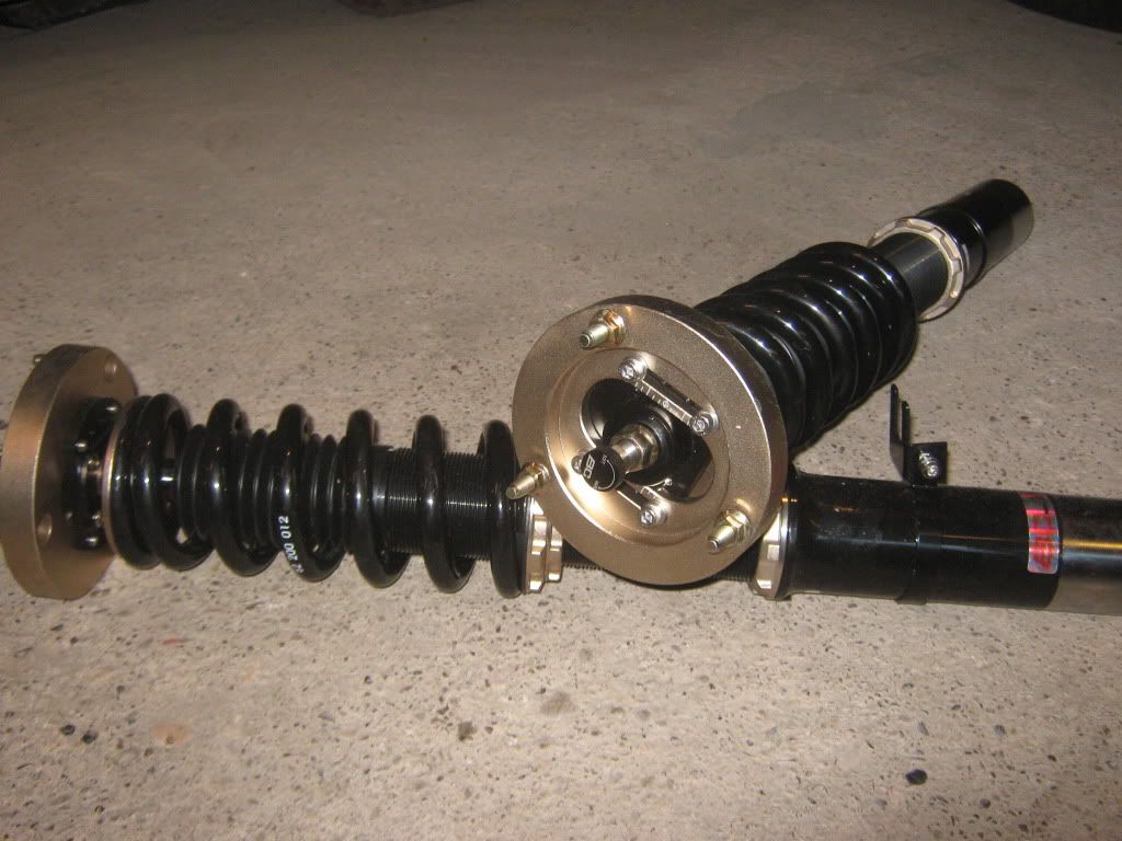

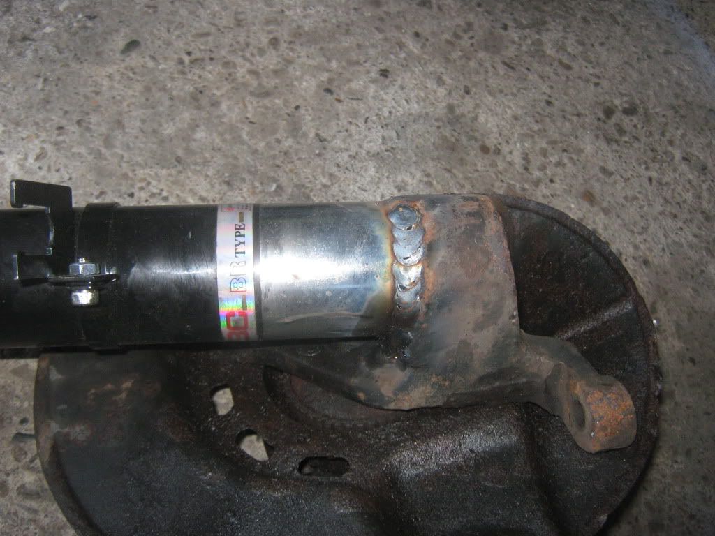

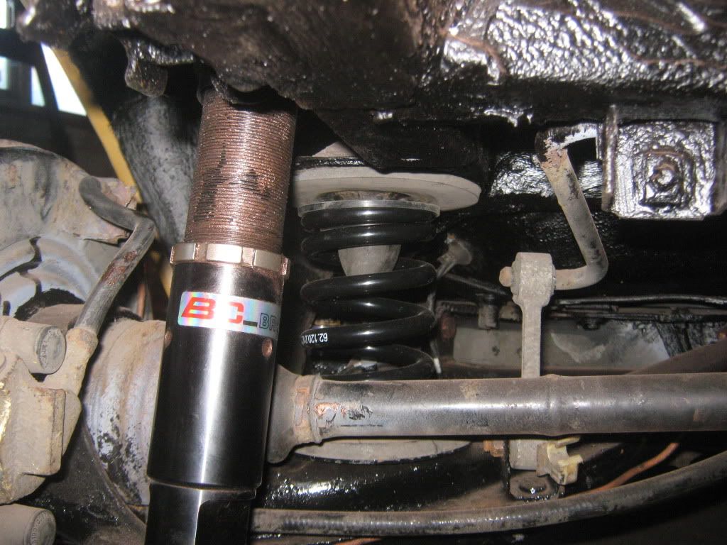

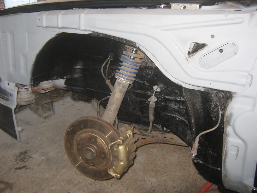

Got a little bit more done so thought i'd take some photos of the progress. Also the new suspenision turned up :D BC coilover kit. However the rear springs wernt low enough so i took them back and had them changed and the stance is just how i want it now :cool:
These are the fronts but they need welding to the hubs.
And the rears fitted (coated them in copper grease, dont want them seizing)

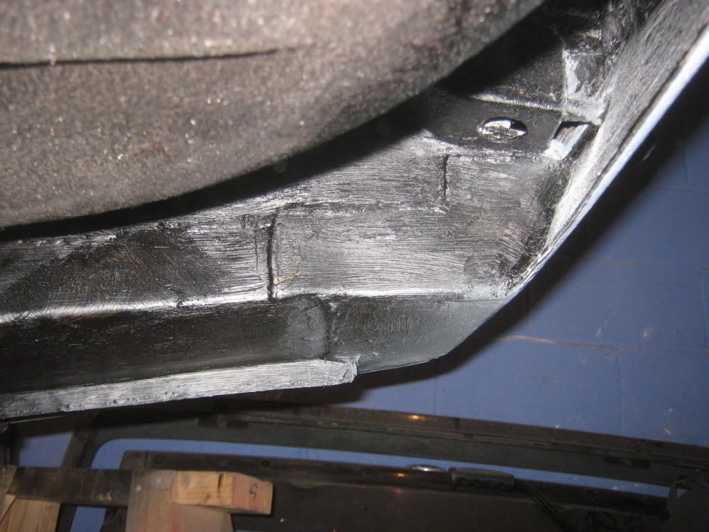

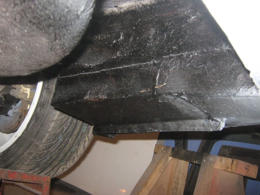

Took the wings off and found it needed a bit of welding :cry: Just where the break line fixes to the inner wing and some in the passengers foot well. This is what it looks like now all done and undersealed back up.
Really happy with the stance of the car now just going to change the spacers on the back from 15mm to 25mm winkeye. Here's a couple more pics of how she sits.

Forgot the main thing. New Wheels. 16x8 rota grid drifts :cool: Took a long time to get them but worth the wait :D

loving this ! exactly how i want my arches so heres the question...
What did you use to flare them, was it an arch rolling tool ? as i am thinking of buying one to do mine with
then a slight skim of filler to finish it off ? thanks dom
loving the car dude
e30max
Posts: 135
Post Thu Dec 23, 2010 2:02 pm
ye just borrowed my mates arch roller. fronts went really easy but the backs were a bit of a pain as they were a bit rusty so the roller wouldnt run smoothly along the arch. Also on the back youre rolling two skins, the inner and outer arch, so it takes alot more force to get them flaring. i just got them best i could and then tapped them into shape with a hammer then a few skims of filler like you said.

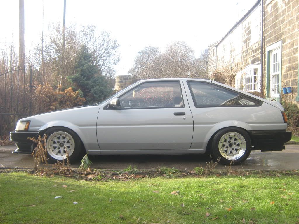

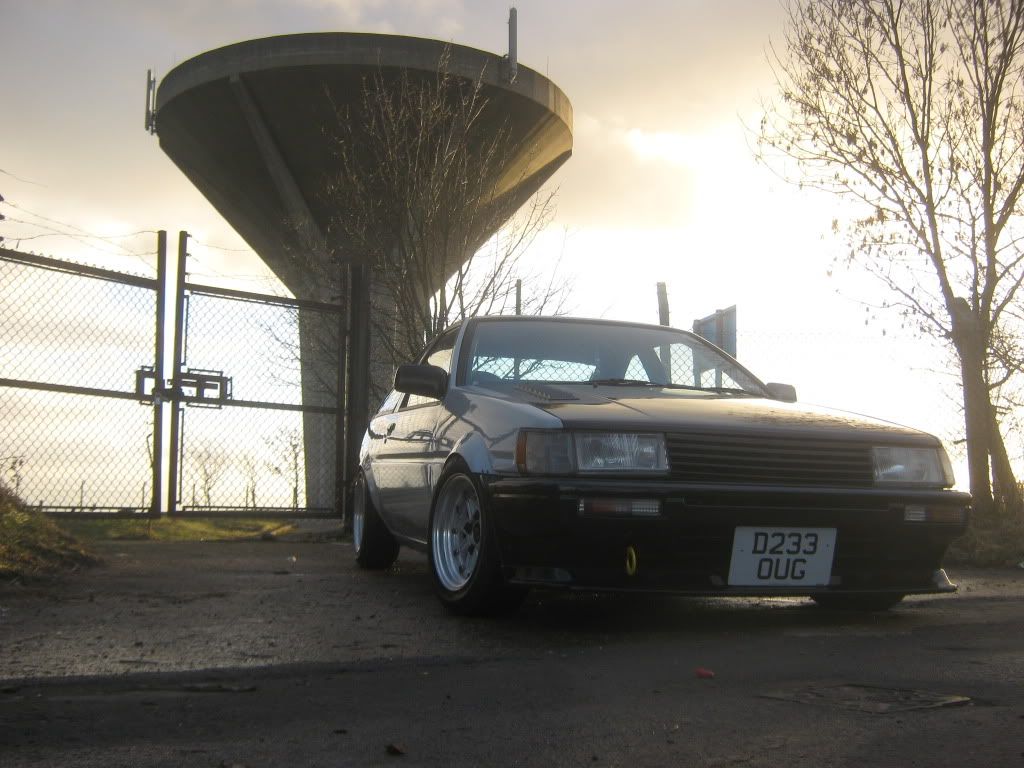

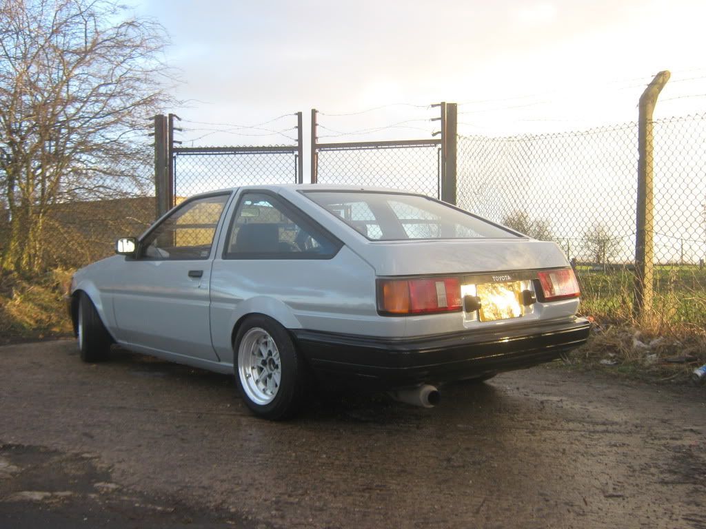

What's sat by the garage? old honda or toyota??

ah kool i cant wait to do mine. did you heat them up ? or do them in a warmish temp garage ?
so i take it you must kinda beat the arch from bieng in like the L shape to straight then shape with the arch roller ?
e30max
Posts: 135
Post Thu Dec 23, 2010 10:01 pm
yep its just a spacer between the track rod arm and the rack. ordered from chiz fab.
The car infront of the garage is my other bro's ae86 toyota corolla. :cool:
nope i didnt bother heating them up. i just took the arch roller straight to the wings as the lip is only small so it just bent the lip round then started flaring the arch. with the back i cut some off the lip as its much bigger on the back arches then did the same with the roller but because it was rusty the arch wasnt a perfect curve so the arch roller didnt run smoothly so it was hard to get it flaring but after a while of rolling it started to take shape. i could still see the line in the arch where it used to go flat (before it was flared) so i just tapped that in with the hammer and a few skims later it was done. Its hard to explain but if u take your time and dont try to flare it too much in one go you'll be fine :D

Post Fri Dec 24, 2010 12:25 am
ah wicked thanks very much now im itching haha ! and PLEASE get some pics of the ae86 !!!! i love em. dan chapman had one was a very good slider and thats where he became a drift king haha

One of my mates is shit hot at welding so got him to weld up my front coilovers today. Just need primming and painting then i can put them on!

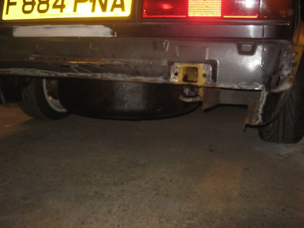

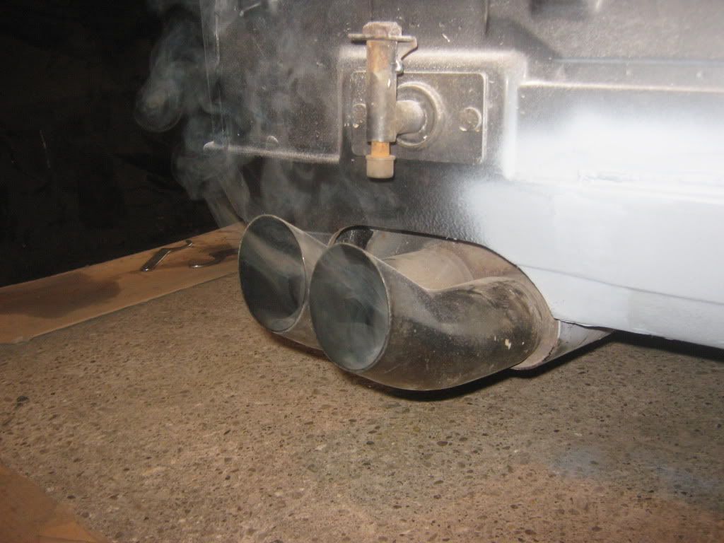

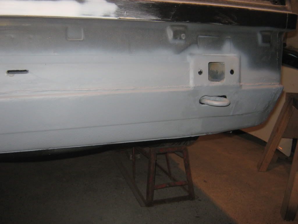

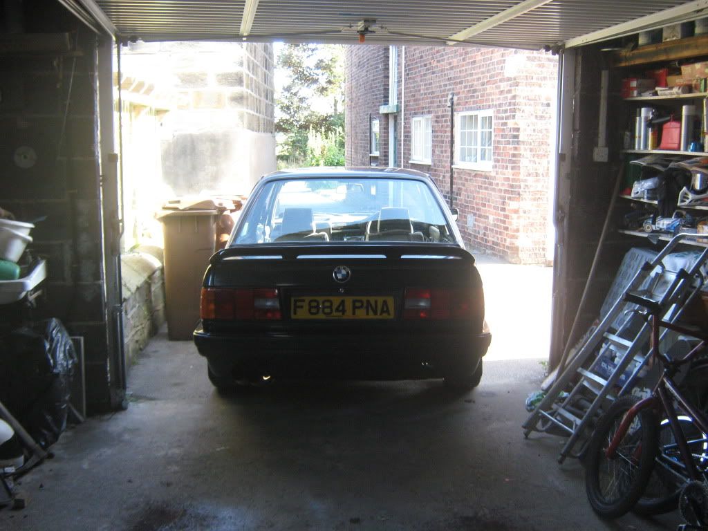

Got the battery box built back up and the rear valance welded on. I cut one off an e30 what was getting scrapped, the rest of the car was really rotten but suprisingly the rear valance was still solid. Also got the exhaust refitted, charged the battery up and started her. First time shes been running since before i went traveling back in may and she started straight away and was ticking over smoothly :D
And, by popular demand i got some photos of my bro's ae86 corolla :cool:
Dezzy

I have a guilty pleasure for the older ricers. :cool:

Post Wed Jan 26, 2011 8:26 pm
wow Love the ae86 !! and the colour looksgood i think nice one mate looks wicked !
