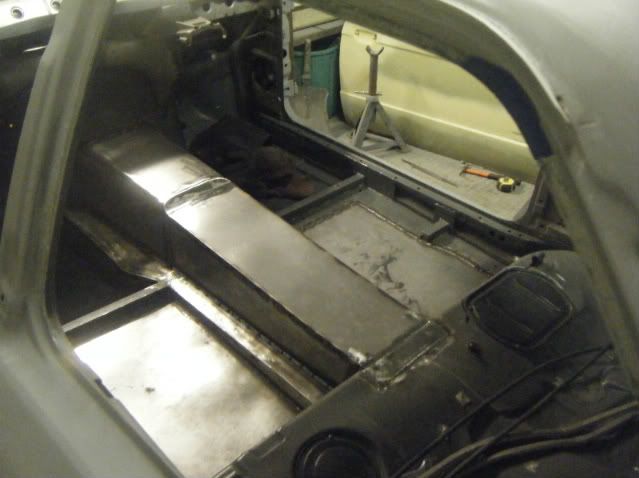

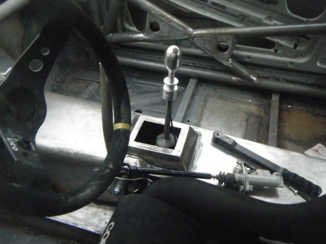

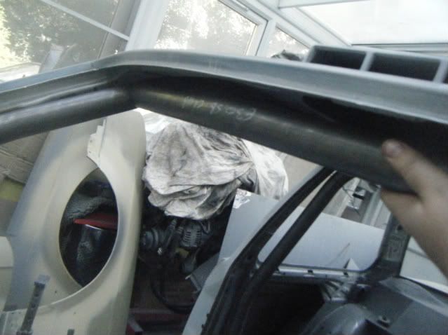

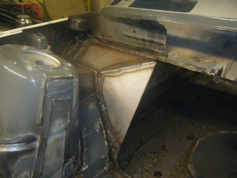

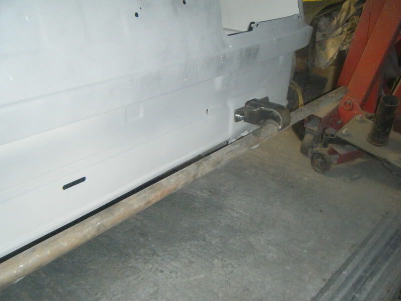

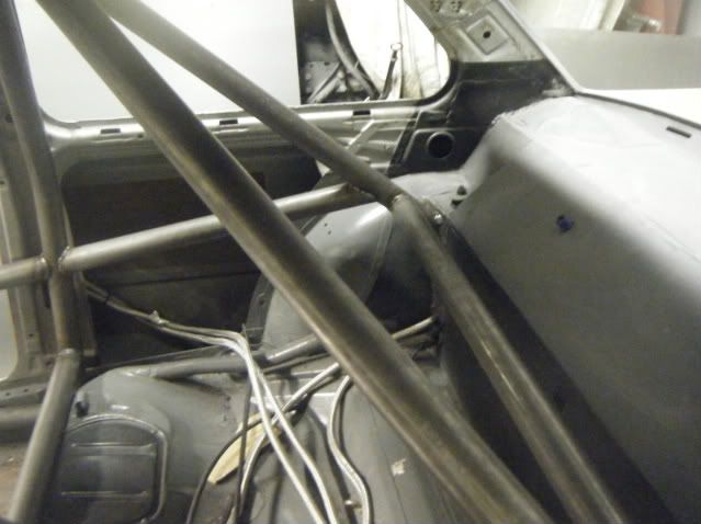

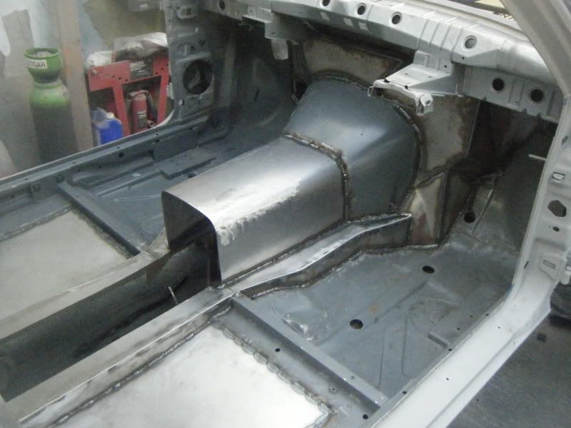

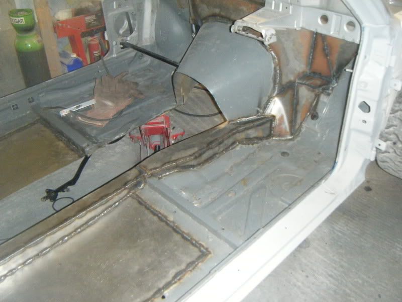

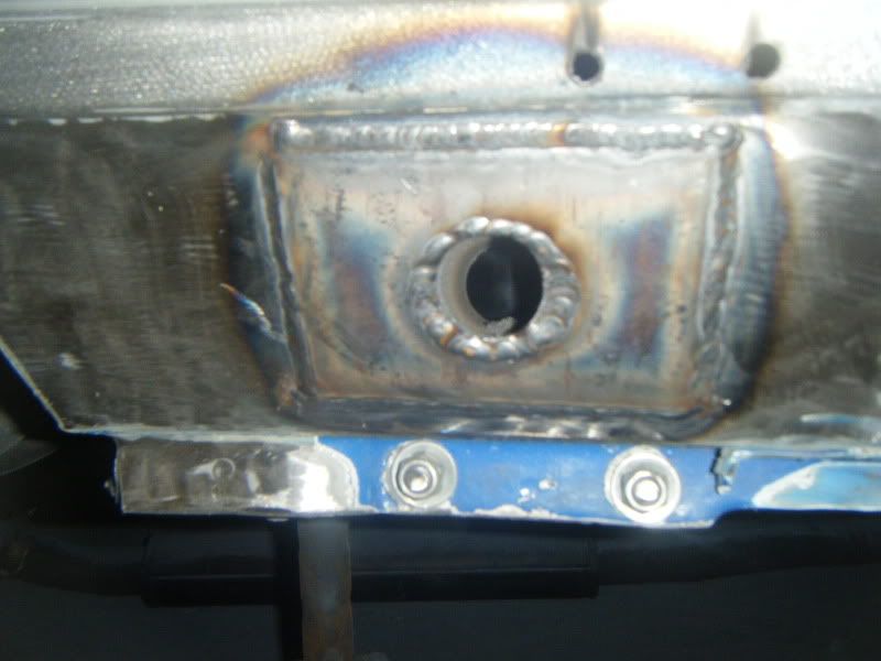

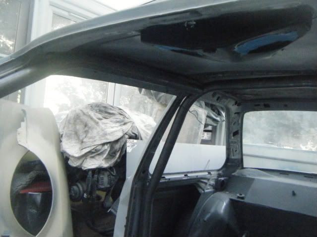

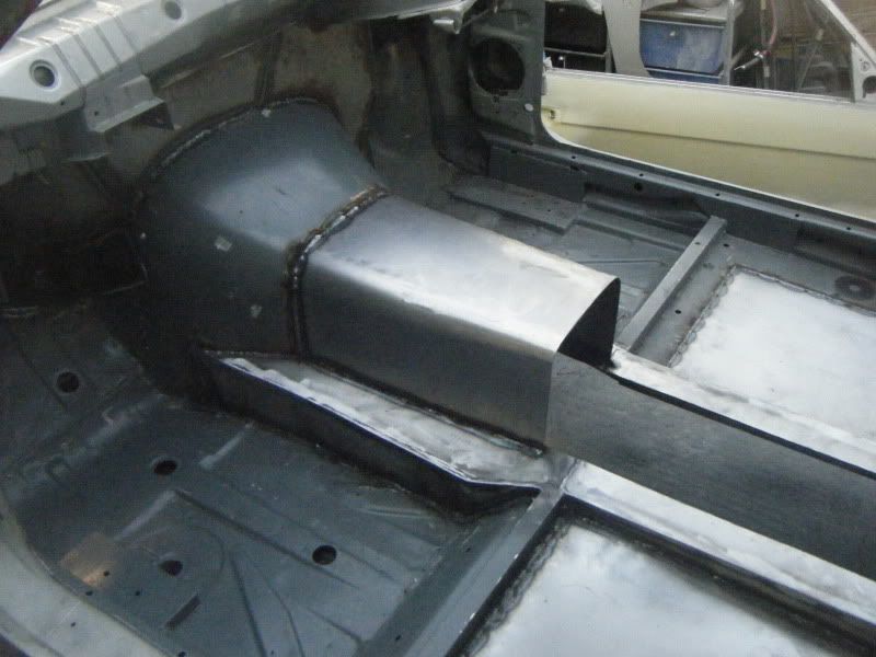

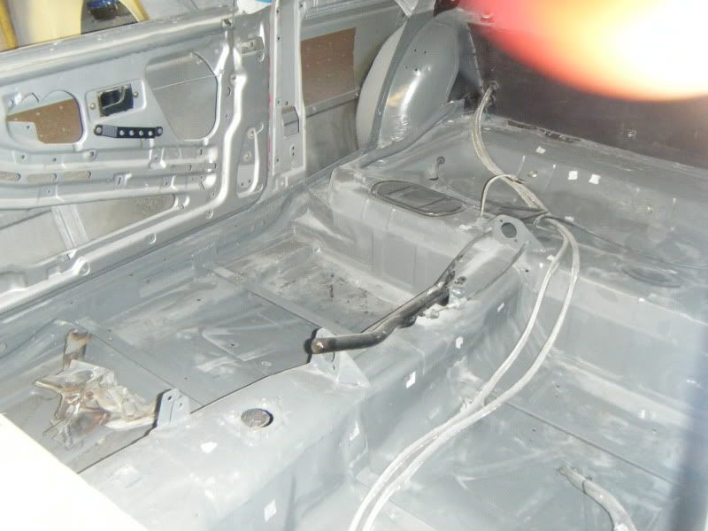

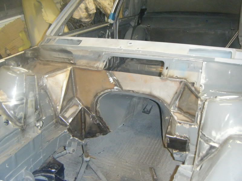

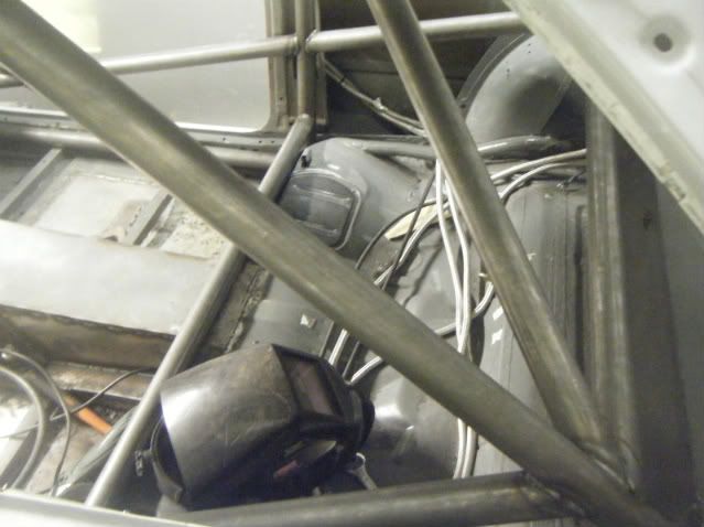

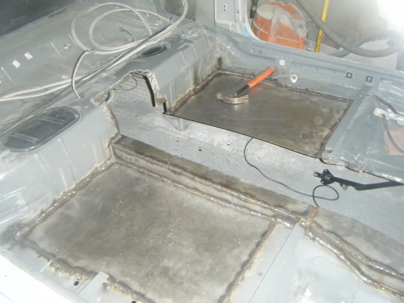

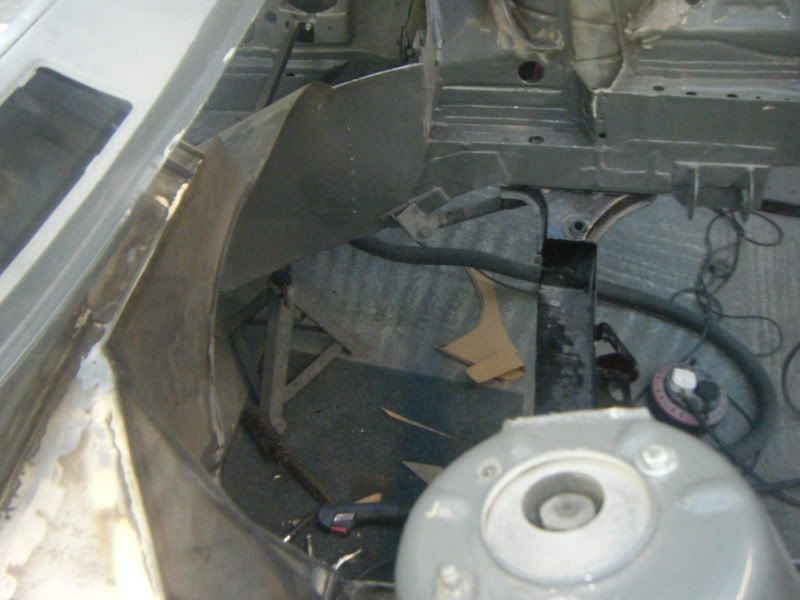

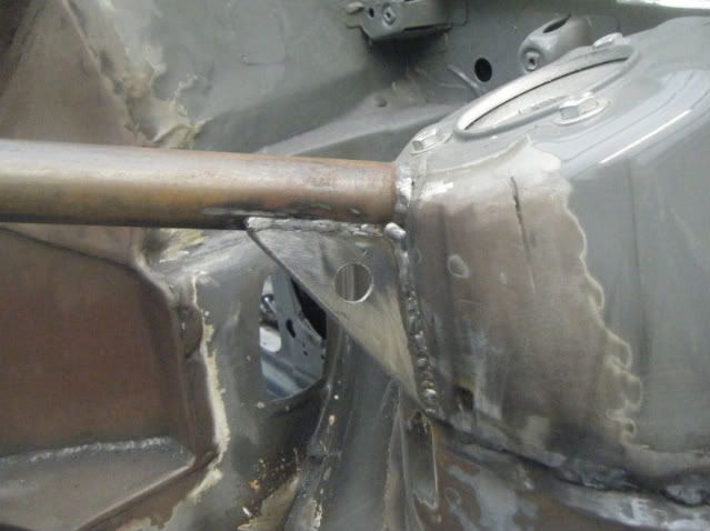

Posted a some pictures in the zoner's track day cars forum a couple of weeks a go but thought I would start my own thread here. At a biit of a stand still at the moment due to lack of parts but will update provided there is enough interest. Will let the pictures do the talking.

Wow you do mess about :D, what engine you putting in?

Steve wrote:Wow you do mess about :D, what engine you putting in?
Iirc it is an S50, sat errrr.. Quite far back :cool:

Used to be RHD also I think :D

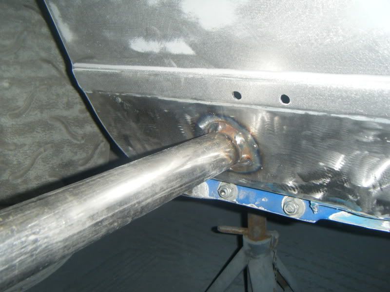

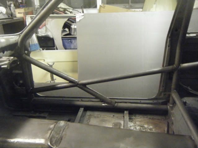

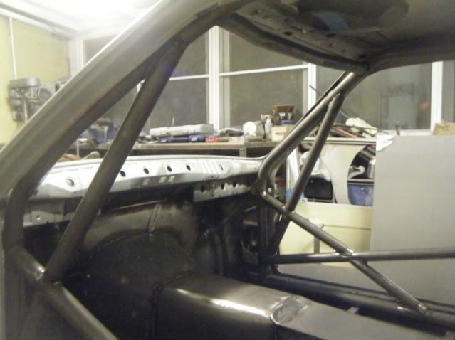

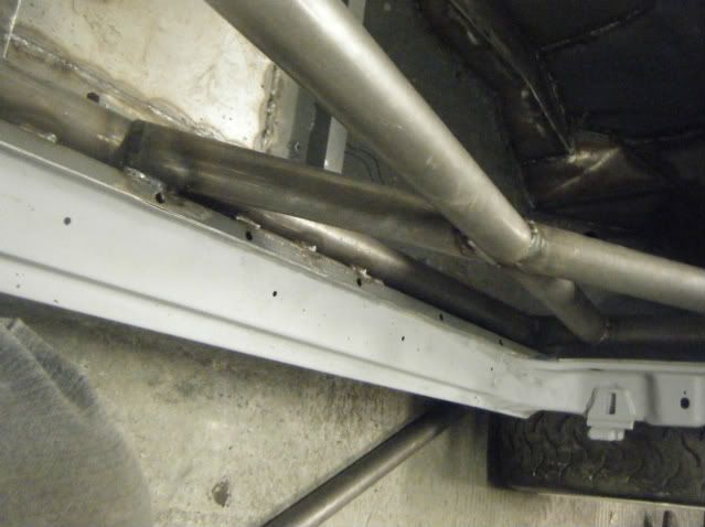

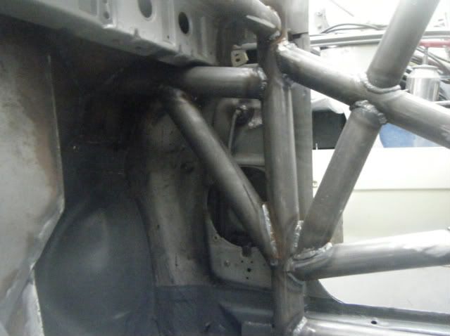

Nice job, very good details for the hand brake mount etc.
What the logic with the door bars not going to the bottom of the b post
Jason

Thnks guys, the car did indeeed used to be RHD and will be running the S50 that was in it previously, with the exception of the sequential gearbox which should have been here today (damn weather :-x )

Jason, the door bars are like that to make it possible to get in an out with contracting into the feotal position every time, my knees are shot and I used to suffer with the prvious bolt so thought I should rectify it before I excacerbate the situation any more. The bar that runs across the sill goes to the B pillar, so they are in essence still 'double door bars so to speak, the x is more to act as a load path for the front triangulation. Early e36 touring cars ran the same set up but with a third bar running from the centre of the 'X' to the main hoop. I saw this as overkill considering the application so ommited it.

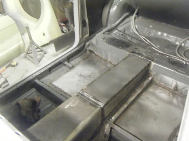

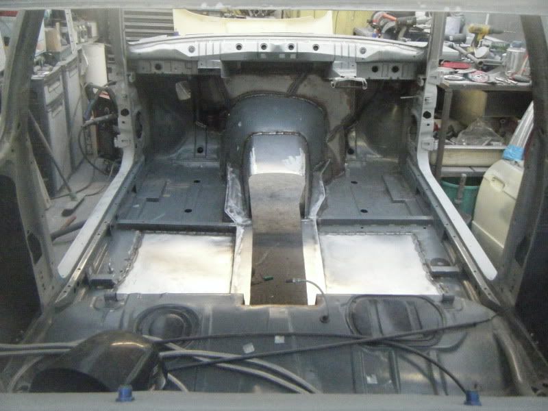

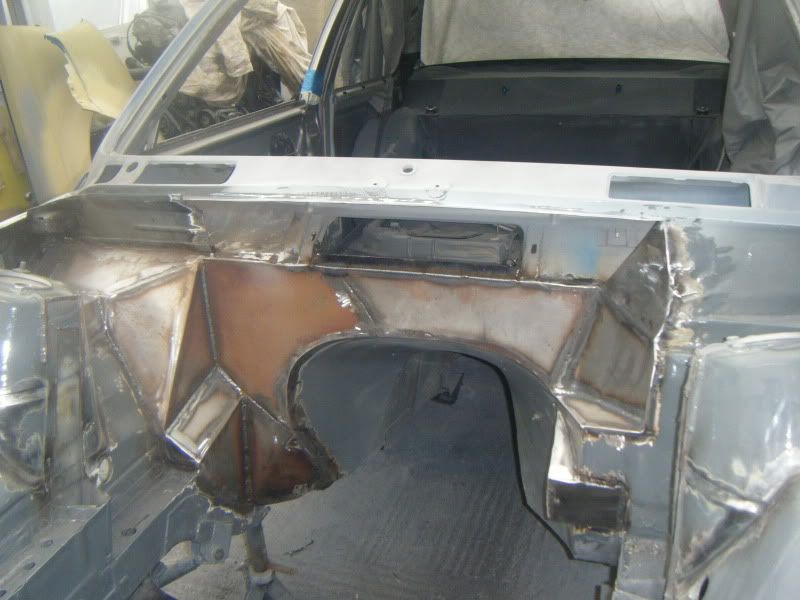

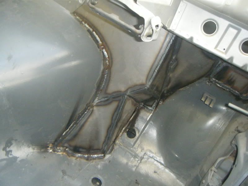

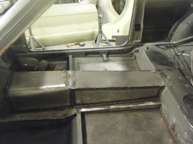

I started on the bodywork on september, took about 4 weeks to bare metal it, then gave it a long break until mid october when I sold the old rollcage so stripped the interior and took the engine out . That was when I made the bulkhead and floors. All in all its probably about 8 weeks work not counting the idle time inbetween jobs when I didnt have the enthusiasm.

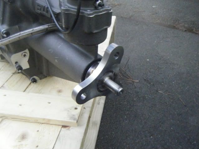

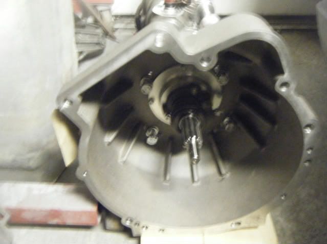

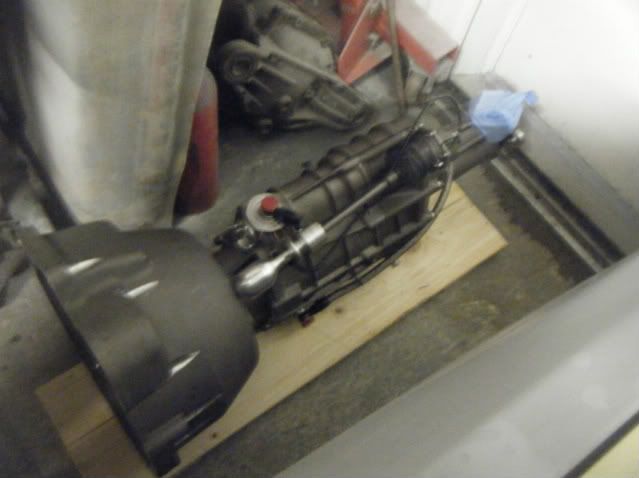

Well, the single most expensive car part ive bought in my life arrived today, shame it will be a while until it proves its worth. Must say im very happy with the items they machined for it, the yoke and input shaft are spot on and appear more accurate than the standard stuff on the ZF box.

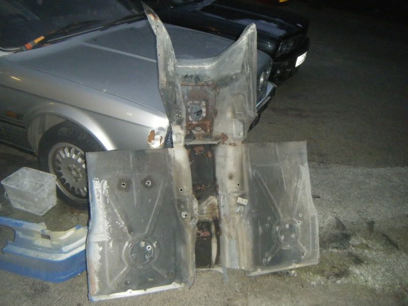

The chromie was an engine-less 84 323i which was molested last week before the petrol tank was subjected to all my waste oil and it made its way to the scrap heap in the sky winkeye
Bit of better quality gearbox porn for those into that sort of stuff:

thats lovely....for a hunk of metal :)
always wanted a sequential box.....how much does one of those puppies cost?

It is rather nice and clean isnt it.......but so it should be at 6.5k + VAT with the oil pump gear indicator and bellhousing 8O
Luckily im a Channel Island tax dodger and didnt have to pay the VAT winkeye

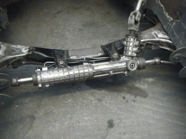

Post Wed Nov 17, 2010 2:01 pm

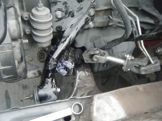

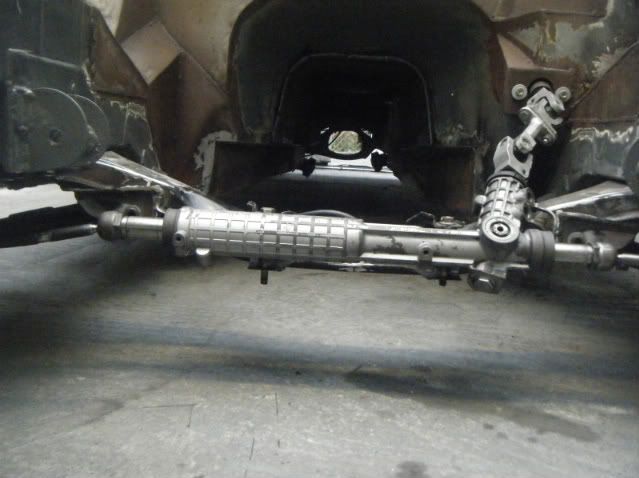

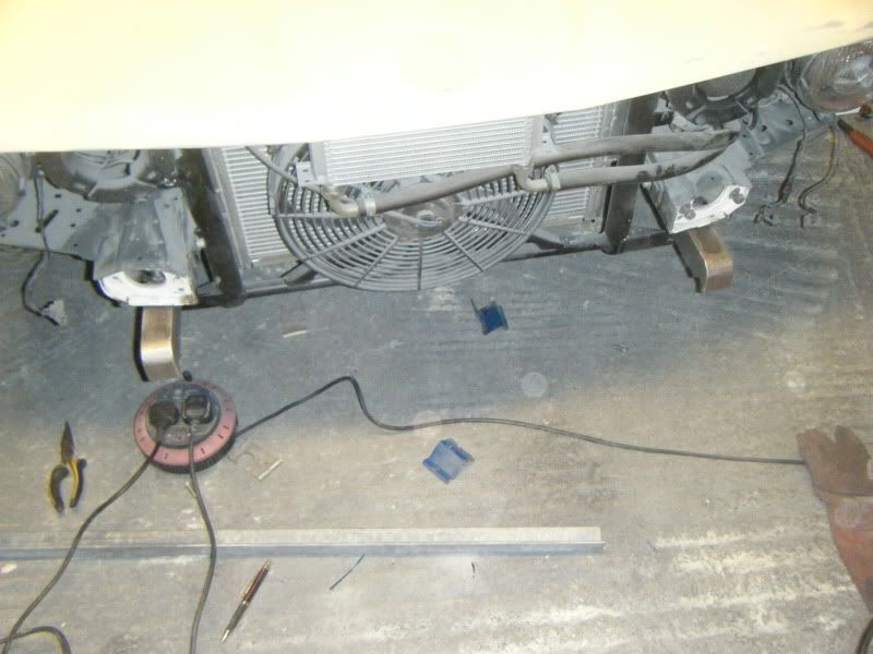

New crossmeber finished with much improved roll centres, the front has been moved upwards 45mm to negate the effect of lowering.
Please excuse the bent tie rods, the rack is off an accident damged car and I still havnt received the new ones.

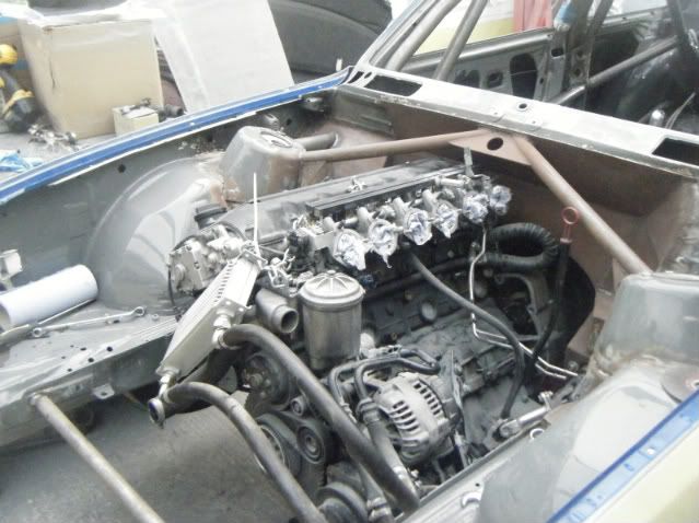

Post Mon Nov 22, 2010 2:19 pm

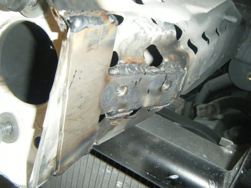

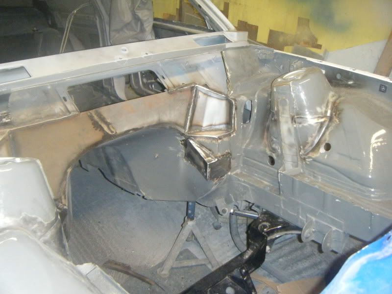

Dummy fitted the engine and gearbox today, all went in rather nicely. As you can see I've used the rearmost lug from the old engine mounts to to position it for now. The offside can stay as it is with the old front mount becoming the rear if you get what i mean, but the nearside will need re-doing as the chassis legs taper towards the front of the car and so they are about 5mm out causing the motor to be twisted slightly, hence why the the gear stick is slightly off centre at the moment.
Have ordered some e30 trailing arm bushes which i will use to make a chassis mount style gearbox cradle. Once the gearbox mount is done I can do the engine mounts, then the prop-shaft and anti roll bar mounts, make up some brackets for the oil cooler, header tank and brake reservoirs, then its on to prepping for paint at last :!:

Thats in about the same position in relation to the strut tops as an E36 8)

Are you using the E36 sump?
