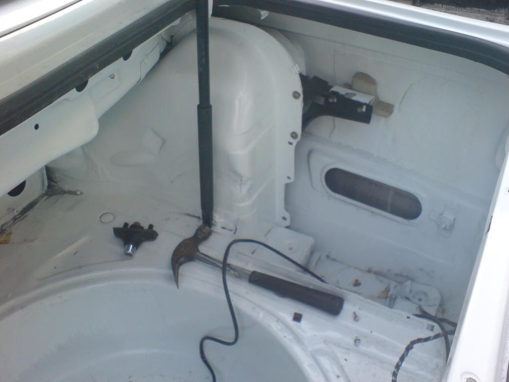

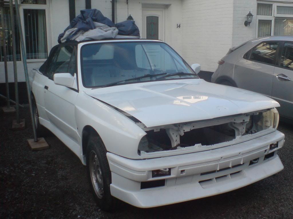

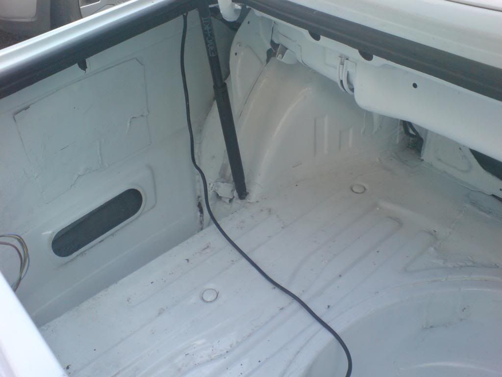

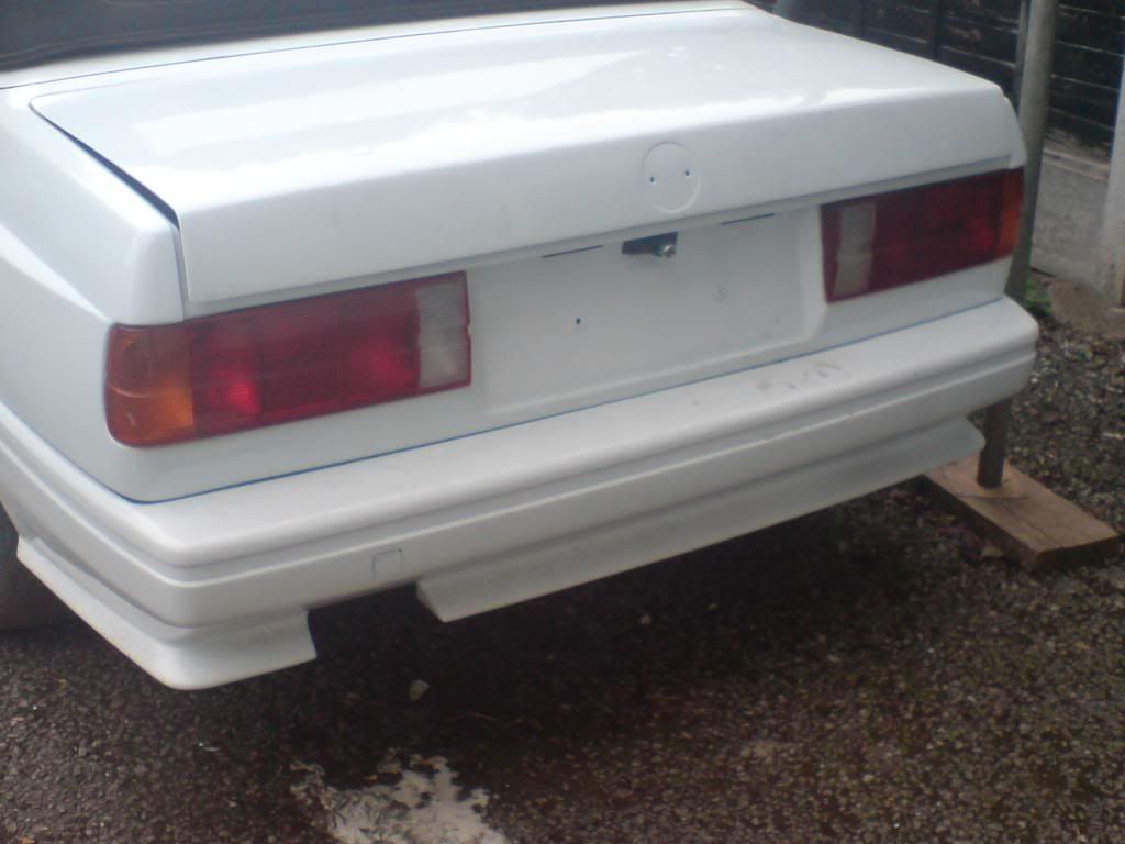

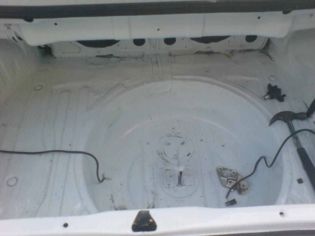

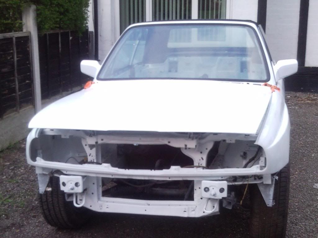

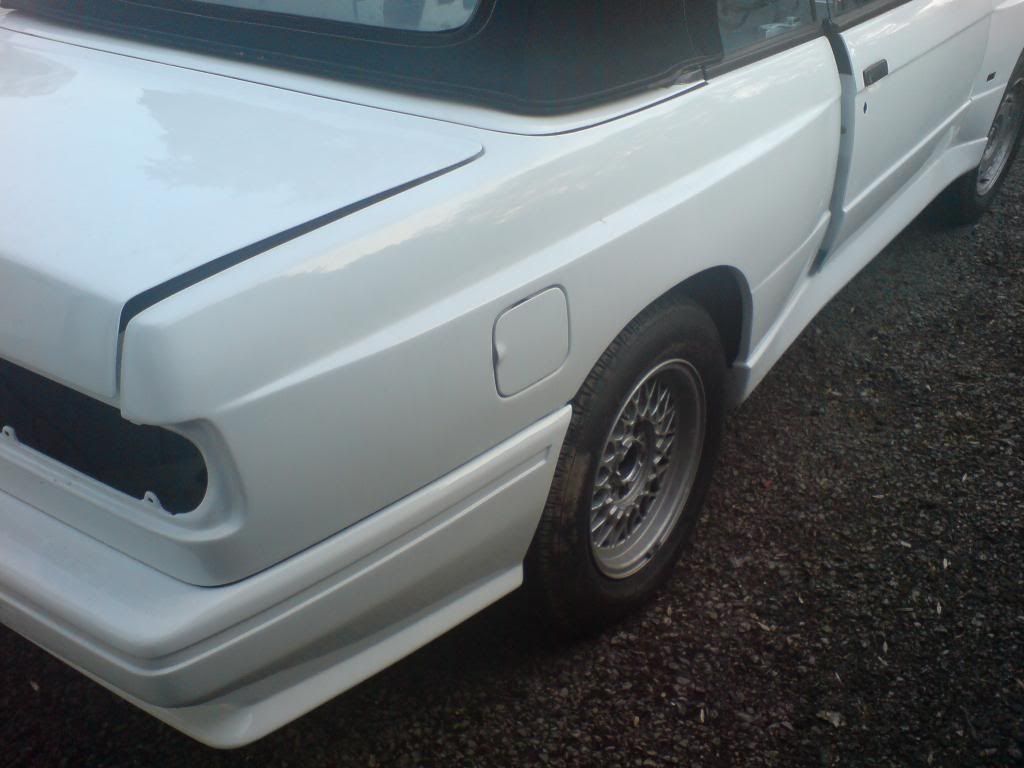

Pictures of when I first got the cabby. All bodywork and respray work done. Full E30 M3 suspension already fitted. Apart from that, a bare shell. Basic wiring loom fitted but removed further down.
Exterior:
Interior:
Engine Bay and Boot:

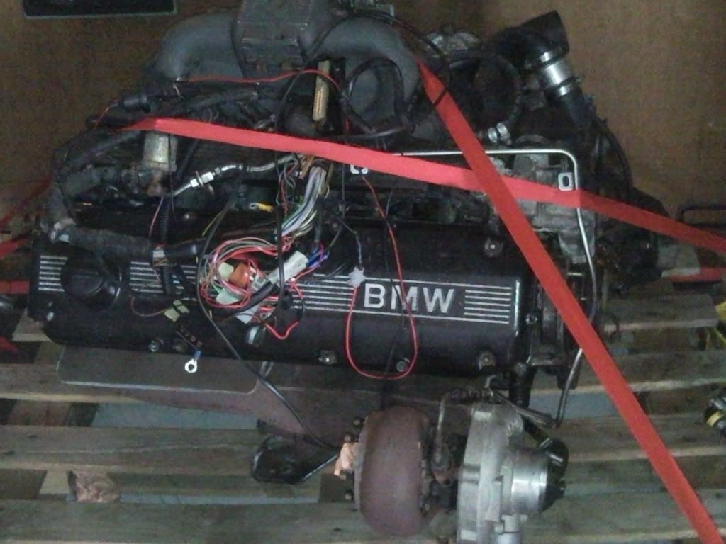

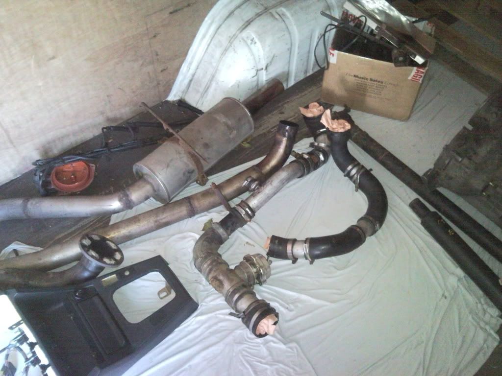

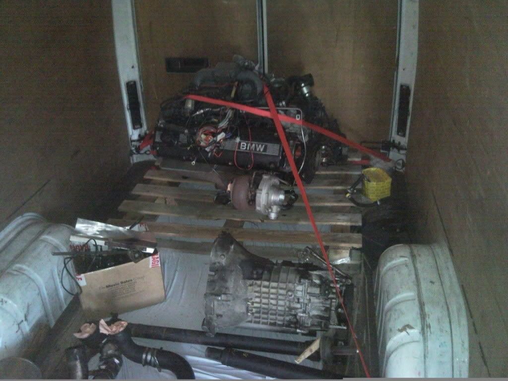

Next up was to buy something to fill the gap left in the engine bay. Thought M52, M30 even S50 if I won the lottery but as soon as Martin (DRIFTBOY) was thinking about selling his set-up, there was only one thing on my mind.
Drove all the way down to Kent to pick it up and bring it home (good doing business with you Martin).

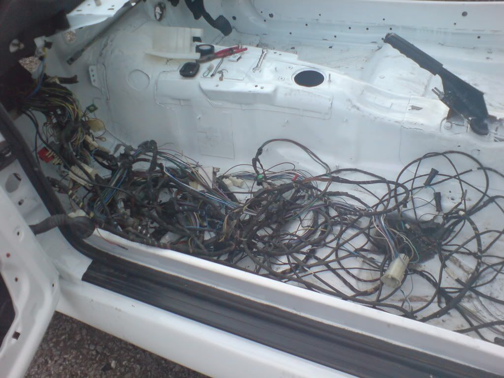

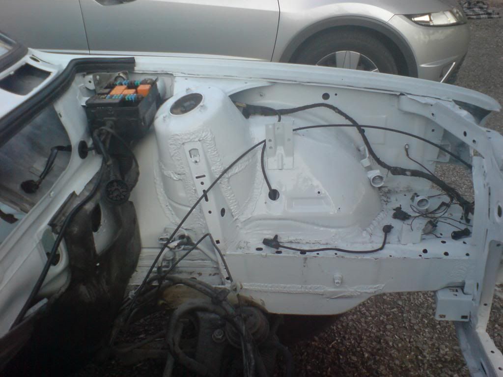

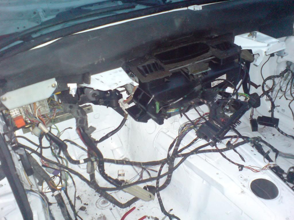

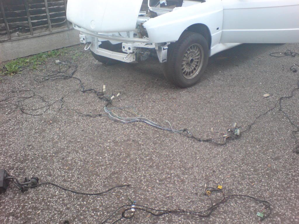

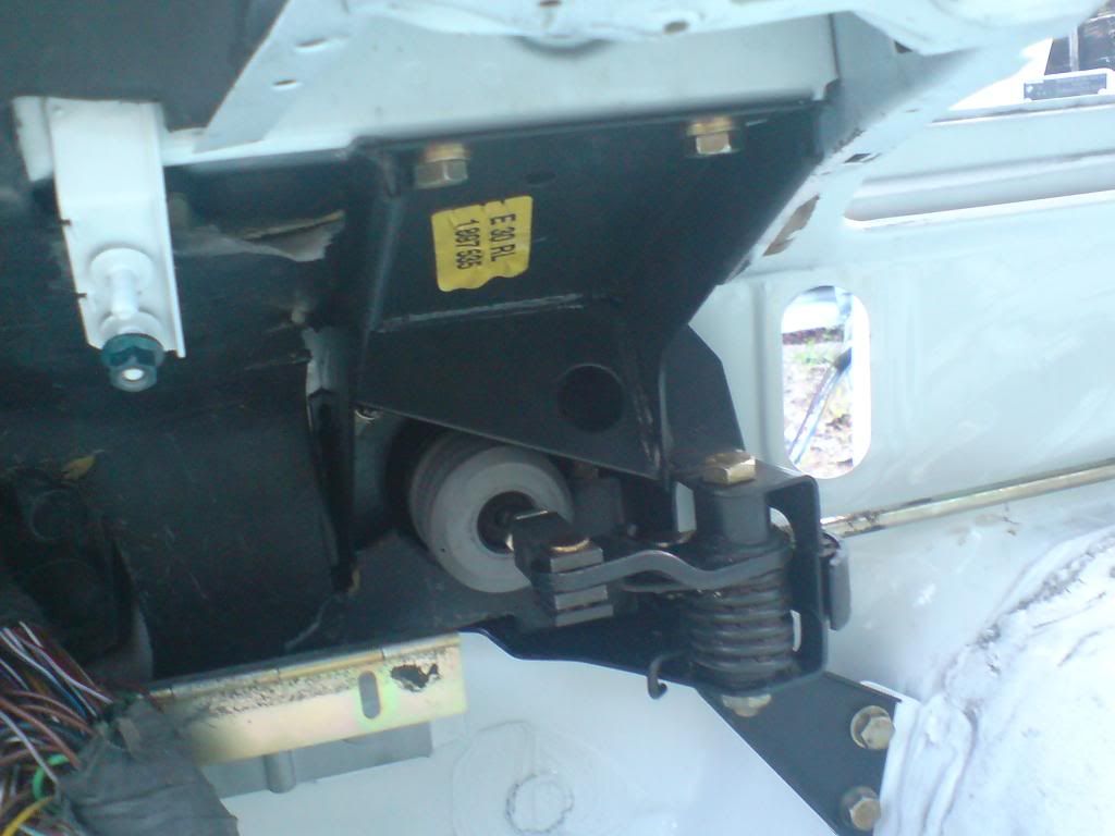

Time now to focus on sorting the body loom out. It came with a weedy 4 pot loom without the check panel so this had to go. Got a cabby 325i loom (cheers Barx) and then to take out the 4 pot loom and put in the 6 pot loom. Took a fair few hours but worth it.
Out with the old:
In with the new:

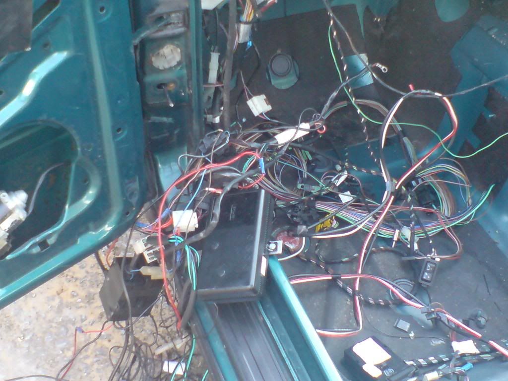

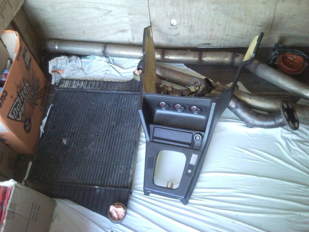

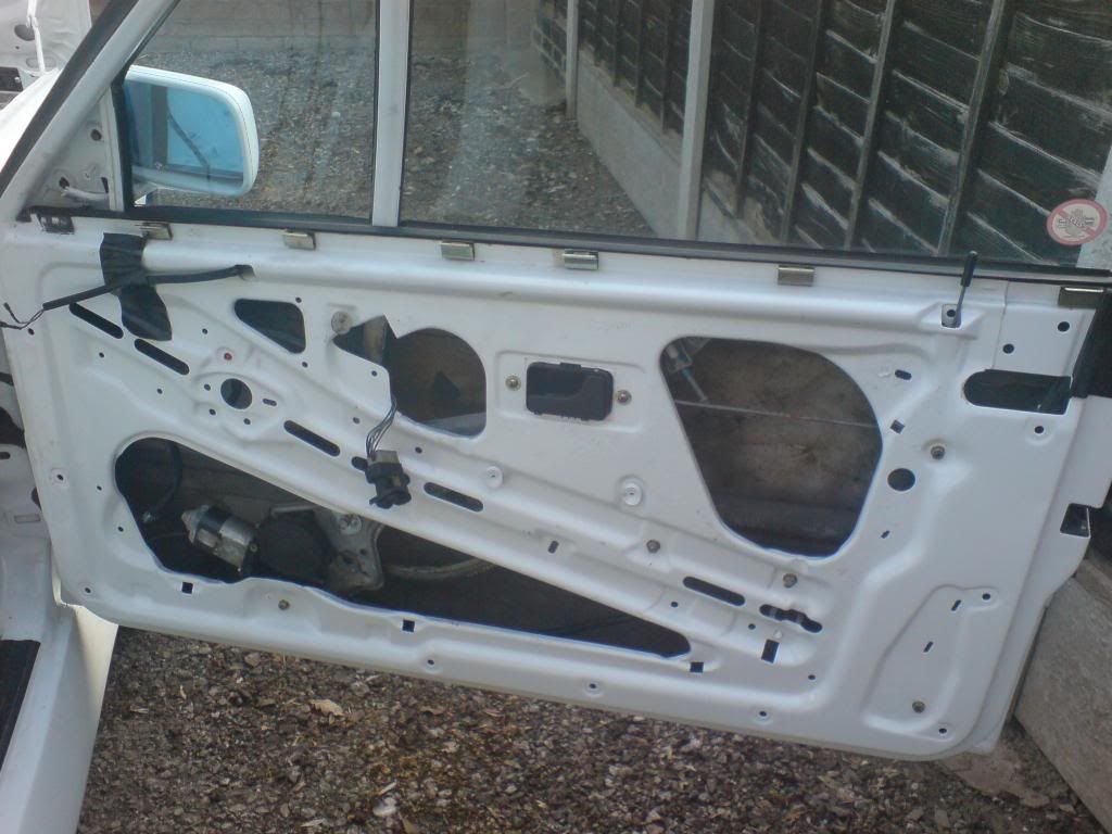

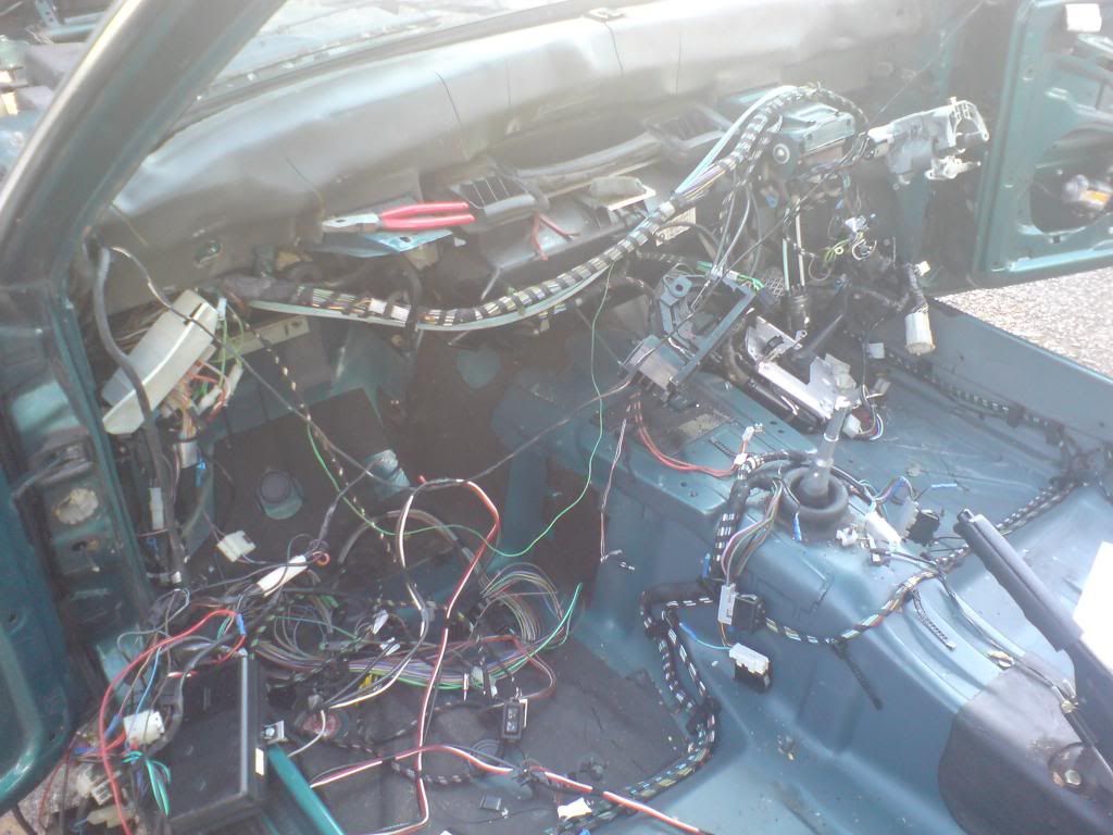

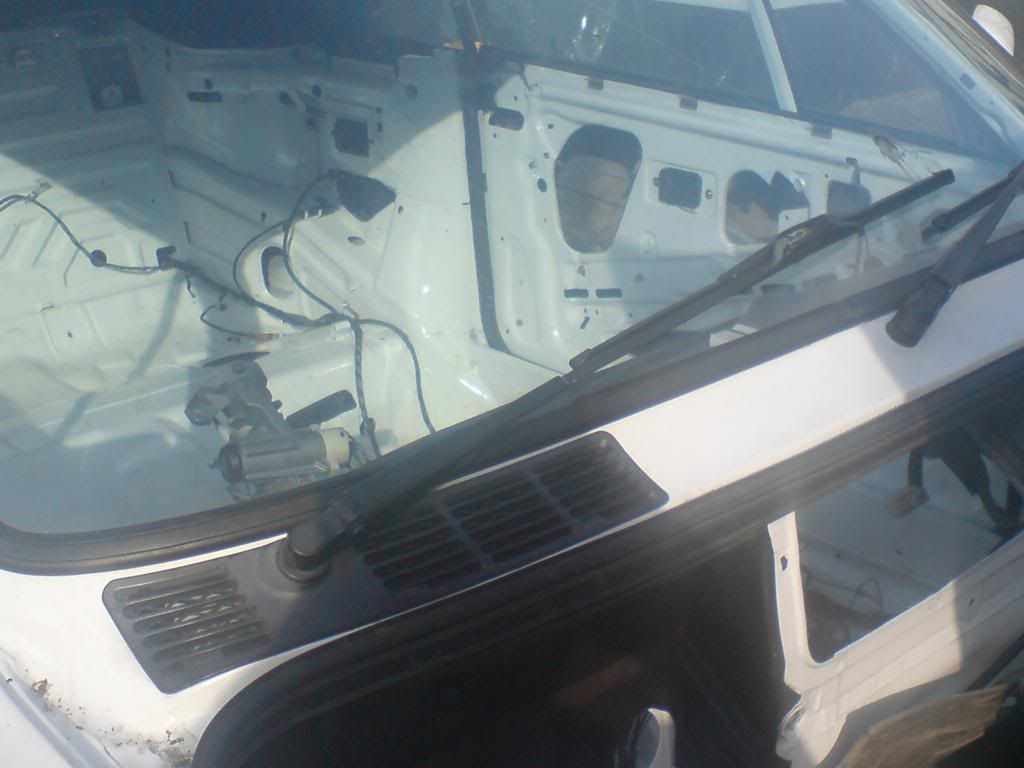

Meanwhile on the other cabby, time to take out the dash and pinch a few bits of loom. Also removed the original BMW alarm as intentions were to fit this to the new cabby but going to fit an aftermarket one now. After a few hours, left with this:
Removed the wiper arms and motor from the other cabby and fitted them to the M3 cabby. A bit fiddly with getting the wiper arms in but got there in the end:
Standard rear lights fitted along with new number plate lights (GSF). Boot lock from other cabby also fitted.

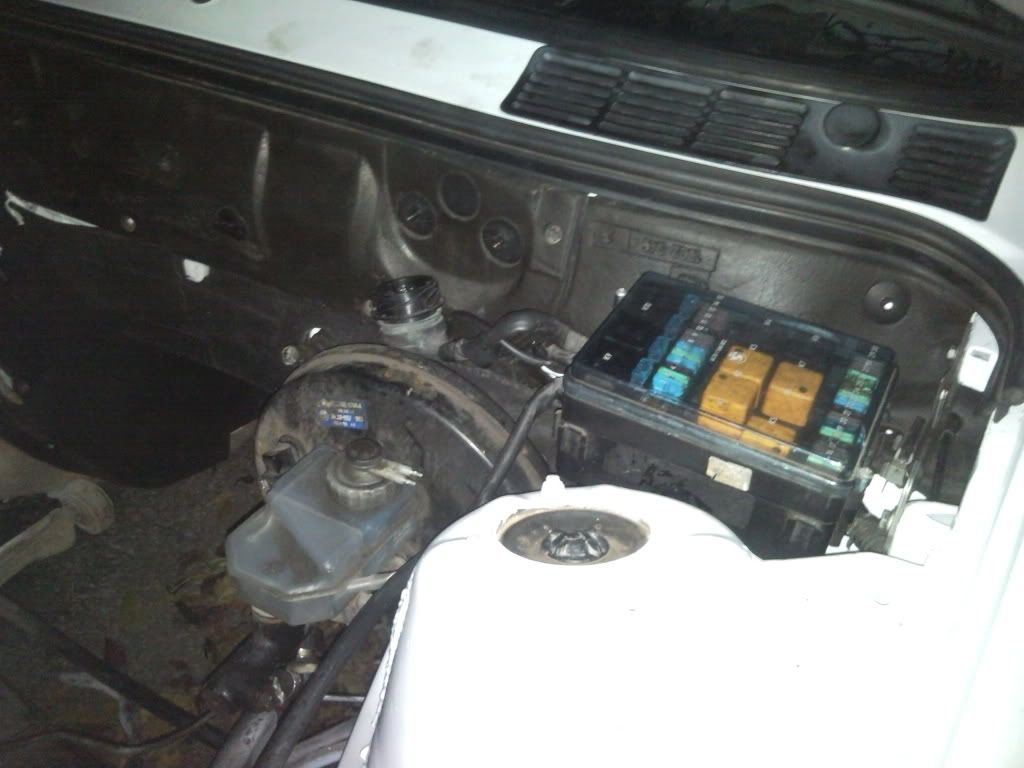

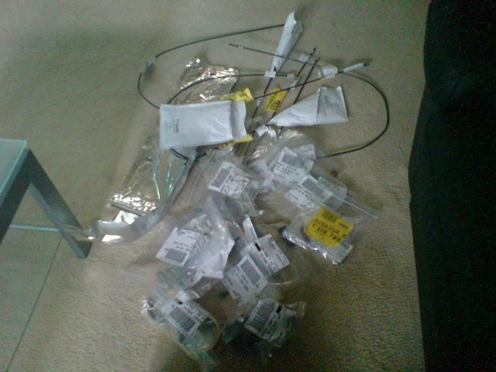

Next thing to do was to connect up the entire wiring loom and to also fit the pedal box removed from the other cabby, brake servo (cheers town325i) and heater box also taken out of other cabby.

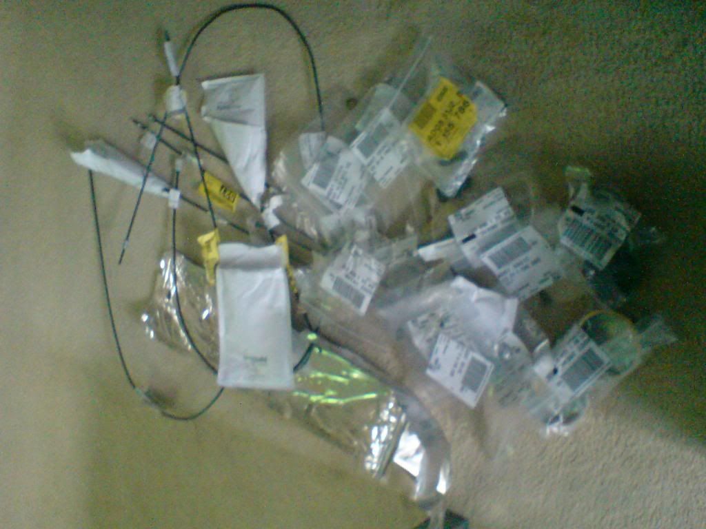

Ordered a few goodies from BMW, mainly brake lines:
That’s as far as I’ve got at the moment, until the next update”¦.

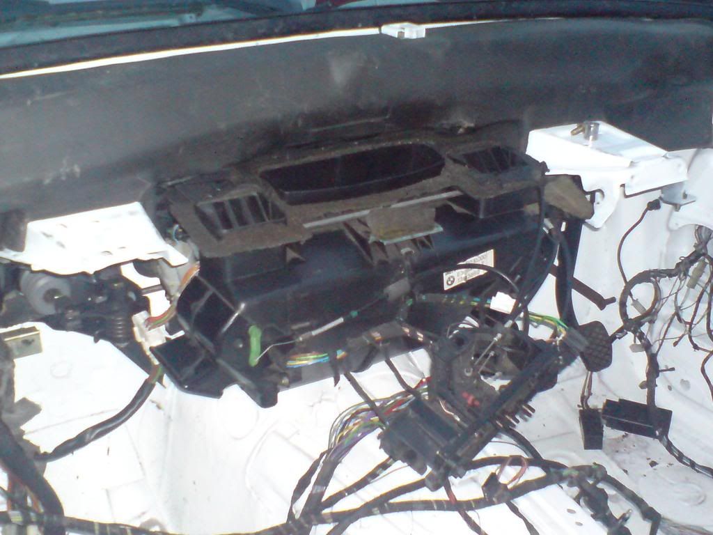

Tue Oct 19, 2010 9:38 pm
Some advice.
Buy a new foam gasket for the heater box as the one in the pics is fooked and you want a tight seal against the ducting on the dash.
Also, fitting a carpet thats not been cut is near impossible to do with the heater box in place.

bss325i wrote:Some advice.
Is it part number 4?
http://bmwfans.info/parts/catalog/E30/C ... nstrument/
This is just to get the car ready so i can get the engine in, can always remove it and re-fix it once i get to the carpet stage :)

looks a good project for an M3 rep , at least it has the correct rear lights :D
what was welded into the boot floor ?
ImysE30
Posts: 22486
Joined: Mon Jul 07, 2008 11:00 pm
Location: Derby Massive!!
Tue Oct 19, 2010 9:53 pm
Not sure, never noticed anything :?
Yes its part number 4.

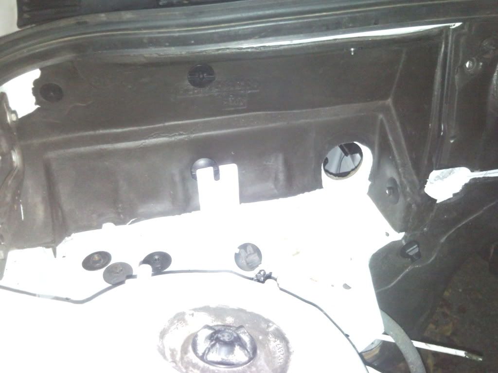

Tue Oct 19, 2010 10:17 pm
Cheers Barry, i'll get one ordered :thumb:
I've done the insulation padding in the bay, forgot to take pics but will put some up tomorrow.
Next is to get the dash in and all the bits that go with it. Fit all the seat belts and then drop the tank to put the correct loom back in.
Probably fit the electric hood and motors afterwards depending on the weather.

UPDATE - 20/10/10
Bought some new engine bay sound insulation from BMW as the old one was torn and cracked. Also had to re-fit the brake servo as i had to remove that to get the insulation to fit.
Fitting was pretty easy with the engine out :)
Really freshens up the engine bay :cool:
