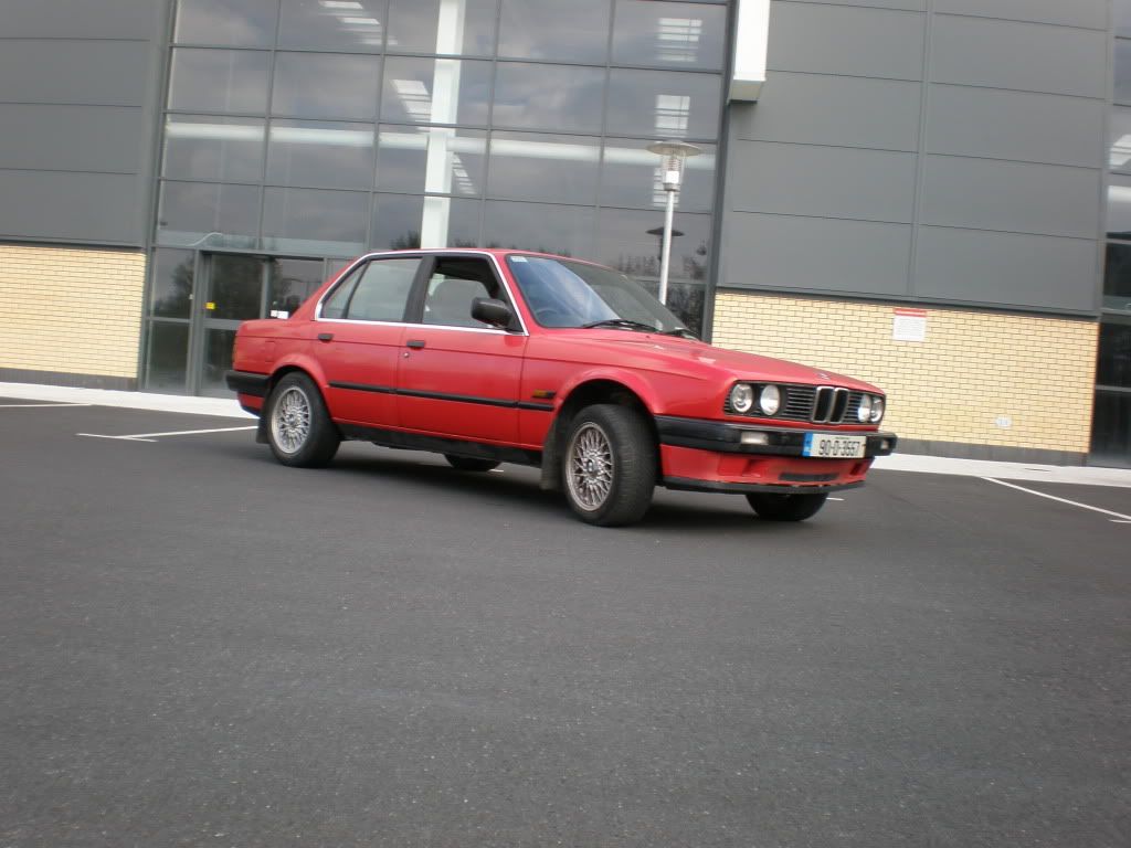

I got my 1990 318i in October '09, this is how she looked the day i got her:
She was completely standard when i got her and more than a little pink 8O

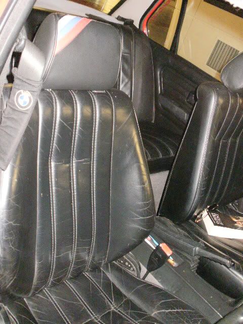

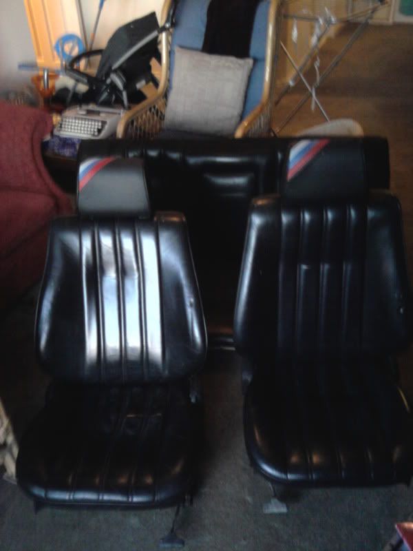

One of the first things i did was get a new interior for her
New interior fitted

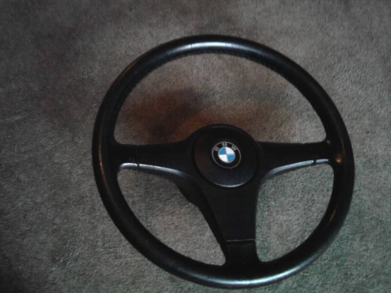

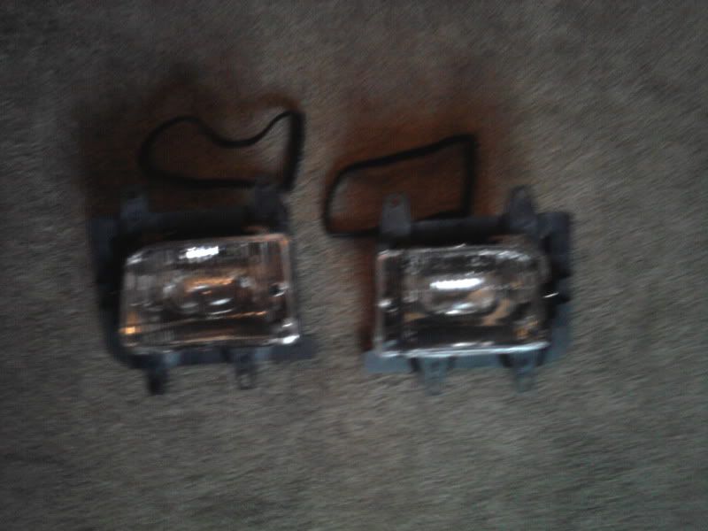

Same day i got the interior, i got a few other goodies, including a new steering wheel and foglamps which are both now fitted

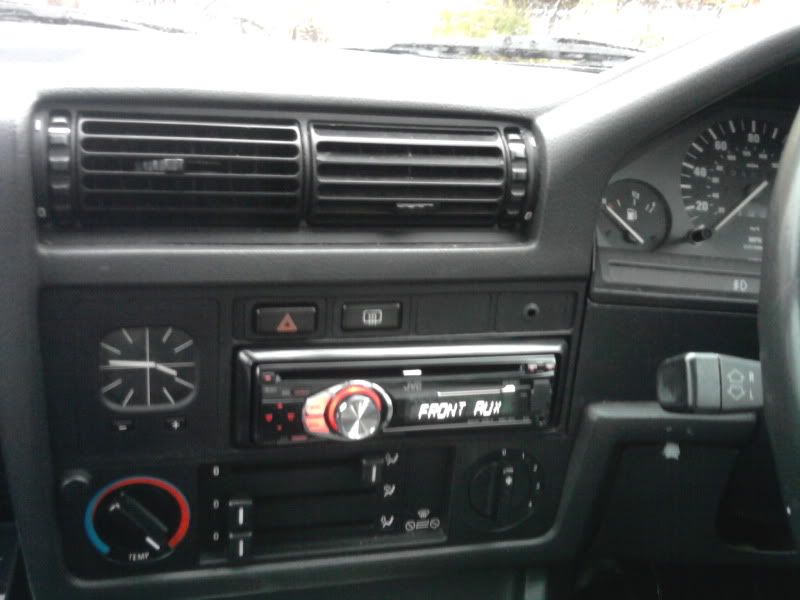

Got a JVC iPod headunit

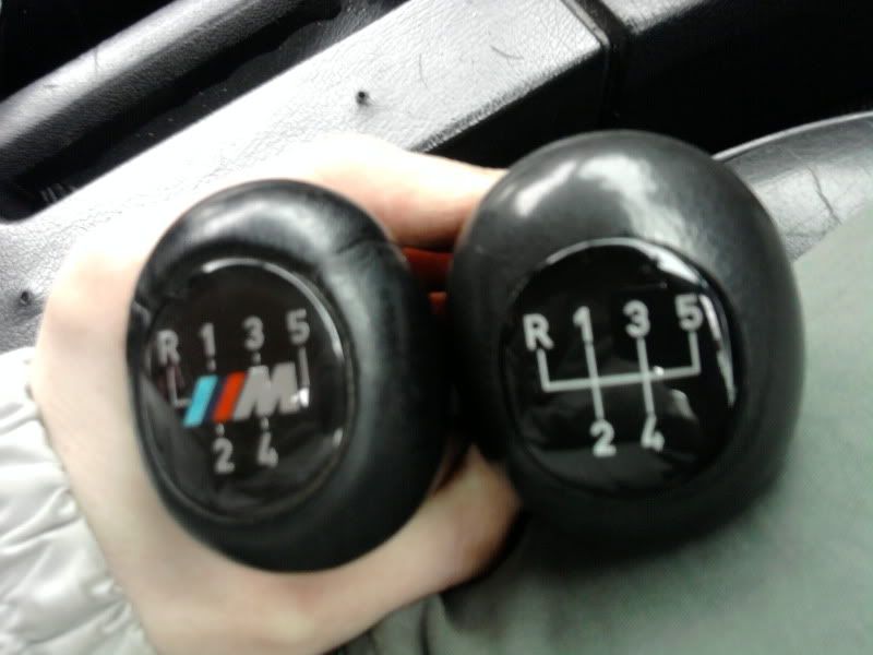

One of the lads gave me an Mtec gearknob

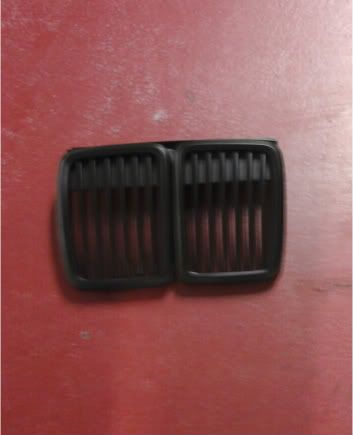

Got a shadowline grill
Grill fitted

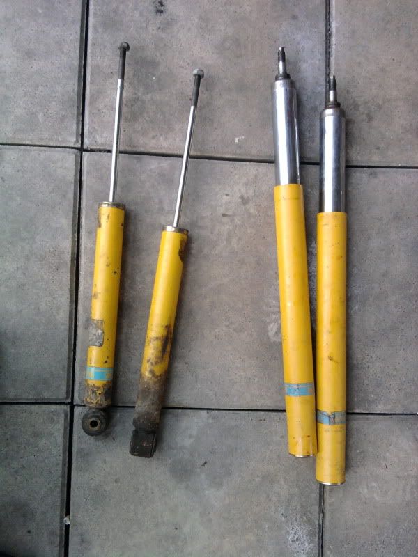

Got some Bilsteins

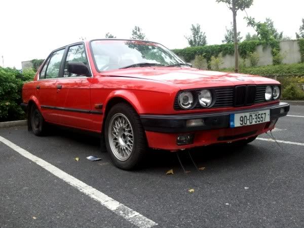

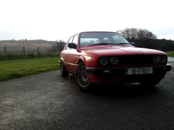

I'd had 2 tires bust on me in the space of a week a while back and hadn't been able to afford more rubber at the time so she'd been running on my spare 14" steelies for a while (as seen in the pic above just after the compound/buff. I just rectified this a few days ago, and this is how she stands at present

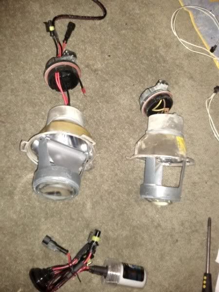

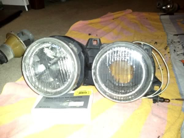

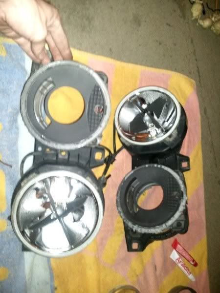

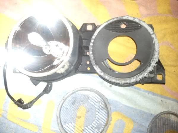

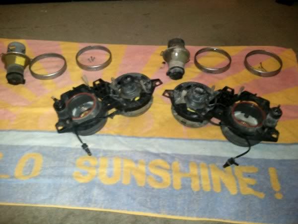

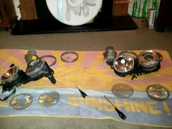

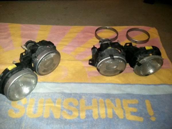

So i finally got off my ass and spent the last 8 hours or so doing my headlights - smoked, HIDs & Angel eyes.

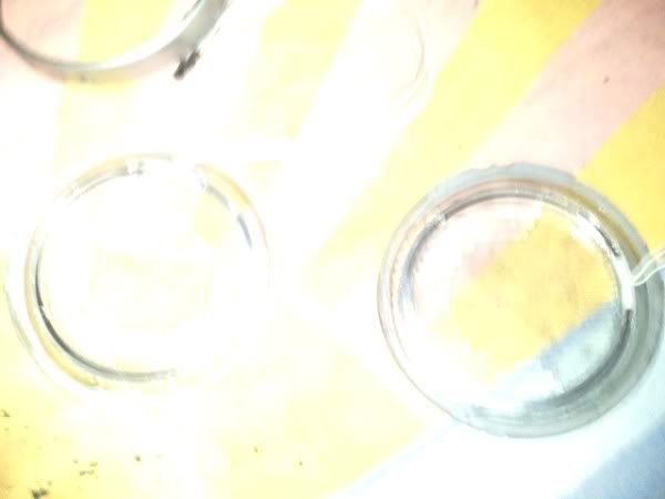

Removing outer rings
Removing dipped beams
Removing glass
Dipped beam insert sprayed and fitted

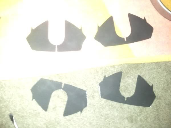

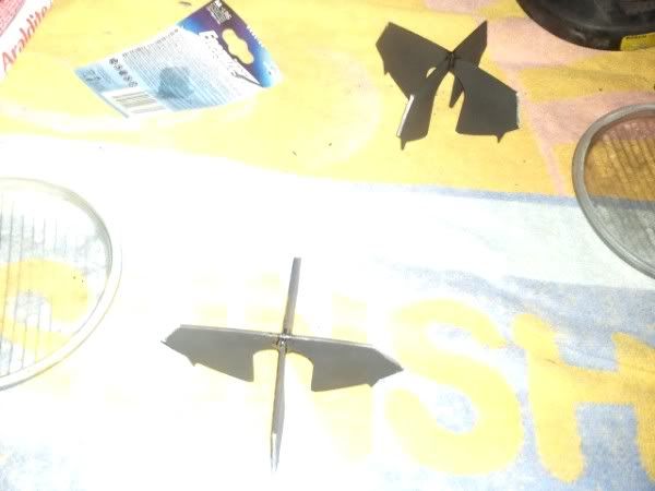

Crosshairs sprayed
Crosshairs glued together
Crosshairs fitted

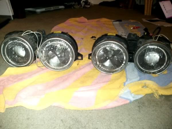

HIDs fitted (HIDs on left, standard on right)
Terrible picture of angel eye halo rings fitted
Lights re-assembled
So, since last post, the z3 shortshifter was fitted and made a nice difference :)
And i finally got off my ass and spent the last 8 hours or so doing my headlights - smoked, HIDs & Angel eyes.

Those shrouds round the projectors on the dipped beam are a good idea when fitting HIDs as they stop the glare you get from the reflector behind the projector. Will also do a good job of separating the light from your angel eyes too so you will actually be able to see them with the HIDs on!
Looks like you've made some good upgrades since buying it. But I can't help thinking the front is way too high compared to the back! 8O Did you have lowering springs fitted all round when you had the shocks changed??

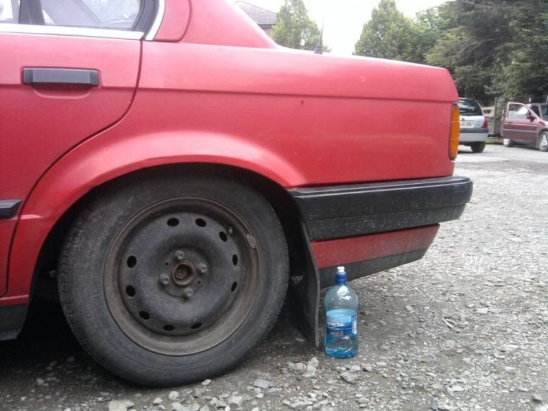

@aj_mckay: Thanks :) Yeah, i realised about a week ago that the springs i have are 6cyl springs, my car being a 4 pot doesn't have the weight over the front to get the proper ride height. It'll be sorted whenever i finally get myself round to the m50 conversion. It's supposed to be -40 front/-60 rear.
@magpie: got them from Rav320UK off here :) I had to modify them slightly to cater for the angel eye rings.

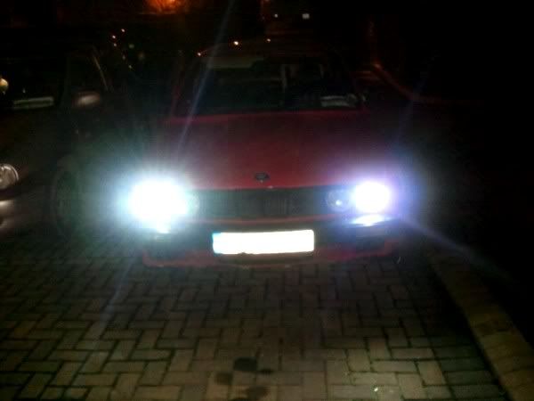

Thu Nov 18, 2010 10:54 pm
Here's the HIDs wired up. Need to get them focused.
Haven't had a chance to take a pic of them fitted just showing how they look smoked, and i also haven't gotten to wire up the angel eyes yet so can't show them either.

Sat Nov 20, 2010 12:14 am
Looking very good there bud, i fitted my HIDs about two weeks ago, and what a diference! Was very pleased with the result.
Just need to do the insides of them now, just waiting foor a nice day haha!
Just wondering, what do you mean by geting the headlights focused? Do you mean adjusted?

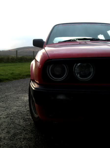

Here they are fitted since i smoked them

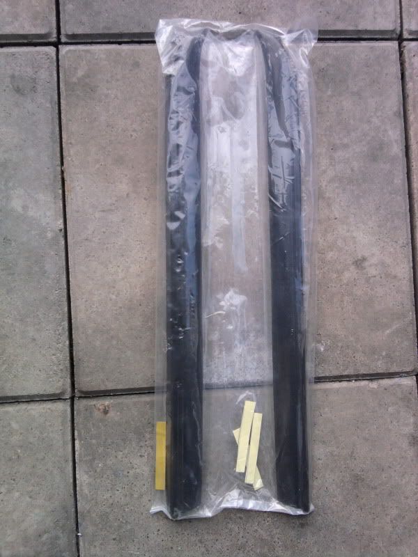

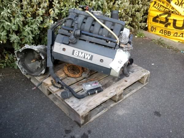

Well, in the time that the zone was down, this arrived winkeye

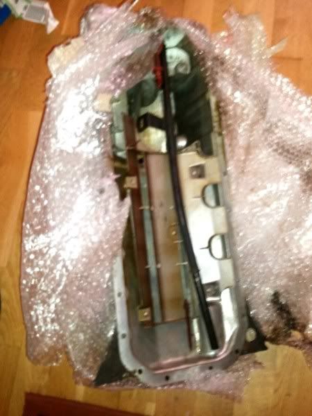

Also received the 88* thermostat about a week ago, and the e34 sump kit arrived today :cool:
Slowly slowly catchy monkey :P
Tue Mar 08, 2011 5:43 pm
That looks like it came from a LHD E36 8)

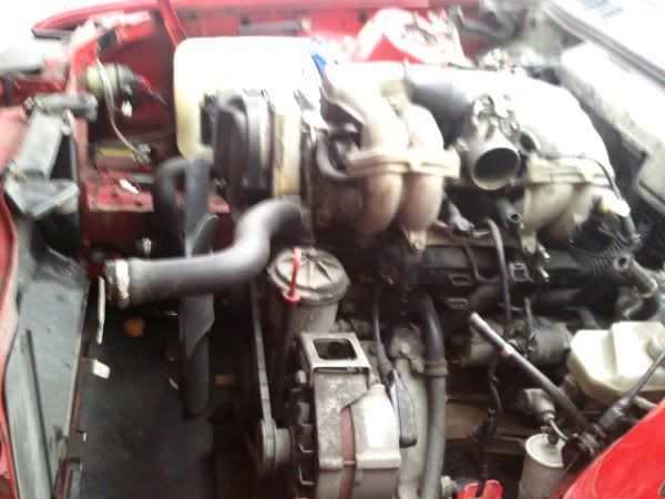

Finally got off my ass and started to prepare for taking out the m40, pretty much ready to be taken out just have to undo engine & gearbox mounts, exhaust, prop. Waiting on one of the lads to grab a crane :thumb:

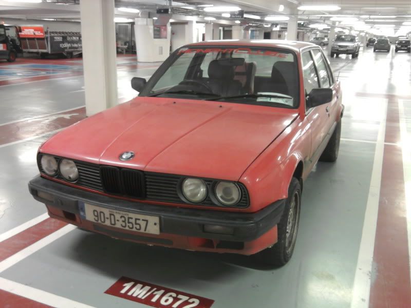

And here's the bit of jap scrap i'll be running around in for the next coupla months. It's completely sound mechanically and has NCT til Jan '13 so i'll probs keep it for a while anyway.
I now have the flywheel, sump/dipstick/oil pickup, and thermostat that i need, and am waiting on delivery of the engine arms, mounts & servo that are necessary.

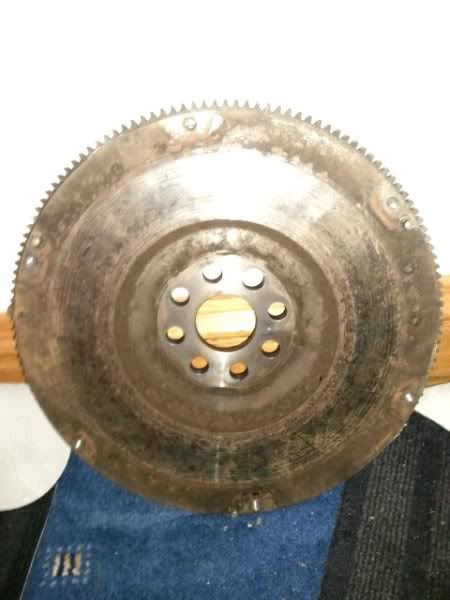

Have to get the flywheel lightened, anyone any suggestions for somewhere decent?

m20 flywheel
e34 sump, dipstick & oil pickup

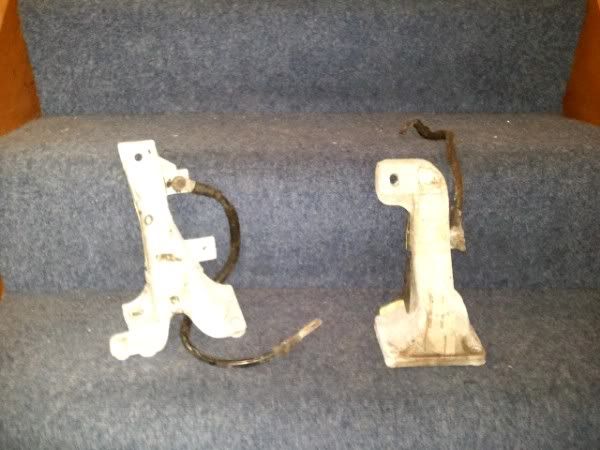

e36 Alloy engine arms

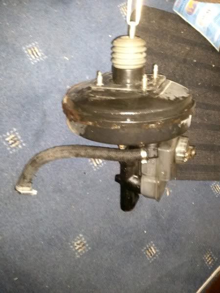

Clio brake servo with necessary mods already done

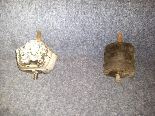

e28 m5 rubber engine mounts
